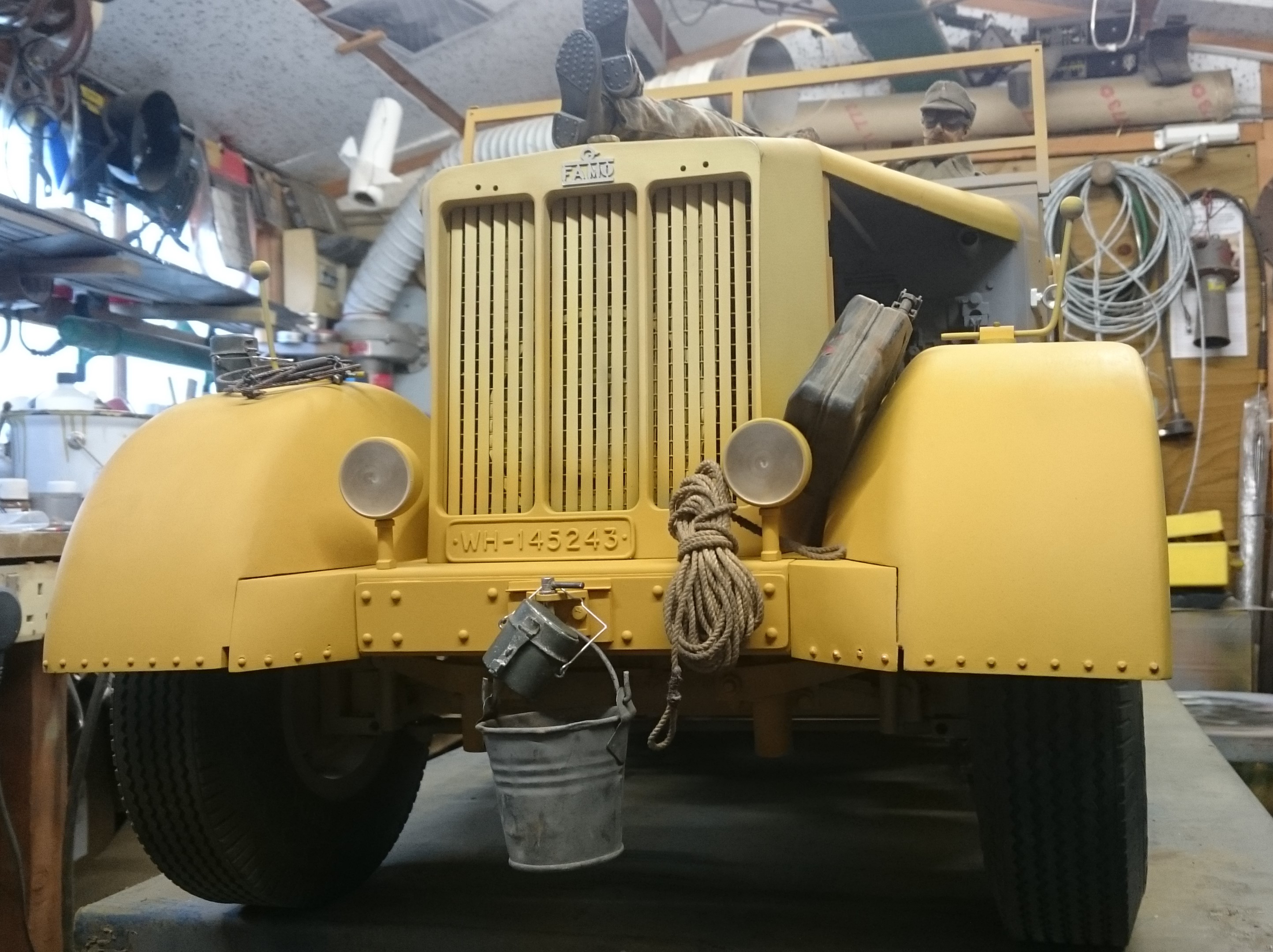

Thanks Florian, when you get a minuet can you see if your tyre rubs the back end of the outer edge of your fender please, mine is and will need a fair amount of material removing so that it clears. When there's load on the axle it's not too bad but as the front lifts ie, when the front is light or is crossing a hole it catches, is it just mine or me?
As the wheel turns to the right the tyre catches just here.

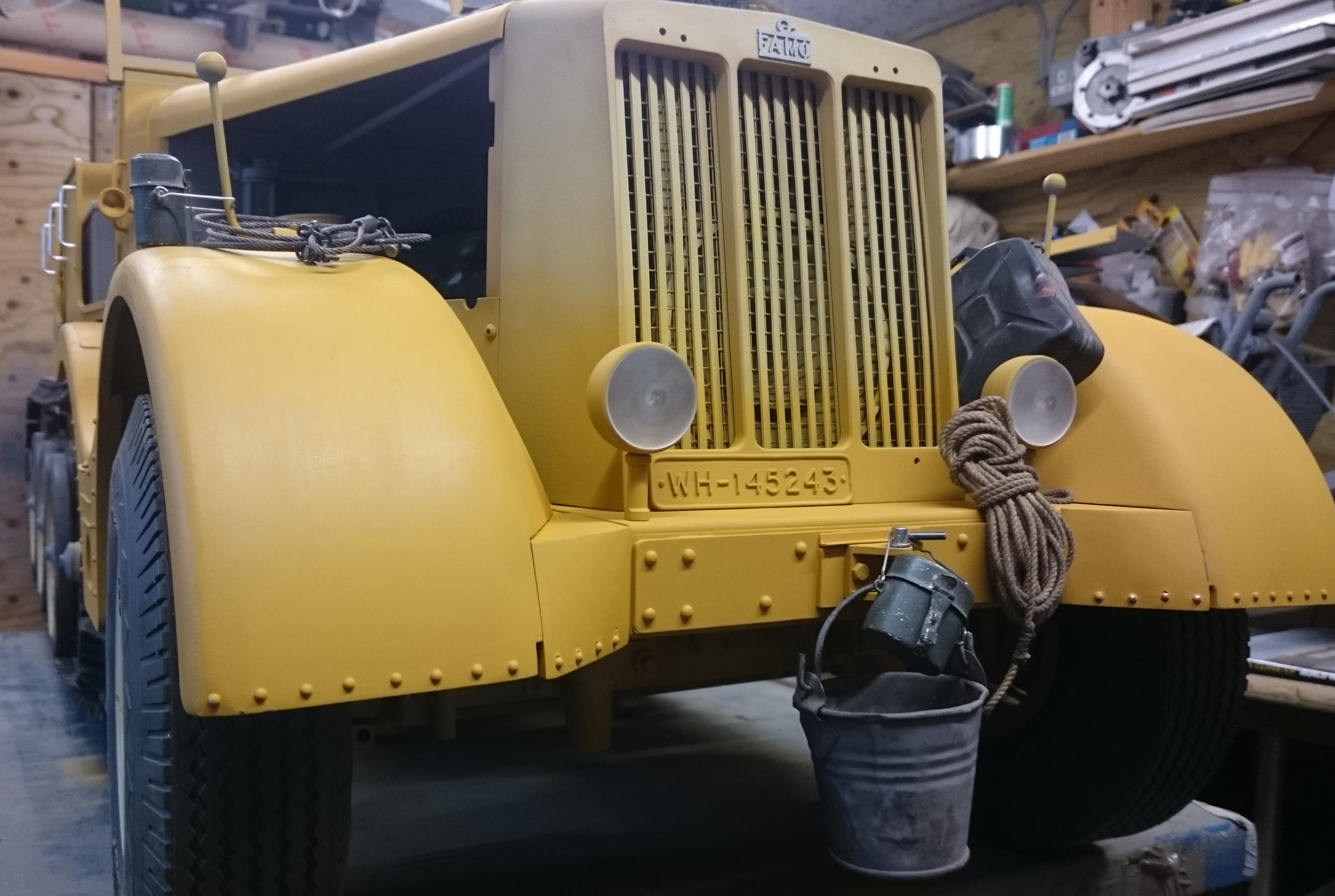

I've sorted the tyre rubbing issue, A little more progress the front 1/3 of the vehicle is getting there, there's so much to do, this kit could keep you busy for a year (part time), so good value for money.
I've gone for the 1938/1943 types, this covers lots of variations.

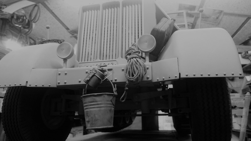

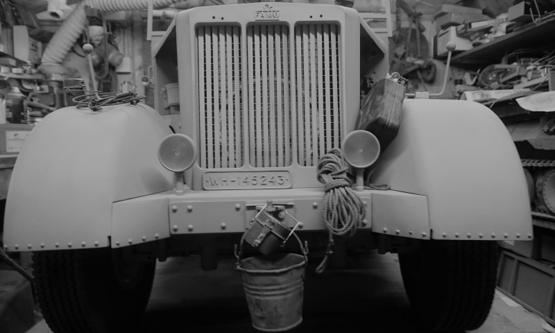

I do like the reinforced front cross member look with all the big rivets
You can appreciate the need for the reinforcing plates, when they are all linked together to pull a Tiger1 the forces on the chassis must have been incredible.
Oh no not a bucket!
Oh no not a bucket!
The number plate won't fit in the suggested place so I have gone for the 1942 position. (don't quote me on that)

From the above two photos dated 22/dec/2018, we can see the foot steps are totally clear-cut through the fenders.
So unless we also cut it through, to paint it darker/ black colour is the only option, I reckon.... :idea:

I agree, it's a massive piece of ali indeed and really needs milling at the back to, I guess we may have to live with it.

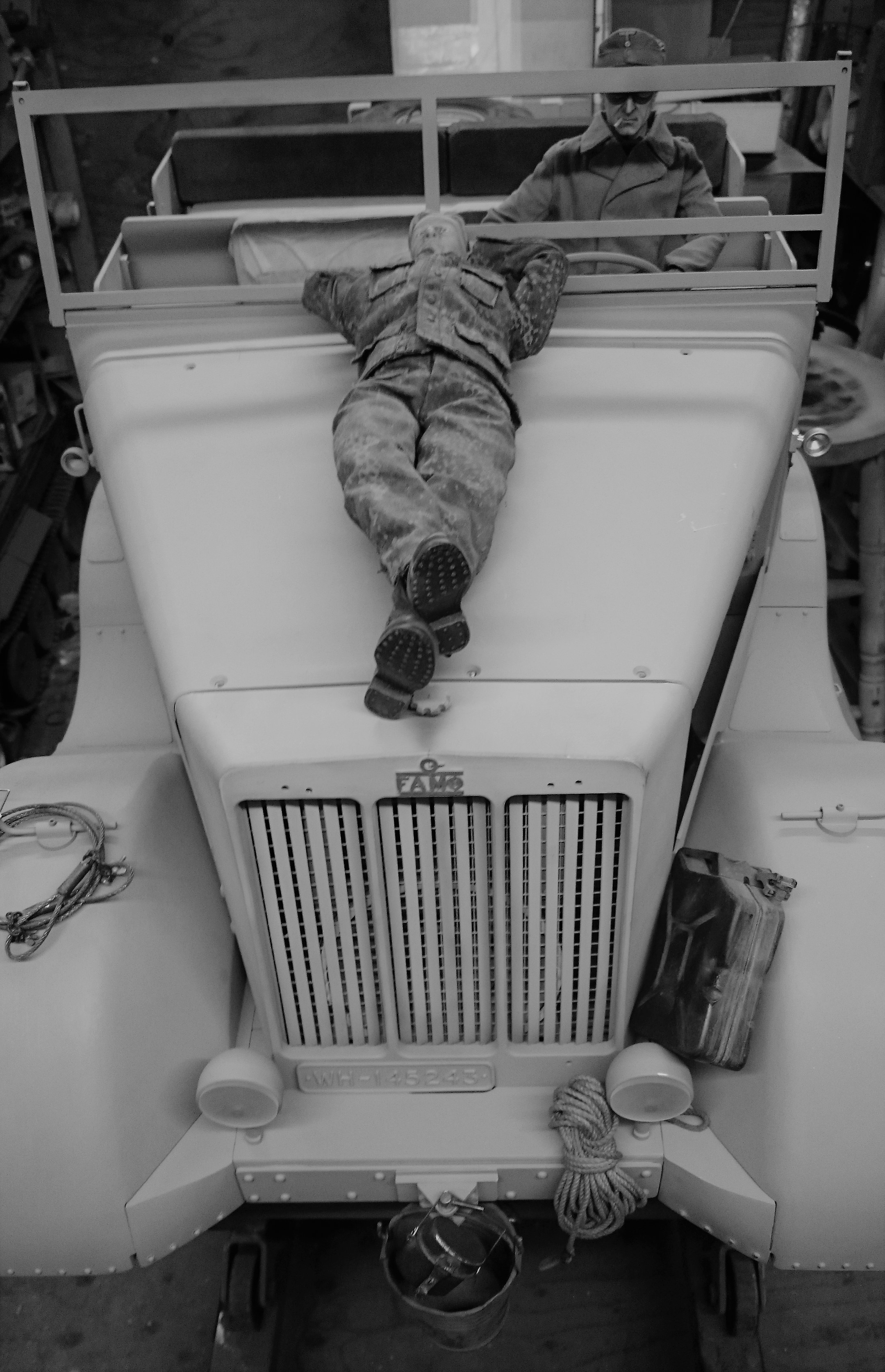

The driver slept on the bonnet reminds me of one historical photo: :D

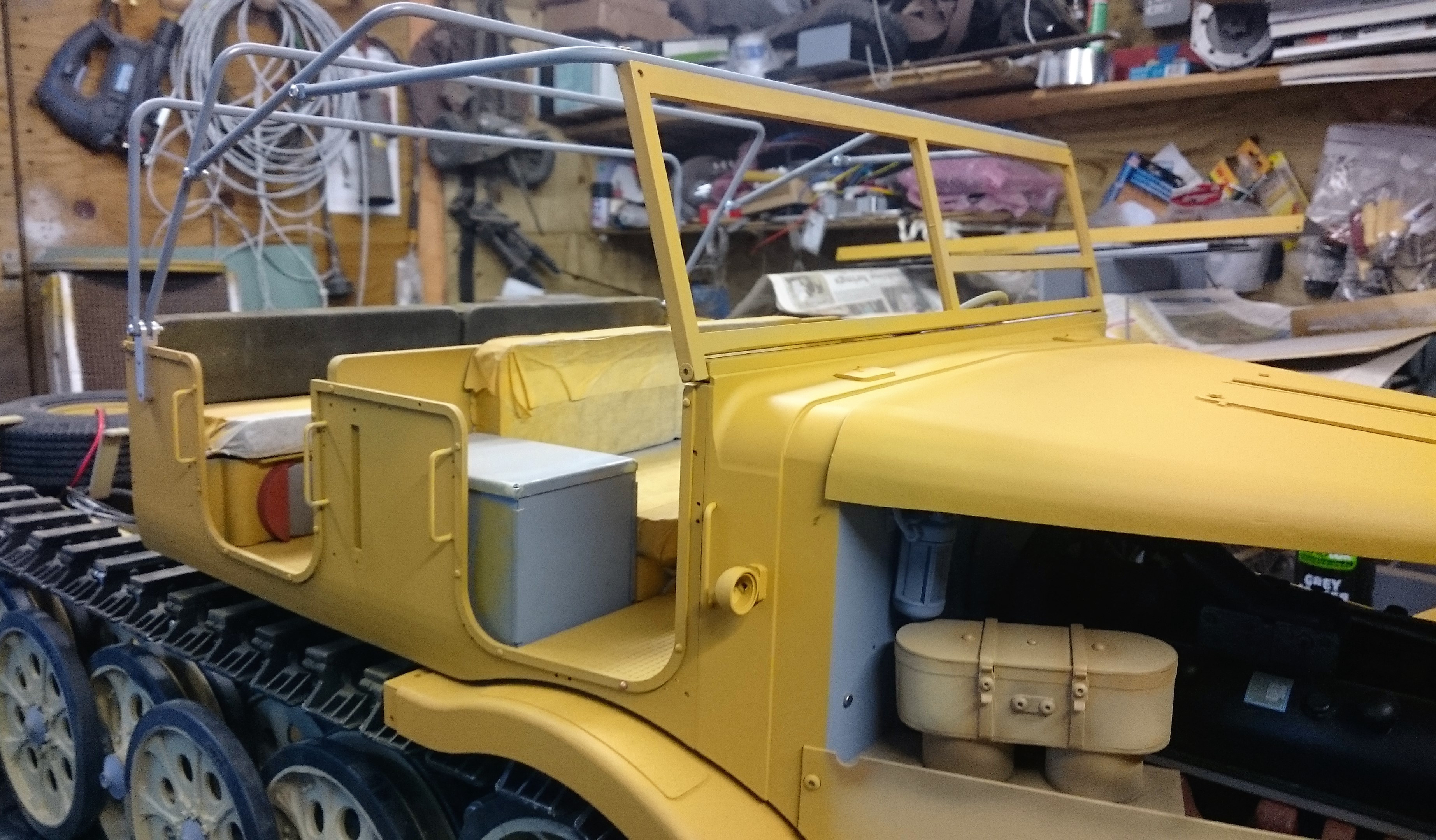

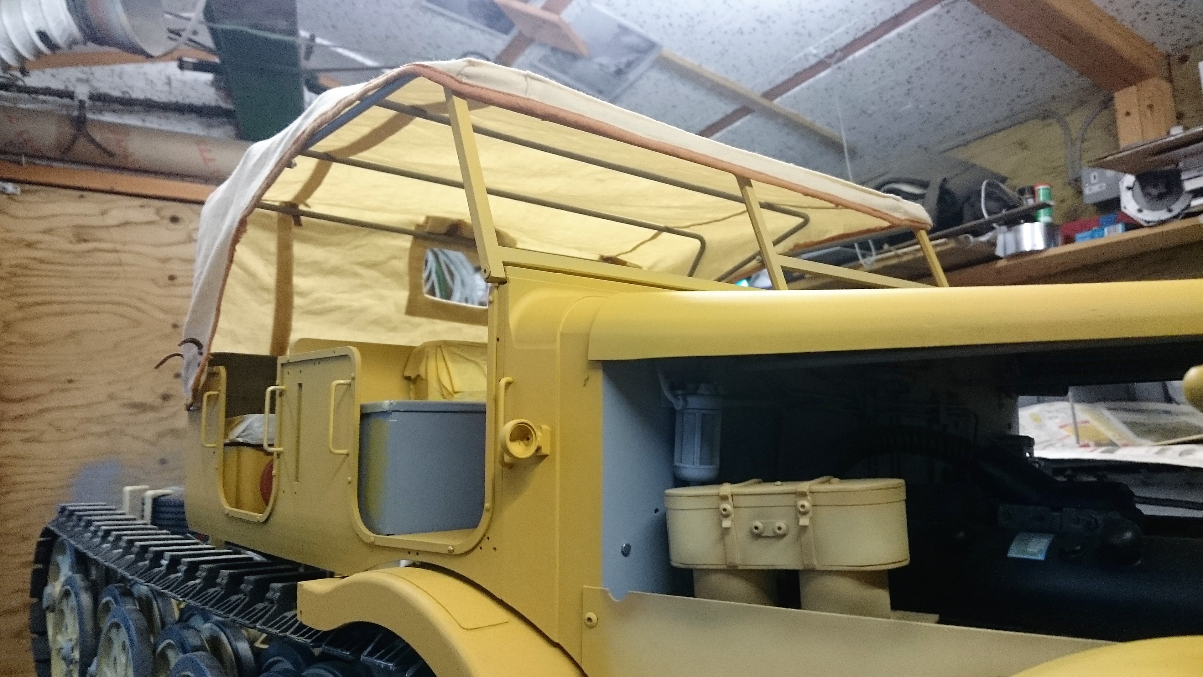

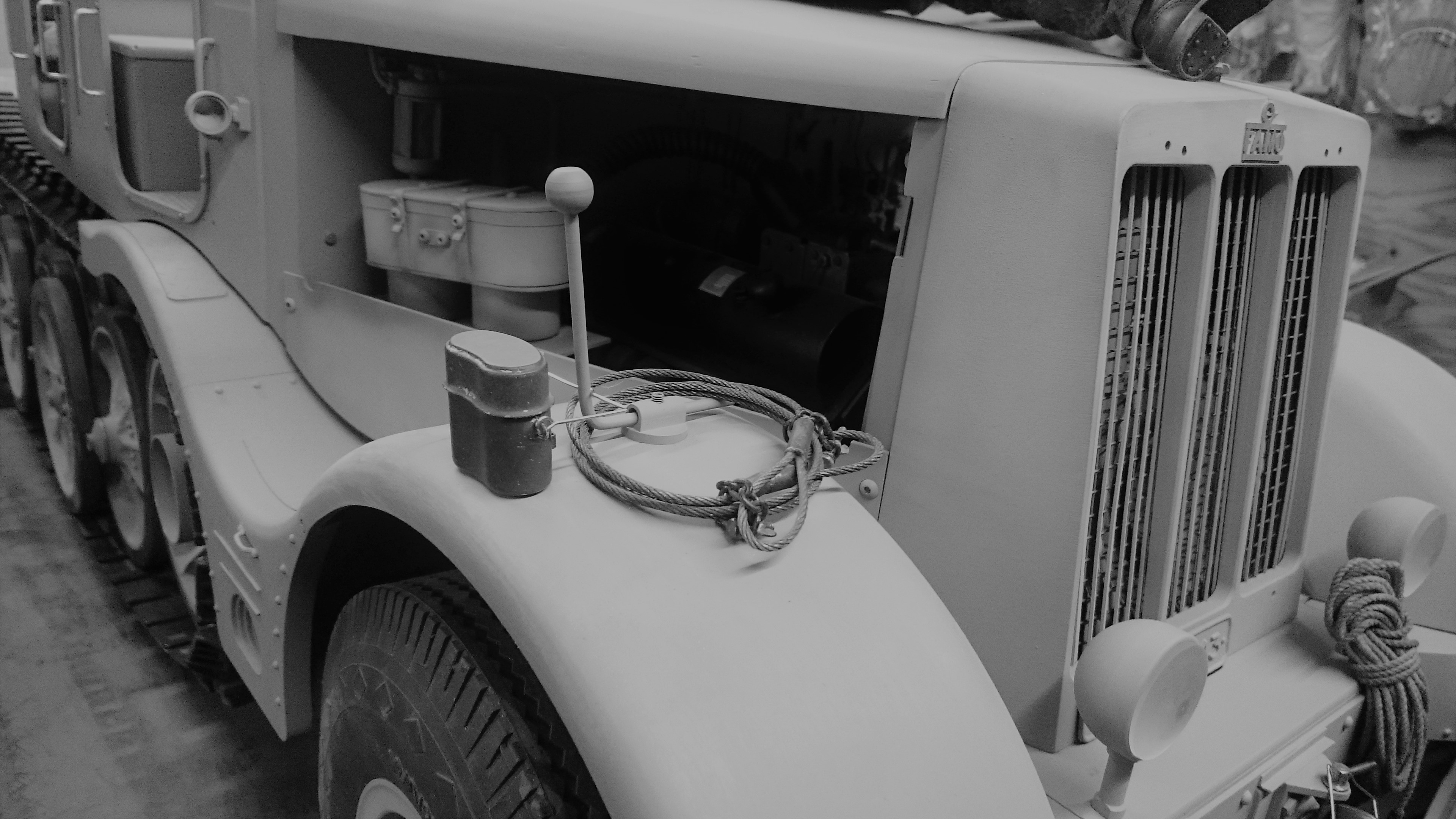

Vents, canvas iron work, and the winch. I'm in the process of dyeing the canvas in the kitchen sink right now.
A few issues with the winch, I will cover that later.

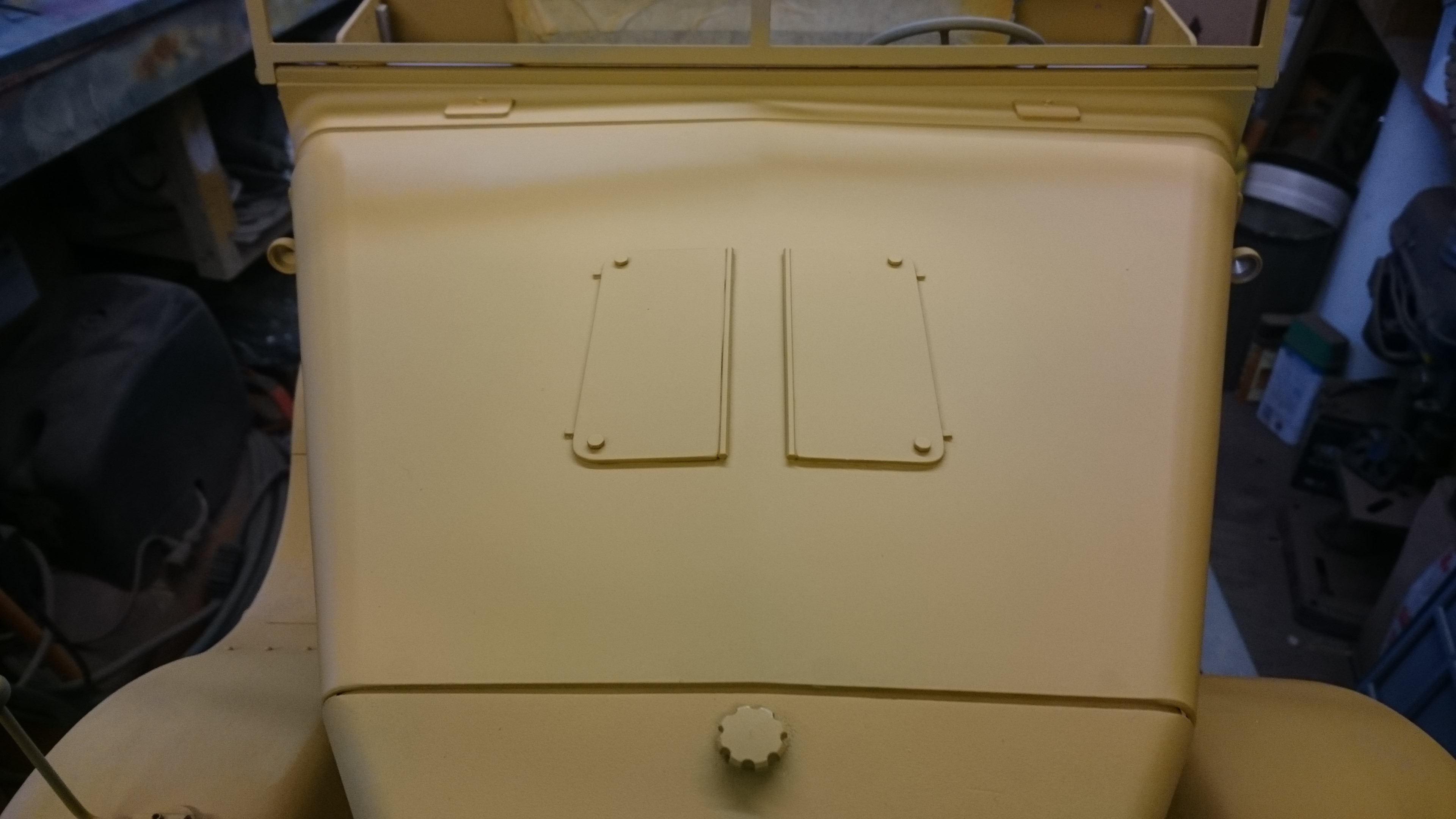

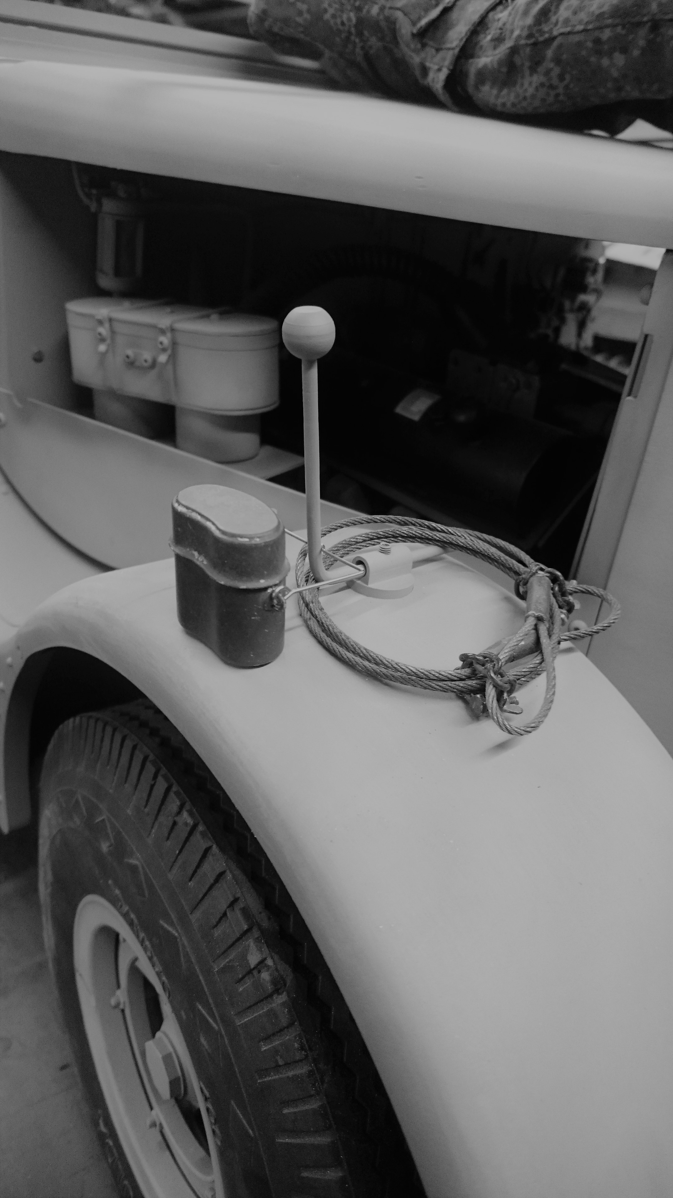

Vents added and, I have also removed the bonnet kit fixings and will add more scale like replacements.
Some filling required to the blend in the bending marks.

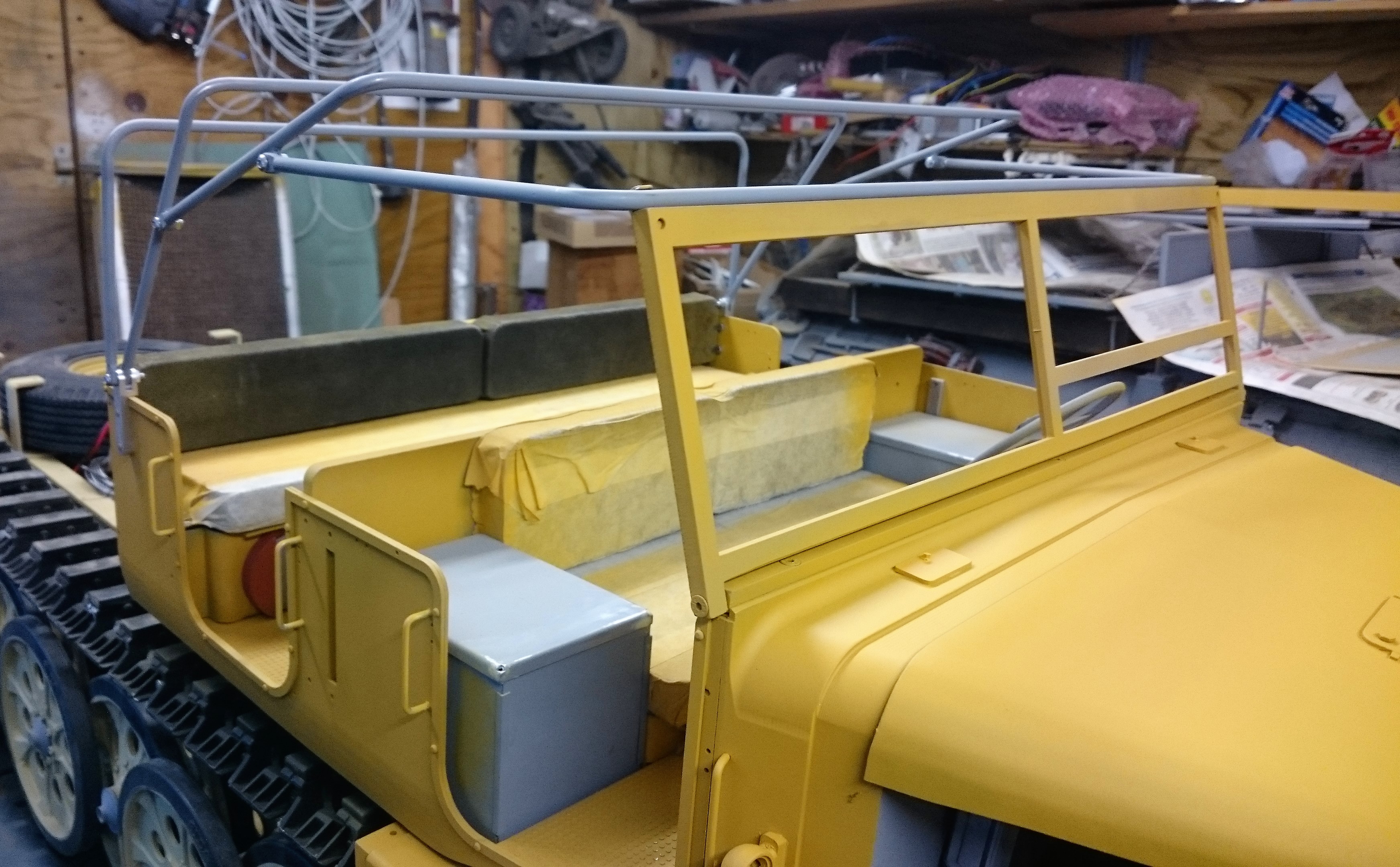

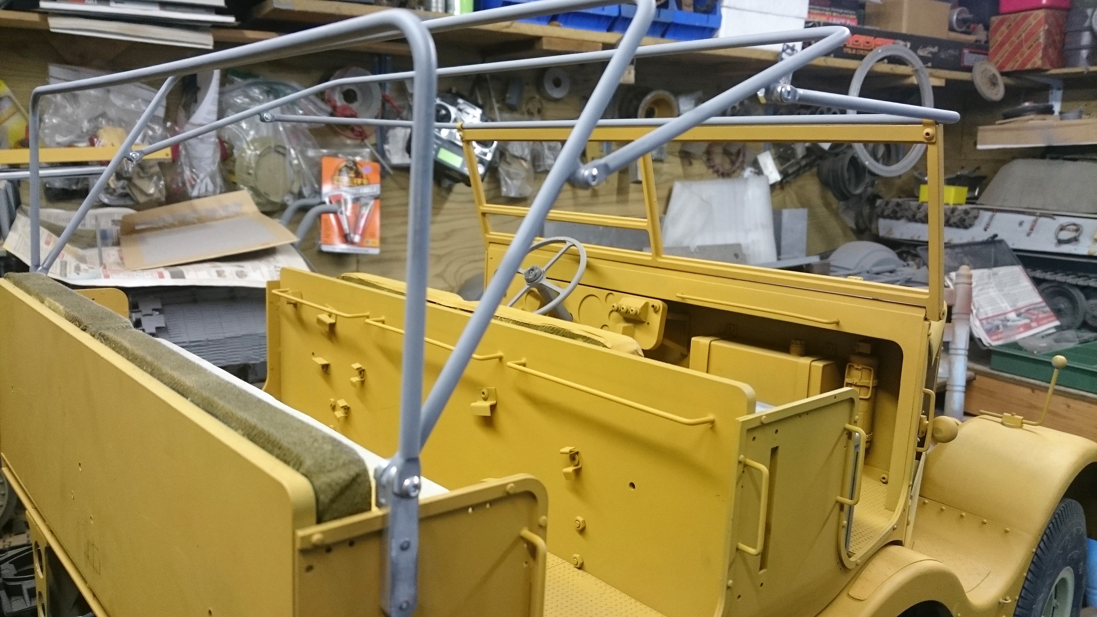

I want the canvas iron work to be functional but need to work out a way to fold the hoops back.
The second hoop folds back nicely up against the first, the next two need need some clever folding brackets

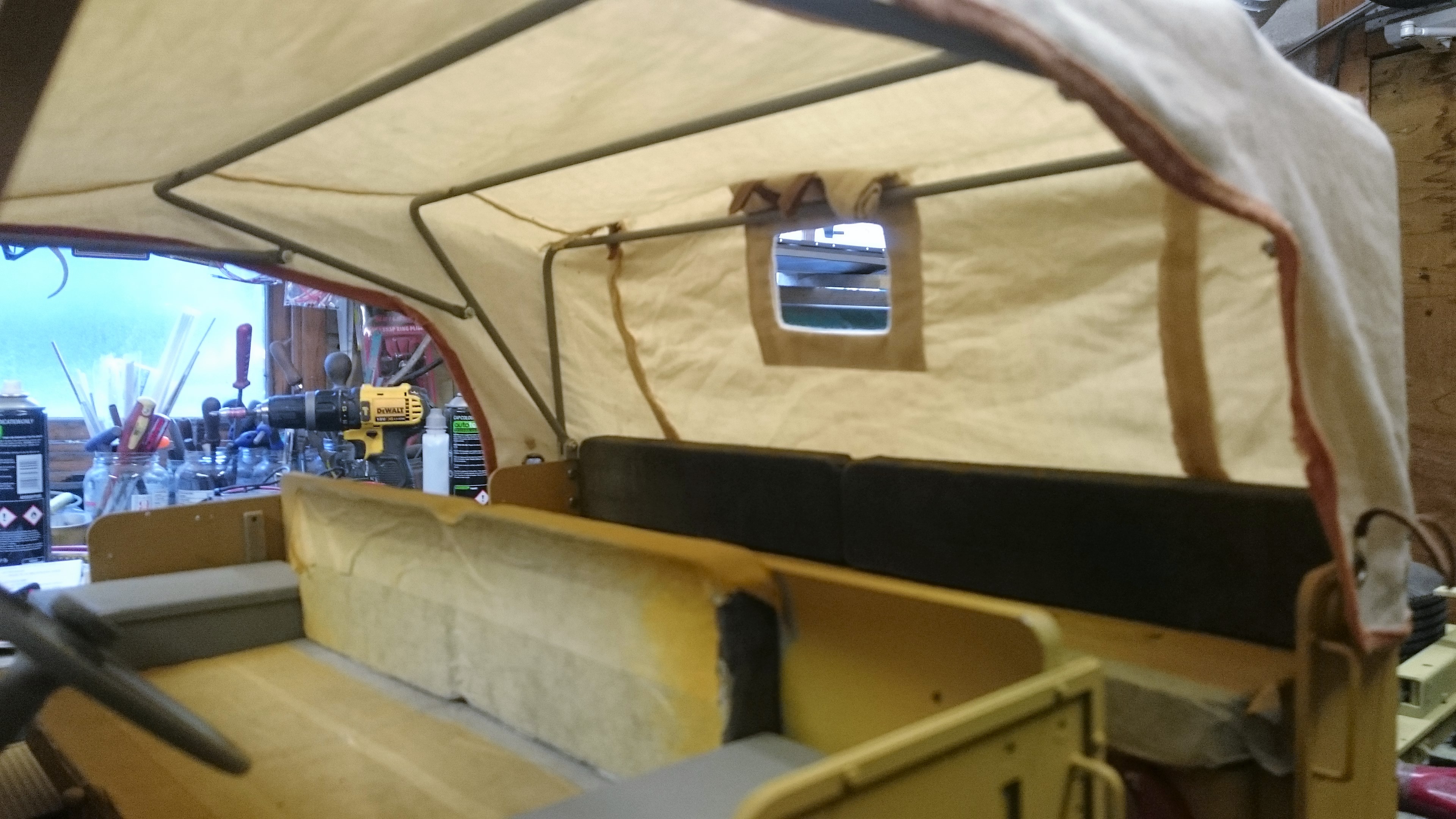

Re: Phils Famo build

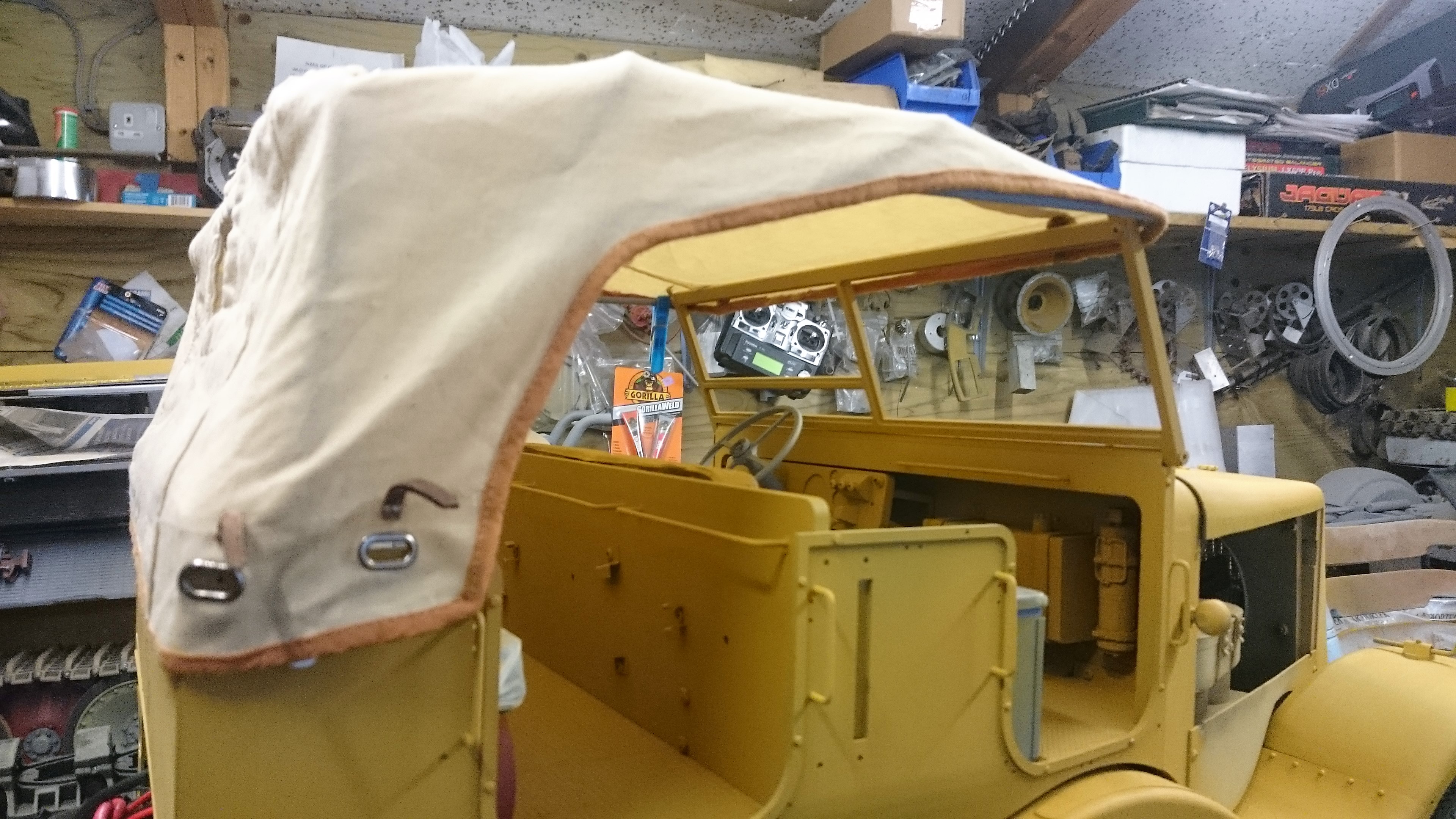

The first proper fitting of the crew compartment hood,(well not a proper fitting as I have just draped it over the hoops) and it's a nice fit to.
