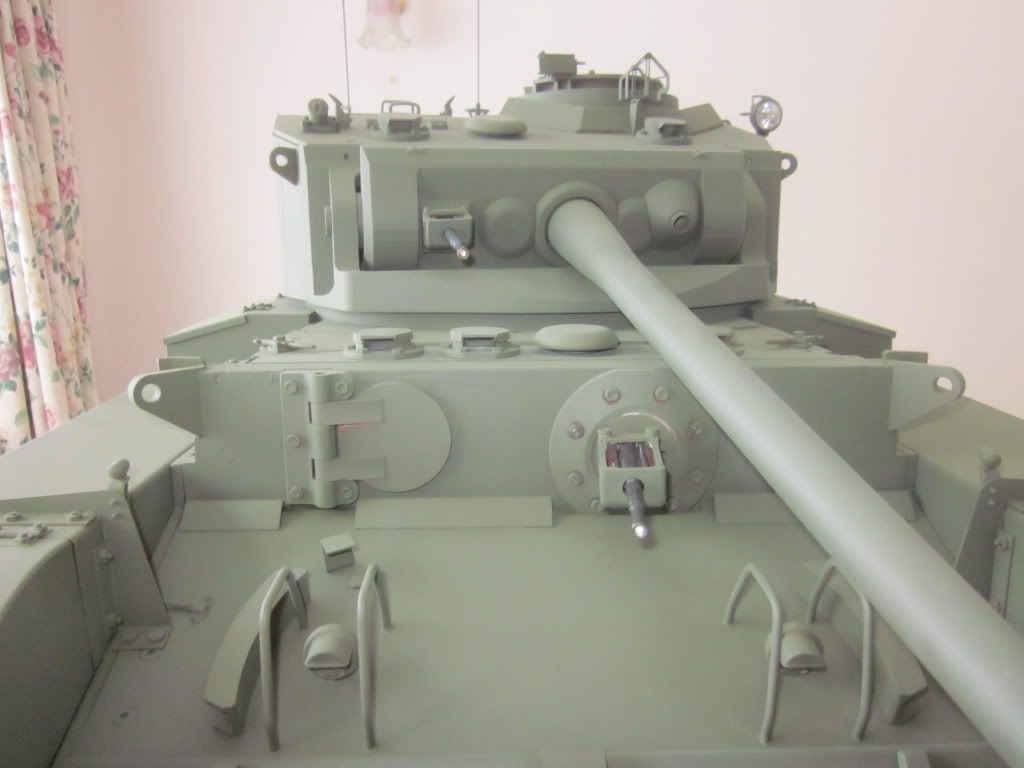

Post by phil fitzpatrick »
Fitted my 2 Steve Winstone MG's with Led's

I also purchased the M/G upgrades from Steve Winstone, I had not considered a system to move the gun....when the time arrives perhaps you will describe how it all works.

like the machine gun mods looks very good and so does the mesh on the engine deck.There,s not mutch room for the turkey on that table,looks good though, best wishes
