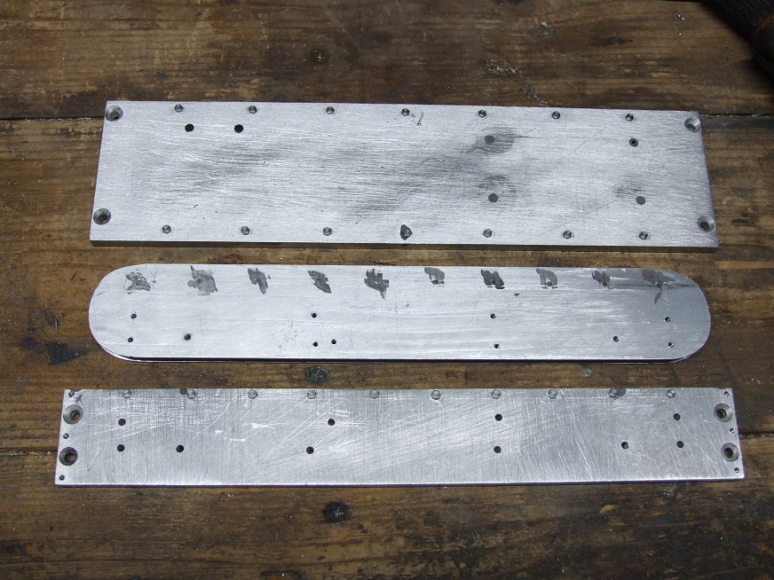

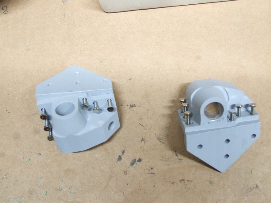

Ok so lets get these pesky idler blocks out the way. In case you've forgotten, here's the assembly diagram again....
Fortunately, Kian had a replacement available. Now I could've used filler to plug the hole but I want my Chieftain to be as close to all metal as I can make it so the use of filler, resin and 3D printing is going to be the absolute minimum!
So after repairing the affected block, I carried on making the studs from some long hex head screws secured with Loctite Blue..... Cut the heads off and added the M3 Nylocs with a little grinding off of the studs to finish..... On a separate note, the tracks are now all painted and assembled! Each tack measuring a tad over 2.4m! Tyre fixing up next (with pictures) followed by an update on the exhaust box...oh yay.....deep joy :lol
First of all, the two halves were bolted together with the recommended hex heads and filed to remove machine marks and to match the halves together.....
All the parts were then prepped, degreased and etch primed....
Assembly and testing for smoothness of operation occurred next....
It was at this piont that I identified that one of the thread on one of the tensioning bolts was grating on the side of the block. By removing a little of the thread (in the position shown in the pic below), the bolt moved over sufficiently and smooth operation was restored.....
It was at this point that I'd thought I'd have a go and improve the blocks by carving webs and replacing the hex head bolts with studs and nyloc nuts. Unfortunately, I crashed and burned severely on the webs; I don't have the proper tooling to attempt this so it was a little risky and I paid the penalty!

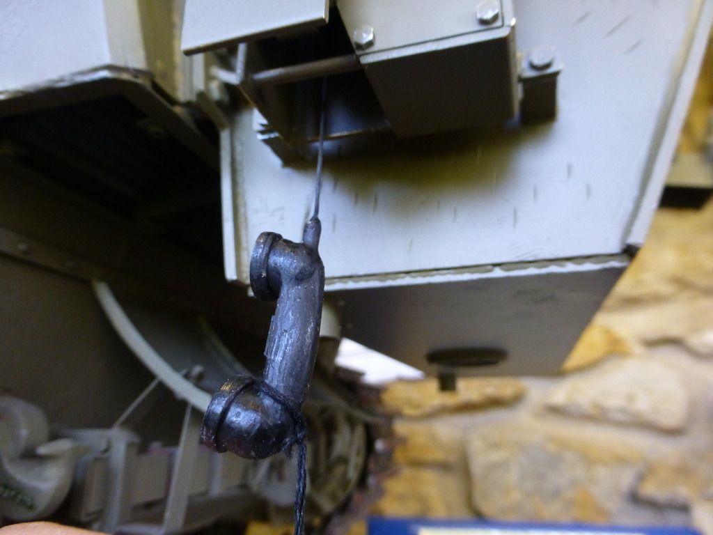

Nice one Richard. The box contained the Infantry/Tank telephone, which allowed a dismounted caller to talk on the internal intercom. In theory, an infantryman could indicate targets to the tank commander or point out obstacles. In practice, the infantry were rightly nervous of standing in a cloud of diesel fumes with every likelihood that in an emergency, the tank commander would order high reverse to get out of trouble, thus rendering the unfortunate infantryman into a flat-pack form. In all my time on tanks, I never once had a call. We did from time to time put helpful instructions on the box, leaving the infantry to work out where the coins were inserted.......
Here's one I prepared earlier, complete with handset on a pullout cord. The retracting mechanism came from an ID badge given to me at a US military facility so that you could hang your ID on a yoyo. Useful. Glad I kept it.
The original on an Australian Cent:
The copy:
The copy:

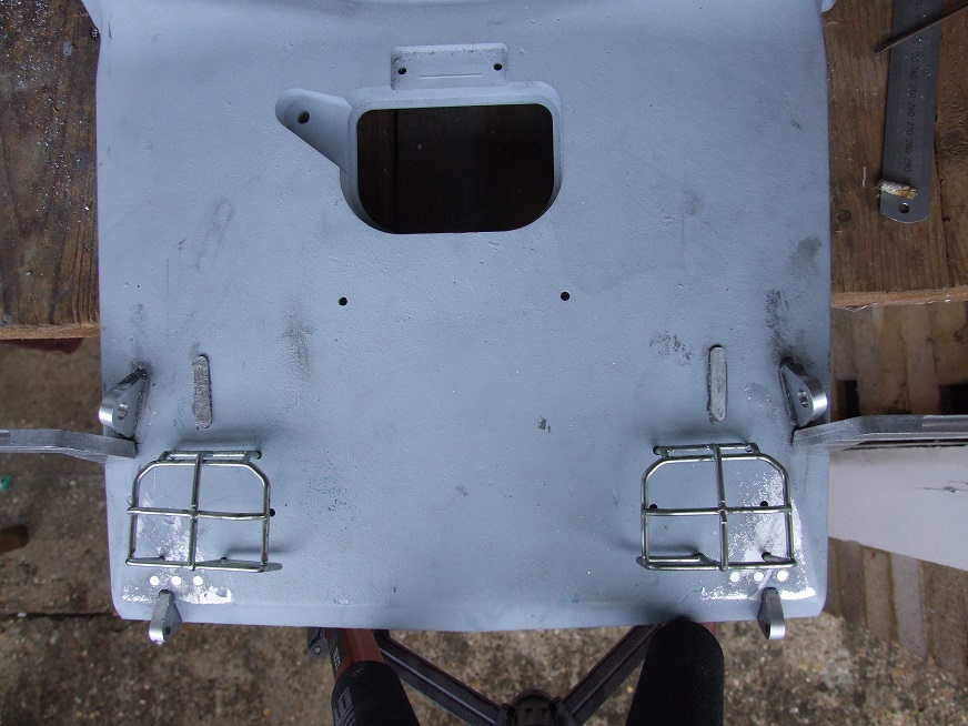

Ok so its been a while since my last update so this is what I've been up to.....
Worked on the smaller detail below the exhaust box which I think is now complete.. Have also added the jacking plates front and rear but that is the only detail I will be adding on the floor.
Now on to that great lump of a casting; the securing lugs on this thing needed a lot of careful filing to ensure it fitted between the hull sides securely but didn't bow them out. A check later on with the front plate removed showed a relatively good fit (I think). In addition I also ground down to create flats where the mudguard plates are secured to the casting to allow the securing bolts to sit flat against the casting. Any deviations in level will be taken up by the addition of a spring washer. Now for an observation test.....can you tell what is missing in the picture below? I must admit, this kit of parts never ceases to amaze me; more so when I get free tooling as well..
Mudguards next. An earlier dry fit had identified that the rear mudguards fitted perfectly but the fronts did not....
Using a hammer and a block of wood, they were adjusted to a better fit before the mudguards were welded...
Final adjustment occurred after welding but before the welds were ground down to protect the joints...
Just need to drill and tap the front fixing hole of each mudguard. Onwards and upwards.....keep smiling!

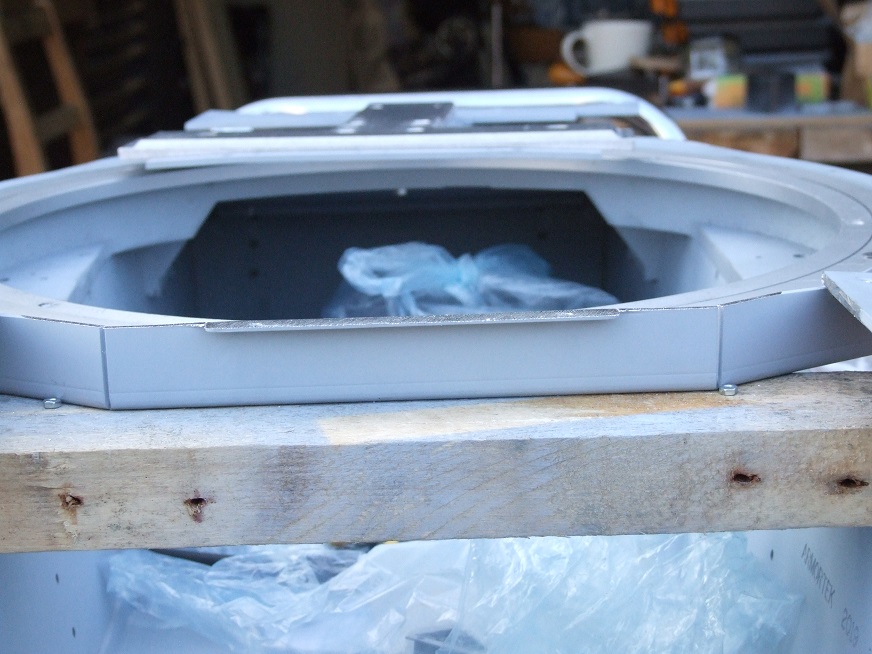

So this post is all about the rear deck. Now the supplied deck has to be modified to allow the following:
1) ease of access for maintenance like so.... 2) the middle of the deck needs to be dropped such that the middle is level with the highest point of the sides of the deck from the start of the forward engine louvers to the turret tray such that the forward louvers are flat and level like so.... 3) Lastly that the turret doesn't catch the rear deck when it rotates
This is what I did to mine to achieve the above. First, 5 cuts were made on the rear deck as shown below... The front part of the rear deck centre was then flattened using a hammer, block of wood and the inverted 'T' piece.... The parts of the rear deck that sat underneath the 'T' piece were then assembled but under the leg of the 'T', a 4mm slab was sandwiched between the T and the rear deck. This addition made the middle of the deck at the same level as that of the highest point of the sides.... The finished T piece plus attached rear deck parts looking like this.... The middle turret tray tab was the filed to within an inch of its life such that the sides of the T sat level with the highest point of the sides... With the full rear deck installed albeit loosley and with the turret tray supported with a block of wood, the turret was installed and no fouling of the turret against the rear deck occured.
There is still more stuff to do which will come in my next post which should then complete all the major rework of the rear deck. When this is complete, I can then paint the lower hull and start adding the drive gear to get those motors running pronto!
