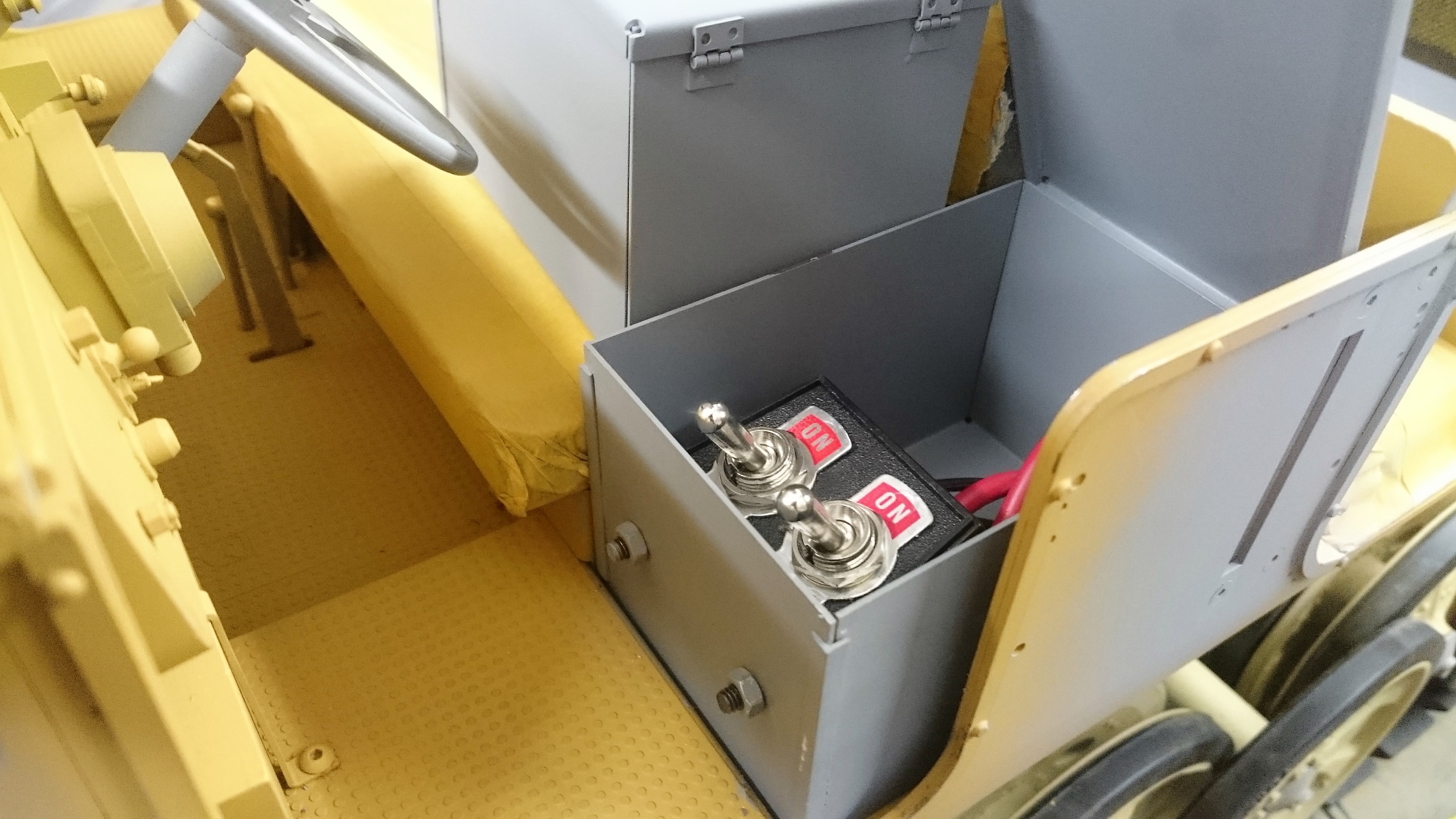

Nothing very exciting with the build at present, I'm still wiring. I am using the front kit boxes as convenient switch positions, the main isolator, the on off and the ancillaries all easily accessible and to hand in the drivers side kit box. The flip up indicator holders have been reduced in thickness so the boxes have enough room to be functional, you could also reduce the rubber seats width instead.

Re: Phils Famo build
Hi Florian, I've been researching the later vehicle kit boxes and they are all sizes but most seem to be above the seat height so I have left as is, I'm rubbing down the tool marks on the front fenders right now, that's a long job!

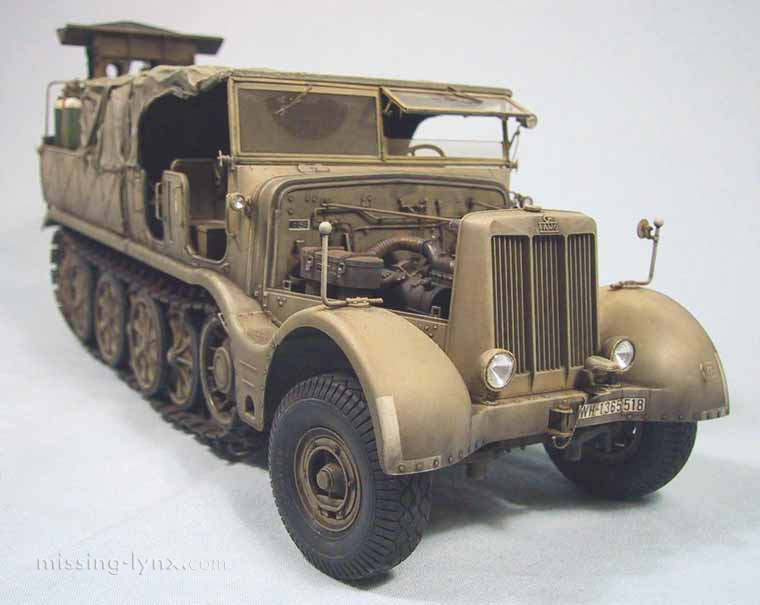

Good morning Phil,
I make it the easy way with th tool marks. The same way like on the front. With spatula after cleaning the alu I think its ok. BUT how do you make it with the form? - The Famo fenders are more round?! - The late Famos are the way they are in the kit, but than its the wrong front, and the fenders are shorter in the front. How do you build this?
The late Famo also have a bumper on the front. I don't know jet wich way I'll go.
Good morning to you Florian, I am using a power file to remove the tooling marks on the fenders ( i will post some more photos after a full day in the workshop later) and then emery paper to flatten and finish. It's a bit confusing ref the body type differences but then anything could have been put together late in the war to make up a new vehicle, I do like the look of the rounded fenders , although not correct for a late. I do like the look of the front bumper and will almost certainly add this at some time ( although it would make the Famo even longer), I should get a good six hours of build time in today, that's if I have no interruptions!
I intend to mix up the various colours and finishes including the canvas covers to give the vehicle some depth and interest, as if it's seen some work in the field
Hi Phil,
I like the early version too. Its also the right for my special Famo from north Africa.
Maybe I build the hole fender by my own. Don't know yet. There are some possibilities.
You know there is tons of extra material on the Armortek fenders, so it may be possible to round off profiles. I will maybe have a go in an area that is hidden and see what it looks like!
