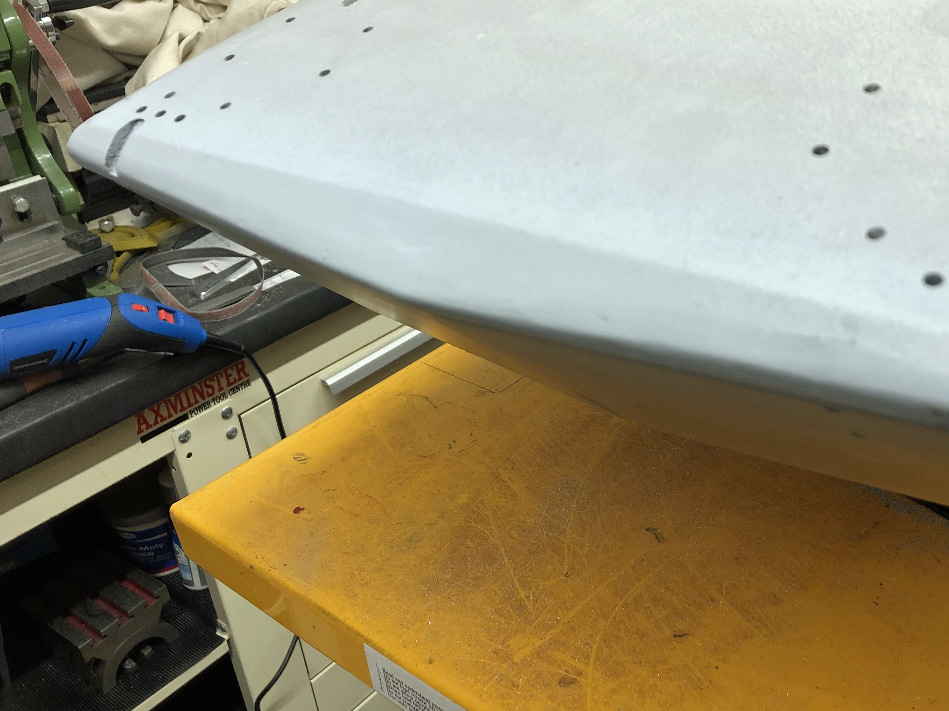

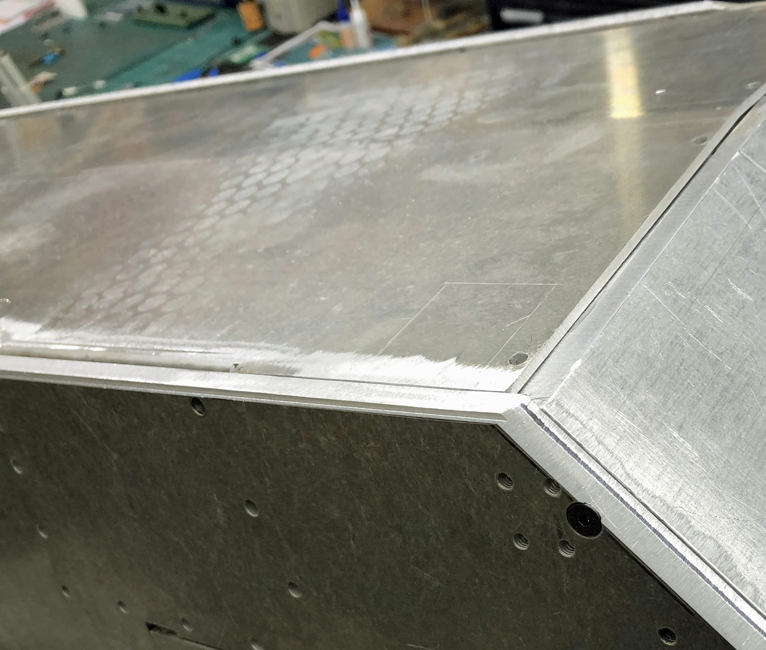

This one is fighting me every step of the way so far but today we had a meaningful discussion, I hit it with a rubber mallet and now we've at last made a bit of progress. It's not the kit's fault, we just started out on the wrong foot with some less than perfect aluminium brazing. You ought to love all your children without fear or favour but this one is challenging. It''s partly about the complexity of shapes, which is the price of the ballistic excellence of the armour design.
The bow of the toe plate and glacis has finally come clean and given me what I was after. I had several goes with the UV glue as filler to build up the V line, which runs at an angle to the original Armortek shape. It's finally there:

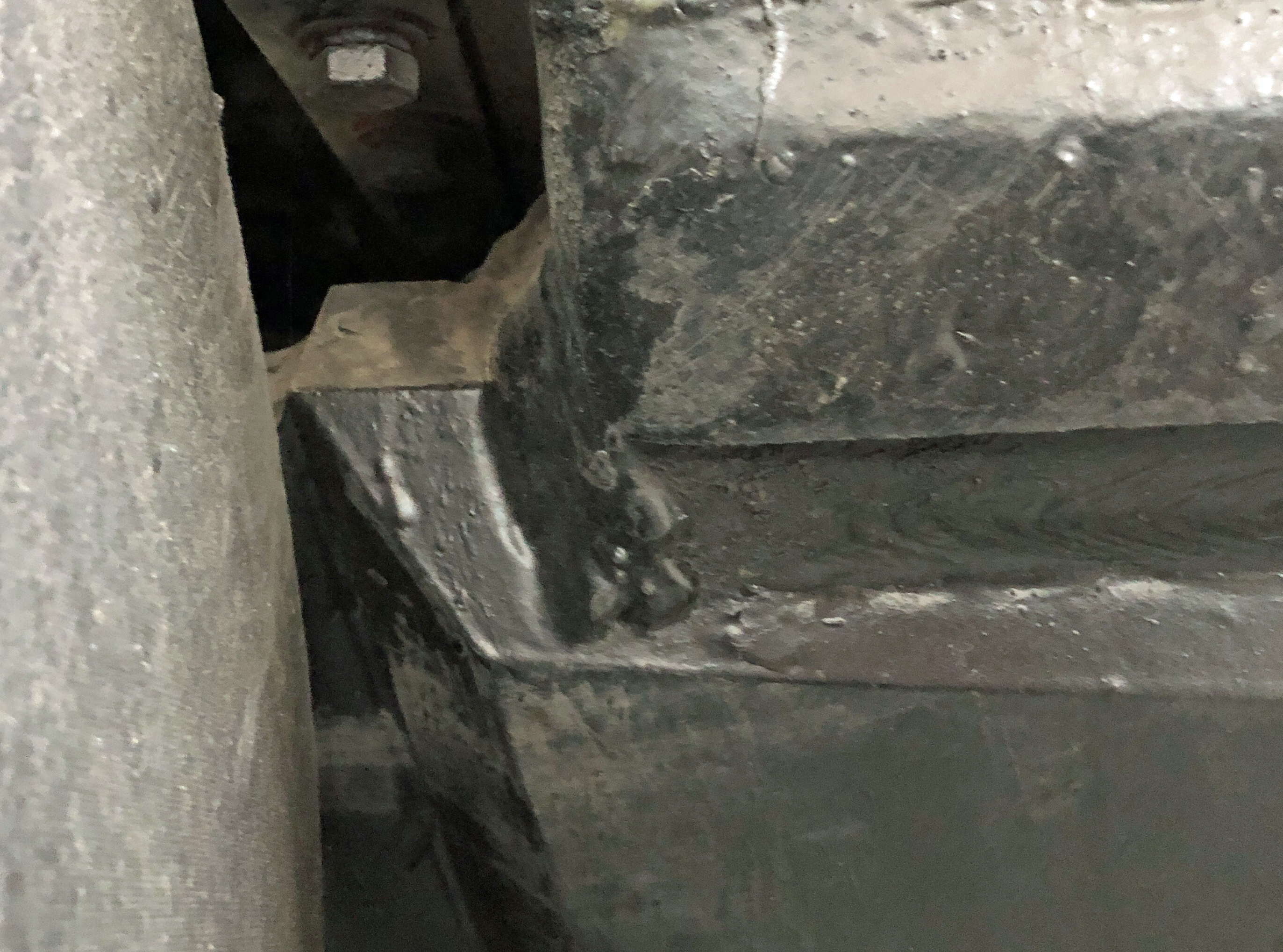

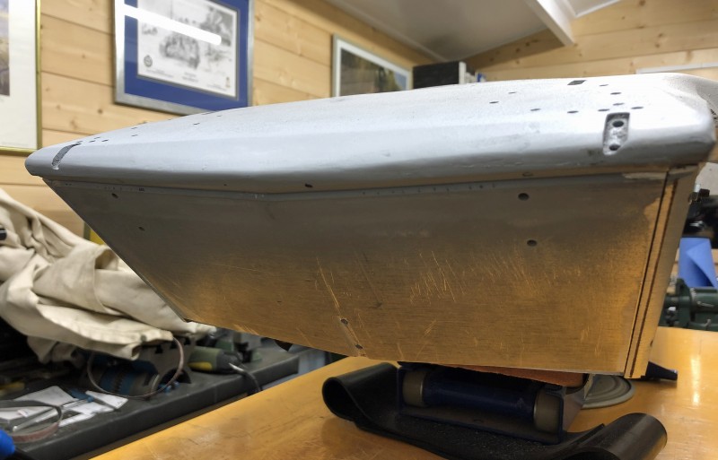

Turning to the bottom edge of the side plates, first stage was to mill off the overhang. Given that it took three passes on my mill to run the full length, I decided not to muck around with trying to set up the correct angle but simply milled at right angles and achieved the correct angle with a power file and rasp. I then milled the rebate which simulates the weld joint between the side and bottom plates. This is what I started with:
and final shaping:
To represent this:

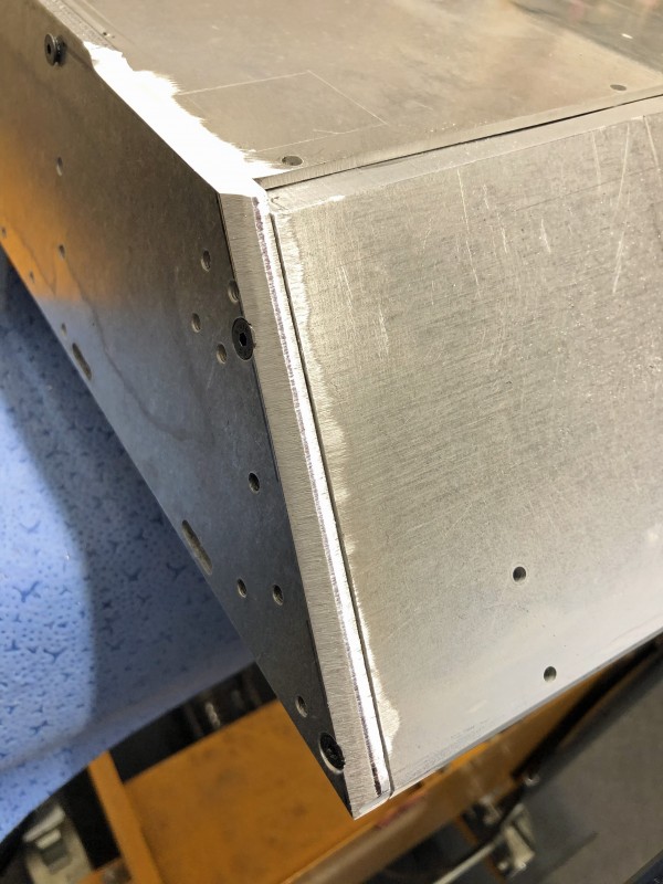

Lastly for today, the outer sides of the toe plate need the chamfer to be represented:

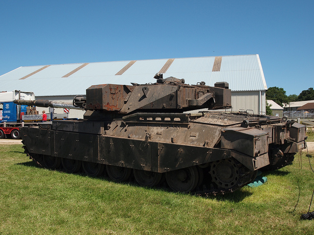

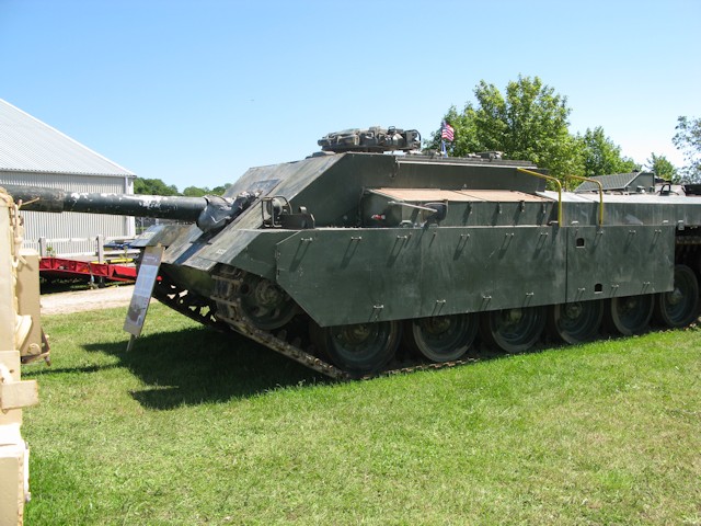

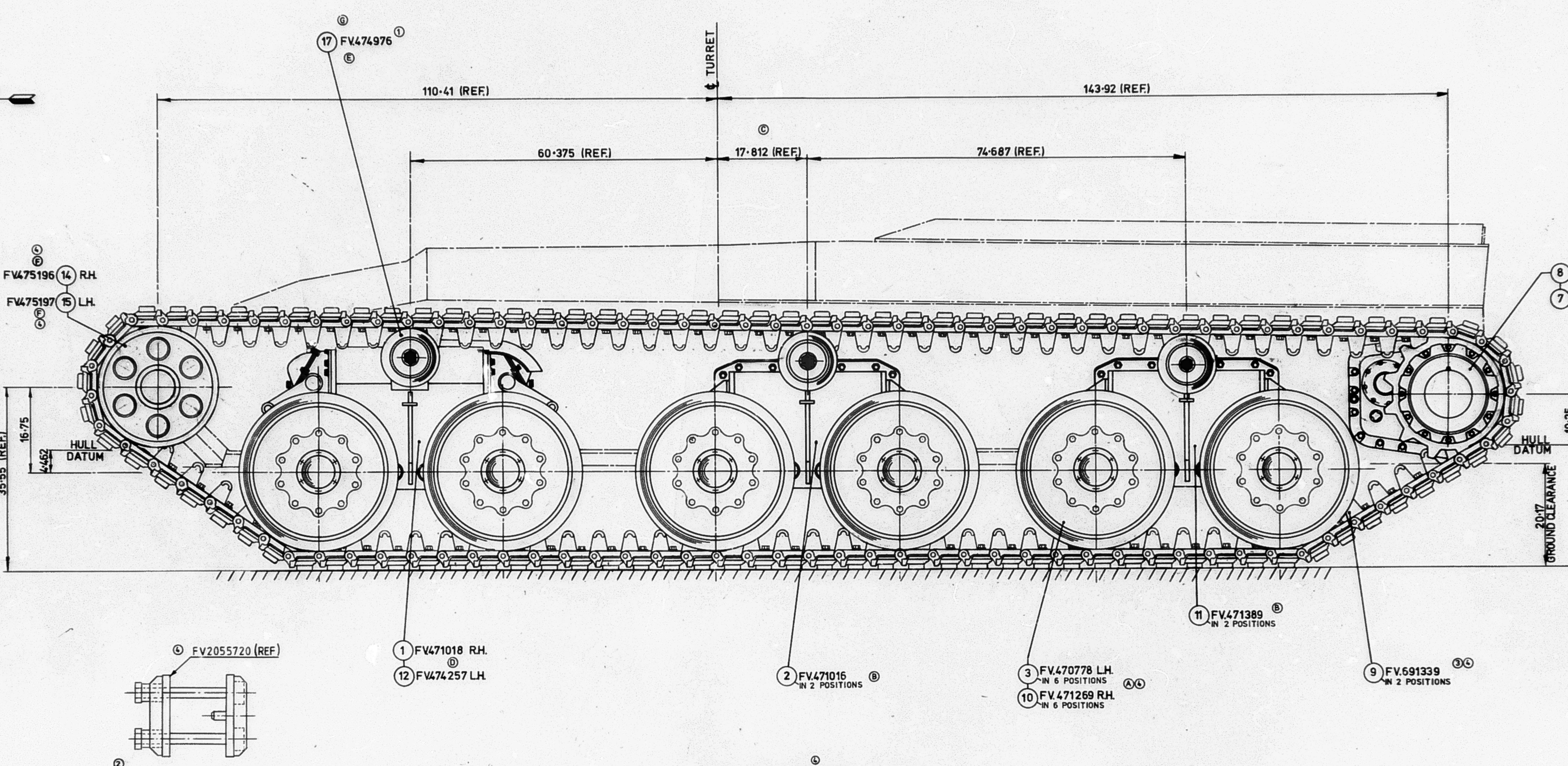

One of the more obscure but effective modifications made to British tanks involved the spacing of the roadwheels. The typical British suspension arrangement of six roadwheels per side on three suspension stations was common to Centurion, Chieftain and both Challenger 1 and 2. It's not immediately obvious though, that there is a larger gap between the front and centre stations compared with the centre and rear. This was to facilitate the practice of "half-tracking" or shortening the track to run from the sprocket around the centre and rear stations only, ie roadwheels 3-6. This practice was the response learned from the British experience of mine damage in WW2. Comet crews in particular used this in the latter stages of the campaign in Europe, where nuisance mining of routes was commonplace. The mine usually caused damage to the idler and possibly the front suspension units which immobilised the vehicle unless the track could be shortened to exclude the damaged units. By half-tracking, the mobility could be restored sufficiently to get the tank to a place of repair. To make the process easier, on the post-War tanks, the gap between the front and centre stations was increased.
This was of course not an option open to the Wehrmacht with the overlapped roadwheels of the Tigers and Panther, another reason for my comment on another post that those tanks are over-hyped and not all they're cracked up to be by modern pundits and fans. It's inexplicable to me also why neither Leo 2 or Abrams M1 make use of this feature, whereas the Russian T-80 does.
On Chieftain, the dimension between the mid-points of the front and centre suspension units is 78.812 inches, whereas that between the centre and rear is 74.688 inches. This differential is faithfully replicated on the Armortek Chieftain and was one of the features we picked up when the original was measured up. It's a good example of the attention to detail in the Armortek models, where it matters.

The Chieftain design:

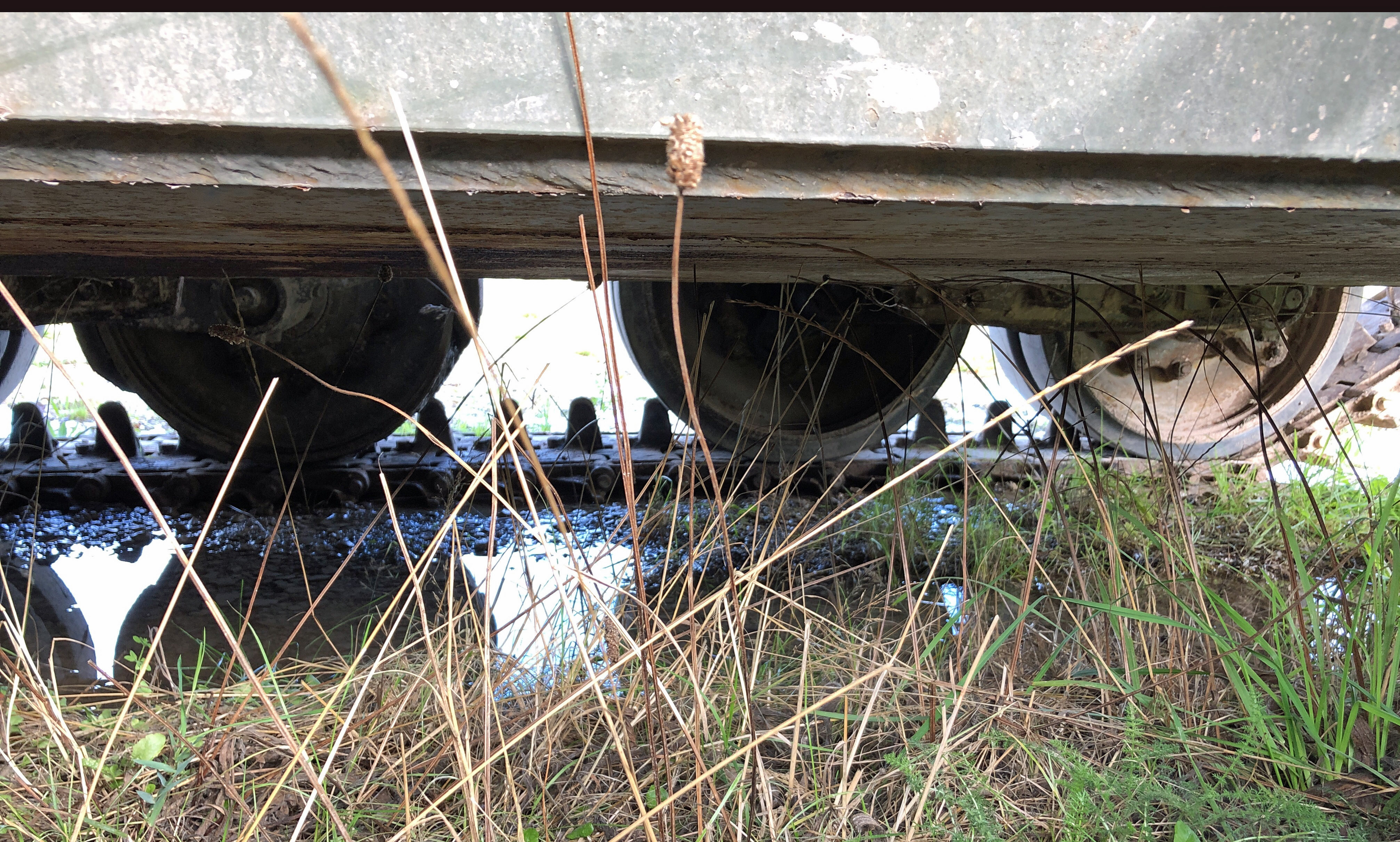

and a half-tracked Chieftain.
It wasn't a very commonplace practice in the British Army of the Rhine. I probably only witnessed it once or twice in my time on Chieftain and Challenger. The reasons are now lost on me but maybe others with experience may recall typical circumstances in which it was used. Anyway, a long-winded explanation for something which might otherwise be a puzzle.

The Professor of Engineering would probably not approve of this asymetry, but the practical engineer would say that is a very neat fix! Thank you for that piece of insight, that gap has has always niggled me, but I now know the reason, and it makes sense.

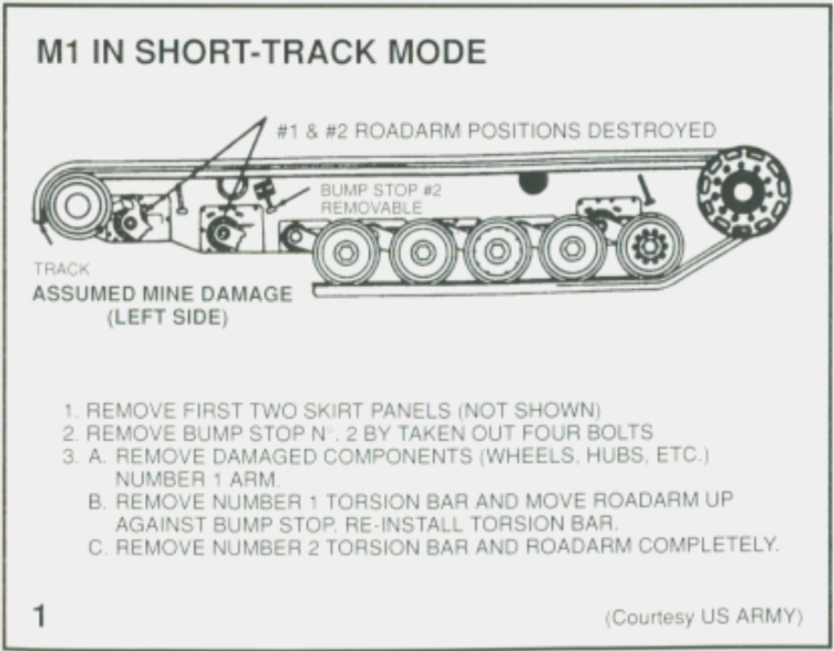

You mentioned "half-tracking" earlier.
I was unable to find an example for the Chieftain, but I found this illustration in 'WarMachines #06 - M1-M1IP-M1A1 Abrams MBT'
PS, I haven't started my Chieftain #41 yet.

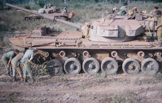

Alan, that’s it. It’s one of those skills which tend to be lost in peacetime but which I learnt with the Australians, who’d needed it frequently in Vietnam. Happy Christmas all. Stephen

Challenger 1 and 2 did not have 3 suspension stations like Chieftain. The six roadwheels either side each had independant hydrogas suspension units.
In my 22 years looking after the tanks and other armoured vehicles, half-tracking was an emergency get-you-home repair and not a get-you-back-in-to-battle repair. The tensioner idler had been lost, the tracks were loose with no way to tighten them, and the vehicle had to be driven extremely carefully to avoid throwing a track, until it could get back to a location where a proper repair could be done.
I only saw it done a few times and that was because we had the next recovery tasking come through on the radio. We could not drag the tank back ourselves so it was quickly half-tracked and sent limping back under its own power.

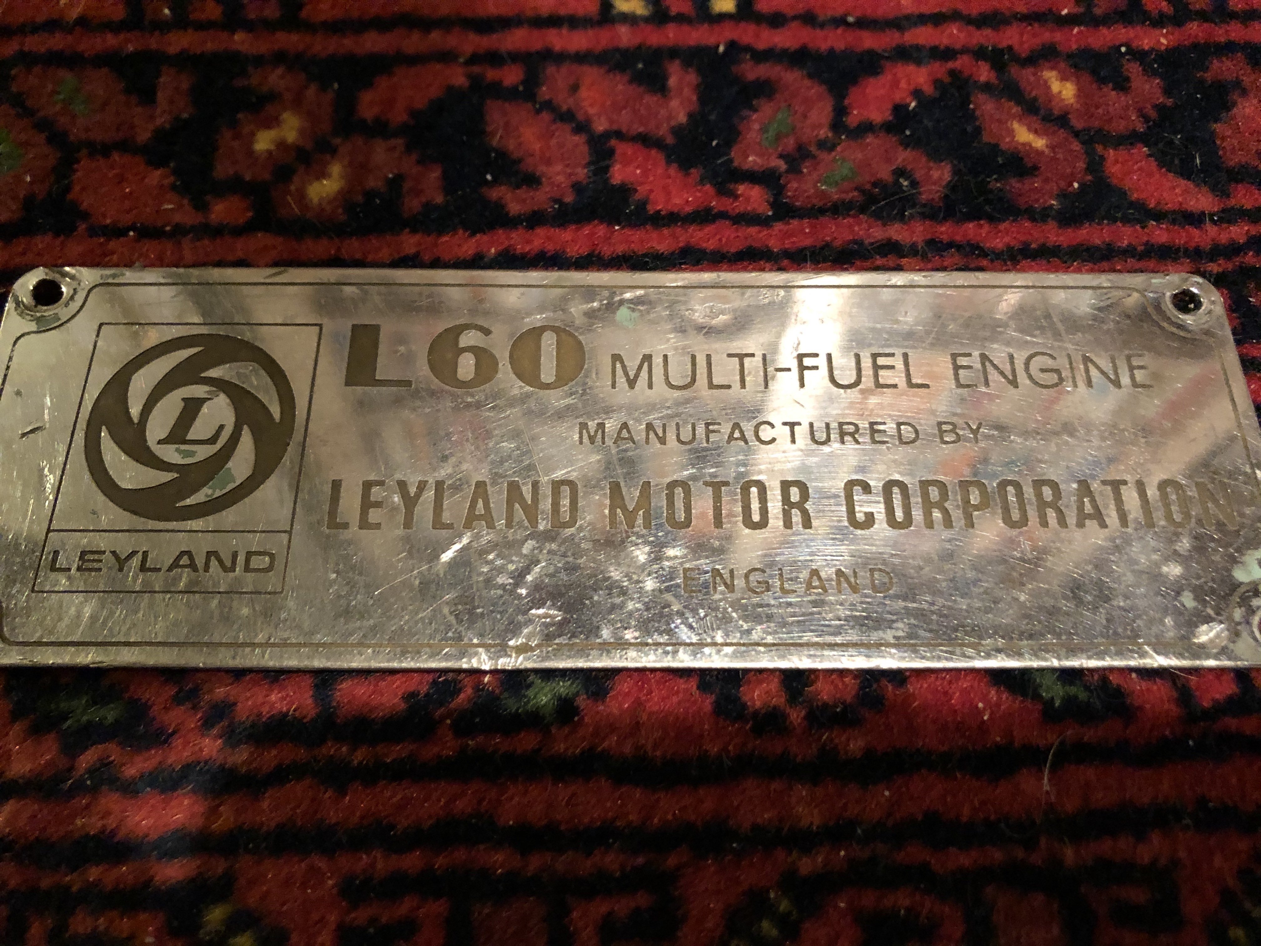

I vowed that the last Leyland L60 to blow up on me would suffer. They were a reliable engine towards the end but the owner of this plate cracked a liner and started to burn coolant, producing a cloud of white smoke out of the engine decks. We were told to keep running until the pack failed but you're not the most welcome company in a battle group if your tank is belching white smoke. Only a new Pope can do that and get away with it. So Ghenghiz, my very capable driver made sure it failed pretty comprehensively and quickly. By that time I'd moved to a less conspicuous tank, which I thought more fitting for a squadron leader. Ghenghiz knew how fond I was of that power pack, so when we caught up with each other, he handed over the maker's plate. I found it this afternoon, thirty four years later.
