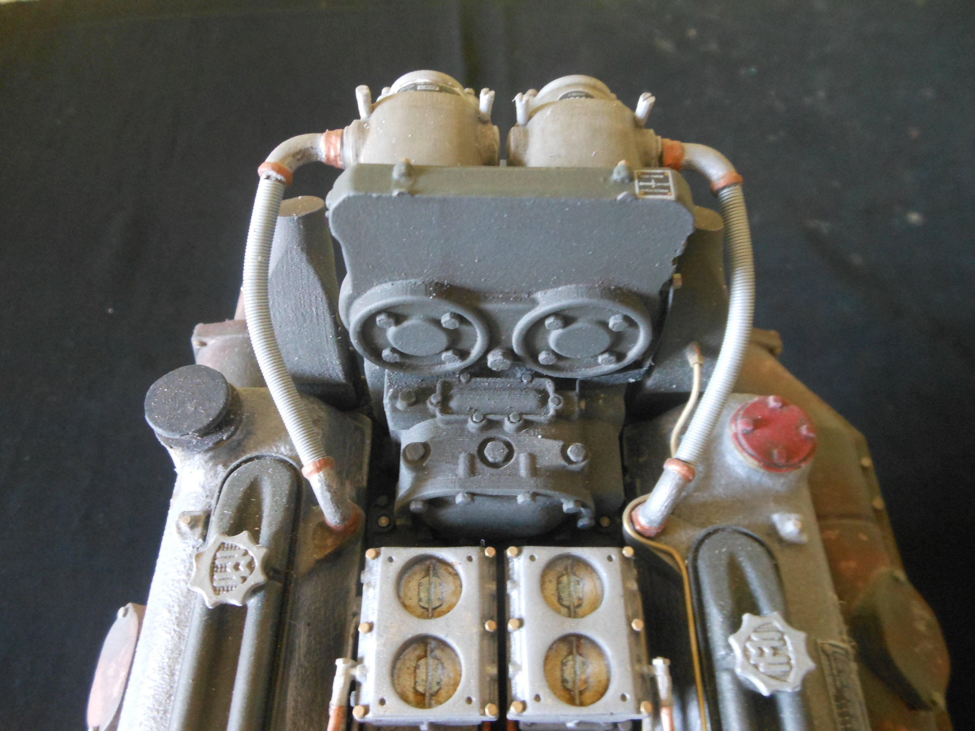

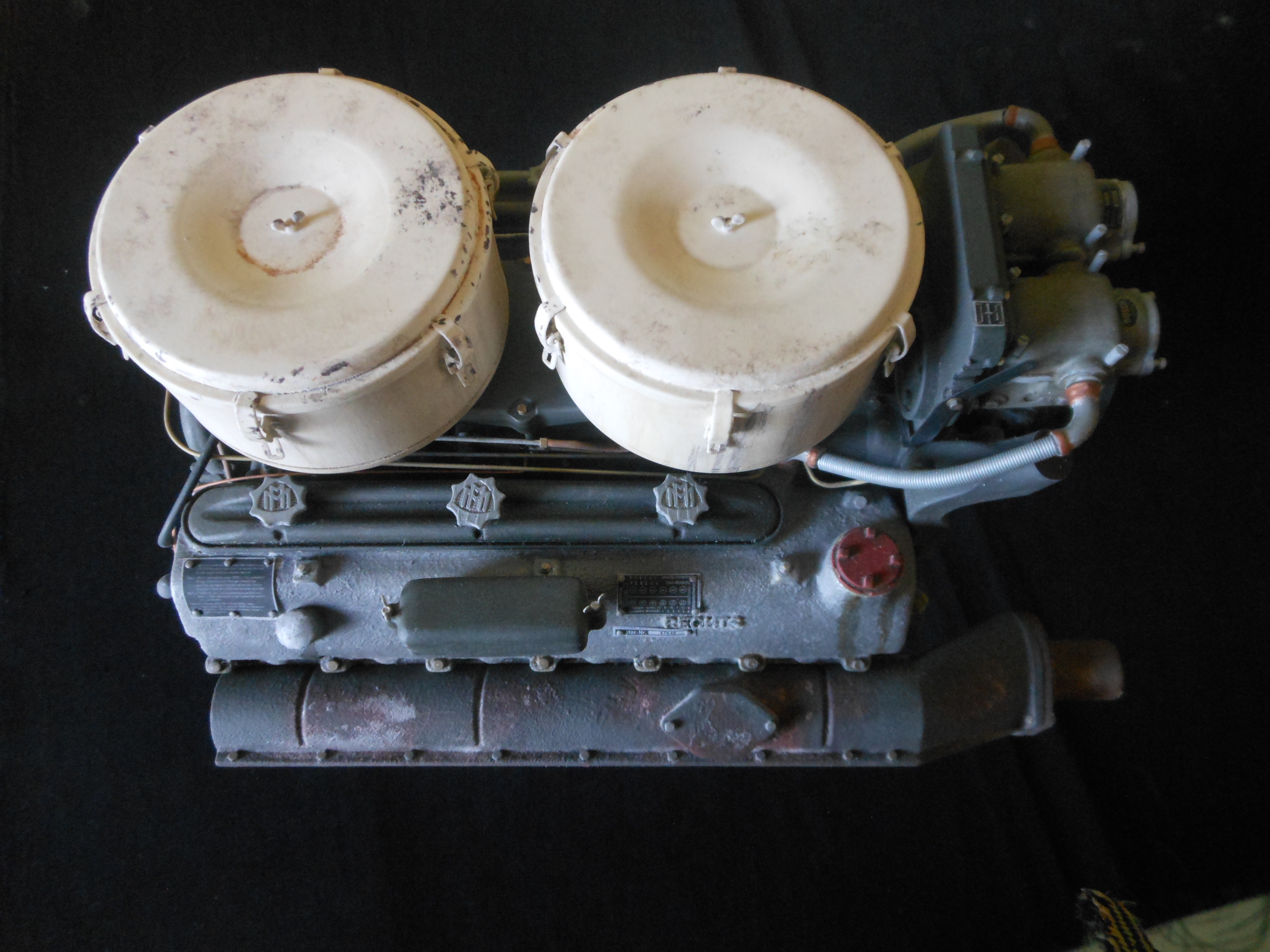

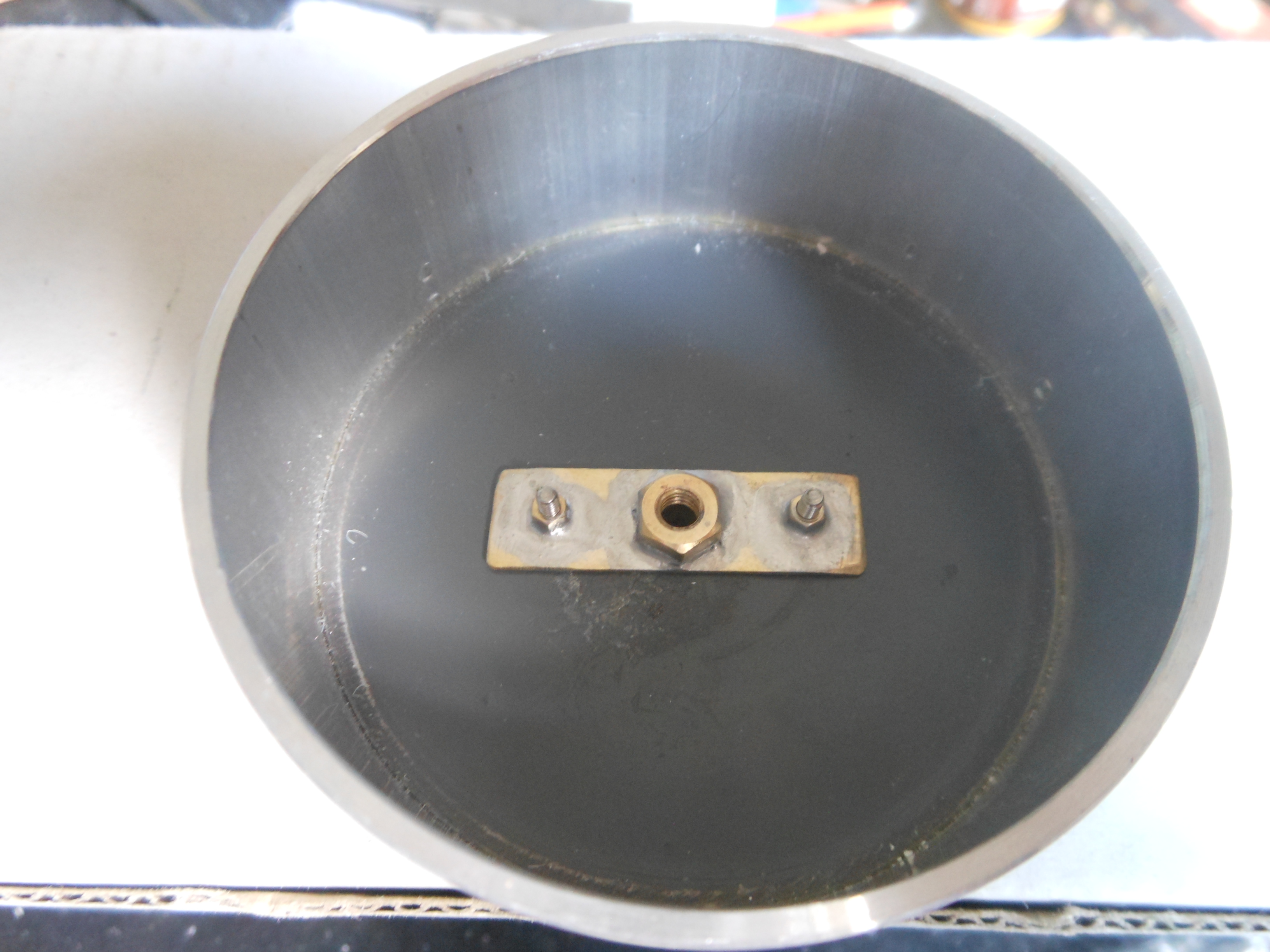

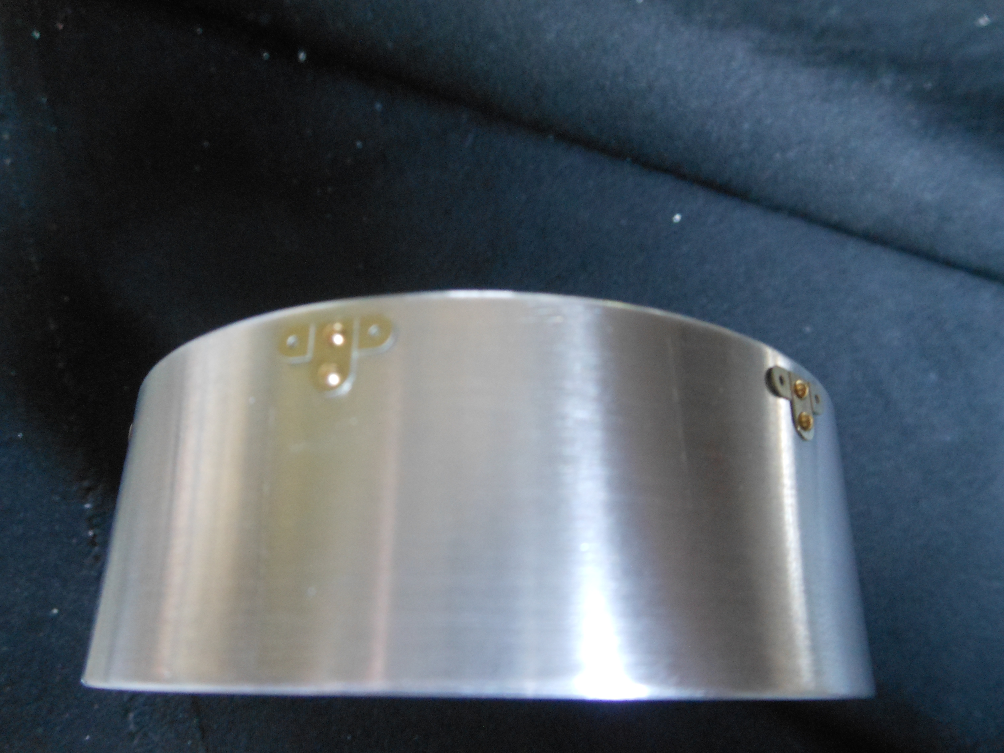

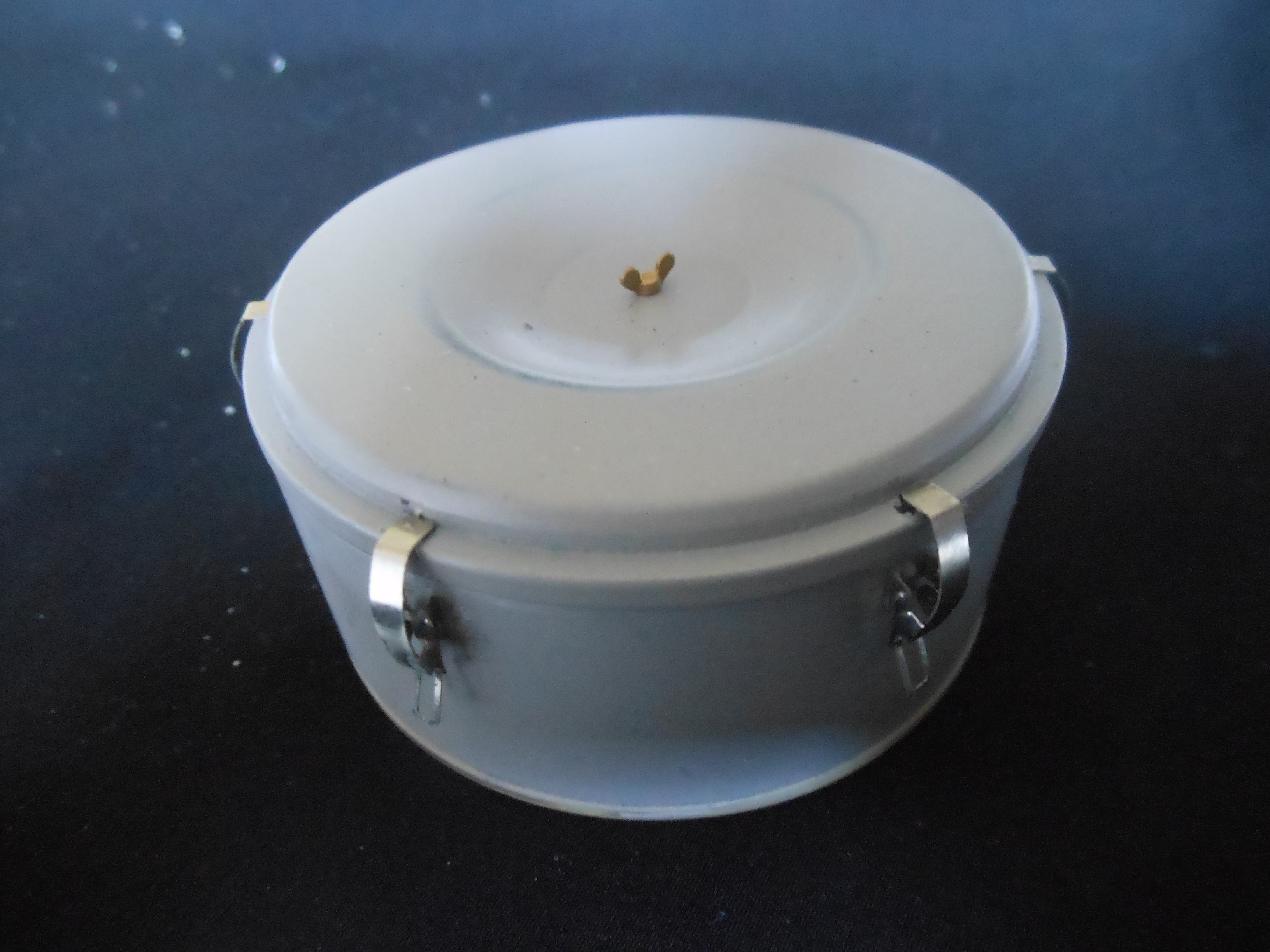

Happy Sunday everyone, I'm running out of air filters on the 1/2 engine already sold. I'll show you how I make it solid enough.
To fix the two filters to the base I fixed a brass profile with M2 screws on which I welded M2 nuts and an M4 nut. For the clamps that close the lids I used M1 rivets with relative nuts which I then fixed with a drop of tin. This way they are solidly attached without using glue. Now I will put the hooks and then we proceed to the coloring.
Ivano Costantini
Posts: 533
Been liked: 735 times
Re: New engine for Tiger1
Post by Ivano Costantini »

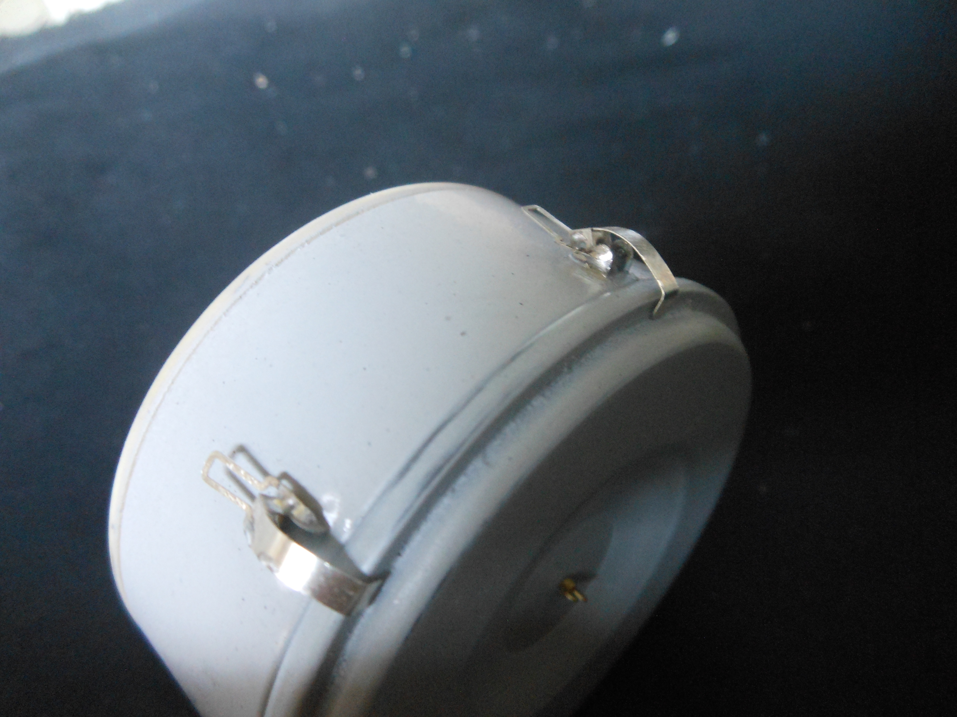

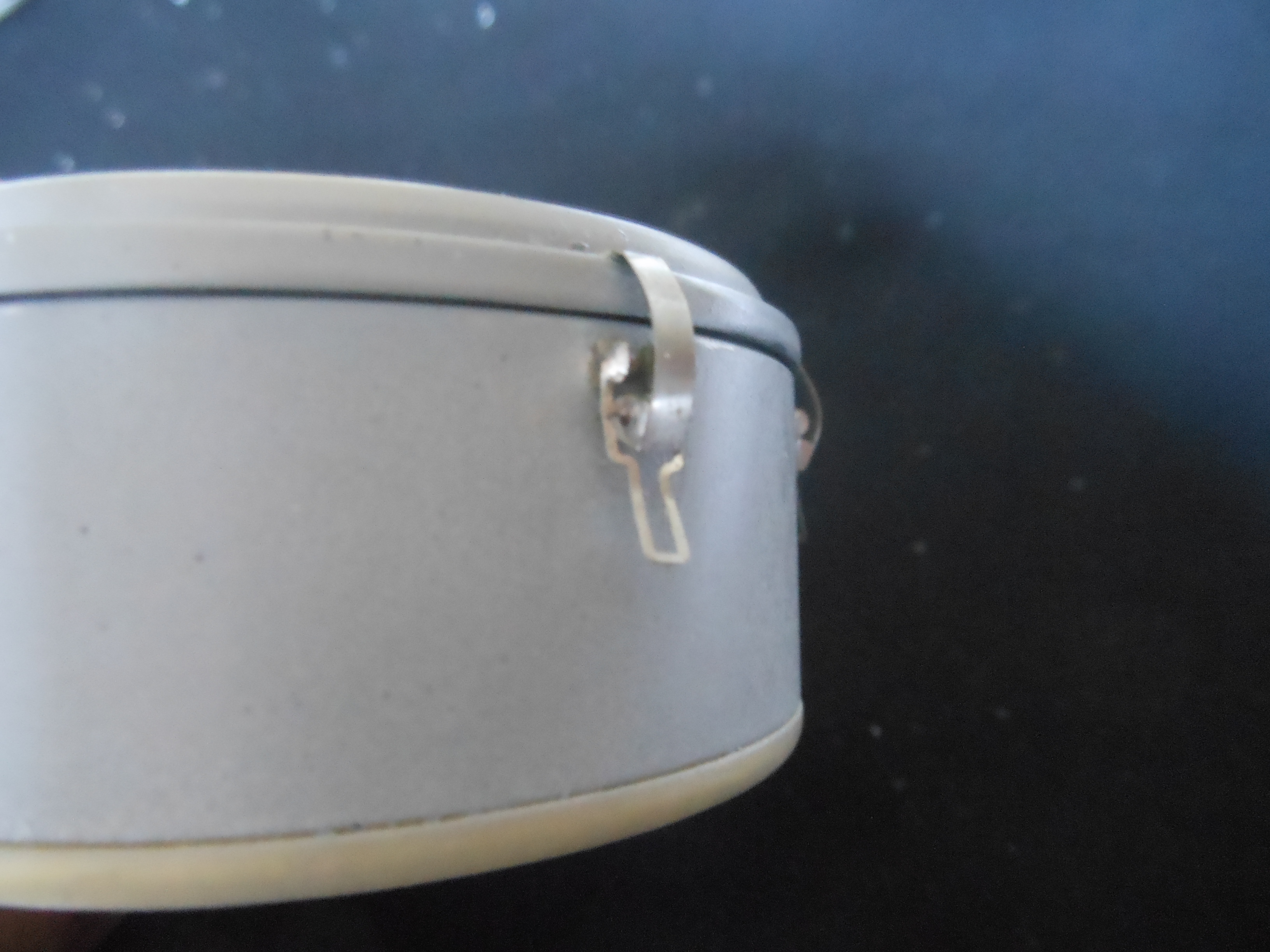

The clamps are also finished, all the levers were fixed with a drop of tin

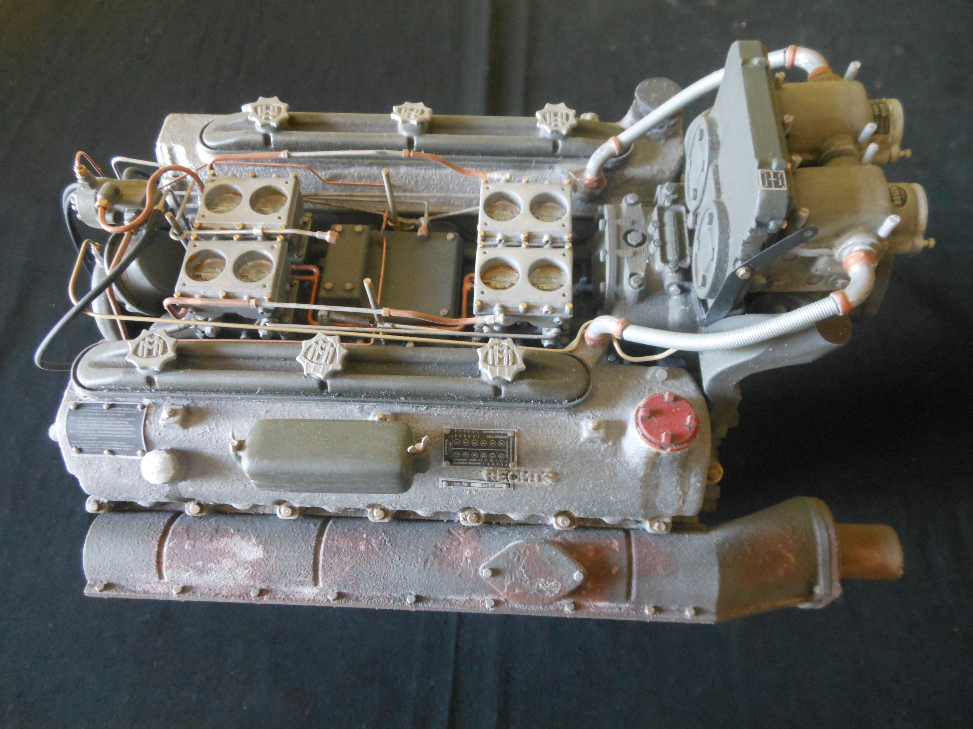

The upper part of the motor that I have sold is finally finished, I hope the buyer likes it. I think I can say that it came good. For the prices of any new kits, I confirm that we will have to wait until September. Happy holidays to all.

No Ivano, it didn't come out good, it came out fantastic! :D
