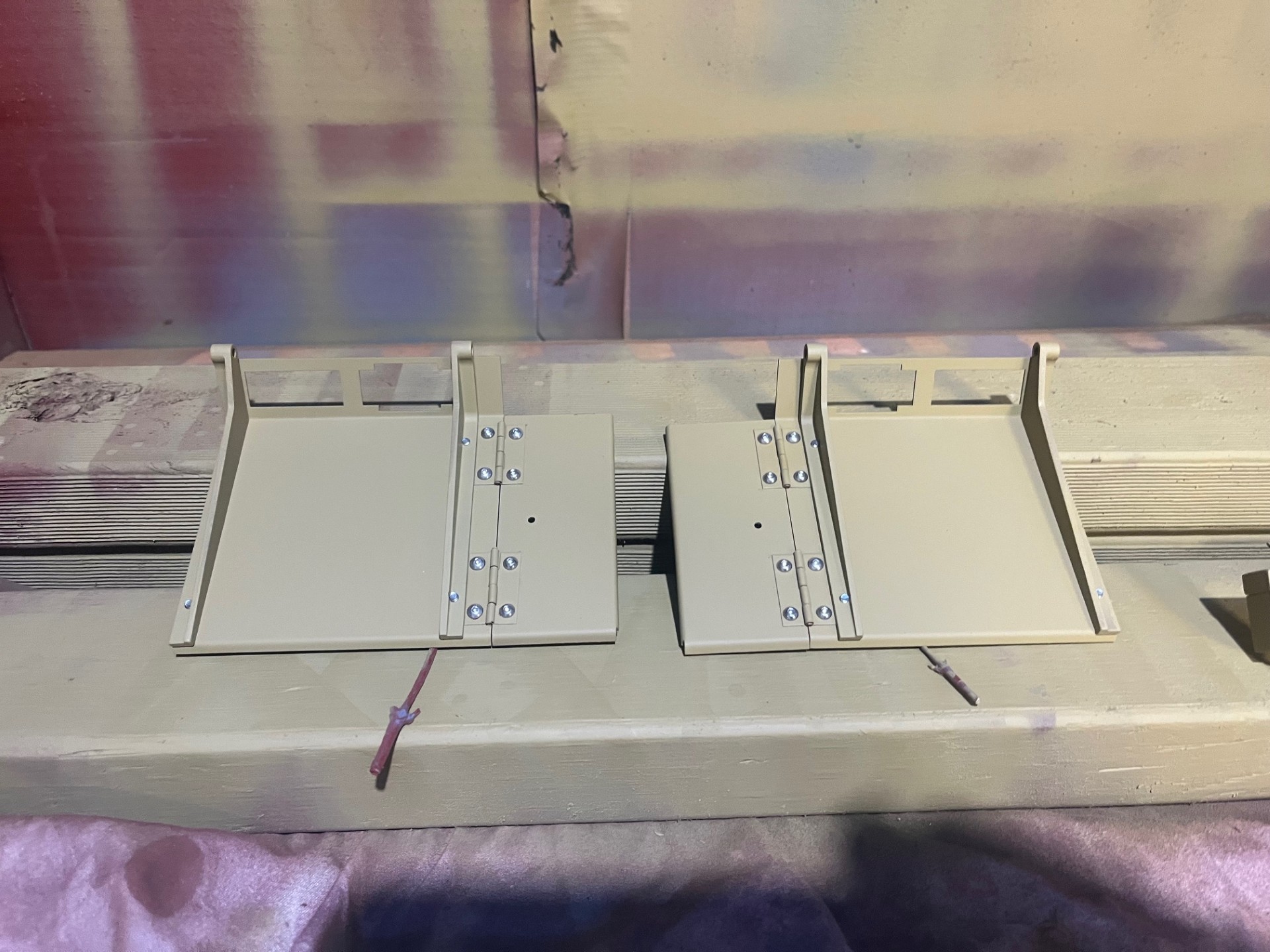

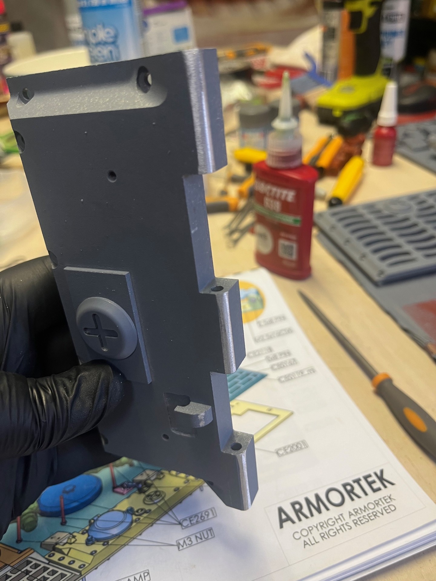

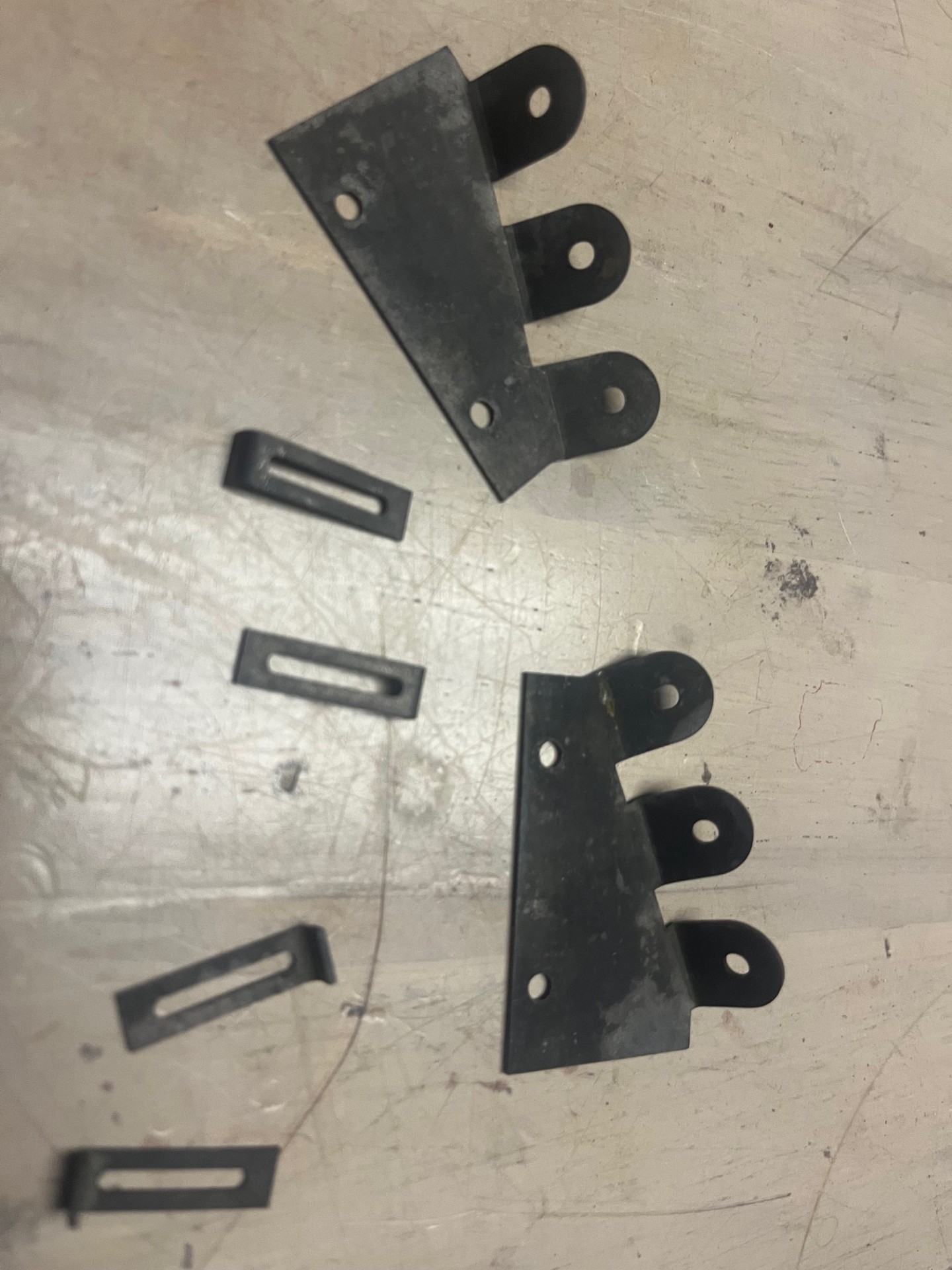

After a family holiday to Japan, got back into things in earnest.

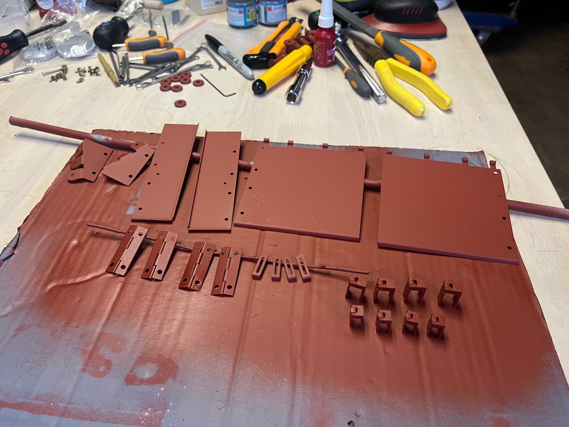

Grates and hinges all sanded, degreased & etched.

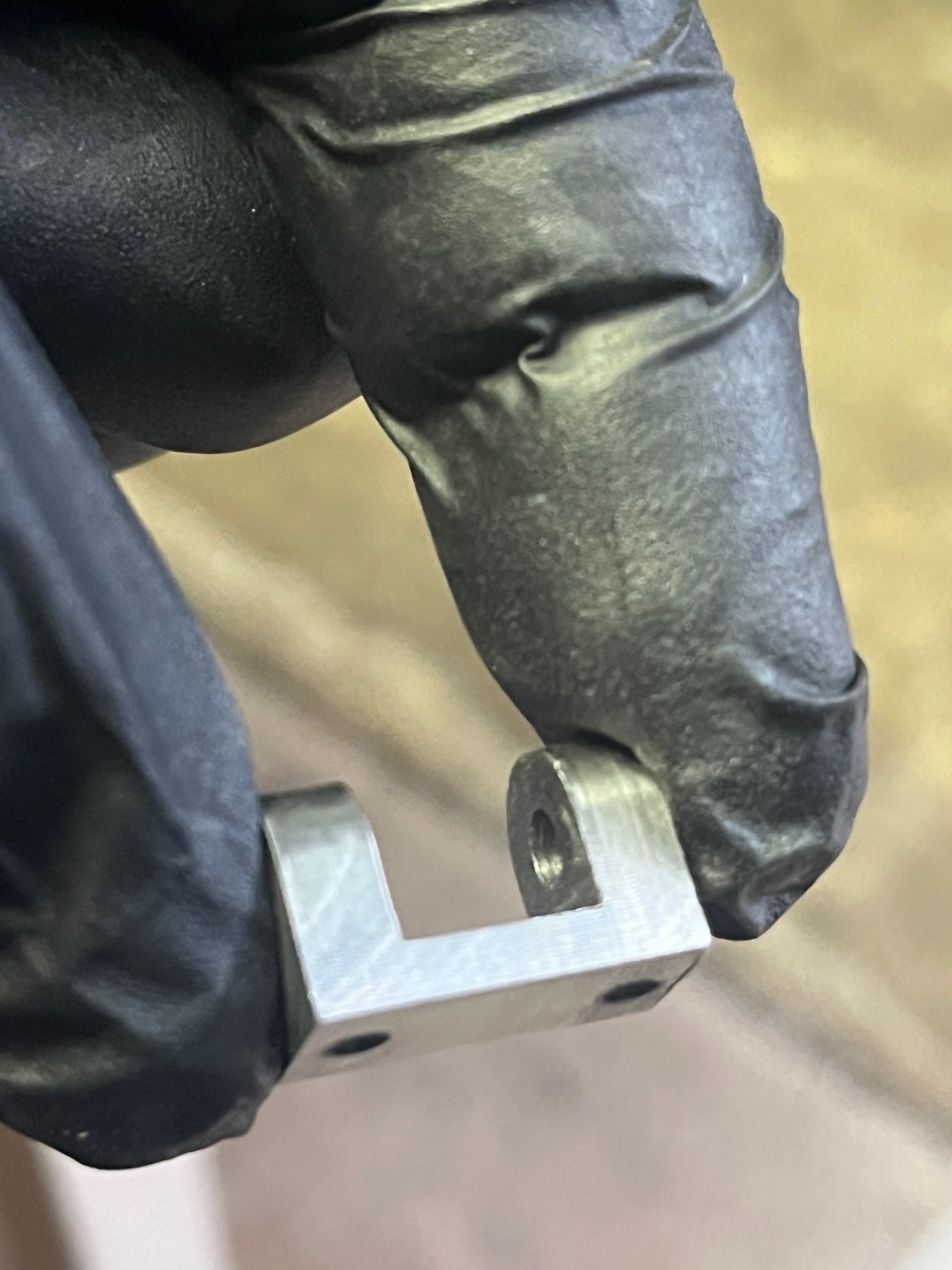

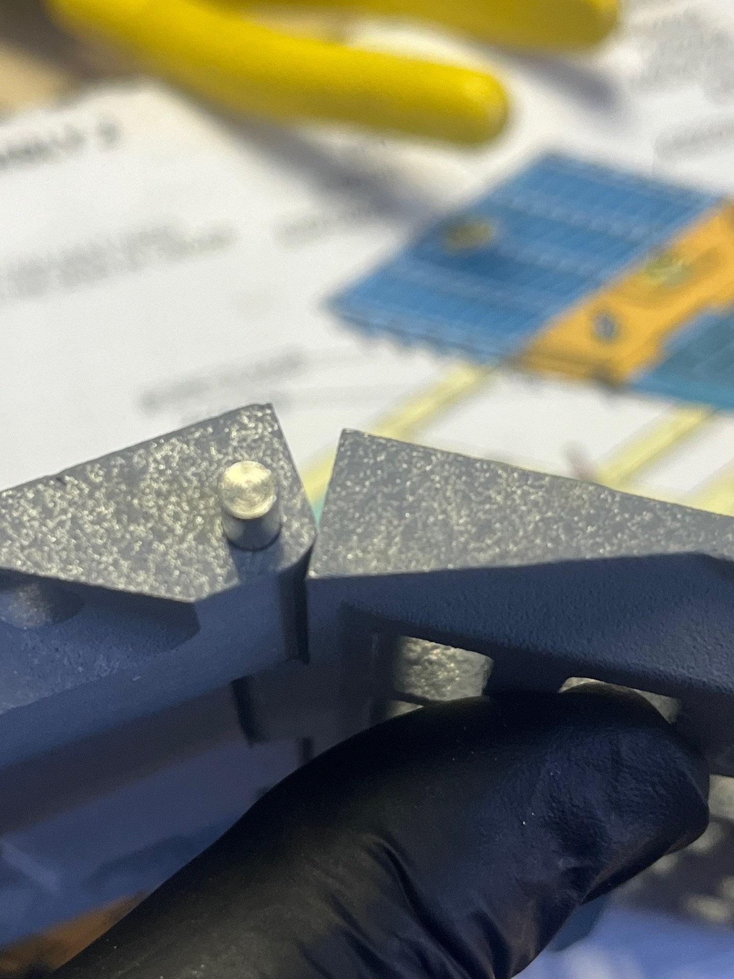

Putting the hinges together. One of them was perfect but the other one did not open more than about 30 degrees, it was jamming (see picture) Filed it down until a test fit was smooth I have done all the deck detail except for the clamps. I discovered that the rope clamp latch piece (CP0293) had an alignment issue, not sure why but all four of them are the same. The larger clamp type in the same bag were perfect length but where the hole aligns seems quite different. In the pic below the pin holes are perfectly aligned on both of these. The dremel will get another outing to try fix these.
Those square bolts were all very cool looking but I was glad when I had done the last one up. I am using nylocs so getting them all done up was fiddly, used needle nosed pliers to hold the heads.

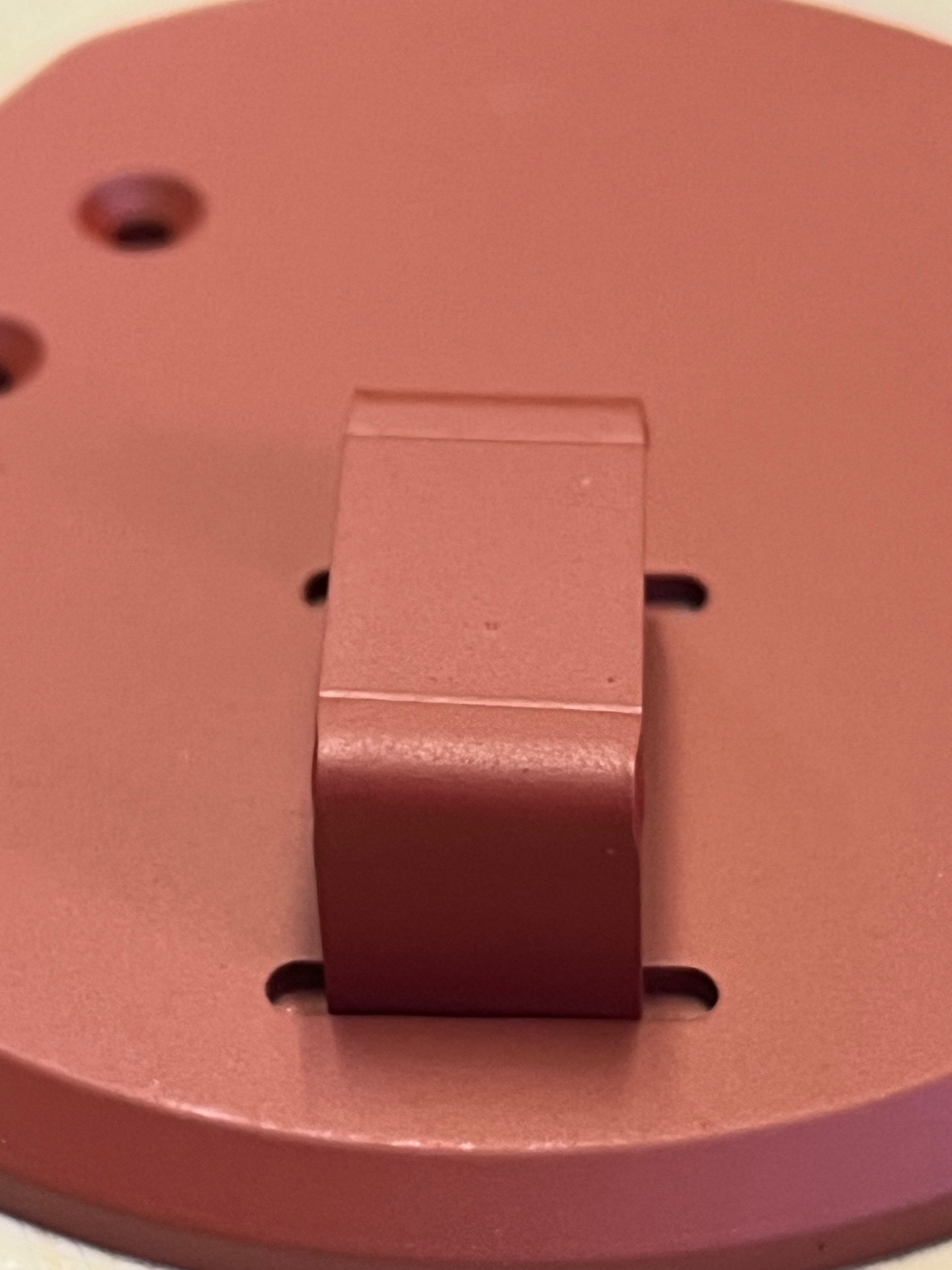

Re: Neil's early Tiger 1 (2023)

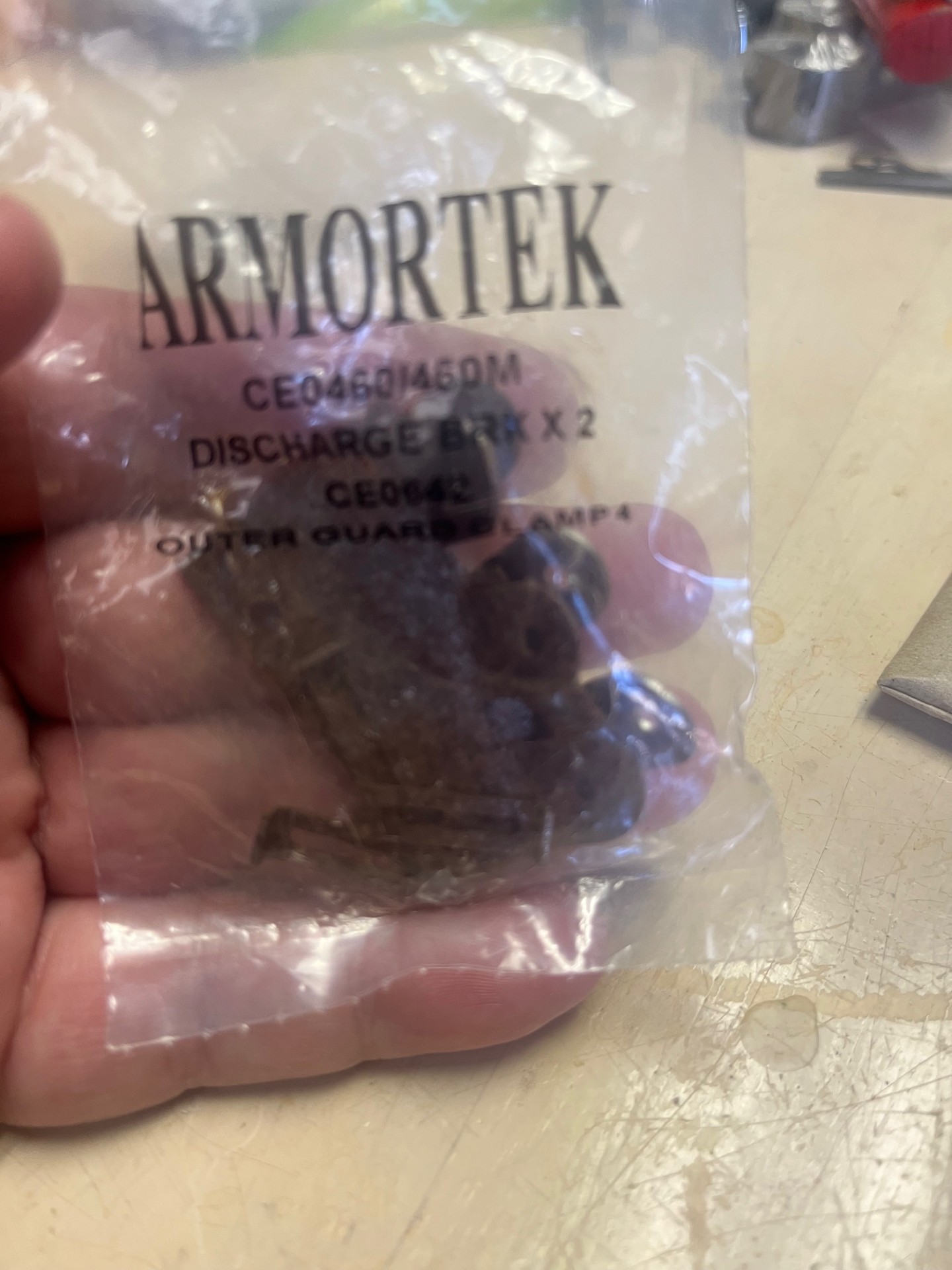

Potentially.... the short top clamps you slotted previously for the jack clamp were the correct ones for these shorter rope clamps. There's about 2mm difference between them iirc.
- Posts: 154
- Location: ACT, Australia
- Has liked: 71 times
- Been liked: 315 times
That would make sense....either way, these are a cosmetic detail and I am not complaining! Gives me a good excuse to get the dremel outSean-Armortek wrote: ↑Sun Jul 14, 2024 9:57 amPotentially.... the short top clamps you slotted previously for the jack clamp were the correct ones for these shorter rope clamps. There's about 2mm difference between them iirc.

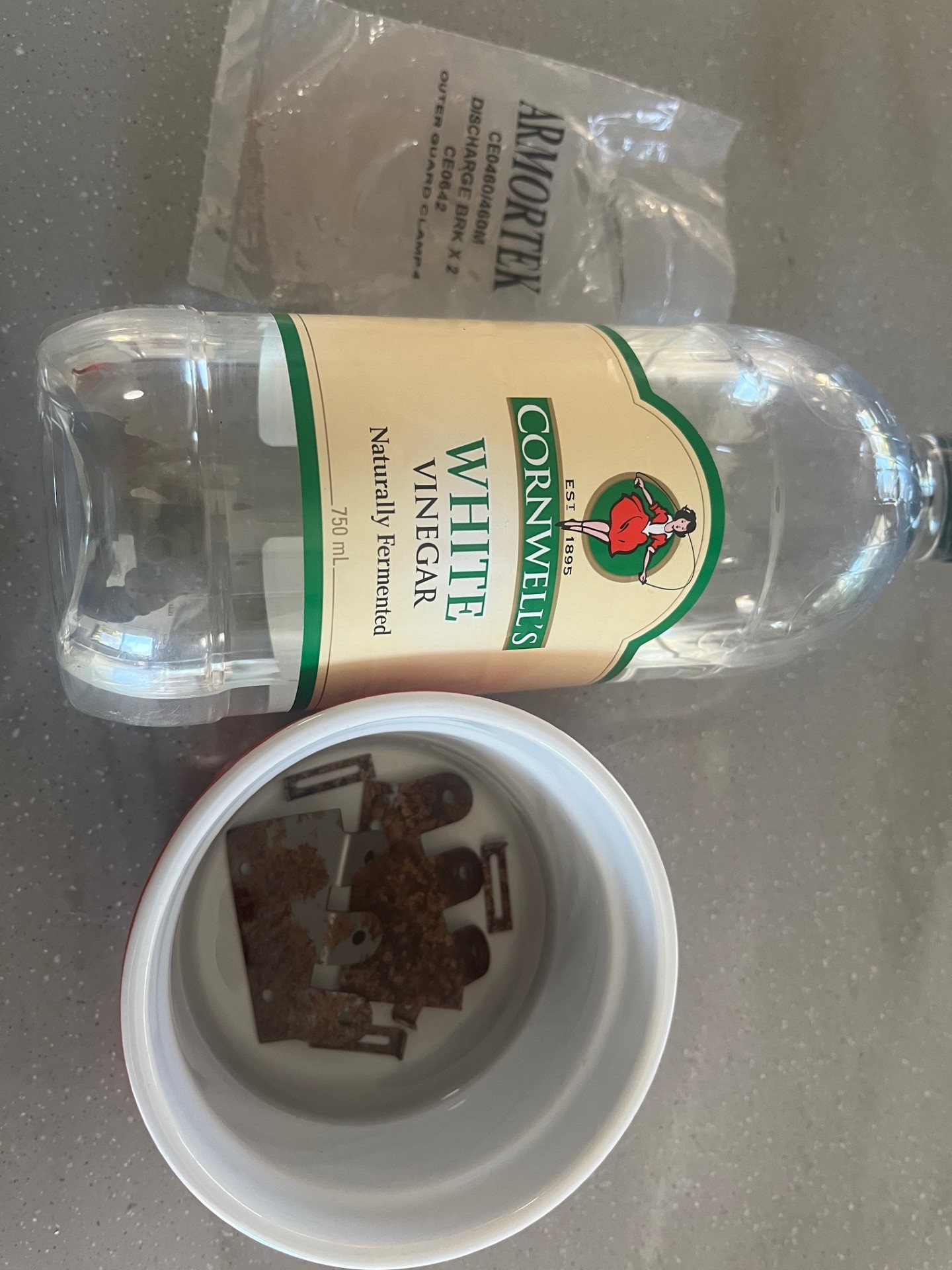

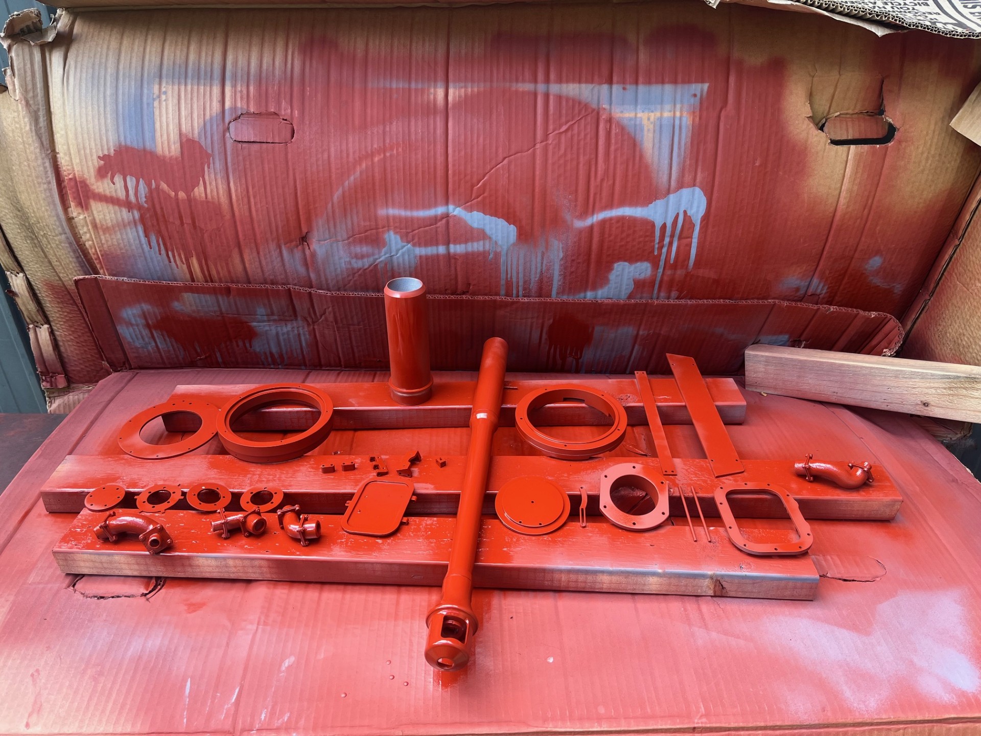

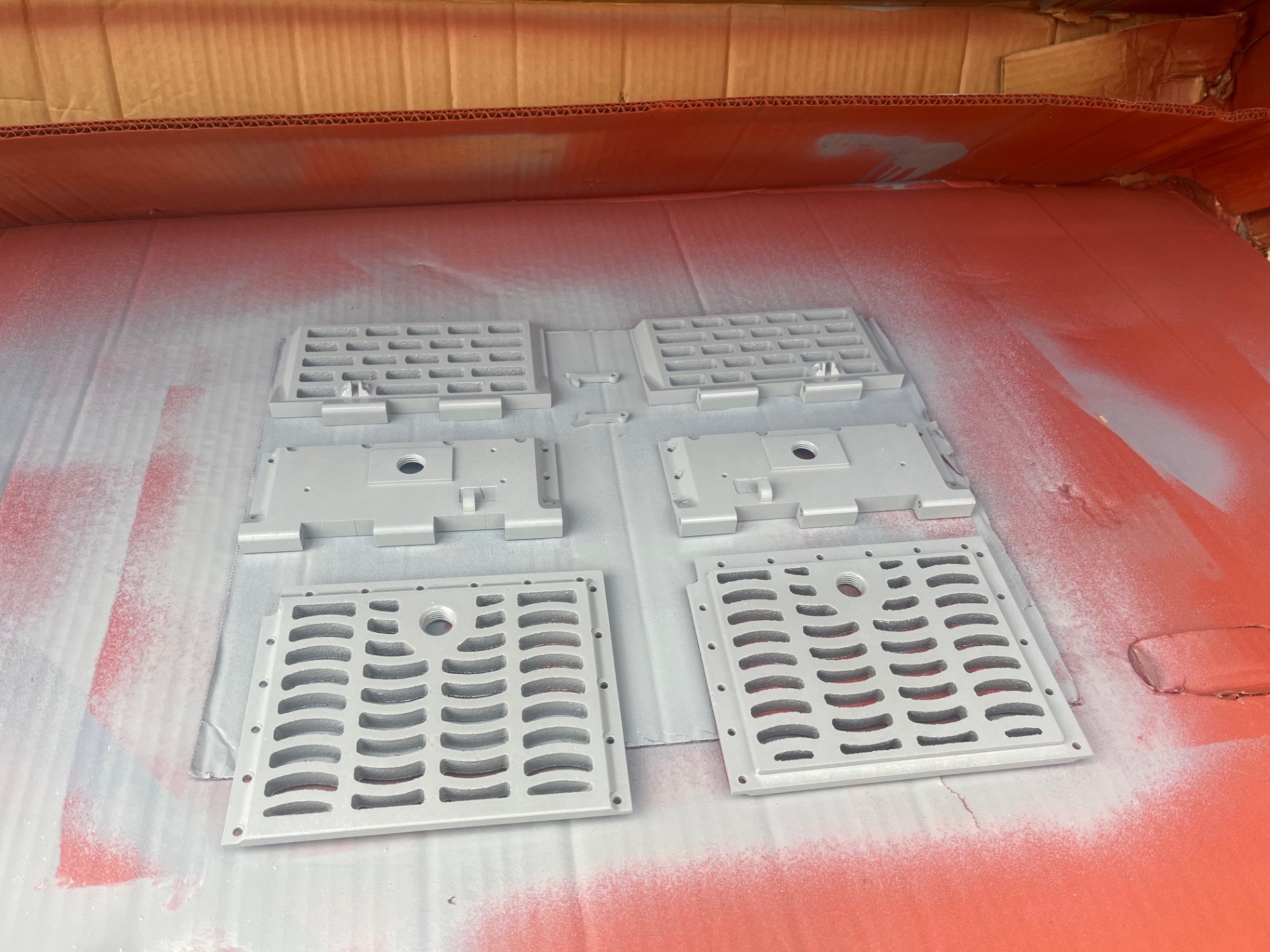

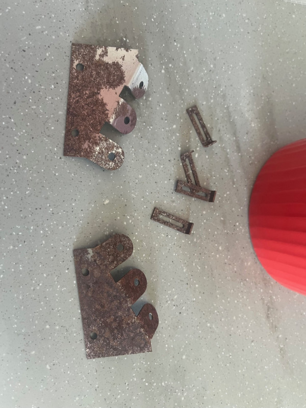

Rust? What rust!: Neil's early Tiger 1 (2023)
Long break with only doing a few bits and pieces.
There aren't that many steel parts, but even of those there have only been a few pieces with a few small bits of rust, until I needed these parts: They looked even worse out of the bag I think I have had this vinegar for 10 years After 2 days in the vinegar they came out clean, but slippery! Then a good sanding.... I etch primed them immediately after the sanding.

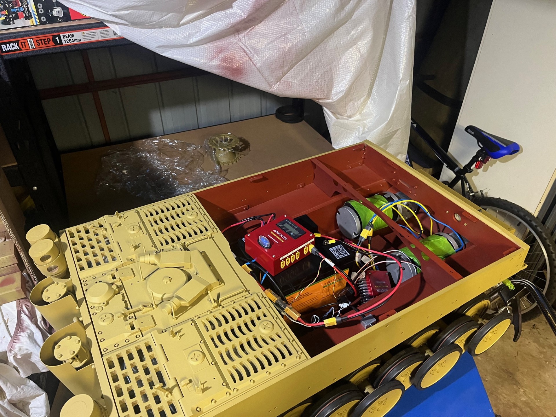

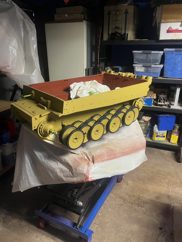

Wheels ON!: Neil's early Tiger 1 (2023)
Prepared all the pieces of front mudguards, will put them together and paint them this weekend.
Finally decided to put the wheels on, its now looking very 'tanky'
Now I am about ready to put the sprockets on, but before I do that I need to get the motors in..... so battery tray in first, then the supports
Rear deck plate as well
Finally managed to connect all the electrics and test the gears......the motors are pretty noisy but the gears are smooth!

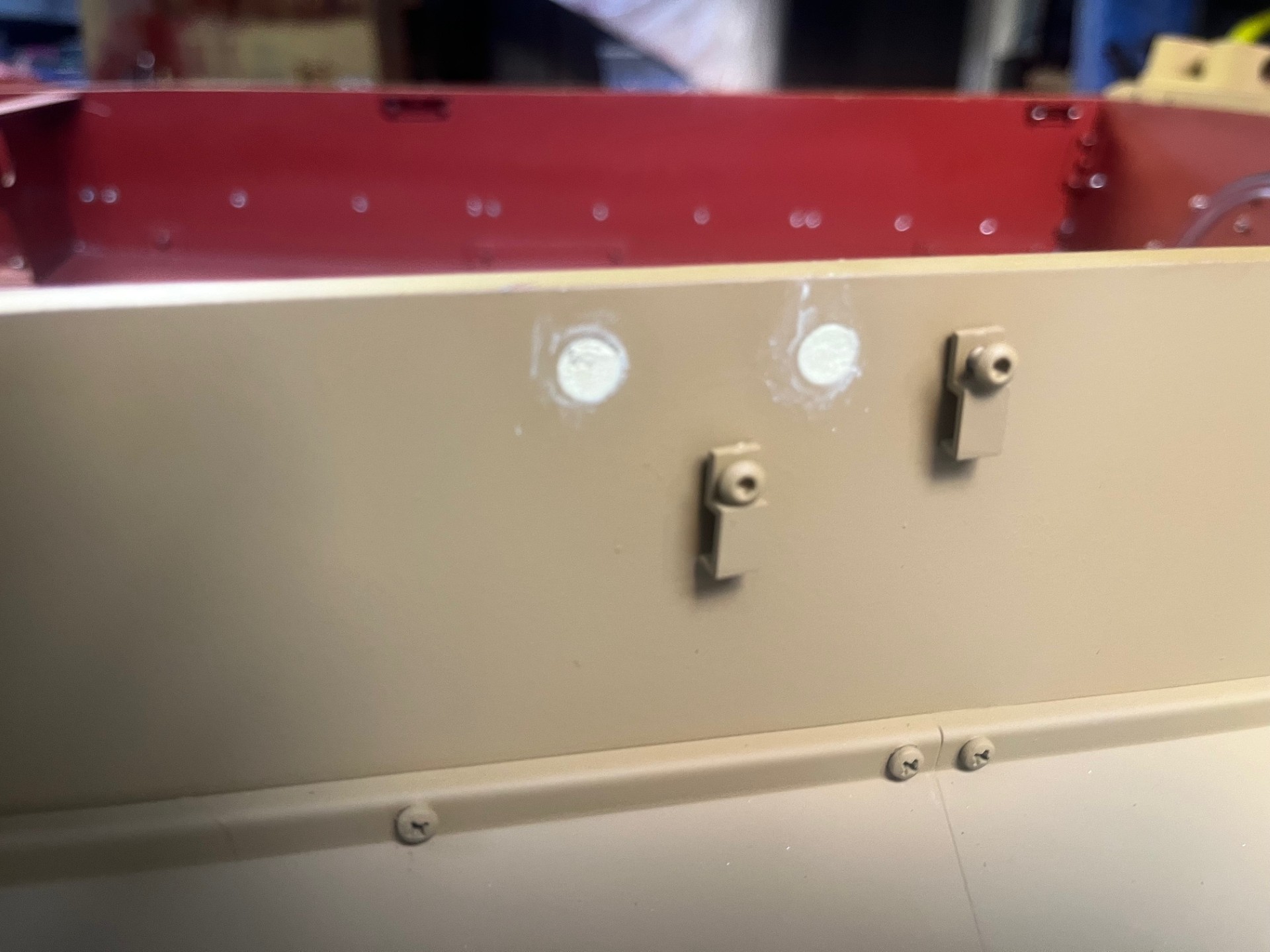

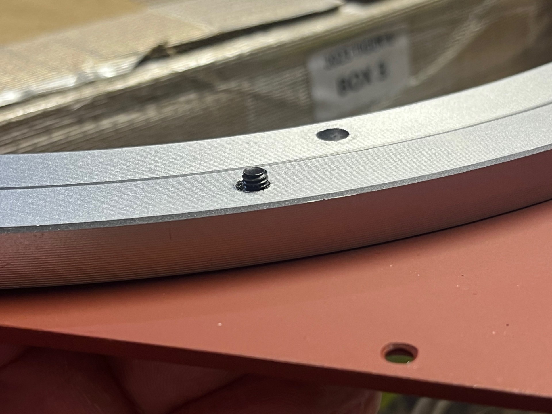

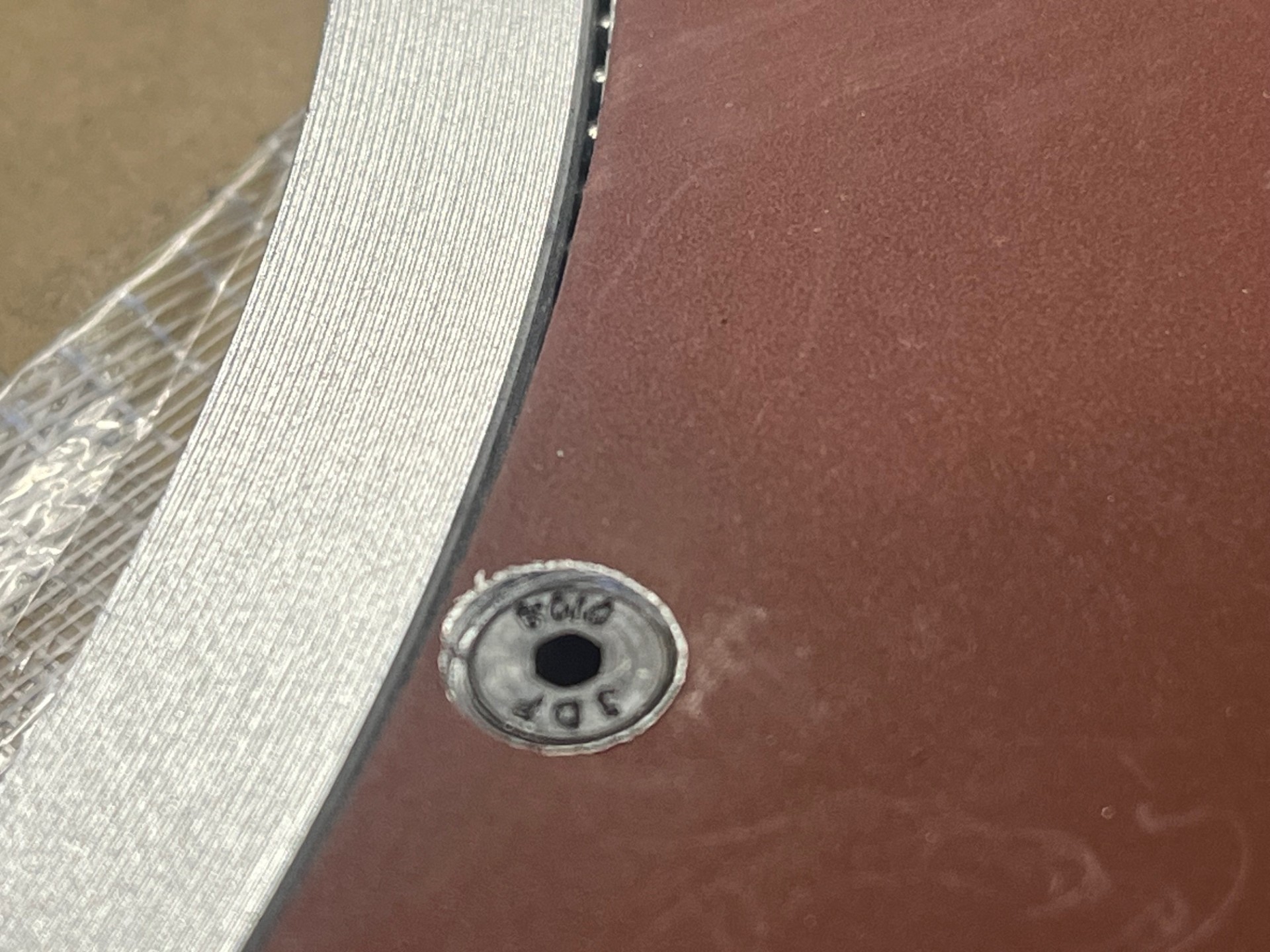

Ring of Fire!: Neil's early Tiger 1 (2023)
As always, I did what I felt like doing.... not what I said I would do

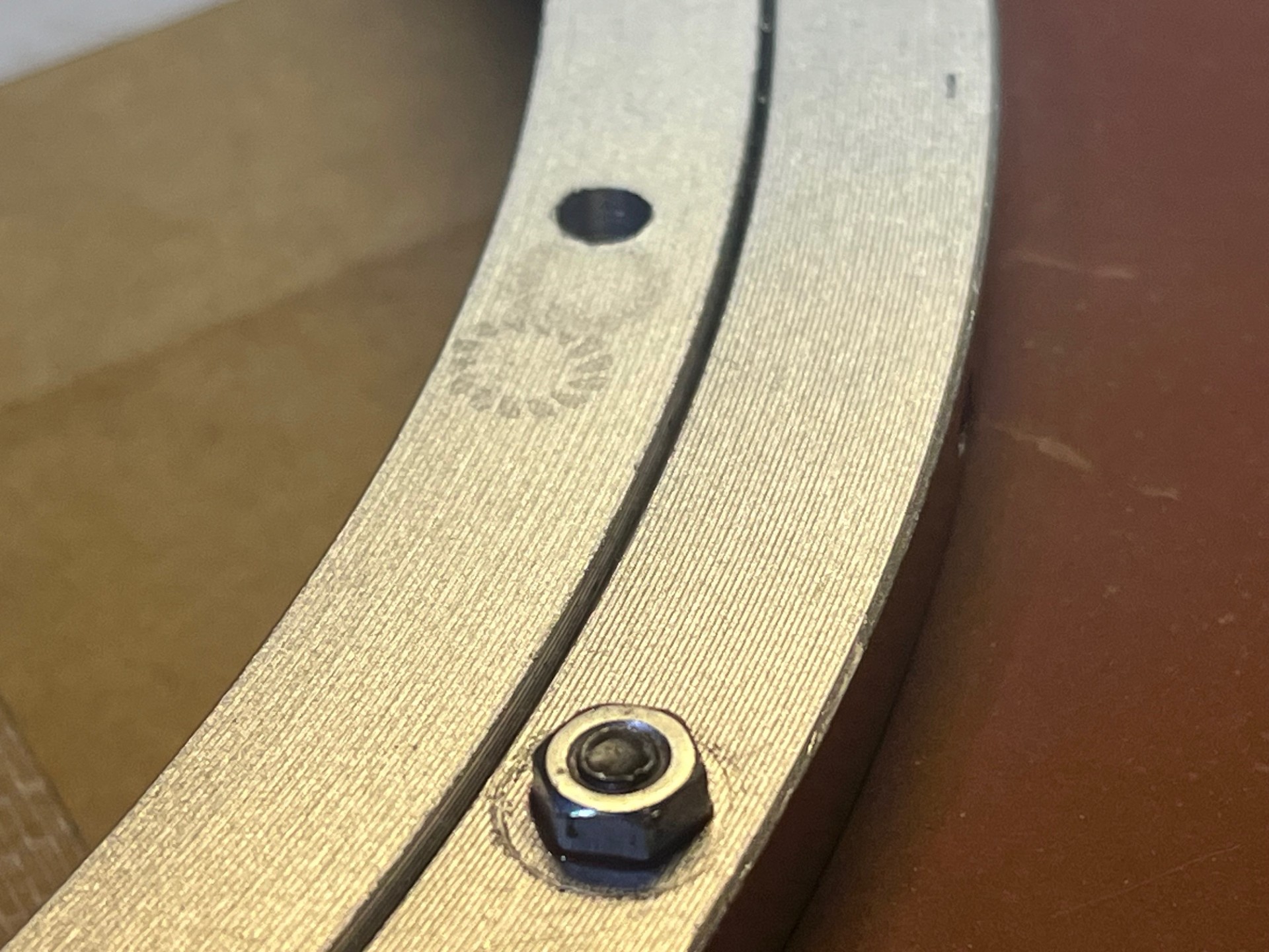

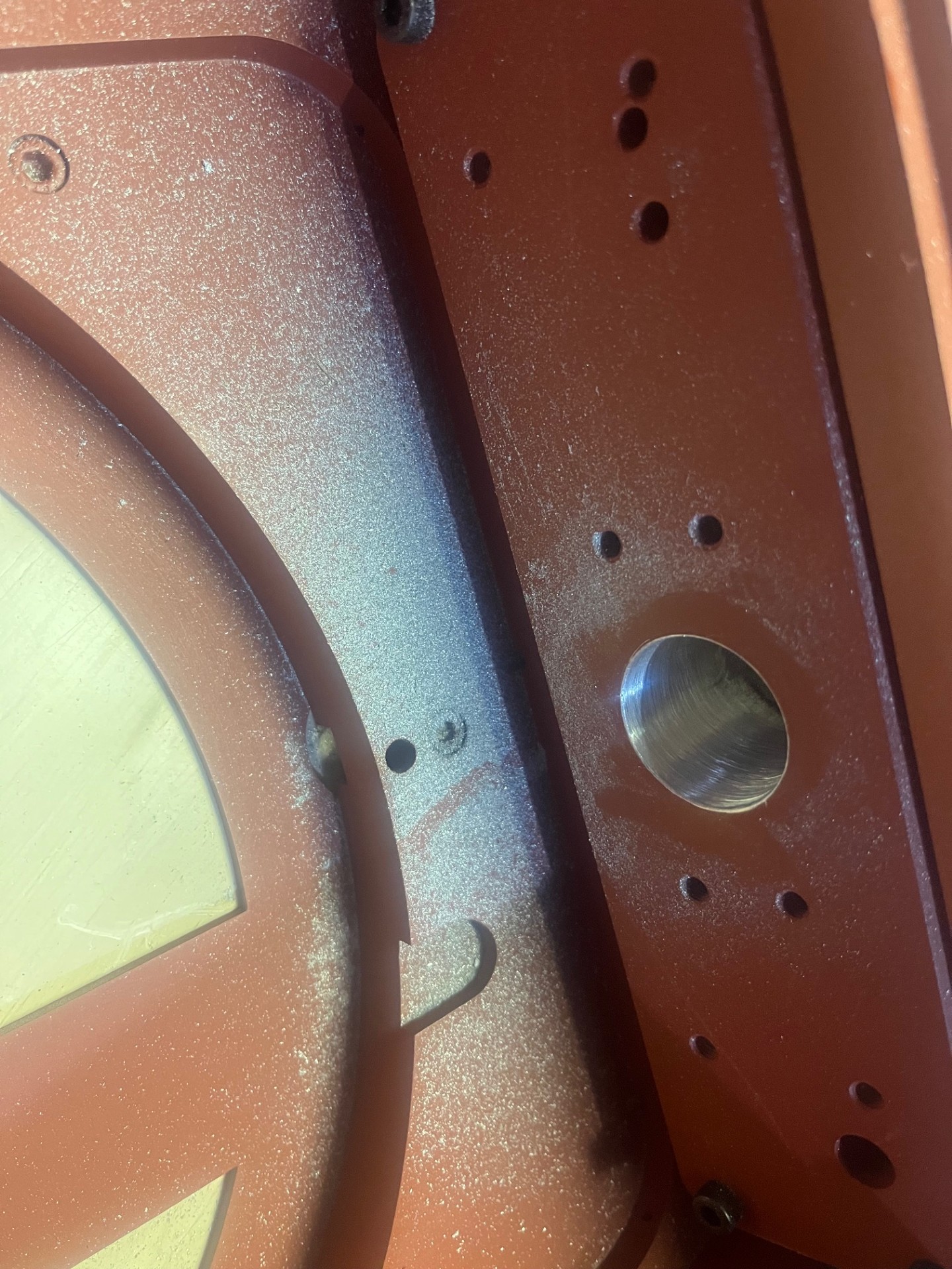

Attached the turret ring, but not without some issues. Nothing very dramatic, but took me into new areas. I have seen others mention this one, and indeed I had the same problems about length as others (bolt length!!!, I swear!). Normally I don't hesitate to replace bolts/nuts, but these bolts were trickier... its very hard to get M3 countersunk bolts of exactly 18mm!! They cant be longer due to the turret ring gear for those with the option packs.
So, I had to man up instead and fix the actual issue. The countersink wasn't drilled deep enough, so the bolts sat about 1-2mm proud. Normally that would be no issue....but this meant that there was only a few turns on the nuts underneath. I had to buy a countersinking drill head, and carefully correct the countersink depth.... scary stuff!
Clenched while drilling... but here are the results:

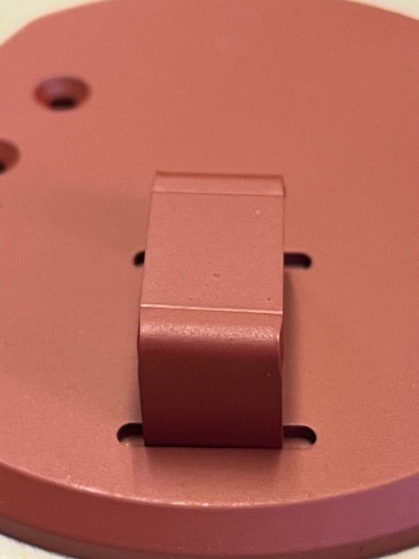

Off script adventures: Neil's early Tiger 1 (2023)

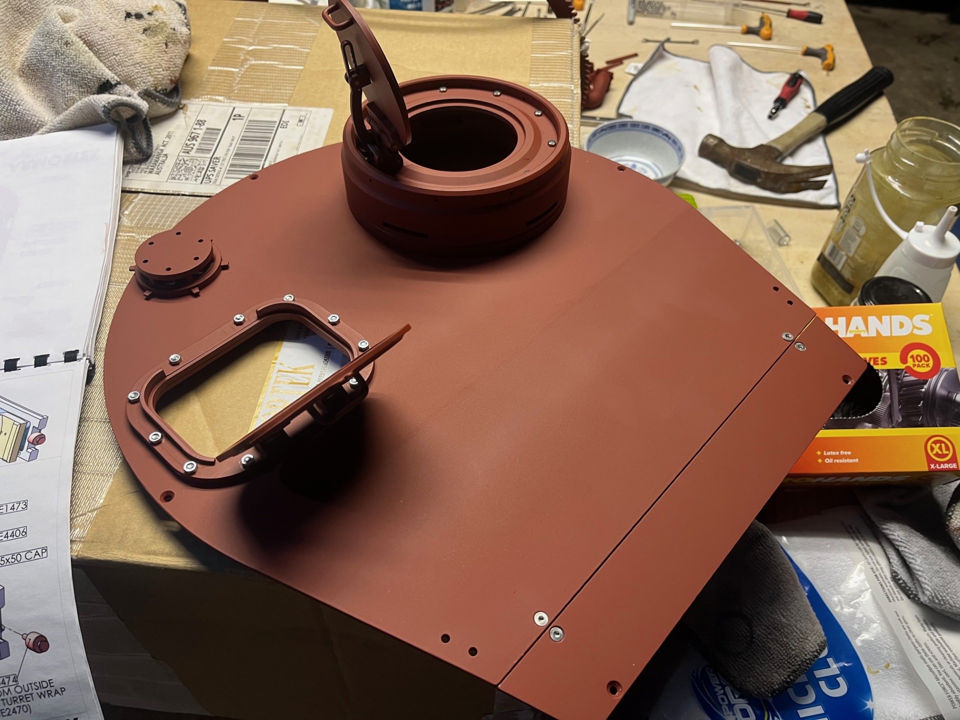

As I moved onto the top deck things became very much more fluid, the instructions become more like guidelines....though its pretty clear what needs to be done.

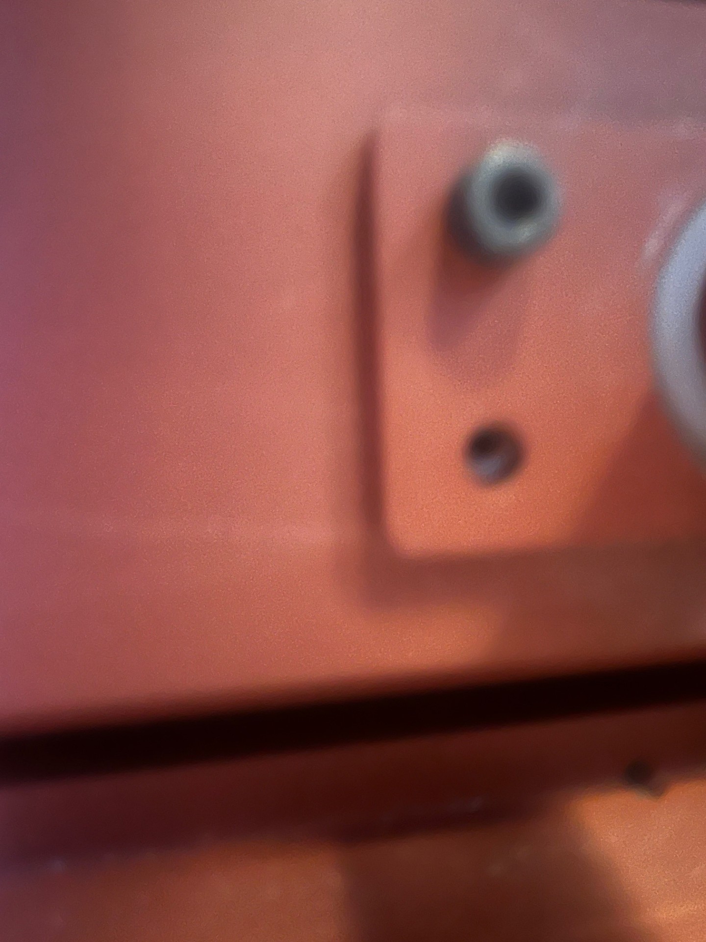

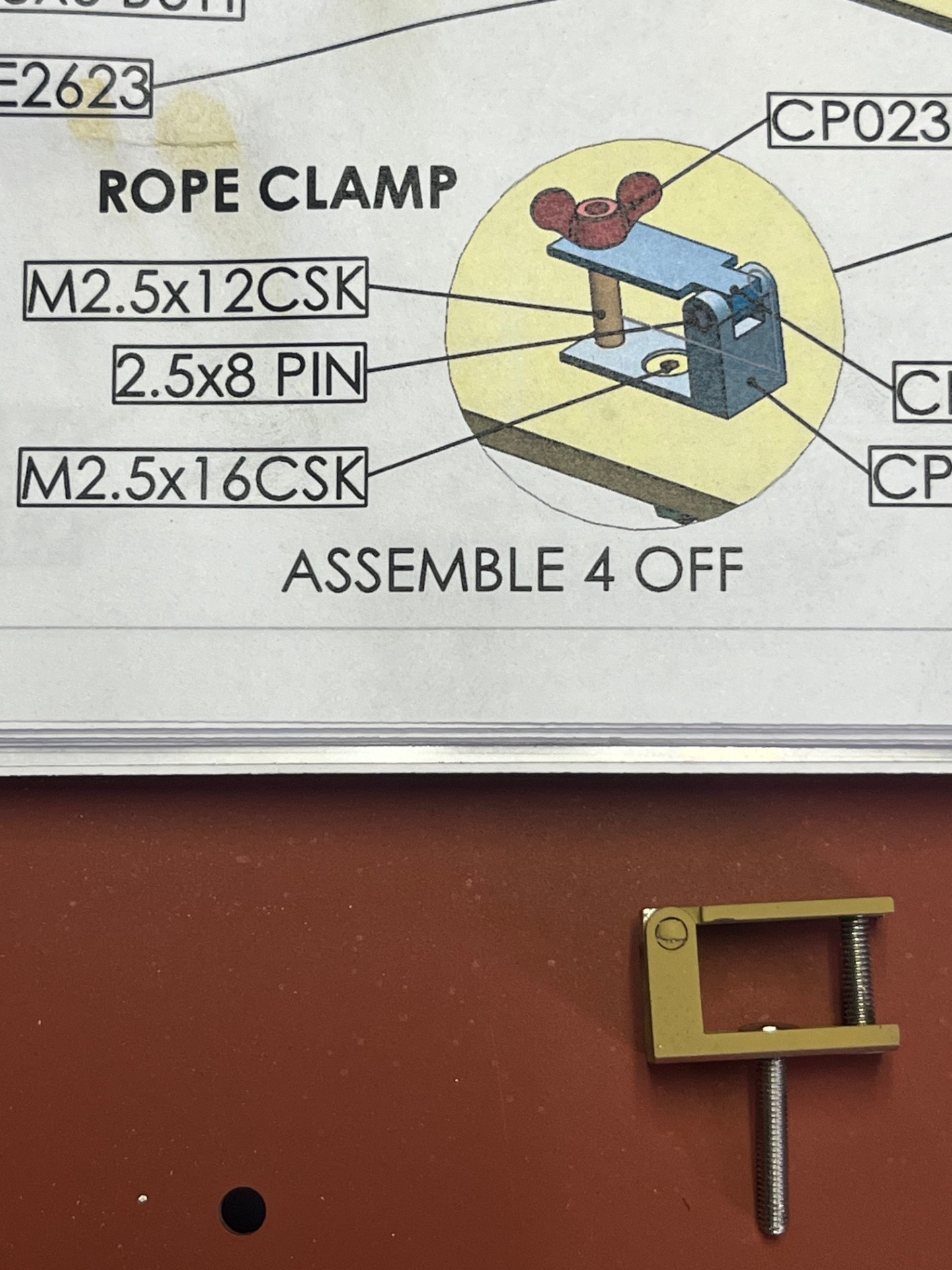

Some of the instruction errors were obvious.... the M3 bolt simply doesn't screw into the M4 threaded object, though trying to guess which M4 bolt you didn't need for other things wasn't obvious (I hope I guessed correctly).
The rope clamps: I therefore switched the bolts the other way around, it seemed to work.
I just tried to centre them: Not sure why one of my parts has been rounded... but I expect it to work without issue After all that, I emptied an entire bottle of the paint I am using on this

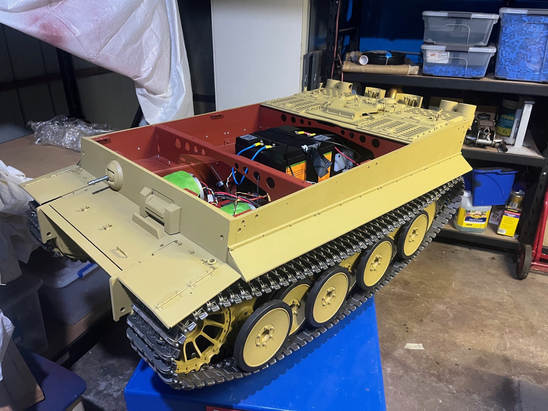

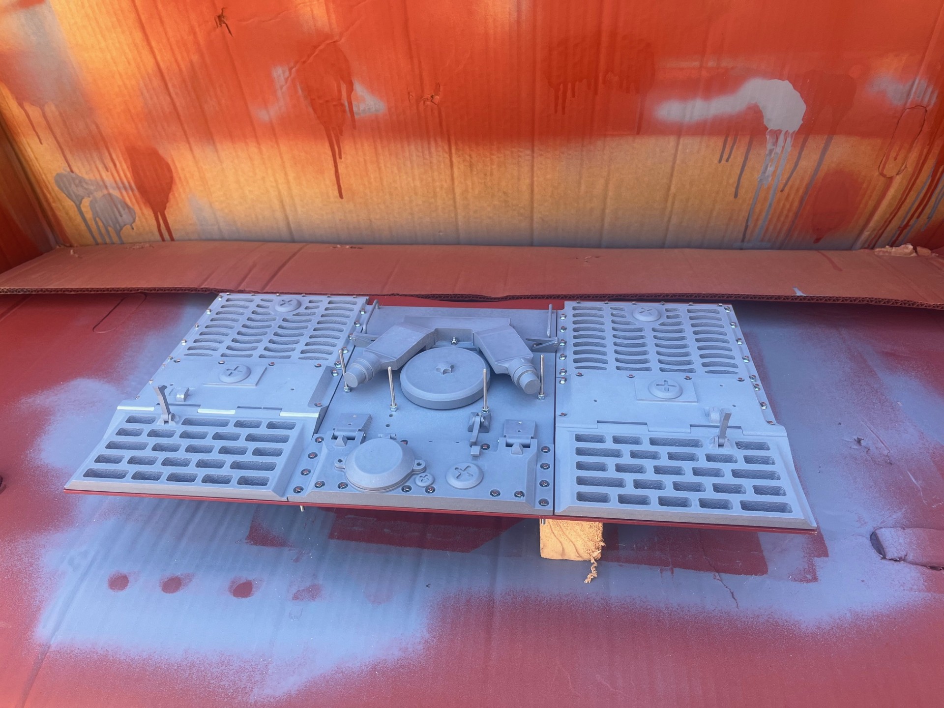

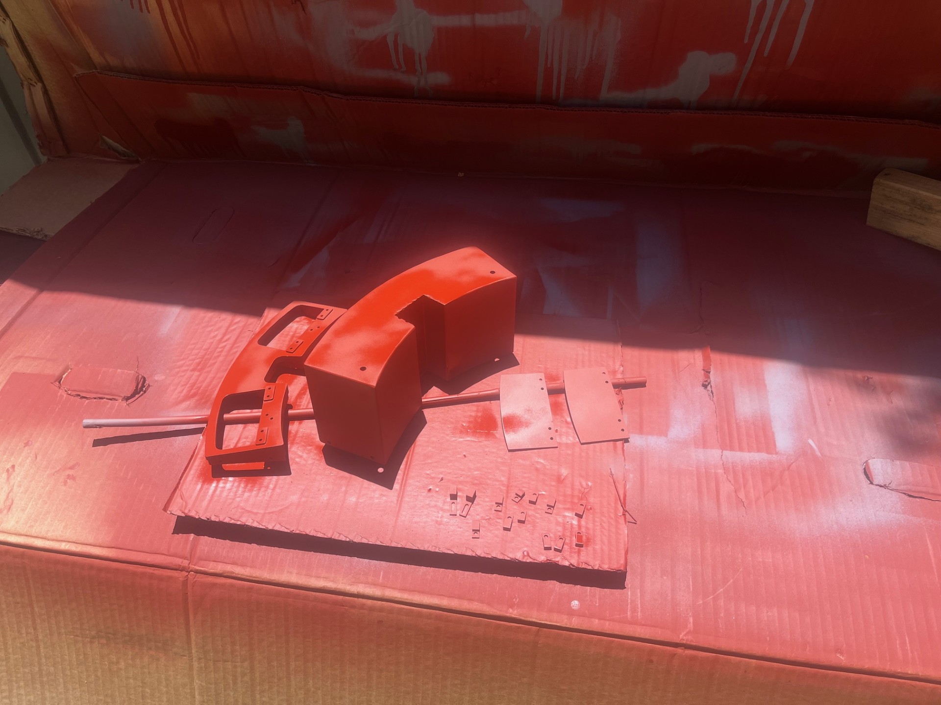

I have been super busy the last few months with work, but I have still managed to get a few things done.
I got the front sprockets, steel upgrade tracks & front mudguards on! Started painting the rear mudguards: Cracked open the turret parts: Sanded, etched and primed:

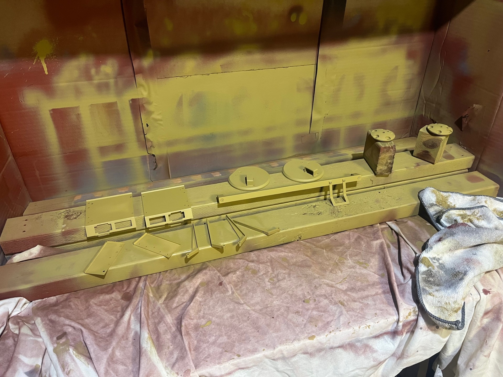

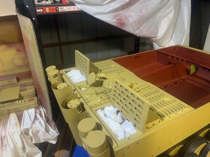

Oh Danny Boy, the pipes, the pipes are calling
This last few weeks was involved with a bunch of things.

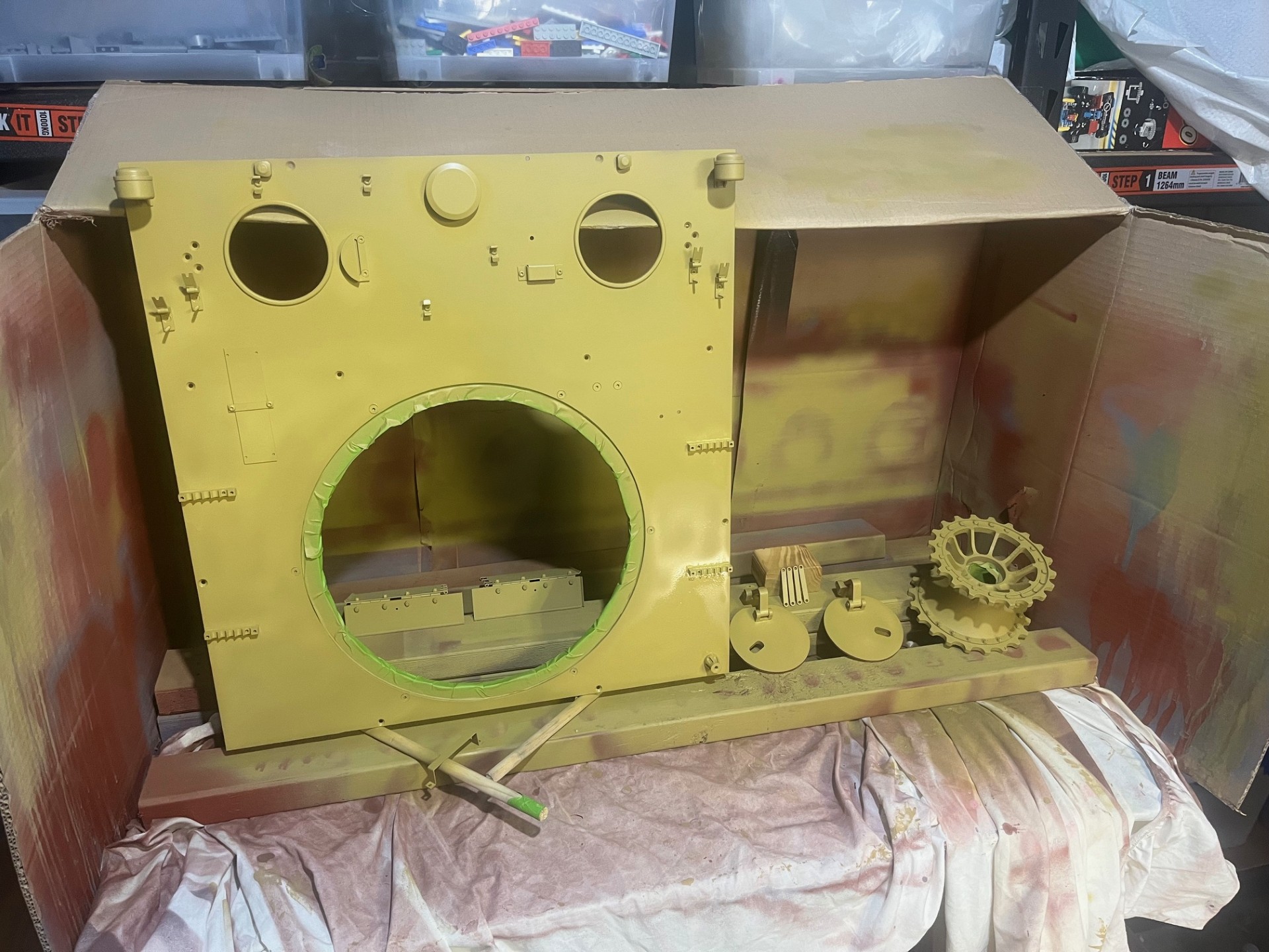

Firstly fixing up my mistakes from my stupidly linear reading of the instructions and then dealing with flaws in the smoker option pack.

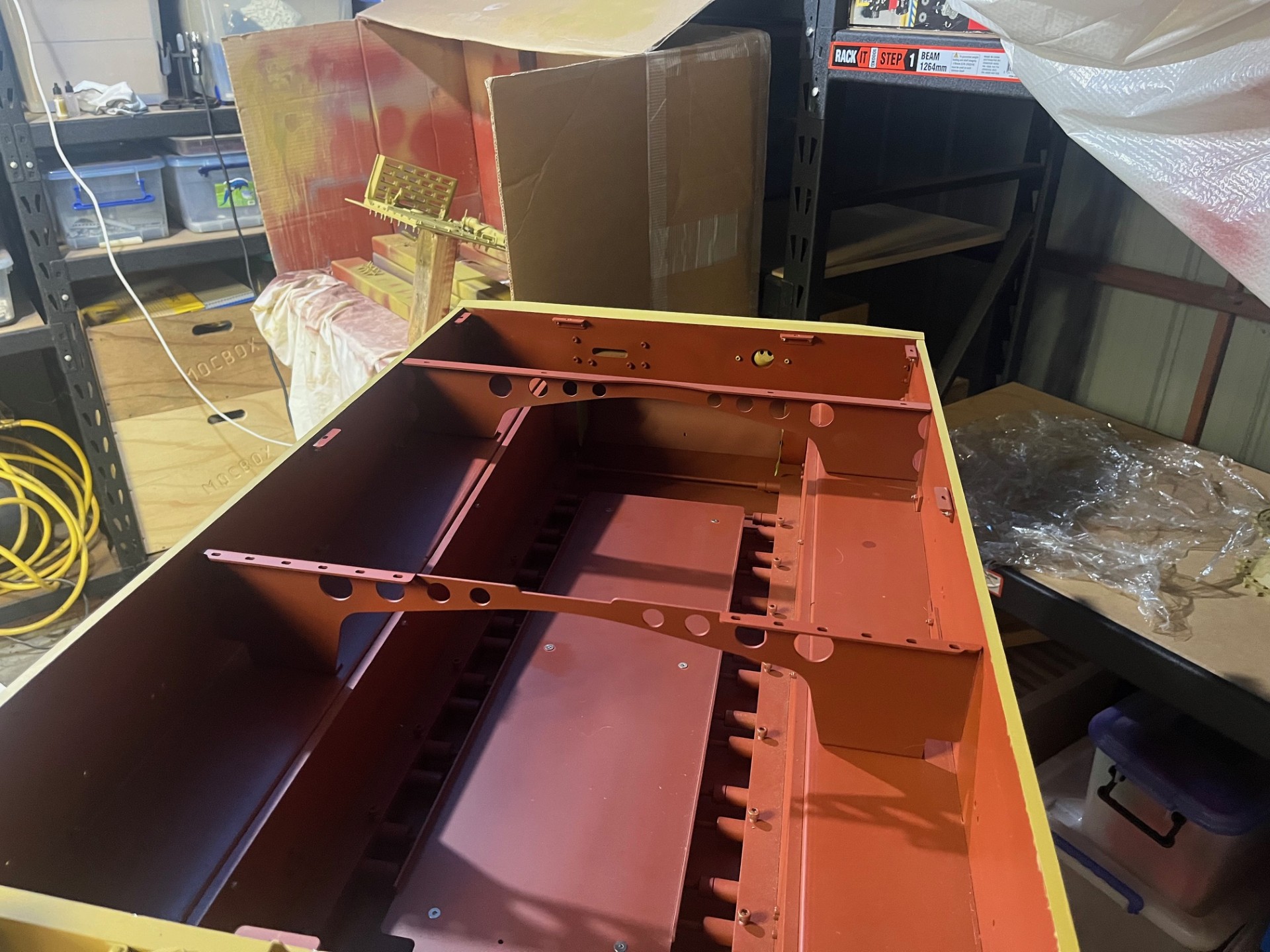

I originally attached all my square headed bolts to the rear plate first....then attached it to the chassis, with the nyloc nuts in between the chassis support and the rear plate. This actually looked pretty good, the rear plate lined up with the sides. However, when I then went to put the main turret plate on....this no longer all lined up nicely, the main plate sat too high. So....had to undo most of the square bolts to remove the nuts....only to find that the main plate now sits too low. OK..... I guess I will add a few washers or something under the support to raise it a little. EDIT: or use the original nuts which turned out best!!
The more I build this tank the more I realise why a lot of people seem to dry build the whole thing first, then dismantle and build it for real.

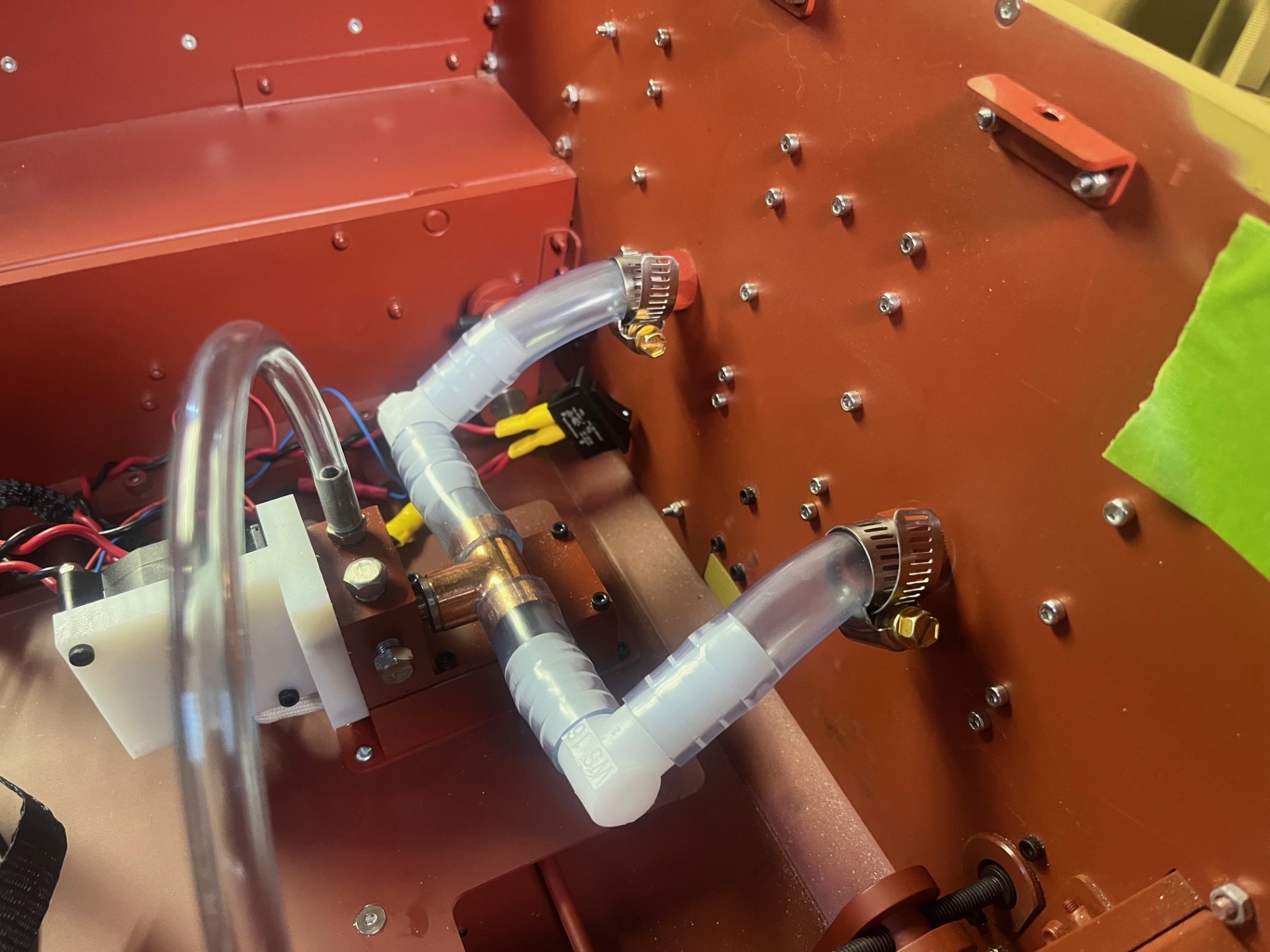

However, one bonus to removing the rear plate was I now had easier access to the smoker option pack. It had some obvious issues that blind optimism told me would be fine....but after a 5 minute test run in the backyard I had pipes falling out everywhere. So, I decided to fix it so this would not happen again. Overkill? Ugly? Maybe not workable? Probably....but at least these pipes arent falling out!! The original pipe is still inside the copper....well, at least 5cm of it anyway, new oversize pipe that goes outside the copper fits over the top of the original pipe. I put together the rear mudguards...just need to give all the bolts a coat of paint. After a lot of back and forth, I decided to give Milliput a crack and fill in the big bolt holes on the sides. Obviously I did this after fixing all the top plate alignment issues. Obviously its not very well done.... but its my first attempt.
Painting/touching up a few things here and there. Turret bins looking good

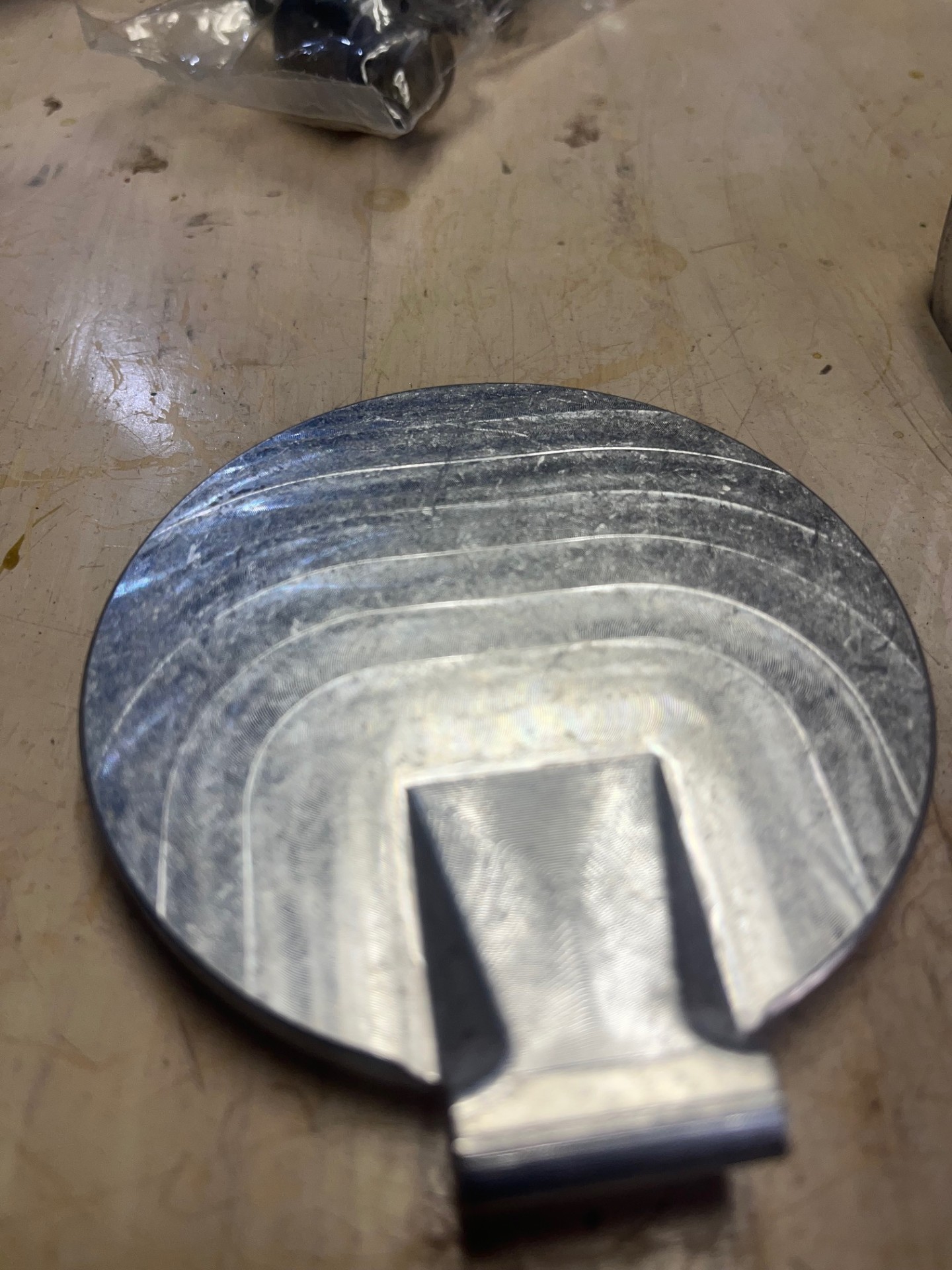

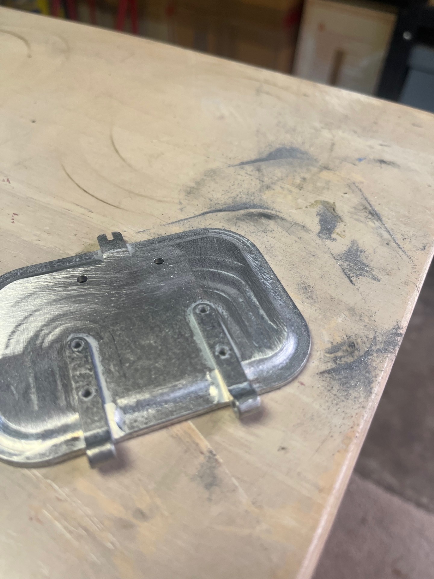

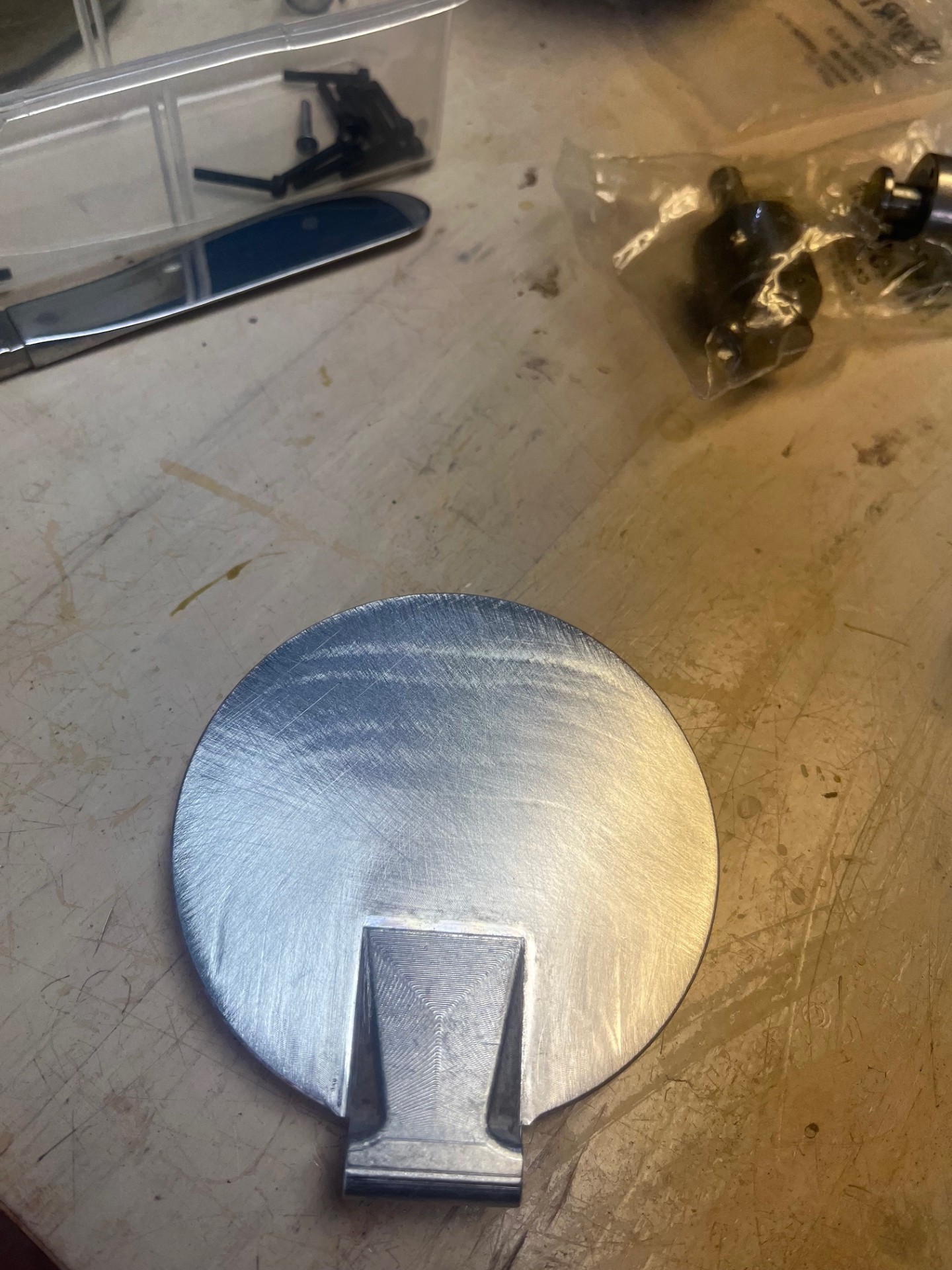

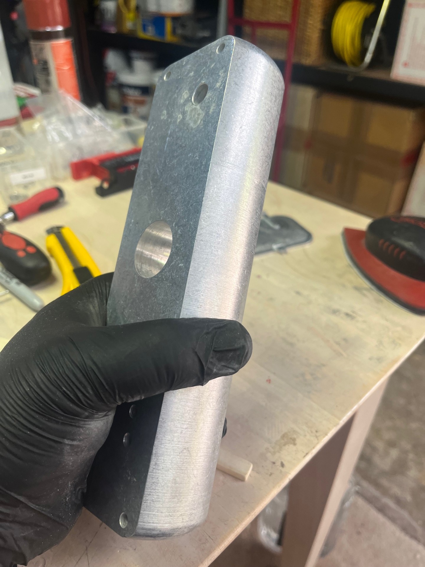

As seen on another thread, the hatch on the top of the turret had some serious CNC issues going on.
Phew..... a lot of elbow grease just to get them to this stage...
I dont recall handling an almost solid ingot of aluminium before..... but this was impressive!

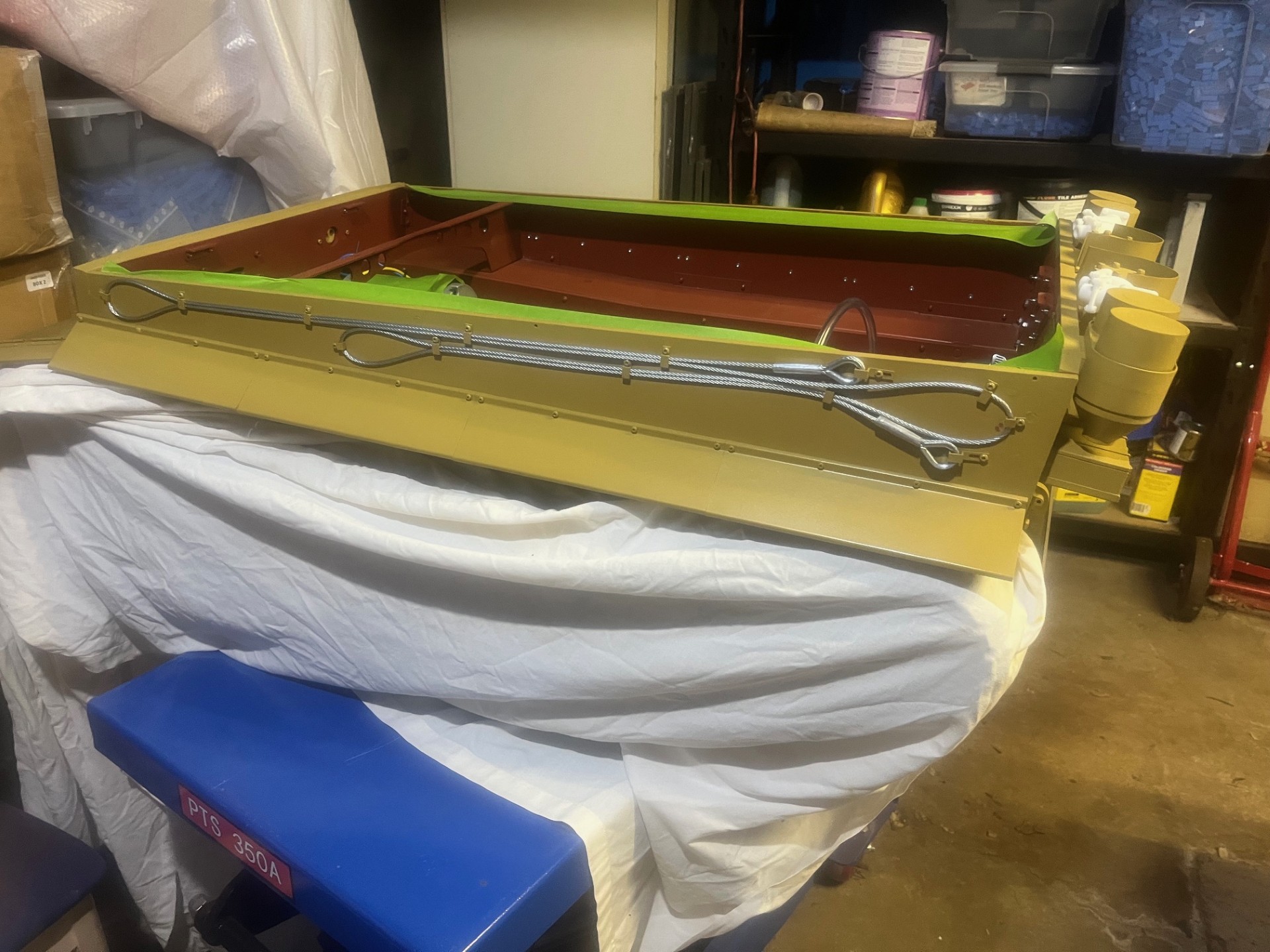

Attached the light rope. I found it was 3-4cm too short to be put on as the instructions suggested, so I switched the end bracket and this seemed to work well.
The other hatch for the turret had even worse CNC marking. These ridges were very easy to feel, let alone see. It was very cool to get the barrel out and loctited together, it looks awesome! Tiny open end spanner saving the day again. These bolts were too close to the edge to use any of my sockets or even the tiny ring spanner Assembled turret lid The turret with barrel being fitted. Used Mr Surfacer over the top of the primer followed by a light sanding. It looks and feels great....cant wait to see how it looks painted.

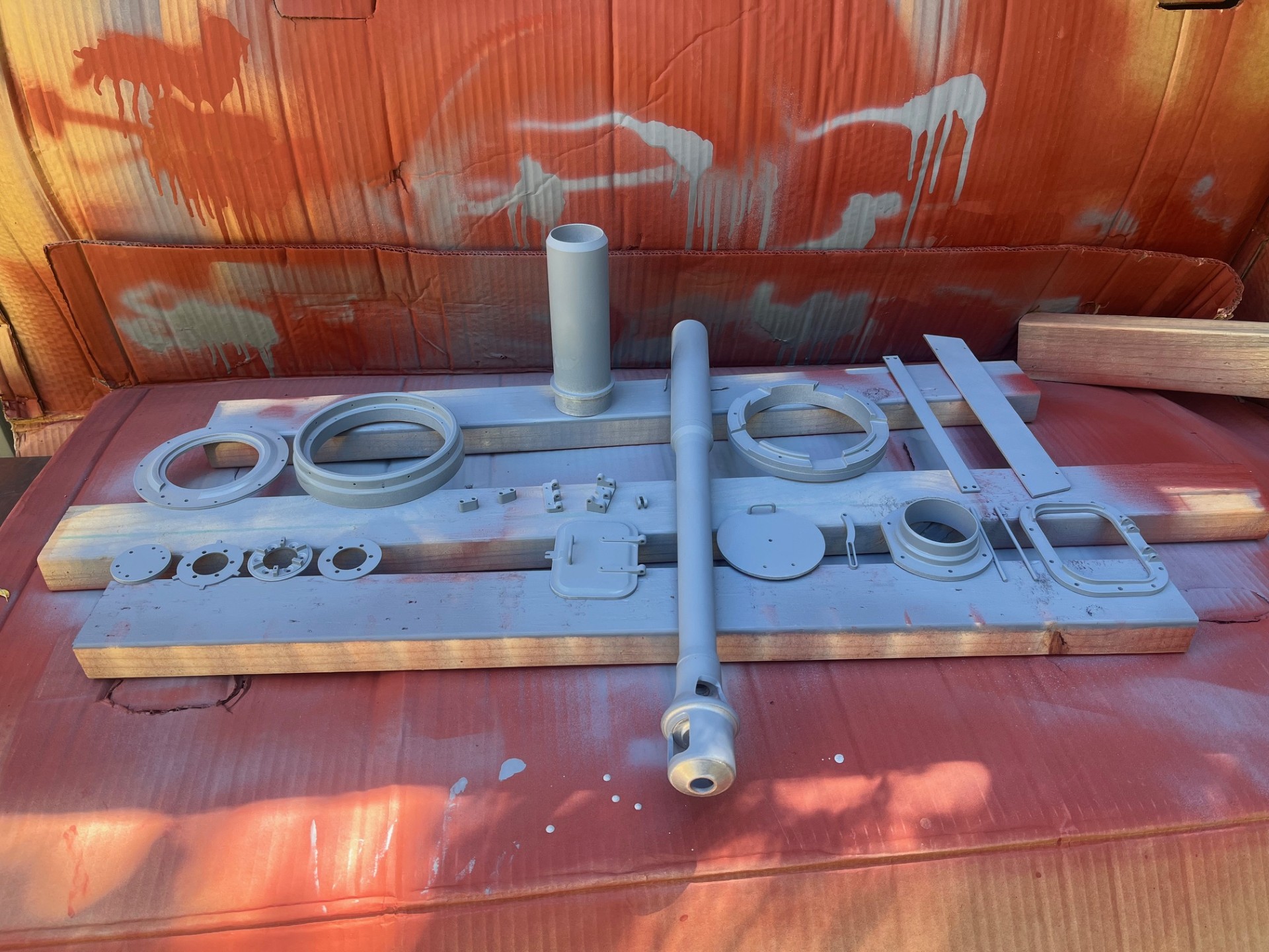

Work continued on the turret, I basically took all the remaining parts I had left and sanded, etched & primed them. It is hitting home to me how close I am to finishing!The other hatch for the turret had even worse CNC marking. These ridges were very easy to feel, let alone see. It was very cool to get the barrel out and loctited together, it looks awesome! Tiny open end spanner saving the day again. These bolts were too close to the edge to use any of my sockets or even the tiny ring spanner Assembled turret lid The turret with barrel being fitted. Used Mr Surfacer over the top of the primer followed by a light sanding. It looks and feels great....cant wait to see how it looks painted.

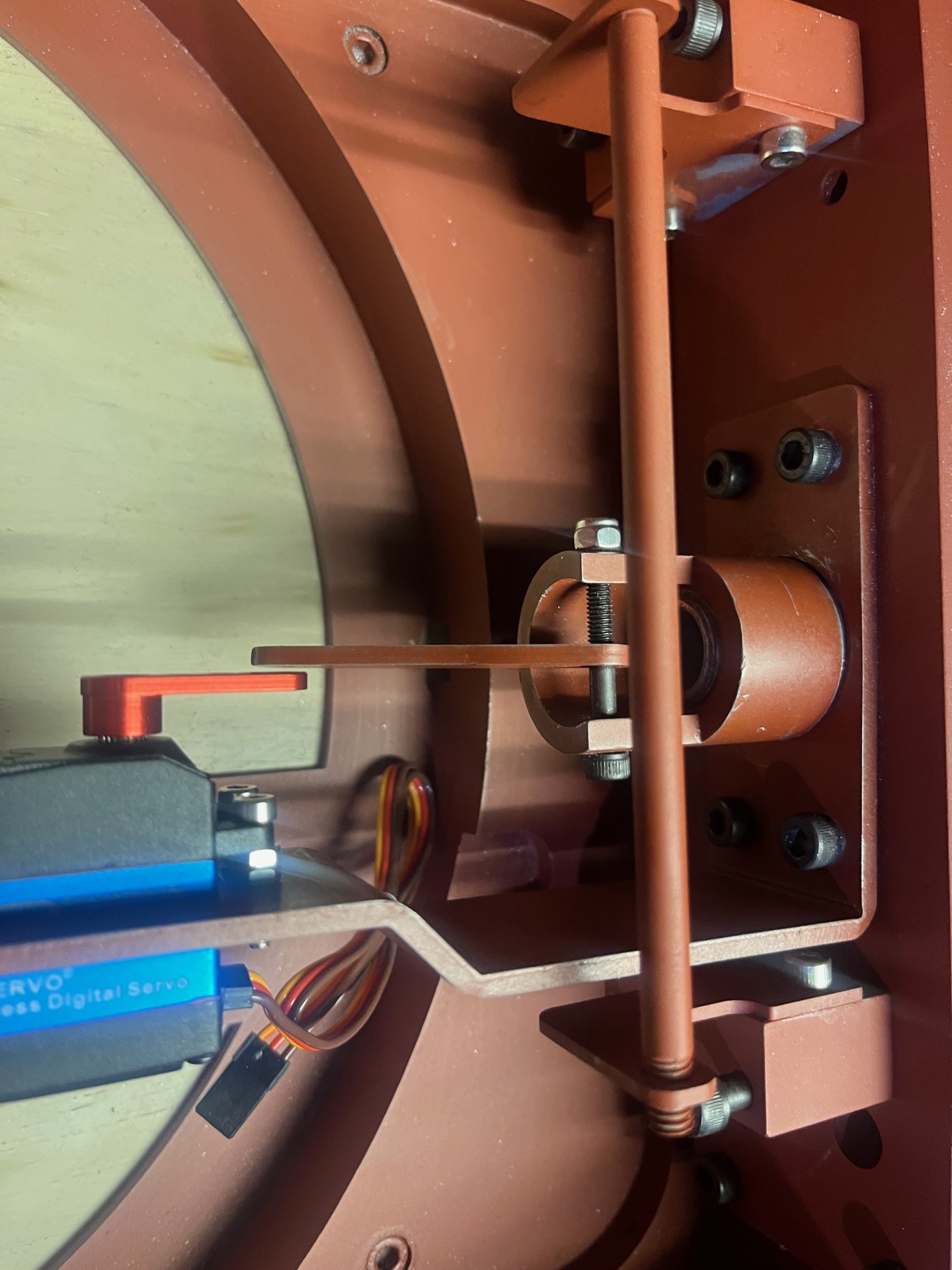

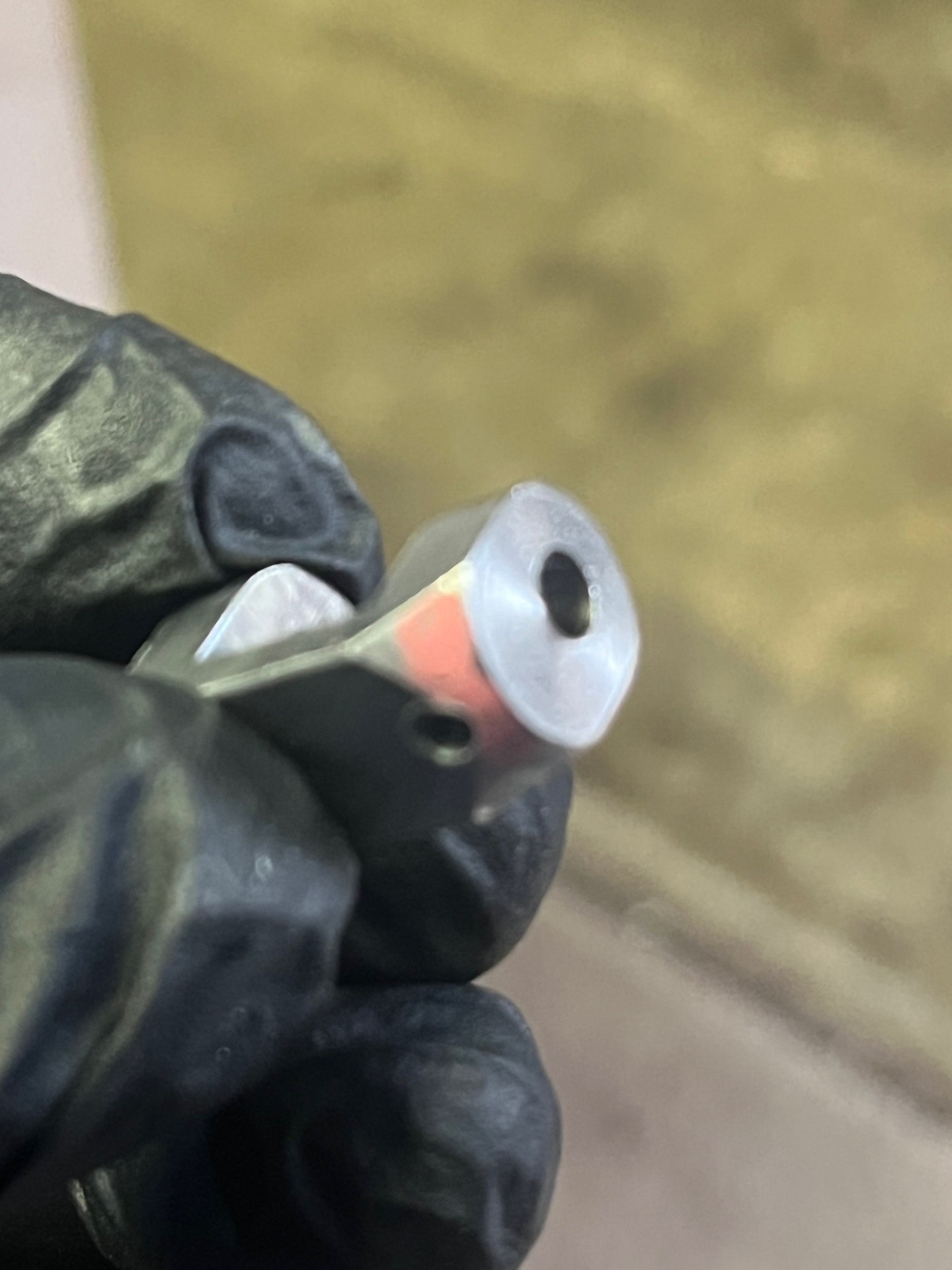

Messing around with option packs

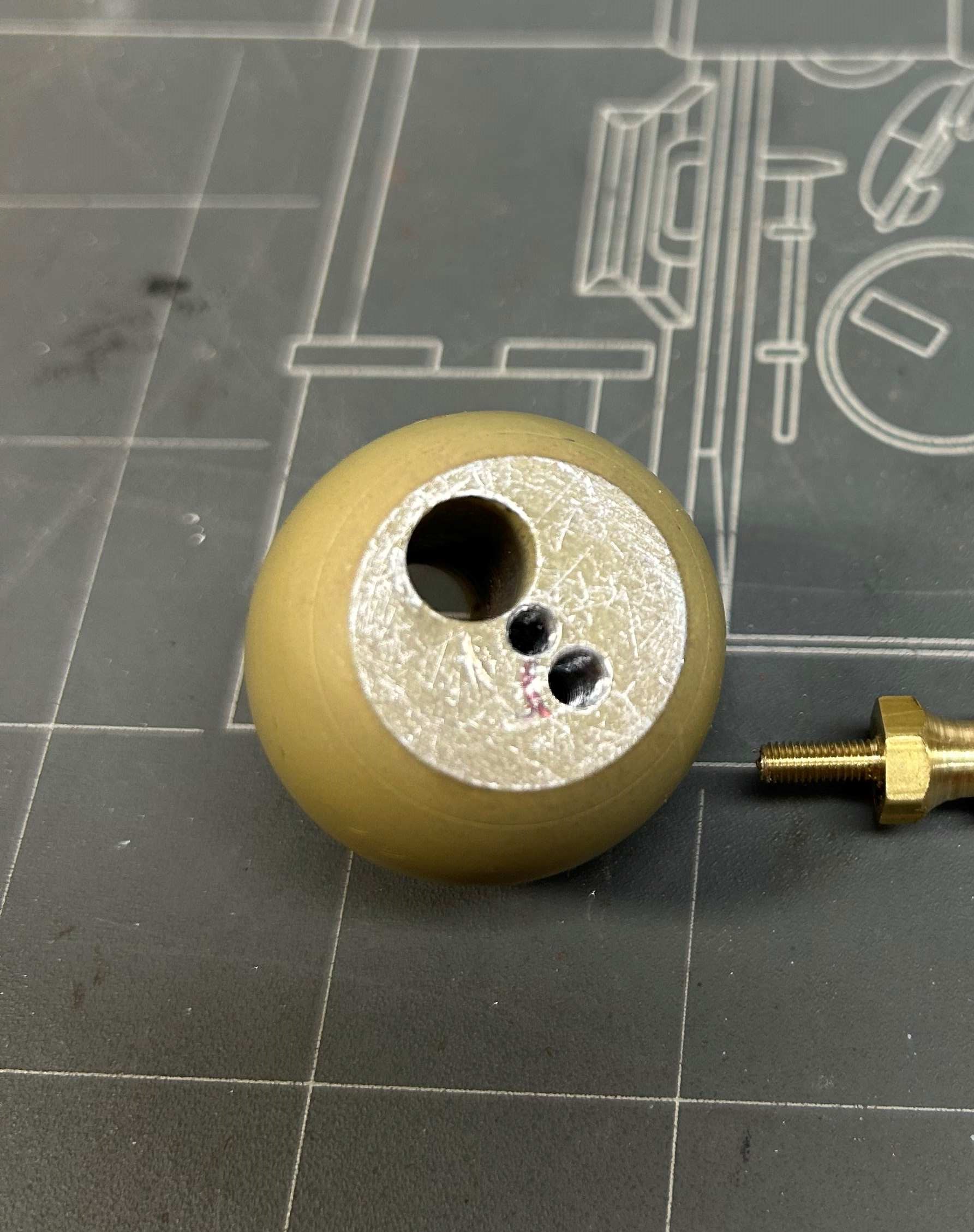

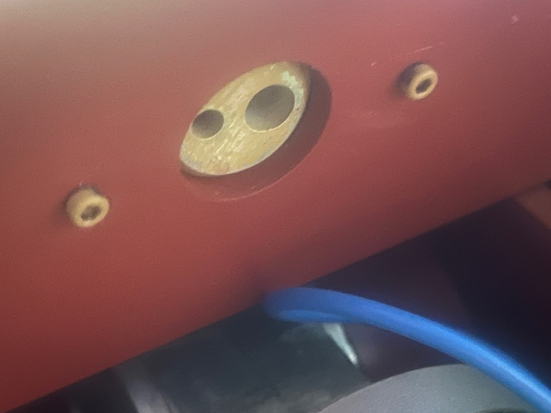

Moving forward, I decided to add the machine gun parts...... yet I am missing something here. The instructions indicate a M3x10 goes into the machine gun ball, but I dont get it.
To get the bush to fit into the barrel I eventually had to get my dremel out and grind off a huge amount of the aluminium. The dust you see here is not even all of it as I had been sanding for 30 minutes previous to this....and had to do more dremeling after. But, I eventually got the bush to go in

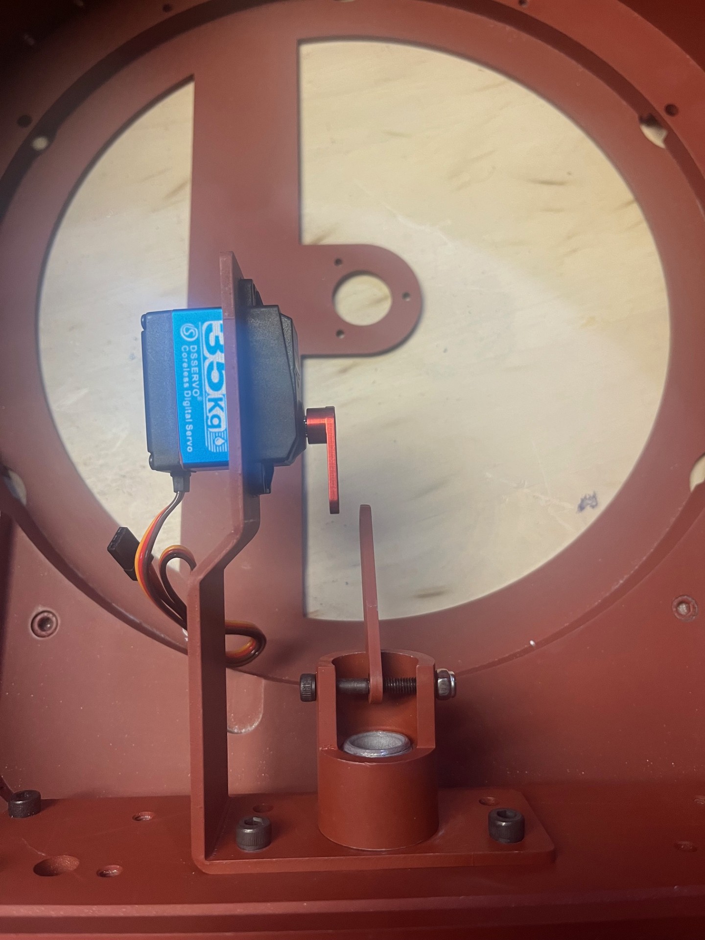

Unfortunately, the bracket holding the recoil servo did not have its bolt holes drilled correctly. The holes were 2-3mm out so I had to drill and file these like nuts just to make the bolts go in.
Before I could get the bracket fully on, I at least wanted to check the alignment, the instructions made it clear that the servo arm should line up with the middle of the barrel for best results. Hmm, its a long way out!
So, I swapped the bolts for longer ones and added a few extra nuts to act as spacers, I was pretty happy with how this turned out
... and yes, I know I got the slip ring on backwards... will fix it tomorrow.
So.... putting the machine gun to one side for now, I move onto the recoil and gun elevation options.To get the bush to fit into the barrel I eventually had to get my dremel out and grind off a huge amount of the aluminium. The dust you see here is not even all of it as I had been sanding for 30 minutes previous to this....and had to do more dremeling after. But, I eventually got the bush to go in
- Posts: 597
- Location: Somerset
- Has liked: 787 times
- Been liked: 1878 times
Hi Neil
Nice to see your Tiger build progressing.
Where the bolt goes through the connection at the rear of the barrel and connects the metal bar from the servo arm I used two bits of brass tube to keep it centred. I found the washers reduced the room for the muzzle flash wiring and kept pulling in down the barrel during recoil. Putting a cone of heat shrink just below the led also helps keep it in place.
Keep up the good work.
Gary
Gary
- Paul McMartin
- Posts: 33
- Joined: Thu Dec 14, 2023 10:02 am
- Location: Queensland, Australia
- Has liked: 499 times
- Been liked: 170 times
Hi Neil
With the machine gun ball, at first I tapped and put a bolt in the vision hole, but it limited the range one way.
So I drilled & tapped a hole in the centre.
Hope this helps.
Cheers Paul
Hope this helps.
Cheers Paul
Thanks for the solid advice guys!
I wonder all the time if I am doing something wrong, or just not understanding something......you have reassured me
Now to get a tap & die set and maybe a mini drill press
