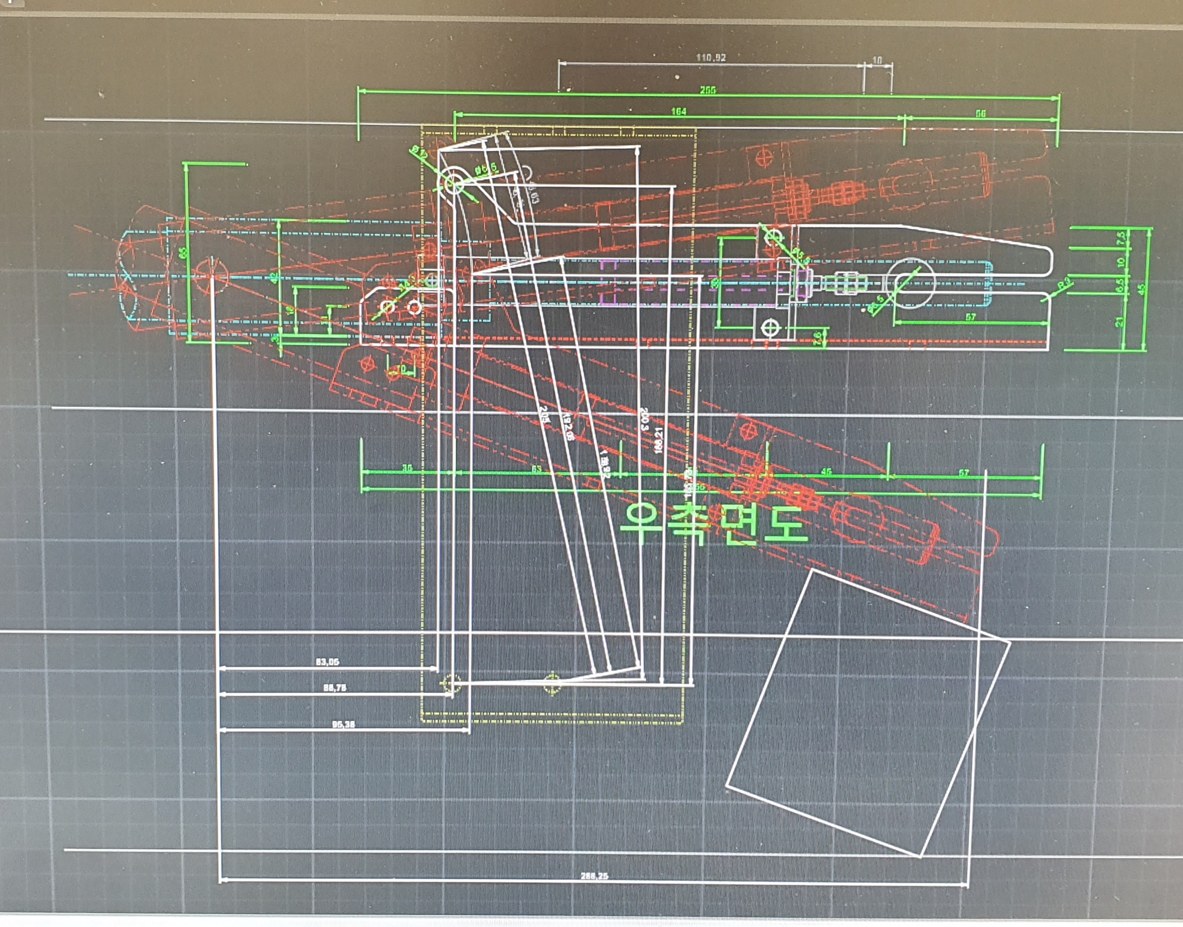

The main gun and turret stability I tried were both conceptually completed and the foundry mechanical review was finished, and all the materials for the dispersion and control of the torque were completed.

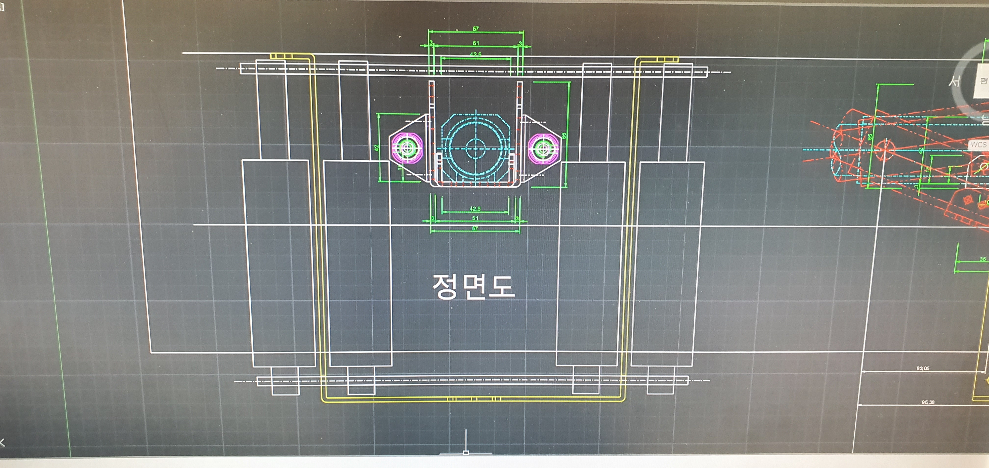

First of all, I'll explain the personalisation direction of the recoil.
Spring-type pneumatic cylinder, 24V-solenoid valve, two-way BEC to use servo signals, 750CC air tank and fittings.
I use a springair cylinder to make sure that the main gun's quick retreat is pneumatic, and the slow recovery is springing, and these instruments are common on the market.
The advantage of this approach is that all LED, sound and motion signals provided by Armortek are used without conversion.
The smoke effect of the main gun can be expected by using the air that is then purged through the small dry-ice chamber as a chimney.
For example, both the bore size of the cylinder and the number of strokes required have been designed.
However, the tension of the spring to handle the mass of the main gun of more than 2.2 kg needs to be checked.
I have already been wondering about sector production and will arrive at me tomorrow.
Perhaps I expect it to be validated in a few days.
Considering this behavior, the frame inside the main gun is from yesterday.
But I modified the connection point of the linear actuator to stabilize the main gun in the frame last night.
Frames are free from interference in all movements.
Nevertheless, Battery intends to switch to a smaller, more speed-sensitive one you talked about at another forum.

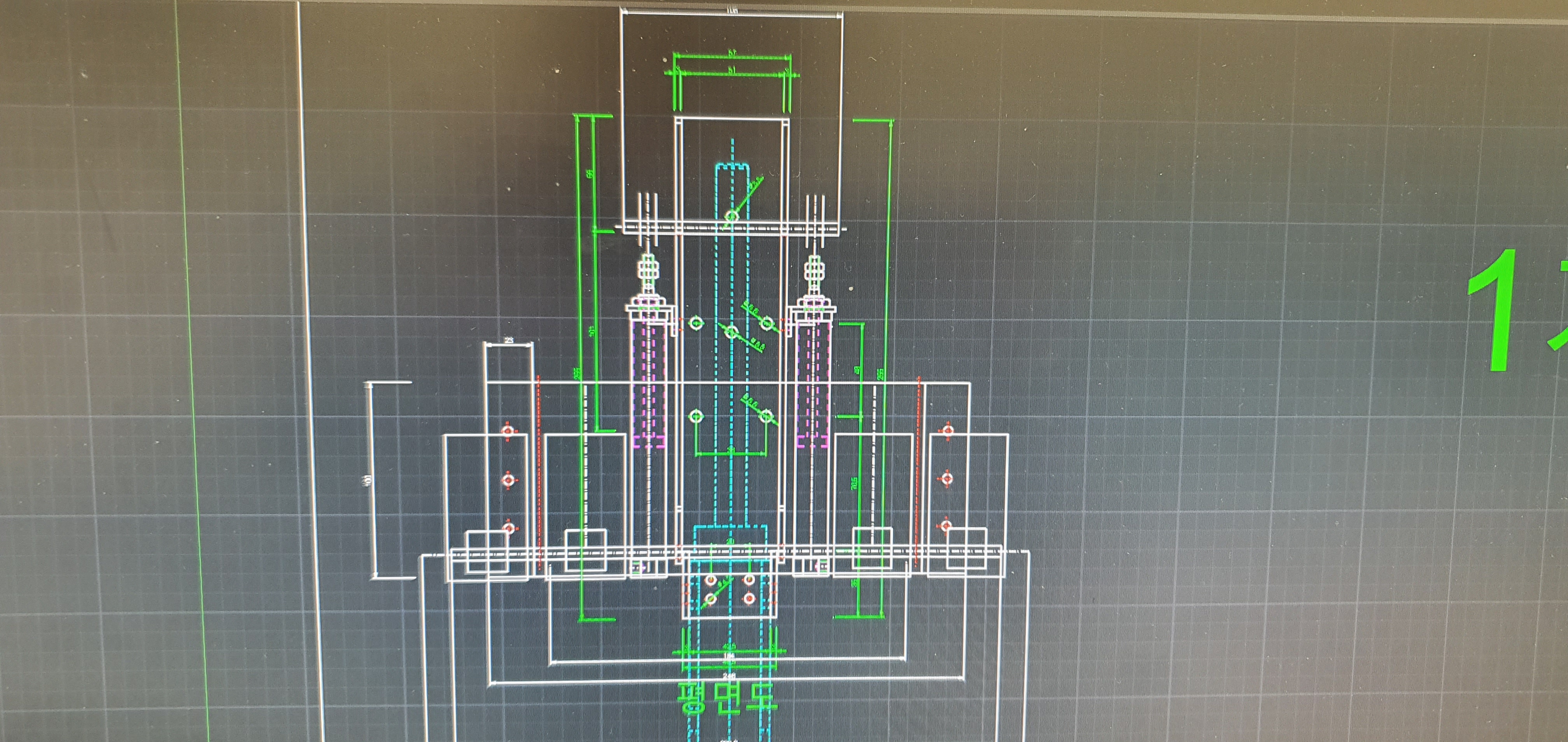

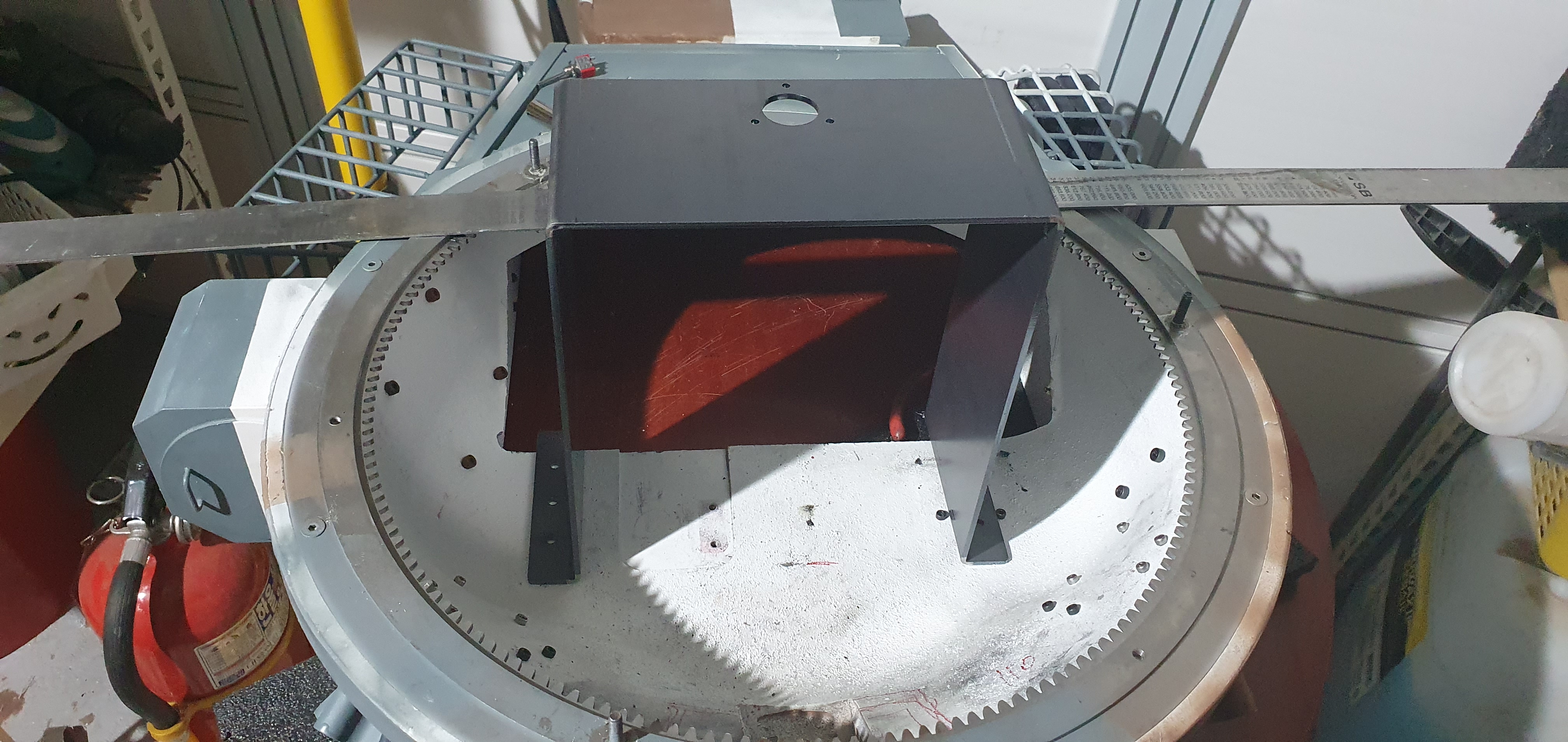

Personalisation for horizontal stabilization of the turret is described.
I thought that it might be a burden to hold the rebound torque when turning a large turret, so I prepared a motor, gear, and fixed frame by dividing one motor and one gear into three and waiting for the motor to arrive.
I'll share this with you if there's no problem after the test.
The vertical stability of the main gun is waiting for the material, with the power, operating speed and operating length of the linear actuator to control the main gun, and the location and panel of the new sliding.
The connection point of the linear actuator is also a very important point.
I will attach the signal to the off-the-shelf Gyro between the motor driver of Armortek Motion Controller B and the receiver to try to control it and then edit Arduino if there.
It looks complicated, but it's too simple to go over P&ID.

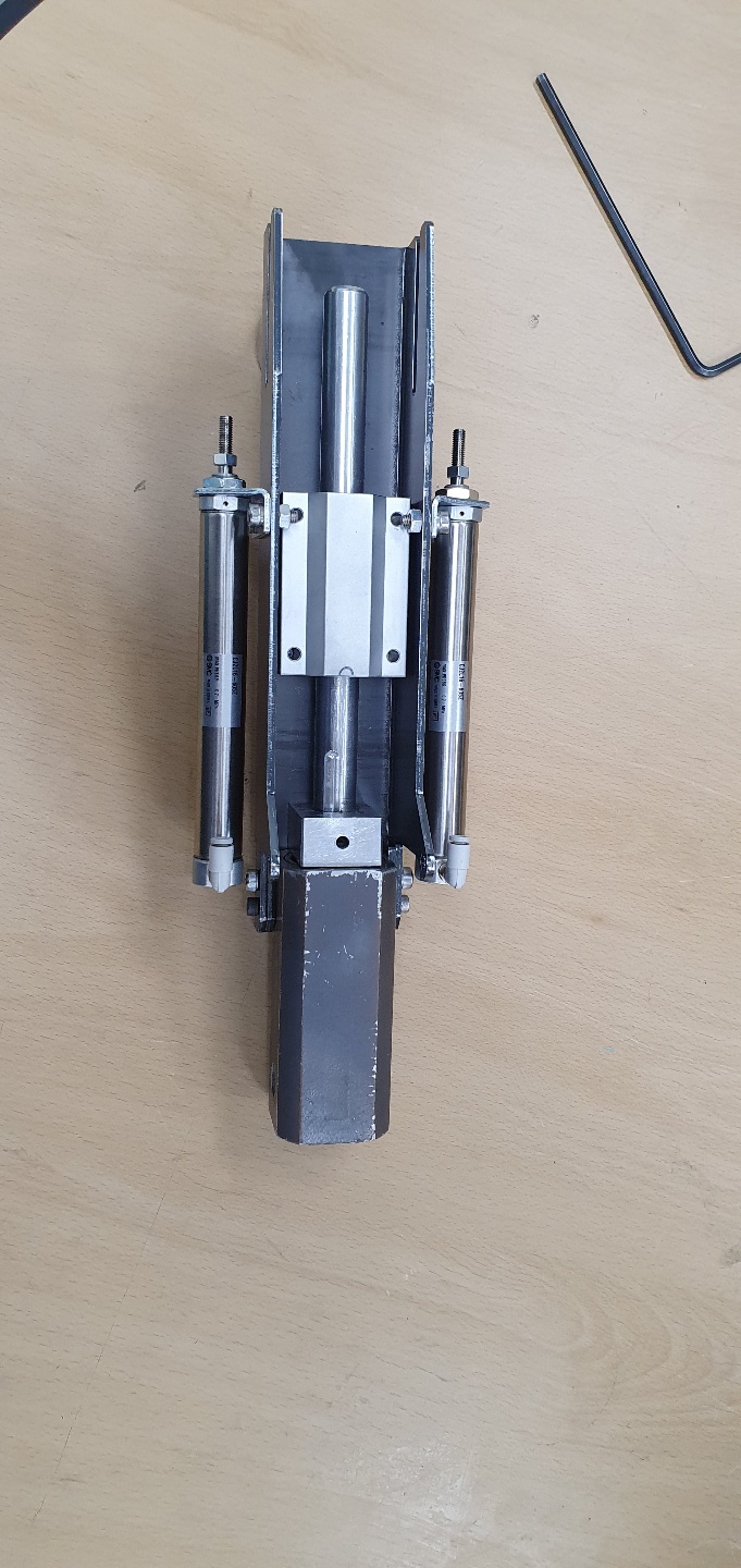

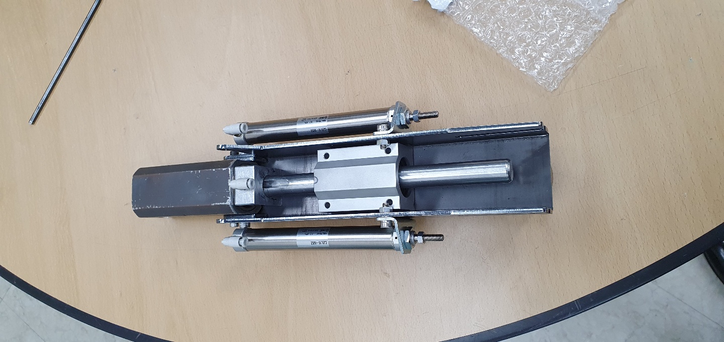

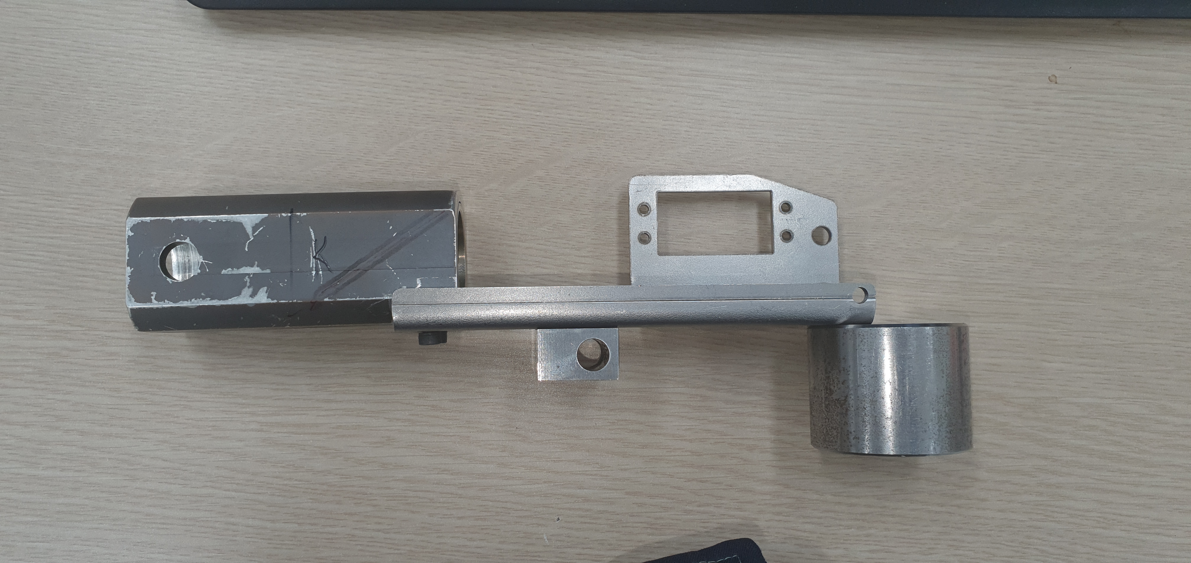

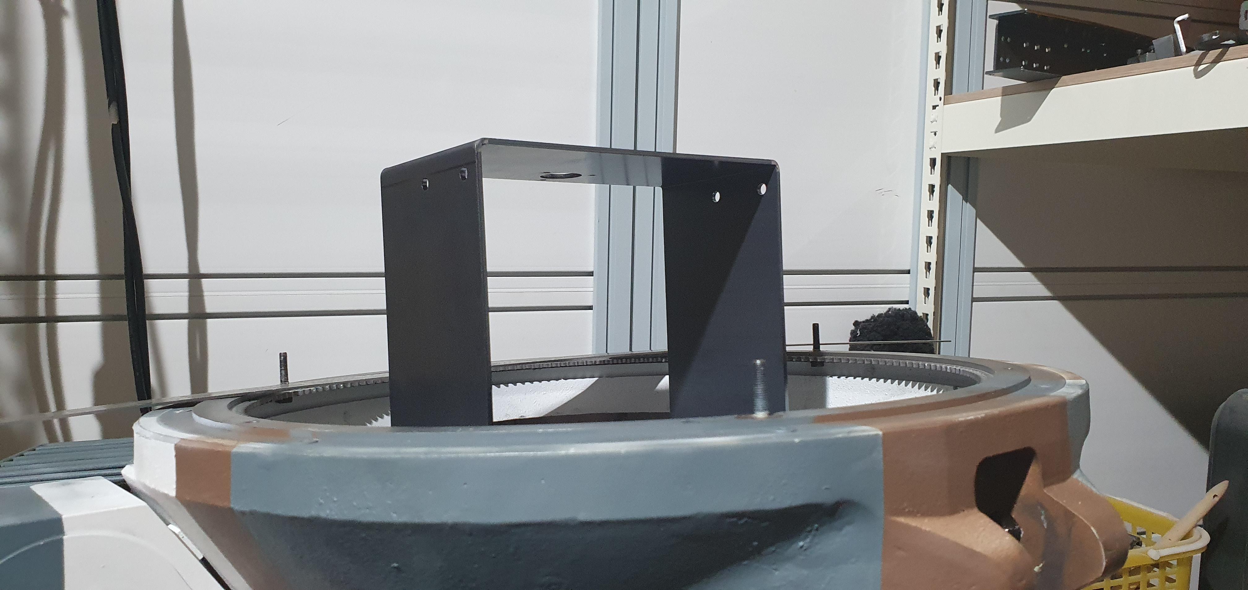

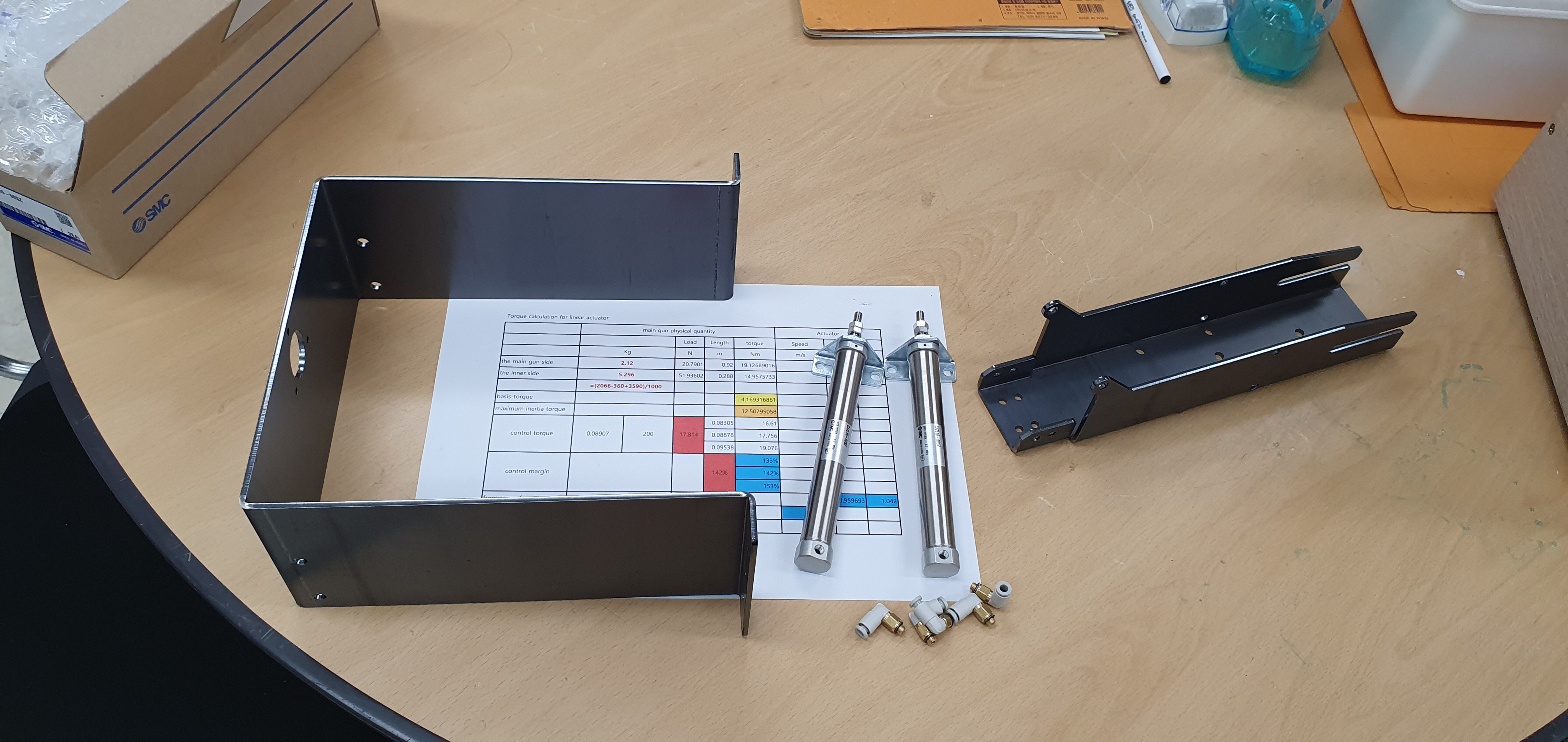

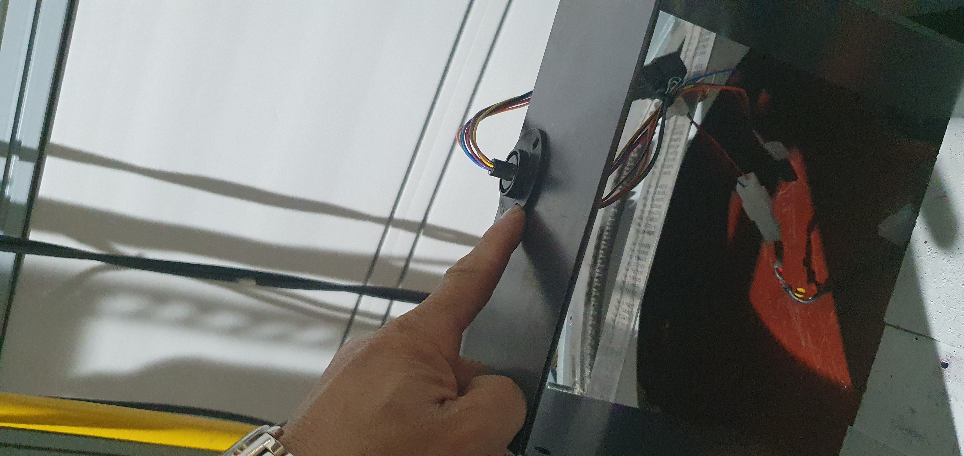

Based on the design, I built a recoil base, a large counterweight, a cylinder and a hanger-type electric actuator base, and a slip ring hole was machined on the actuator base. :mrgreen:

Re: Chieftain kit arrival
Post by Chang »
Hi Youngjae,
One question. What's the reason to instal a longer/larger counterweight? Isn't it going to reduce the gun elevation angle?
Regards,
Lerh Chang
Youngjae Bae
Posts: 277
Location: South Korea
Has liked: 761 times
Been liked: 613 times
Post by Youngjae Bae »
Chang wrote:
Fri Feb 14, 2020 7:42 am
Hi Youngjae,
Regards,
Lerh Chang
You can understand the principles of seesaw.
Reduce the moment difference between the main gun and the inner end to create a natural equilibrium as much-needed.
Of course, you have to think about interference when the mass grows, but it takes into account the way you create the maximum angle of motion on the cross section and the way you make the difference on the floor.
I have also applied several different methods of dividing the number of instruments in the actuators, considering overcoming the inertia as the mass increases.
This only takes into account the functions shown.

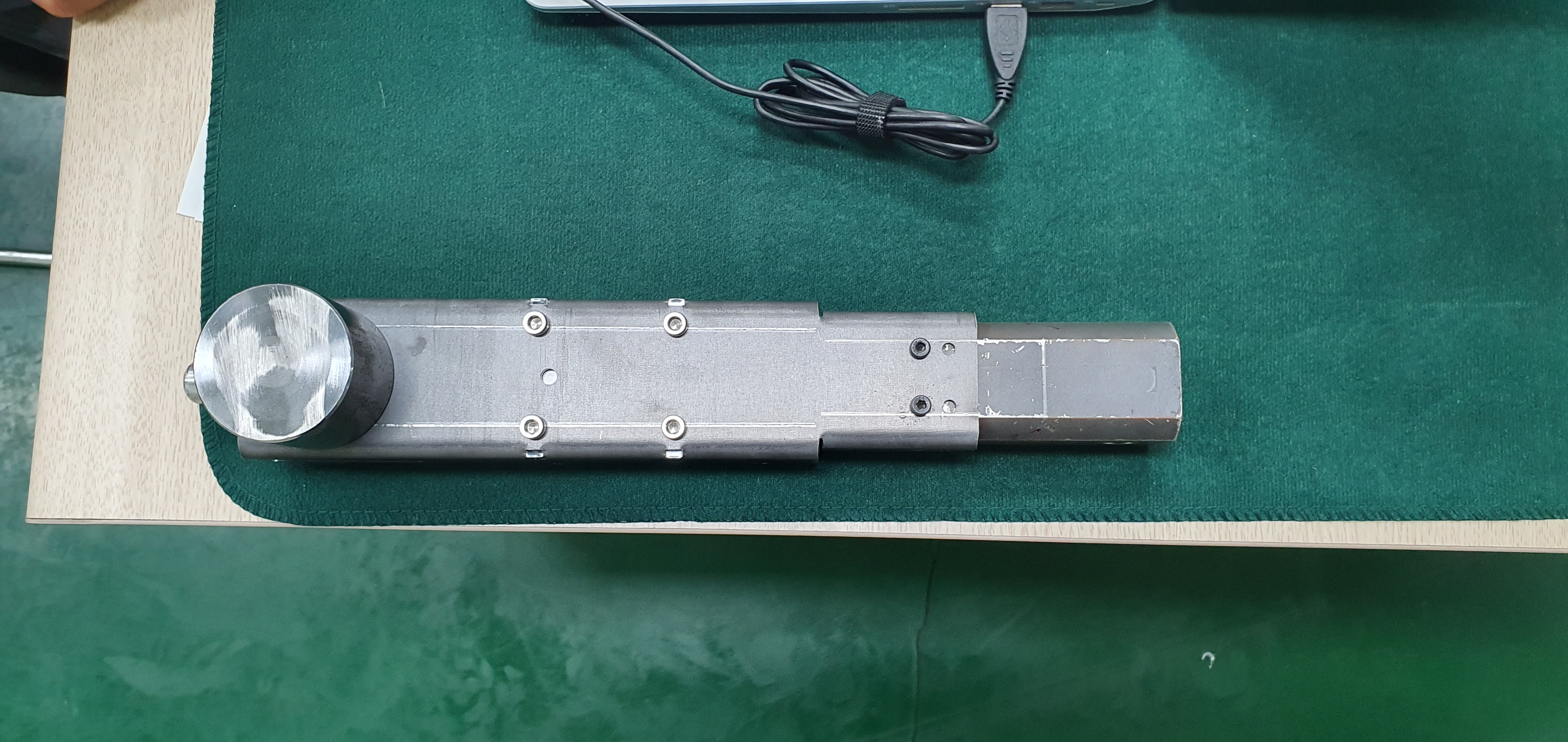

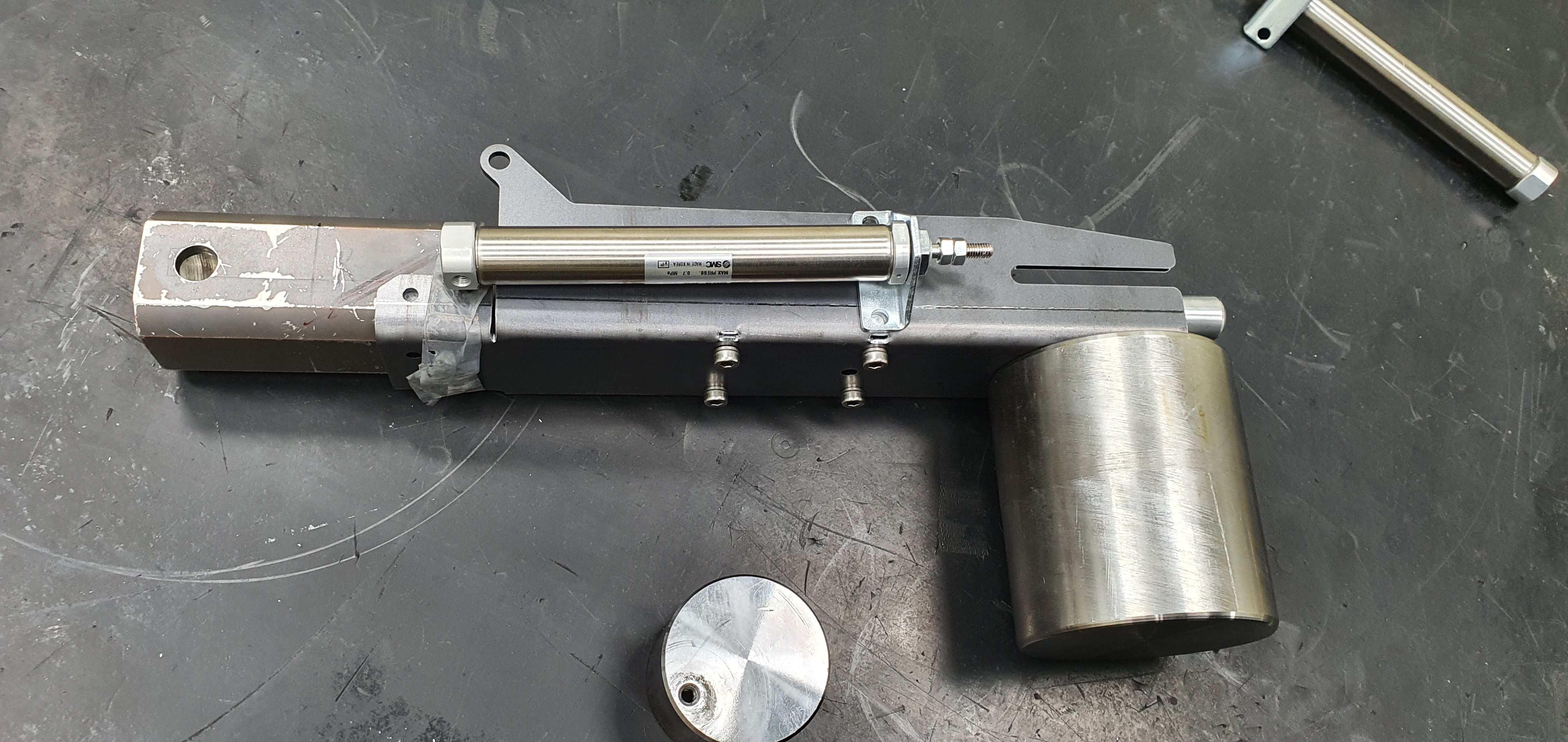

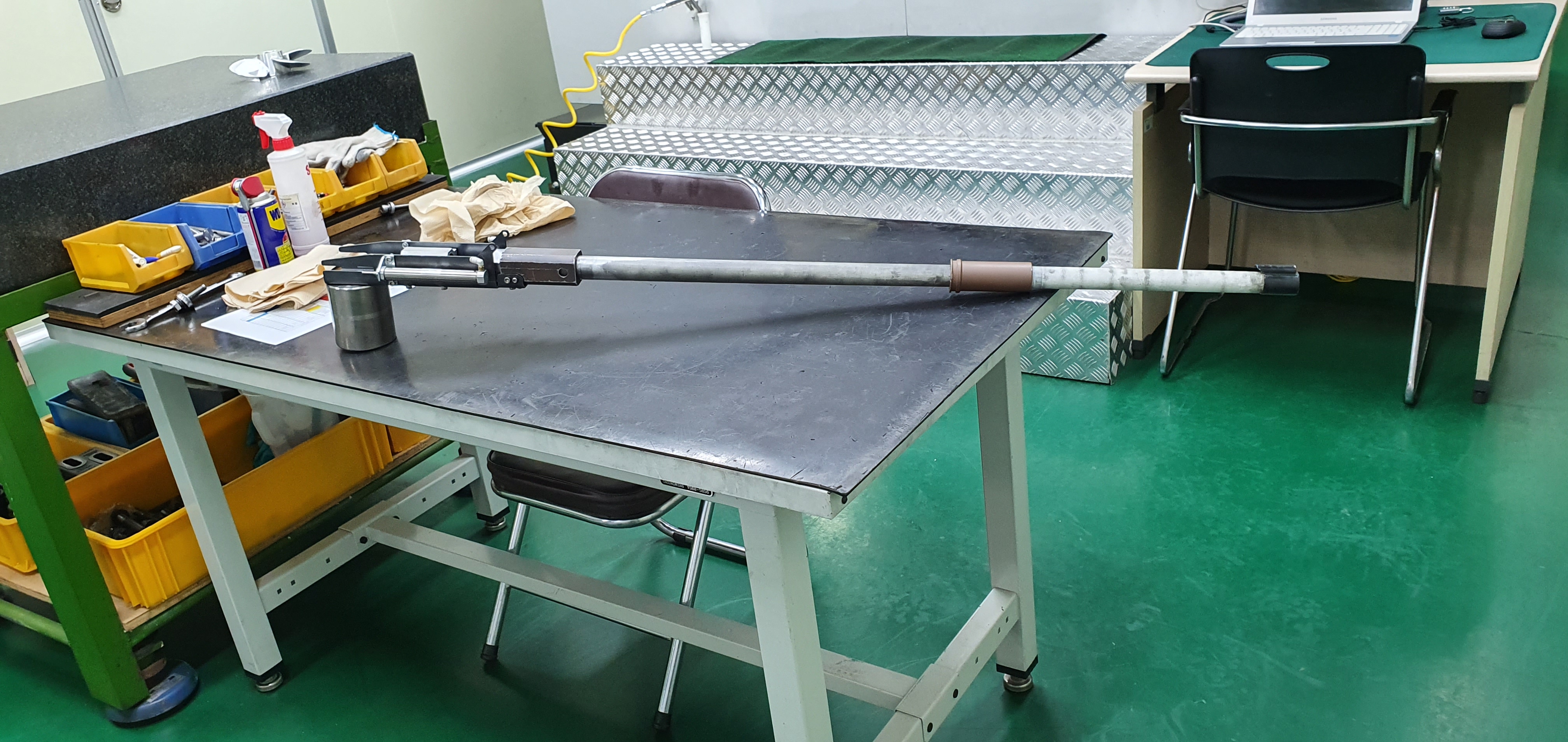

Check before installing hanger type actuator base

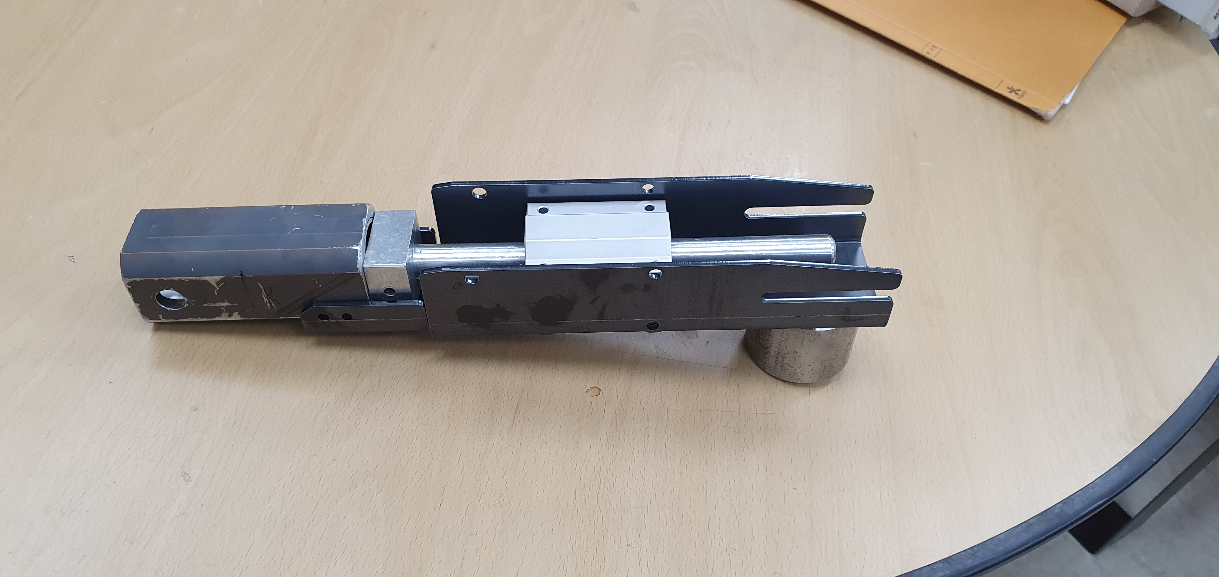

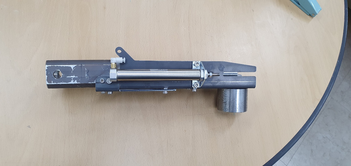

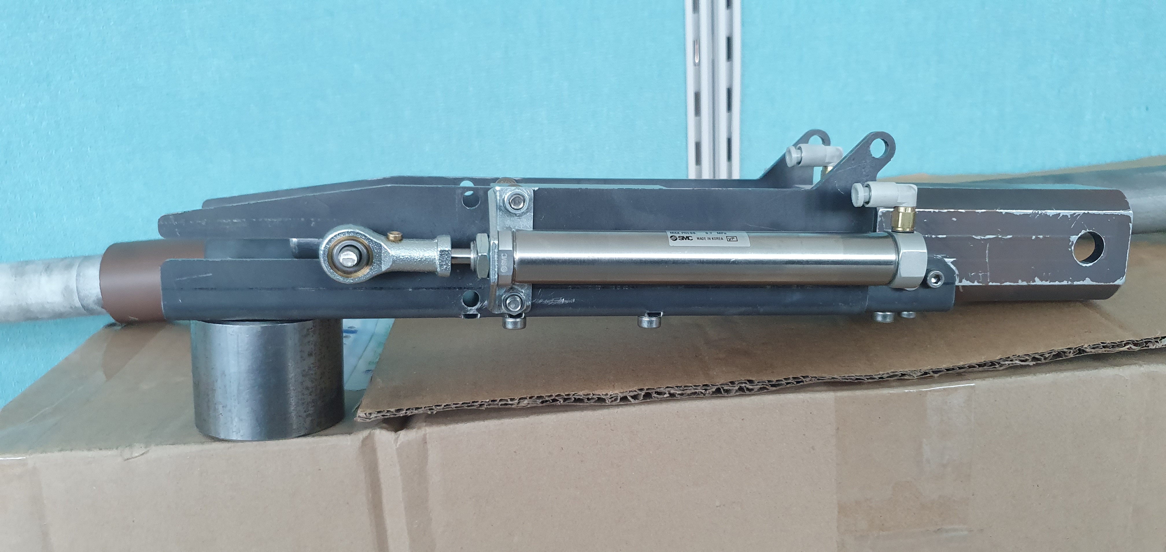

I checked the tension of the main gun return spring, made sure there was sufficient force and finished some work.

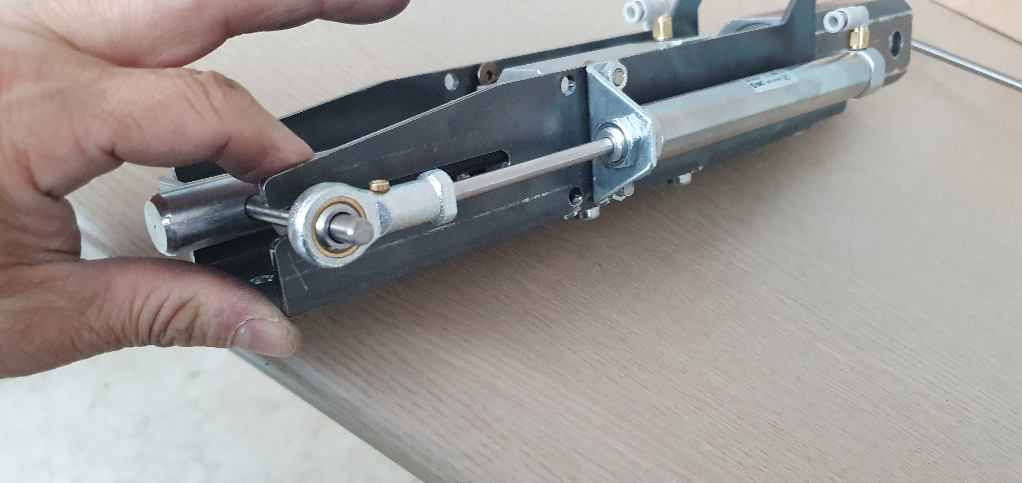

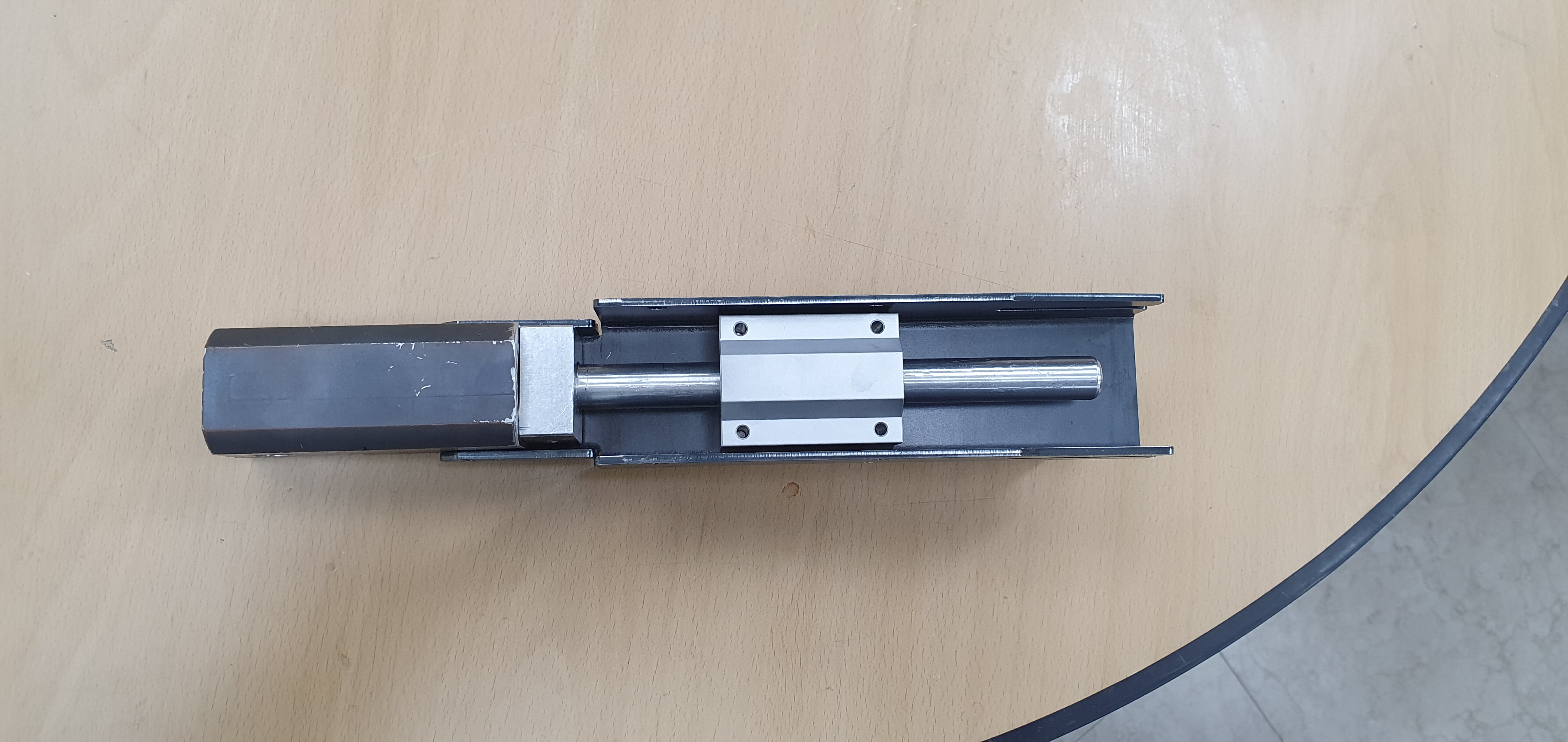

Today, I connected main gun and did a motion test about the recoil.
The hand motion was as expected and next I will connect the air system.
And I am going to test it in a reduced weight inside. :D

The recoils of chieftain are working as I intended I'm only doing a motion test with my hands, but it's very smooth than the original, because the surrounding parts to connect the pneumatic are not ready yet.
The recoil renovation is being carried out in conjunction with the main Gun stabiliser.
Although progress is a bit slow due to the surrounding situation, the pleasure of each move is also great as expected.:mrgreen:
