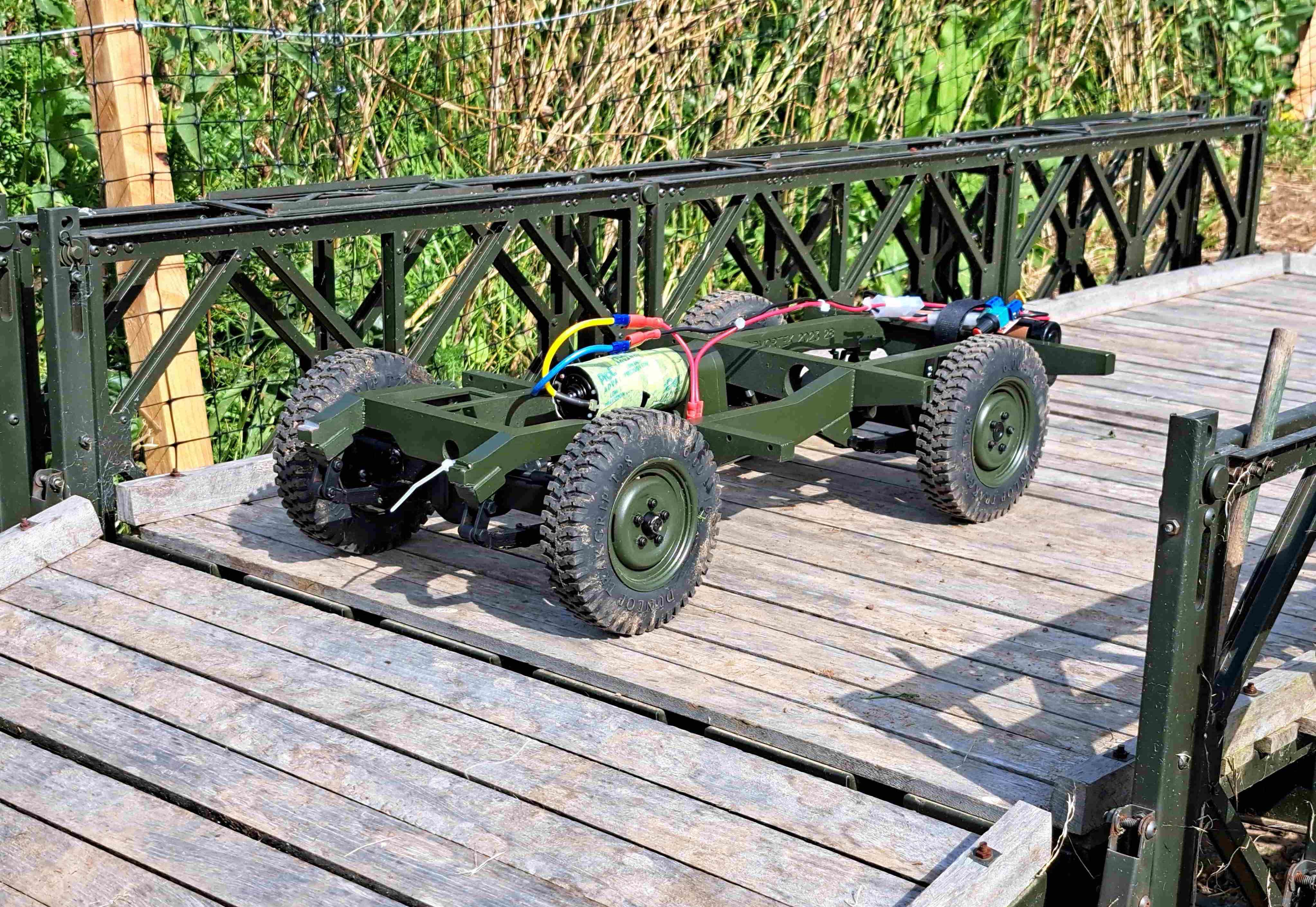

Afternoon all.
Couldn't resist it.
Only running on a 7.2V lash up, but seems to does the run on the grass OK, struggled a bit on the soft earth of the tank track. We hope a video will be forthcoming. So here a couple of photos for now:-
A word of warning though, even at 7.2v and voltage regulate turn up too high it could out run you, be aware
I am lucky I have a lad to run after it
Charles

Did you adjust the Diffs? i found them really loose?Charles A Stewart wrote: ↑Fri Sep 08, 2023 2:01 pmAfternoon all.

Hi Donald
PM'd
Charles

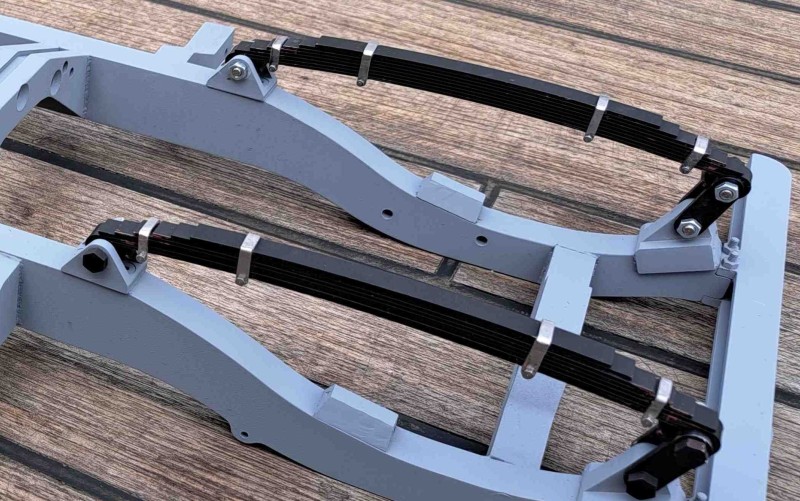

Good afternoon everyone.
I had a pm asking me about my wheel studs and the brackets on the leaf springs.
Springs first then. The brackets were first bend, in vice and hammer over, second bend, over a former (about 7mm, I used a 4mm & a 3mm) clamped in vice and hammer over.
2.5mm sections were then cut off(see earlier post), tidied up and drilled to suit.
Studs are simply m2.5 bolts loctited(638) into the hubs, cut the heads off, which could be used for something sometime
maybe.
Fit nuts, trim and touch up paint work.
Hope that answers any queries, take care
Charles

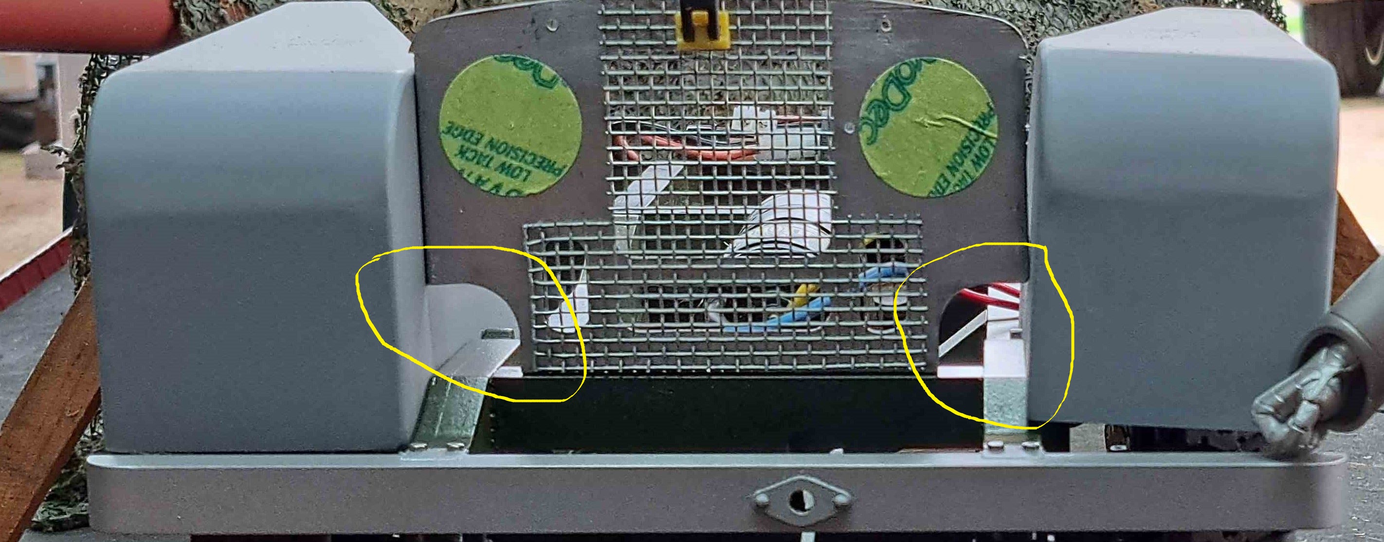

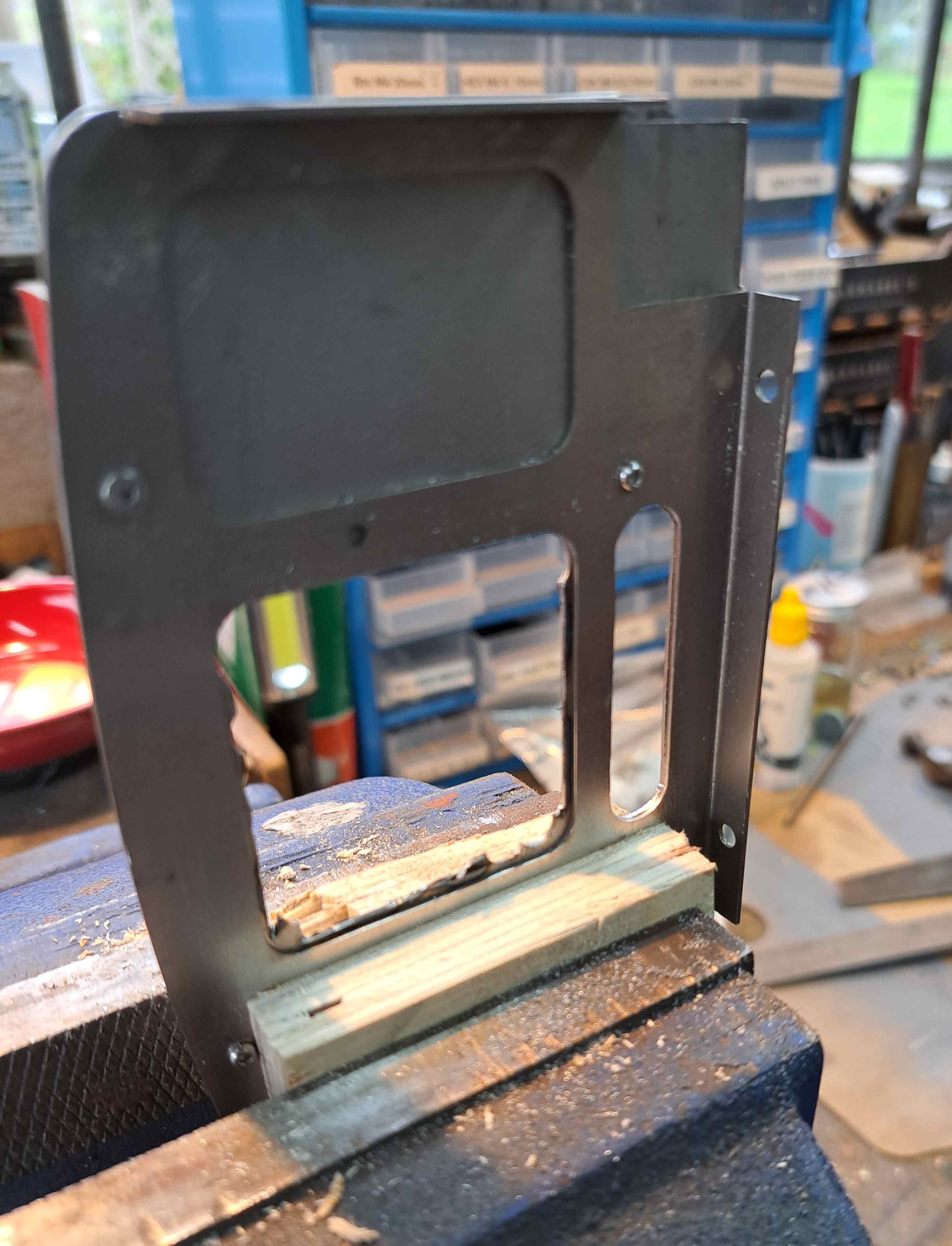

Evening all.
Thought I would get my panel bashing head on, ahead of some stuff I would like to do on the Chieftain. Not a lot needs to be said, you can see where I am going with this, enjoy.
That's all for now, take care. Oh, BTW one reason for this mod was:-
Enjoy the weekend.
Charles
