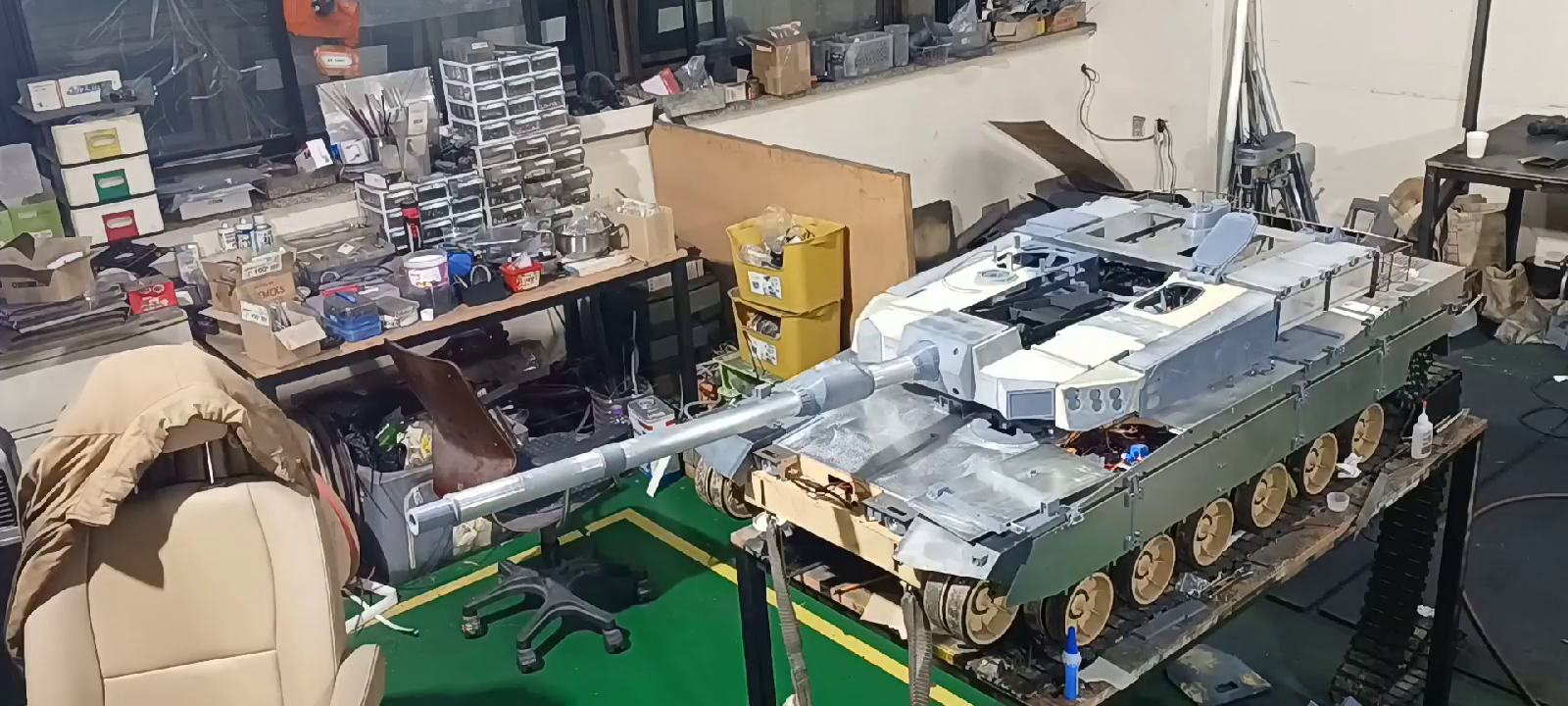

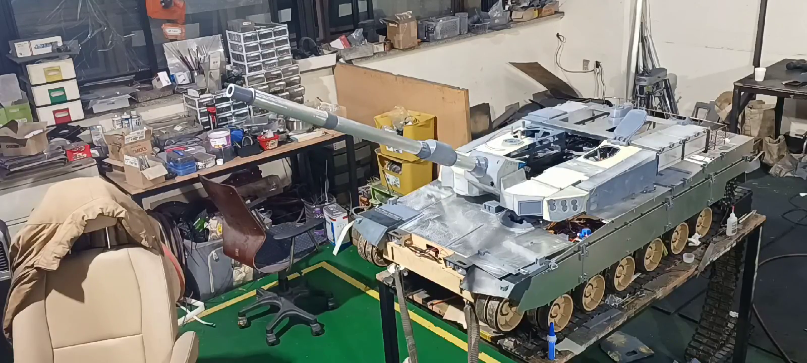

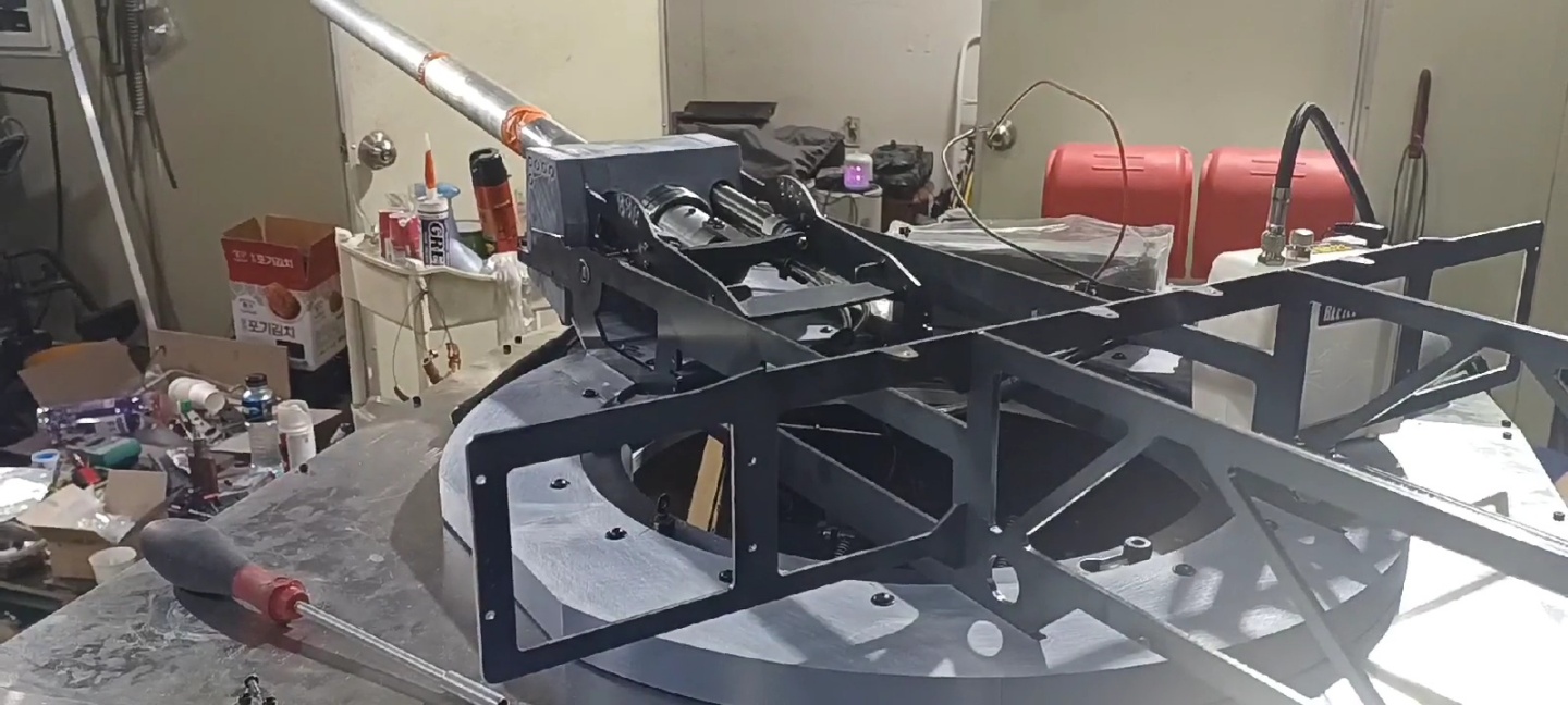

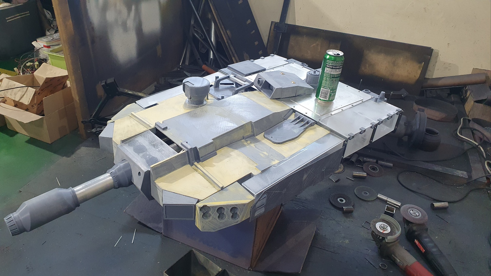

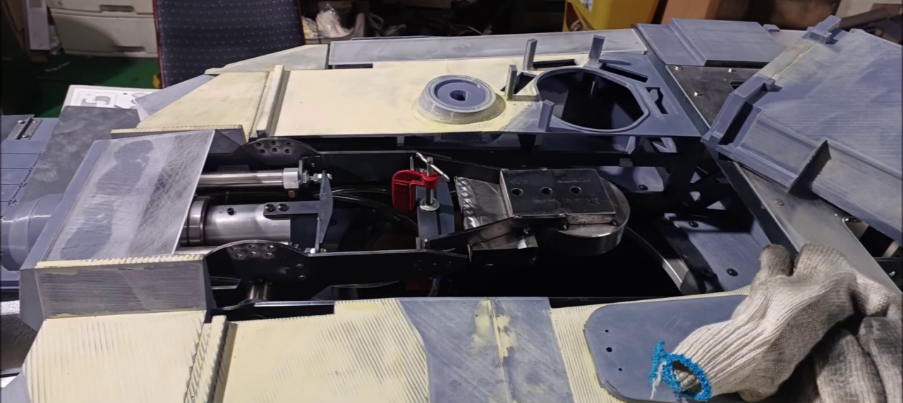

The turret's frame was constructed from the prepared K2 tank's turret structural materials, and the main gun was applied with pneumatic recoil.
The work video will be edited and shared on YouTube soon.

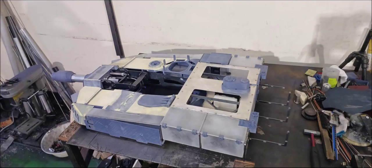

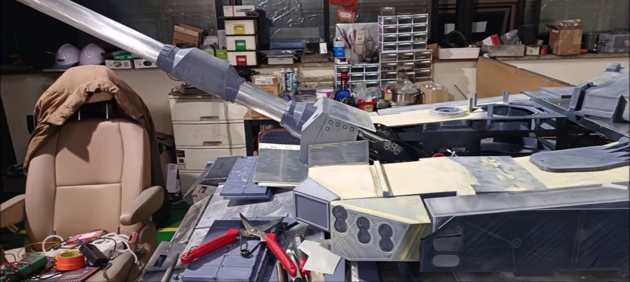

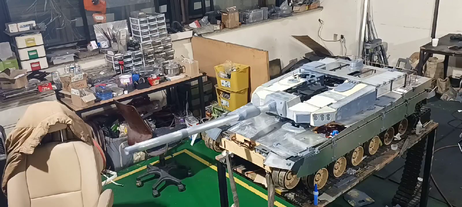

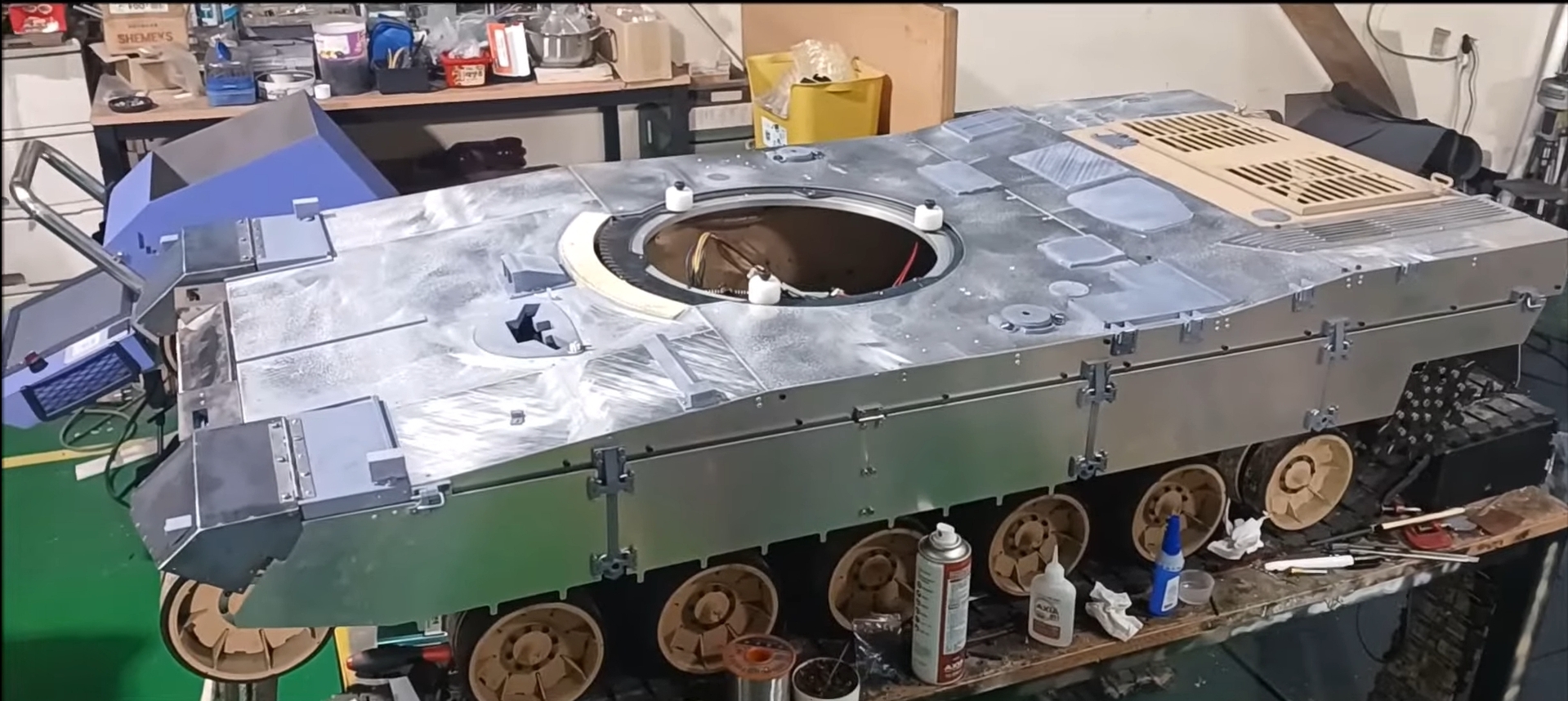

The shape of the turret of the K2 tank has been completed.
It seems to be completed by wiring, working on details and painting the wires.

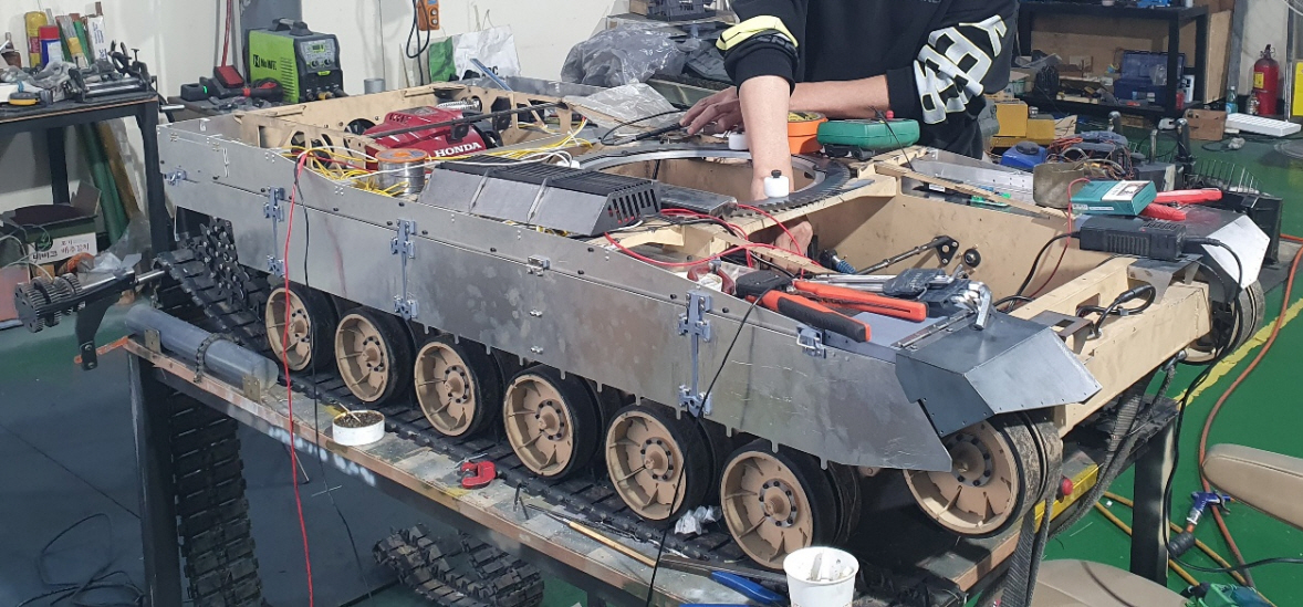

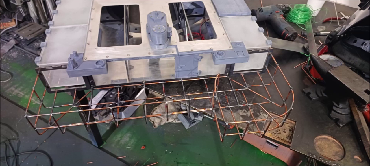

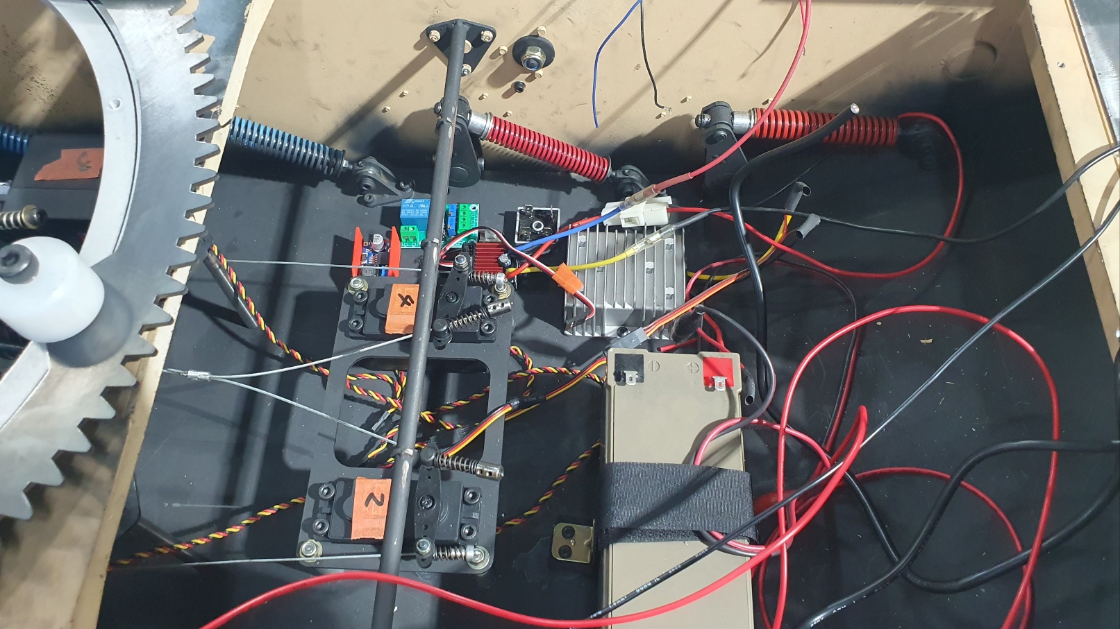

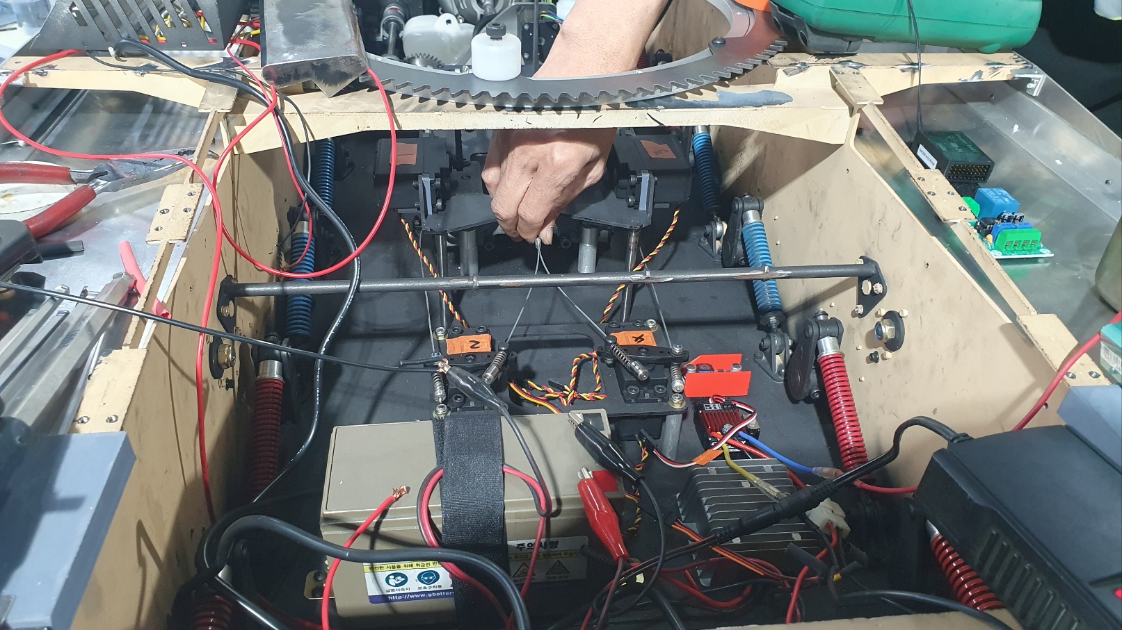

Electrical wiring is being carried out to drive the K2 tank using engine power and to use a generator using a brushless motor.
This K2 production work will be completed by November 20th.
Youngjae

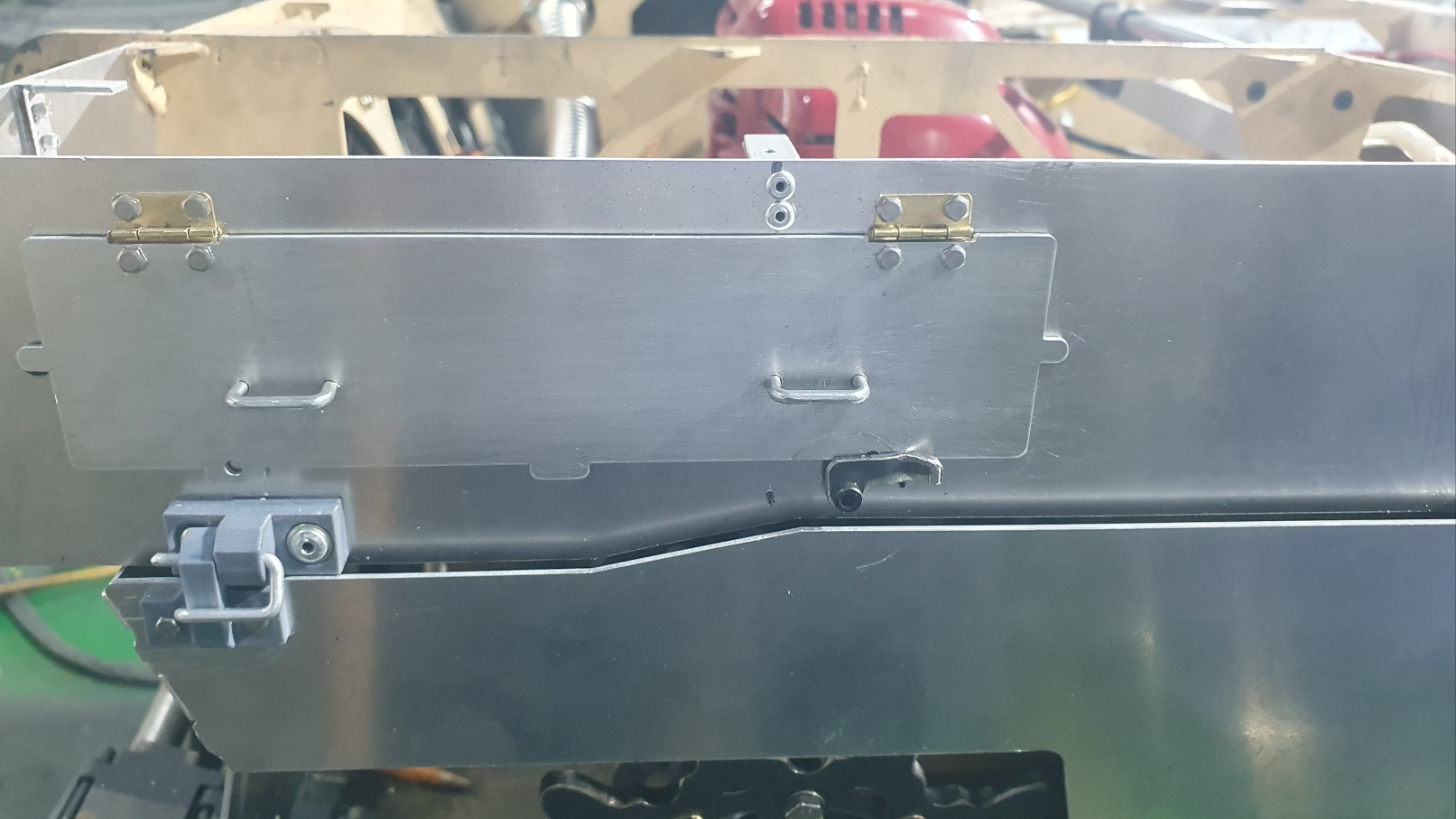

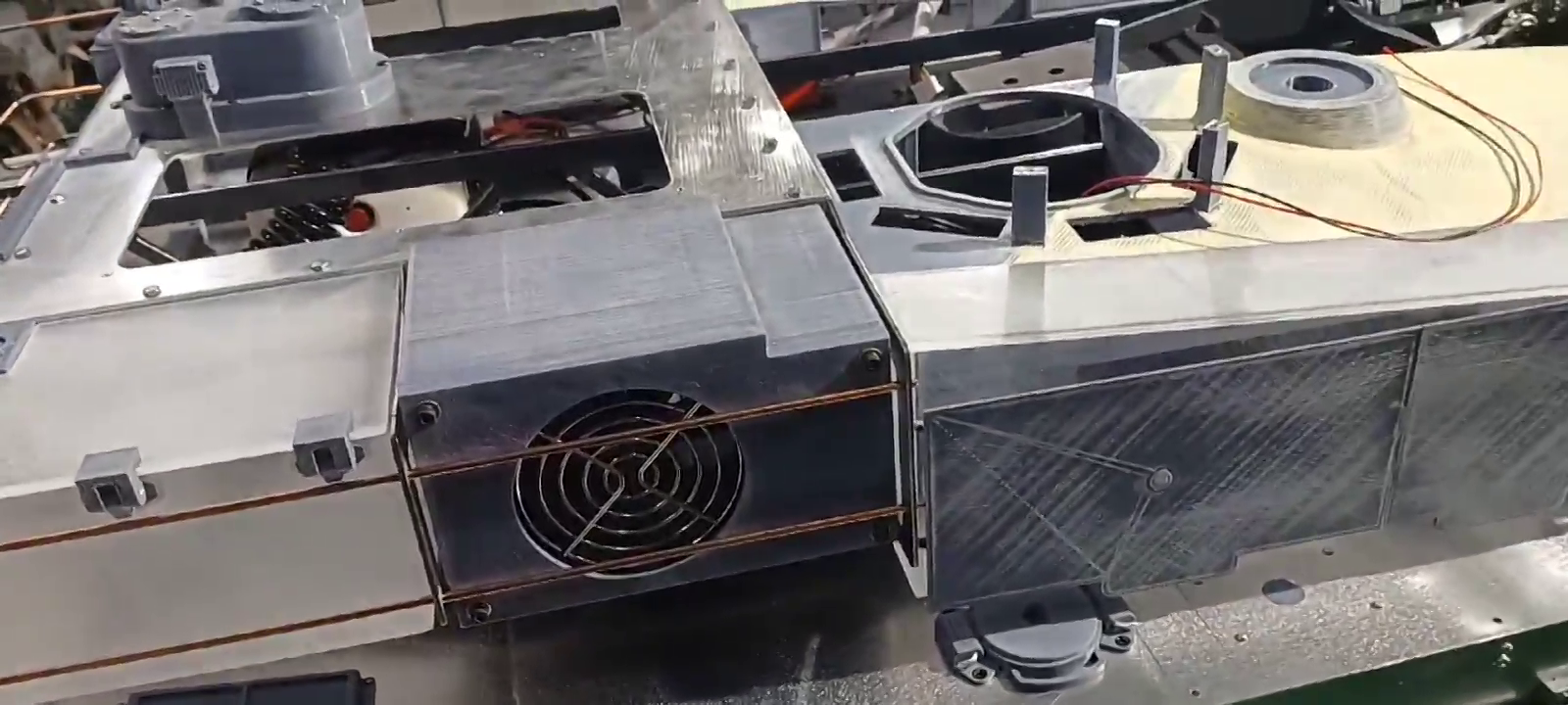

Side skirt support work

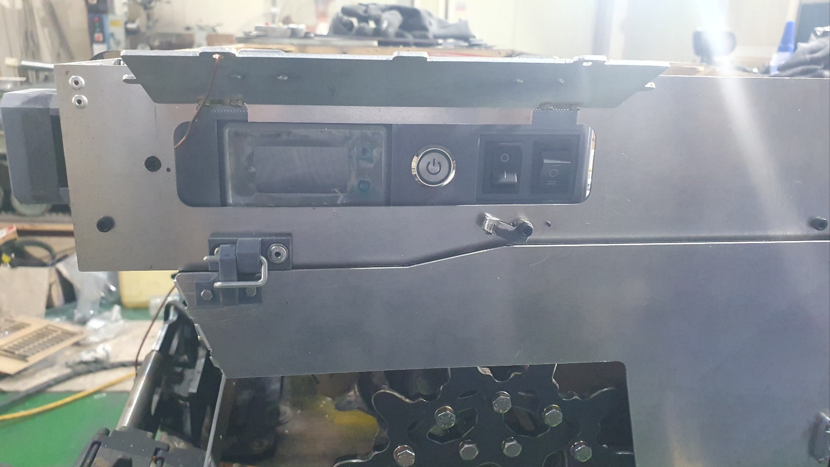

Charging system and electronic component arrangement
Working with the emergency manual charging connector for emergency use
Installation of a high-capacity gasoline tank
Engine exhaust muffler
Fans for emission of engine Heat
Brushless Motor Generators
Clean up for electrical contacts
Conducting wire operations
Turrets compared to 500CC cans of beer

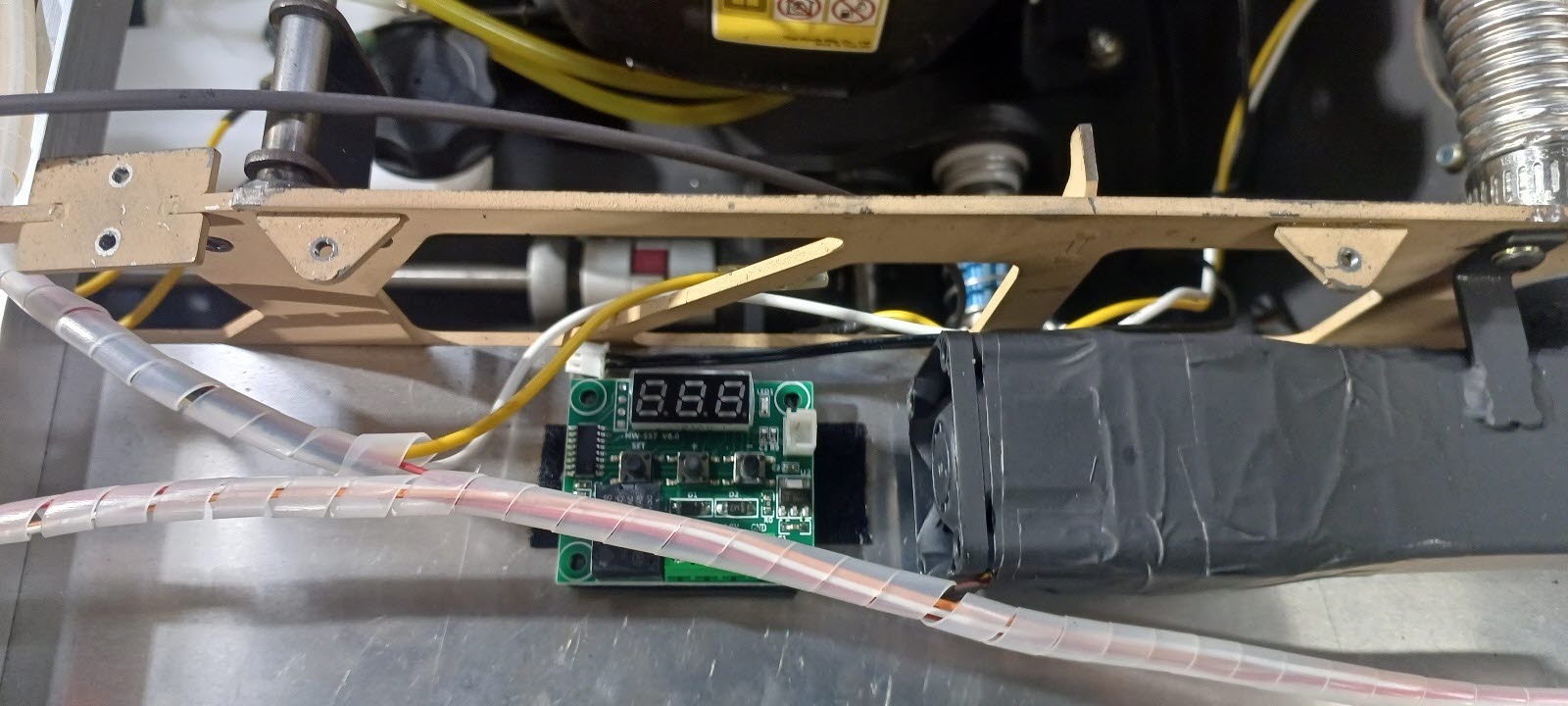

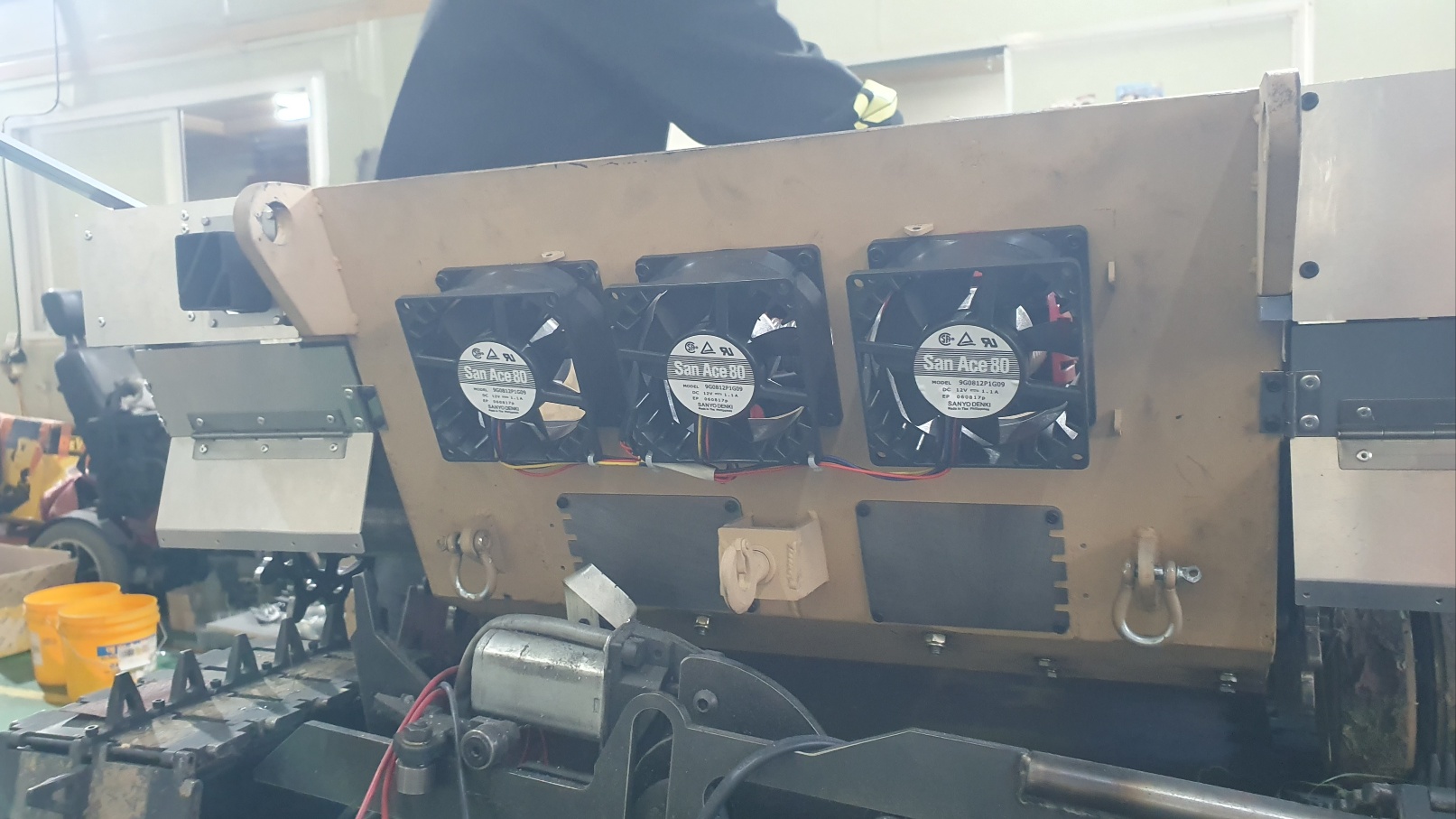

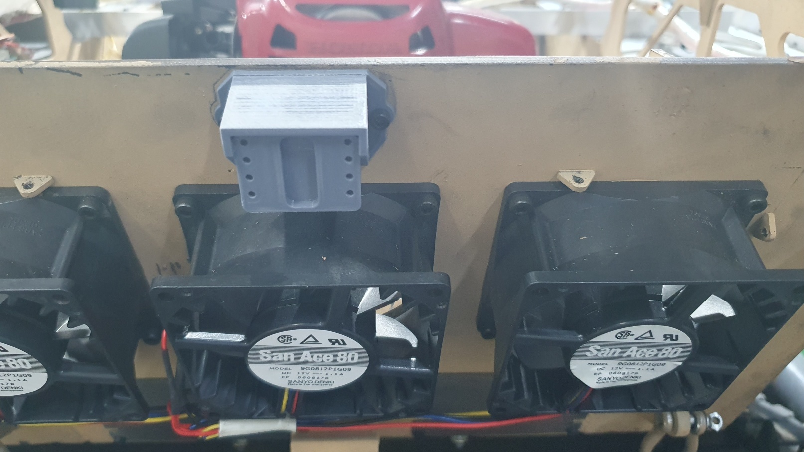

In this K2 tank, two of the three heat exhaust fans at the back of the tank can be proportionally controlled by engine room temperature in order to maximize the electric energy of the generator using a brushless motor linked to the engine shaft.
When the engine is started, one out of three is always operated, and when the engine room temperature exceeds 60 degrees Celsius, fan 2 and fan 3 are operated sequentially.
If it goes below 60 degrees, the fan stops and the excess energy is stored in the battery.

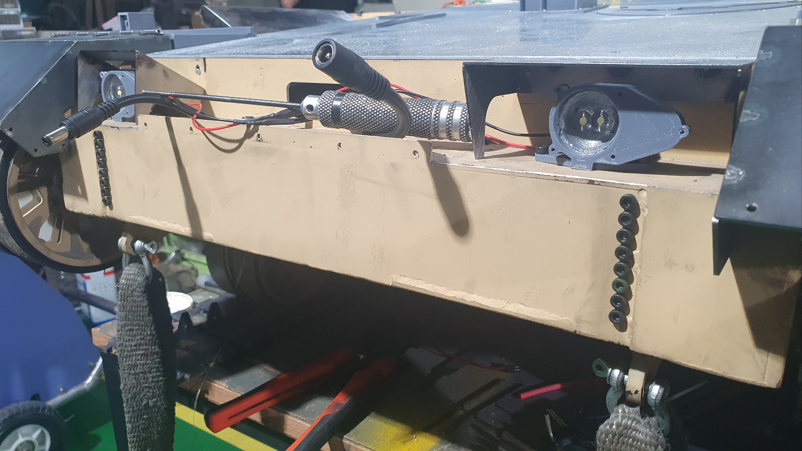

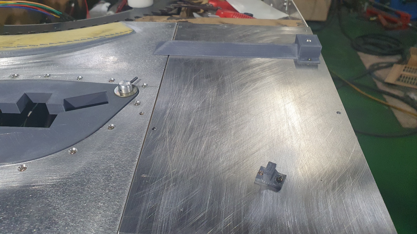

The K2 tank is being worked on in detail by division.
Headlight connections, left and right turn signals, etc
Left taillights and exhaust muffler
Right taillights
Right taillights
Dummy rear camera
Dummy rear camera
Front light and binding bolts
Driver Hatch, Stopper, Light Sensor
APU DOOR AND DOOR HINGE
Door supporter
Door supporter

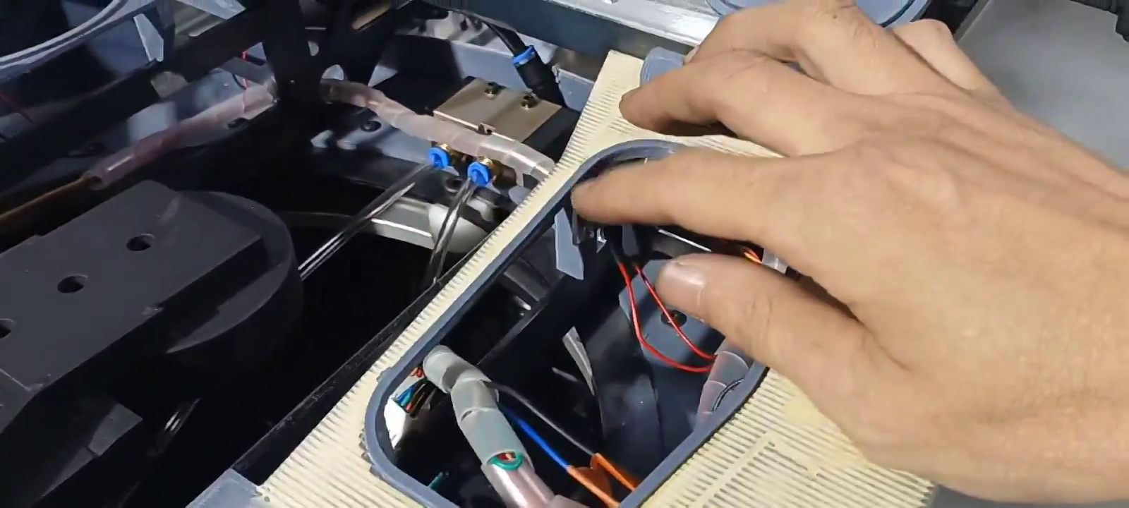

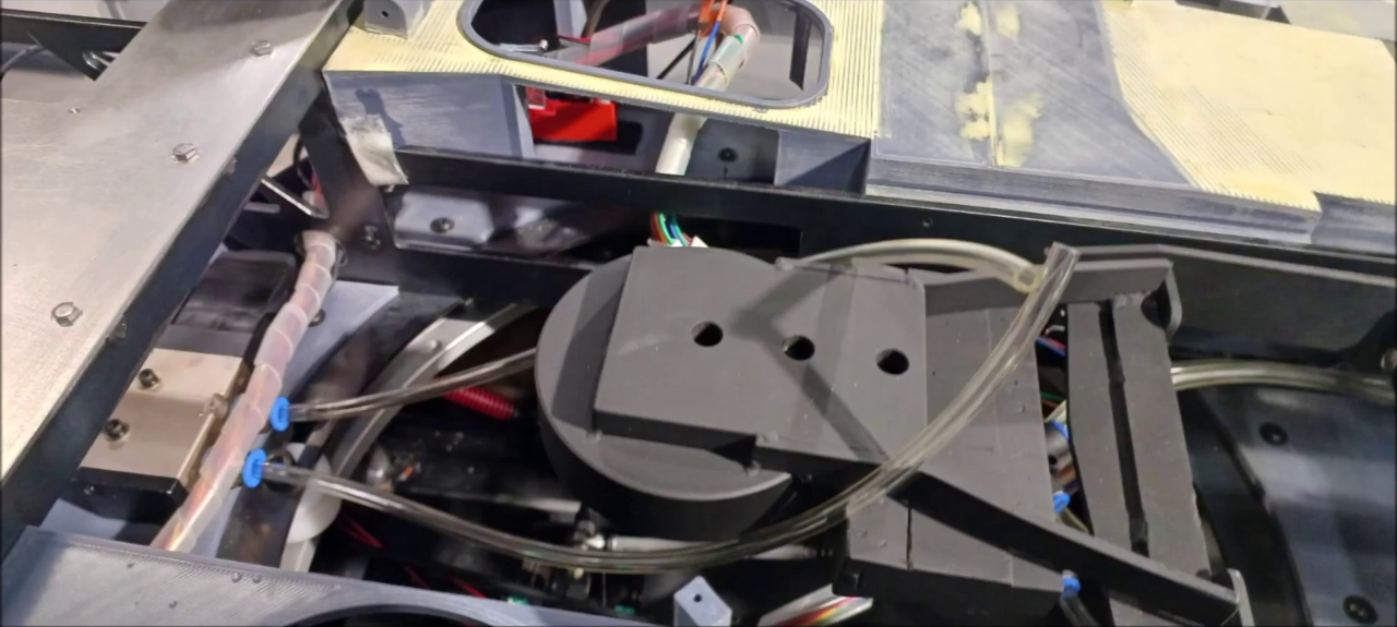

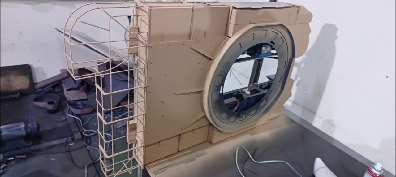

The turret rear basket was constructed, motion tests were carried out, and detailed work was provided for completion.
Youngjae

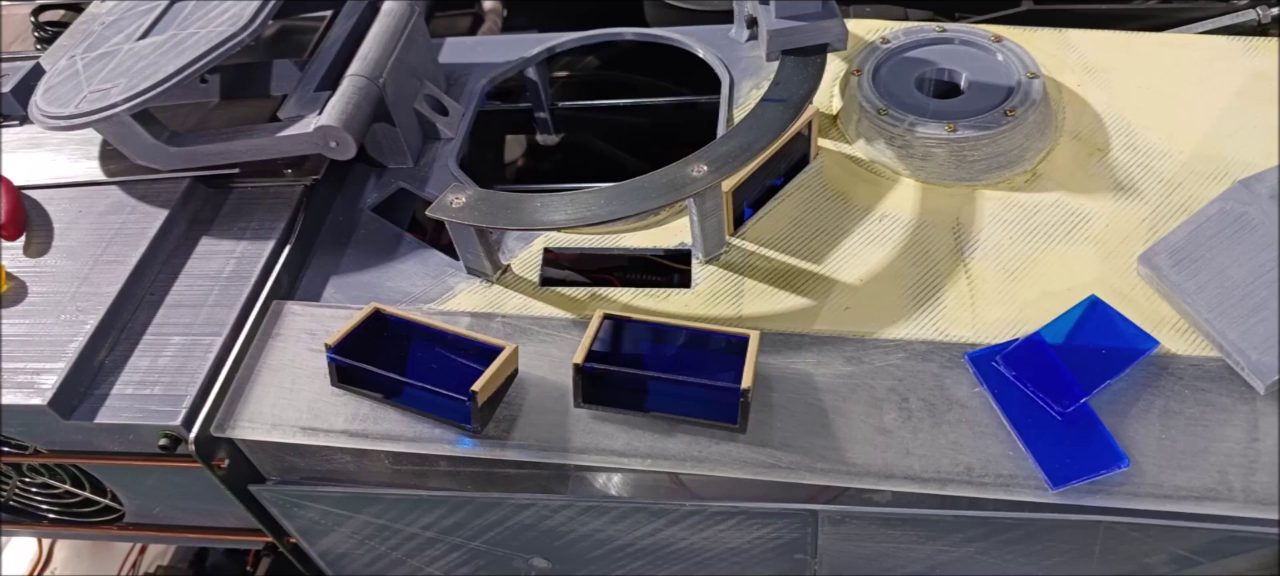

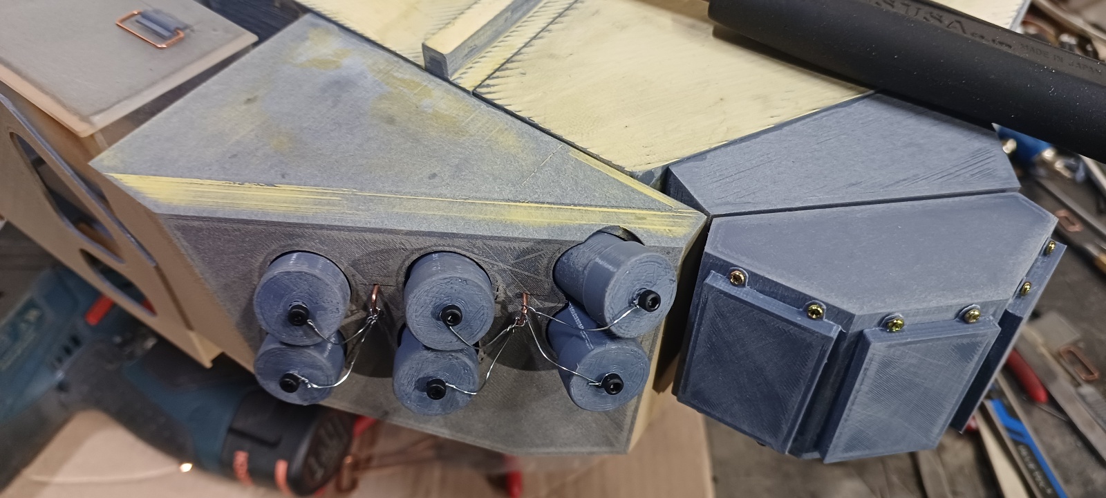

The air-cooled heat sink applied to the desert type of K2 CPS (Commander's Primary Sight) was added, and the work of DMRS (Dynamic Muzzle Reference System) and IFF (Identification Friend or Foe) was carried out.
DMRS is a laser fired into the reflector at the end of the main gun, but in this K2 model, it was made of a turret searchlight.
K2 is undergoing detail work. In this photo, a smoke bomb and radar are constructed to be used for the turret's lower paint, handle, and softkill.
Youngjae
Smoke bomb
Smoke bomb
DMRS and IFF
DMRS and IFF
CPS
CPS

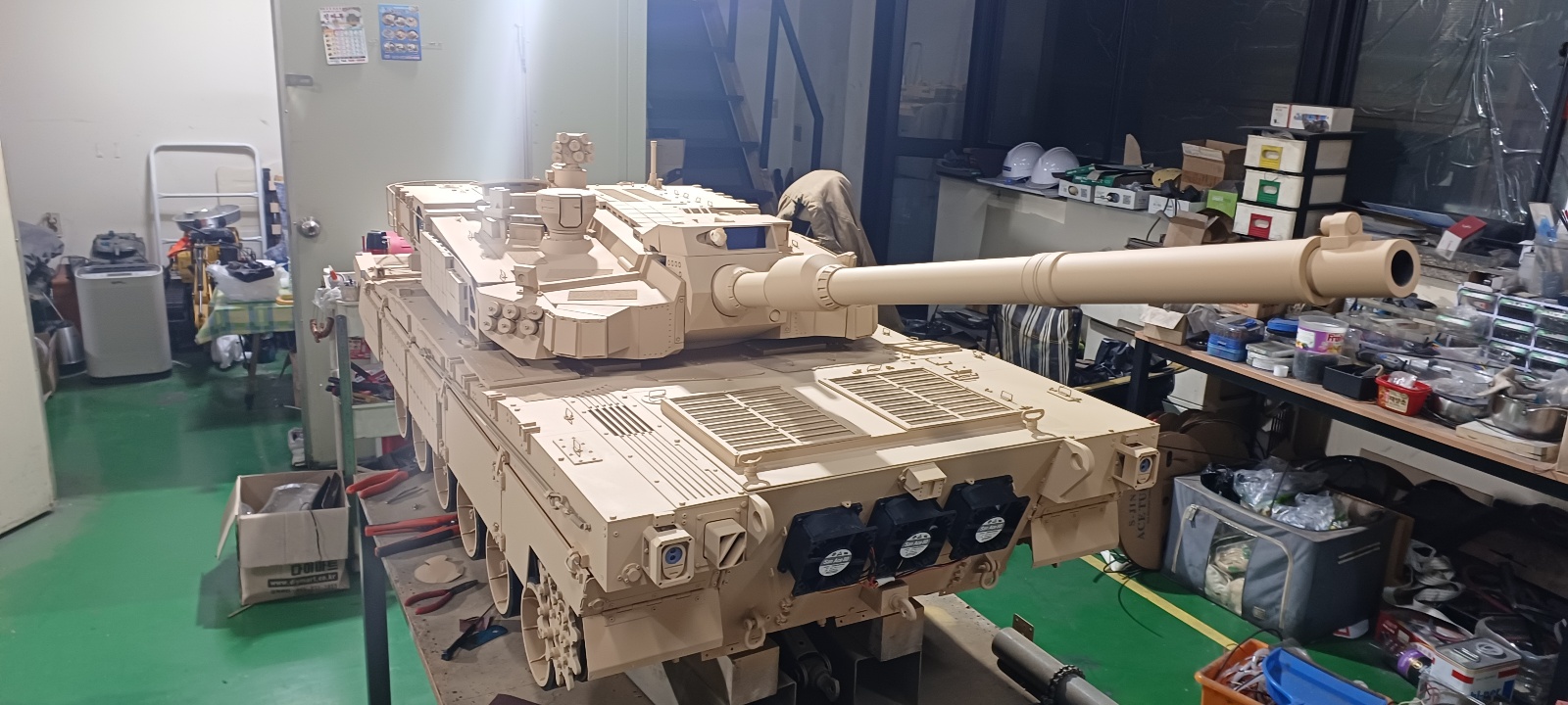

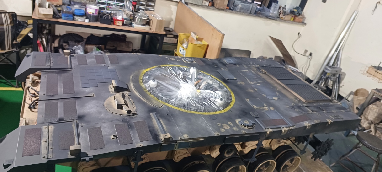

The K2 tank is undergoing its final painting work, and after 3 days, all the work will be completed,
so I will move the work from the workshop to the house and meet with my chieftain.
Youngjae
Paint3
Paint3
Paint2
Paint2
Marking
Marking
paint1
paint1

Superb quality ! one and only dunkelgelb coloured K-2 Black panther! can't wait to see it soon! :D
Has liked: 794 times
Re: Hand made 1/5 scale K2 Black Panther MBT in Korea.
Amazing how a little paint changes the look and brings it all together.
Can't wait to see a final video of it running around.
