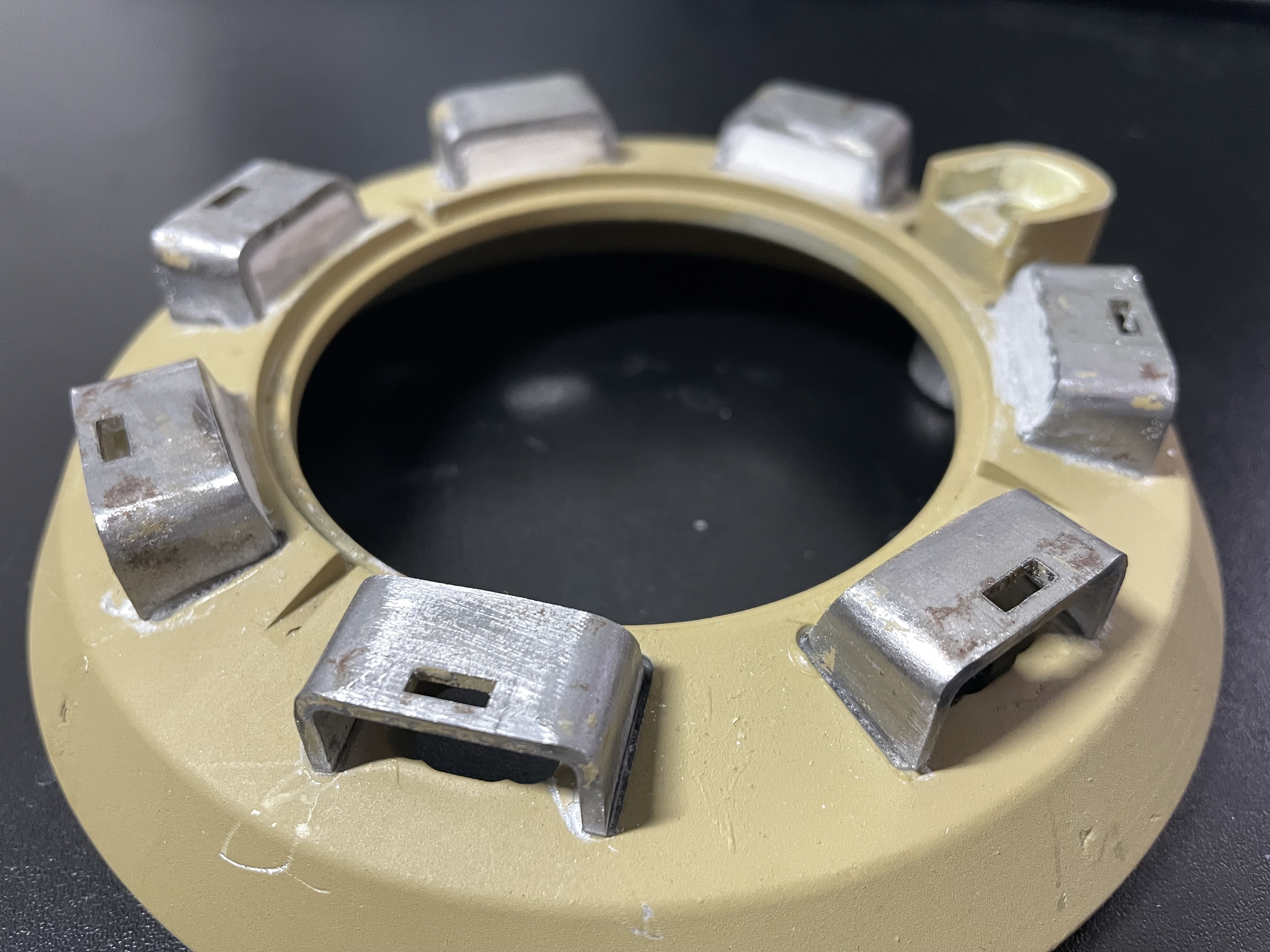

Started work on the Tiger 1 cupola today.
I decided that there were a few basic jobs to be done on the cupola to get it closer to my liking. As you can see in the pix above, this is how my Tiger had been assembled and I suppose, it was absolutely fine as it was.
However, after looking at pix of other late Tiger 1 at Vimoutiers and Saumur i realised that i could do a bit or work to improve the original parts.
The rear of the armoured periscope covers is angled and has been welded closed but the Armortek parts are square and open.
So, I stripped the cupola down and cleaned up all the old epoxy.
I then got out my 4" grinder added a slope to the rear of the armoured covers. I think i scribed a line 2mm back from the rears and then started grinding. I then tidied up with a file. I then made some plasticard pieces to block in the rears of the Periscope housings and these were then glued in place. This will be left to dry overnight and then move onto the next jobs which will be to add the 2 umbrella mounts and the turret lid stop.
I have also got to adjust the position of the mg ring because it was not quite in the right place.
This will get epoxied into position and then i will prime everything but then have to pause until i get the new cupola hatch cover arm ordered from Armotek.
I have a few parts to order to replace parts that were either missing from my build or now broken/damaged.
So, in the mean time i am picking away on a few odd jobs.
I am waiting for some m4 countersunk hex bolts to replace the original bolts fixing the torsion bar fails to the floor.
The hull is upside down right now but i hope to get this job done and then get the new rectangular access plate fitted before getting some new dunkelgelb onto the Tigers belly.
After that i can flip it over and start stripping down the roadwheels.
I realise that working on my Panther an Tiger at the same time is probably not the most efficient use of my time but it certainly keeps things interesting.

Used plenty of loctite 220 threadlock so hopefully they wont fall out.
It should look a fair bit better when painted.
I then bolted the round and the rectangular inspection plates into place.
