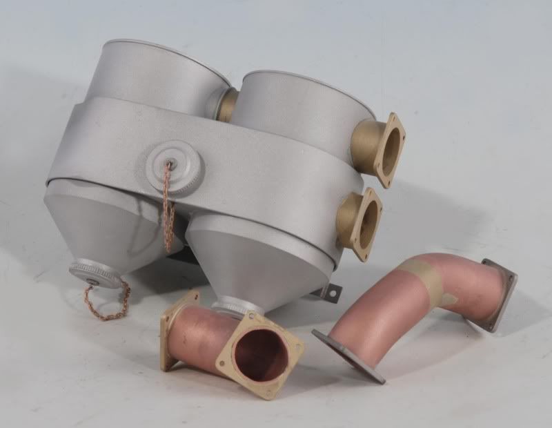

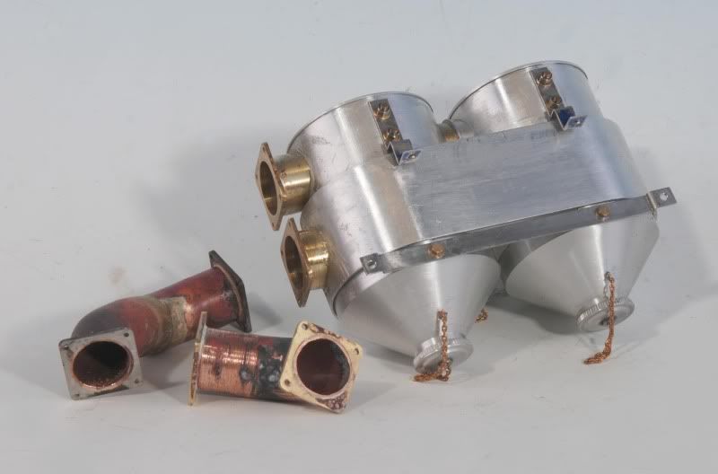

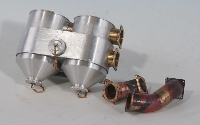

Hi everyone, after some busy time in my job I was able to make some steps with my Feifel filters. Hope with all the new members and models this topic is not too much aside of the main stream. Here is the filter as it looks after machining, silver soldering and completition.
And here it is after light shot blasting ready for going on to the back of my Tiger I
Best regards Roland

Roland Mann wrote:Hope with all the new members and models this topic is not too much aside of the main stream.
Quite contrary - watching the works of the true masters is always very inspiring! I enjoy every post you write and every picture you post. :D
To the left, is that a dent? Intentional?

Yes Chris this is a dent and thank you for your friendly comments. Nice to hear from you.

Simon, Steve, Tim and Per thank you for your comments on my work. I feel some of my old motivation coming back. The filters are made from aluminium and completely hollow. For me an important point since my Tiger is allready tail heavy and adding more weight at the back is the opposite I like. And yes Per it is possible to "breath" throug the filters if ever a need comes up. But I think I mentioned that my MAYACH is not intended to work in my Tiger since the original electric/electronic drive train by ARMORTEK is so smooth and reliable working.
OK now the tubing/hoses on the engine cover are the next steps.
Best regards Roland
