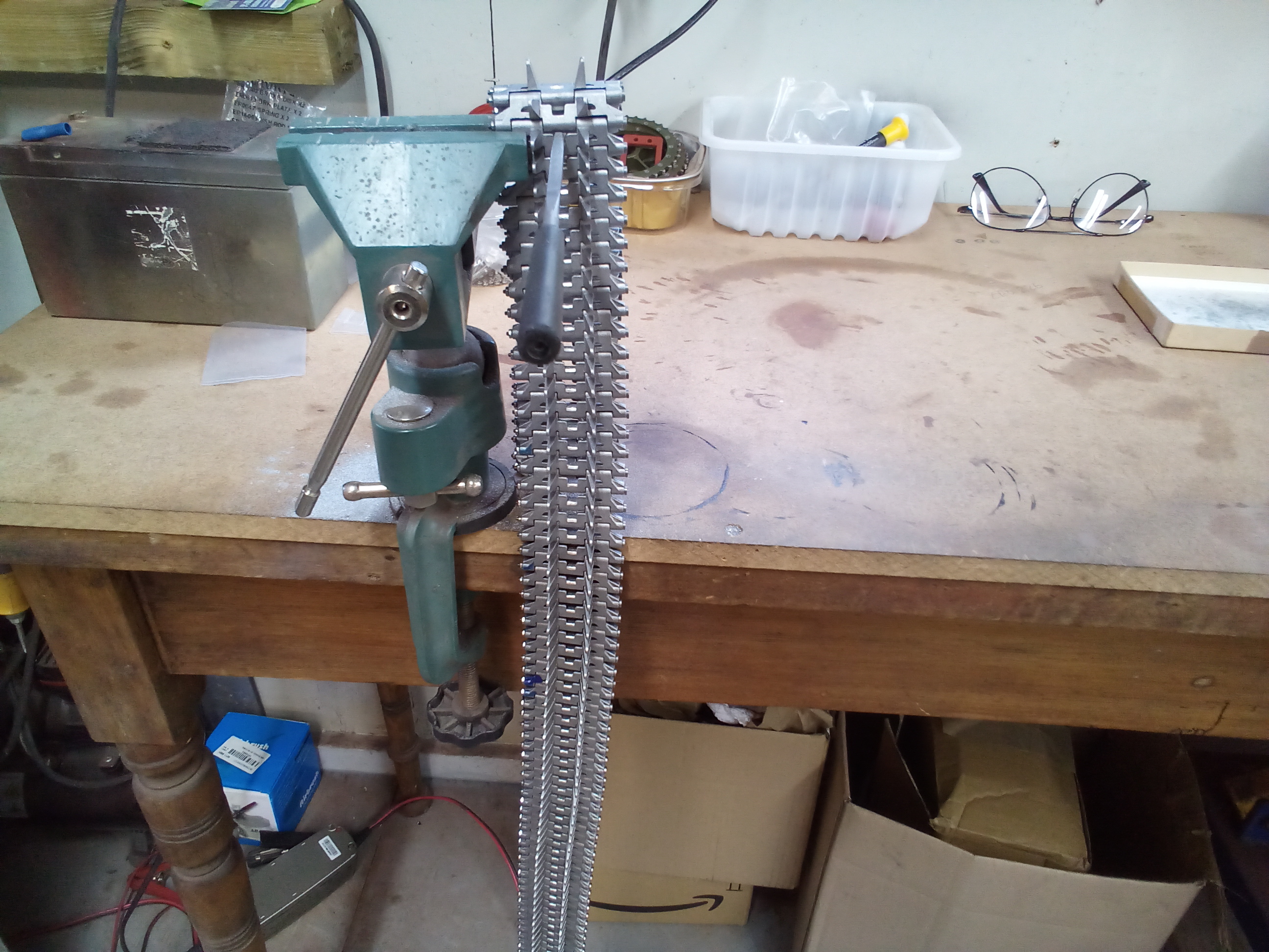

Re: Universal carrier sprocket ring
The gauge, use this template to create the rounded profile that mirrors the sprocket profile.
You will also need to adjust the gap between the links ( when the track is assembled) so the sprocket rolls in and out of mesh, it's not easy dressing the gap and a good square needle file is paramount. If you don't address this assembled track pitch it will never run smoothly. I found that just about all the gaps required attention and every gap was different.
I recommend using the pla sprockets to check the fit or you may damage your nice new sprockets rings, the pla sprockets will quickly show "witness marks" , under coating the track in a contrasting colour will also show witness marks, use these as your guide.
I
I
Phil, silly question: If one is to elongate this engagement hole with a rounded profile would not a round profile needle
file be more appropriate? Is this the sole modification required to ensure smooth running of the tracks? I though I'd read somewhere that re-drilling the pin holes was also required to ensure there's no curvature of the assembled tracks.
Perhaps I misunderstood. No offense to anyone is intended...
I may end up in trouble Jerry but you guys need to know how this modification works, the mod will only work with the after market pins, you have to eliminate the curvature of the track by over drilling each hole on the inner curve line using an over size drill bit of around 1.60 mm, a round needle file is huge in comparison and can be used for internal holes a square/flat file can be used for an external radius ie the journal profile, further adjustment is necessary by filing that journal gap with the said square file.......It's a lot of work but we'll worth the effort for this great big/little kit.
This is an aftermarket modification, the kit track and sprockets with work from the box.
Phil
Phil
Well I'm getting this from you to provide options for my construction of this machine. This isn't my first waltz with a model, any tracked model that could benefit from 'performance upgrades'; I always assume these will work adequately out_of_the_box however like my Audi RS7 one can always tweak things if you aren't risk-averse to get that extra measure of performance... I'm still grateful I don't have to cast my own tracks, once was enough to tell me I don't want to do that again. Ever. Mind numbing doesn't begin to describe it.Phil Woollard wrote: ↑Sun Aug 21, 2022 8:04 pmI may end up in trouble Jerry but you guys need to know how this modification works, the mod will only work with the after market pins, you have to eliminate the curvature of the track by over drilling each hole on the inner curve line using an over size drill bit of around 1.60 mm, a round needle file is huge in comparison and can be used for internal holes a square/flat file can be used for an external radius ie the journal profile, further adjustment is necessary by filing that journal gap with the said square file.......It's a lot of work but we'll worth the effort for this great big/little kit.
Phil
I also understand that any modifications and we're on our own; again a condition I began with nearly 50 years ago when I started in this hobby. I suppose a sane man would have given up on these years ago and taken up golf... As it was when I was learning how to be a software developer so long ago: if you don't make mistakes along the way you aren't learning...
