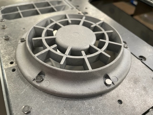

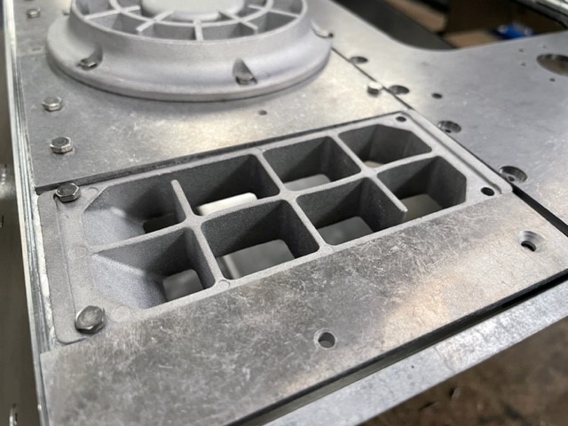

A couple of the grills on the engine deck - these are all new castings and have turned out really well.

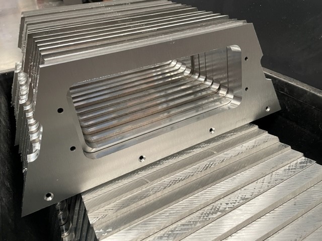

As noted earlier - we have started work on the turret - the part below is the Turret Front. First op on a 3AX mill is complete - it will need another op on a 5AX to add the angles

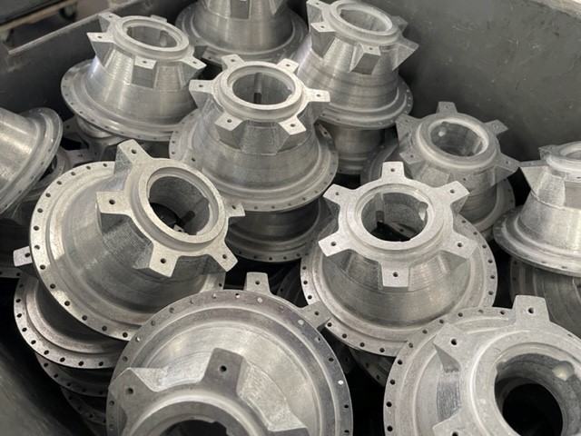

Sprocket centres - all complete. These are a new design as mentioned earlier - there will now be 2 removable sprocket rings. Machining on those is scheduled to start mid to end next week. With 4 rings per tank and 2 operations per ring, they will be running for a while

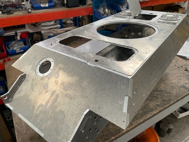

The validation build at the moment. Awaiting some updates on the manual before we progress further.

Great to see some update news with pictures. The grille detail does look great indeed!

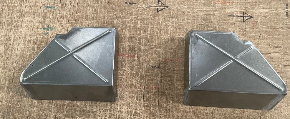

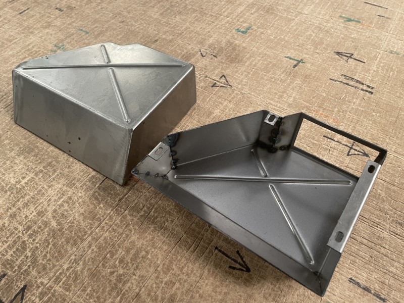

On Friday (yesterday) we got delivery of the Panther rear bins and the mudguards.
Very please with how both have turned out - especially the bins that are a massive change from previously where we machined them out of solid aluminium.
We have ordered some spare bins, so you want to upgrade your panther let us know at sales@armortek.co.uk.

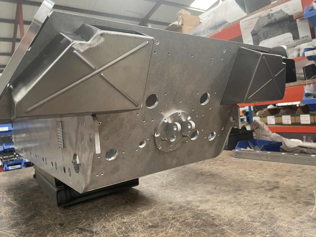

Left hand side and right hand side rear bins:
And as mounted on the Panther G

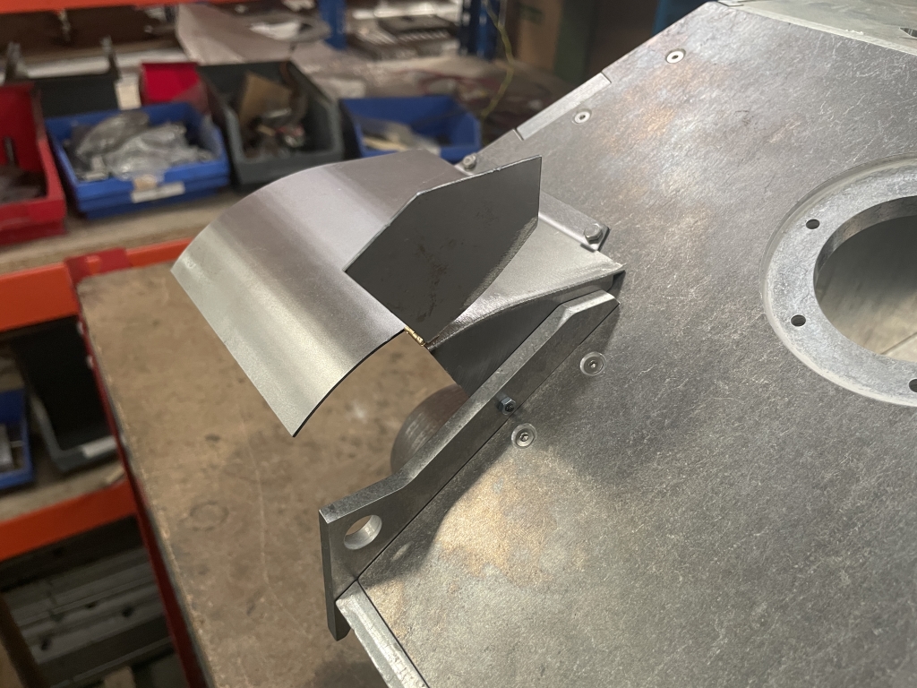

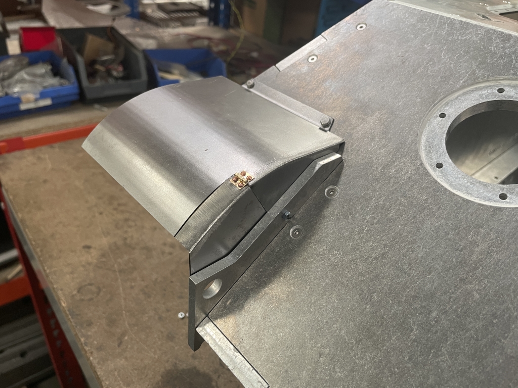

Front mudguards with the insert:

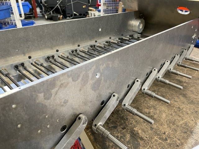

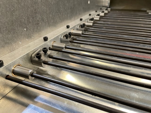

Torsion bars going in
Double torsion bar setup on the Panthers

To my knowledge, the double suspension bars system was intended to provide an optimal hull stabilization allowing relatively high speed travel over undulating terrain. So the Armortek is (as usual) a true functional 1/6 scale Panther.
- Posts: 2936
- Been liked: 3704 times
Re: Panther G (July 1944 version)
Yes - that's correct.laurent ROSSET wrote: ↑Tue Aug 16, 2022 6:09 pmTo my knowledge, the double suspension bars system was intended to provide an optimal hull stabilization allowing relatively high speed travel over undulating terrain. So the Armortek is (as usual) a true functional 1/6 scale Panther.
Here is a video showing the torsion bar set up on a Panther

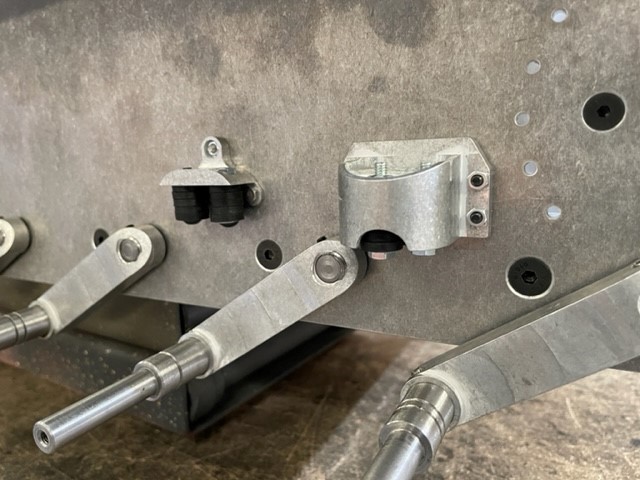

A few more pictures of the Panther G ....

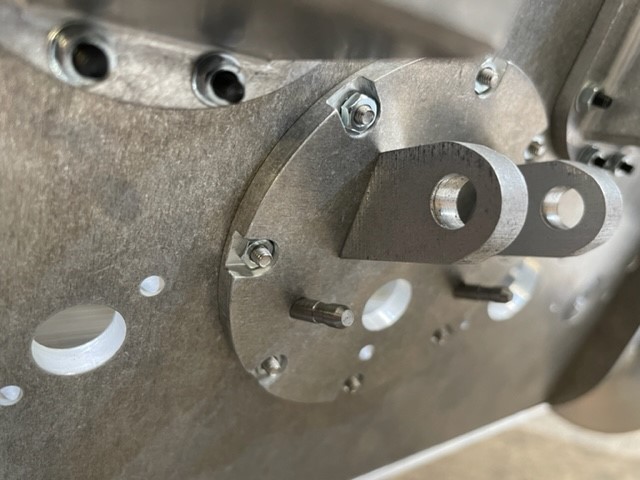

Track tensioning system ..... pretty much the same as on the Tiger 1, Kind Tiger, Jagdtiger, ....

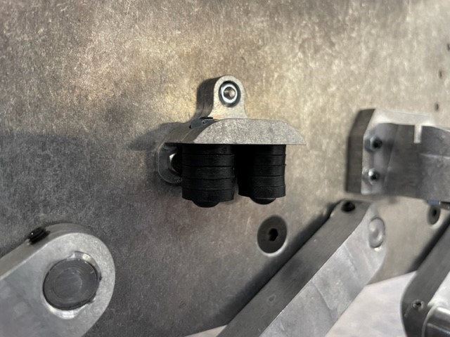

First and second bump stops. Very happy with how these have turned out. The first bump stop is still missing a flange which should be ready this week.
