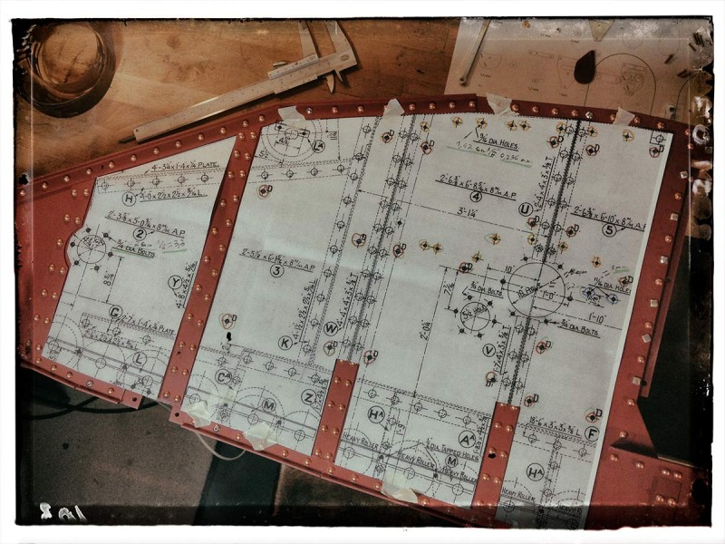

Preparing the Assembly of the Frames
After the trim subassembly of the rear door, slightly larger components needed to be fitted,
deviant to the manual, I assembled the frames in a later stage of the build
after priming and painting every plate to avoid any unprotected surfaces.

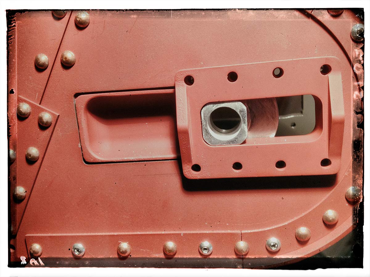

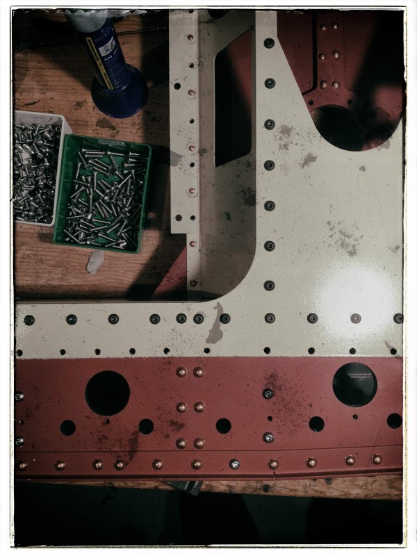

A few additional bolts
During this build stage, I was struck by the idea to enrich the outer plates with some additional bolts.
This extra tour was taken using the prefaces of Haynes Workshop Manual for the MK IV as a reference.
I have identified four sizes for nuts and bolts, so about 60 pieces need to be made for each side.
Using the nuts from Knupfer, the new bolts look authentic.
It was a bit fiddly to apply some of the bolts, but with helping tools and very flexible fingers, it worked in the end.
These parts gave the model a few extra details, which revitalizes the view of the side plates.

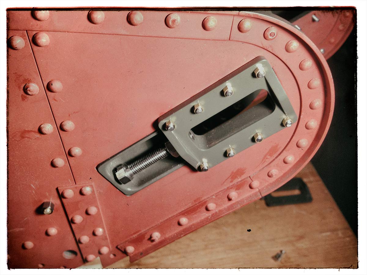

April 2016
Take the advice seriously!
It was often announced in several build logs, so the front bushes got extra attention that the most rear position was accessible.
I removed some material to get a proper fit.
Looking at the old pictures, I was aware that the frames for the front bushes were bolted.
For that, some studdings were screwed in and secured with some strong glue.
The nuts from „Knupfer“ now fix the frames in a way shown on the old pictures.
Best wishes
Oliver

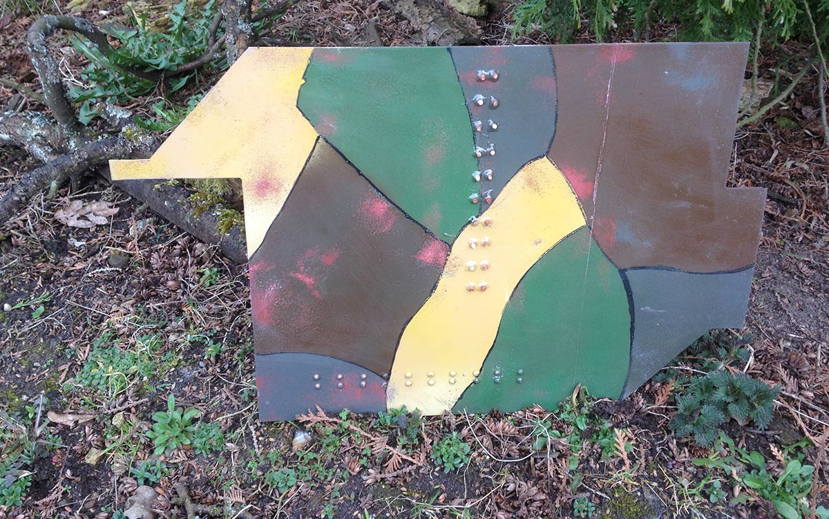

May 2016
And Now for Something Completely Different ...
After several subassemblies like the frames, the rear section, the bottom plate, and the driver‘s cabin were fitted, and the test assembly worked well, it was time to get an idea for the camo pattern.
It wasn‘t easy to extract the color blotches from the old black and white pictures. Searching the web, books, and statements from experts like Mr. Hundleby and Mr. Strassheim, I got an approximate idea of which colors and patterns wouldn‘t be wrong. Another expert I had a constructive and qualified conversation about this topic was Chis Hall, whose deep knowledge of these thanks gave me some more aspects to keep in mind.
Based on this informations, I asked myself which model I would like to see / build and searched the model pages online for beautiful builds of the small Tamiya and Takom kits.
Also inspired by old Märklin tin toys from 1932, I researched which colors would be suitable for this large model.
Wary that airbrush artworks would resist the rough duty of a hefty, radio-controlled one to six models, I choose regular car paint in rattle cans. Another rookie decision as to the many exceptional paintings and weatherings with acrylics and airbrush here in the forum proves.

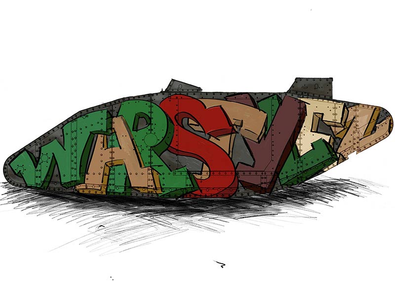

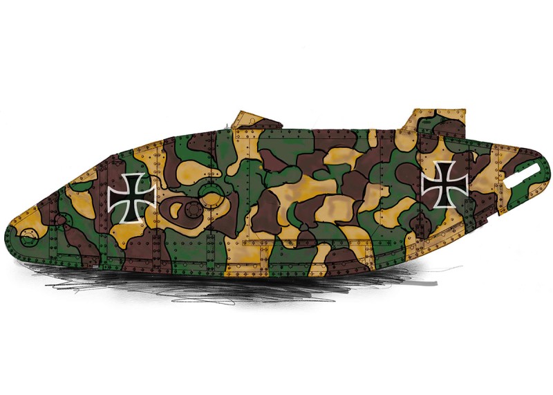

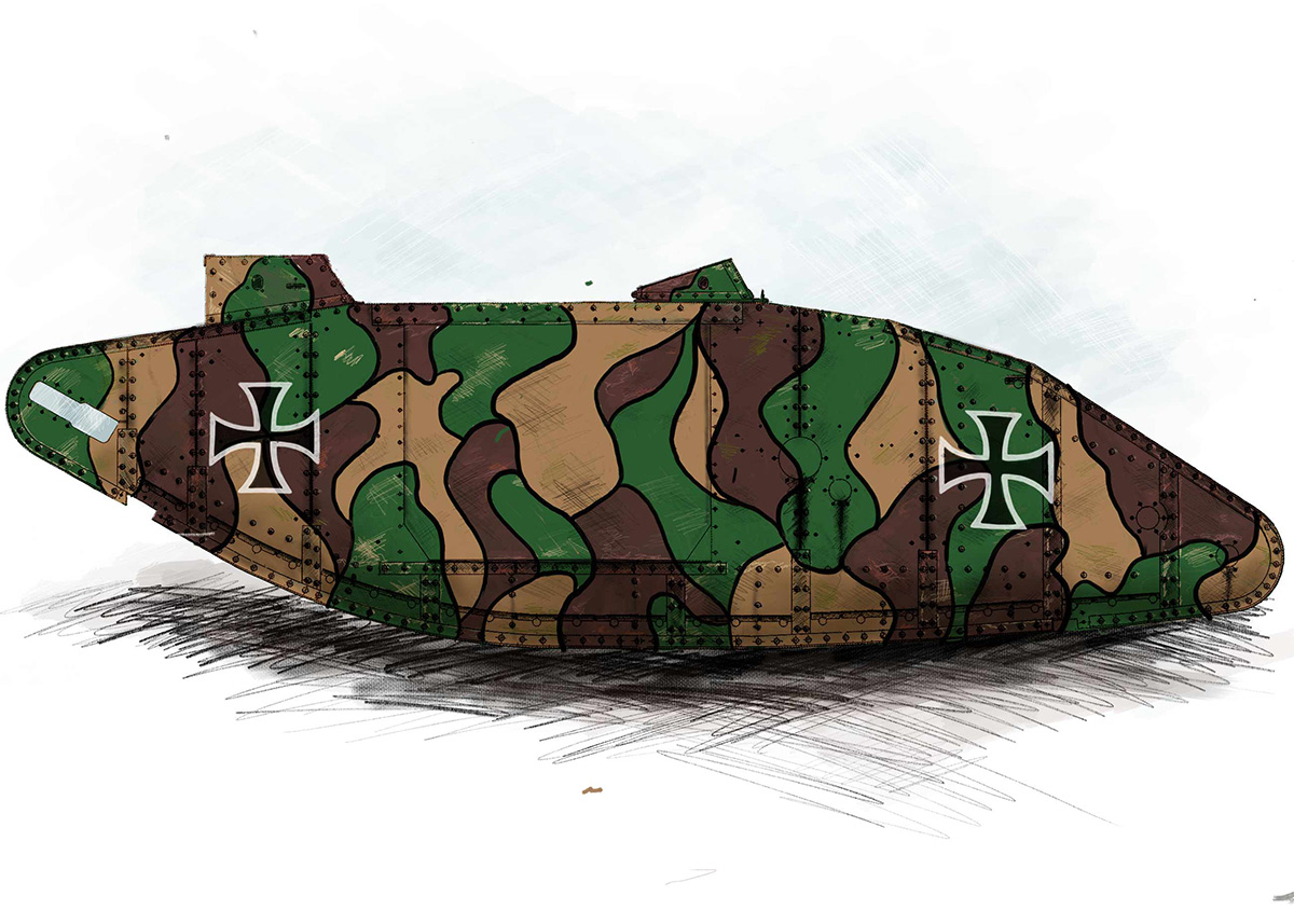

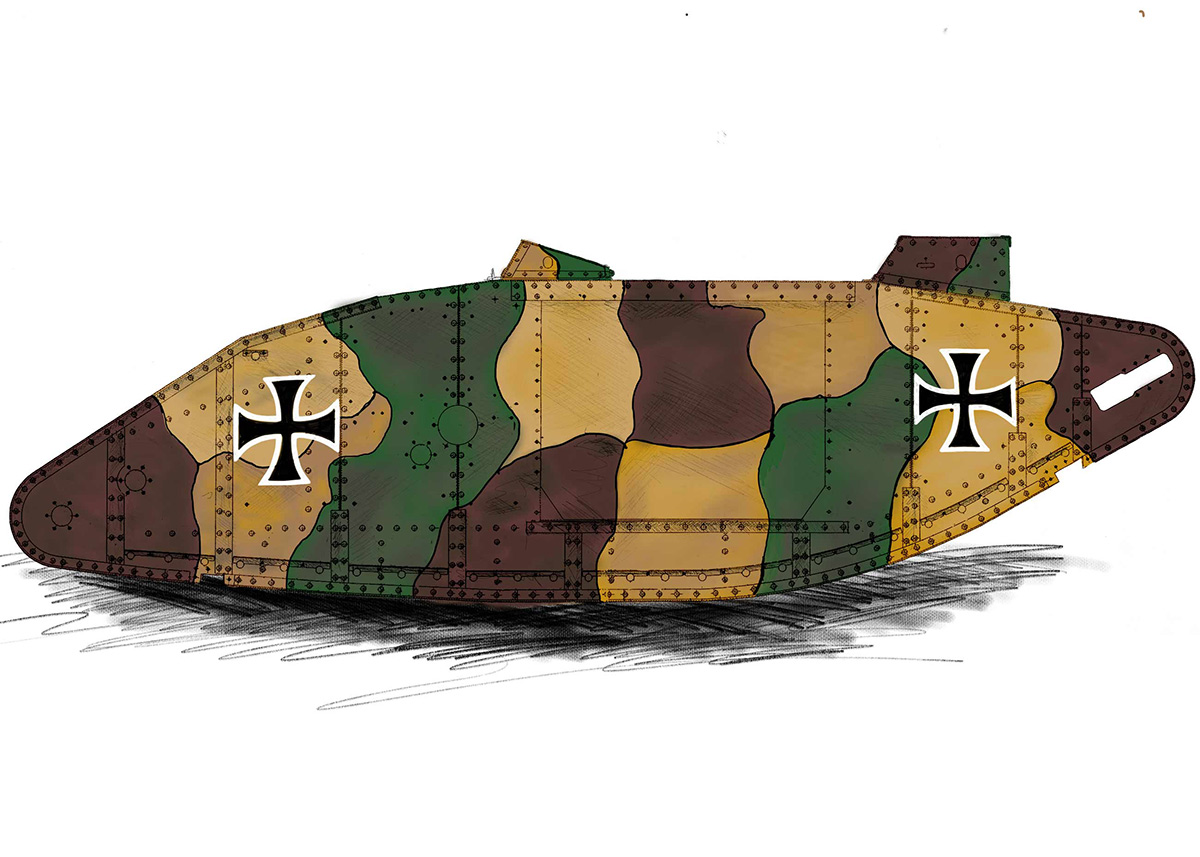

Putting all information together, I did some sketches to find a balance between the form of the pattern and the size of the tank.
Oliver
May 2016
Oliver

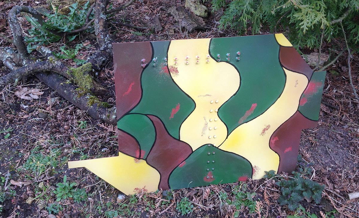

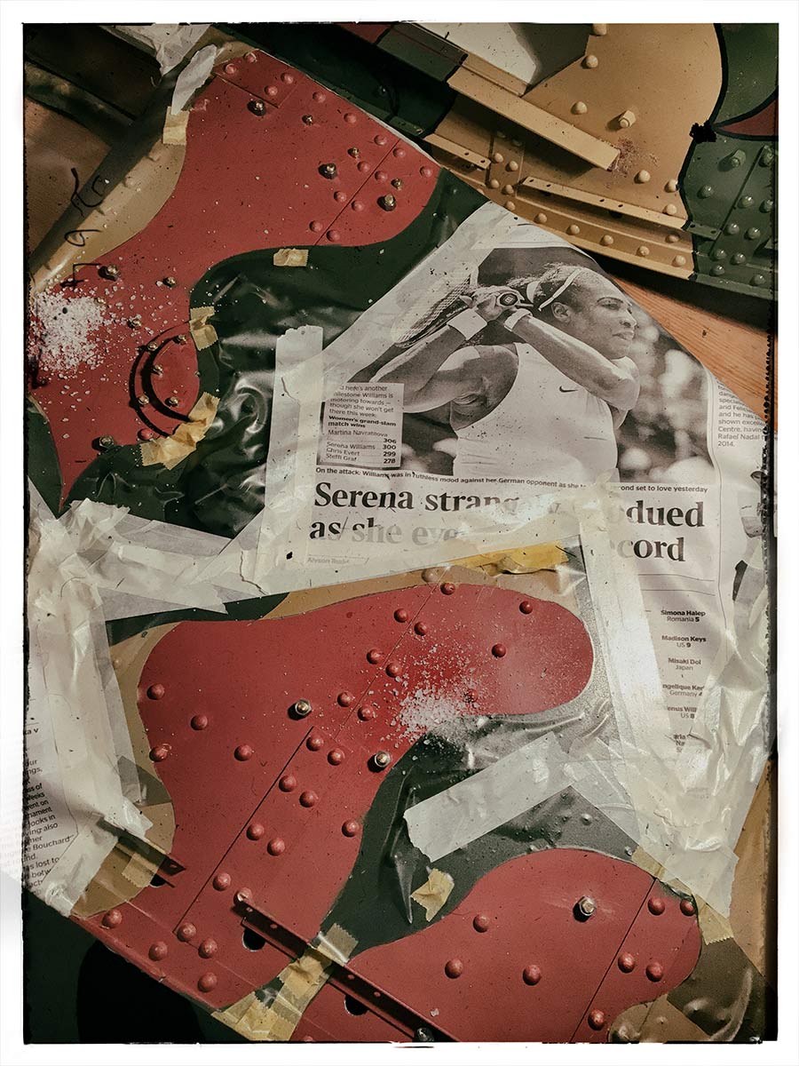

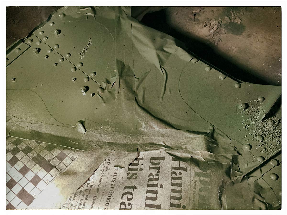

June 2016
Start of Painting
I made a few tests to check the chosen colors and the compatibility of the paints.
Each colour was enriched with two further hues and painted wet in wet with rattle cans. Some salt weathering effects were tested but showed some difficulties if I applied too much paint. Encouraged by the results, I opened the paint shop.
June 2016
Start of Painting
It's Grim Up North
Re: Schwerer Panzerkraftwagen
Are you using the salt as a scrub Oliver?
