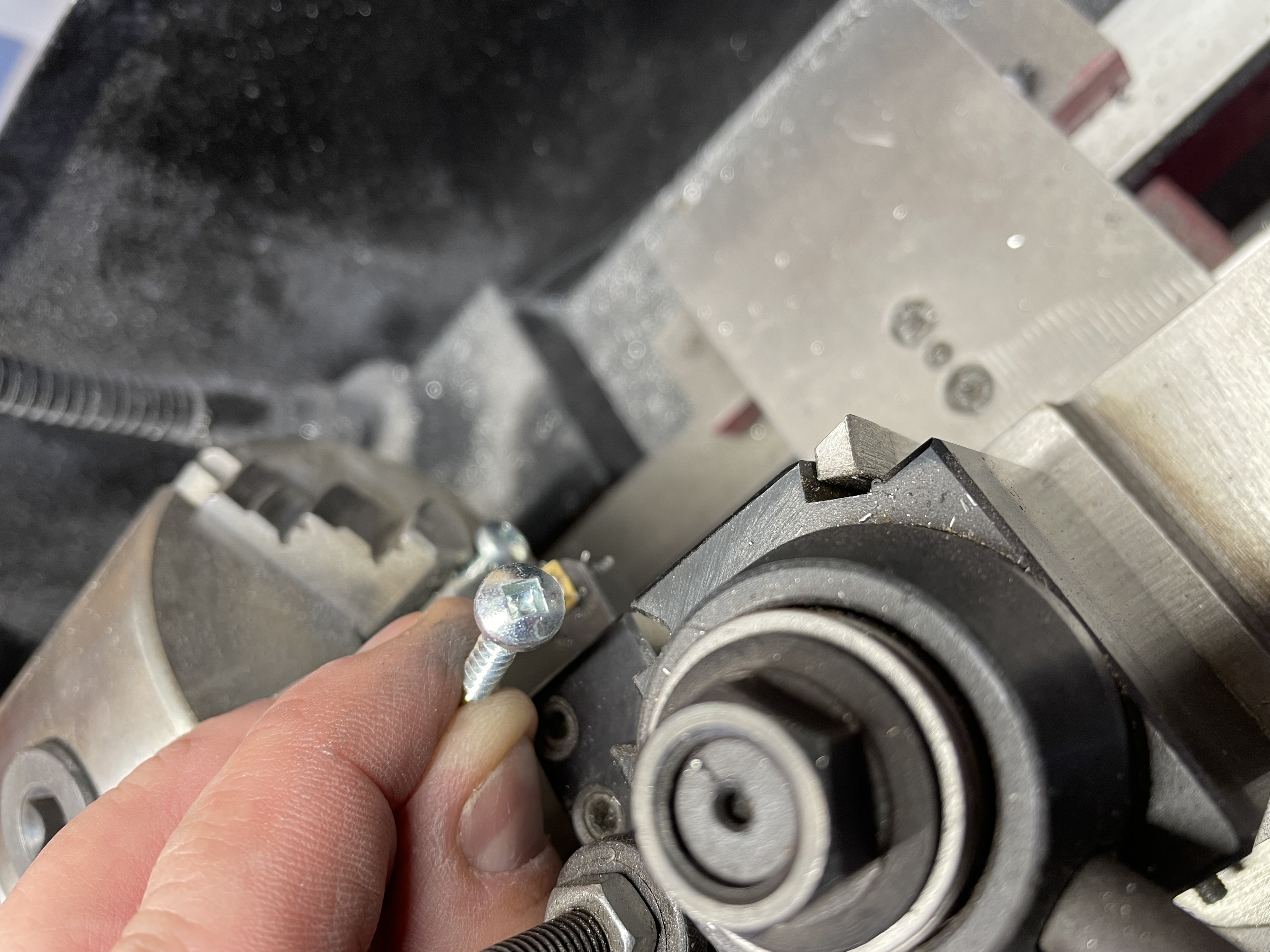

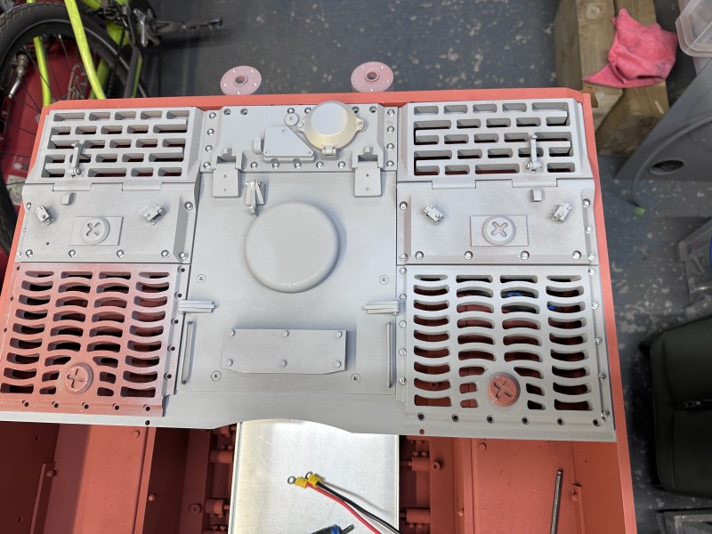

Started work on the engine hatch,i used security Robertson wood screws turned down in the lathe
Thanks to Gary for the tip regarding these
I also gave the cover handles a slight bend in places,I reckon that a late tiger will have had a lot of stuff dropped on the rear plate in its life so a bit of artistic license

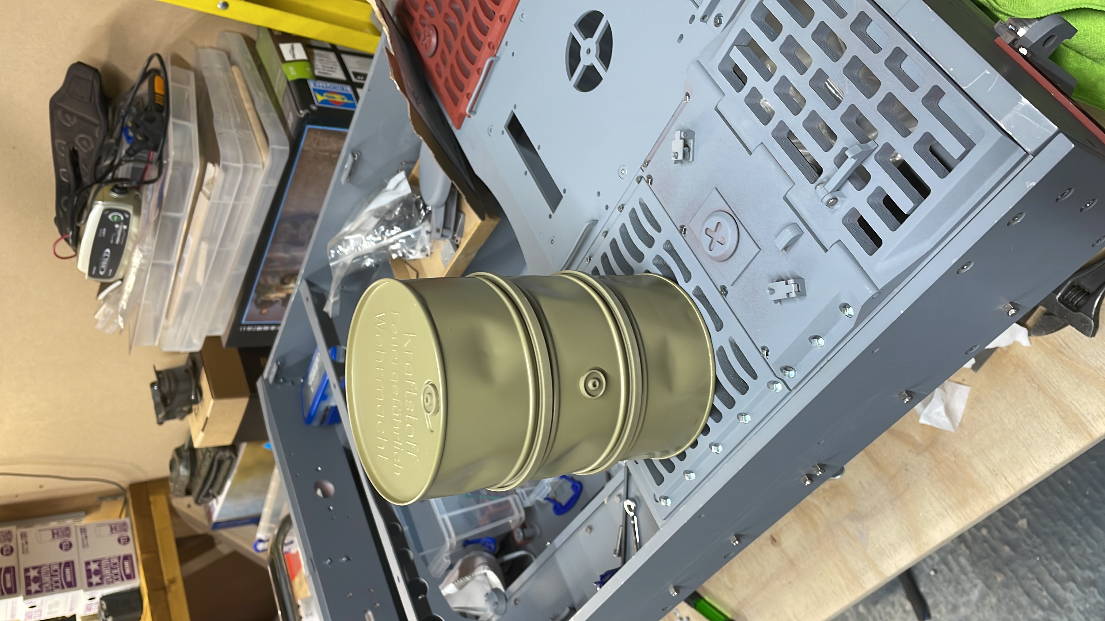

A nice find on ebay some dragon 1/6 scale oil drums,i am sure these would dent the engine hatch handles over time so i stand by my post above

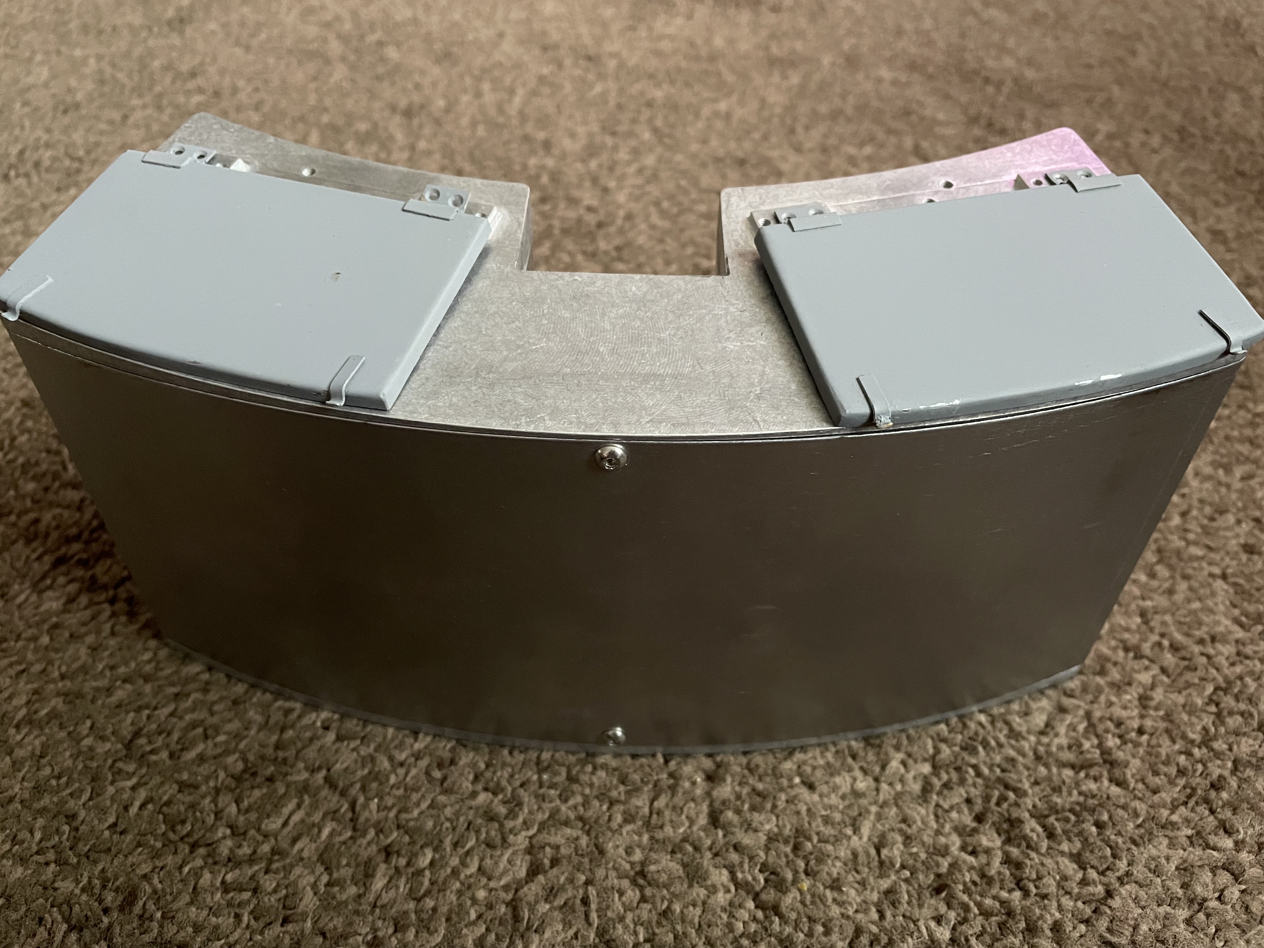

Started to do some work on the turret bin with the advice from Gary Richardson and Steve Winstones excellent after market bin lids

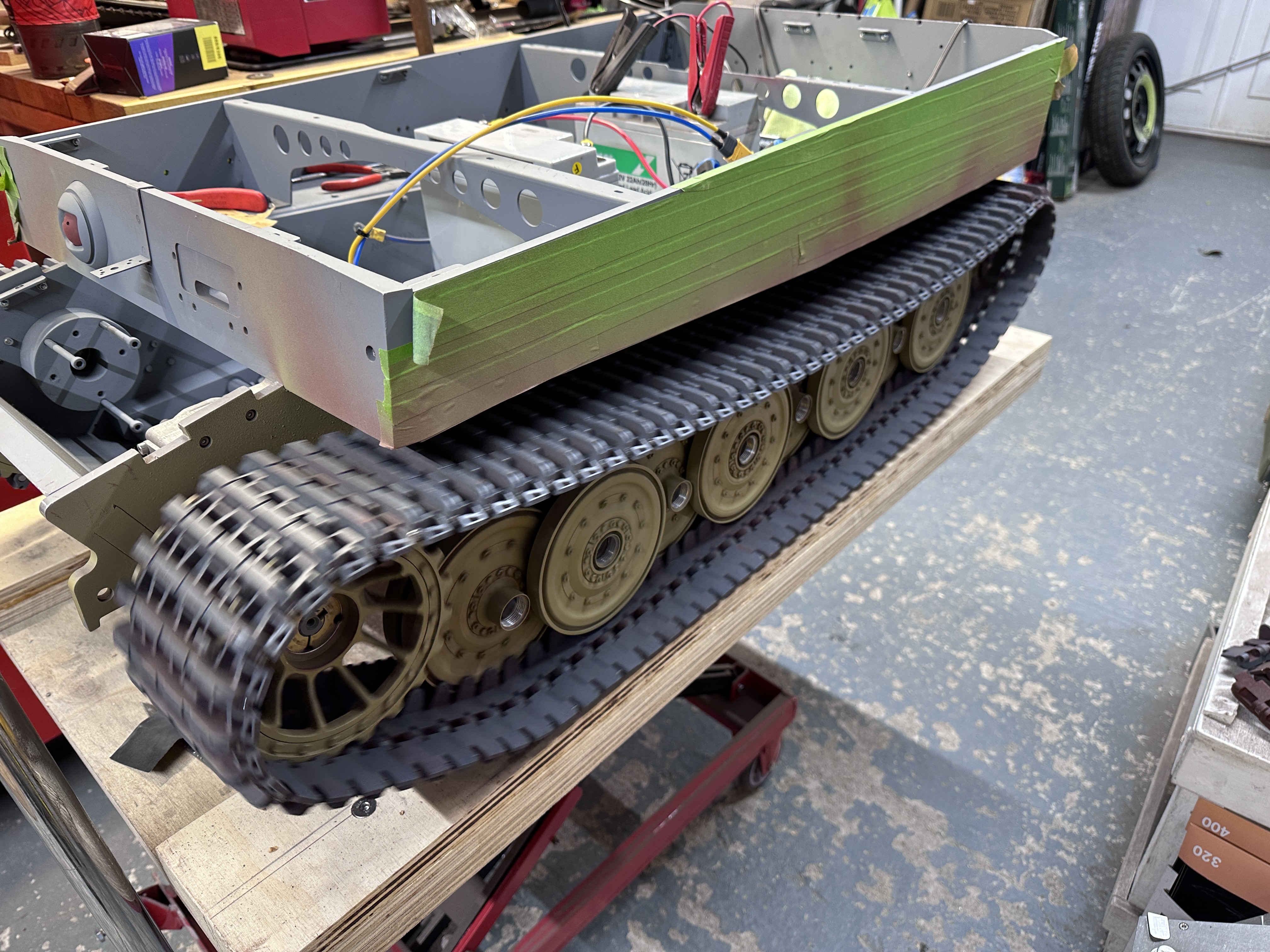

Number 6 comes alive,its been a while since i posted anything but every week my Tiger gets near completion
After a lot of false starts and rebuilding the tracks are on and working 100%
I have had them running dry for about half an hour with no issues
I have completed a lot of the sub assemblies so it should start to take shape a bit quicker now

Both Tracks now running with no issues,i have removed a few track links as i found the tensioner was at max travel to adjust the tracks
Motors all cleaned up from sitting about for 18 months in the workshop and a final check that everything is running smooth,now on to the front plate and sort out the rear exhausts

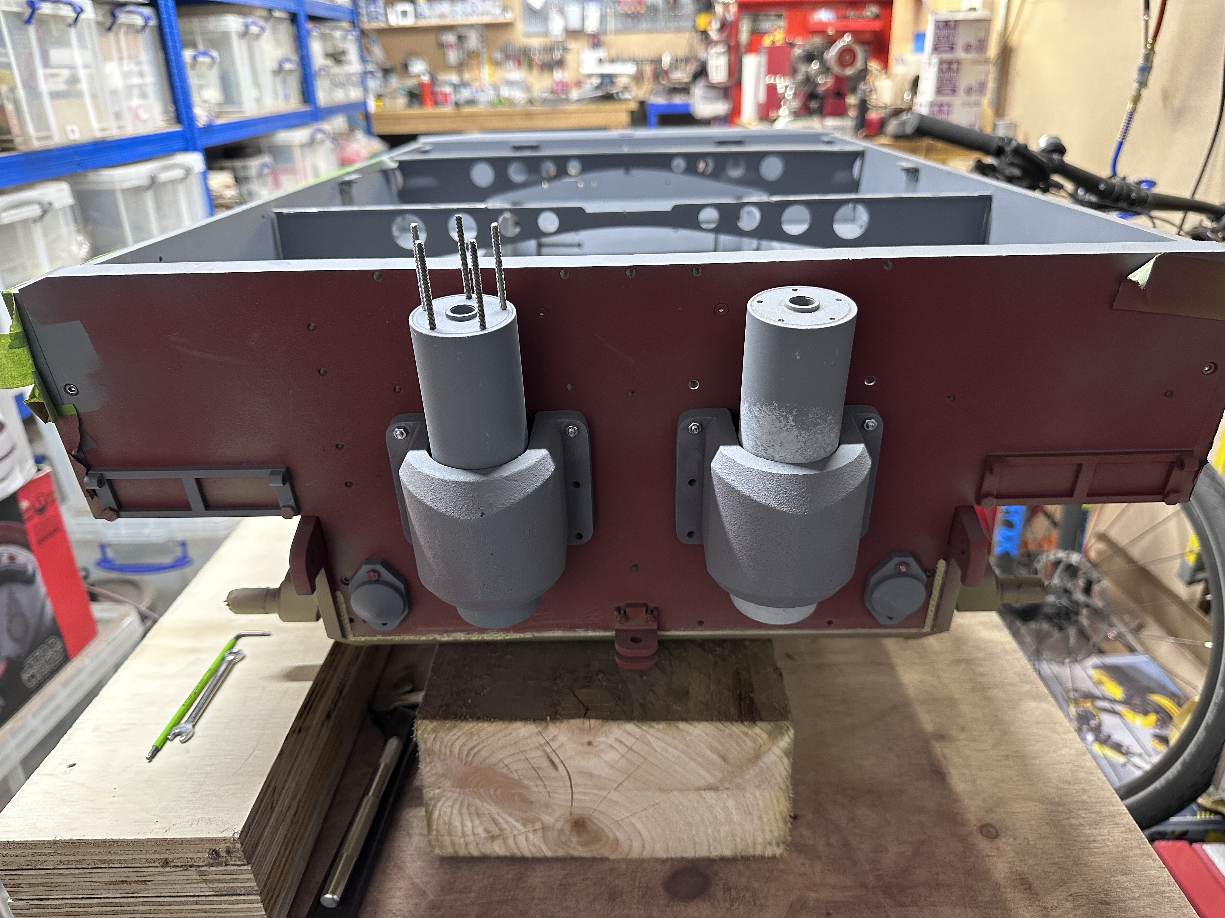

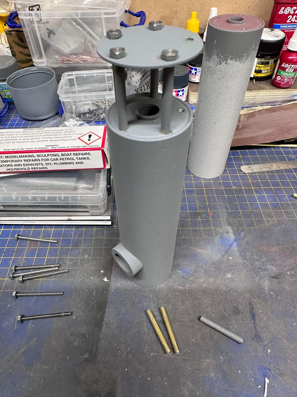

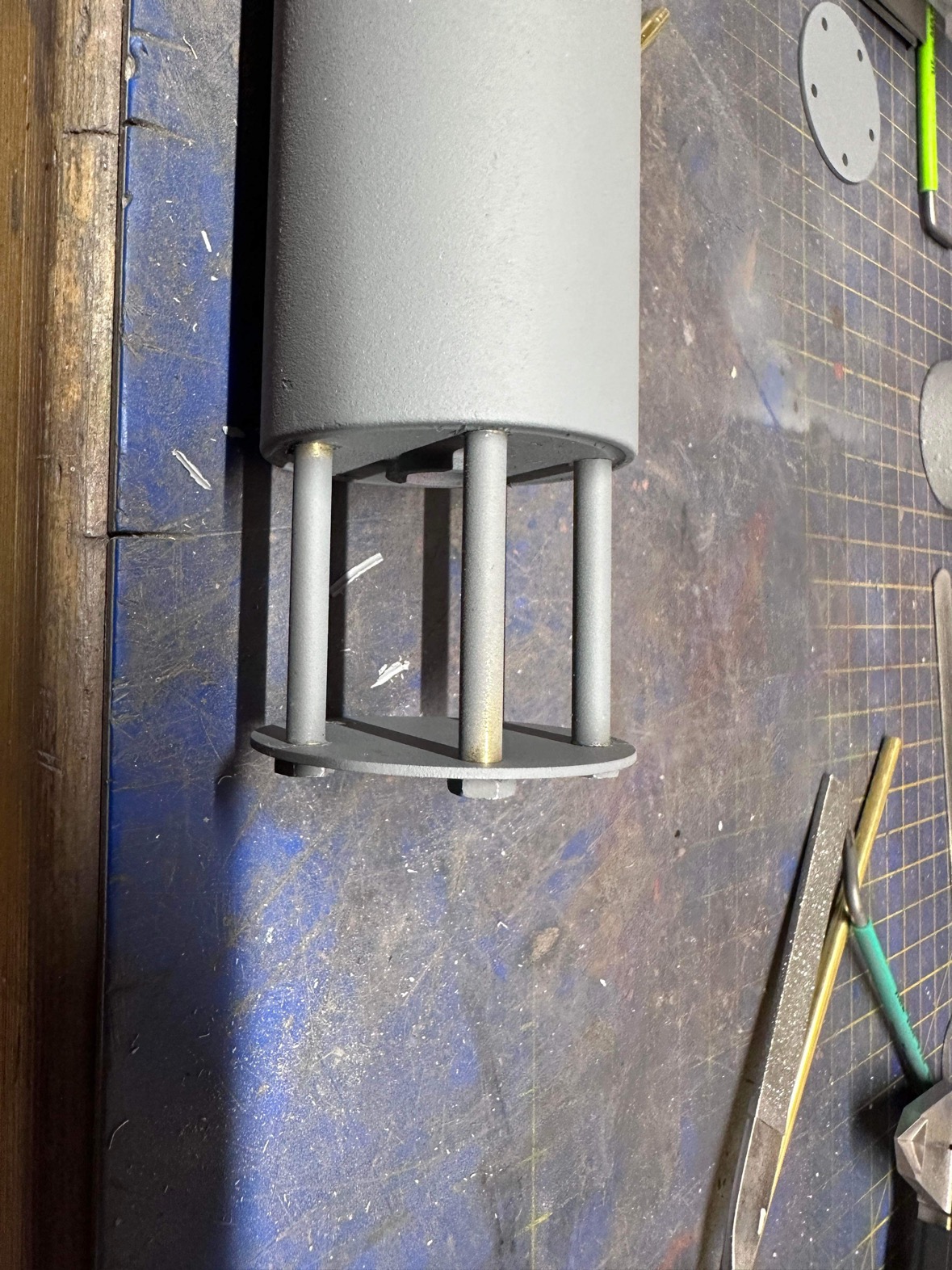

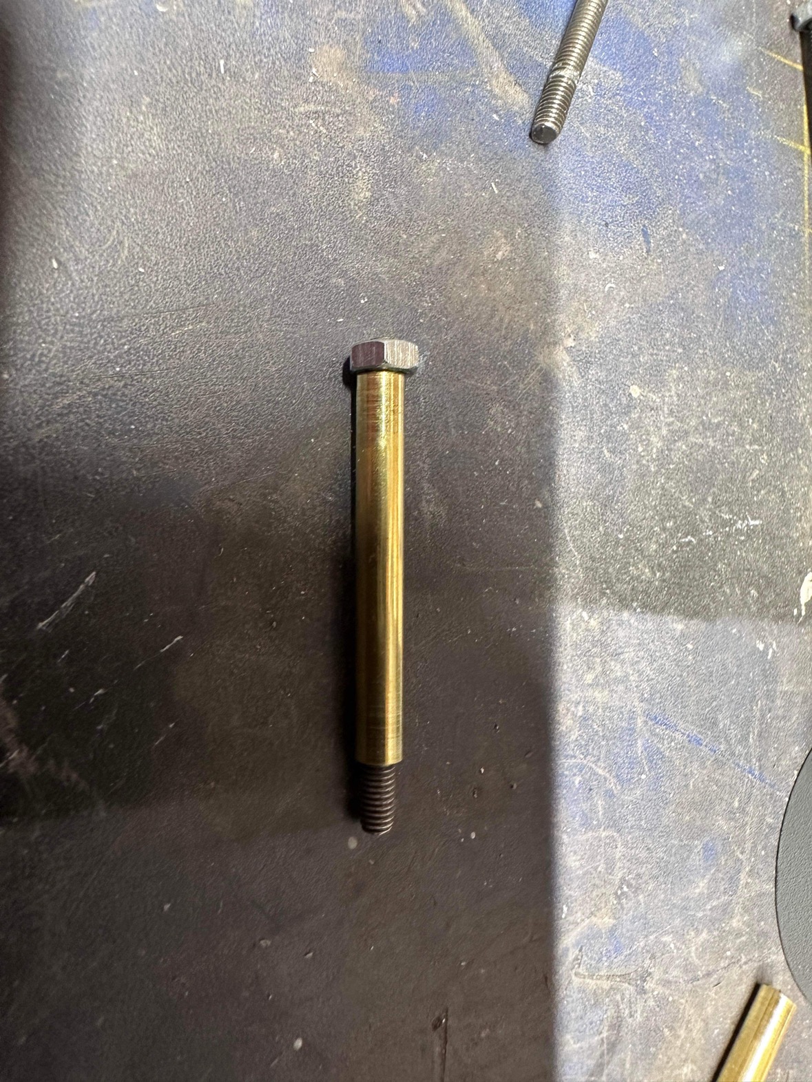

Moving on at last to the rear exhaust area after a few test fits,and how to accurately cut the tube to hide the threaded rod on the top of the exhaust’s
I used the original parts,only adding the outer brass sleeves
I firstly loctited the nuts to the threaded rod and machined the heads flush,cut the rods to length and tightened them up
After months of head scratching it was quite easy in the end

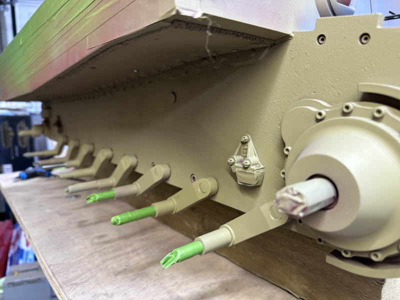

Some updates to my build

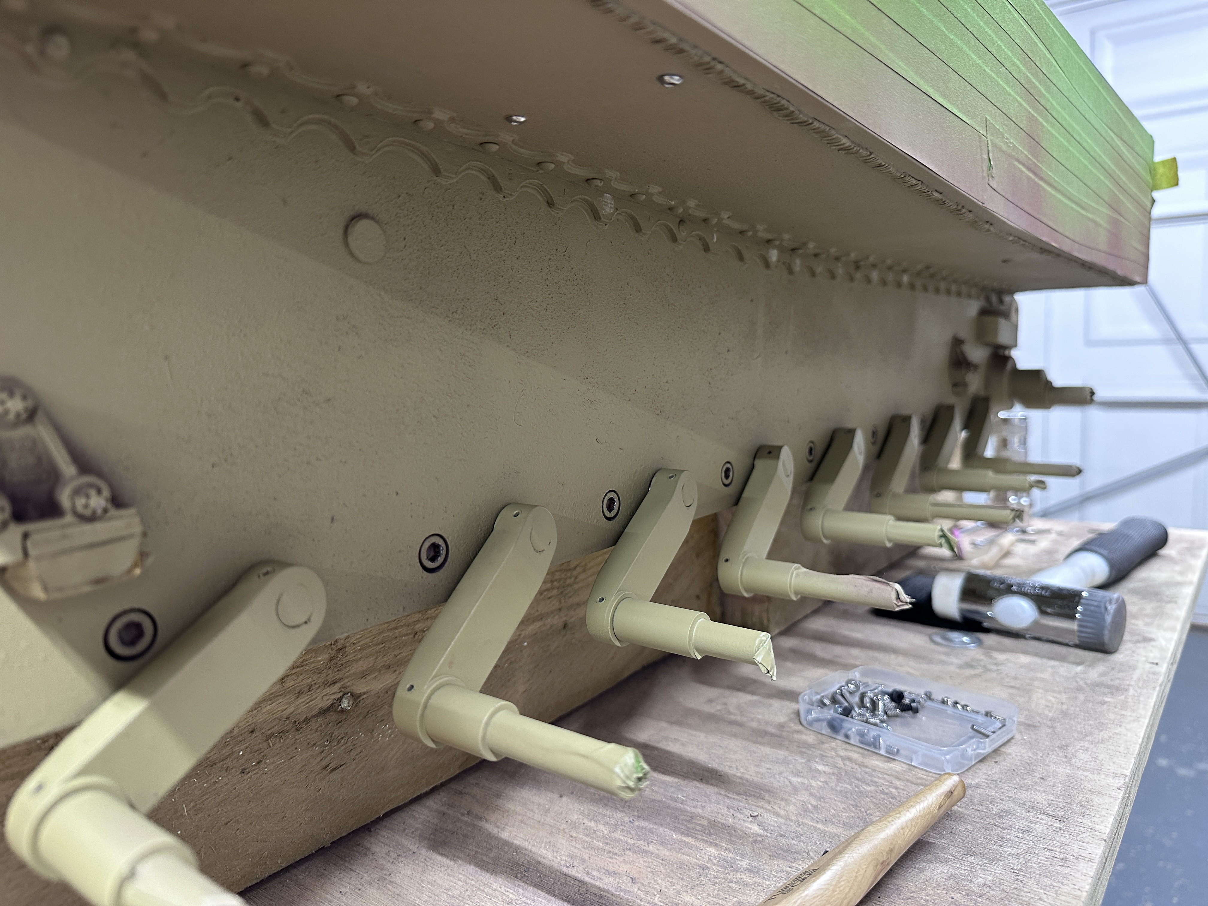

I also had to strip and rebuild a few wheels due to wheel wobble due to excess paint

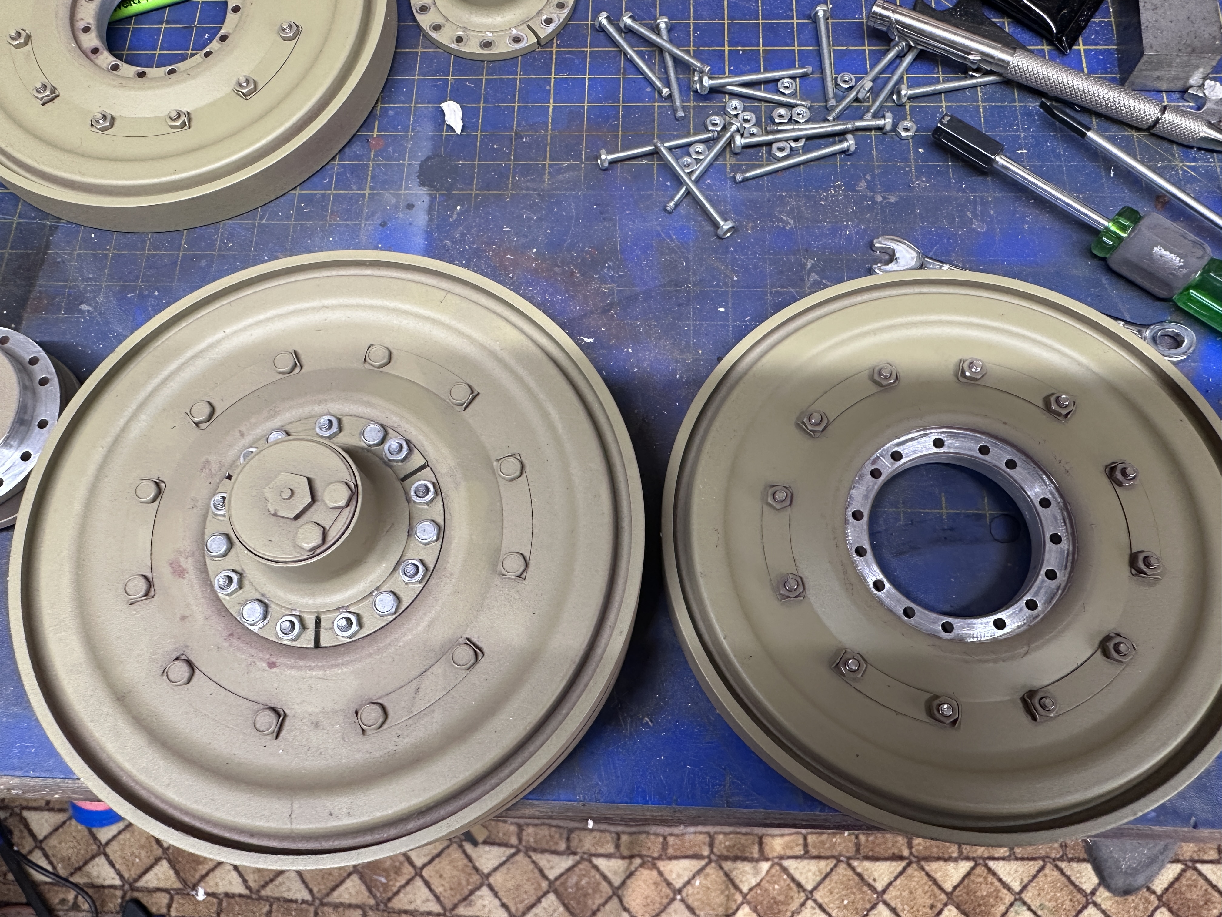

Re: Late Tiger 1 2021 Number 6 Build
If you can spot the mistake,and an easy one to make i had to revisit the wheels again due to some bolts round the wrong way

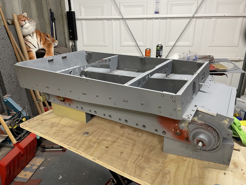

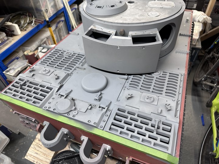

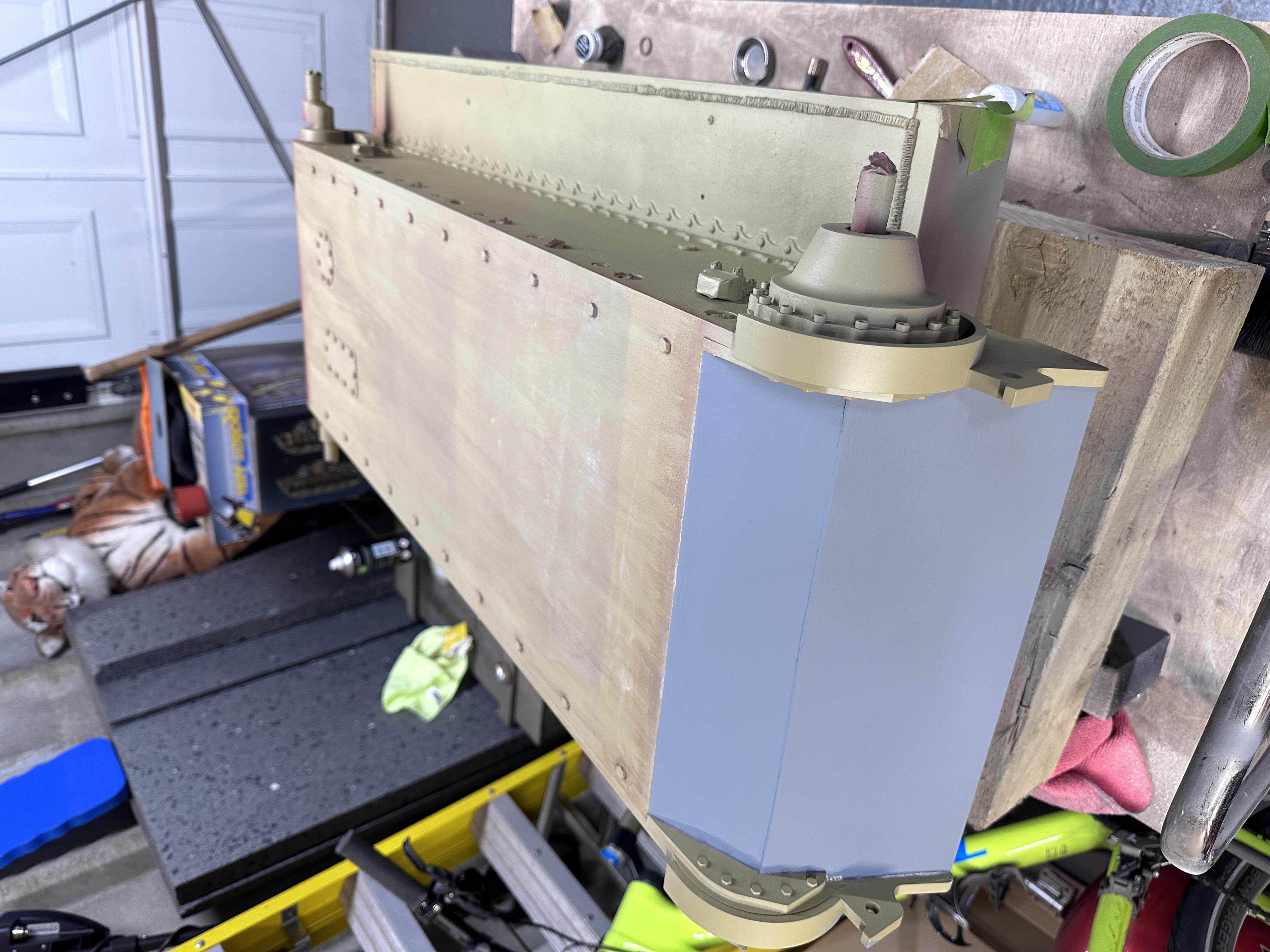

And more updates with the rear deck test fit and another coat of paint on the underside

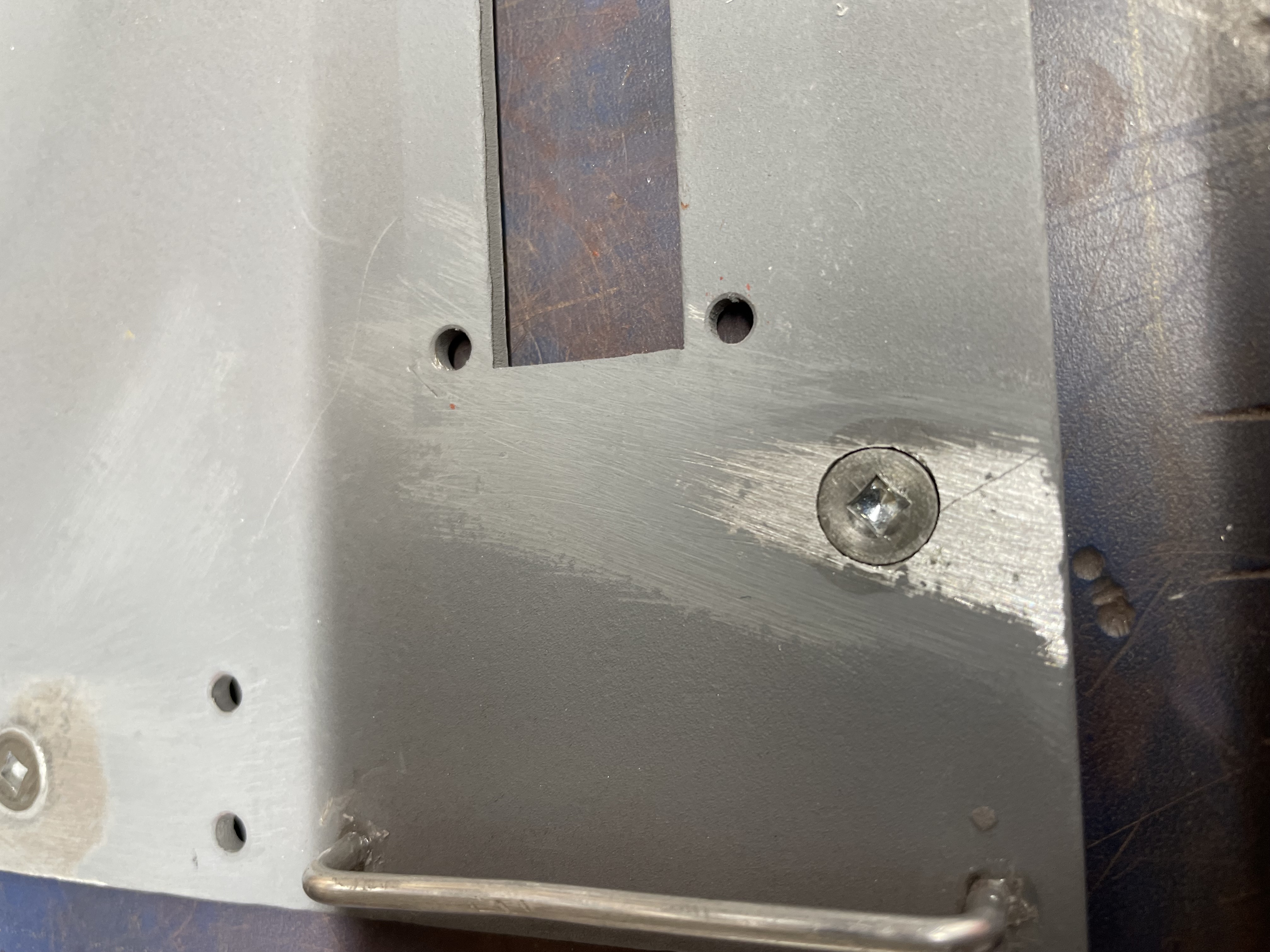

I decided to remove the underside bolts,i wish i had done it beforehand

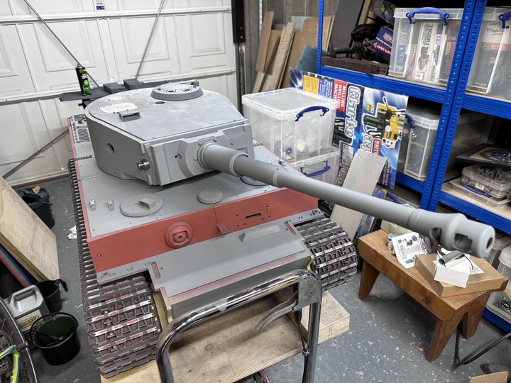

Starting to come together
Donald
Still a bit to go,but it is starting to look like a Tank,and not a box of bitsDonald
