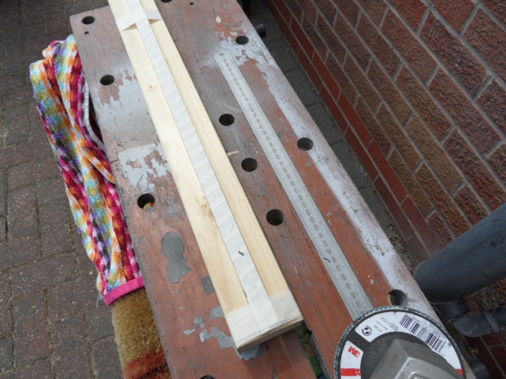

At the weekend got the grinder out, Strapped the three lengths of 6mm alloy channel together with masking tape.
Drew a line along the edge for the desired thickness and thinned them down.

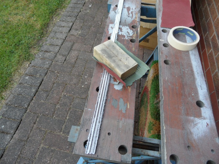

A block, wet and dry to flatten and smooth the edges. Done.
Who needs a miller?
Yes, it would have been handy.

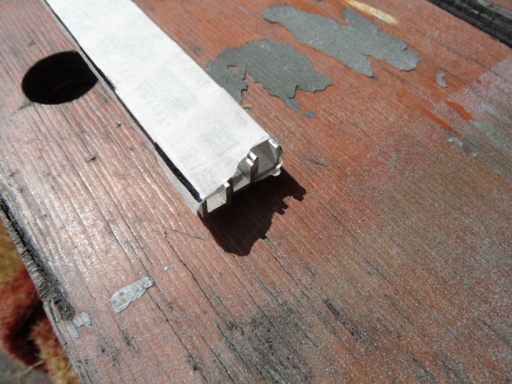

Taped together.
Regularly taping down while gently grinding with a flap wheel, taking time not to gouge lumps out of the channel
Lots of elbow grease required, (wax on, wax off motion)

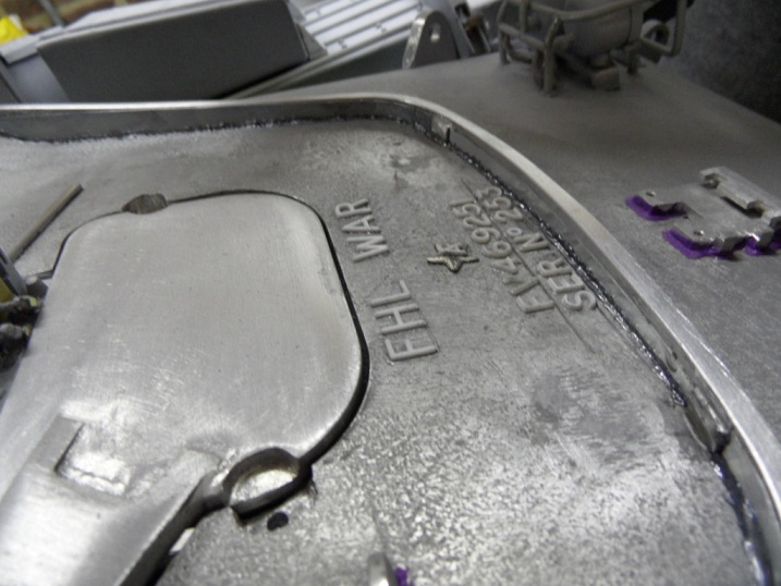

The new slimmer more in scale rail, compared to the supplied rail.
Certainly easy to bend to the correct shape, tighter bends are easier to form without the creasing effect than the supplied rail too.
Worth doing...... I think.

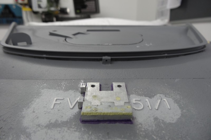

Fine work Greg, Tricky little devil the wading rail, finding the right pictures to give prospective. I used this one a lot because as I look down on the model I could replicate the angle.
Some ways to go yet, but it's coming along.
