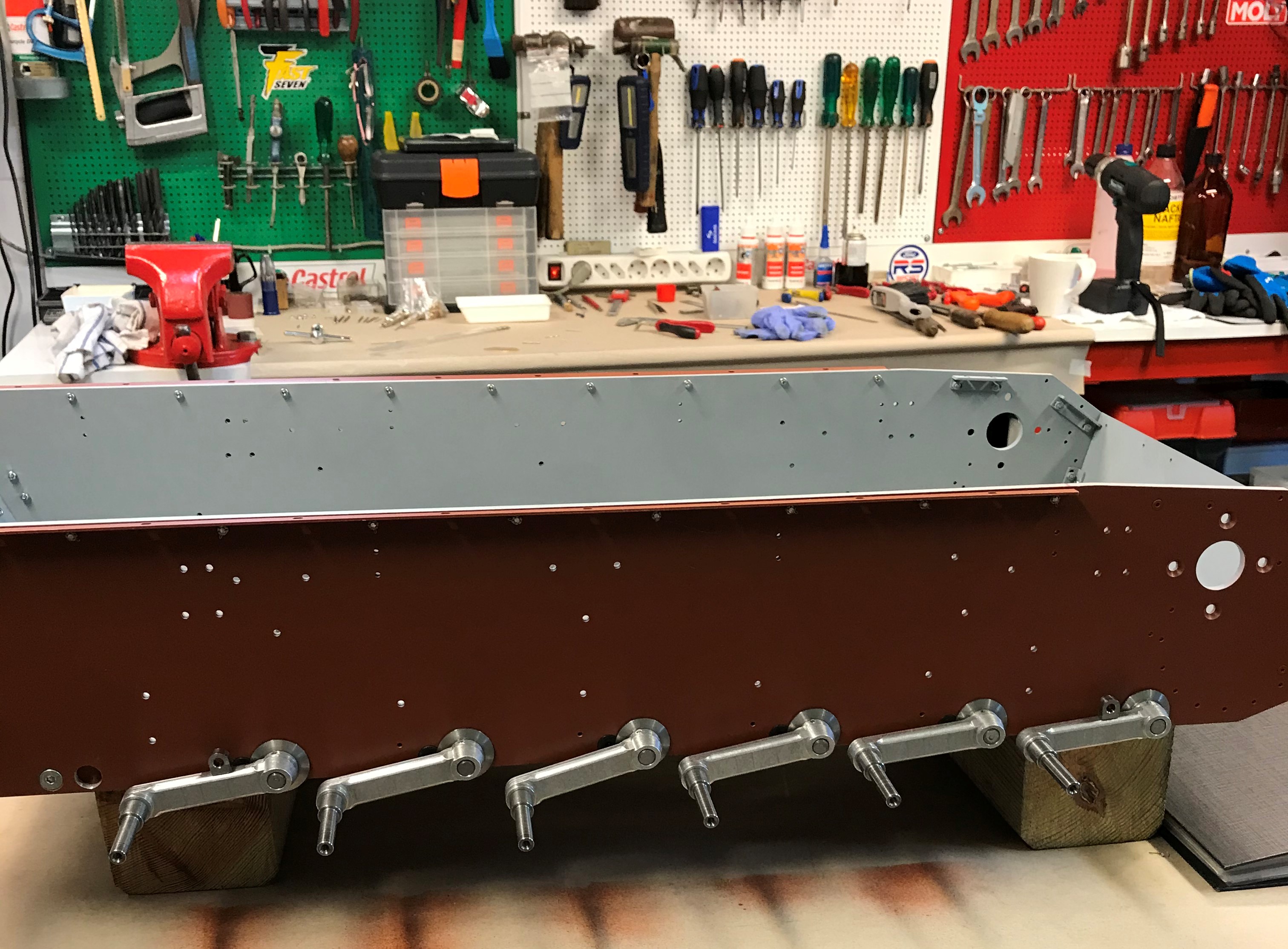

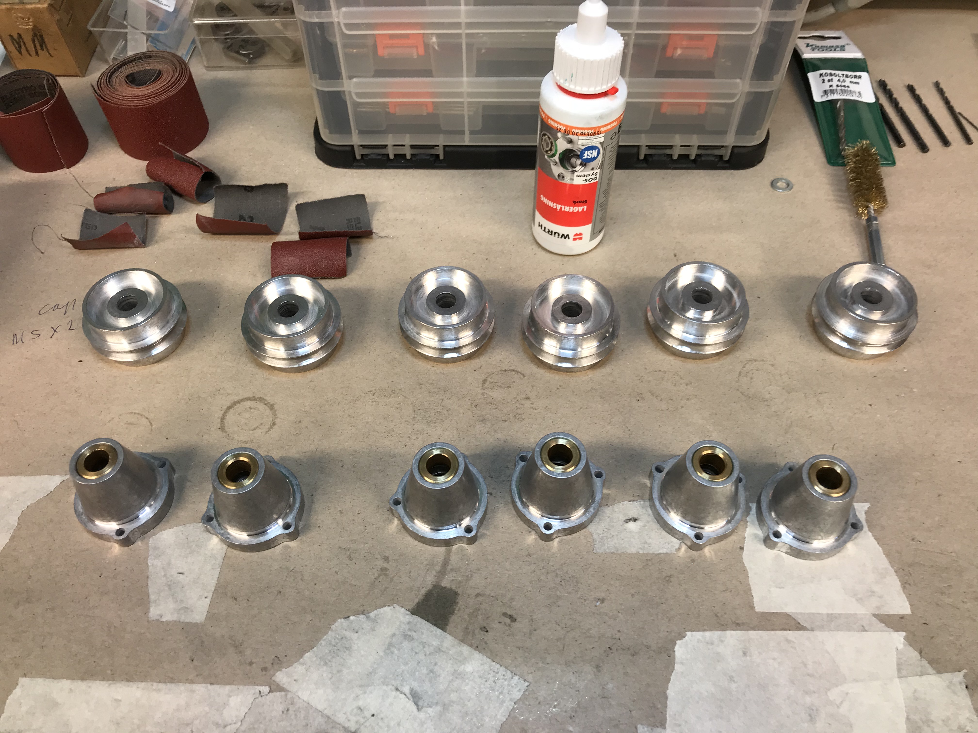

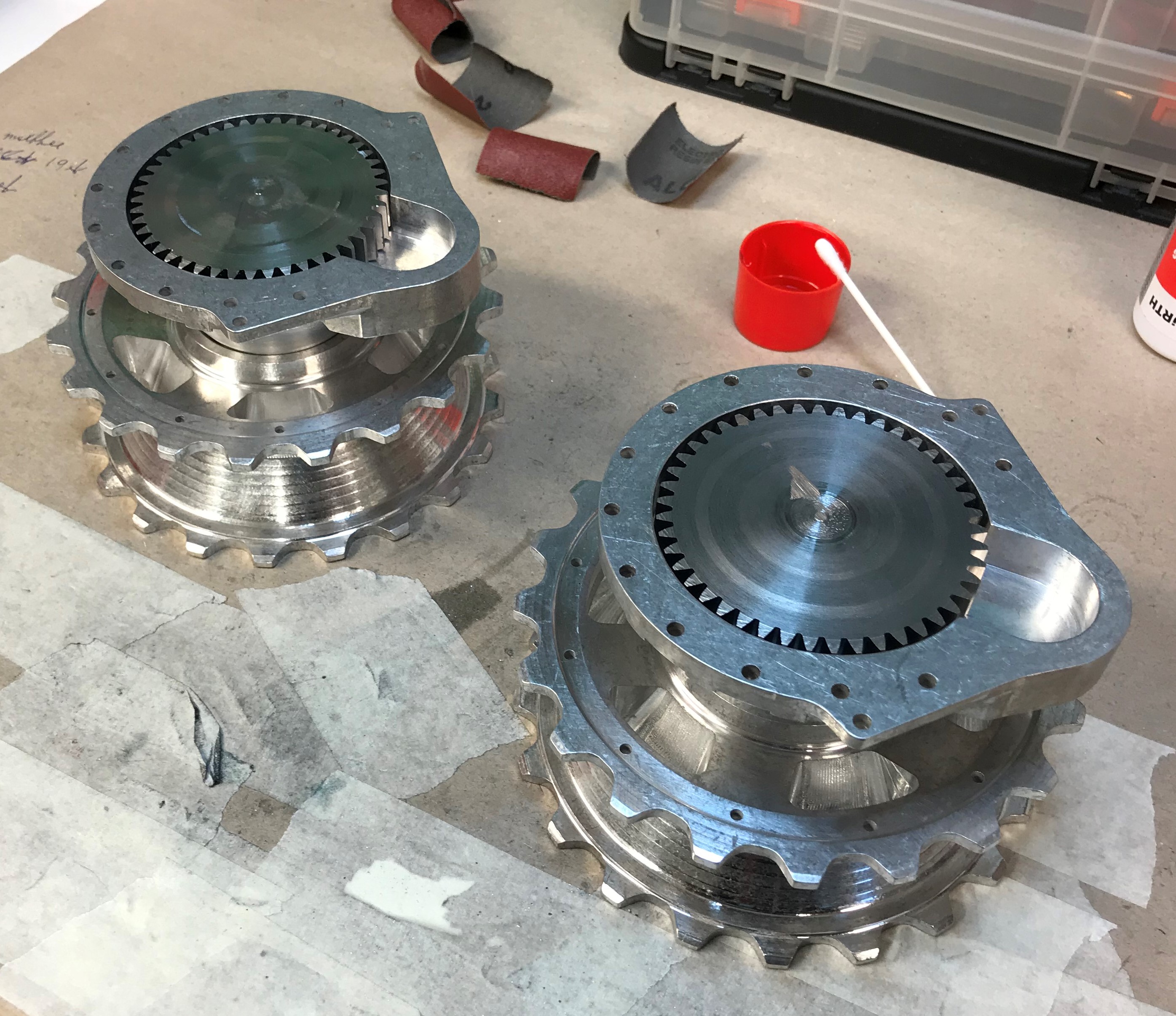

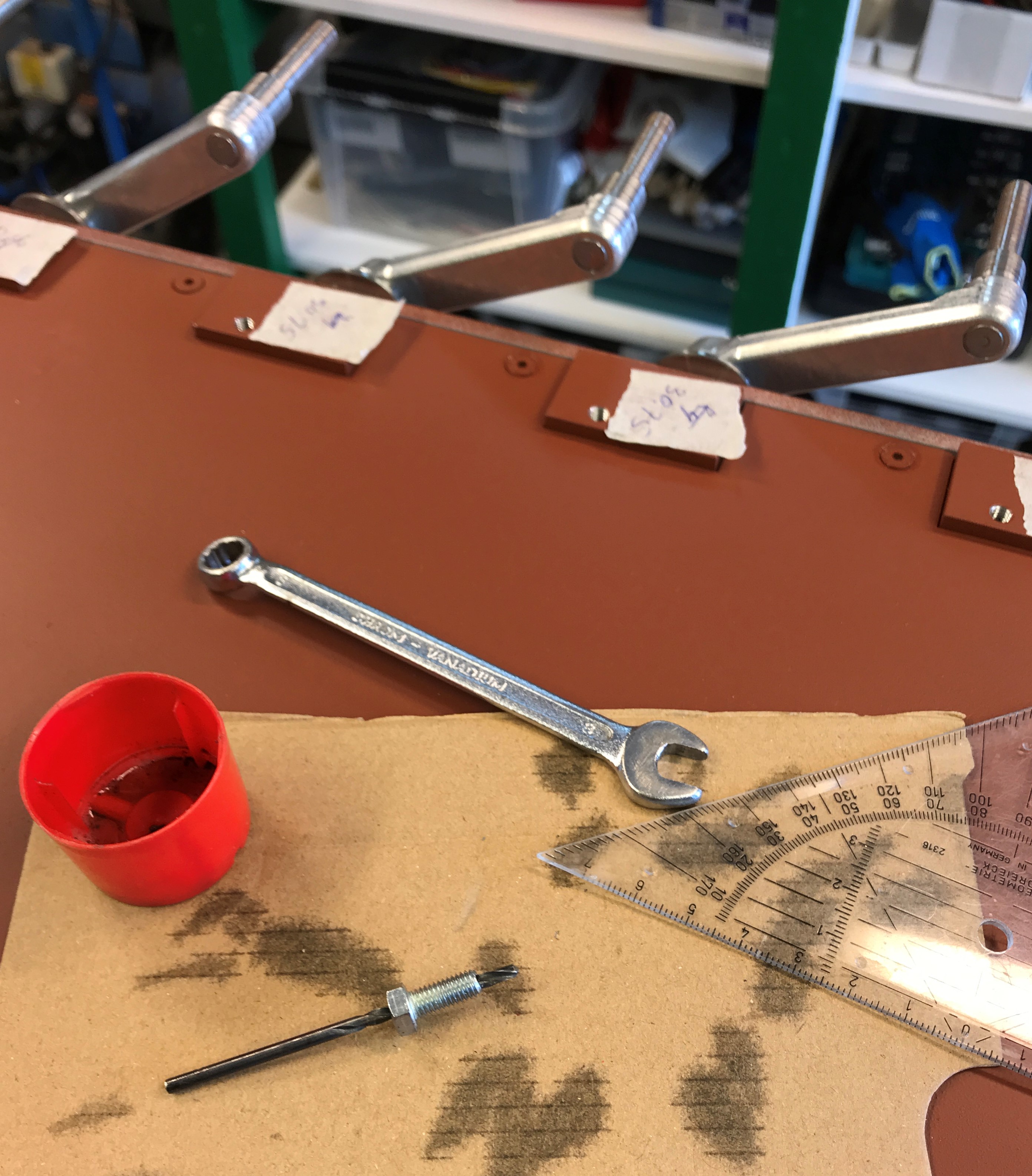

Cleaning alu parts, try to prepare for paint.

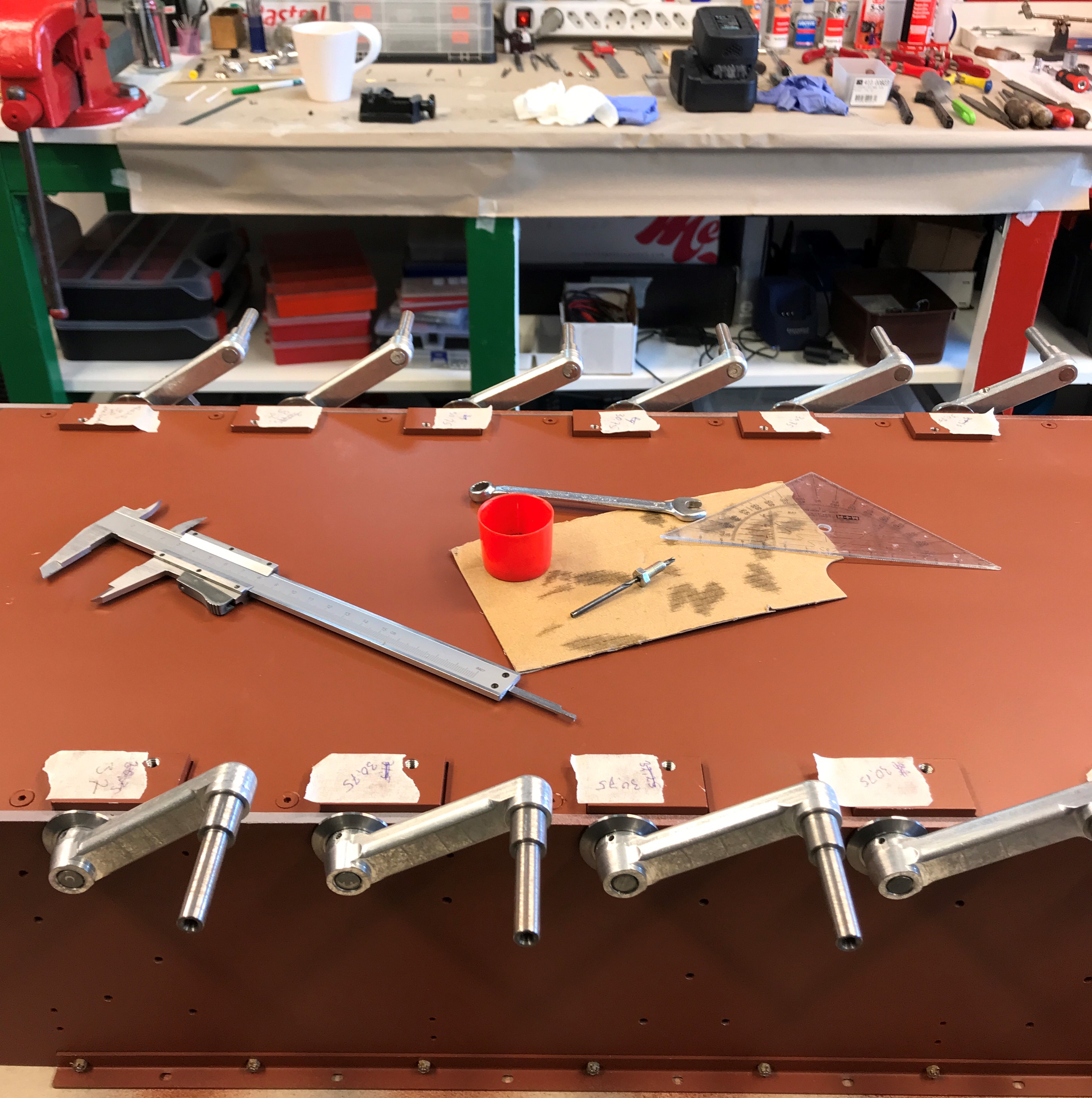

And try to get a hang off this suspension thing ,but I got stuck .

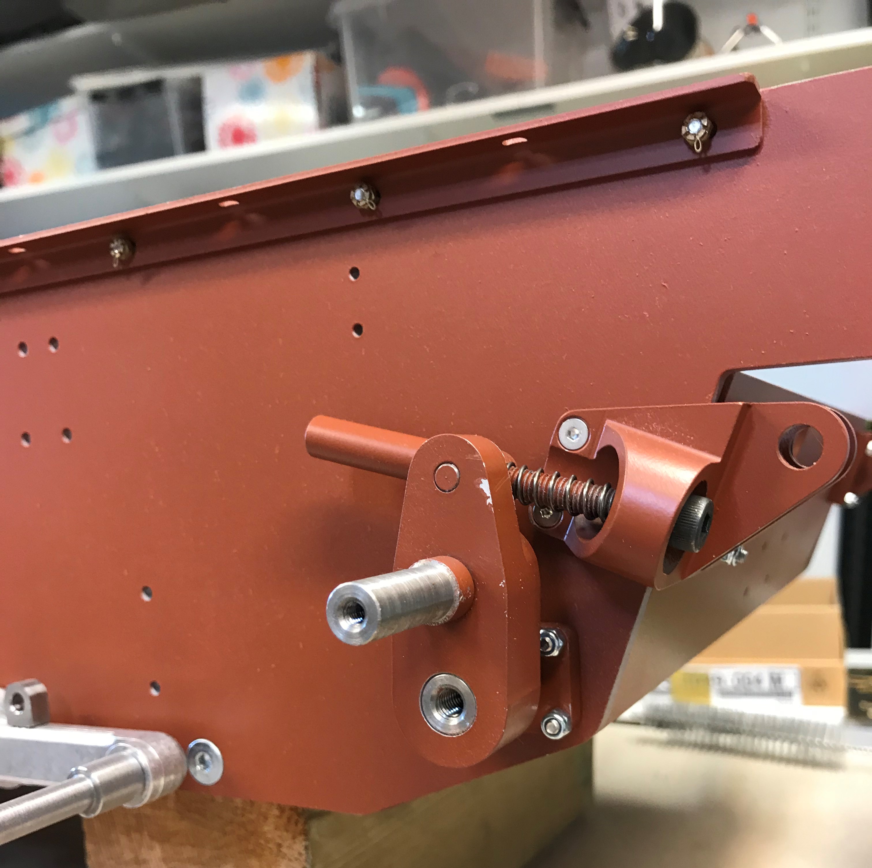

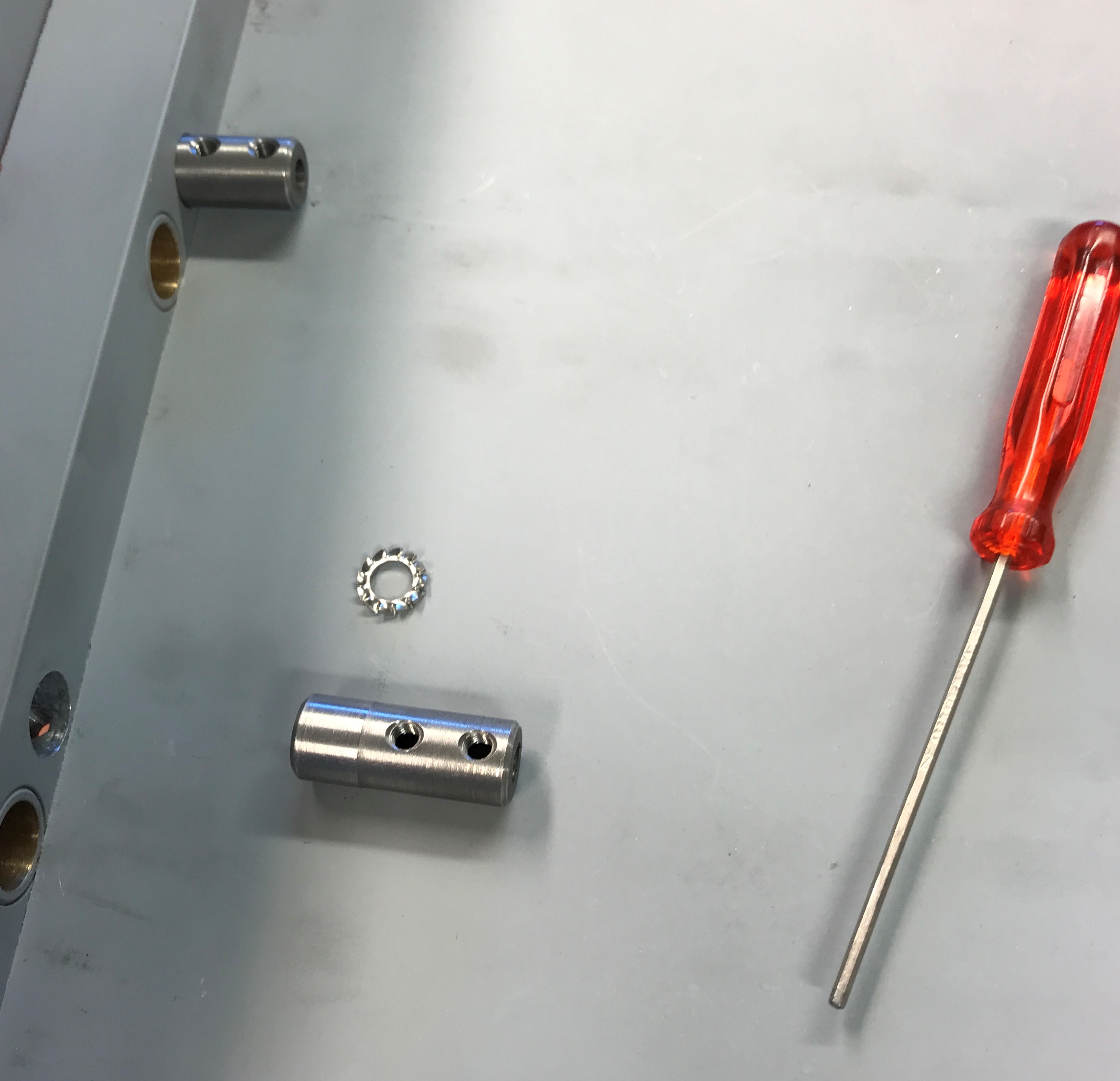

So I have a newbie question :oops: , How would you set the CL0205 to CL 0204??
Left is tighten to the bottom the grub comes on the down side, Right one I guess could work but still a bit low :?:
Or the middle one :?: :?: Or doesn´t matter?
Kind regards from Björn

Good morning Bjorn, With my StuG build I fully tightened CL0205 to CL0204, and then drilled through for the pin. If you choose this route you will find it difficult to reach the internal grub screws on CL0205...should they become loose, they will be underneath CL0205.
There was a time however, when I noticed my suspension was low at the front end. and needed to be reset. I was unable to reach the grub screws and therefore had to remove the complete internal assembly. By this I mean internal fittings motion/drive motors etc,. It took most of a day to disassemble, reset the suspension angle and then reinstall. I suppose looking back I would have set CL0205 so that the grubs where on top. Having said that it will be your choice, just make sure the grub screws are tight. Either way works....Mick
Posts: 5118
Has liked: 1475 times
Been liked: 1673 times
Re: Stug III 2020 57
I would have thought that if you don't tighten CL0205 to CL0204 then the alignment will be out slightly.
Unless I've missed something, when adjusting the suspension, you should only need to loosen the fixed end screws and rotate the whole torsion bar assembly, so no need to access the grub screws. Unless they're loose of course.

Ok thank you guy´s ,then I can continue :)

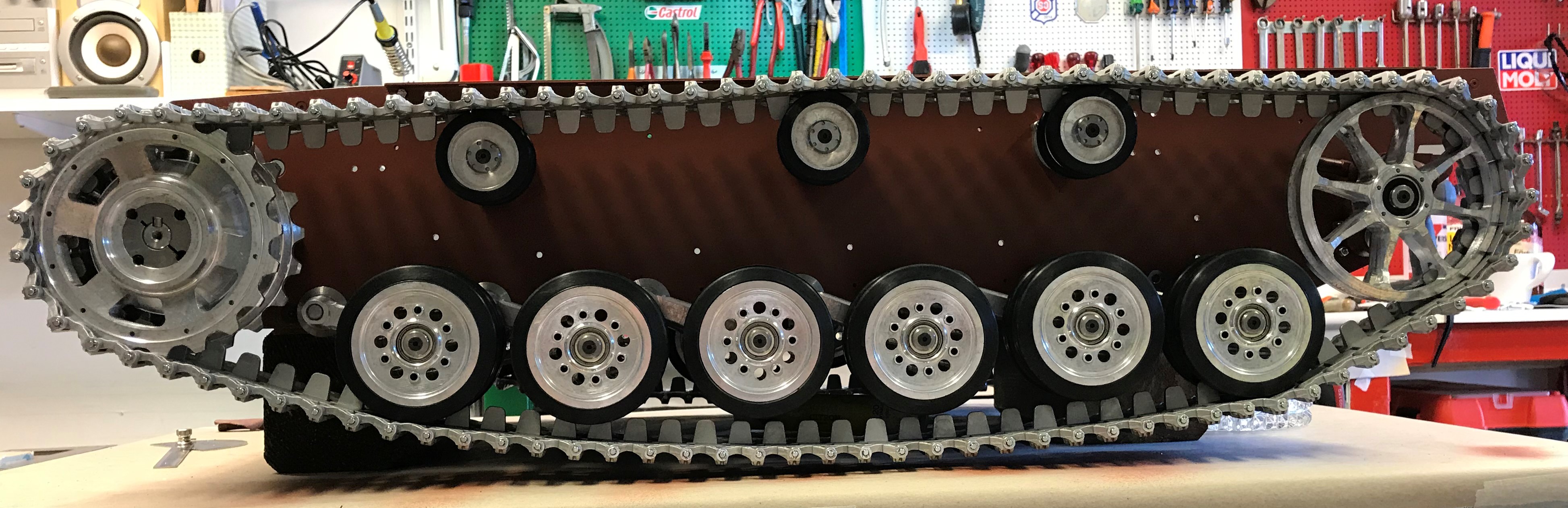

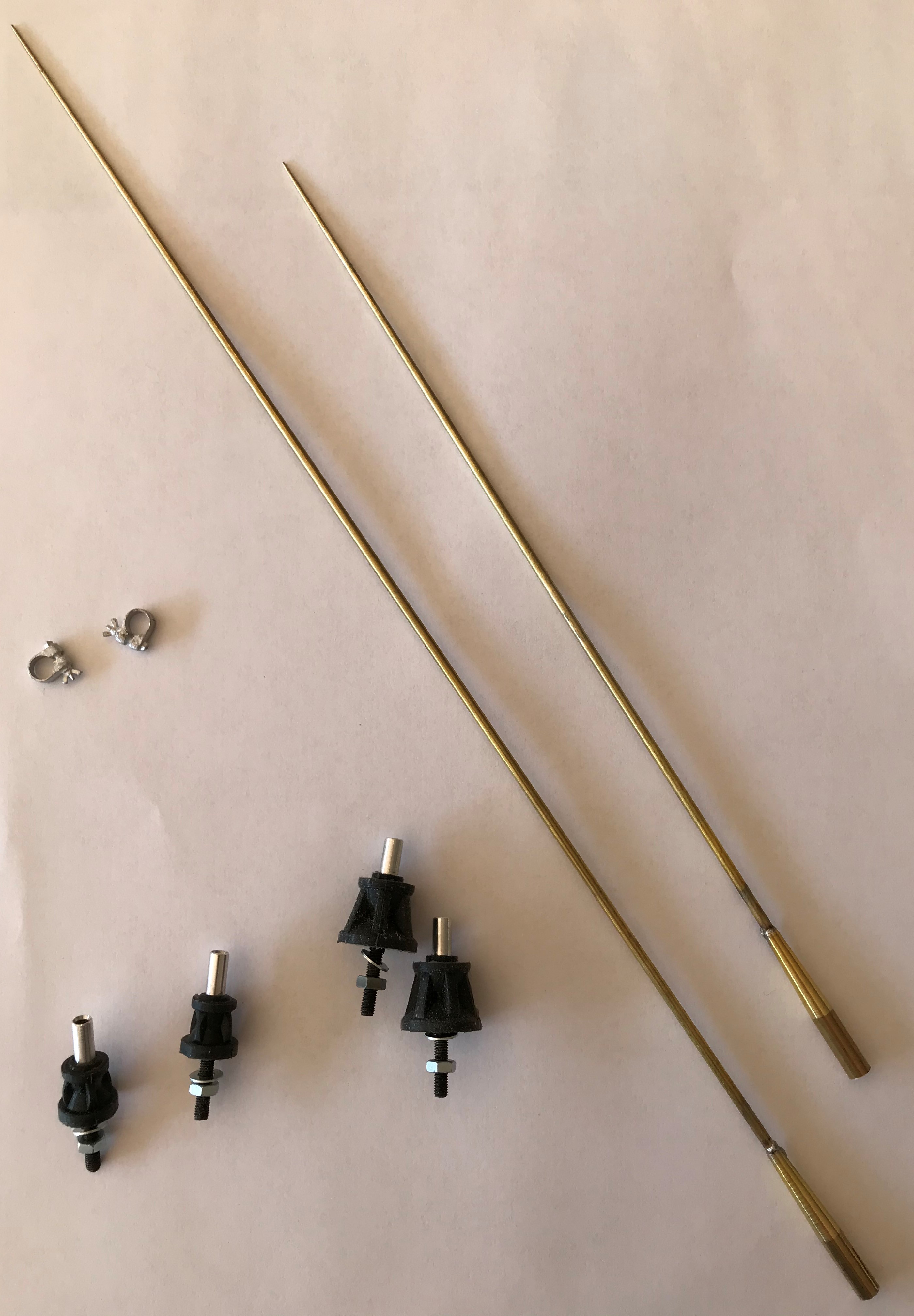

Some small update from the 57 th ,
Did some small adjust to the track tension so it line up properly.
Think I will try to put on a gaiter , off some kind.

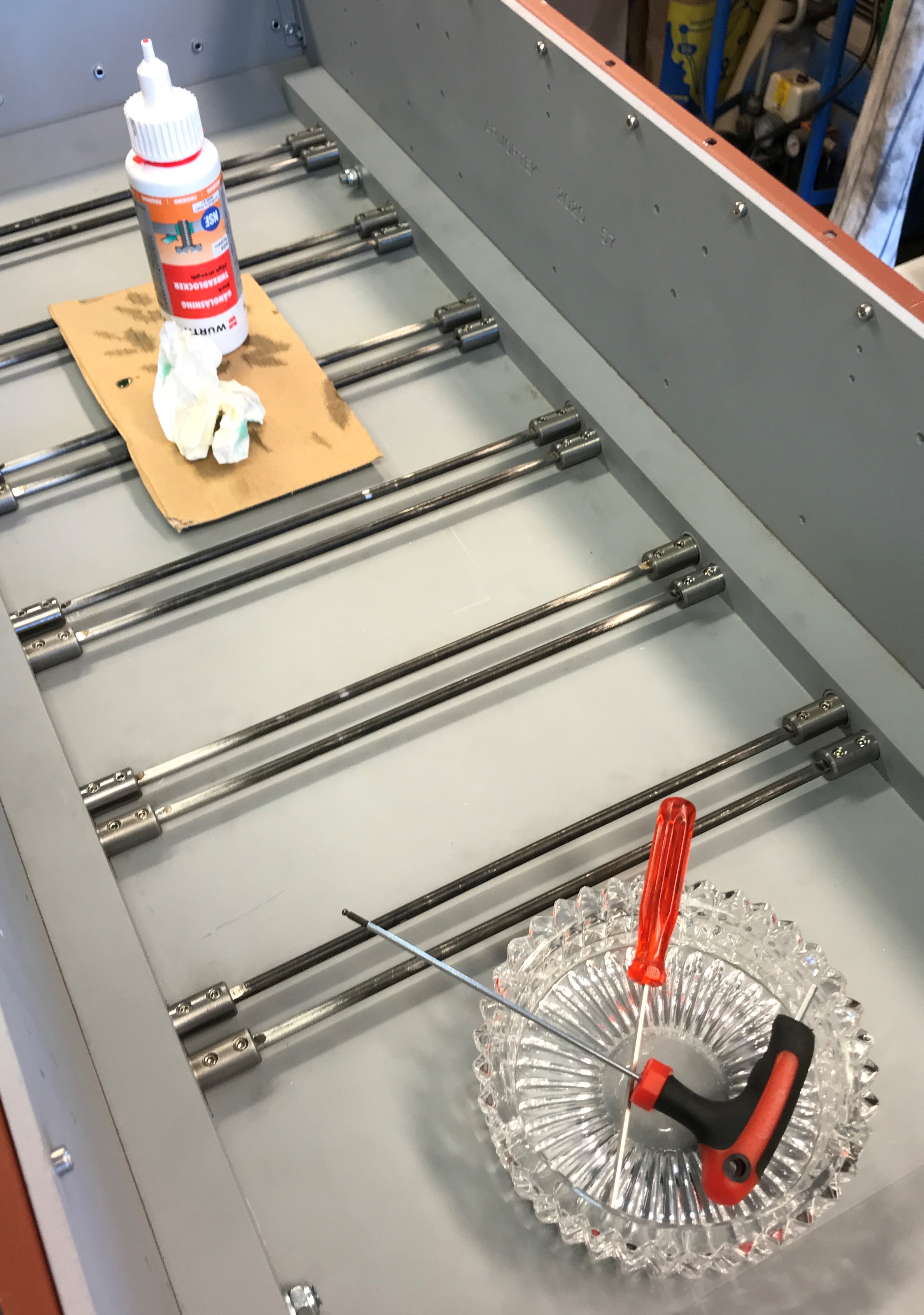

Also got all suspension arms done and dry test for movement/etc .
Otherwise most cleaning alu parts fitting bearings etc

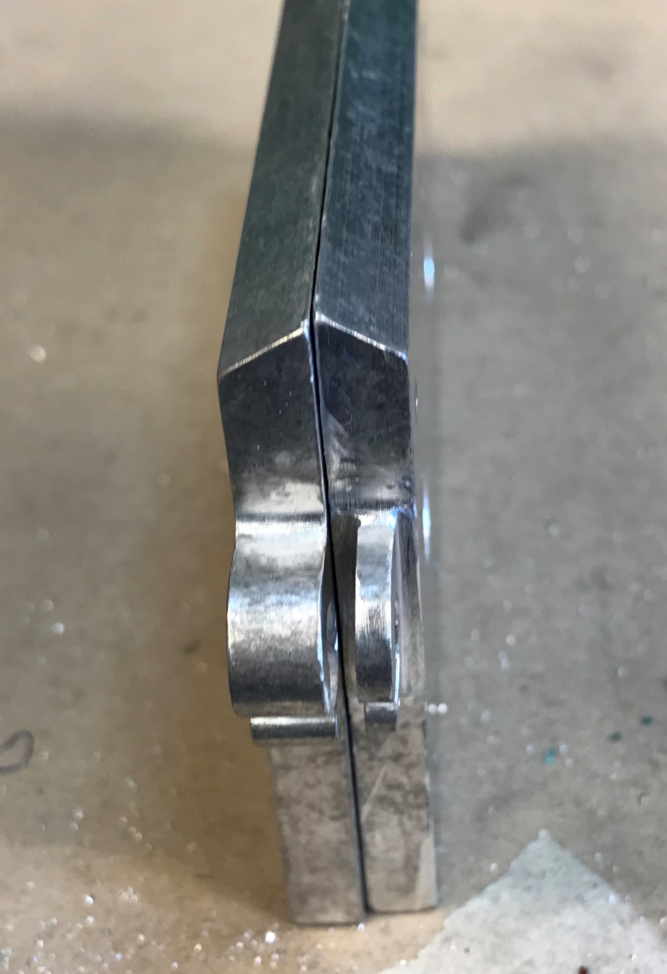

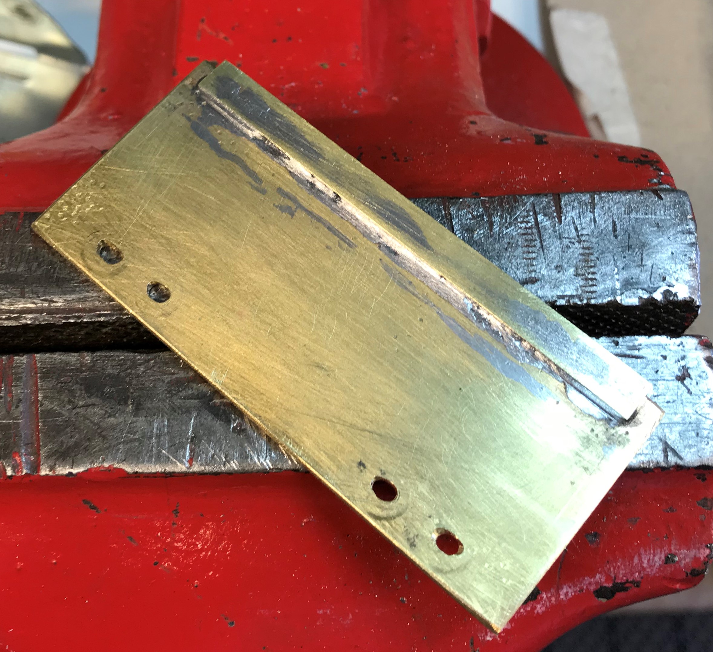

Started with a vital detail for a Stug , no 3D print here wish I could. Only the hard analog way :wink:

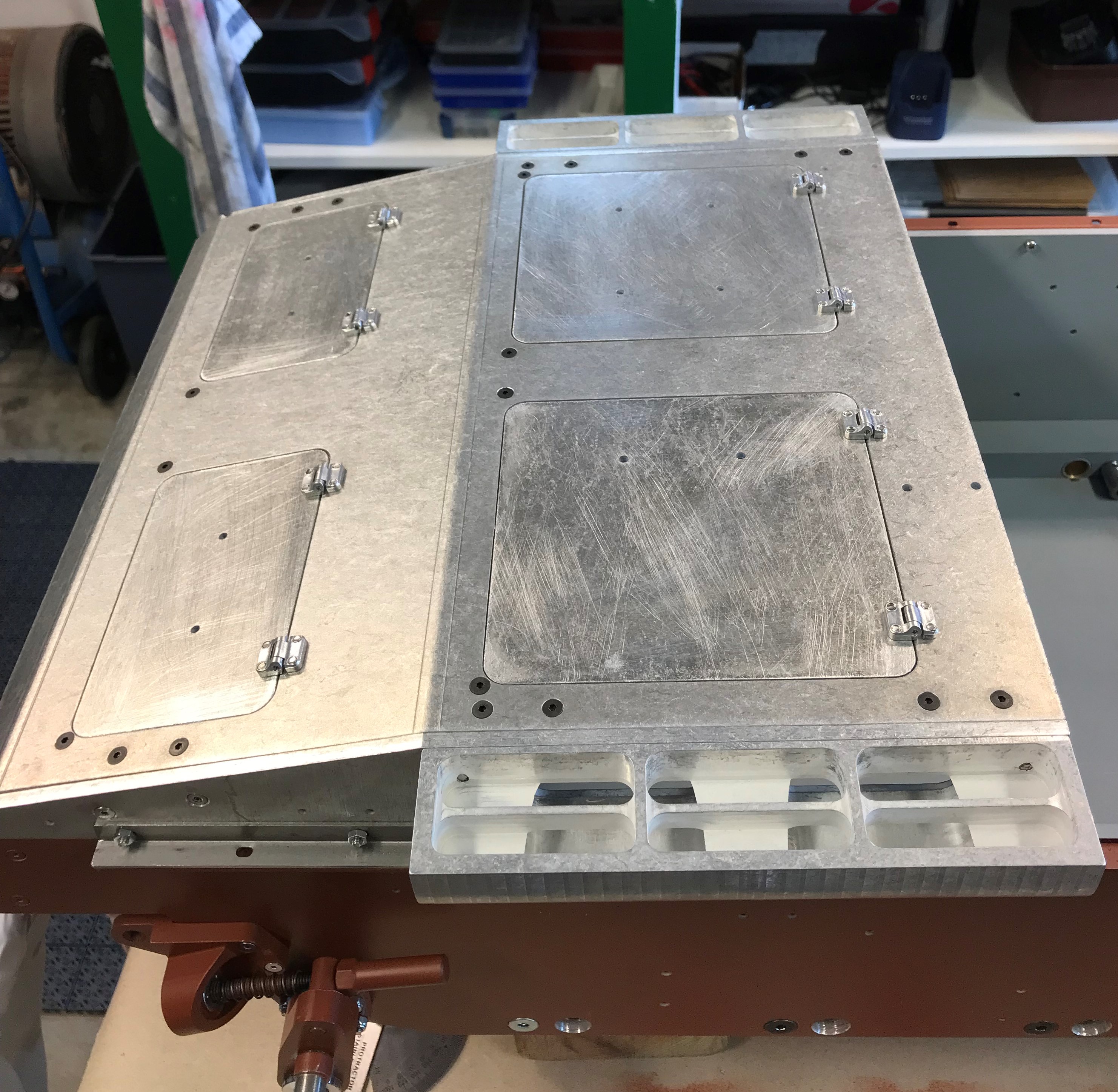

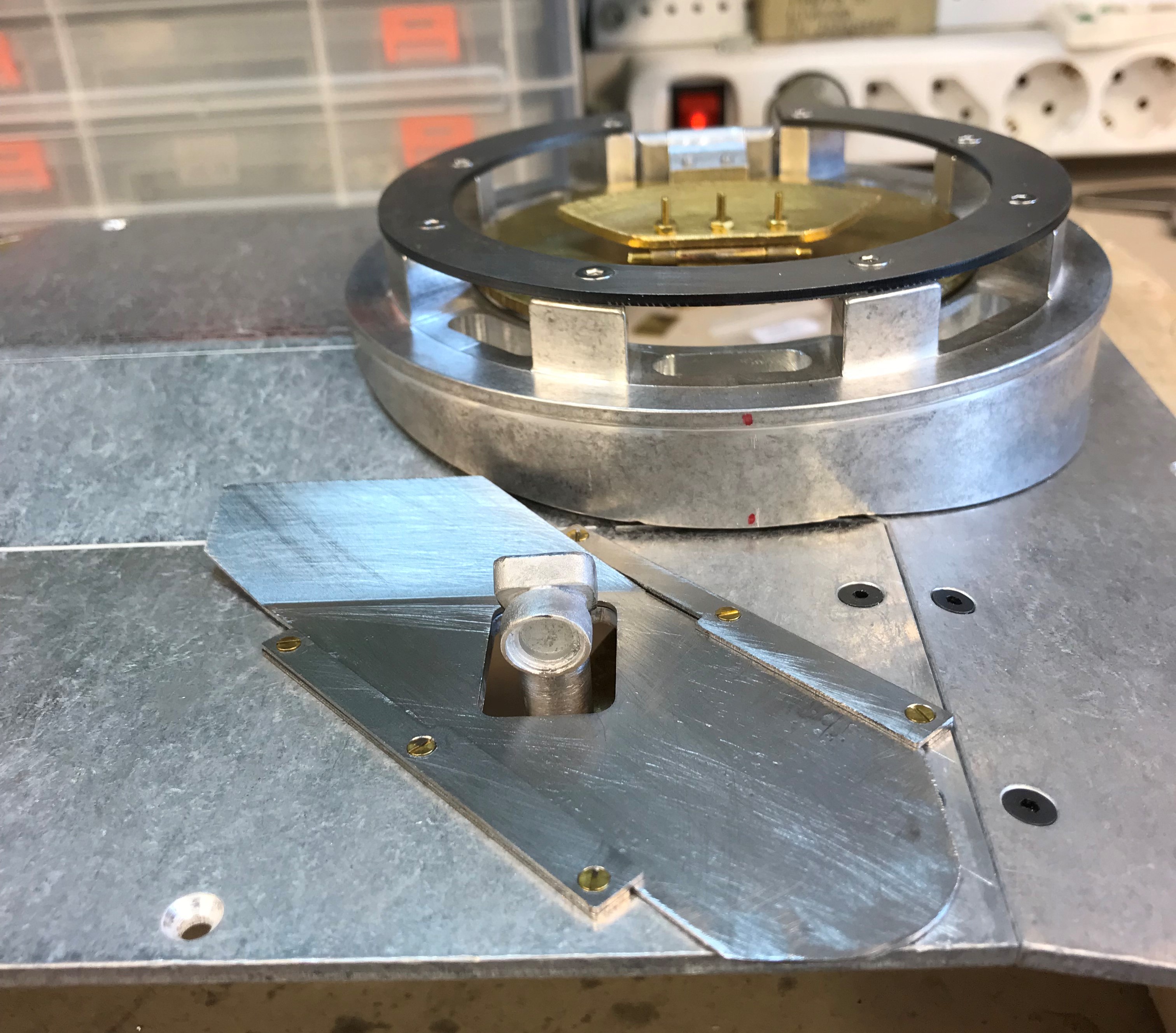

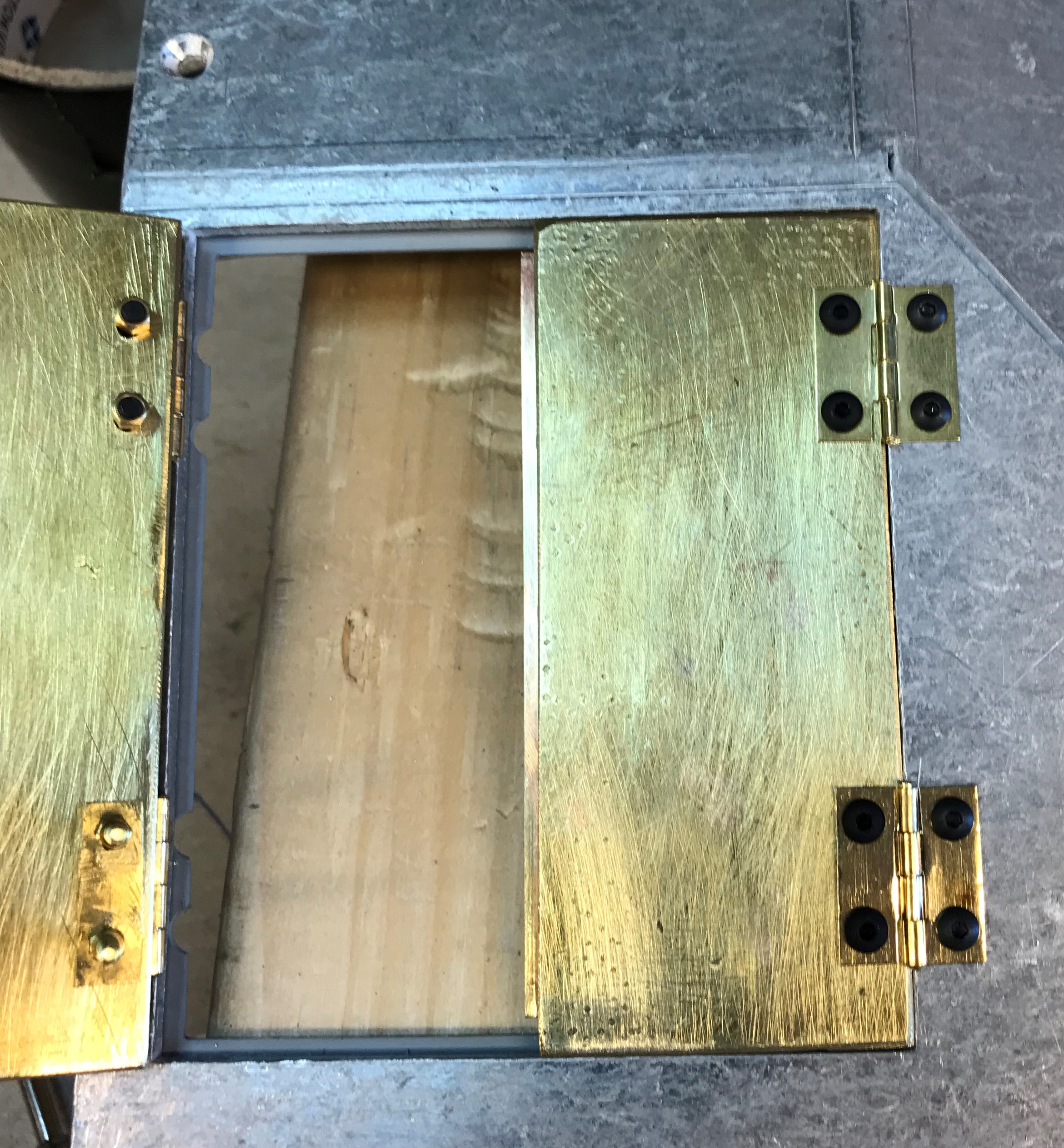

Got some time to do some small work today.
Aint gone use the drill :wink:
Not sure off the bolts yet :?
A bit rusty after 7 years, absence must say.

Great work on the hatch there! And with the scopes in place it looks great!

It does not appear that you are rusty Björn.
Nice work you made.

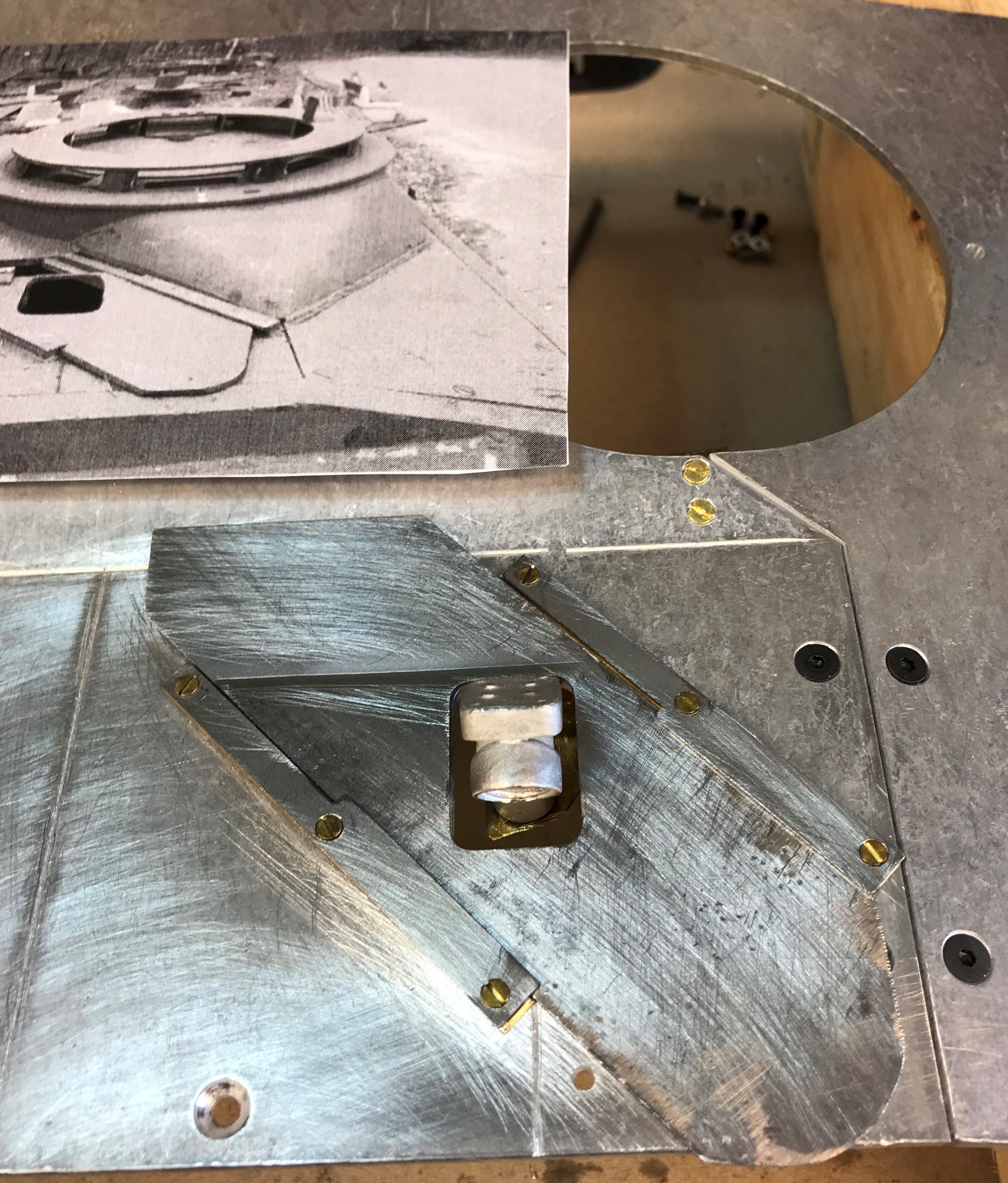

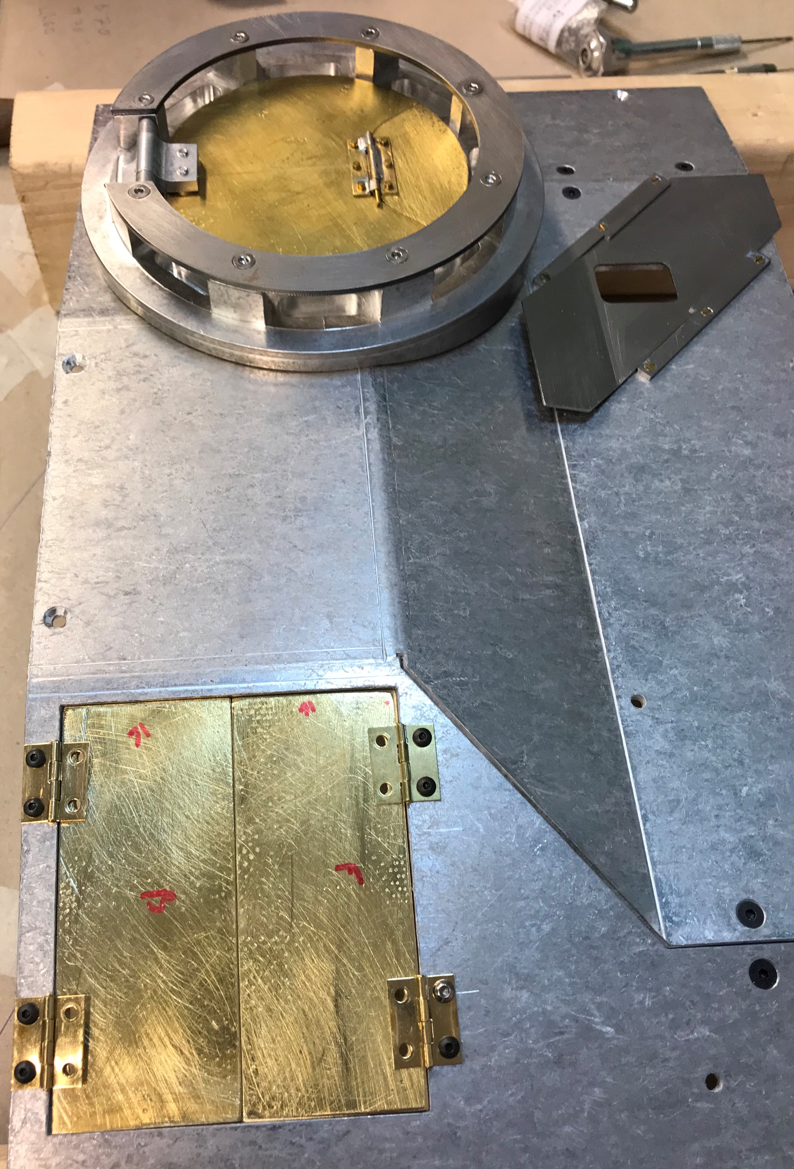

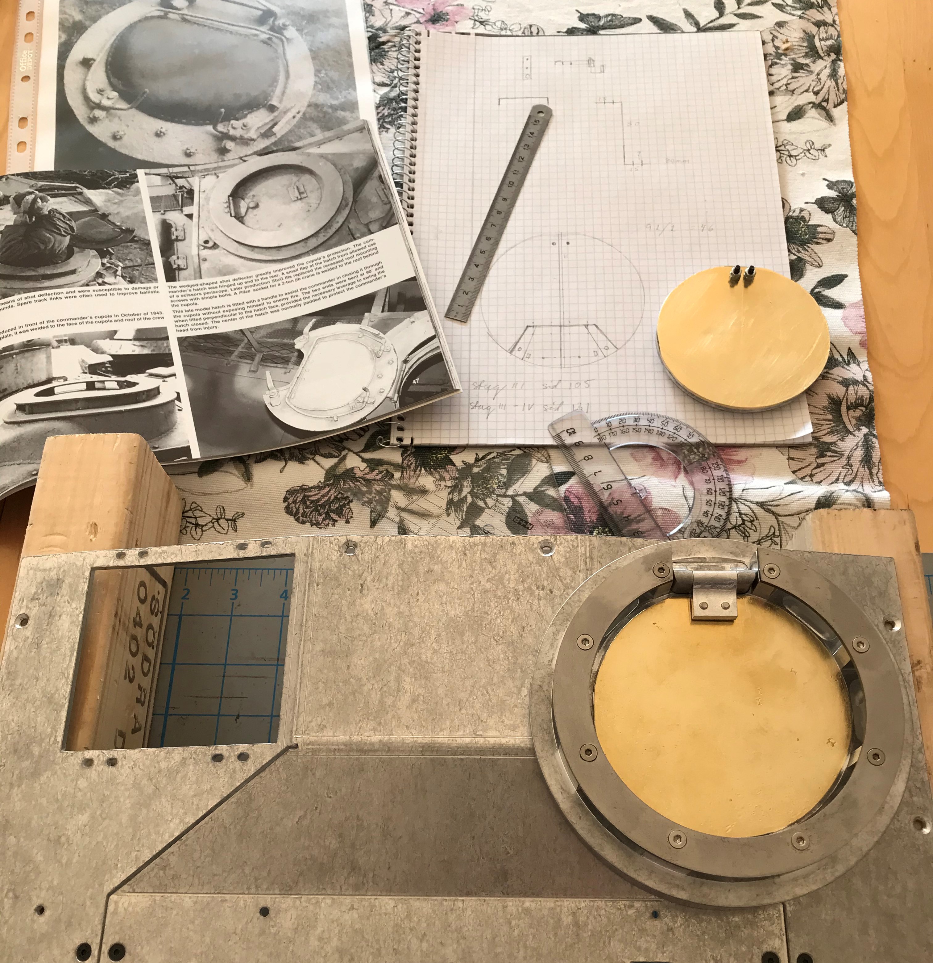

So a little update from 57th Stug.
Been awhile and mostly done the same as everybody else when it comes to Wheel,Tracks etc. Have the all welding left to do etc, not sure how
much I will go about the detail there.

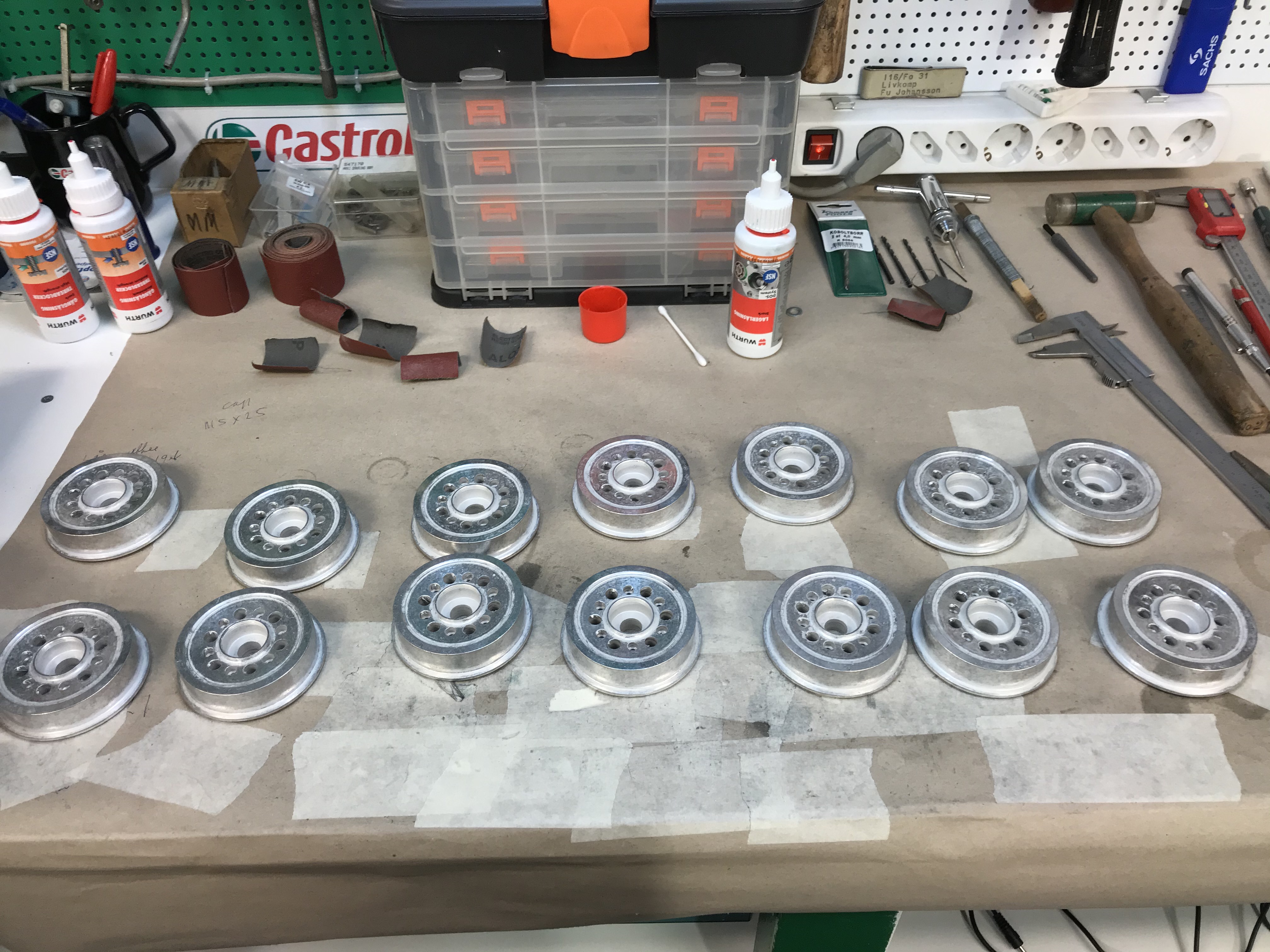

Did a dry fit test just to see how it was lined up , did ok , with some small spacers between the road wheels. to save the track teeth hopefully

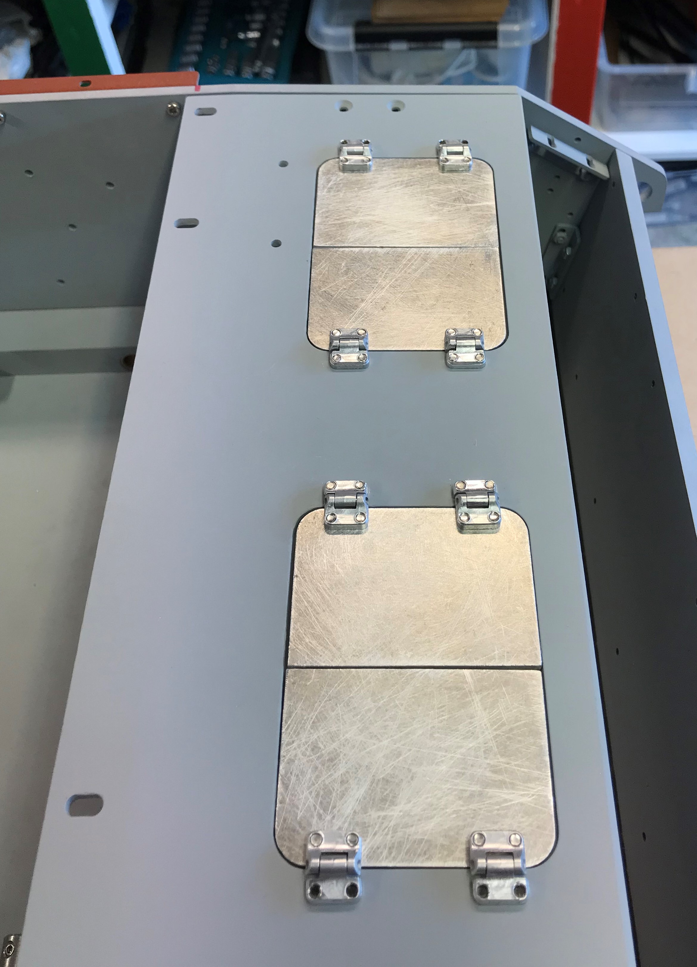

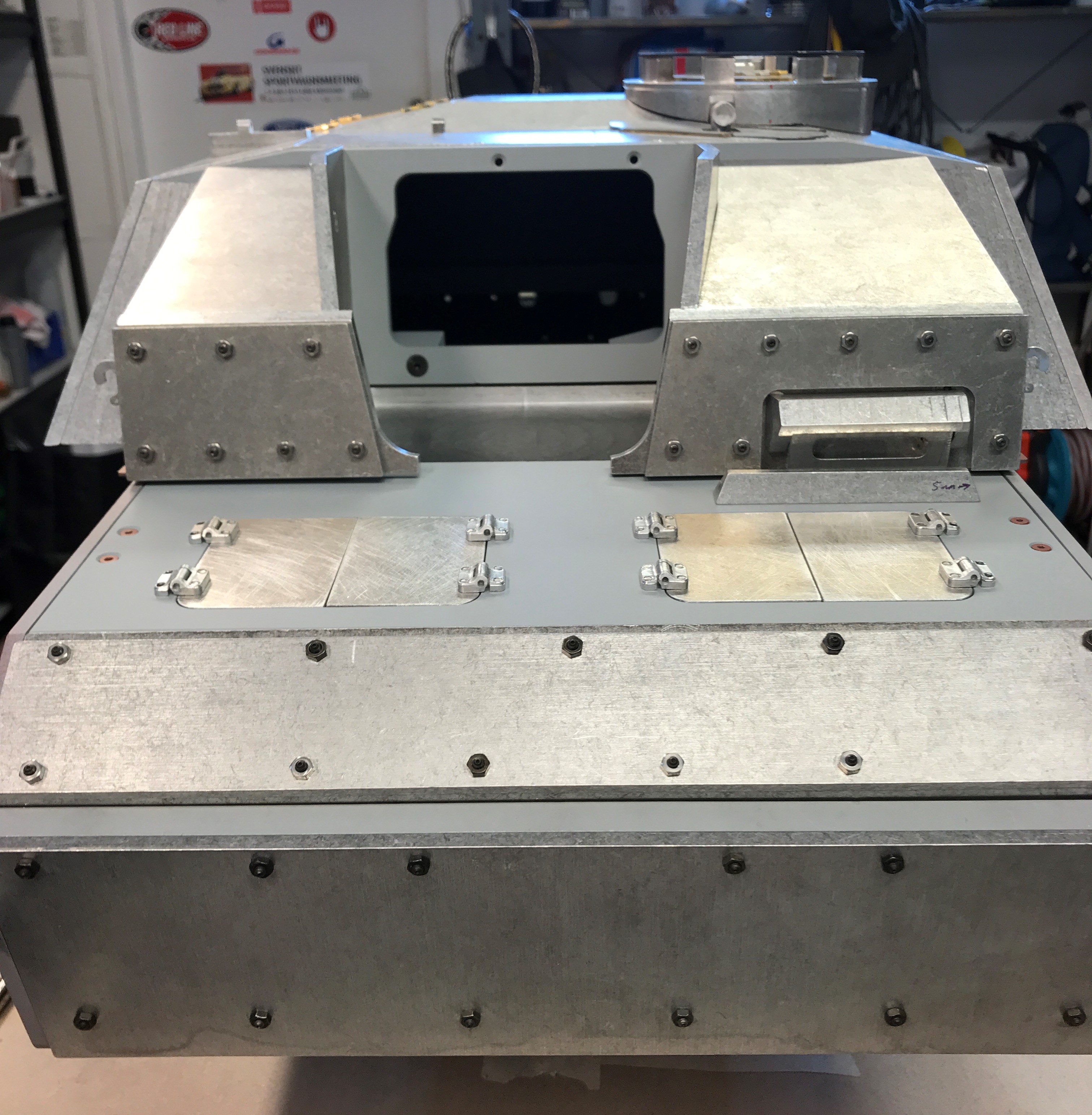

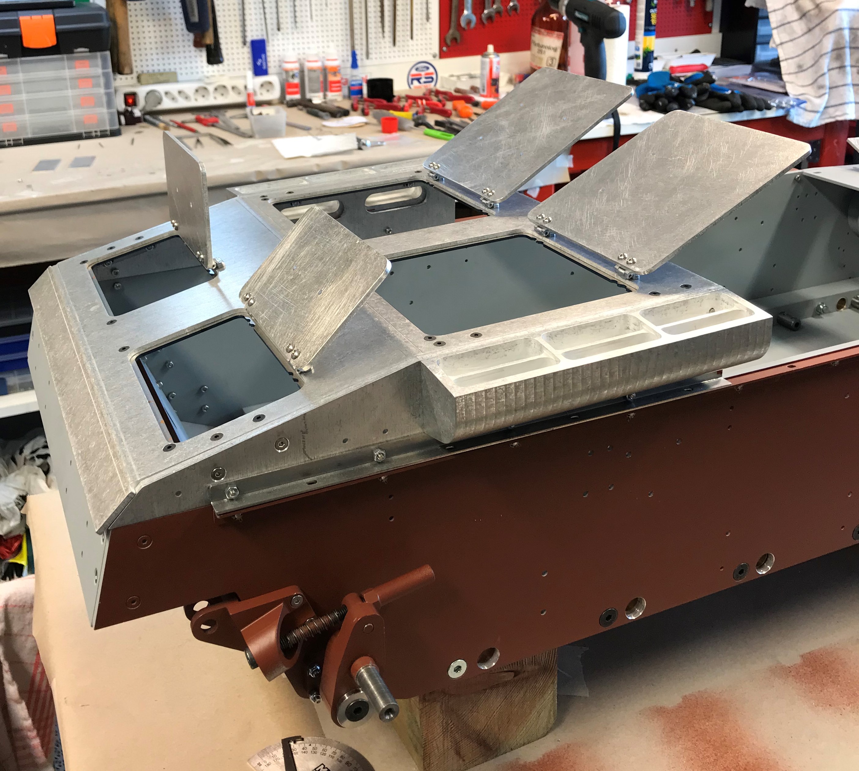

Got all the hinges in place

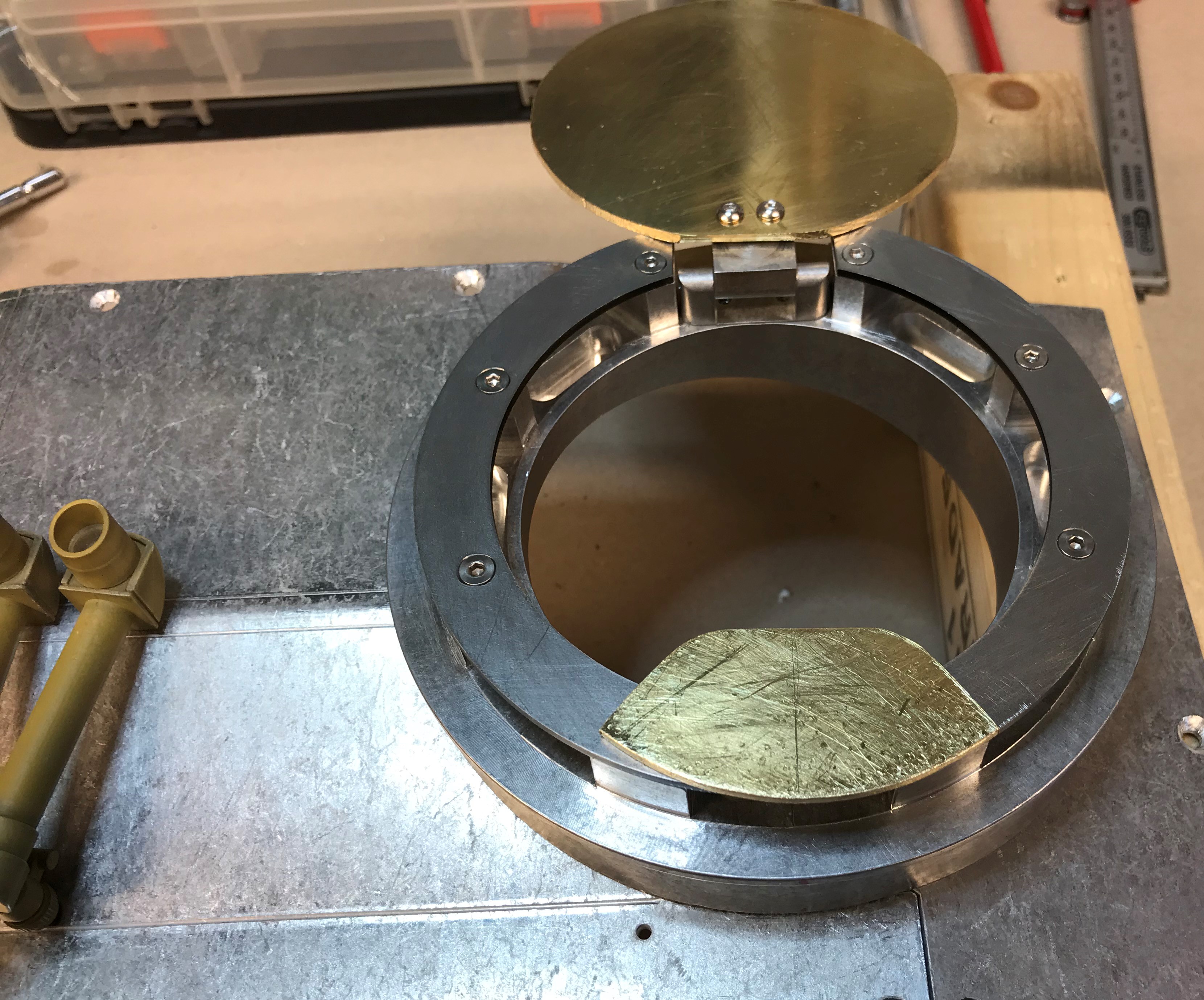

Also done new hatches for the loader and got the gun optic in place ,and did some small adjust to its cover plate. More to come

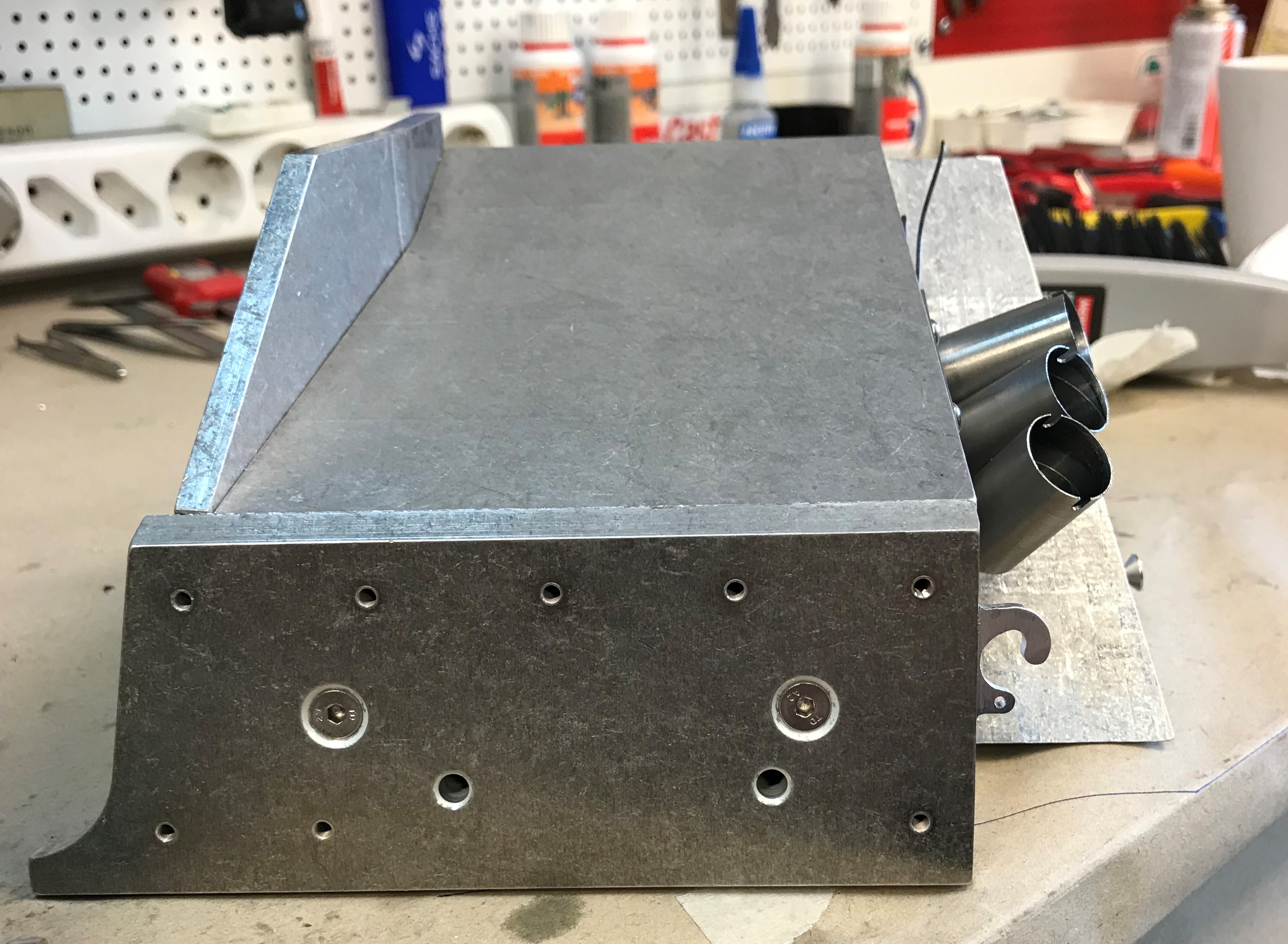

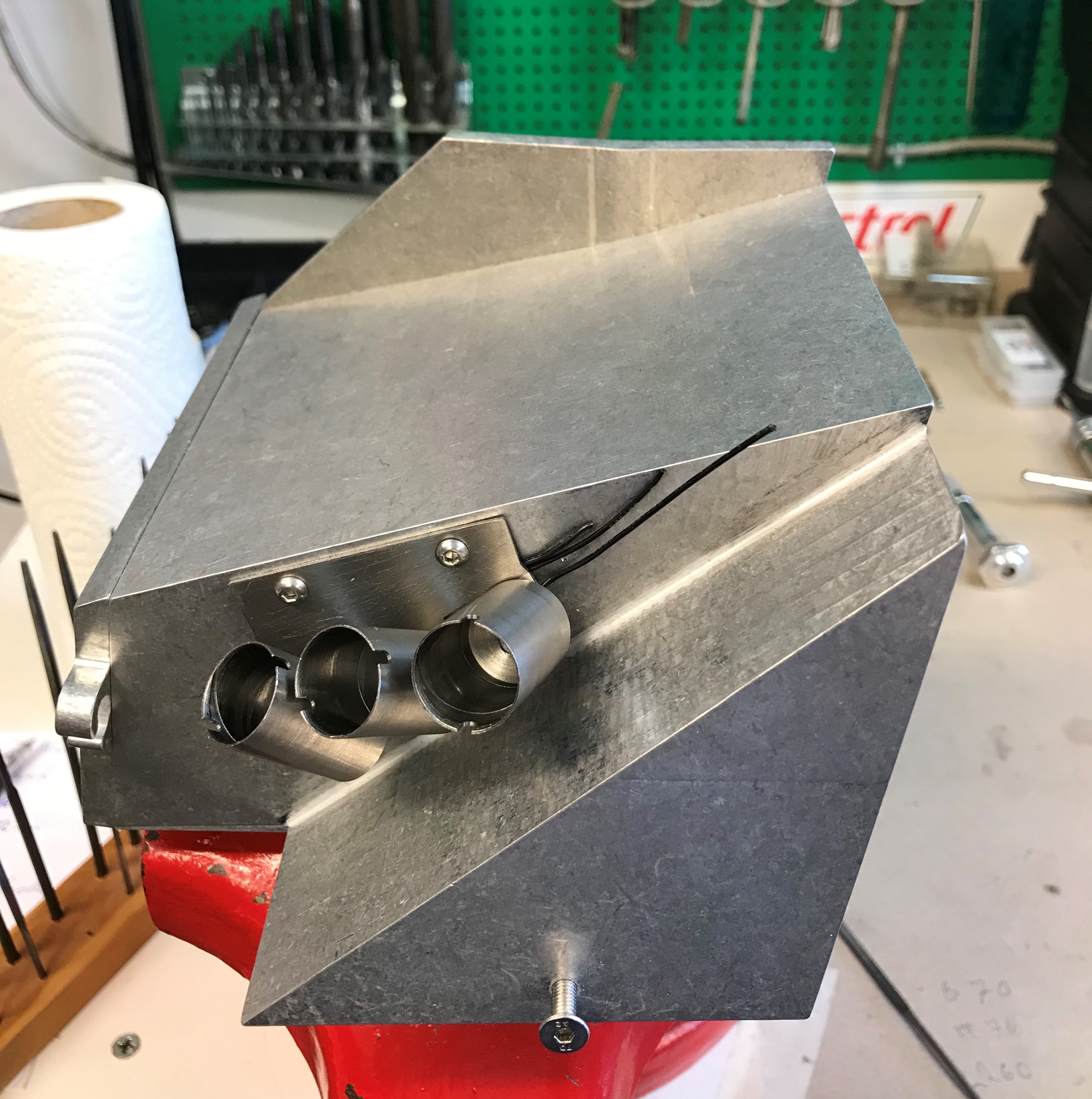

Some small job on the smoke launchers , not sure I use them though ;-)

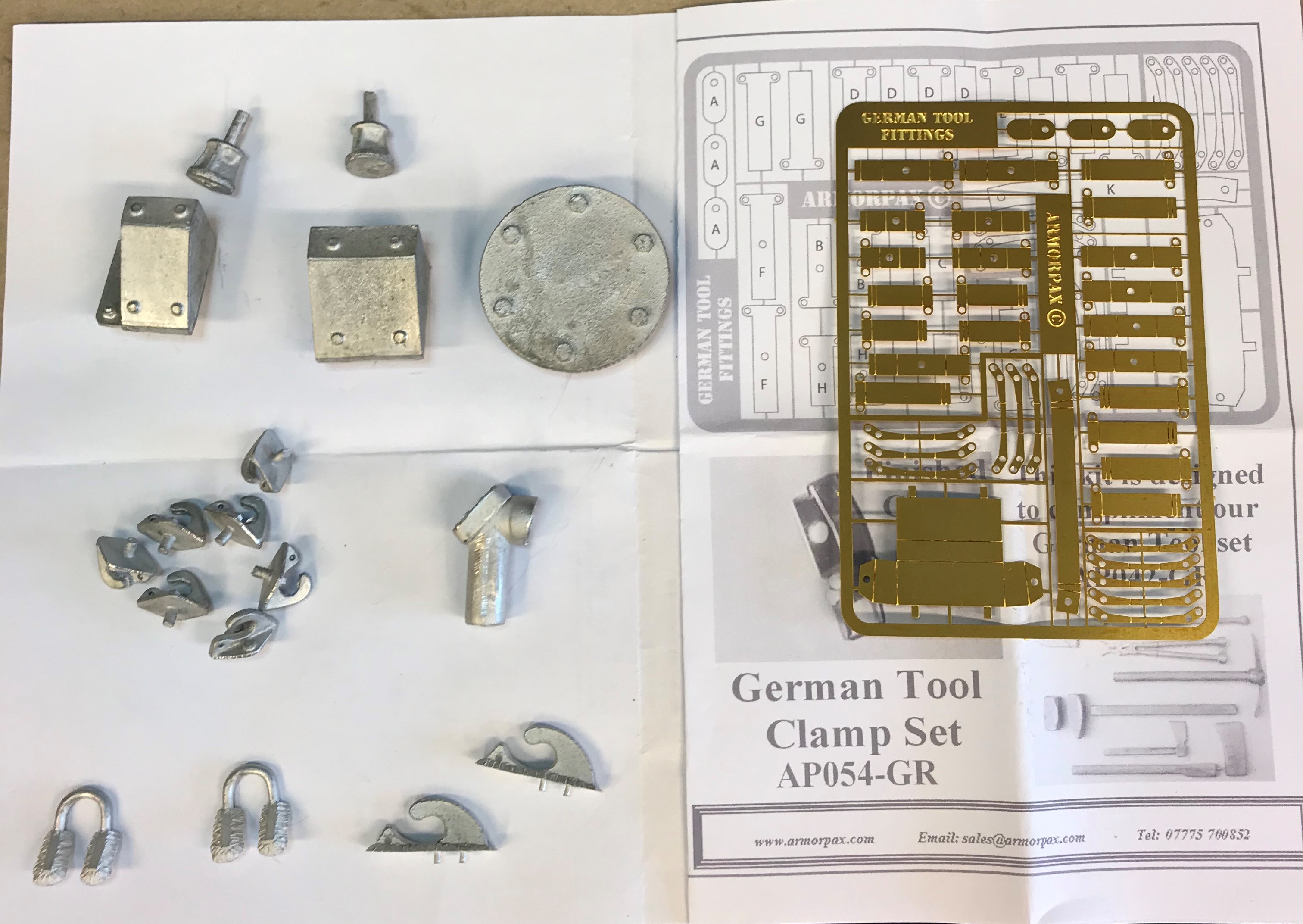

Done som adjust to those lifting hooks on the front armor
Did get some great items from Armorpax and Lawson

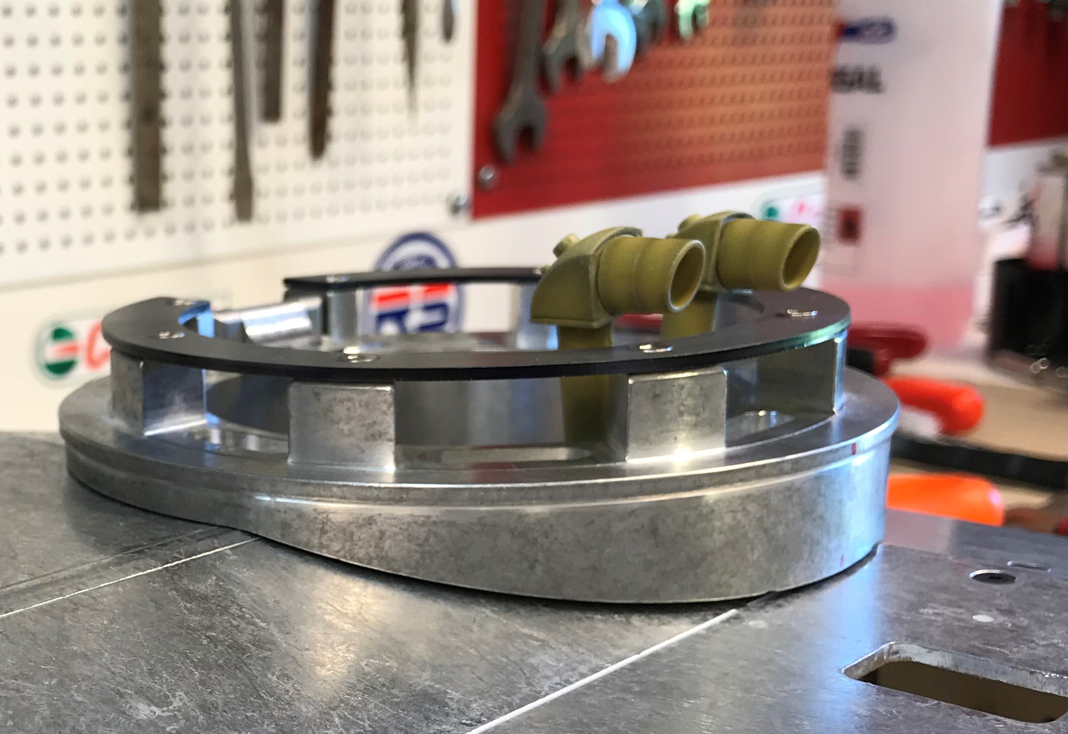

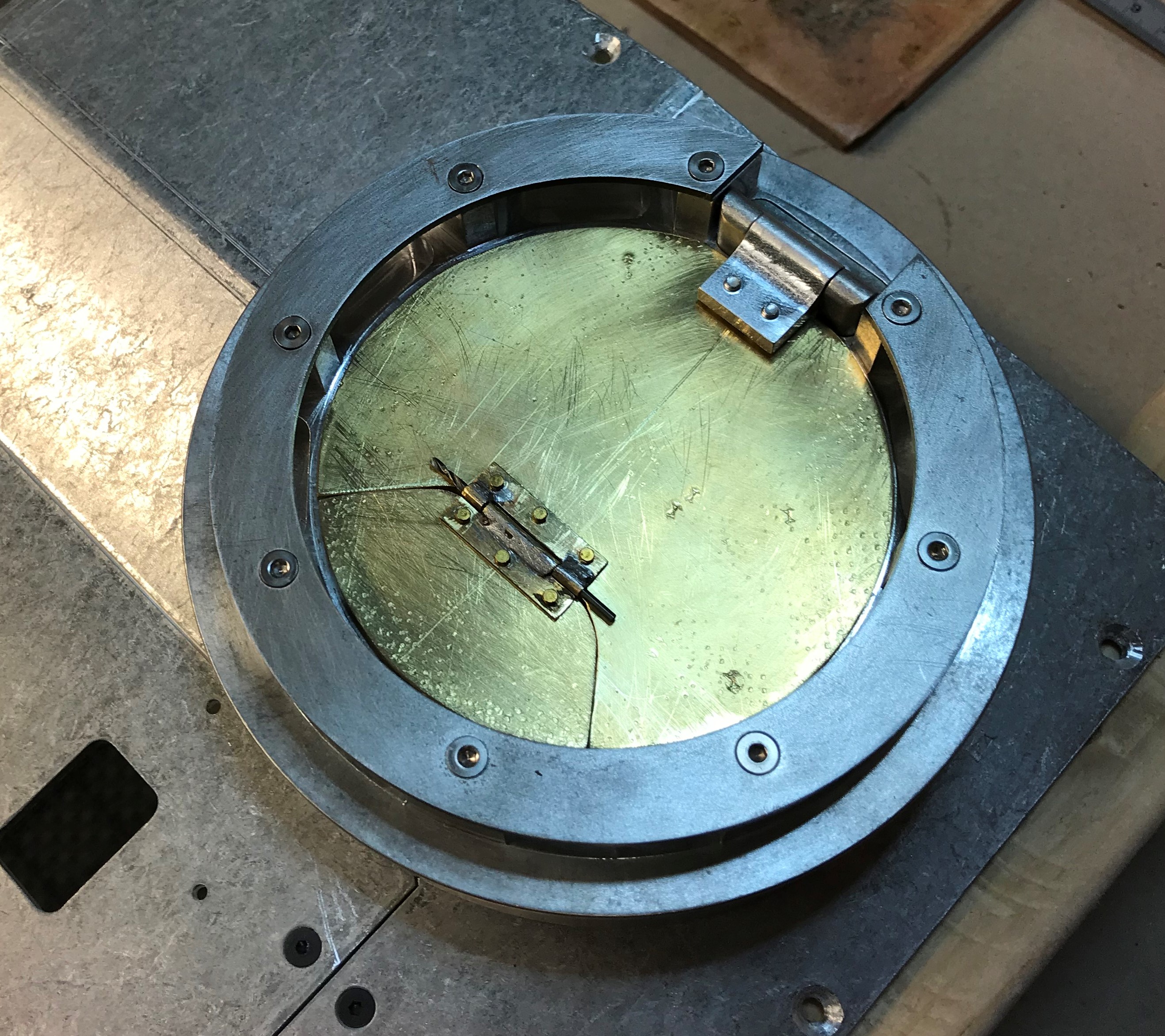

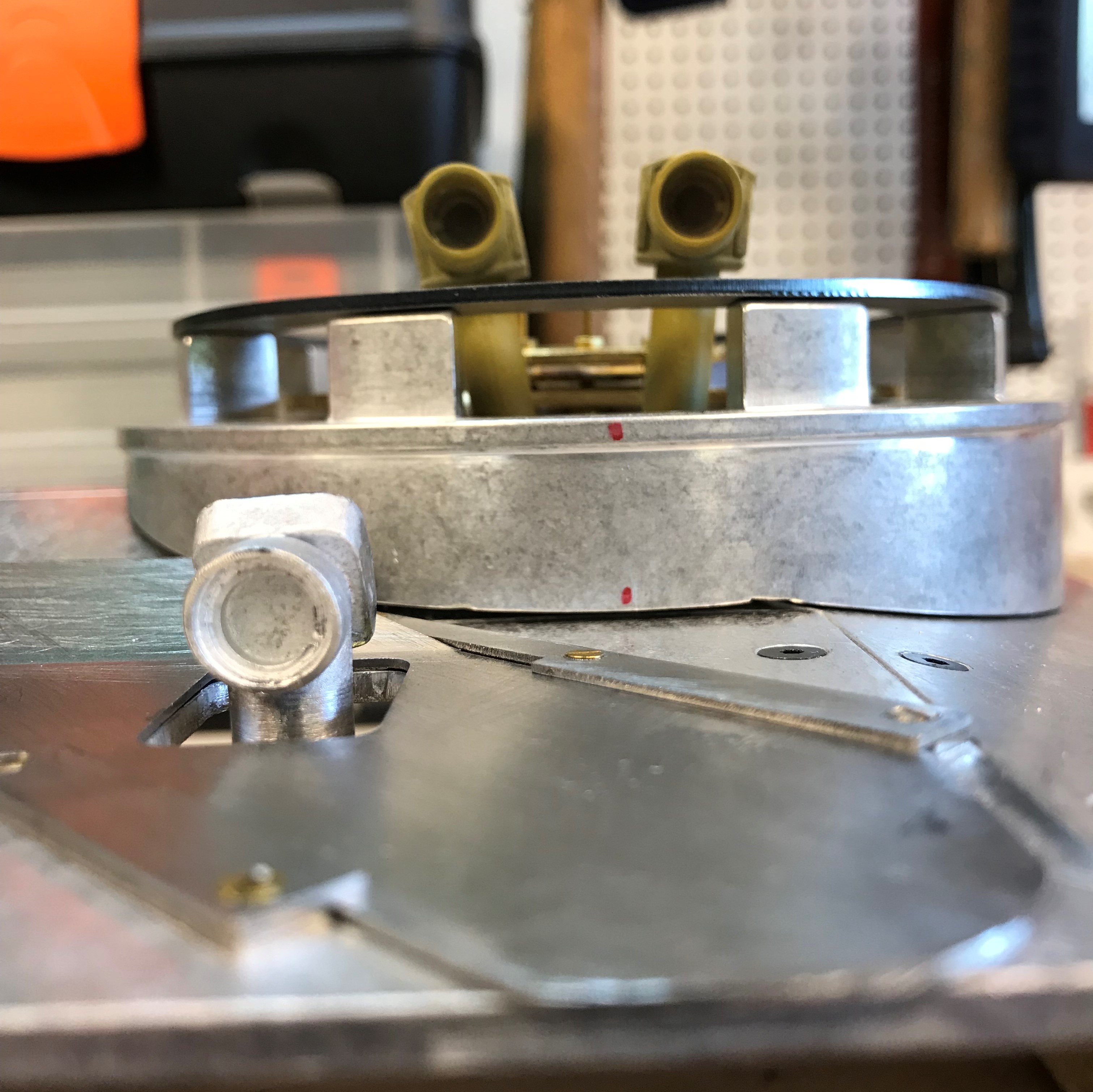

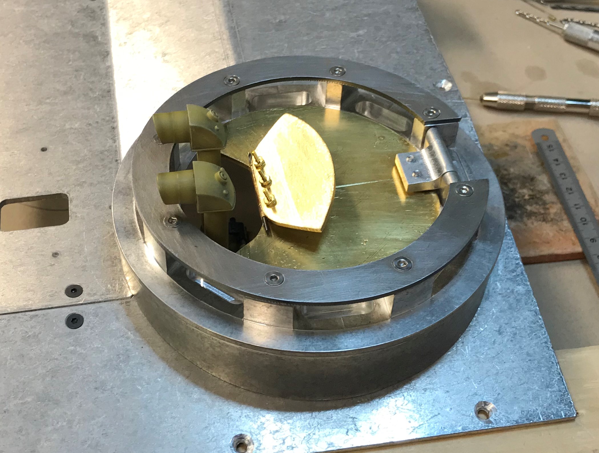

Finaly some small work done, to Loader hatch
Gunner "hatch" small adjustment and one detail left :?: :wink:

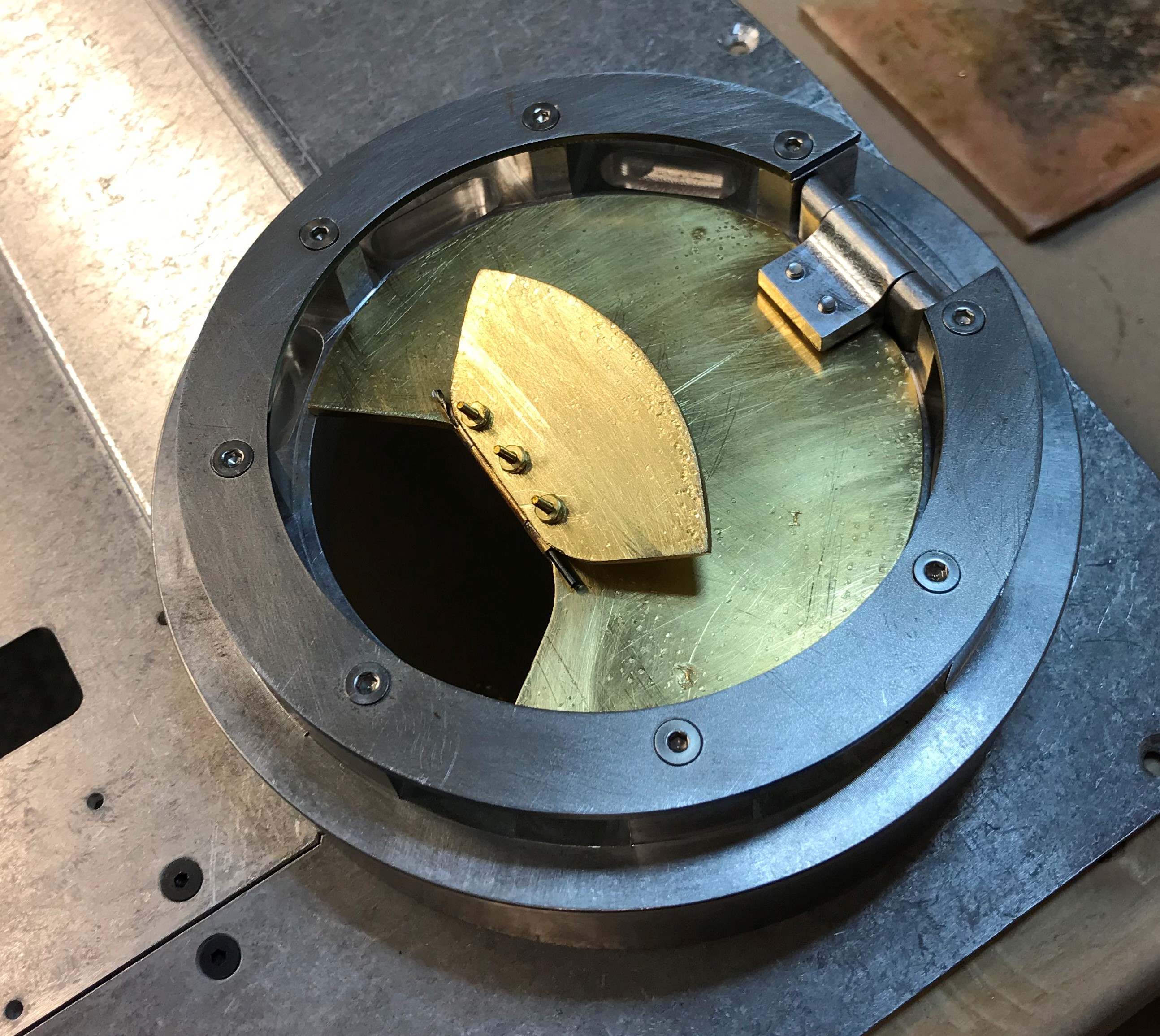

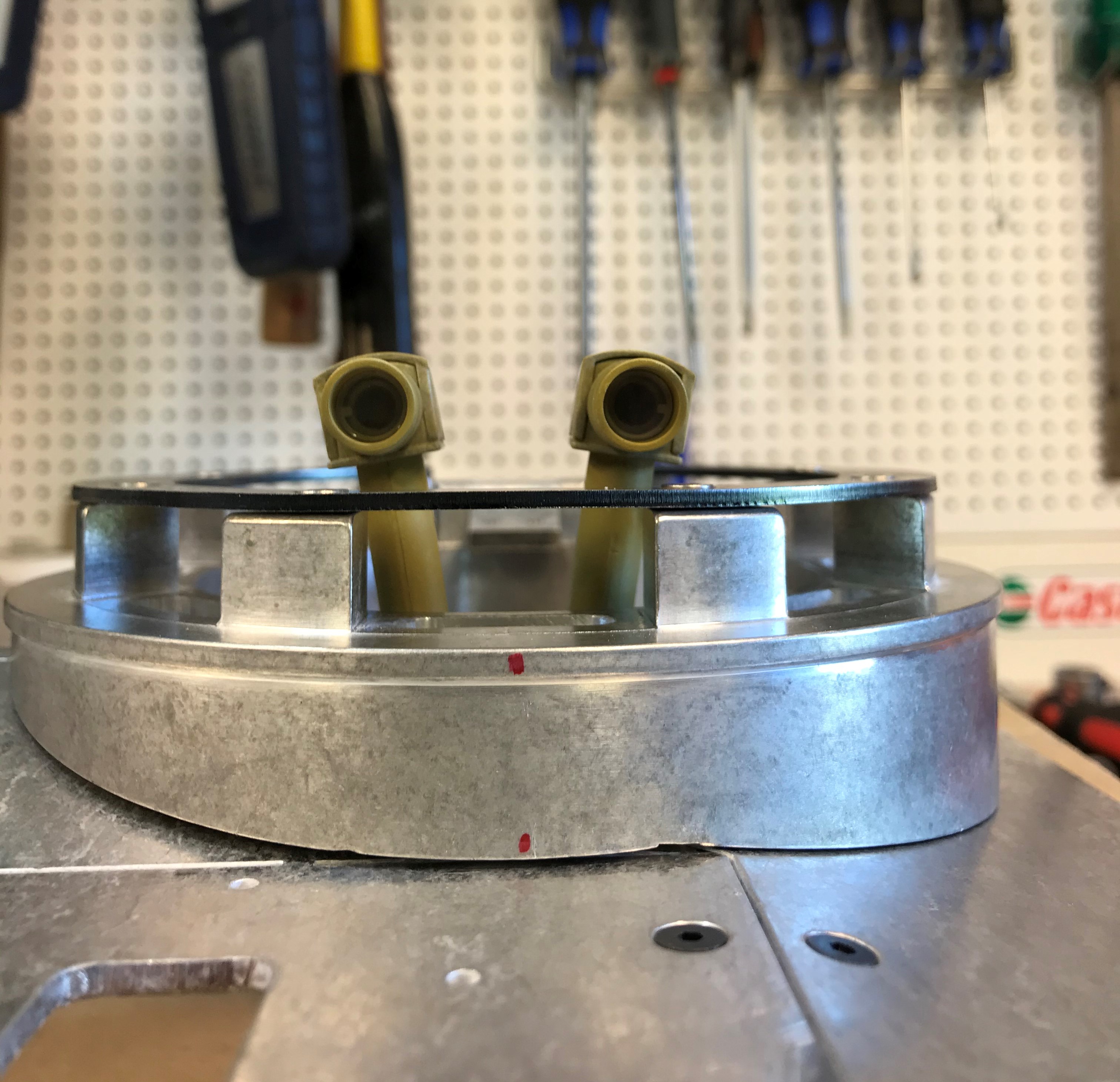

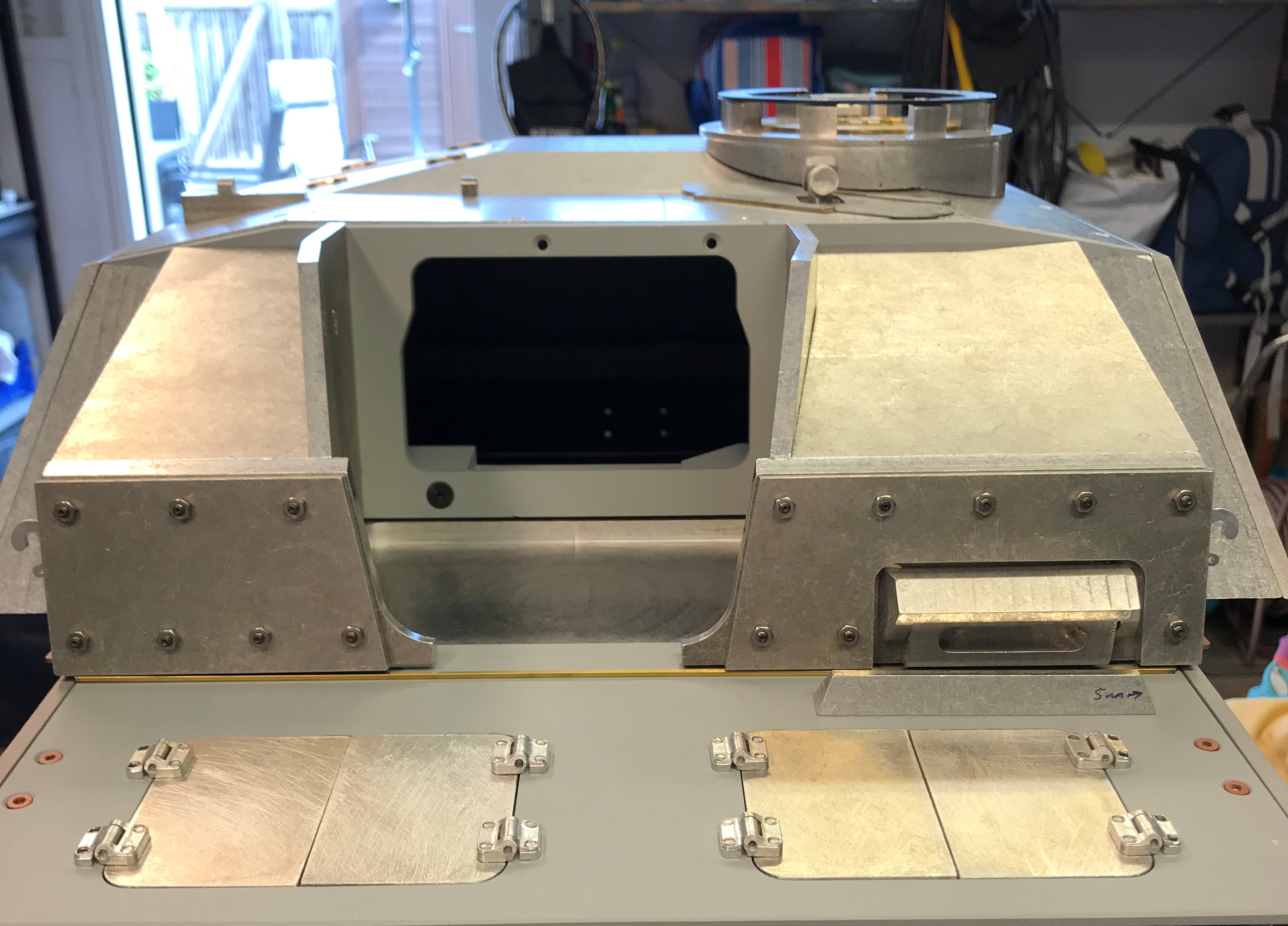

Hi all
Small update on the 57th
Done some work on the front and upper hull ,
Not sure if I will use the brass thing "not sure off the english world" :oops:
Will move the driver deflector 5mm , mostly for the look :roll: think it possible to move it a bit on the real Stug :?:

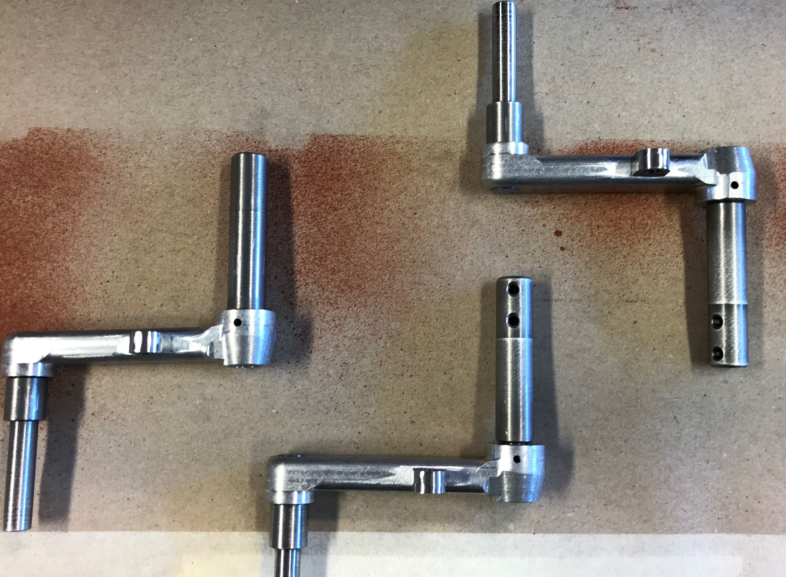

Then it was time for those suspension arms :? was a bit uncertain how to deal with it.
It became a hybrid from what I´v seen here at the forum .
Then Roy´s and now Yves also I think.
Well thats about it for now ,see you
