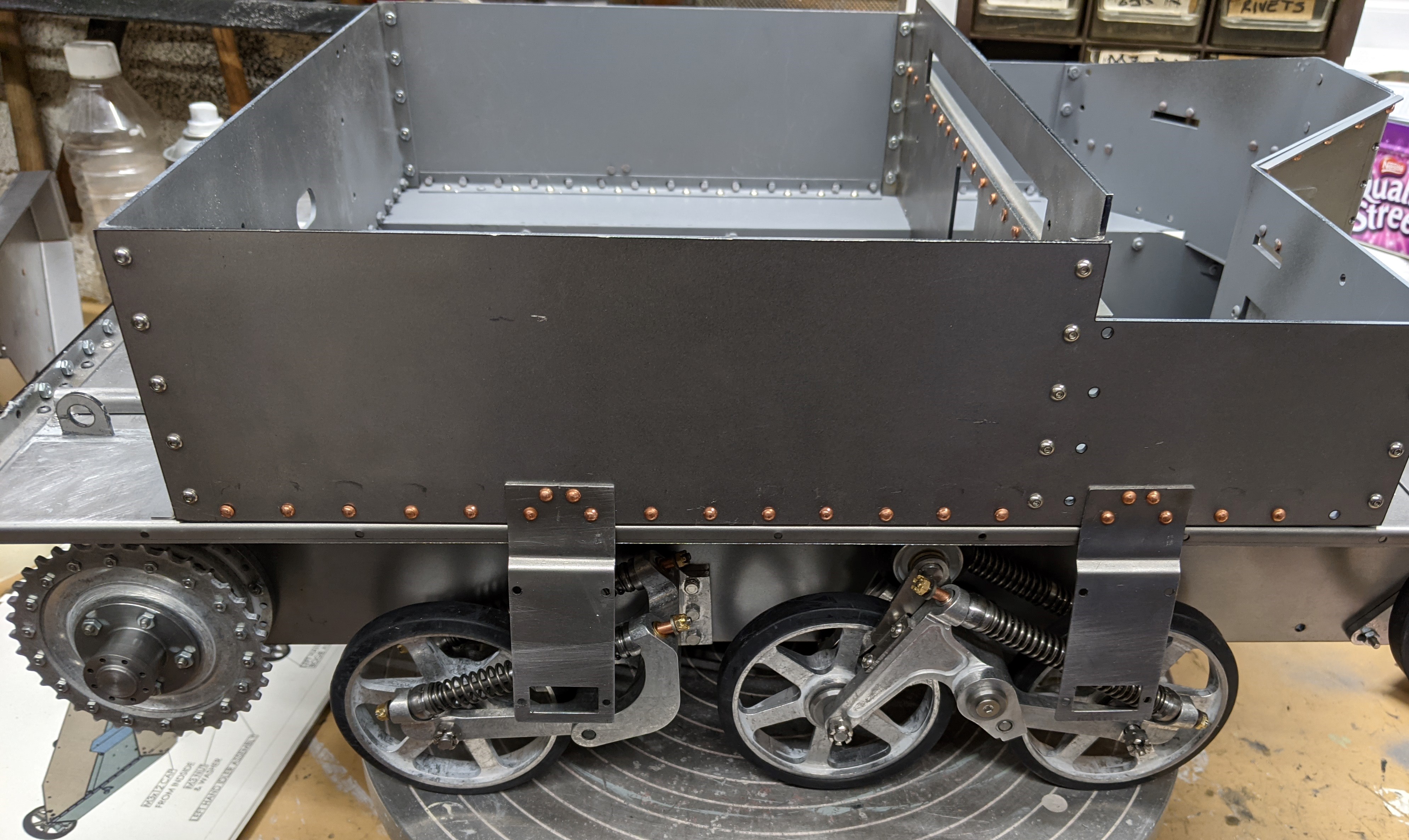

Thank you Dave I will do that. Also I will probably put some shape into the clips, slim them down a bit and round off the ends. Glad you sorted the spring problem. Not trying to make more problems for anyone but I think the joining piece between the springs could be slimmer? I bought M3 castle nuts from Steve Winstone, they arrived today and will finish off the spring adjusters nicely.

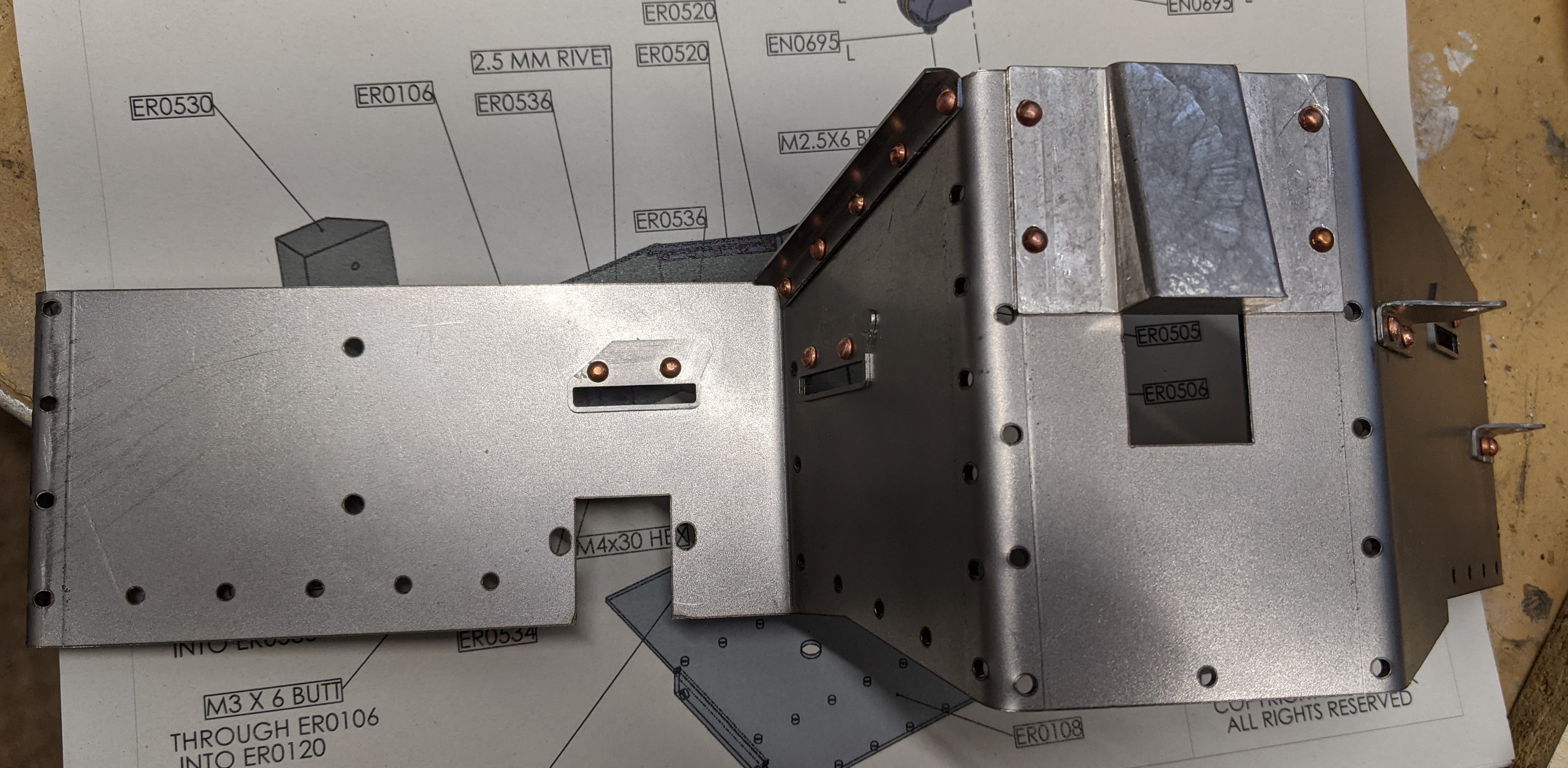

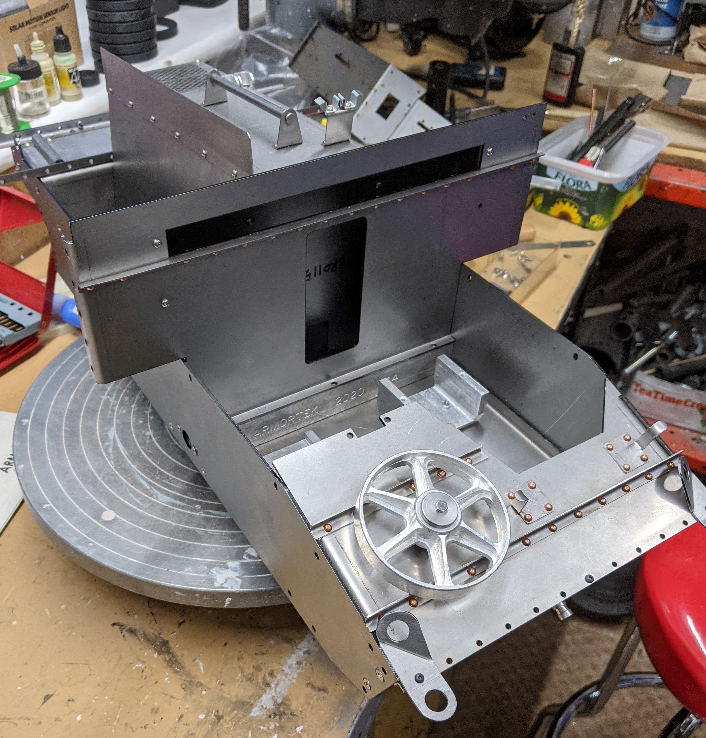

Bit more done today. Found a use for my larger banding wheel, makes a great turntable. No issues except fat biker fingers trying to manipulate little nuts.

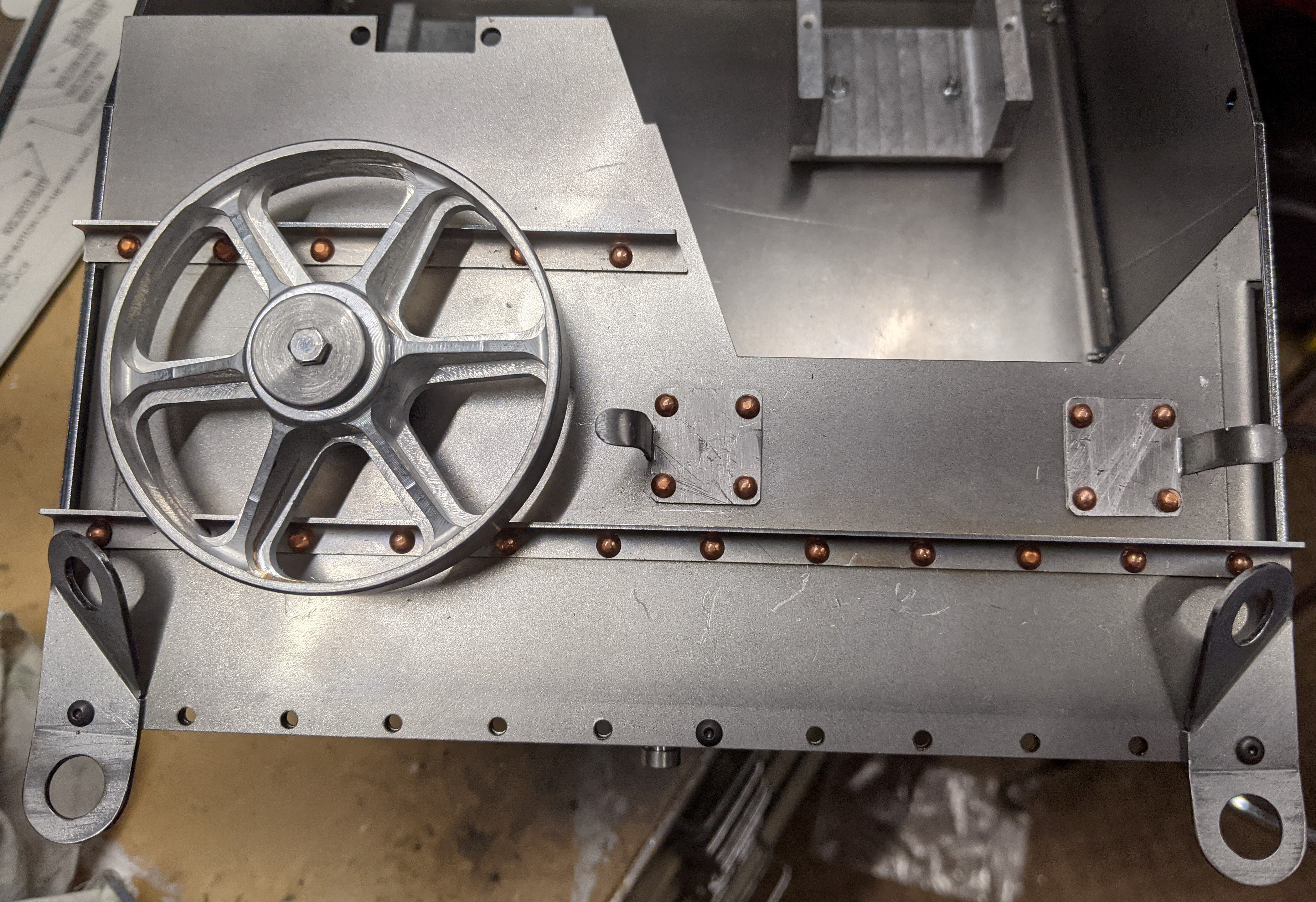

'been riveting today as well as clean up kit pieces. Now seen Dave's post and I will need to revise the gunner's armoured plate.

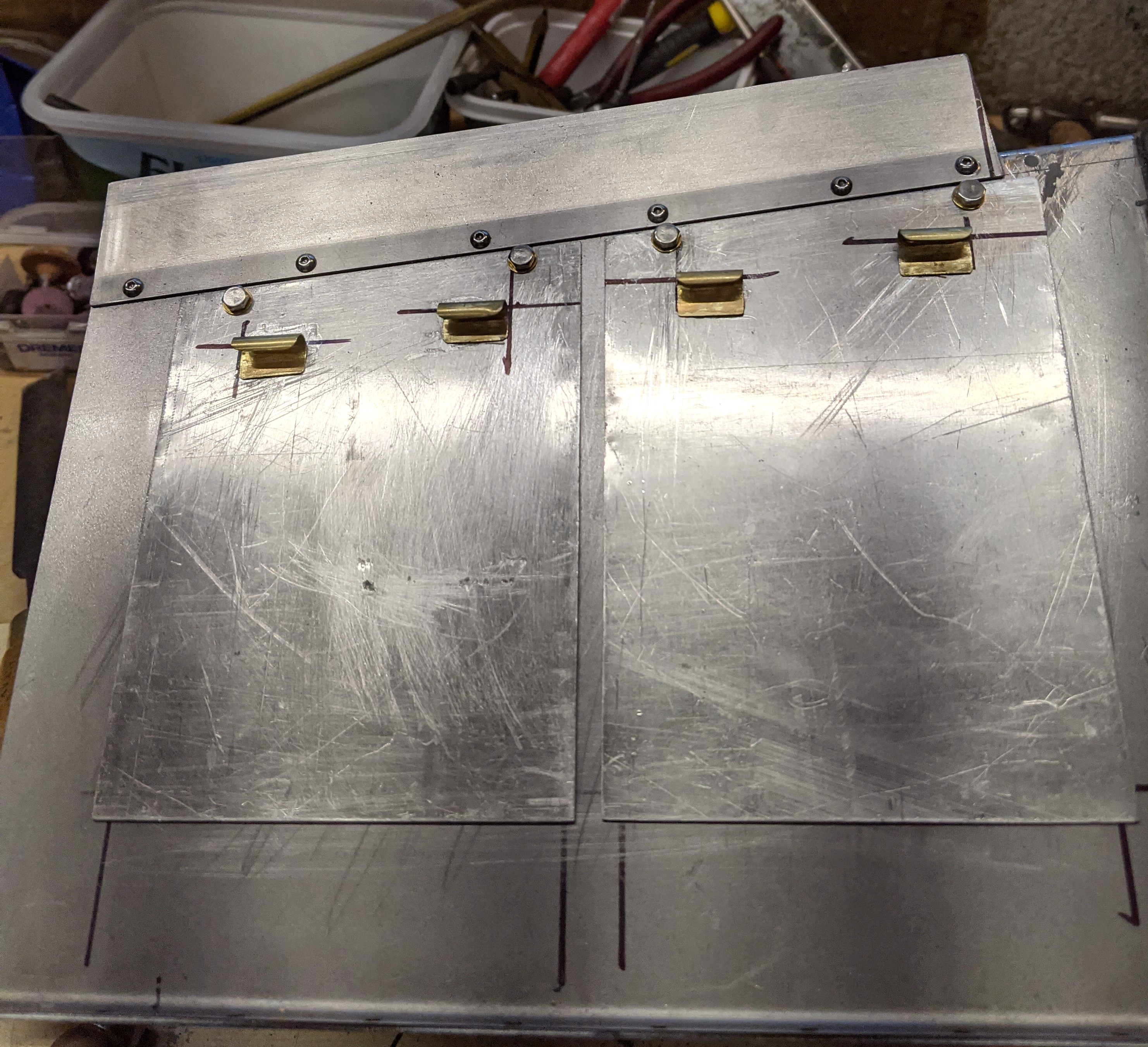

Whilst on the subject of the motion and sound packs and access to the cross shaft you will have seen the note in the instruction manual that the engine cover will have to be removed, I have been working on which parts can be fixed permanently and how to remove and refit the engine cover with minimum disturbance to other parts.
As mentioned before my fat biker fingers are finding manipulating the M2.5 bolts/nuts difficult so I have adapted an allen key to have a long handle from another tool, see photo.
Also progress has been on filling gaps with JB Weld and more rivets.

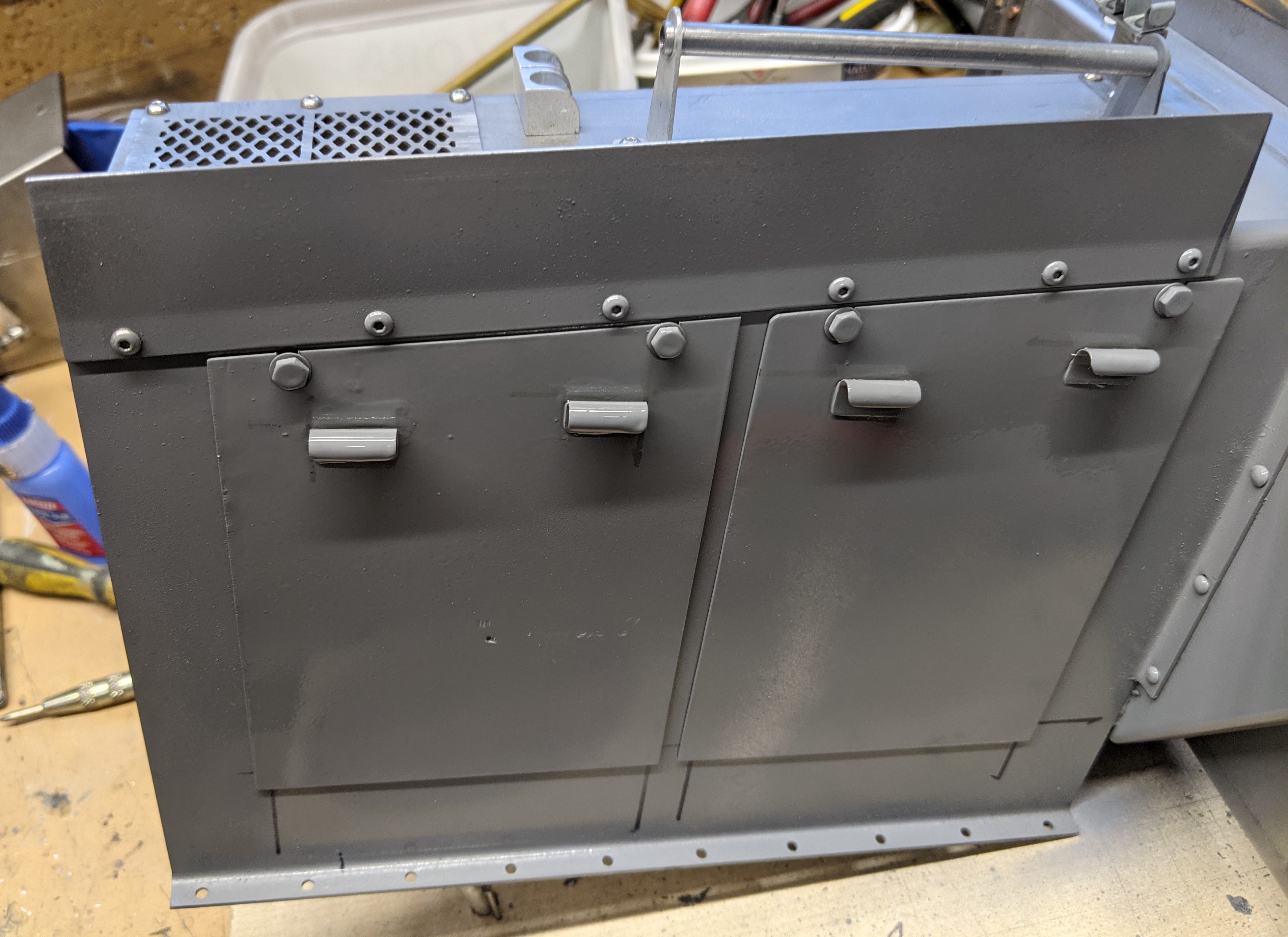

Bit of progress, mostly unseen but I have made and fitted dummy engine covers for the off side of the engine cover.

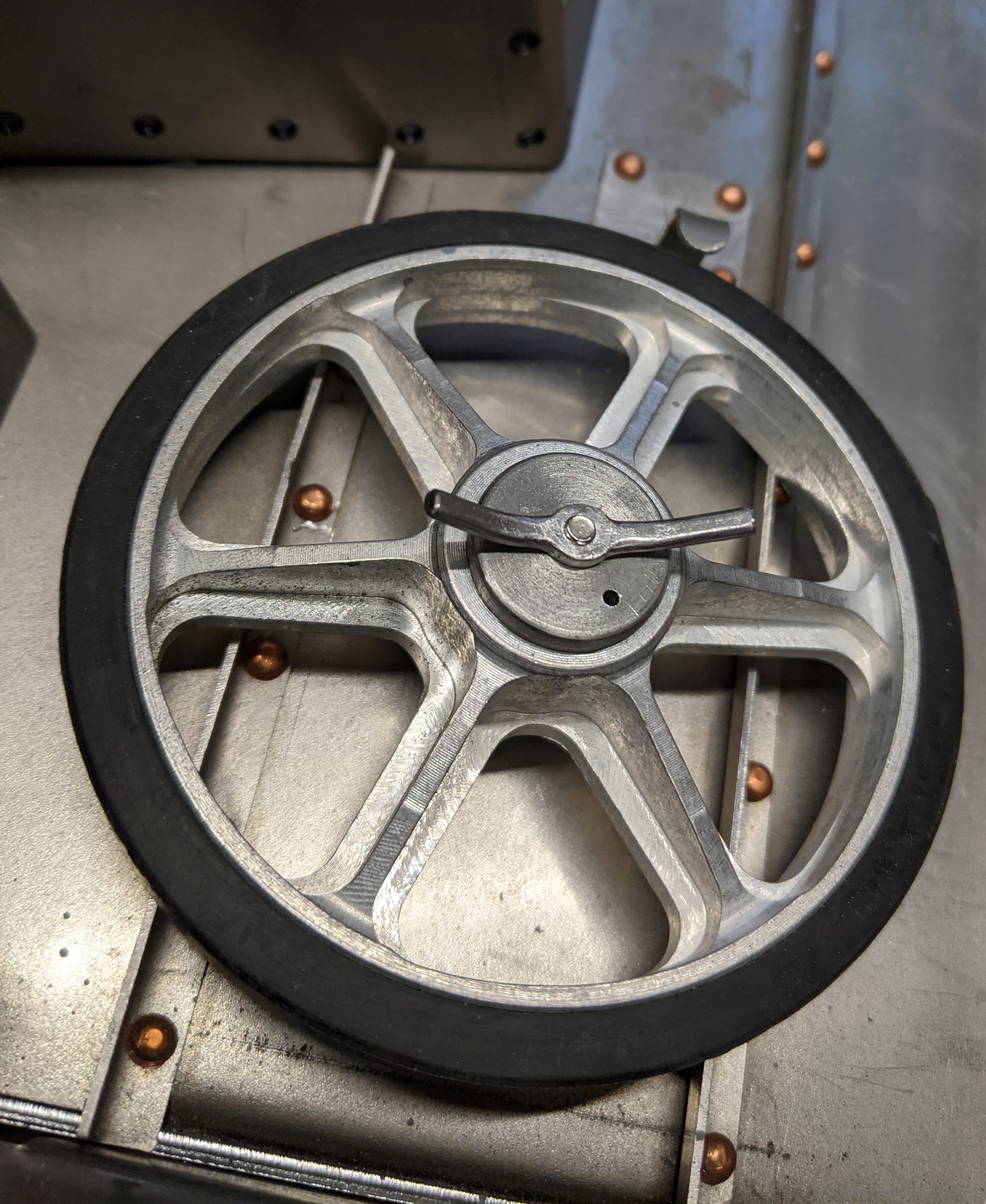

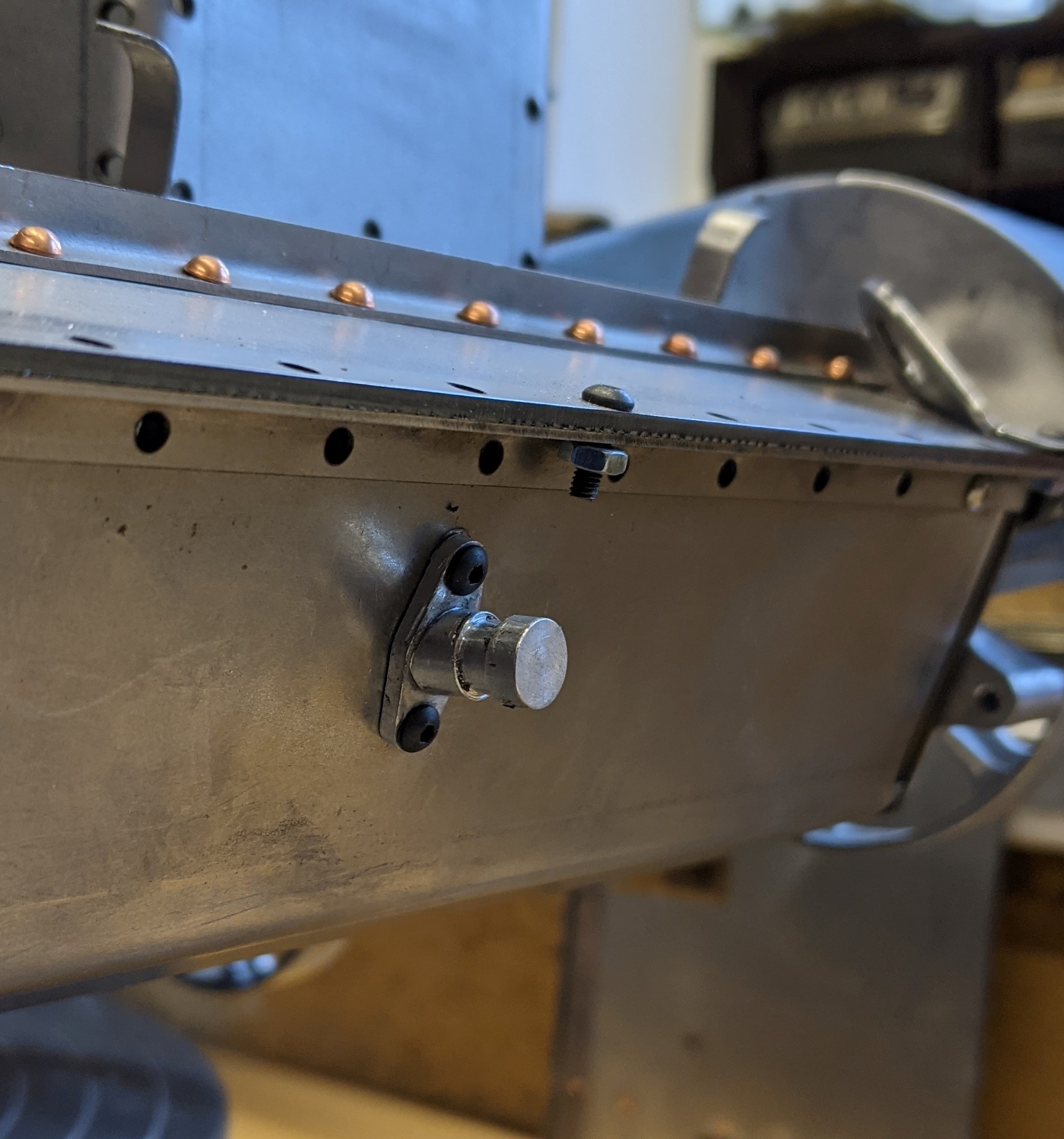

Now as the major parts are assembled the pace slows working on smaller details, I couldn't let the starting handle access hole stay in the wrong angle and a spare wheel holder awaiting the chain. Have been working on the gun cowl Mk 2 but my ran out of oxygen for my brazing kit. Still a great model to work on and enjoy.
