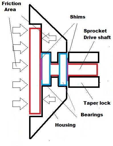

On Thursday last, the fateful day, I anticipated this and ordered replacement bearings. All being well they will arrive today and I can resolve, or not, the problem. I like the diagram and your reasoning, it makes so much sense. Thank you again John, I will follow your advice and try again.

I'm still in Chieftain shimming gearbox mode at the moment, I read somewhere that it was often found when stripping the Armortek gearboxes down the output drive shaft gear wheel was often found to be rubbing on the back wall of the chassis. Counter acting this is done by loctiting the shaft to the inner ball races of the outboard gearbox housing.
But my thoughts turned to if your pulling the shaft outwards away from the chassis wall, you could pull the shaft onto the bearing or inner wall of the gearbox housing, either way the gear wheel could start rubbing against one wall or the other, wasting power,shaving aluminum and making a nice grinding paste with the grease in the gearbox (Worst case scenario)
So have you thought of placing thin shims, space allowing, between inner bearing and gear wheel. Outboard shims fitted once track alignment has been measured up. We maybe only talking 0.2mm - 0.3mm shims inboard. The outboard shim will probably be a lot thicker but when the taper lock is fitted the whole assembly will not move much from set position.
(A shim today will keep the keep the chomper away) :lol:
This is certainly how I intend to set up my gearboxes for maximum efficiency.
On my tiger, I used an aluminum shim on the outside, filed to thickness to provide the right track alignment. Caution has to be used, as the taper bushing can put an axial squeeze on the bearings. Just fit the motors afterwards, so you can first make sure that the bearings are running smoothly. This process is expressly discouraged by Armortek, arguing that the taper bush manufacturer insists that the bushing must be able to slide freely on the shaft. Strange, in my thinking. It sits perfectly still, but the sprocket moves, as the bushing is tightened. Anyway, it has worked well for me.
The inner shim is likely not needed, but it is easy to test: Just press the gear against the housing (bearings installed) with your fingers and check for interference.

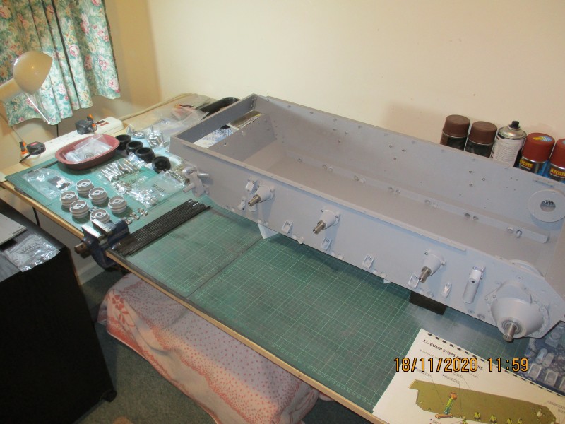

Hi Guys, wet wet wet, 'omering down here in Wales. Ok, if you recall my driven gear problems...I have the gear case re-assembled by Armortek, returned and fitted, sweet as a nut, all is well. I have spray painted the hull parts with acid etch and started the return rollers. Again, not wanting to race along as I would like this build to last until at least the Shermans...Oops! .... Mick

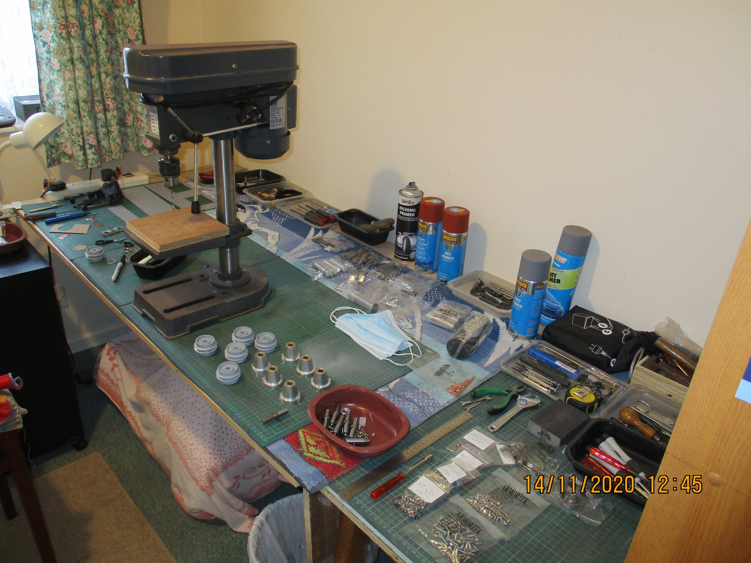

The Workshop, sum total of my machine shop tools.

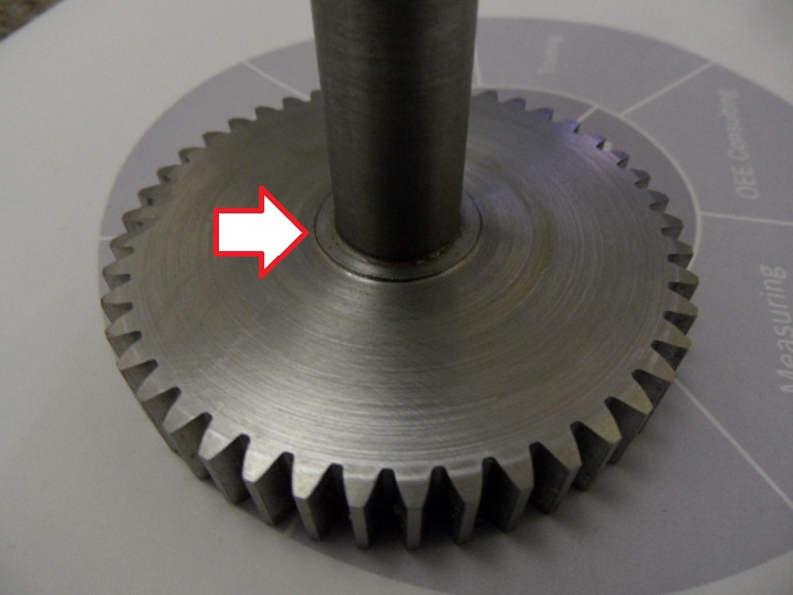

Good to the hear your gearboxes are all good, I've just dug out my final drive shafts to fit into the outboard gearboxes. I was really pleased to see a small step on the gear which will prevent any binding on the gearbox case or the bearing itself. I'll not need shims on the inside now, maybe some on the outside though.

Good morning John, I noticed that lip on the driven gear...it's very slight...I also heard ( when rotating the gear a slight scraping sound ) so I 'ground' very carefully, the screw heads which are under the driven gear, flush with the hull side, this got rid of the sound...and the gears turn smoothly, well pleased.

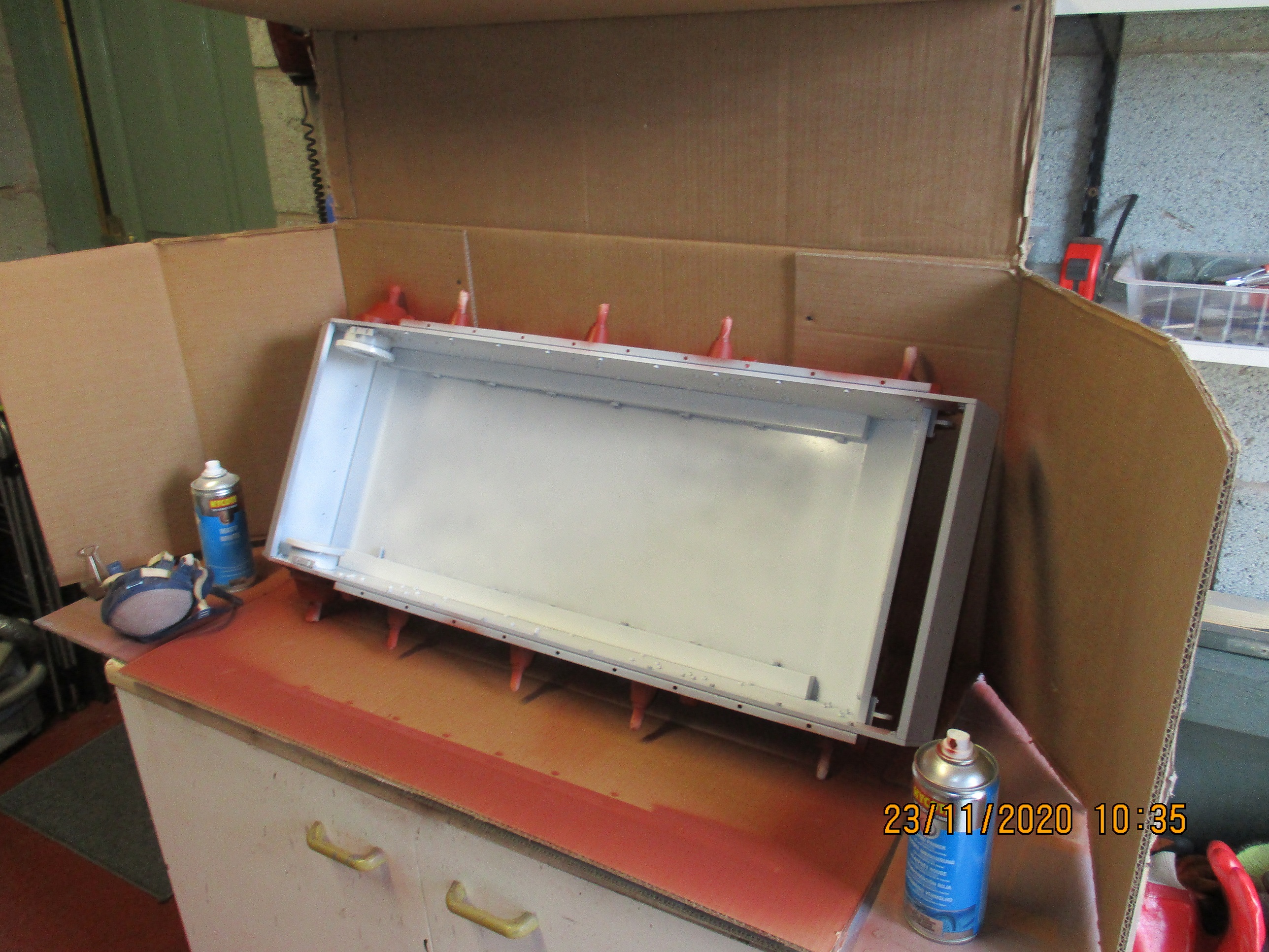

Good morning everyone, slow but steady progress. Cold in the garage for spray painting, i am restricted to this area, because of the smell of Acid Etch.
Nit picking if you ask me...Mick

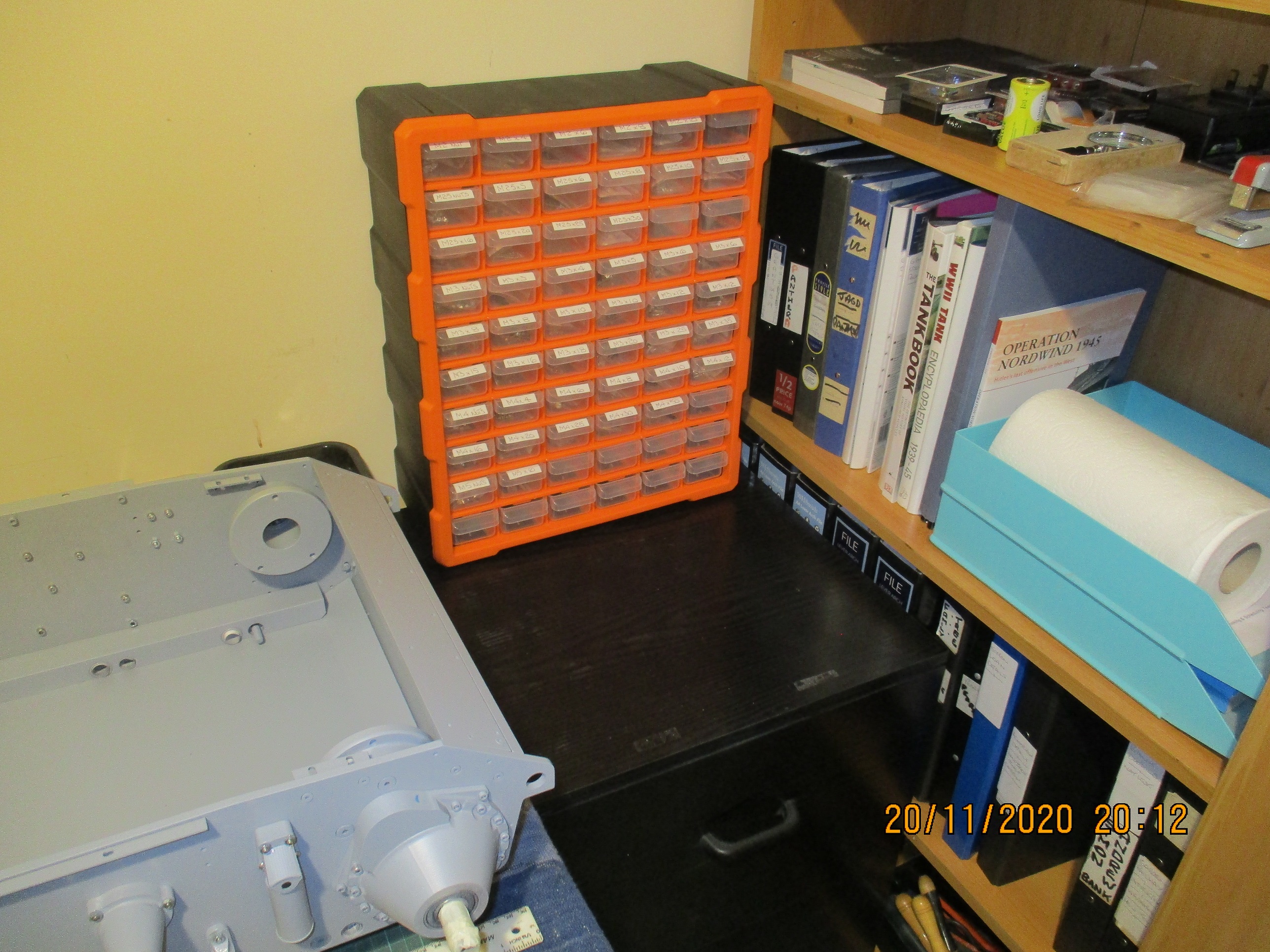

Good evening everyone, back to the more mundane...finally replaced my worn out filing system for all those M screws/bolts /nuts/pins/ rivets. and on and on. Sixty compartments, Tool Bits Organiser Unit, on Ebay. I previously used large tray type boxes and small plastic bags, labelled. Eventually the label's fall off or become oil stained. Woe is me.

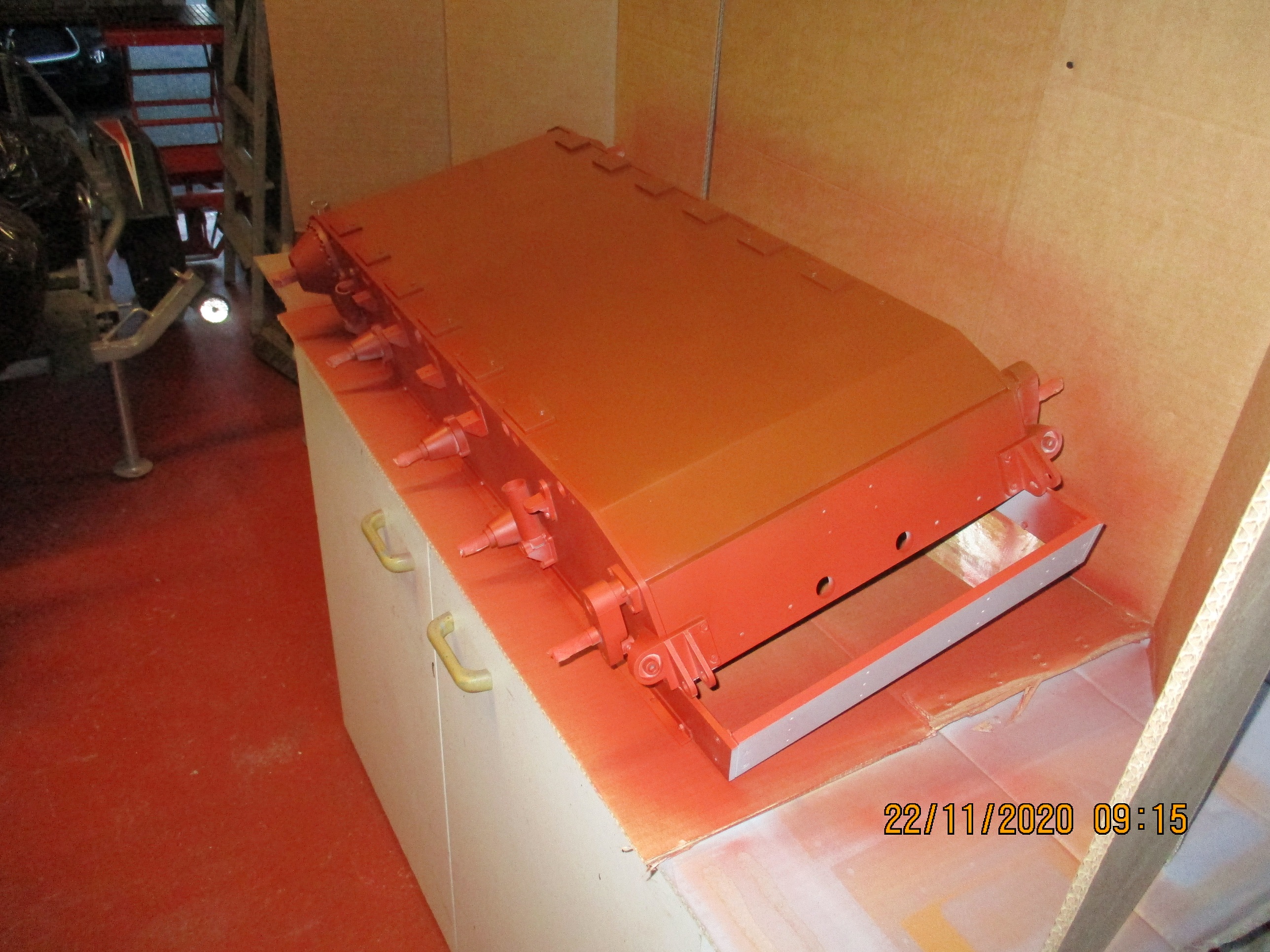

Cold weather or not it's into the garage tomorrow and out with the rattle cans for some undercoat...on the StuG of course....Mick :)
