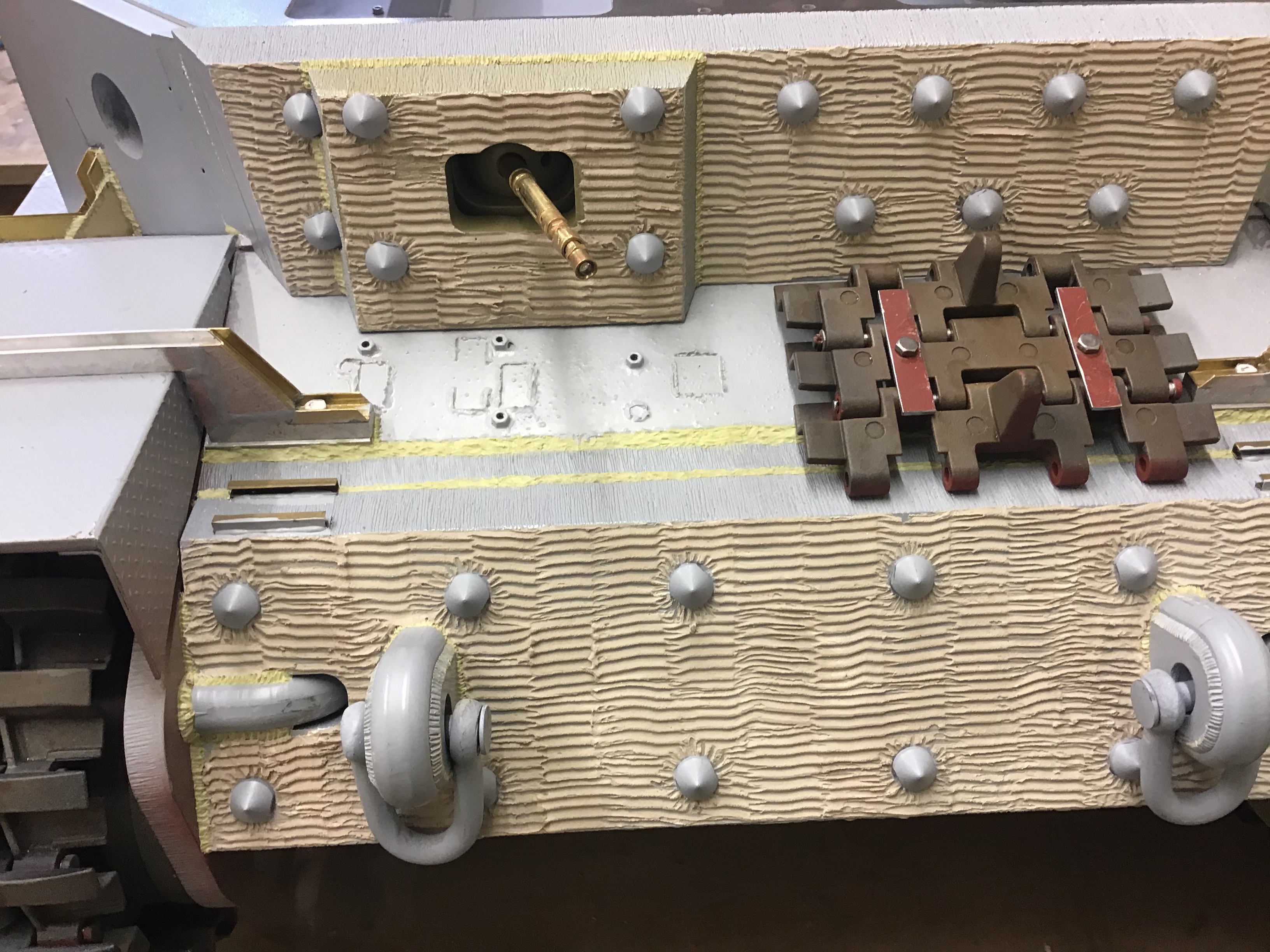

Added the remains of the weld after the jack mounts were repositioned from the front plate to the rear plate. Big thanks to Phil for his suggestion to use templates to achieve the desired effect.
A bit of texture has also been added to the front plate.

Awesome effect with the removed jack mounts! :D
"A bit of texture has also been added to the front plate." What an understatement! :shock:

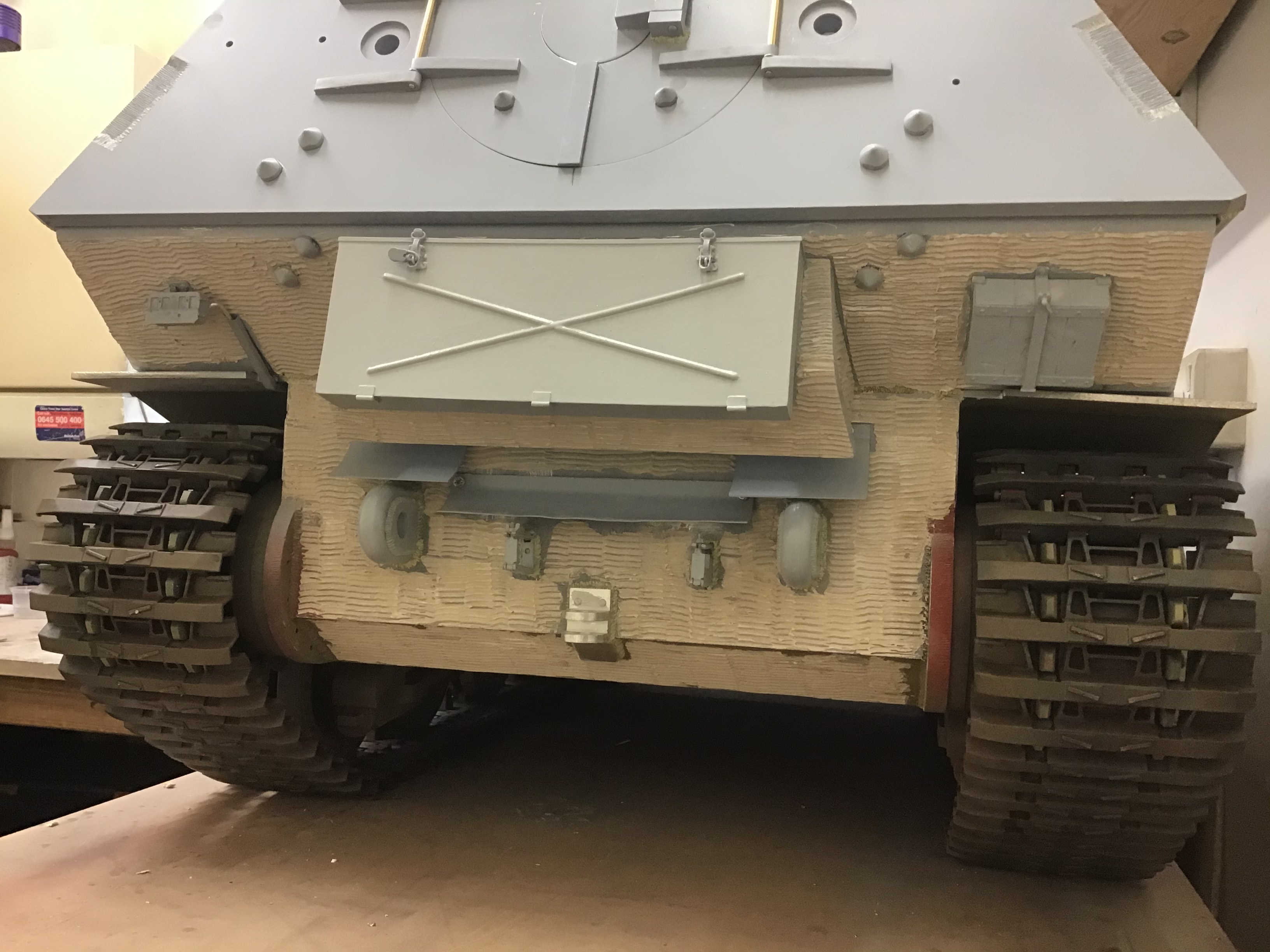

To add a bit of difference and interest I have decided to fit my Elefant with the split and hinged rear hatches. From what I have read there were only 4 Elefants modified in this way and at least 1 was in the headquarters company of Schwere panzerjager 653.
It’s taken a fair bit of work to get everything to fit correctly but I cracked it in the end
Everything needs careful alignment otherwise the tapered faces of each part will not fit flush when closed
The final rear hull details and the zim need adding and the back end is complete.

Rear hull zimmerit now complete

Where did you find out the placement for the hatch’s that go on the underside flooring also did you bolt them on or glue
Are you using tile adisive for the zimimit of milliput
Keep up the good work

That hatch is a master work. I love the one of a kind look. Brilliant. Love following your builds.

I found a diagram on line for the lower hull access panels and used a bit of artistic licence from there. The panels are all bolted in position as per the real thing. The Zimmerit is a mix of tile adhesive and brown acrylic paint, For application I use a set of Mike Stannards excellent Zimmerit tools which I would recommend obtaining.
Looking forward to seeing your build.

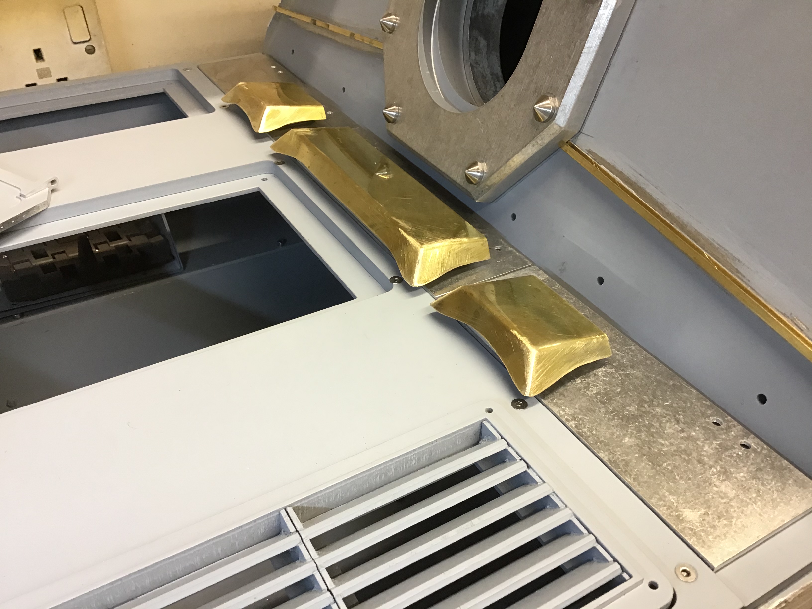

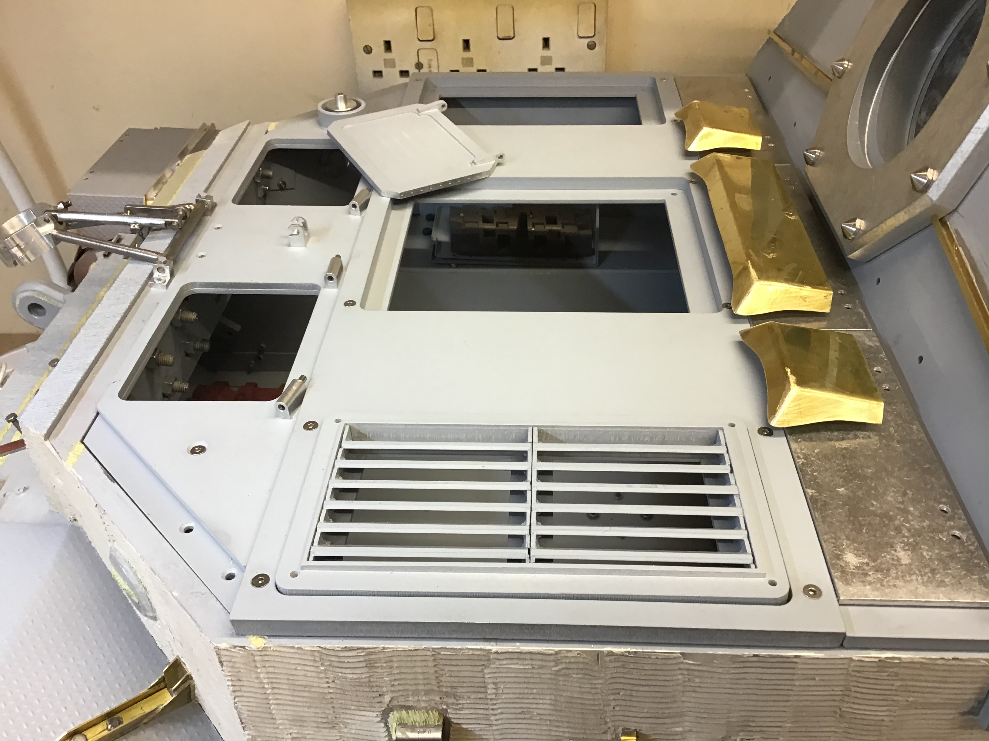

A bit more progress on the Elefant
I have made a start on rebuilding the drivers hatch and periscopes
Gun travel lock has been detailed
Engine air intake covers have been made
The deck as it is at the moment
A lot more to do but it’s getting there.

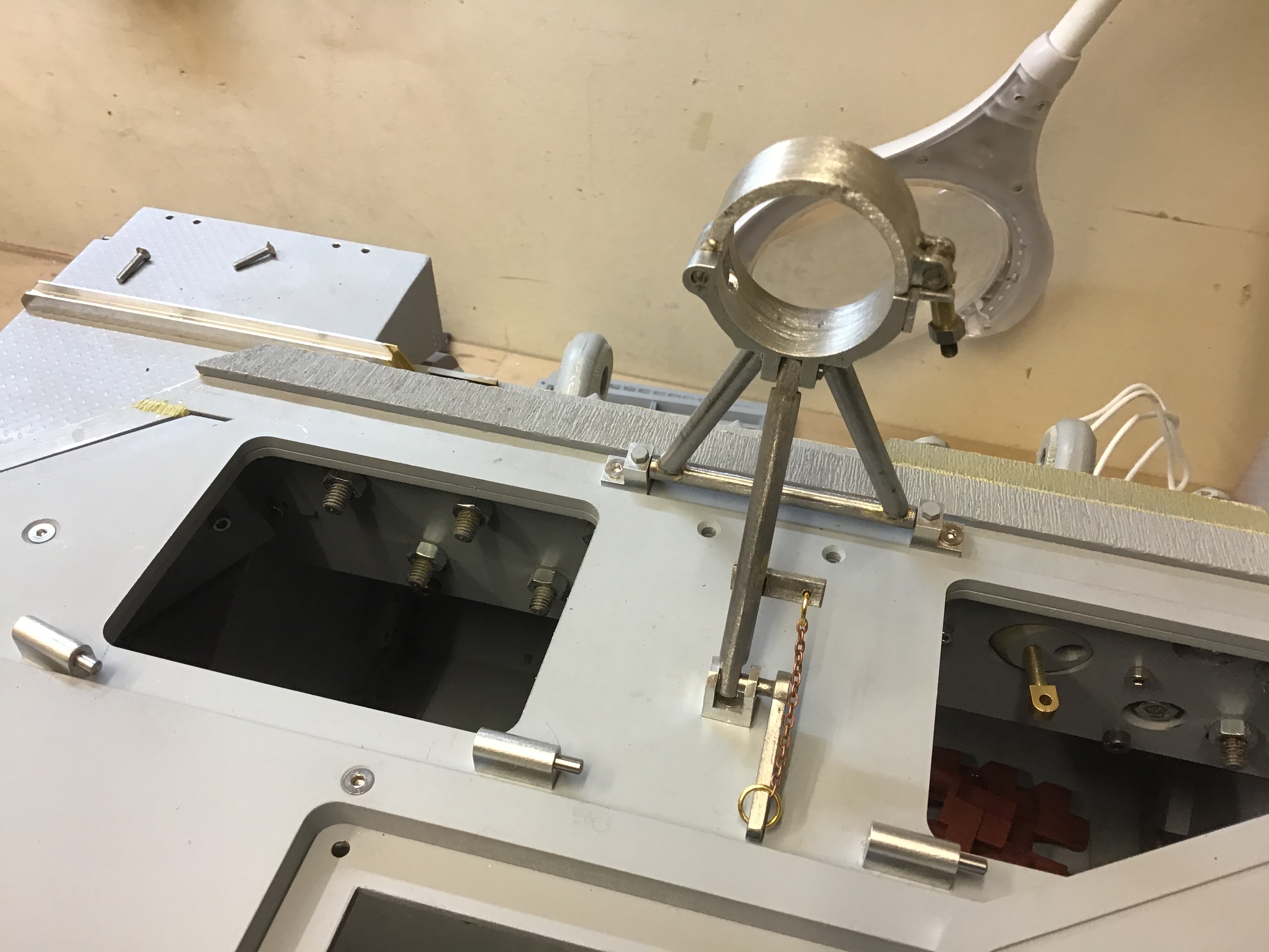

Hull roof details
The roof plate is held on with a latch at the back and magnets at the front
The sight aperture cover has been remade as the hole was incorrectly positioned
View from the back
View from the back
All items are now built for the roof plate, just the Zimmerit to do

Hi Steve
I love what you have done with the hidden runner track for the sliding covers.
I have remade the covers and was wondering how to stop them sliding all over the place.
Your idea is simple and brilliant I will copy if you dont mind :D
