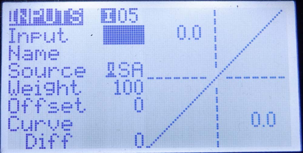

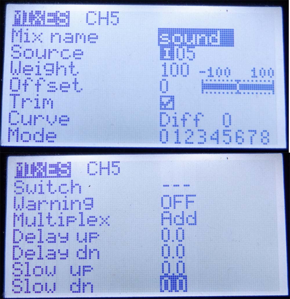

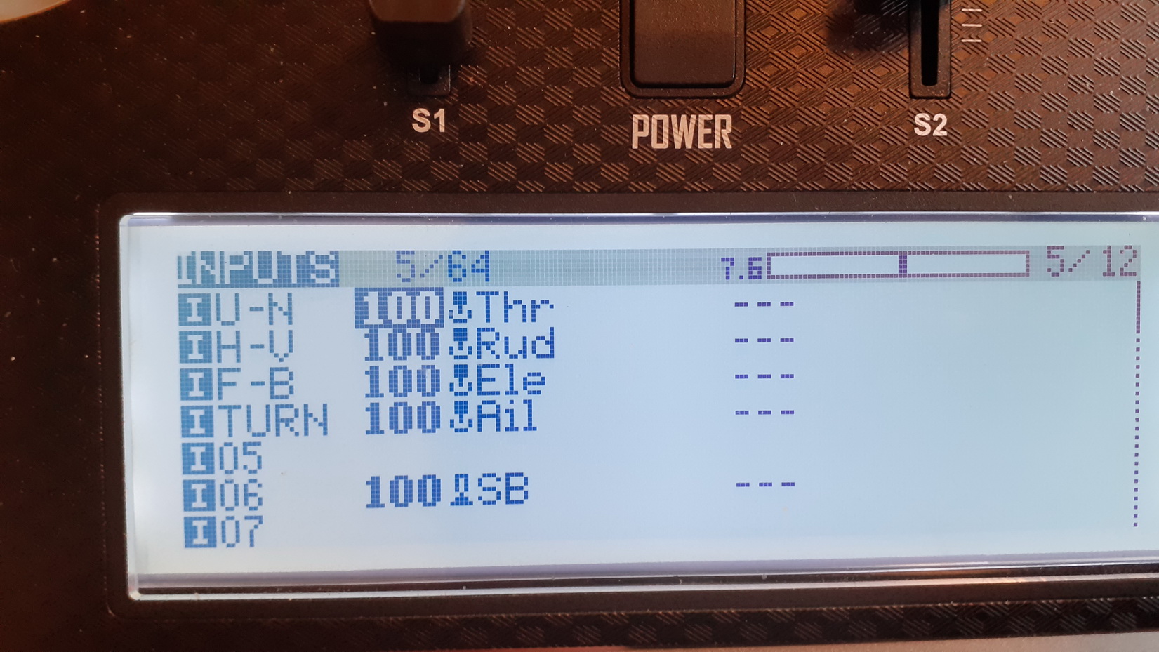

Hello Adrian Harris
It would help me a lot if you could send me pictures of what your mixer looks like.
For the three way switch.
Have a nice day and stay safe.
Robert Tanzer
Posts: 5133
Has liked: 1490 times
Been liked: 1697 times
Re: TBS5
These are screen shots from the transmitter. I made Input 5 = Switch A and Mix CH5 = Input 5
The transmitter is an X-Lite, so the screen is Tiny.

Hello Adrian
Sorry to disturb you again.
But I can not get the extra sounds activated.
I have Ch 6 on a 3way switch.
Possession 1 (Noting)
Possession 3 (Engine sond only idle and track are moving)
After this back to: Possession 2 (Engine sound Rev up with the tracks)
Back to Possession 1 (Engine of)

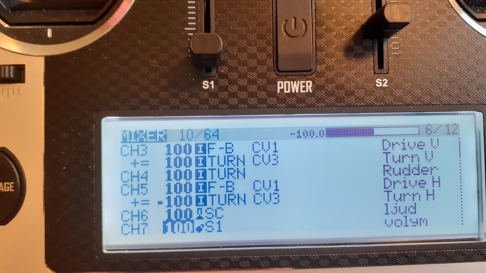

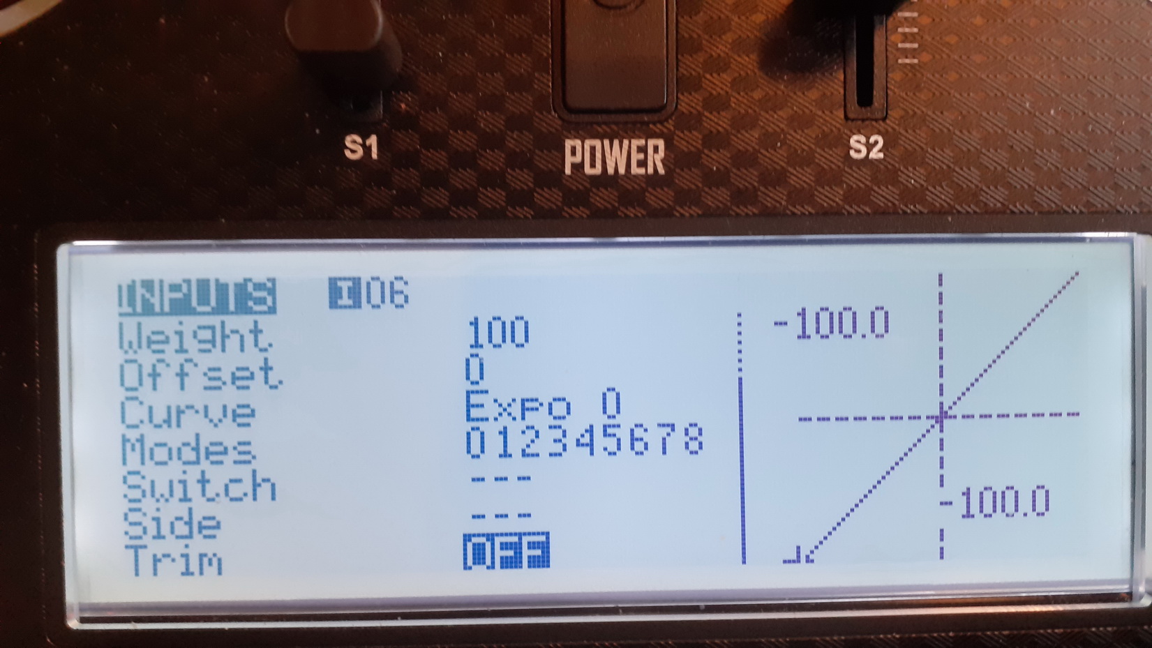

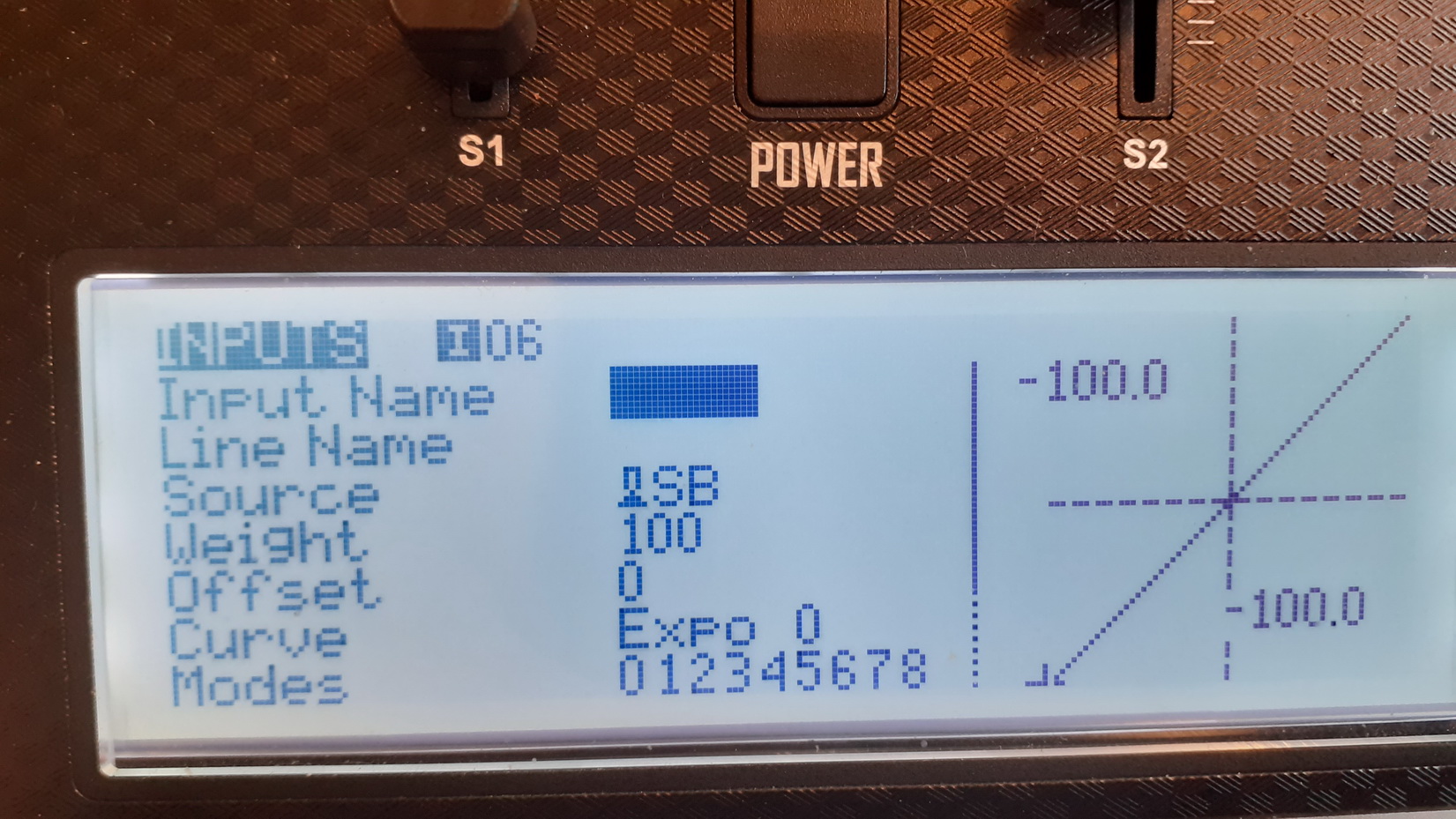

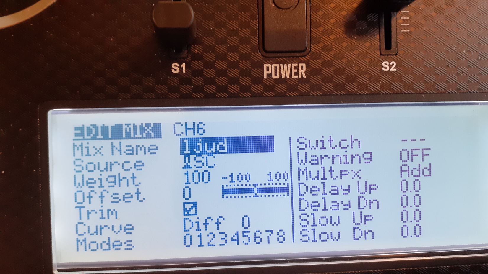

Send you pic's of my Mixer and Inputs.
I need all the help I can get. :D

Adrian Harris I stand up and salute you, with my hat in my hand.
You took your time and explained in a good way as a "Old" beginner that I am, could understand.
The problem was in the radio, the 3way switch was mirrored.
And set to -0 +100.
Instead of -100 and +100
