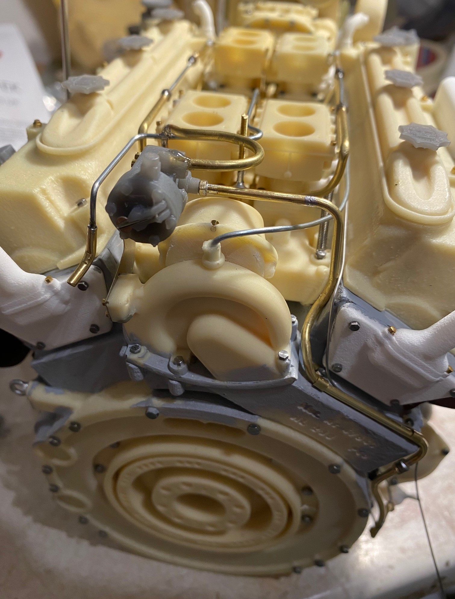

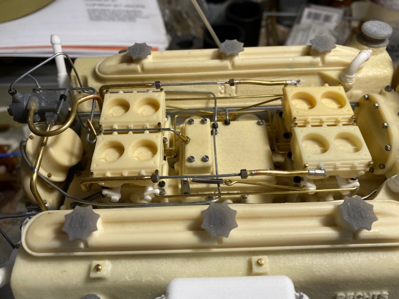

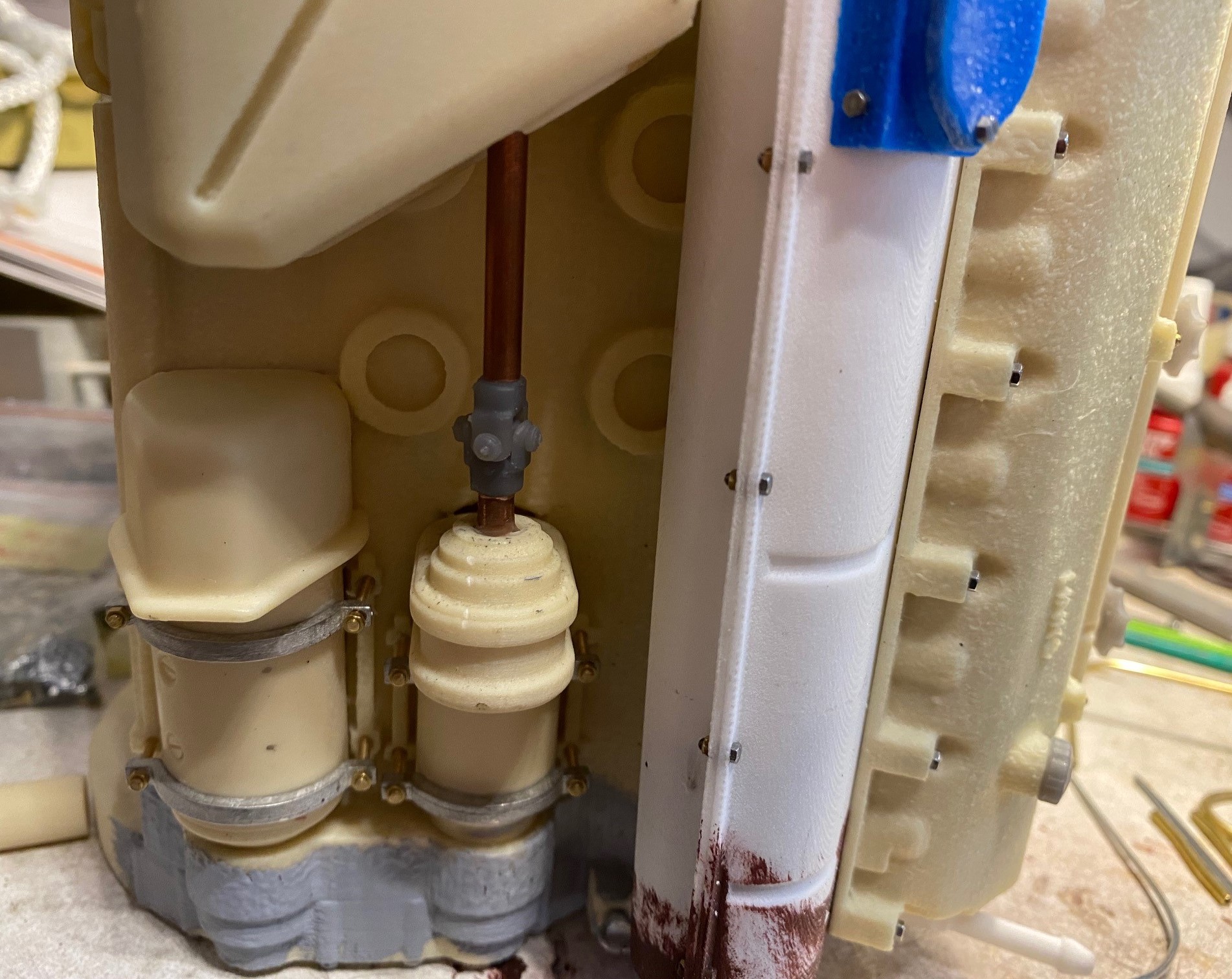

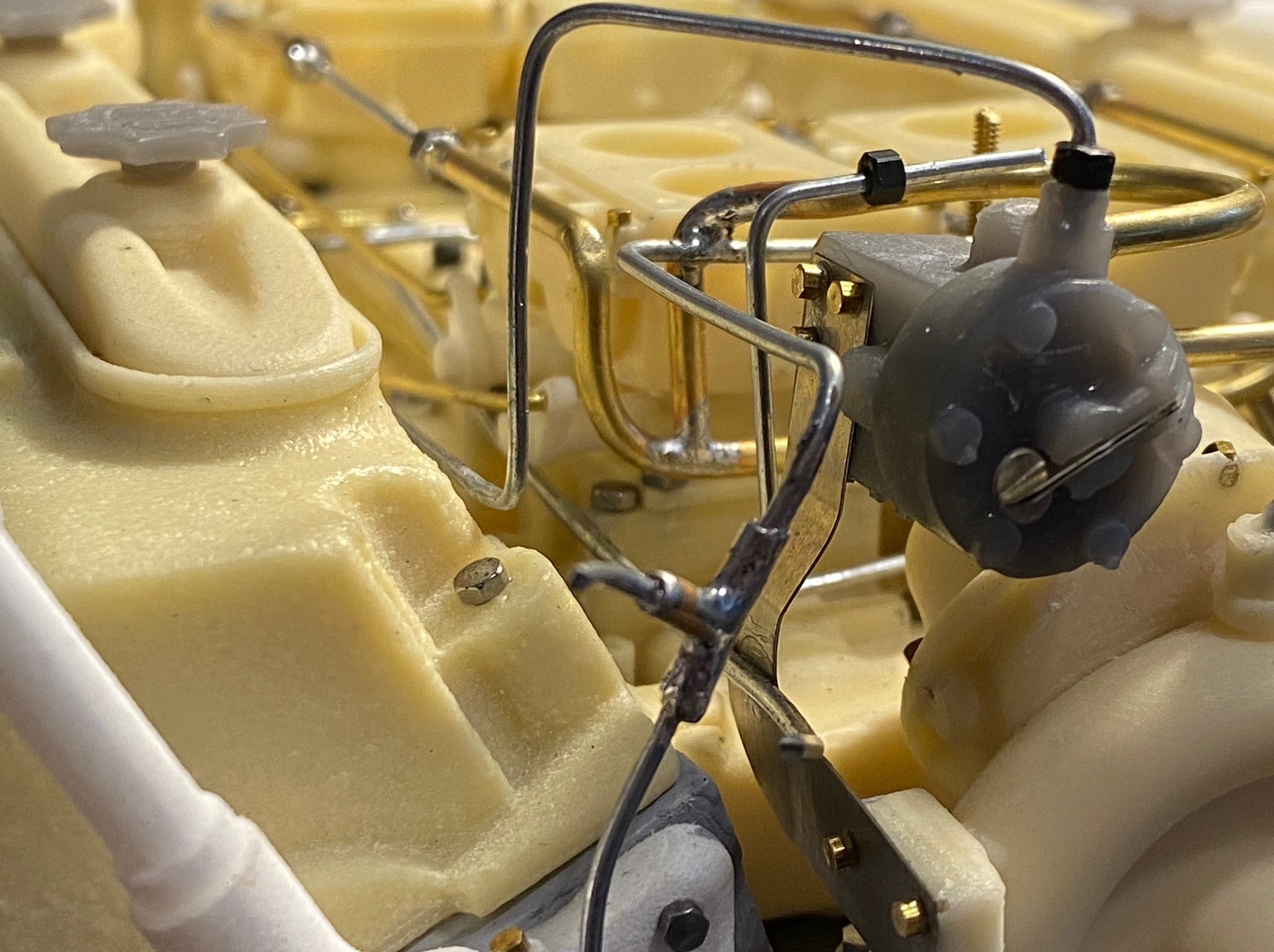

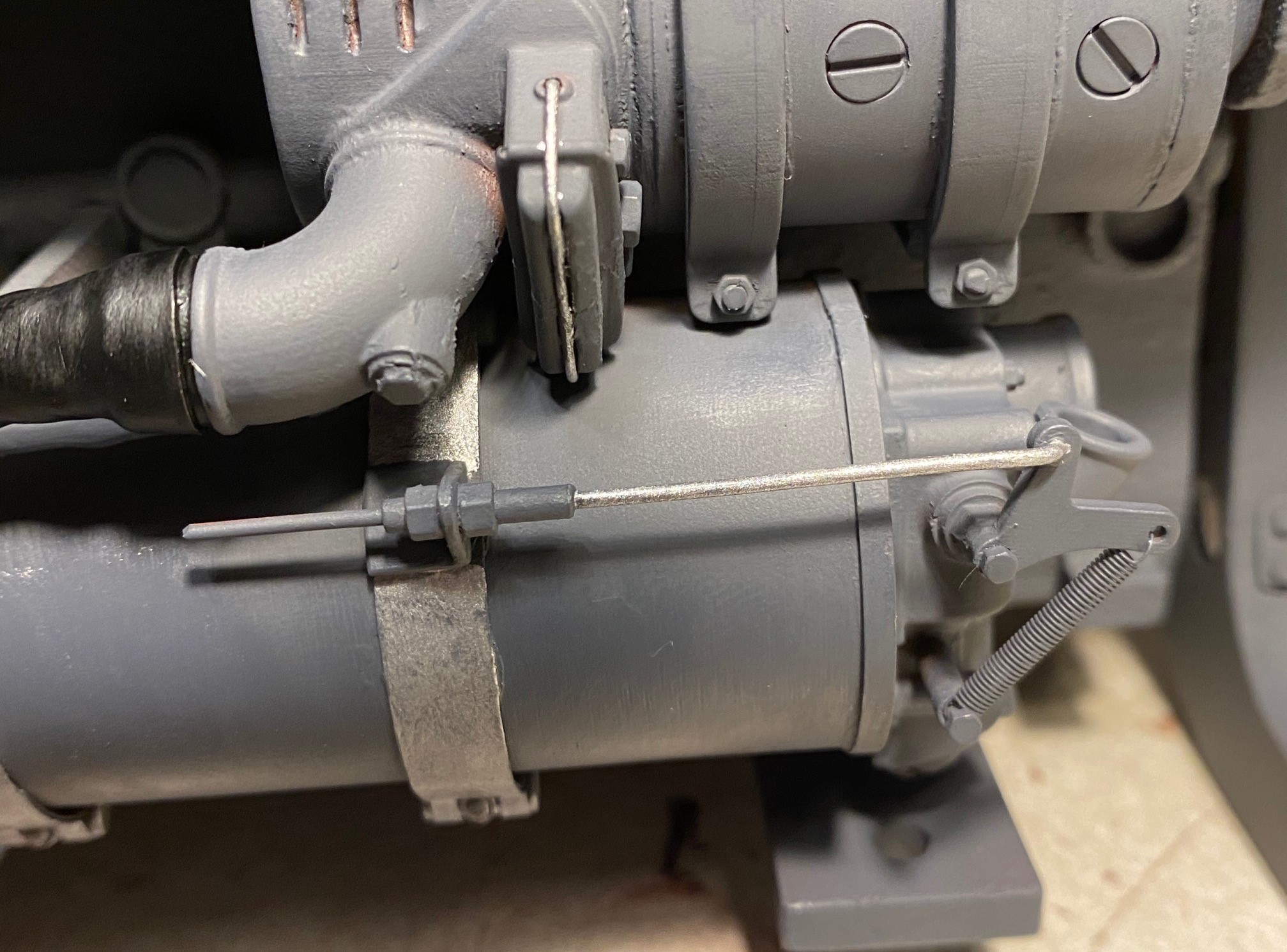

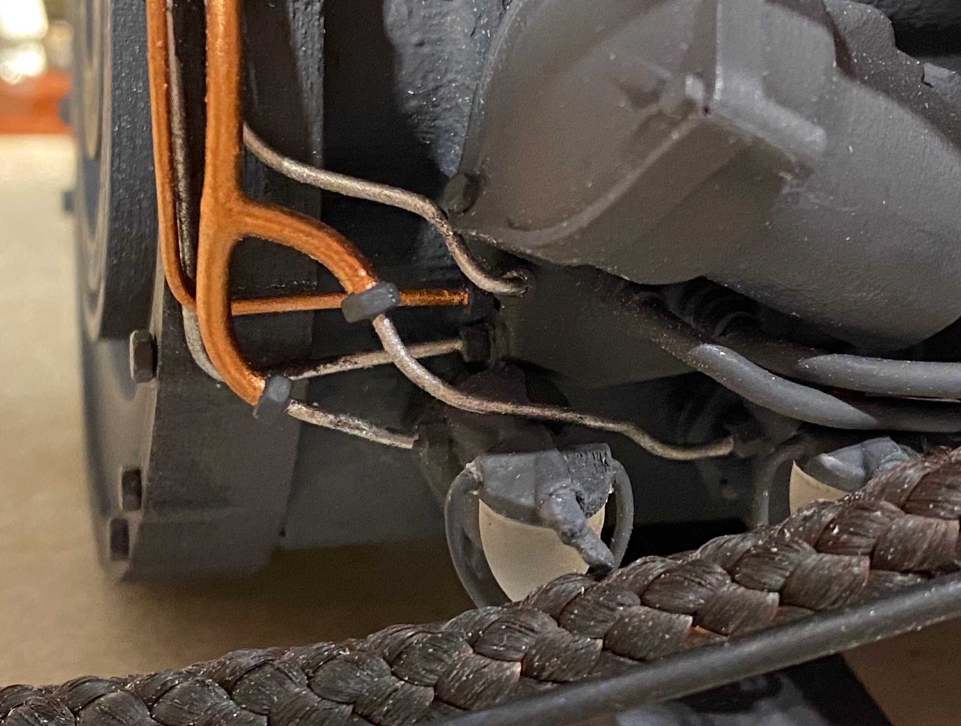

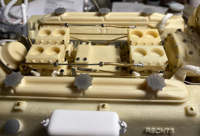

Now some photos from the chain for the hand starter with the cardanic shaft, and the first pipes for oil and petrol.
yes you can buy that kit from Ivano Costantini - see also in craftsmens market.

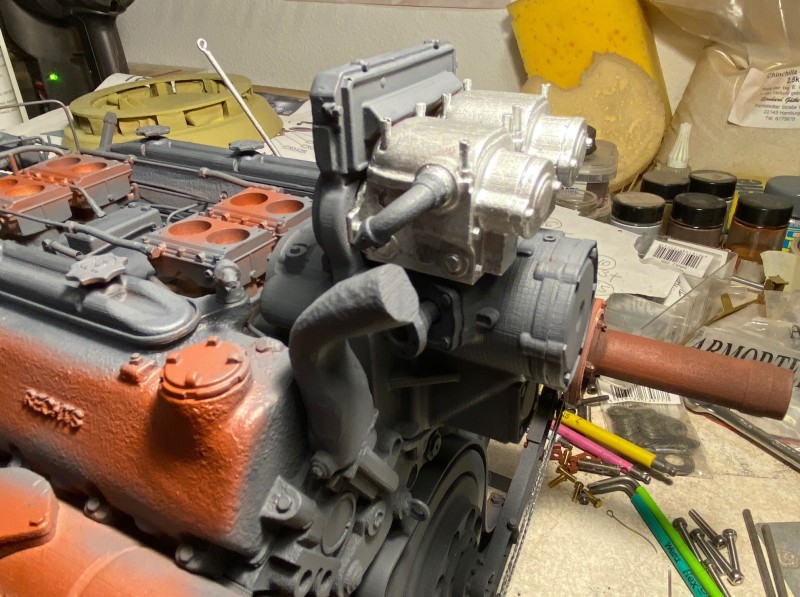

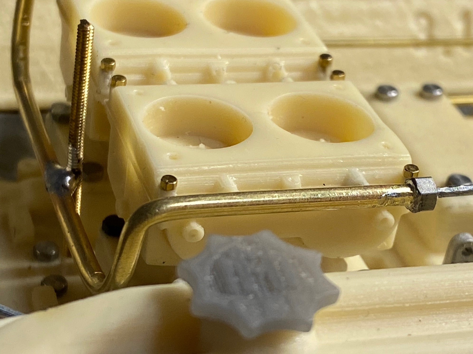

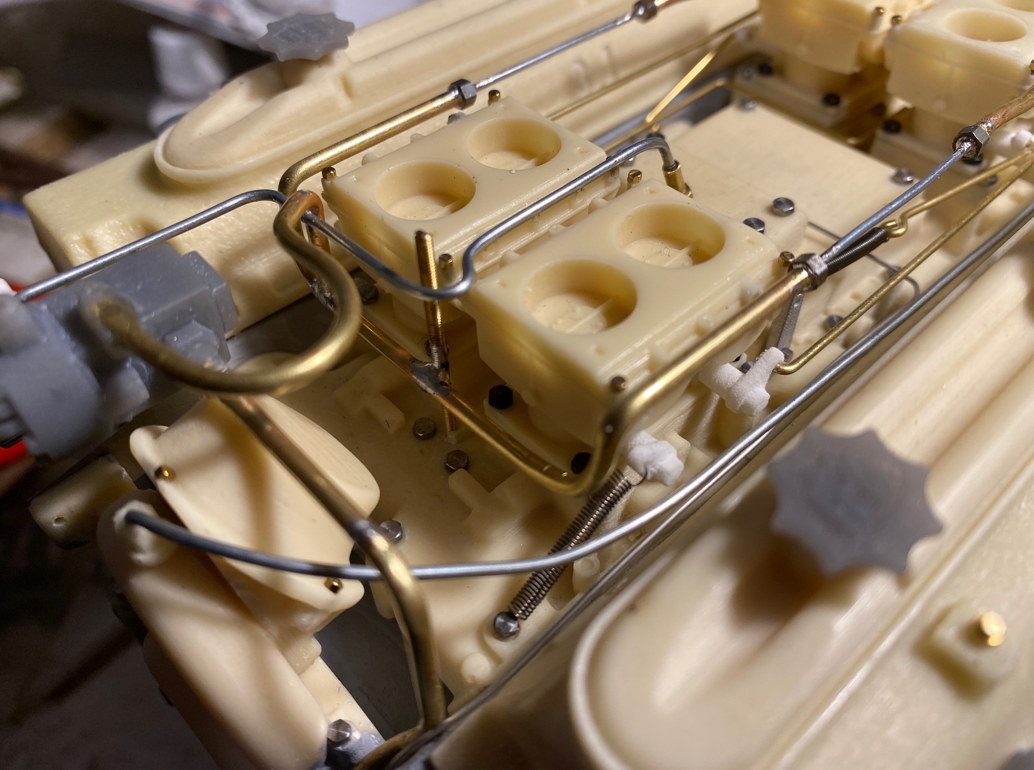

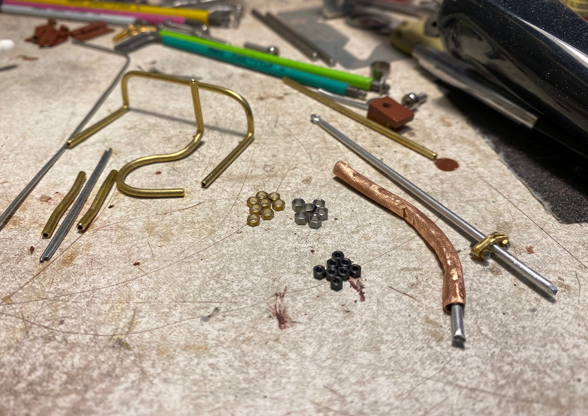

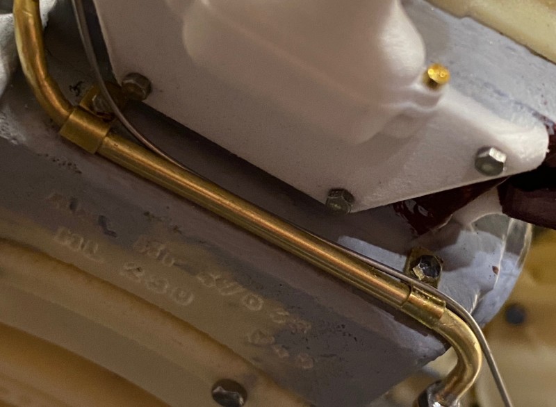

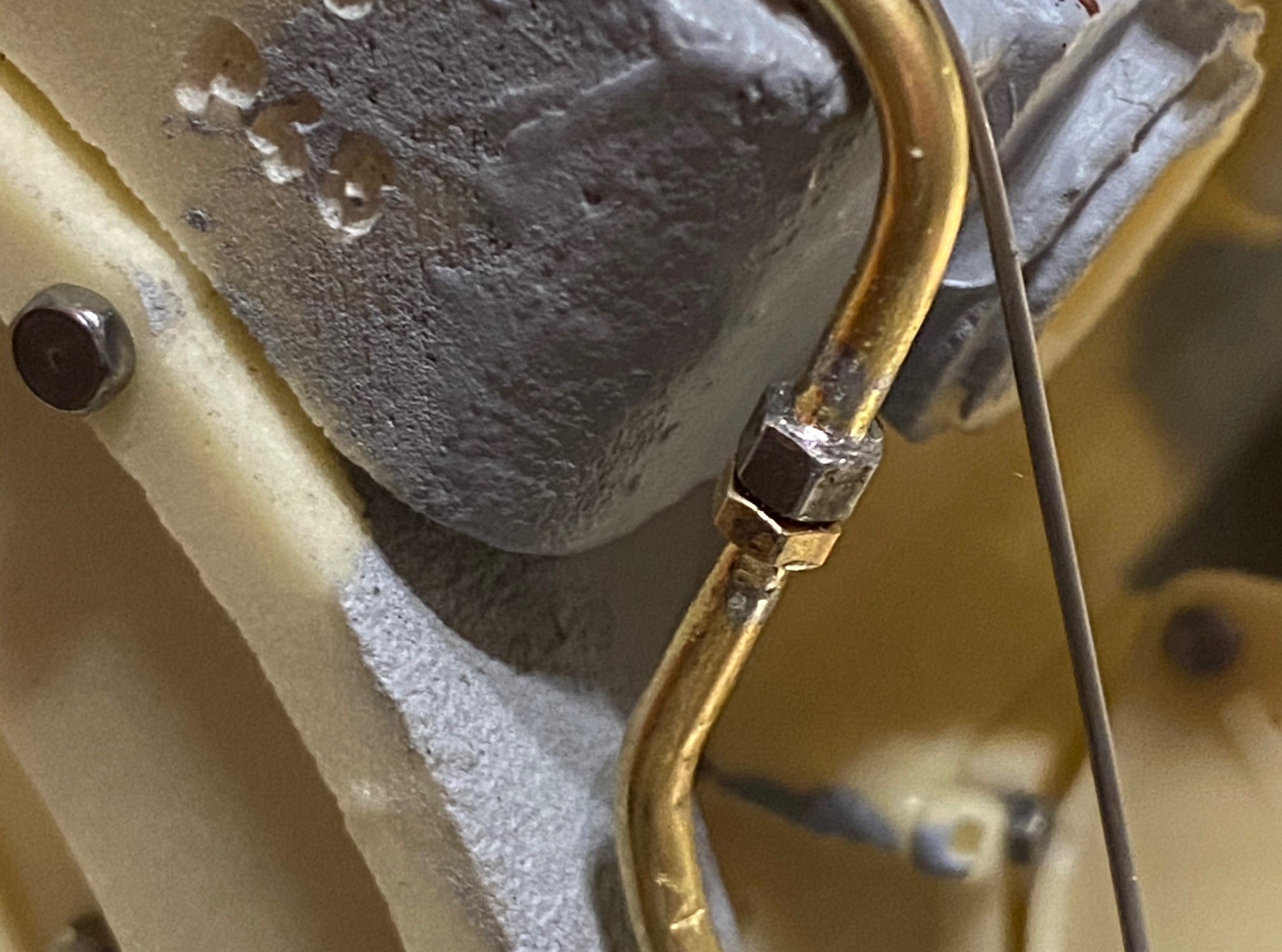

Here comes the next photos of the pipes, holders and all nuts for simulating the fittings. All M2 nuts are bored out with dia 2,1 for pipes of 2mm and M1,6 nuts bored out with dia 1,6 for pipes of 1,5mm, so some solder has place between. Also the alternator get a thick cable for connecting.
thank you for the "cute".

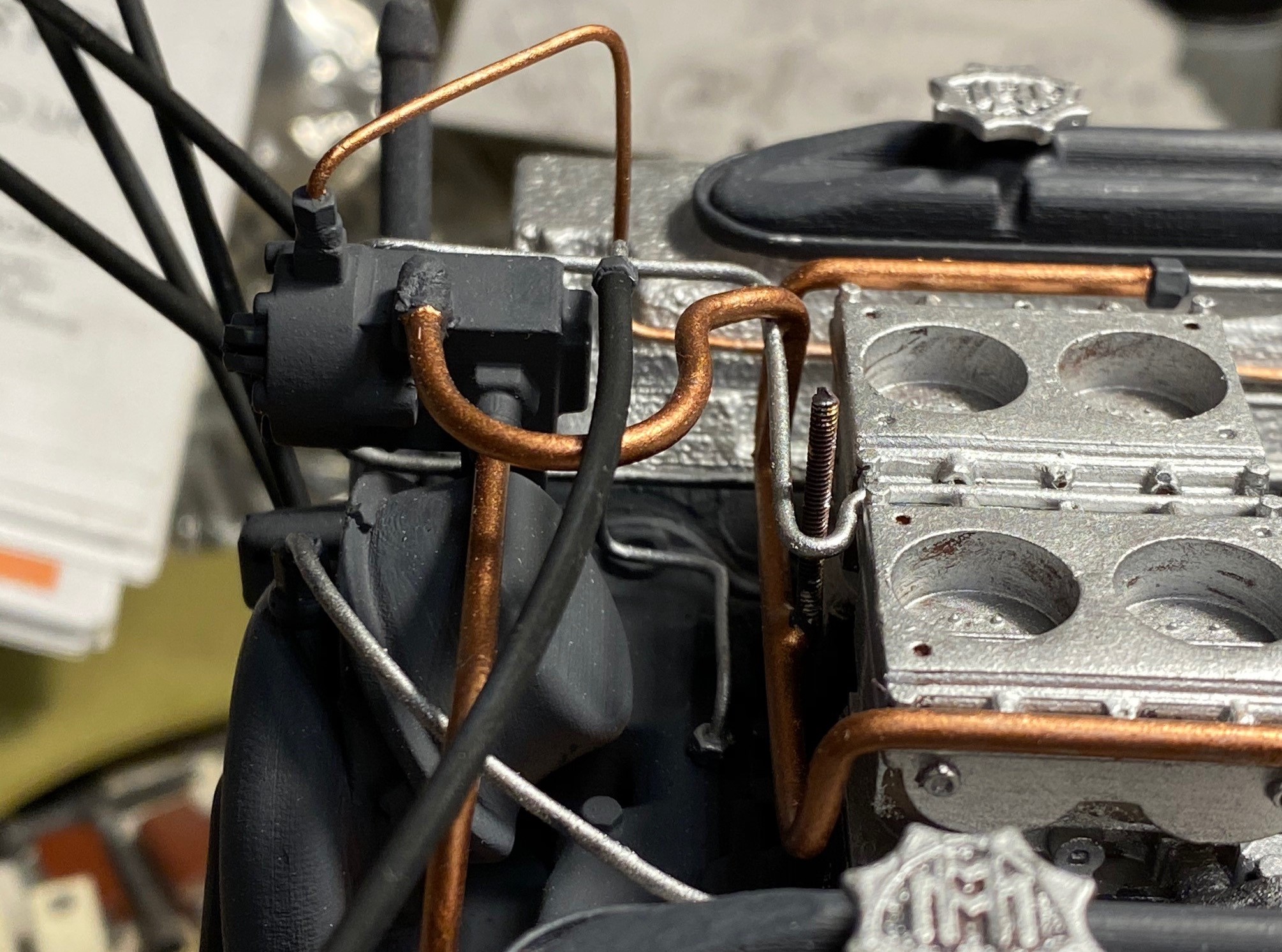

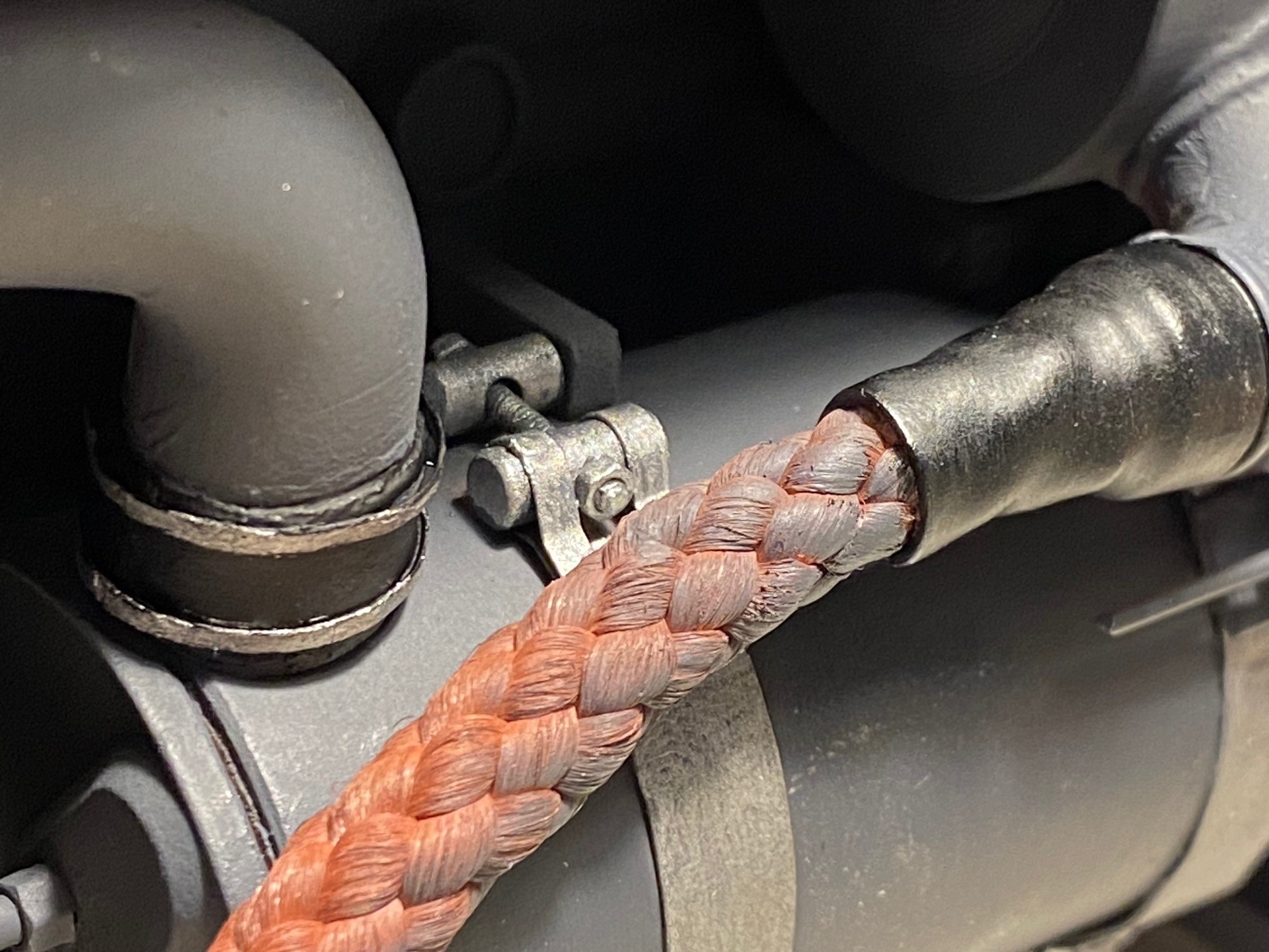

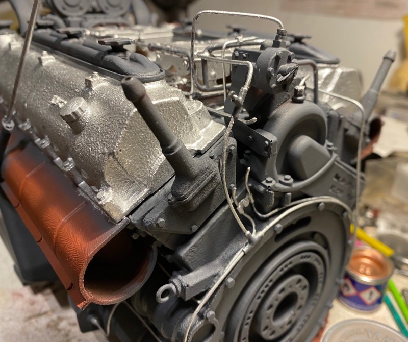

And it is a very good one. Here comes the next photos with new pipes and the first layers of color.
thank you for the FANTASTIC, but i have to give it also to you, because it is your design

all the small bolts are glued in. It is not really possible to cut a thread of M1,4 in resin

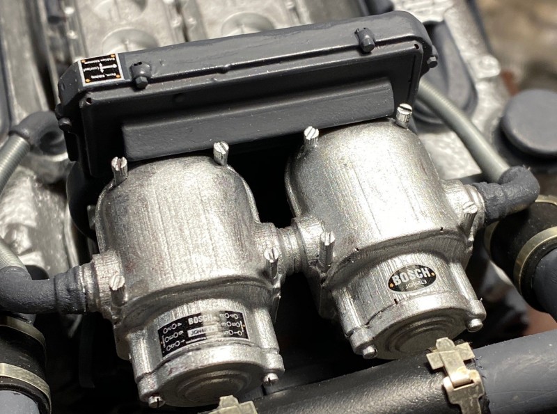

Here comes the next update with some more color. Slowly it looks more and more like a Maybach Motor.

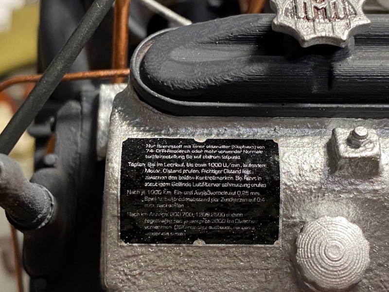

After the first paint there comes some more. There are so much details like the MM of the caps, the decals and so much more - great Ivano

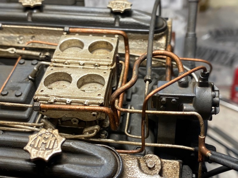

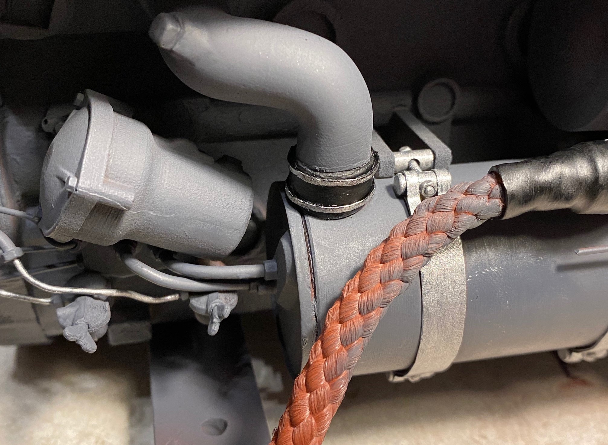

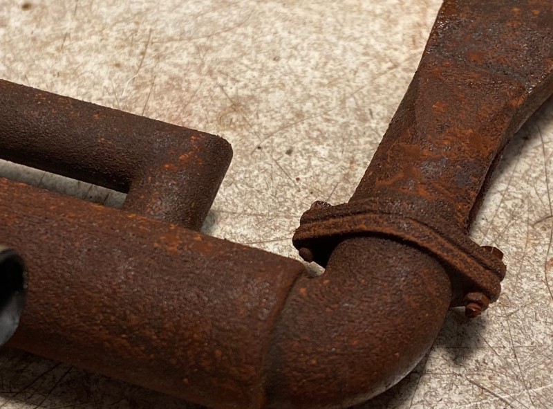

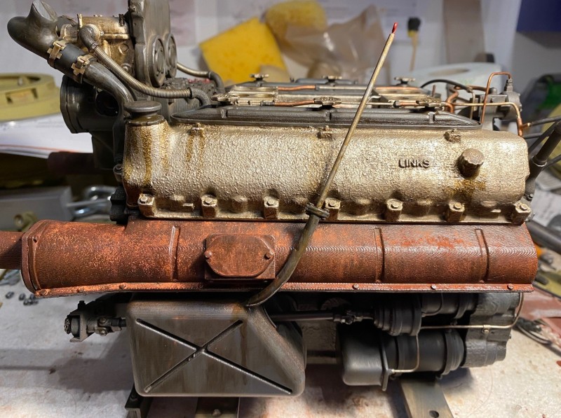

Most of all parts are ready for weathering. Only the preheater was missing. Here it is also getted rusty and dirty.
Now it is time to weather the motor and rusty the exhaust pipes.

What materials did you use to make all the cables, rods and pipes?
Do you mainly work with pigments in rust wheatering?
Regards Michael
The engine looks very great!
Regards Michael

Hi Michael,
thank you for the nice words.
The used materials was: steel wire for the thin silver painted rods, brass pipes for the copper painted pipes, steel for the nuts, rubber shrinking tubes for the cables and connections to the fighting room. An yes, i use several pigments and a brown color under the pigments for the exhausts.
Regards Martin
