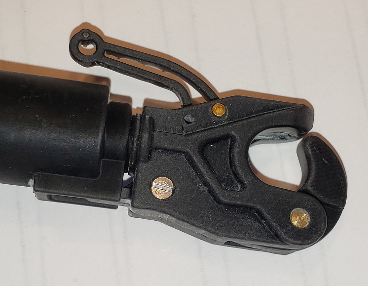

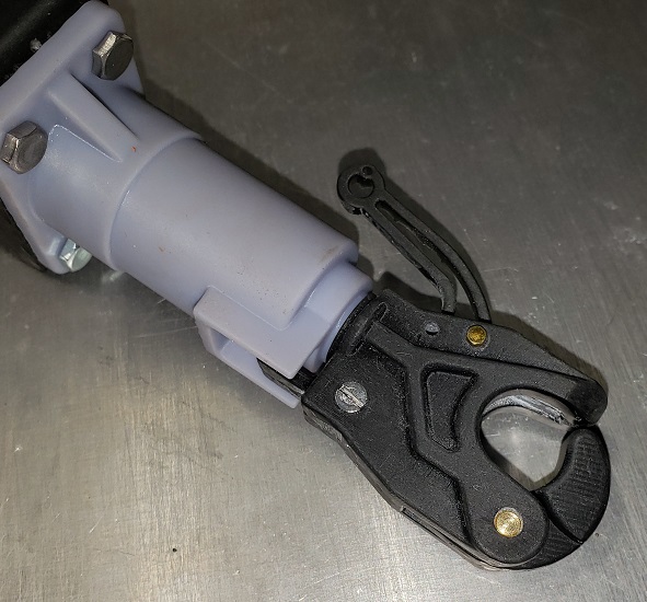

by Robert E Morey
Hi all,
A few new updates on the printed tow hitch prototype. Finally got the design how I want it. Also included some "as printed" images for interest.
Hitch closed:
Hitch opened:
Overall assembly:
Test fit on rear of model:
As printed parts:

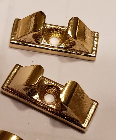

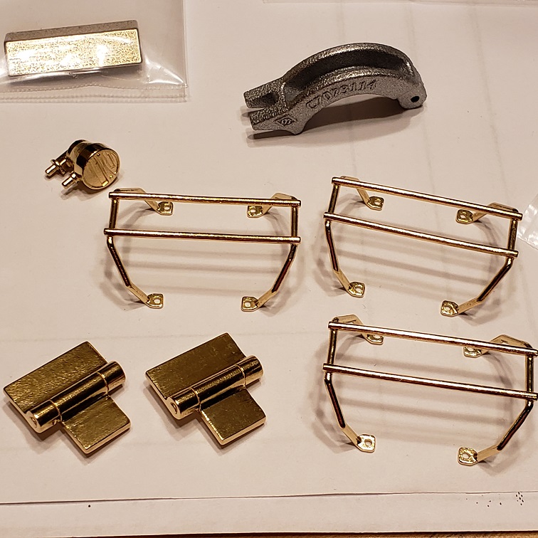

Nice detail brass printed parts from Shapeways. Actually these are investment cast from 3D printed wax models.
Periscope guards:
Tow Cable cleats:
Tow cable blocks assembled:
Rear tail lamps - non functional:
Mini wing nuts. Still need to drill and tap:
