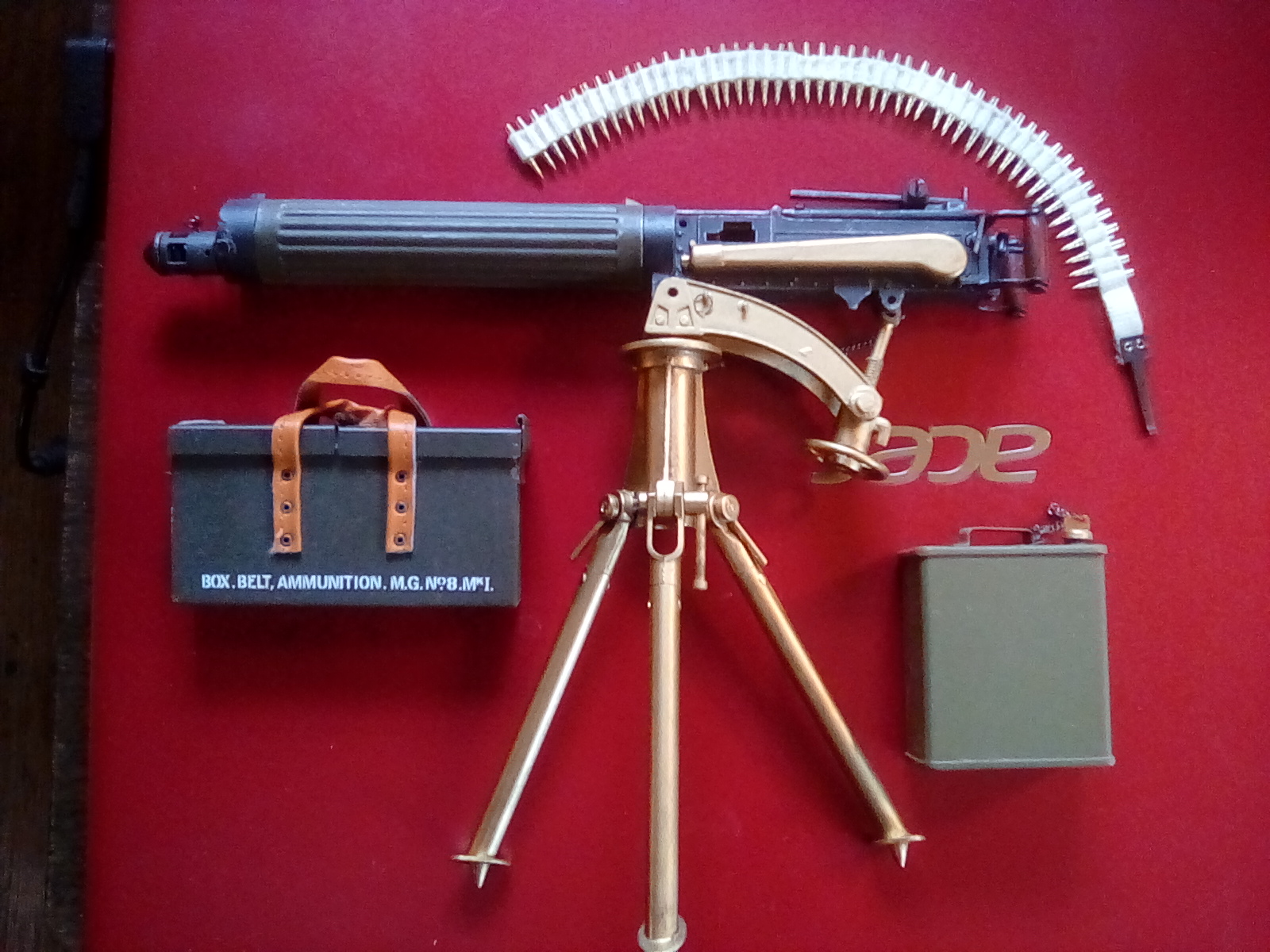

The RR kit arrived this morning, extras to include the engine and plinth, the solid wheels, turret search light and a superb metal Vickers machine gun.
Very nicely detailed Vickers all in metal.

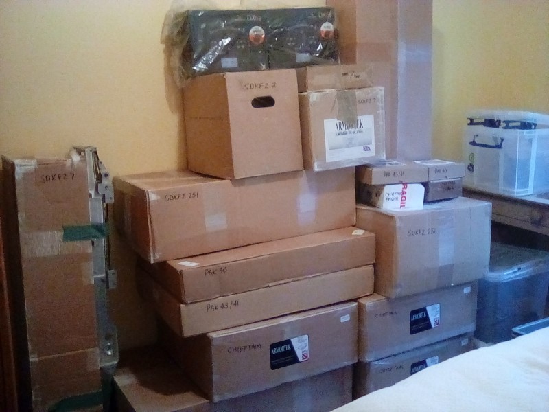

Commission builds awaiting their turn, should keep me busy for a while.

I thought I had a lot to keep me busy ....That's s a mountains worth of kits you have there :shock: :shock: :shock:
Look forward to seeing what you do with them.

That's only half! The back of the van was full!

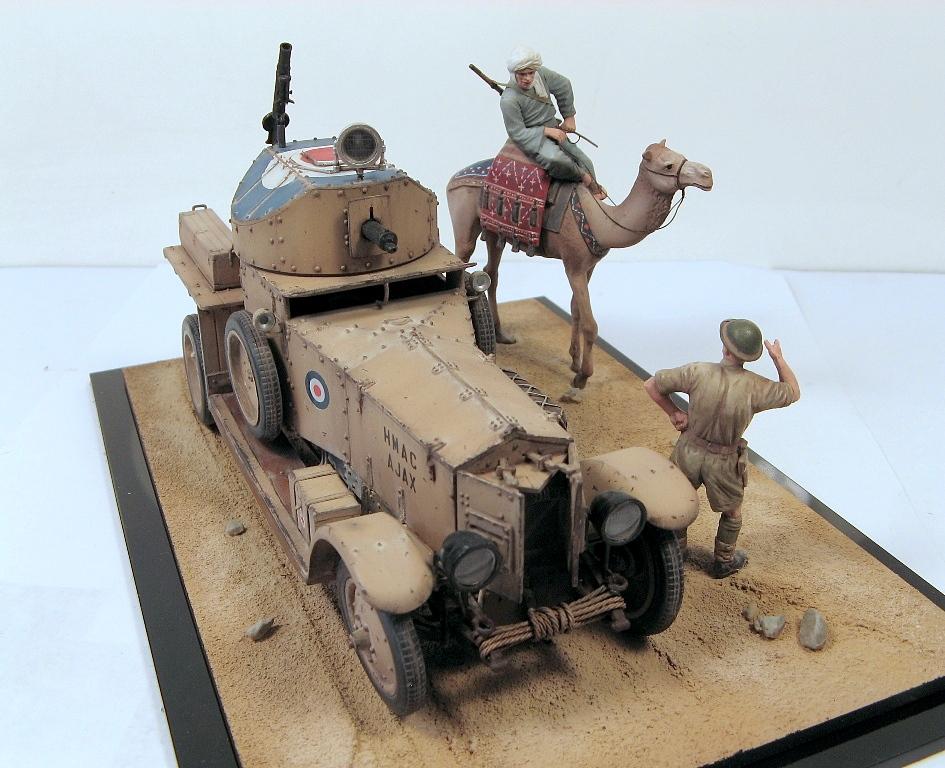

I like the RAF roundel on the turret roof! That Vicker's is awesome! Did you win the Armortek lottery and find a storage locker full of kits?
Re: Coming soon Phil Dawe's RR build
Hi Bob, that RAF version is going to look the business. I reckon Phil Dawe defiantly won the Armortek lottery! 8)

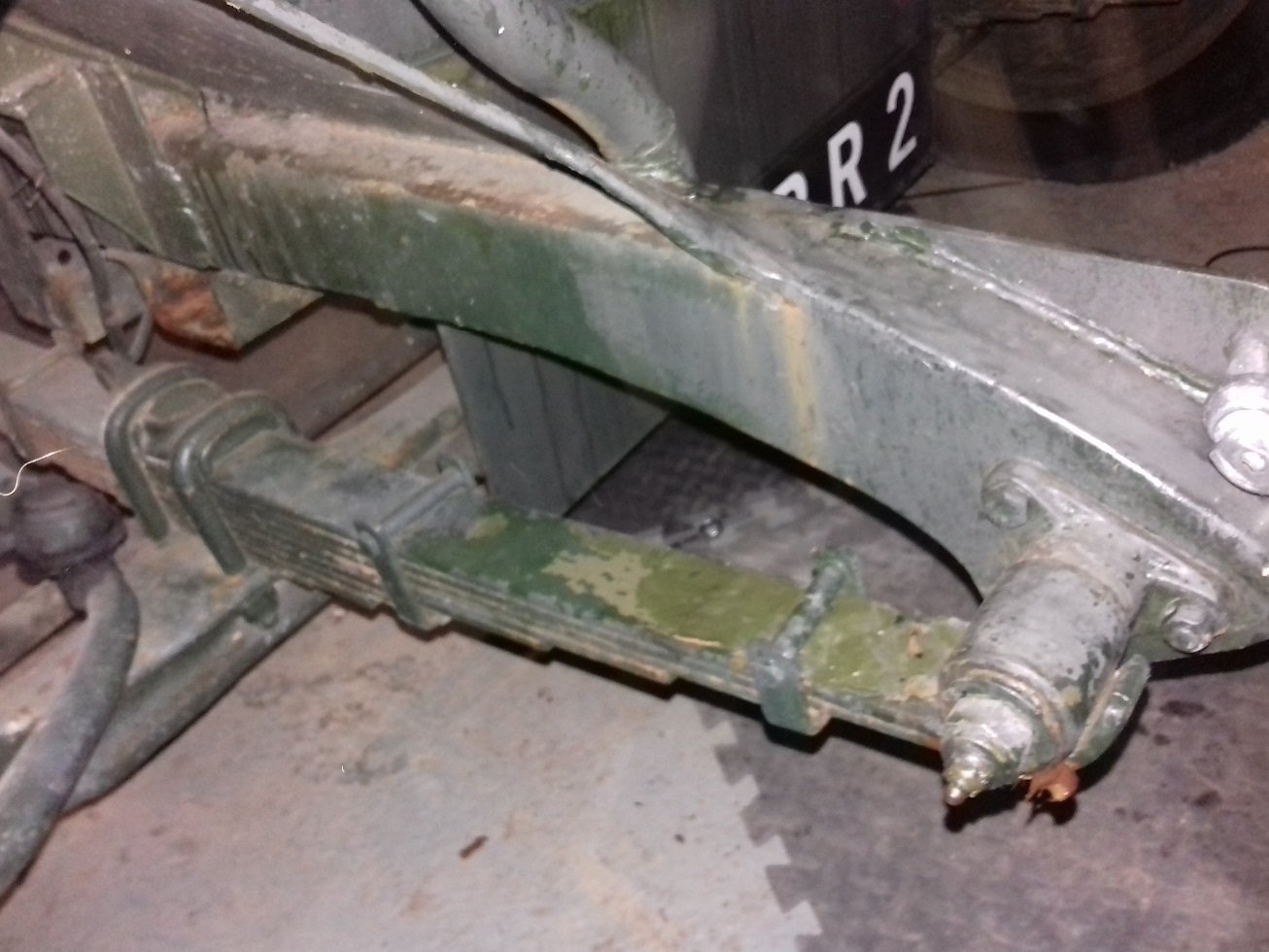

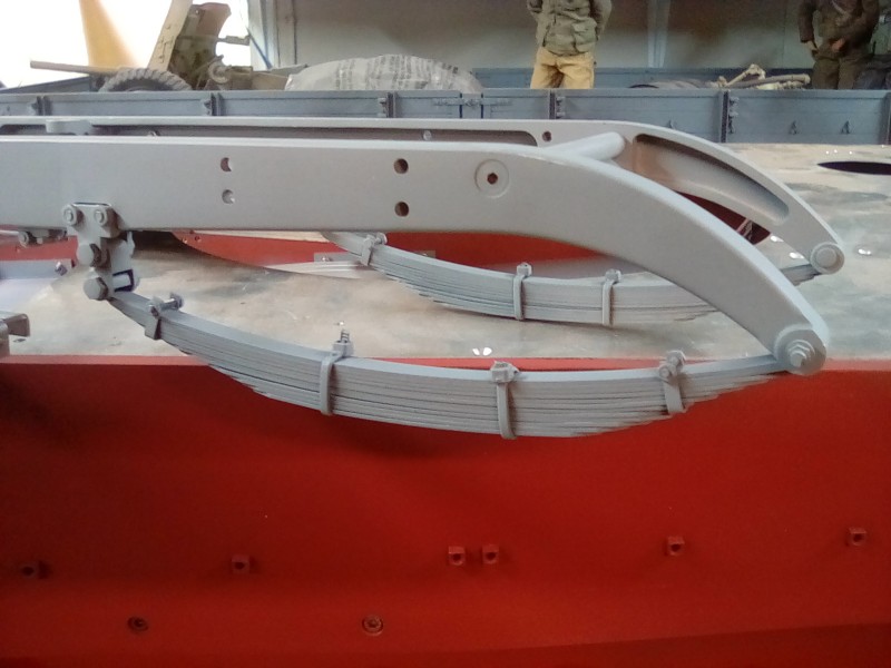

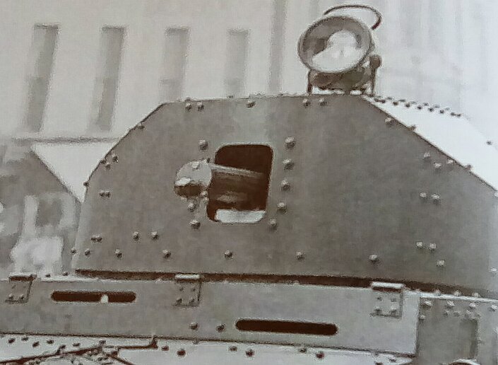

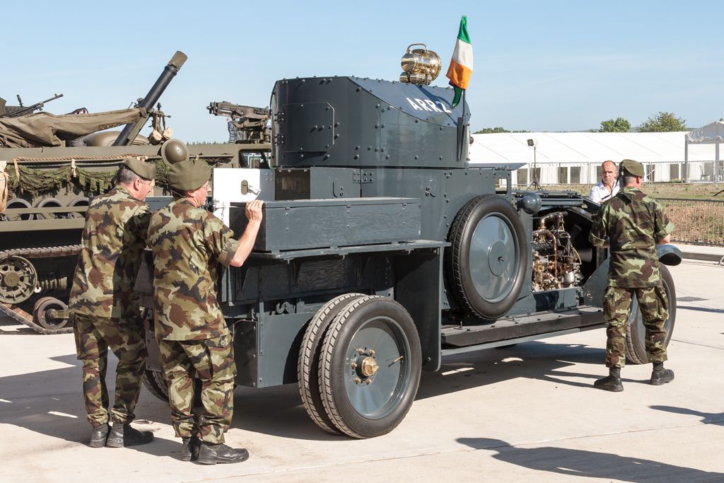

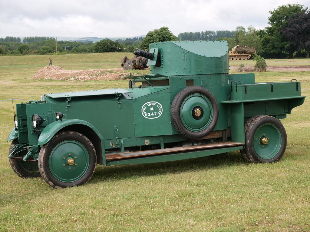

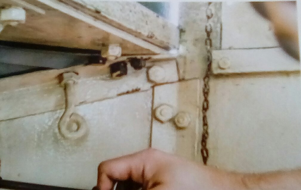

I've been studying photos of the surviving vehicles and particularly the Bovington example to confirm the type of fixings used on the body plates, now some vehicles seem to be constructed using rivets while the Bovington example seems to have nuts and bolts,now as the closest example to our chosen vehicle is the Bovington vehicle can anyone shead some light on this, were the rivets removed when it was restored and replaced with nuts and bolts, or was it originally constructed using nuts and bolts, or maybe a combination?
Difficult to make out but the nuts with a little thread are showing.
The interior clearly shows bolts and nuts.

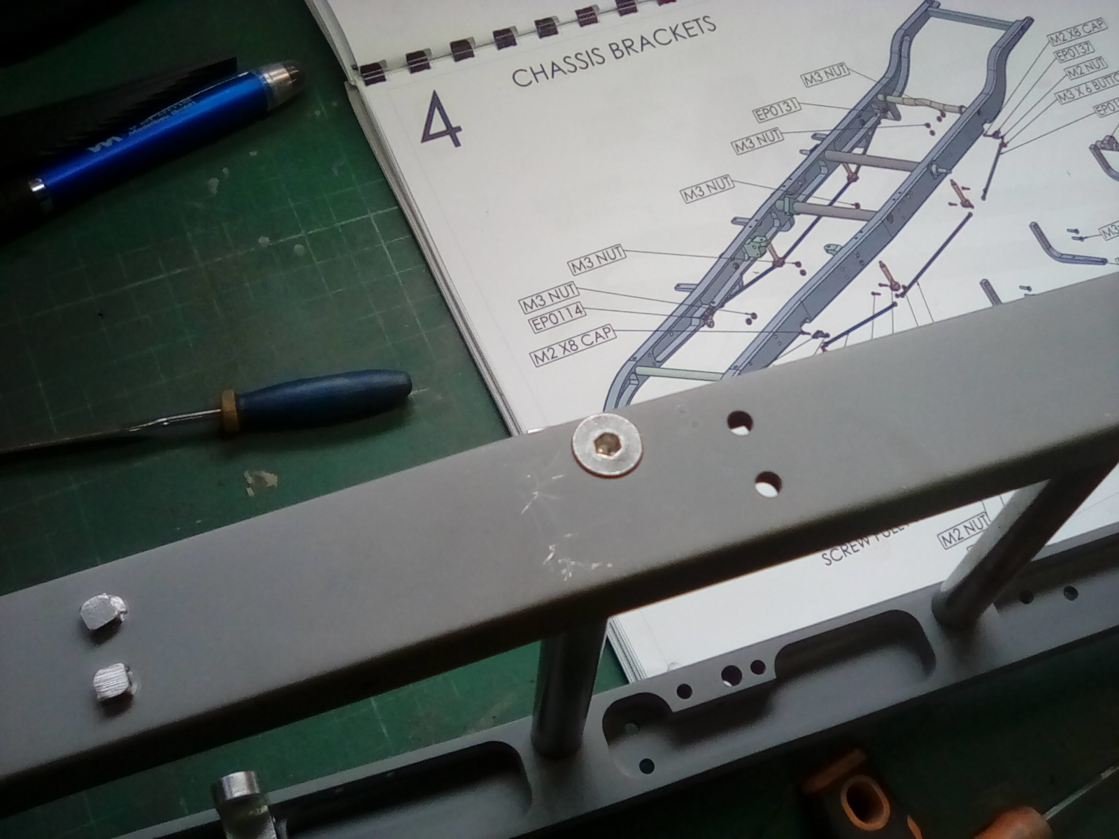

Re: Phil Dawe's RR build

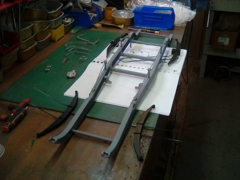

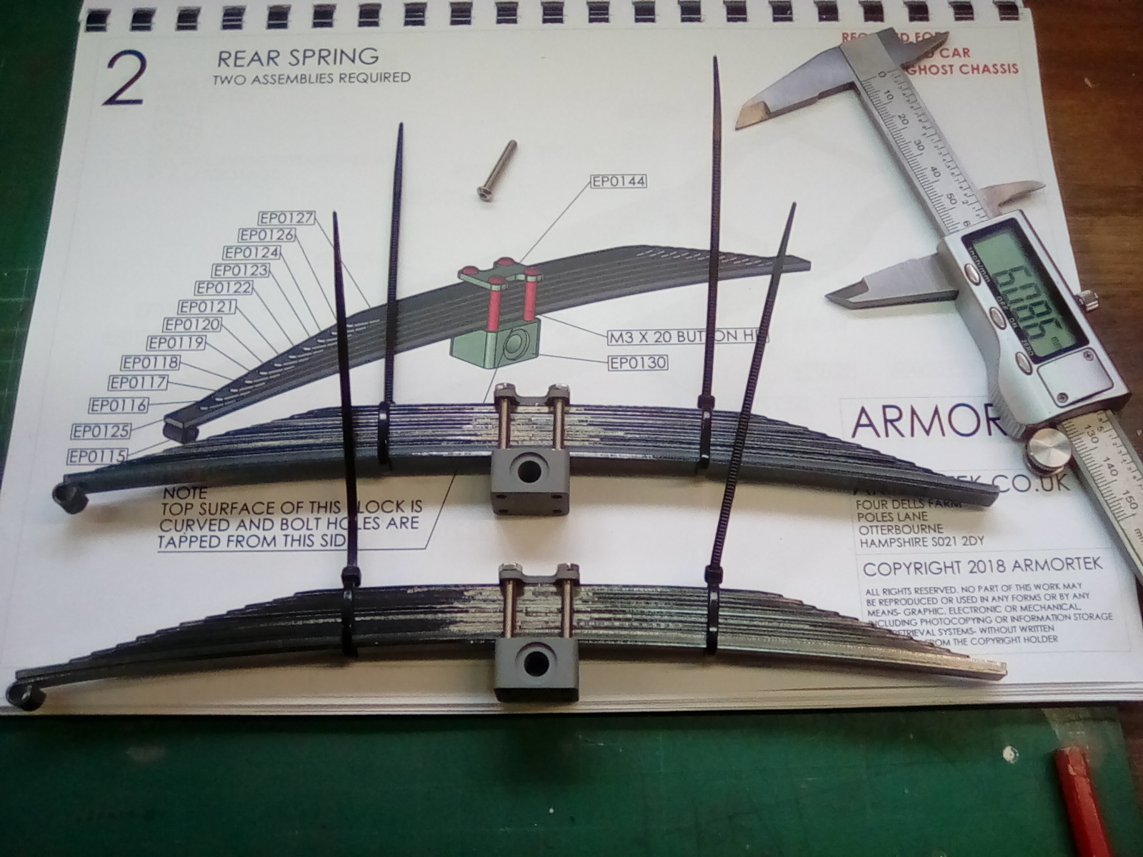

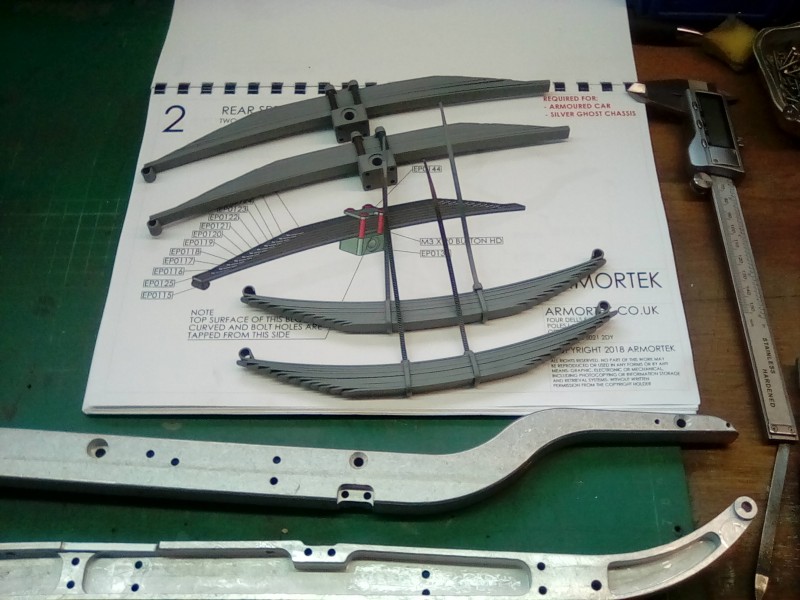

Off we go, spring set assemblies and chassis work. The kit has some very nice intricate parts with a good fit to. 8)

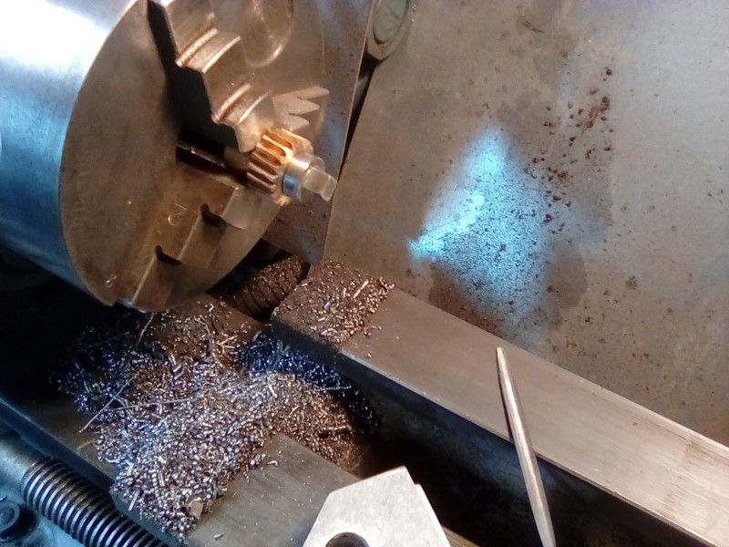

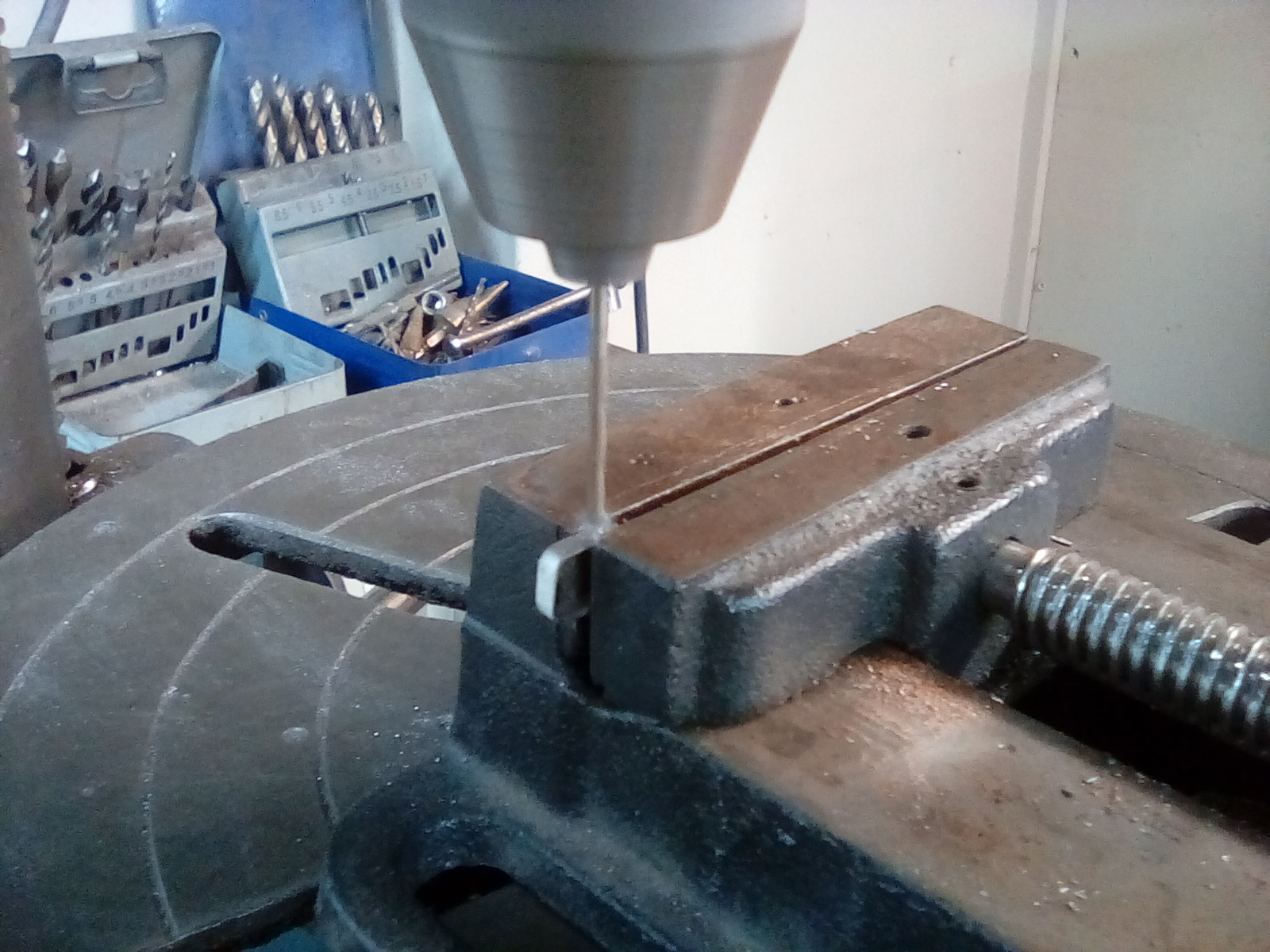

Lots of machining marks to work on, before and after photo.

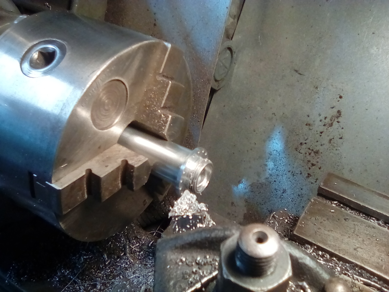

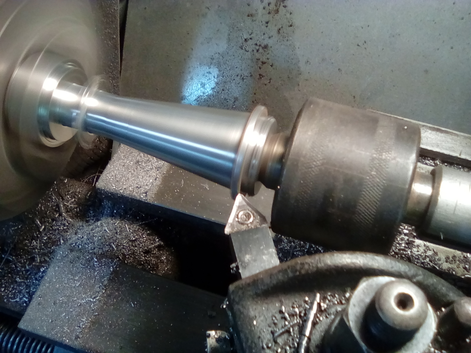

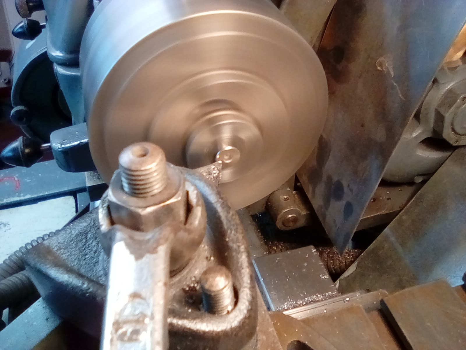

I tend to turn down the fixings head to get it below the surface rather than counter sink a bit deeper, some of the suggested fixings are just to long in the thread.

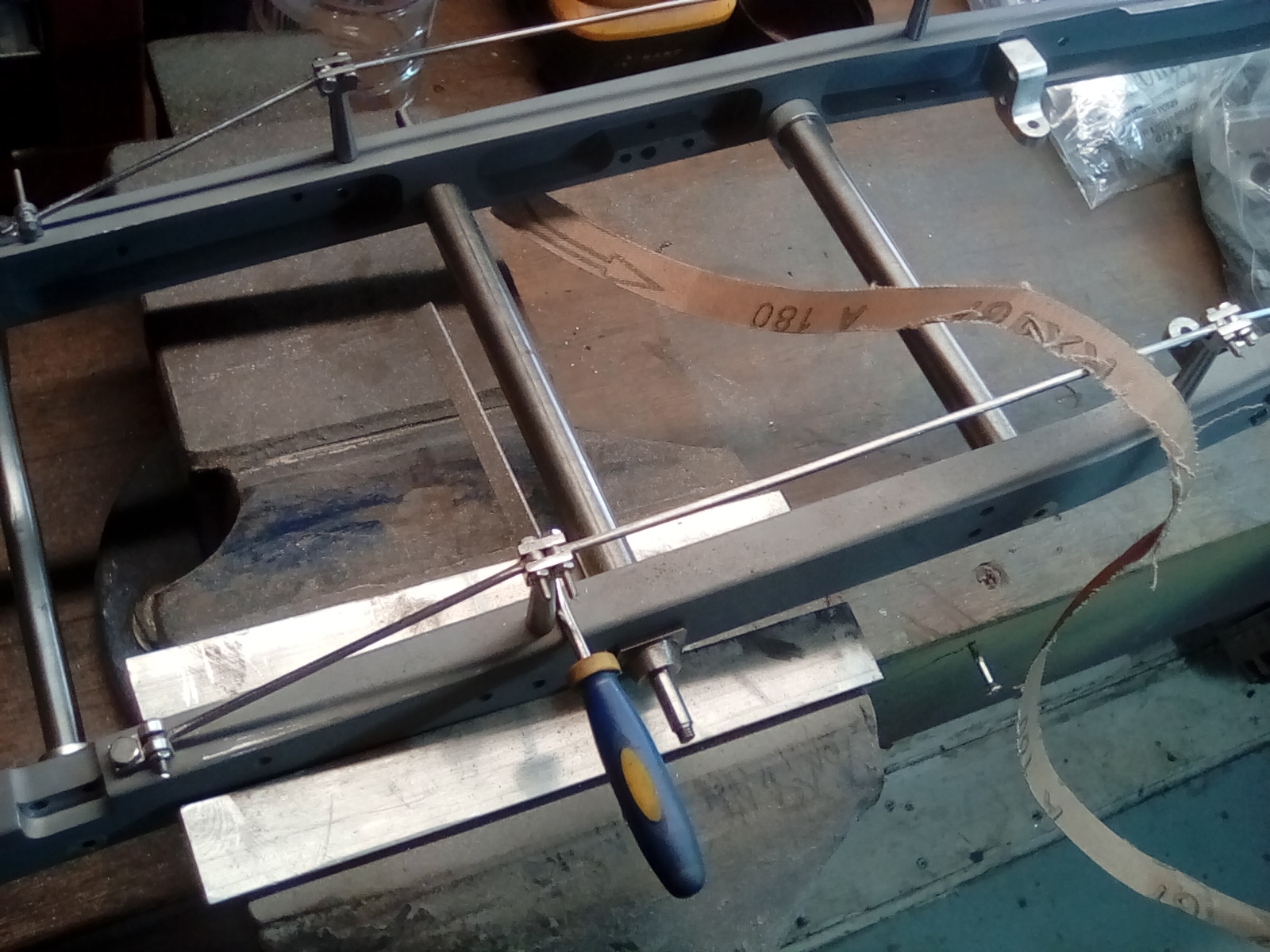

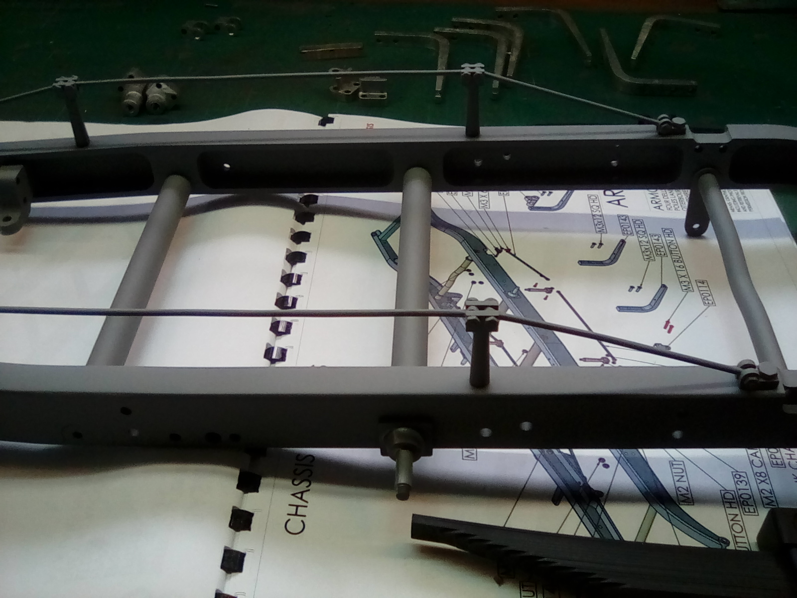

Filing square section into round/rod for the chassis stiffeners.
A good days work with a big pile of parts bags to show for it.

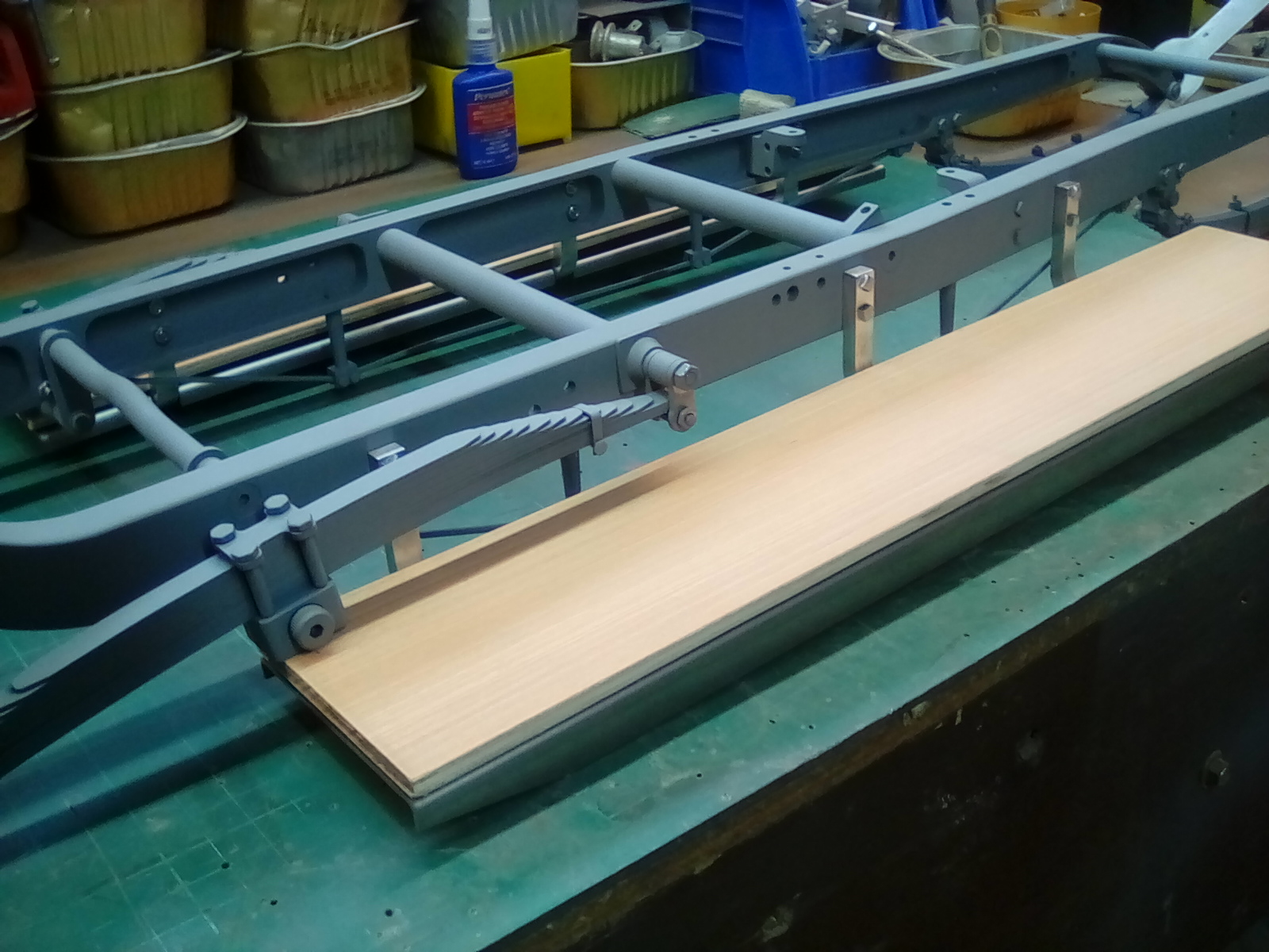

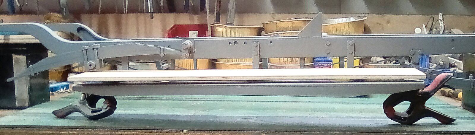

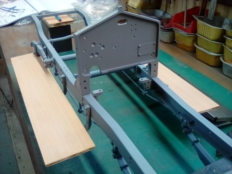

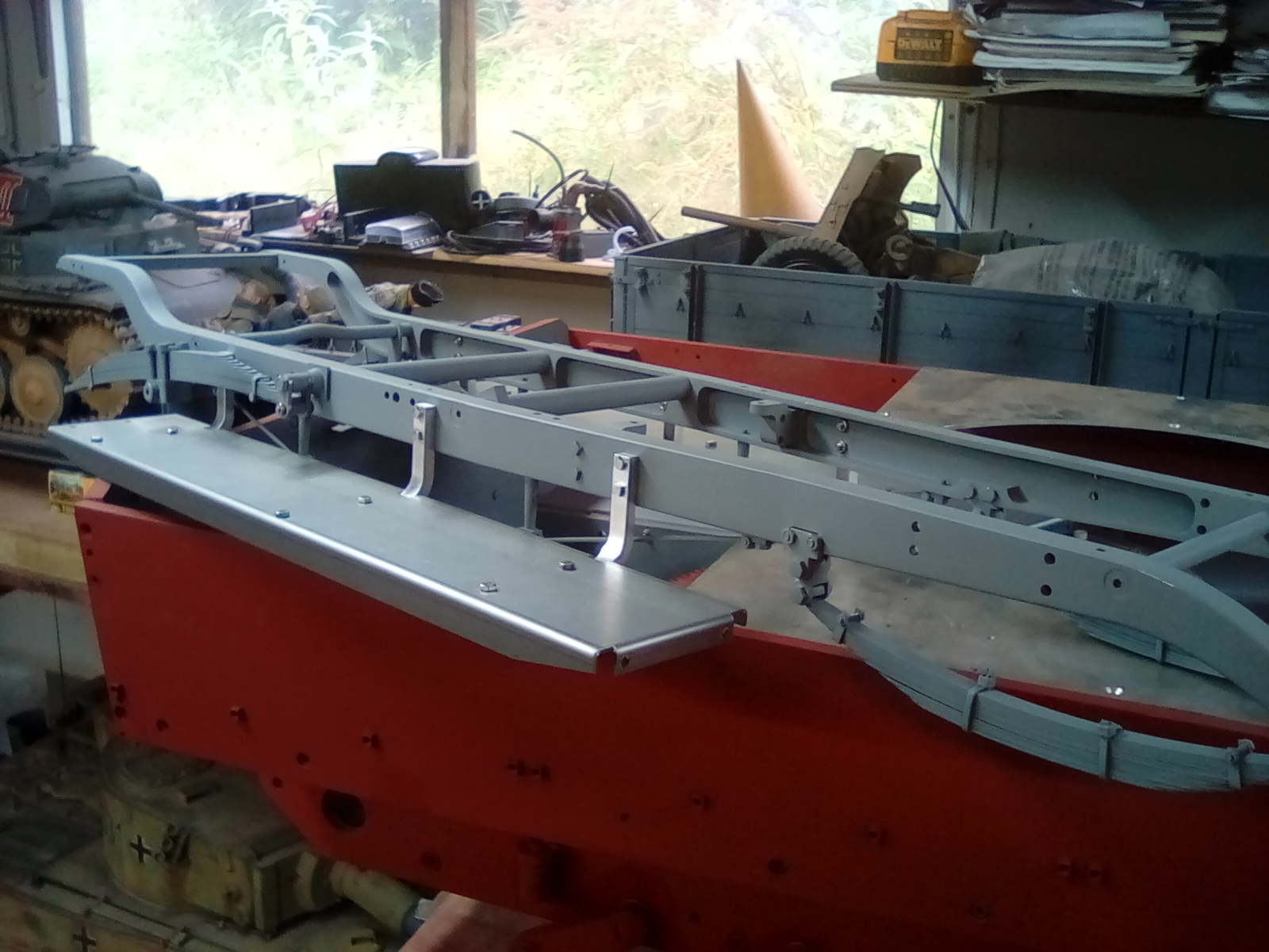

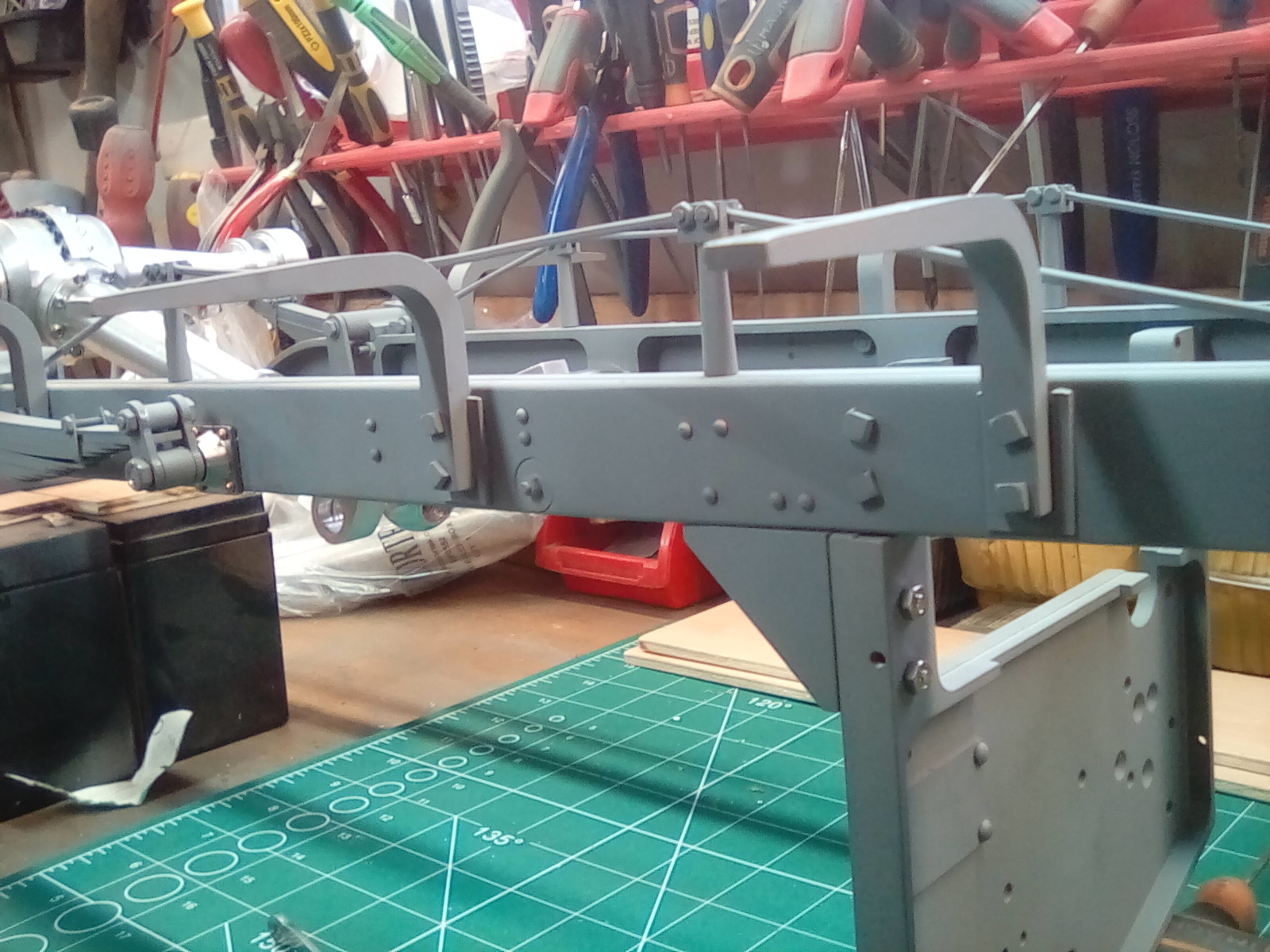

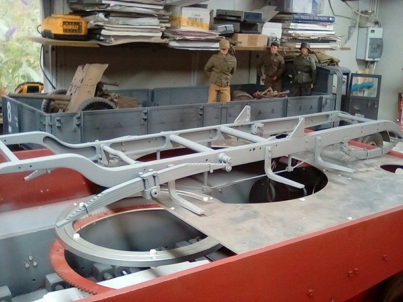

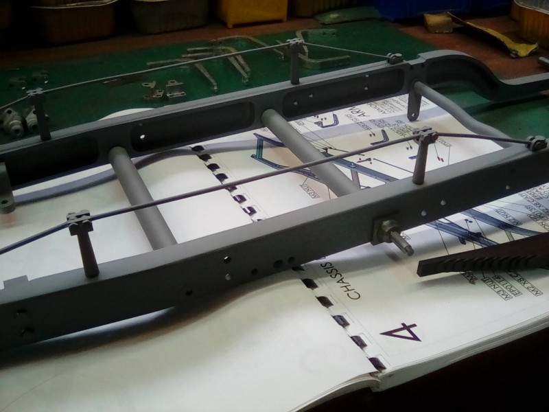

More chassis progress with a little woodwork. I'm enjoying this build 8)

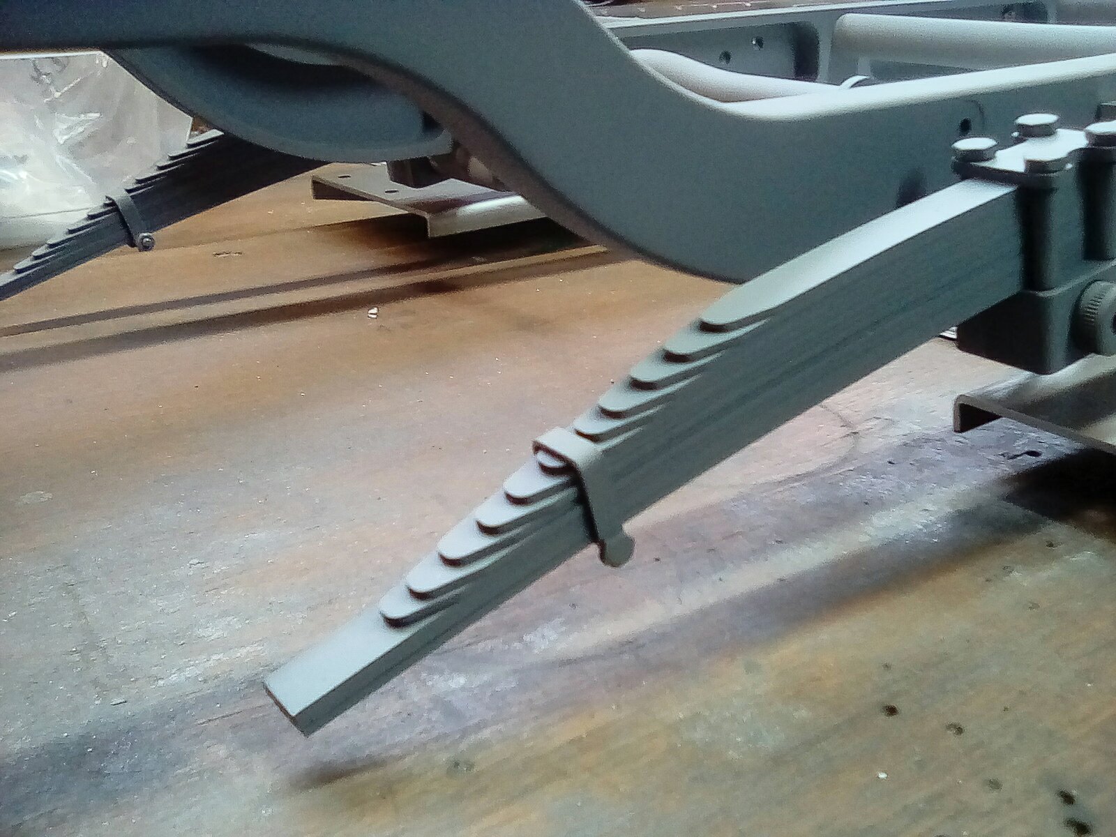

The very fiddly extra leaf spring brackets made and fitted.

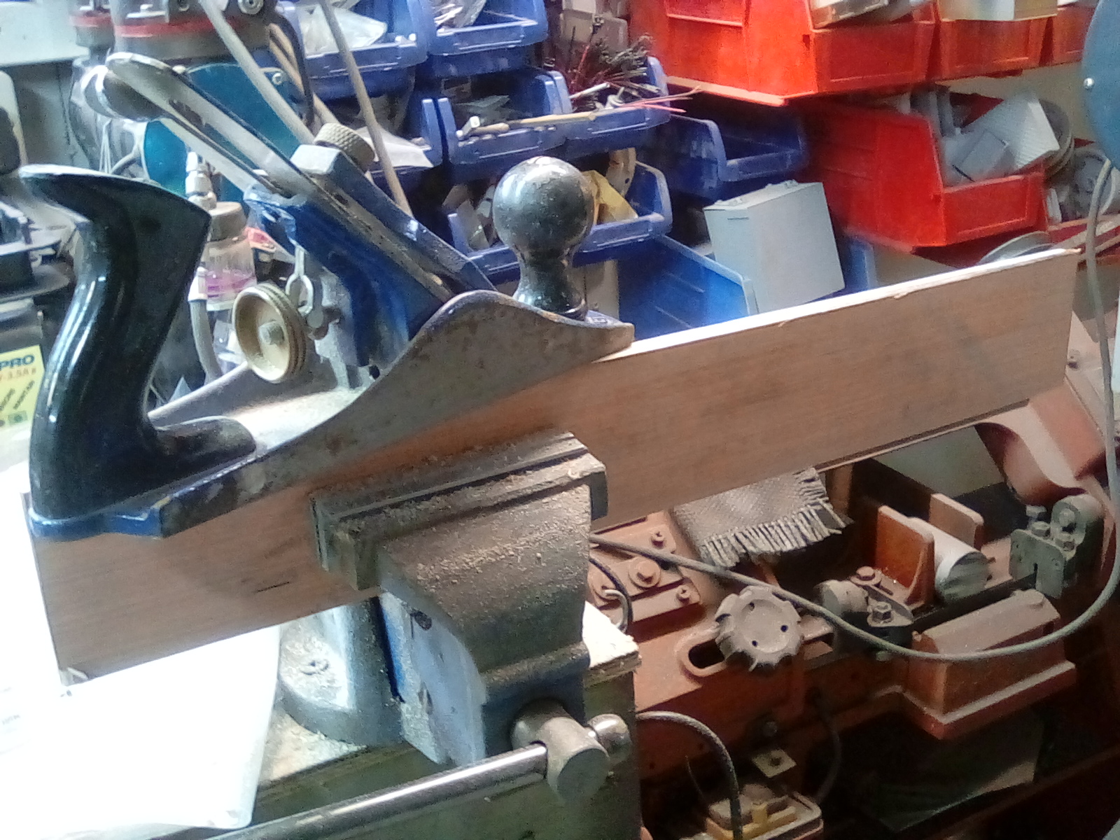

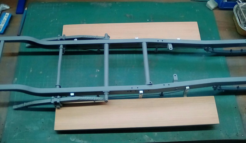

The kit position for the steel running board come ladder/ramp.
New running boards made from timber.
The new running boards with the sand ladders slung underneath, well that's the plan.

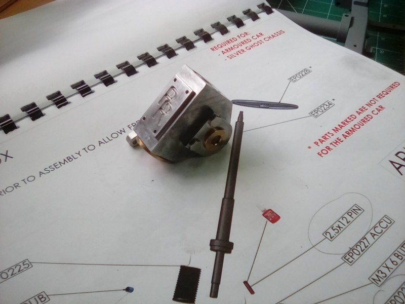

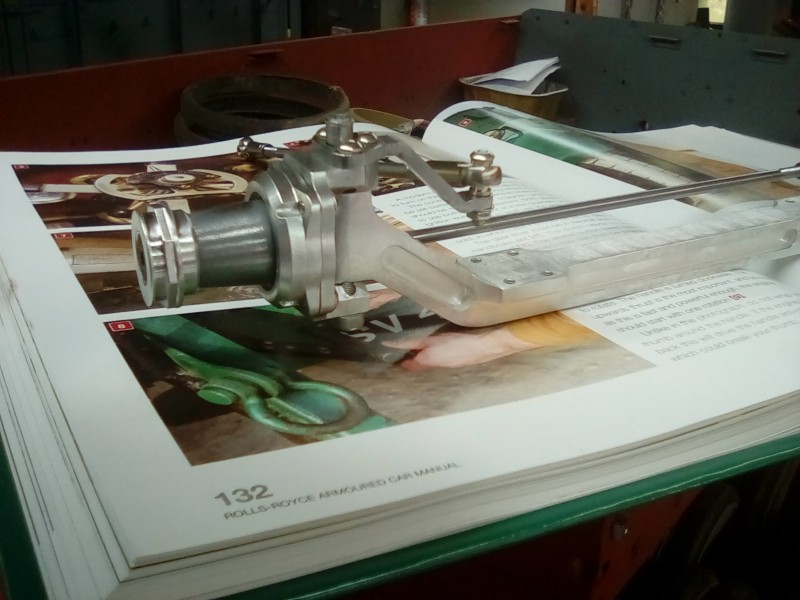

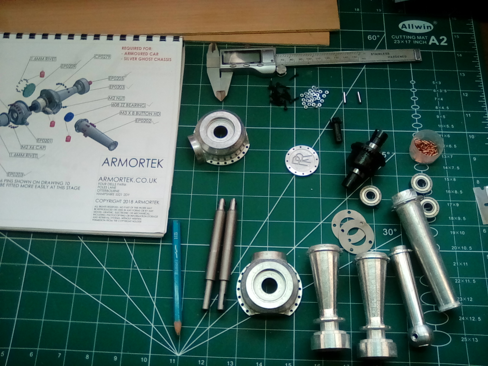

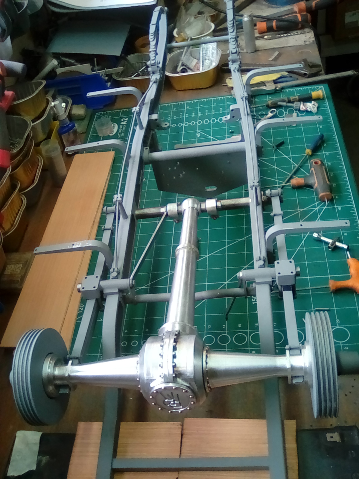

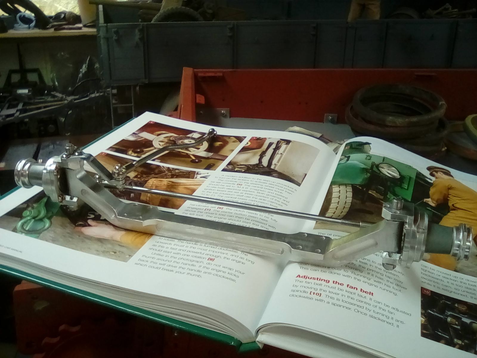

Cracking on with the extra chassis details and I've made a good start on the rear axle which is a work of art. 8)
The steering box parts fetling.
Nice little steering box.
All set out and ready to go.
Some extra fetling required here.

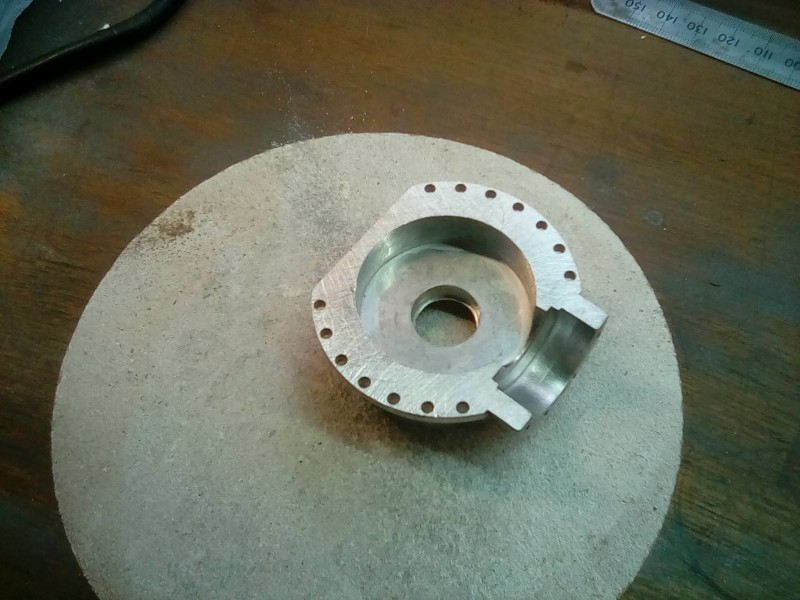

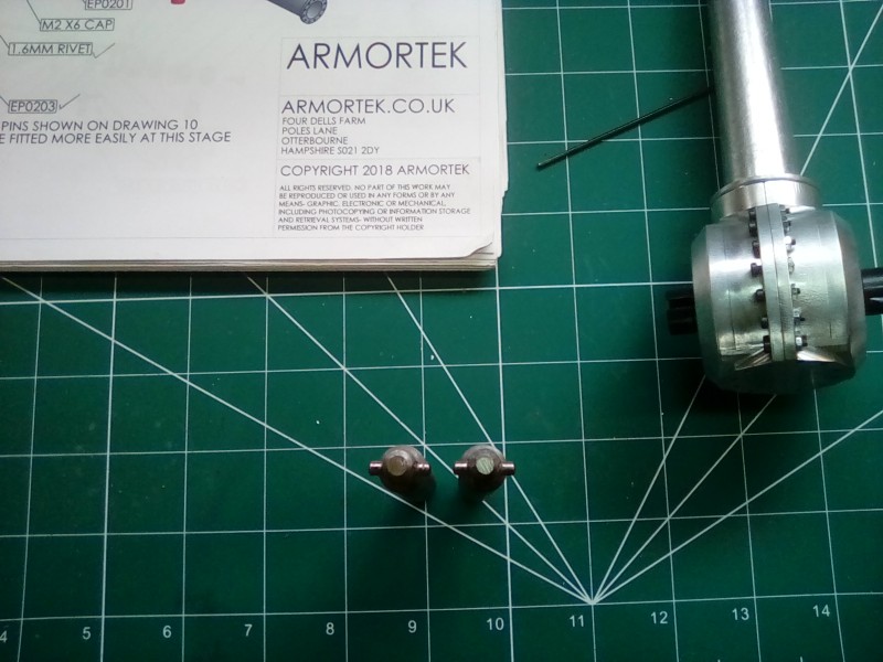

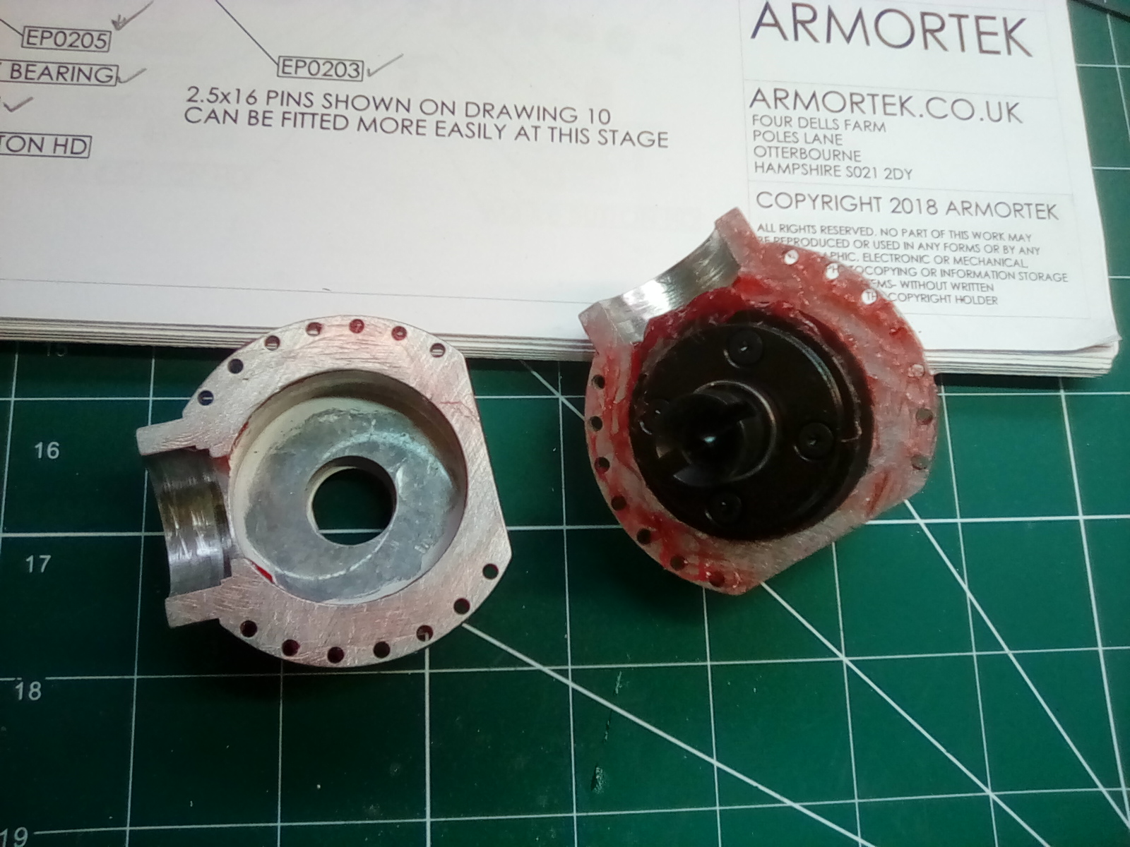

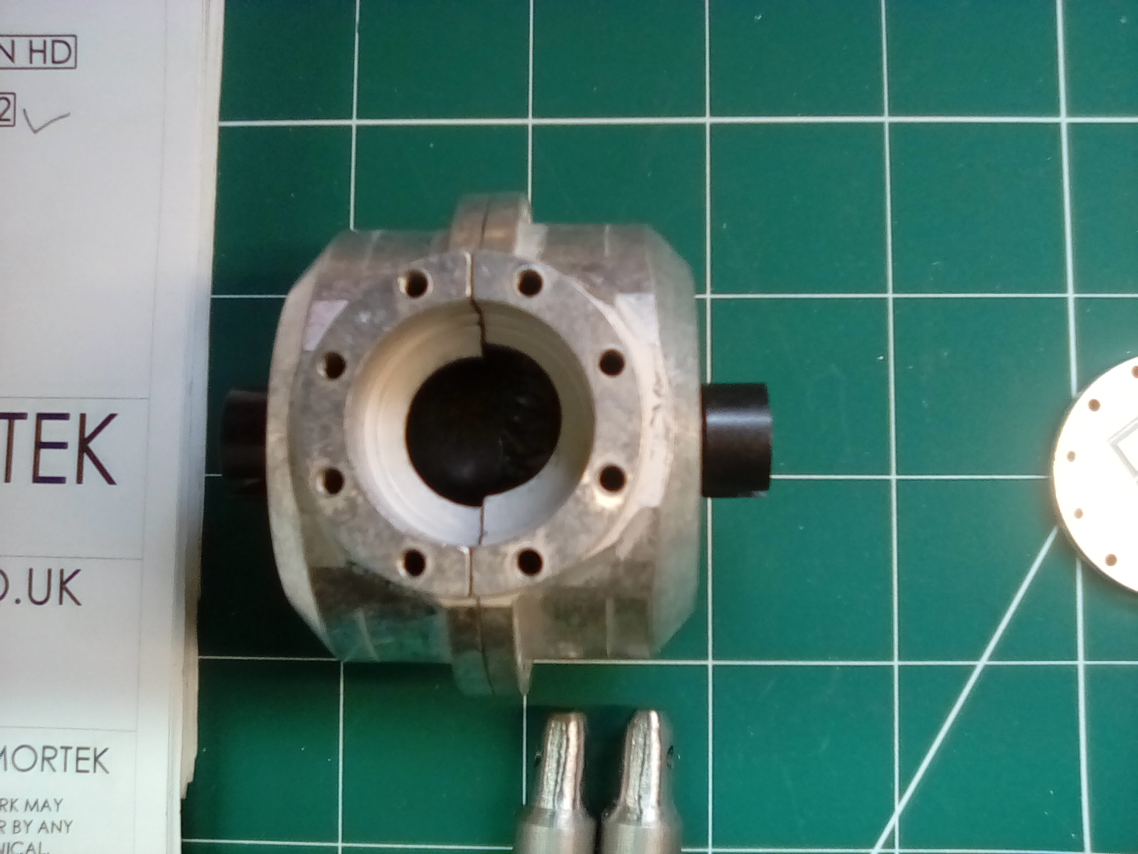

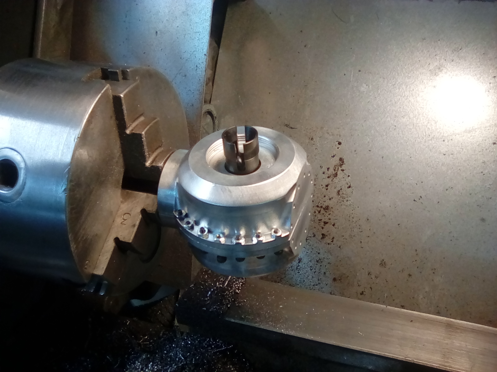

Flattening the lovely diff case halfs.
Running in the diff.
The drive pins are off centre.
The diff has been greased now that I don't think it has to come apart again.
The half shafts will need some work.
Keeping the finish to a high standard, well it is a Rolls Royce!

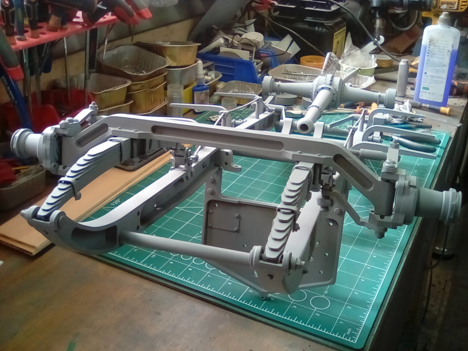

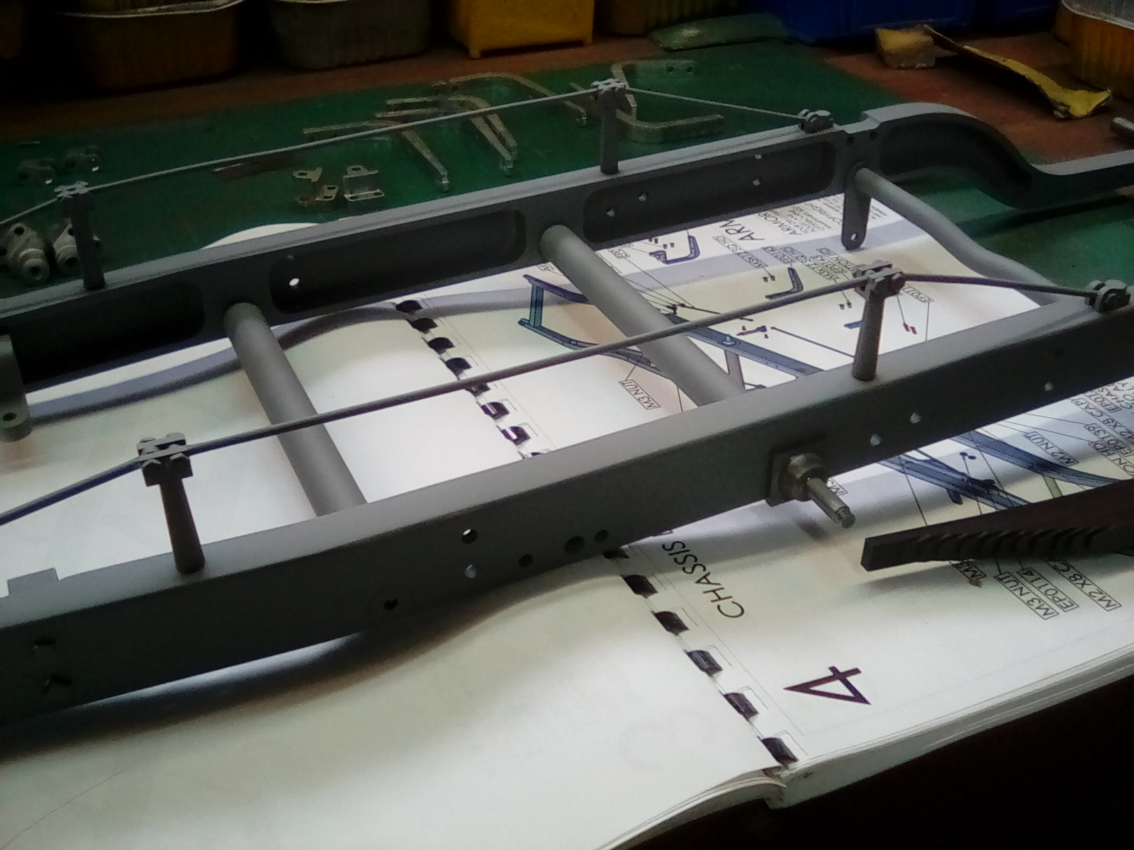

Re: Phil Dawe's RR commission build

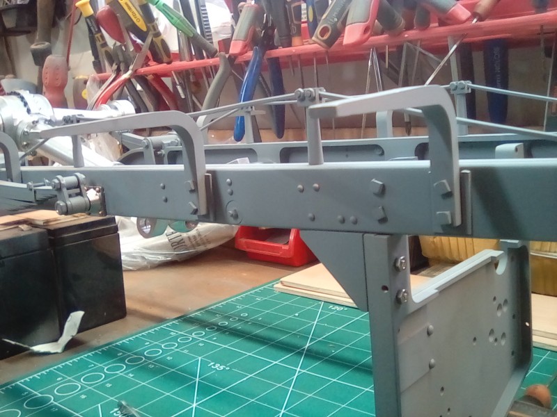

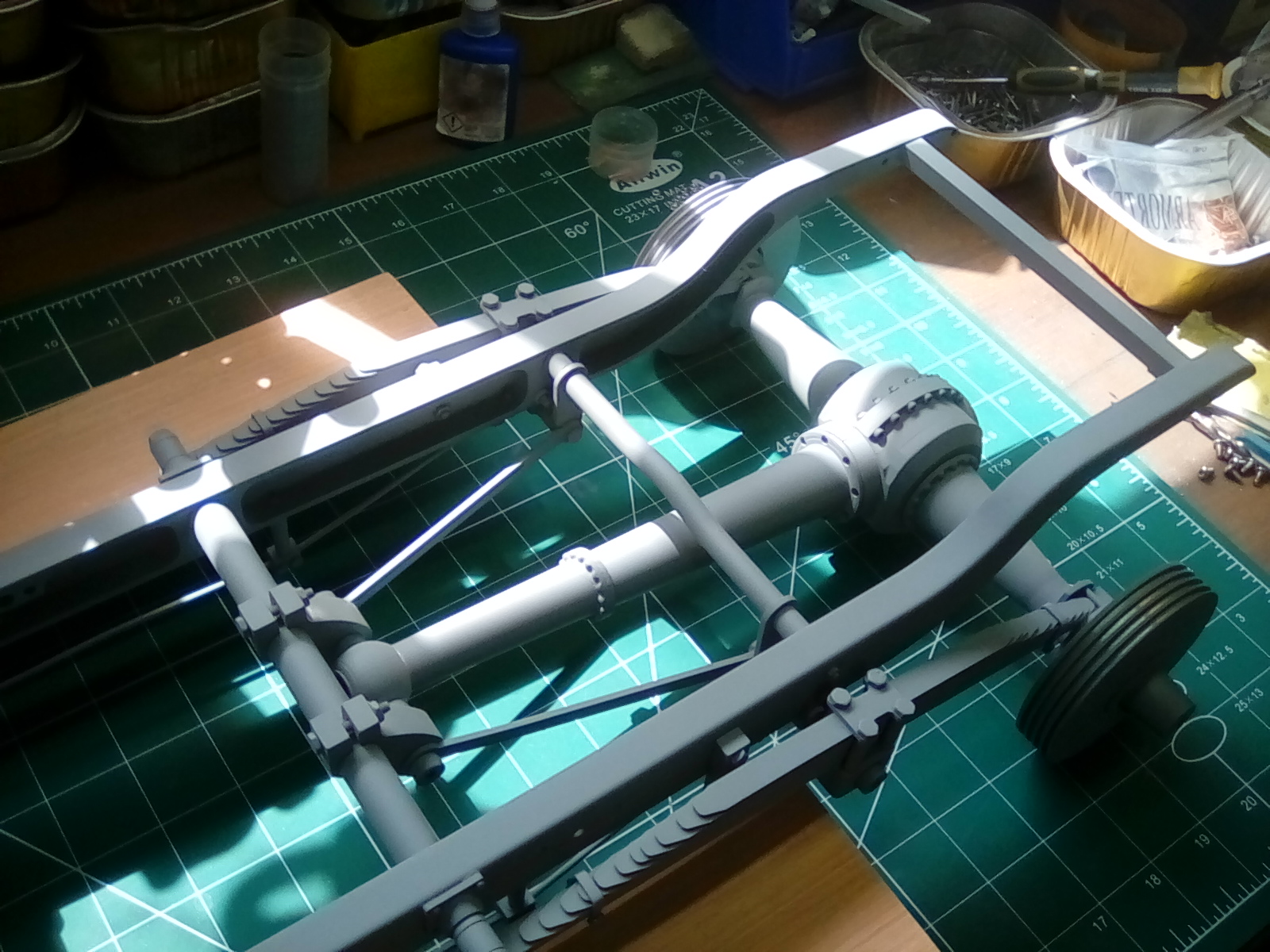

Lots done, there's some thought gone into this chassis. 8)
Lots of extra rivet detail added to the exposed chassis.

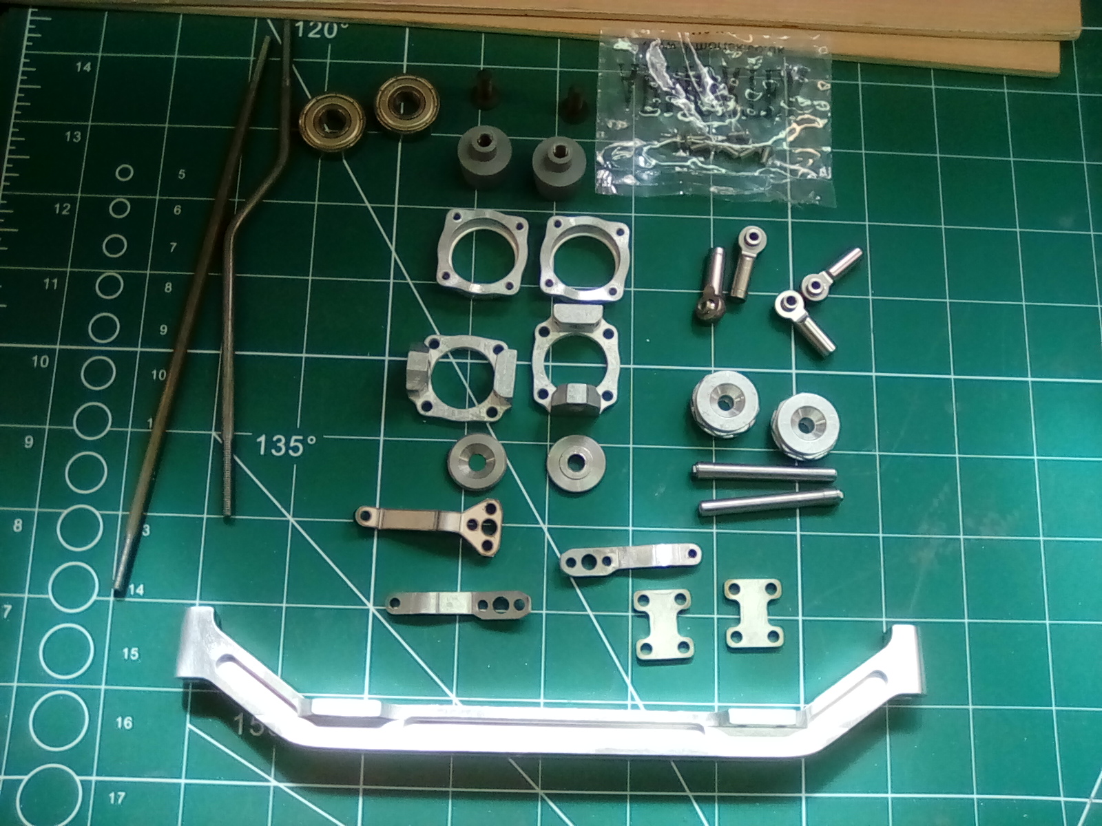

Just about all the parts need some trimming.
These two halves didn't line up true but they do now.
Fashioned the rear leaf spring mounts to look more like the real thing.

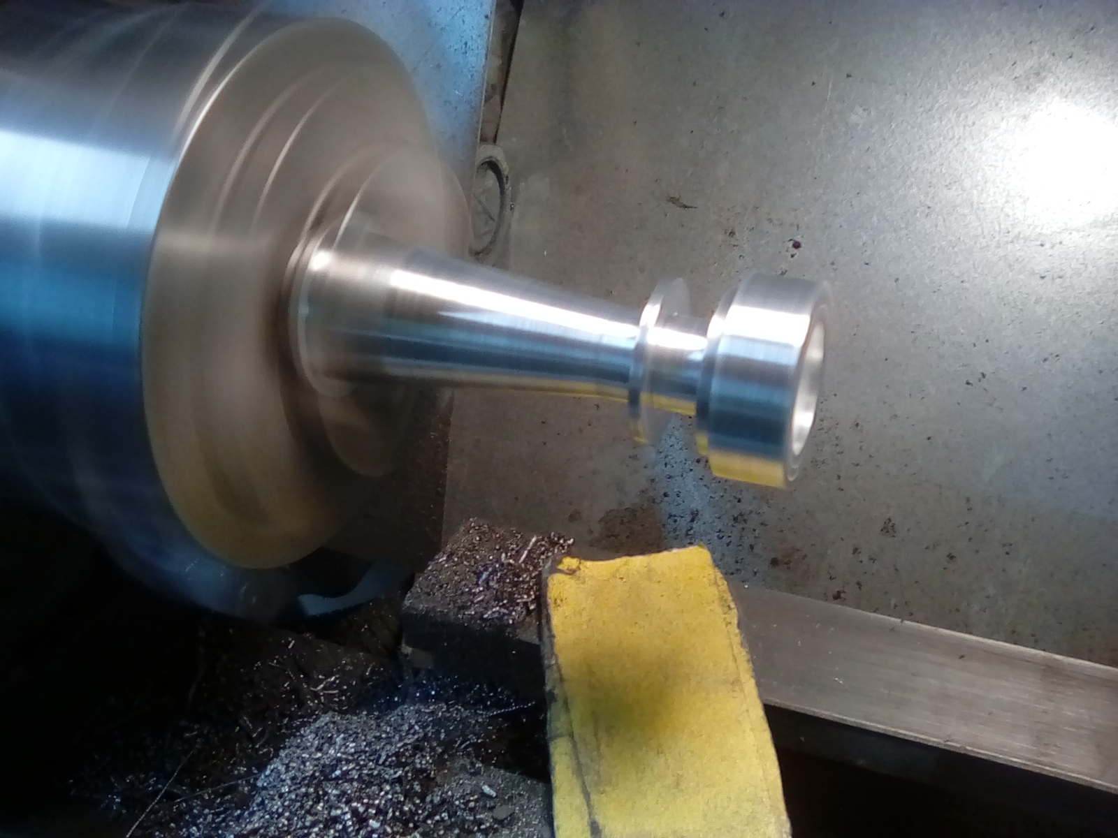

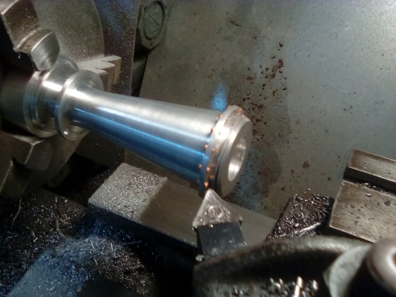

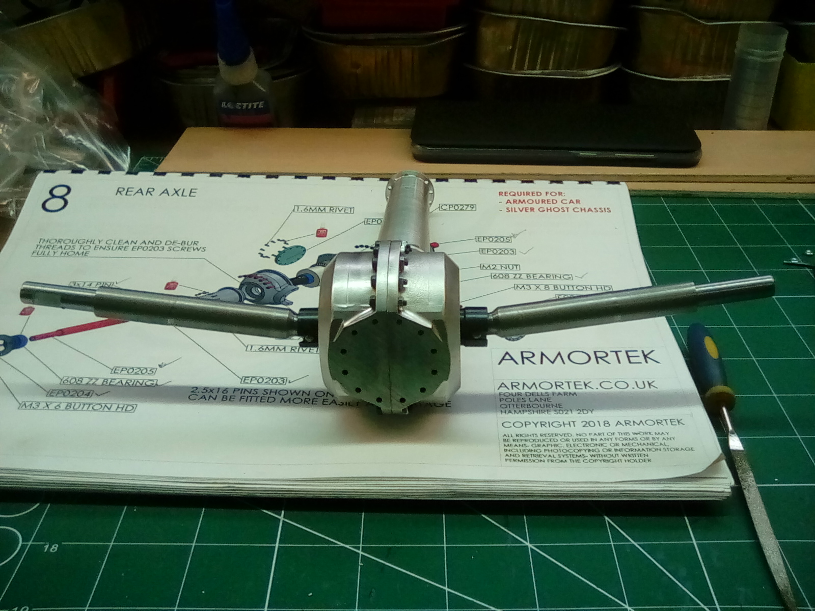

I have spent many hours trimming the half shaft trumpets until it all fits with little to no gaps .

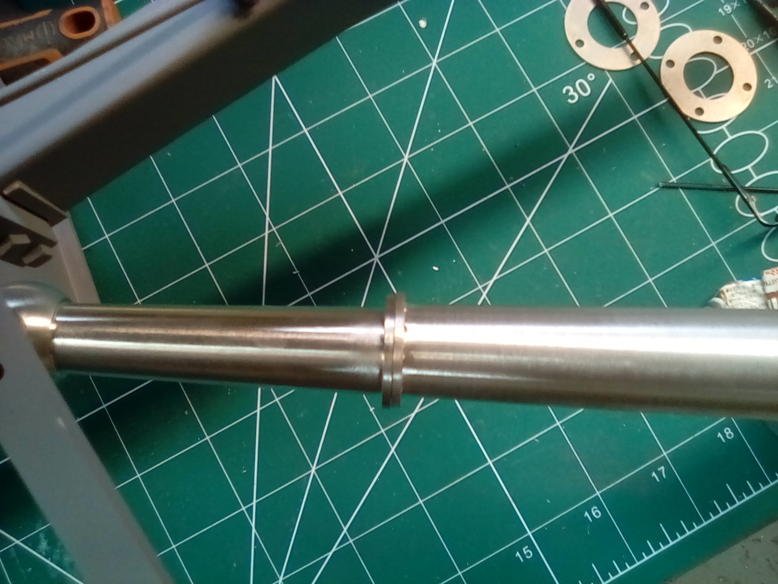

I have managed to get the rear axle just about perfect with everything lined up.

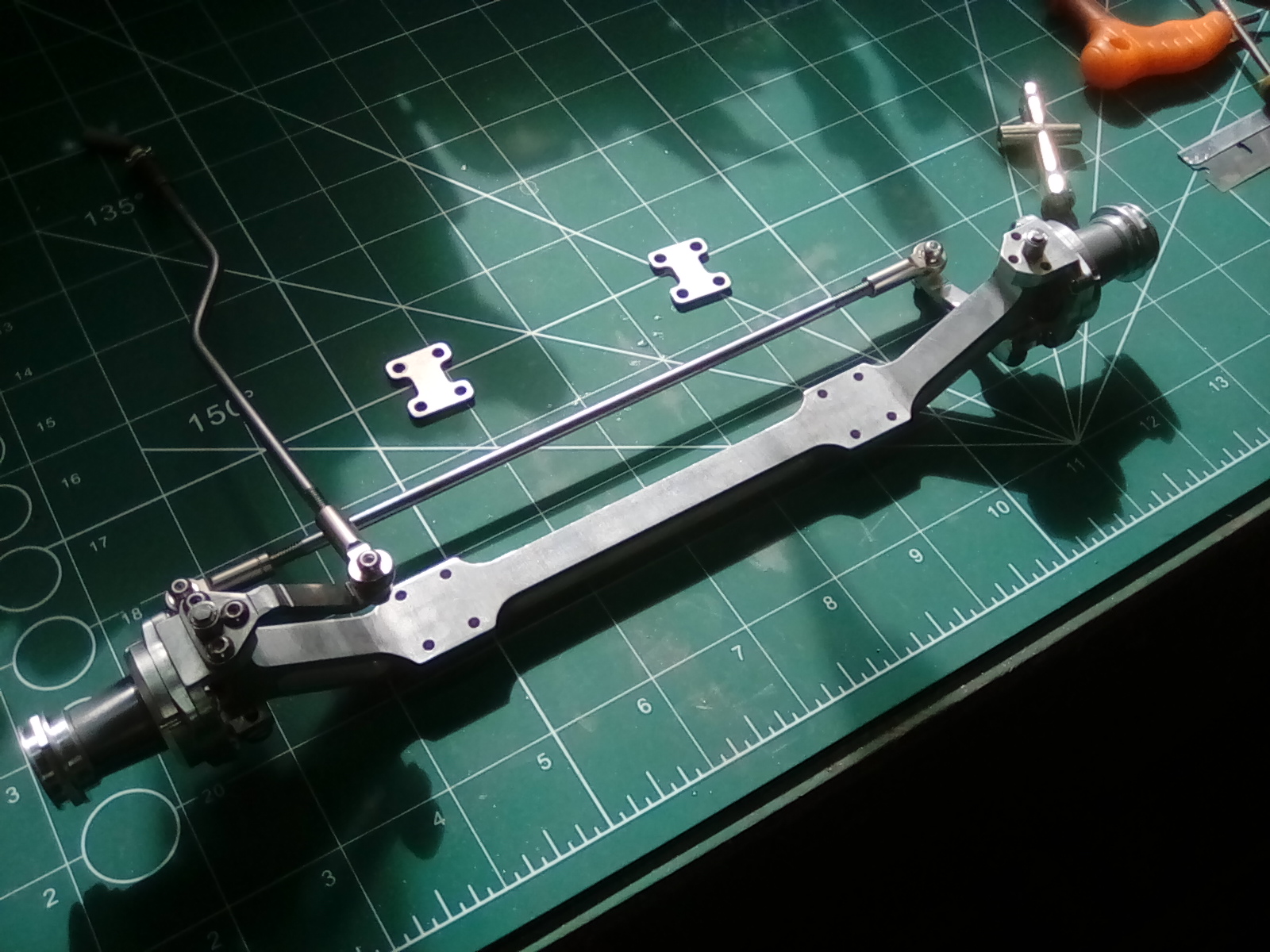

The front axle all set out ready for deburring and assembly.
Very nice front axle assembly.
