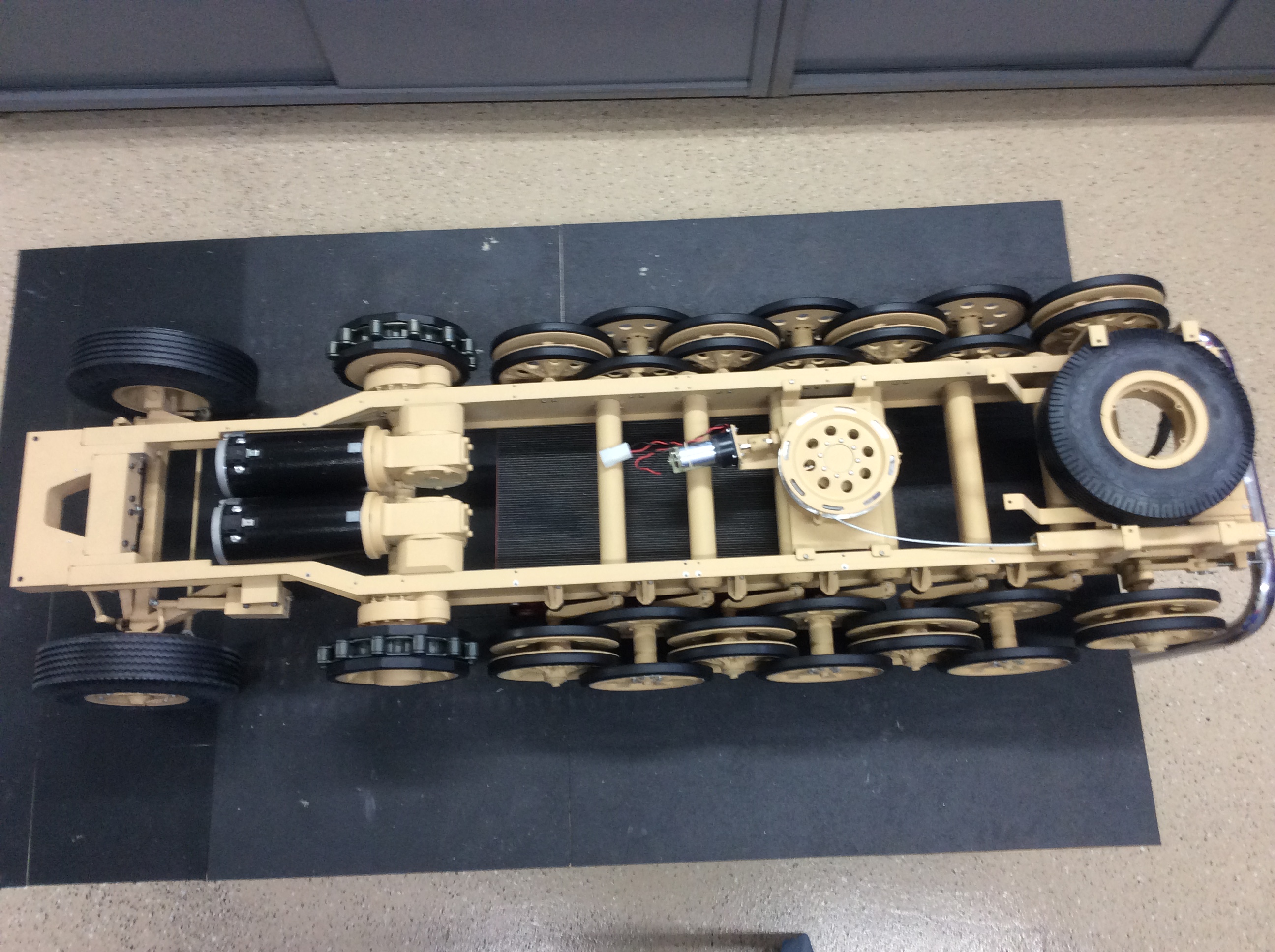

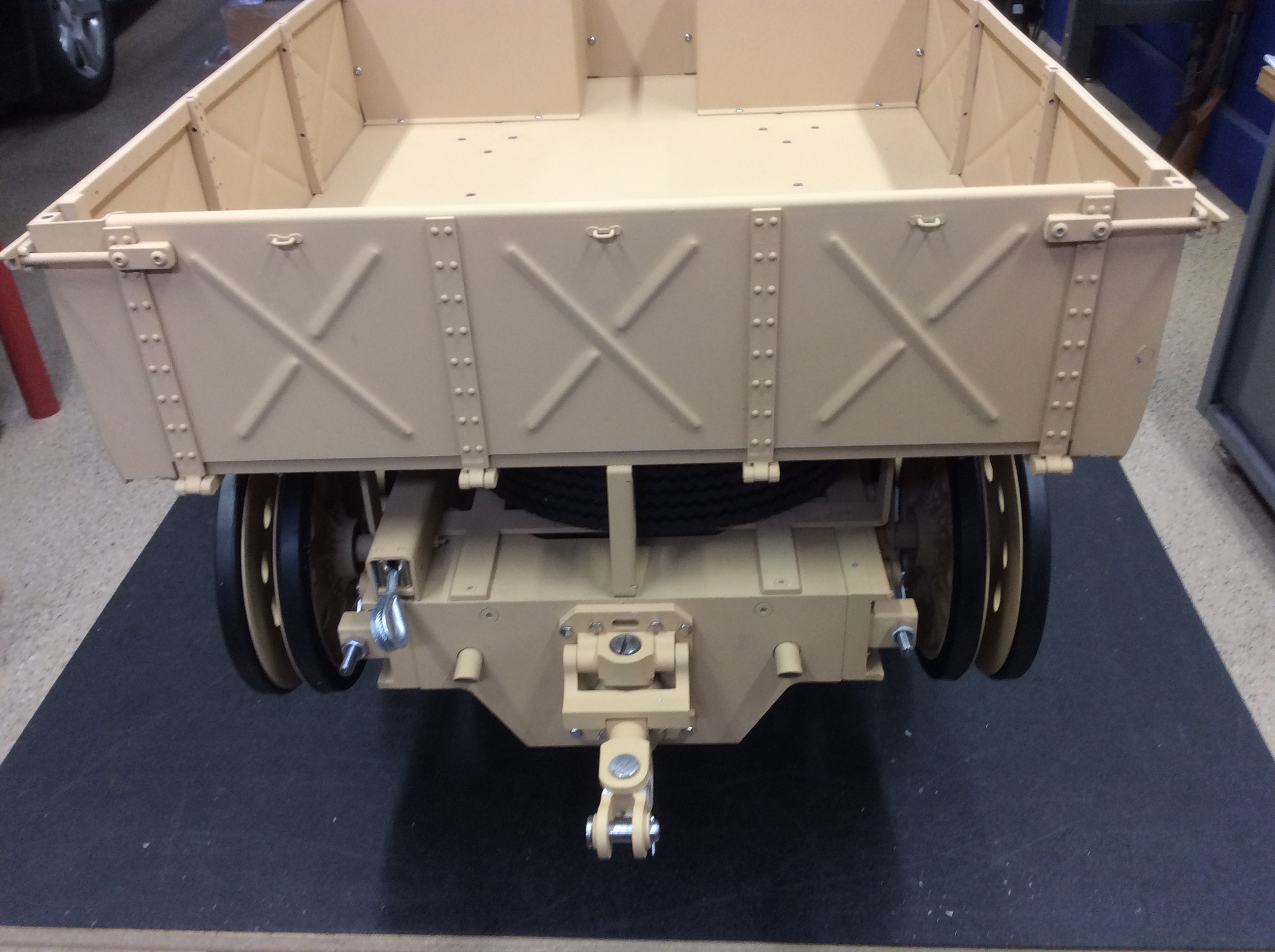

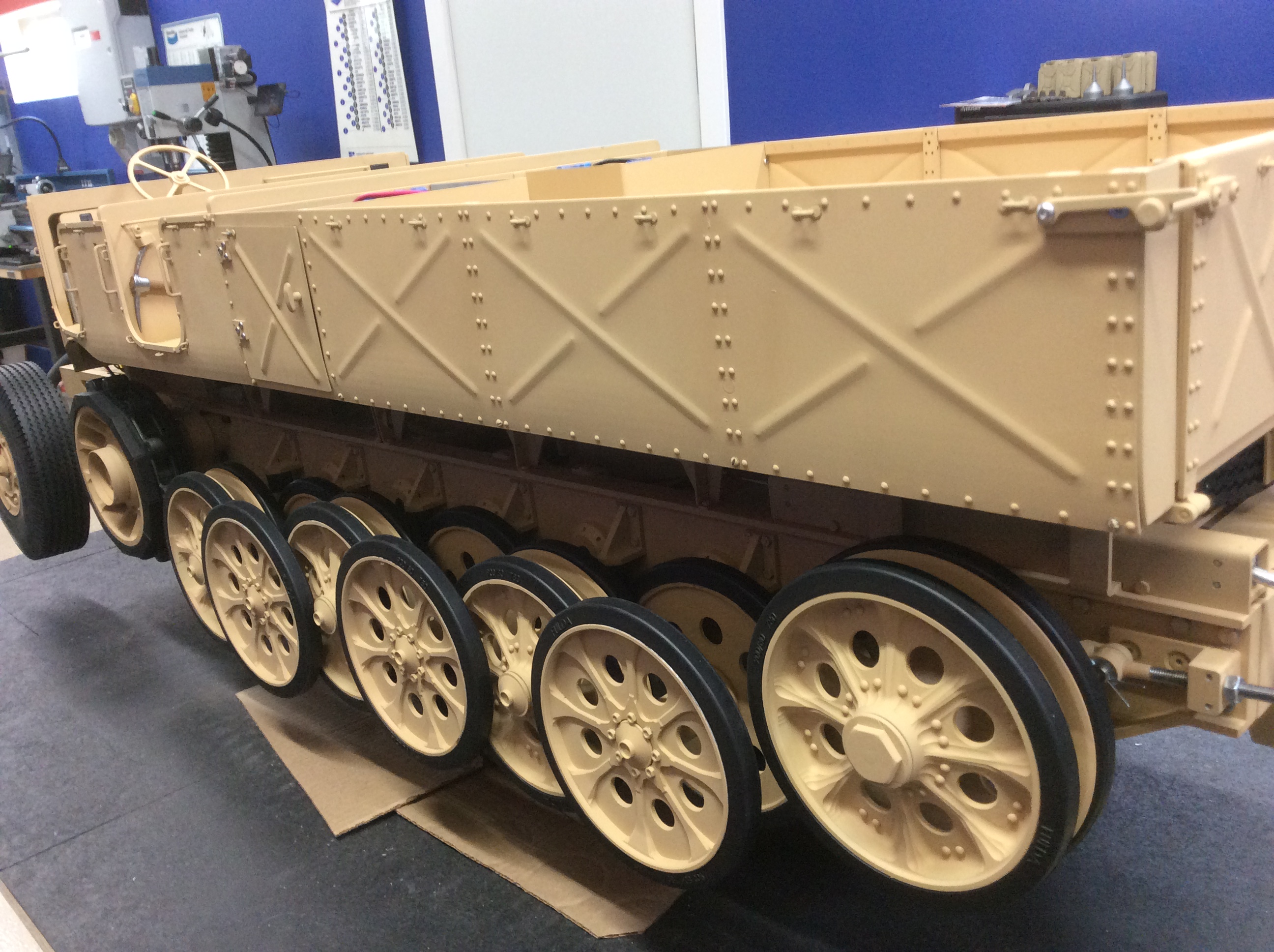

I acquired a paint spray booth so I can paint indoors year round. What a pleasure to use. Here are a few pictures of my progress so far. This is a massive model. Spray booth vented under the garage door

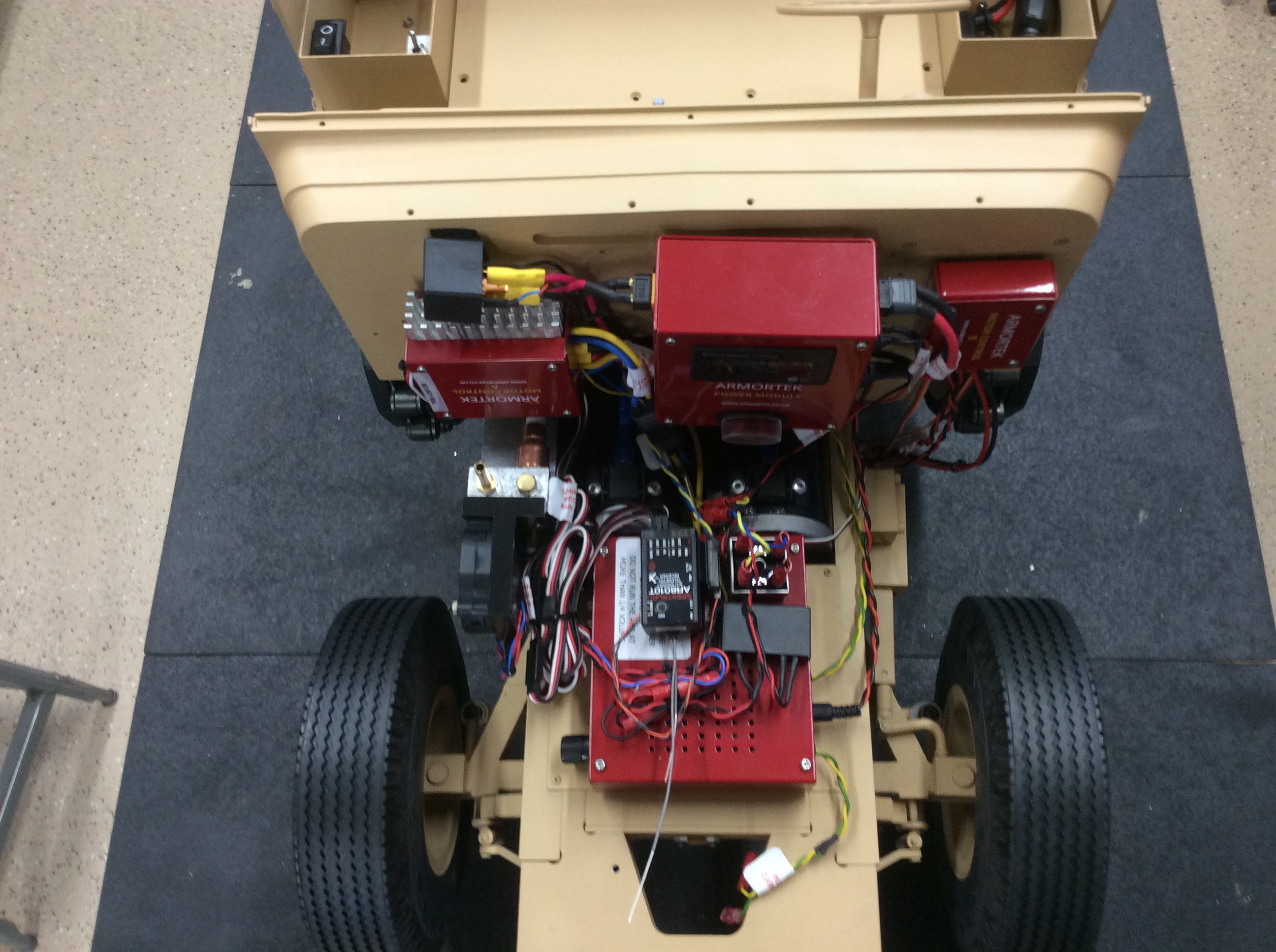

Here are the latest progress pictures.
I have installed all the electronics in the engine bay.
I installed the on/off switches for the master cut off and smoke unit in the tool box in the cab. The charging plug is in the other tool box.
I installed a second 3" speaker inside the spare tire. The supplied 4" speaker will go in the engine bay.

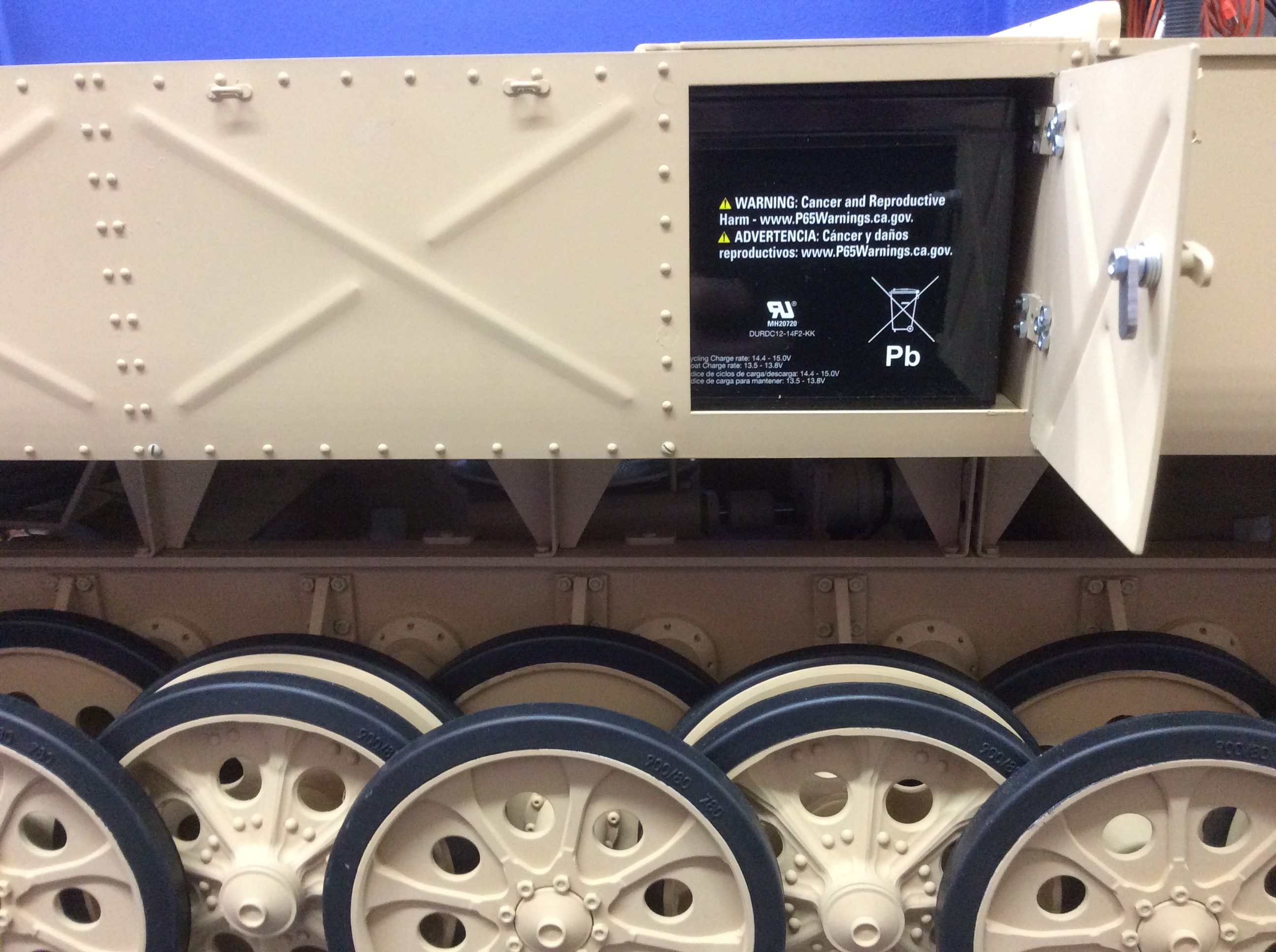

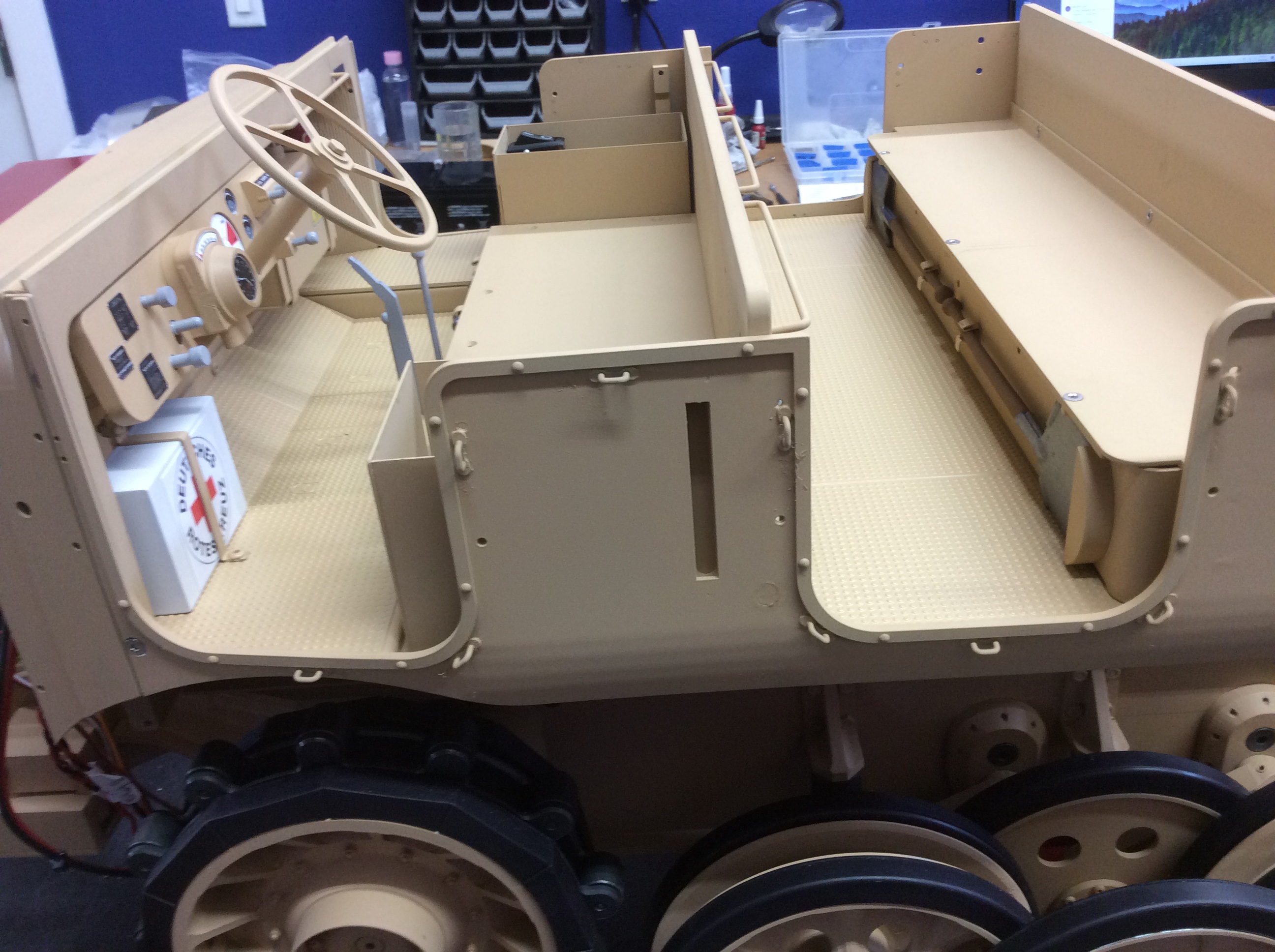

Re: Tom's FAMO Build
Hi Lerh,

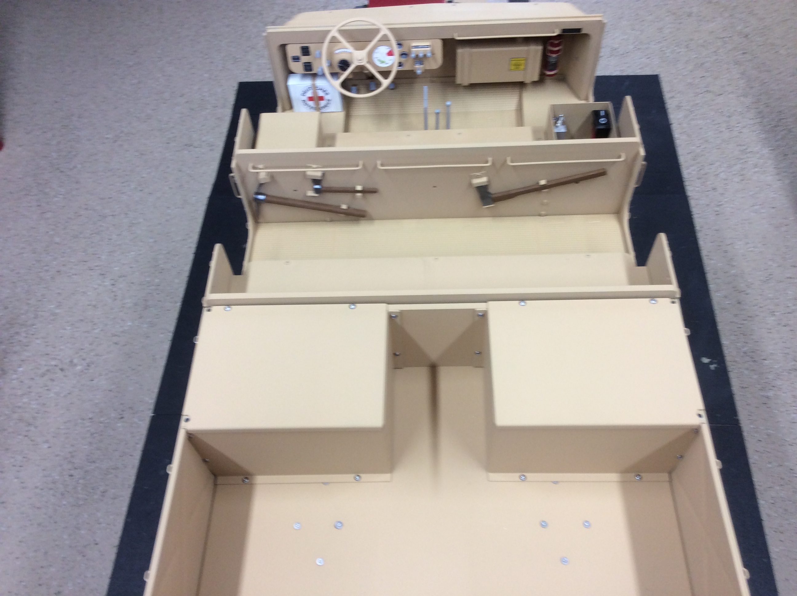

Here are some pictures of the latest work. Installing all this body work is a real struggle. Lots of holes to line up. Just getting to some of the nuts and bolts takes some thought. I ended up soldering all the nuts to the sheet metal brackets for both the front and rear compartments and the compartments under the seats. About 30 nuts! But, now installing everything is much easier because you do not need to reach under the model to install the nuts.
Hi Tom,
Again, two batteries are nicely sit into two tool boxes.
Before doing the similar installation, may I ask few questions on your photos :
(1) In photo 1, there are two Motor Control Modules (A and B). Are they working as the speed controller?
(2) What is the red Module with a black knob sit horizontally at the front? Is it the Audio Module?
(3) A receiver was found on the top of (2). What are the other square one and black one beside it?
(4) Is this just a shadow in photo 2?
Lerh Chang
Lerh Chang
Hi Lerh,
I assume you do not yet have the option paks as all this is explained in the manual.
Motion control A controls the traction motors for forward, reverse and turning.
Motion control B controls the winch.
The box with the volume knob is the audio module.
The units next to the receiver are part of the smoke unit on/off system.
Yes there is a strange shadow in the photo of the batteries.
Have fun with your build.
Tom
Tom

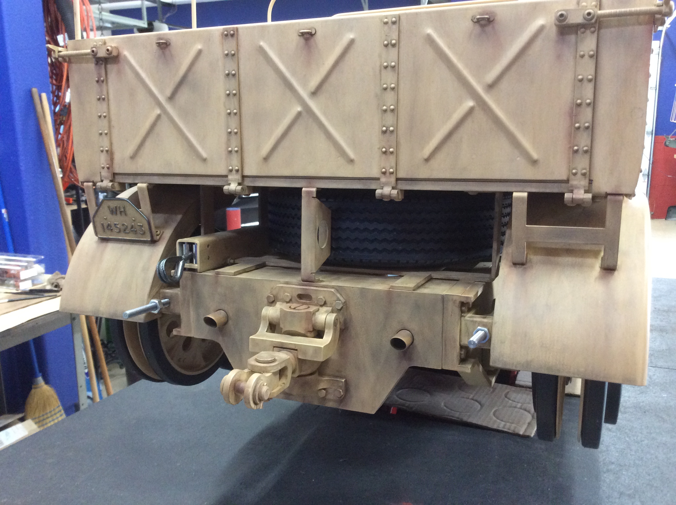

Started weathering the FAMO this week. Long and labor intensive process. Using MIG washes and filters then Bragdon Ent. weathering powders. What you see is four days work.
