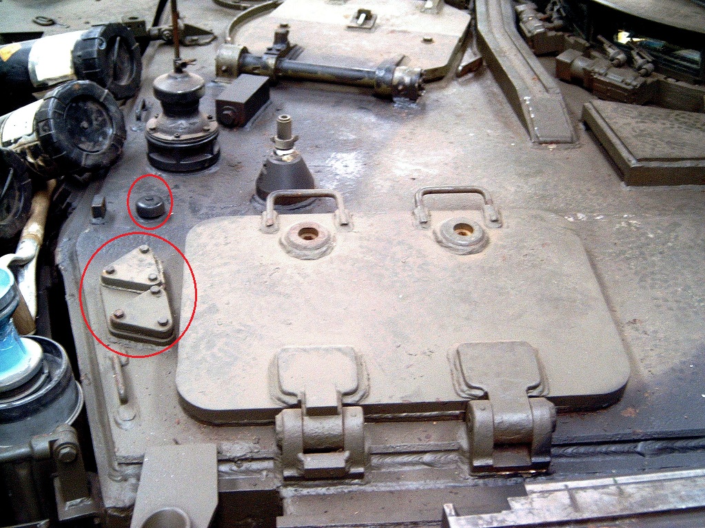

Before anyone starts getting sweaty over the NBC suits, what about these objects on the turret roof behind the loaders hatch?

If I remember correctly, the two turret batteries were underneath that hatch with the metadynes being underneath the hatch behind the commander´s cupola.
The small round thing would then just be the breather valve from the battery compartment so if the batteries started off-gassing, the fumes had some method to escape, looks like a breather valve to me.
Triangular plates were usually used to blank off a connector that was not being used so likely to be a 2 or 3 pin power connector below each of them, but I have no clue what they were intended to provide power for, or if they were just there for the case that they were ever needed in the future.
Chieftain had a lot of rev-modes ( Reversionary modes that the crews would adopt if systems failed, and keep fighting ).

Another possible reason for the blanking plates, but you would need a gunfitter to confirm or deny it, or a crewman to say exactly what was there.
They may have covered the filling and vent points for the coolant tank for the temperature compensated sight linkage. On Chieftain, the sights were mechanically linked to the gun, and coolant was pumped around the linkage to keep it at a constant temperature and prevent it contracting or extending, thereby destroying the gun / sight relationship.
One of my jobs was to ensure the electrical pump worked, it was one of the gunfitters jobs to ensure coolant would be there. I seem to recall it was a closed system so only ever needed to be topped up and /or bled if a repair had been carried out.
