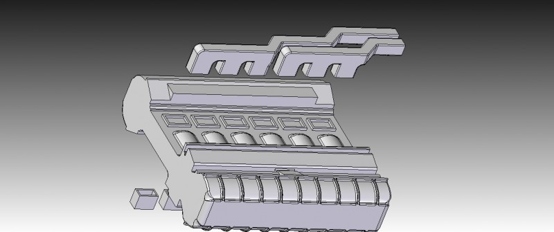

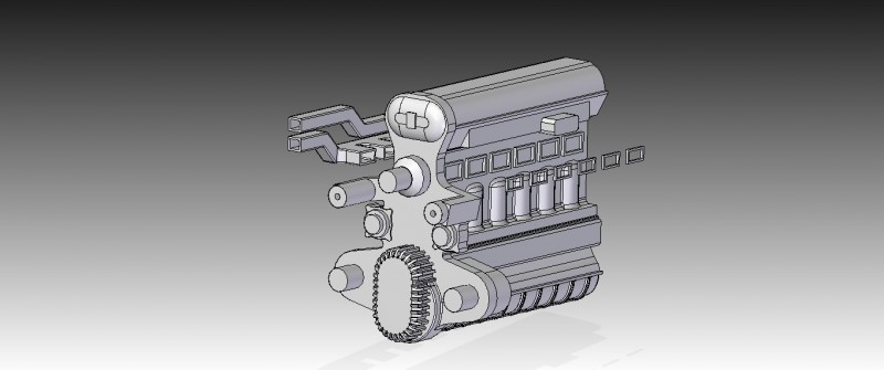

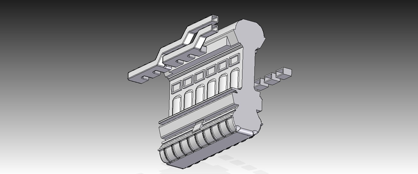

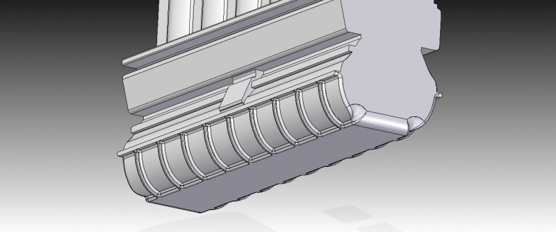

Only a few studies on the "motor body"
As often happens, the 1/35 scale model does not match the dimensions of the diagram provided by Leyland Corporation. You will now need the dimensions of the tank engine compartment reproduced by Armortek. Comments and suggestions are very welcome. Thanks! Ivano
Re: Engine L60 for Chieftain
Looking good Ivano! I will have the Chieftain later this week and as you know my first job is to get those measurements of the engine bay to you asap!
I am hoping that Armortek will send the motors as soon as they can as we really need those measurements as well. It's all very exciting!

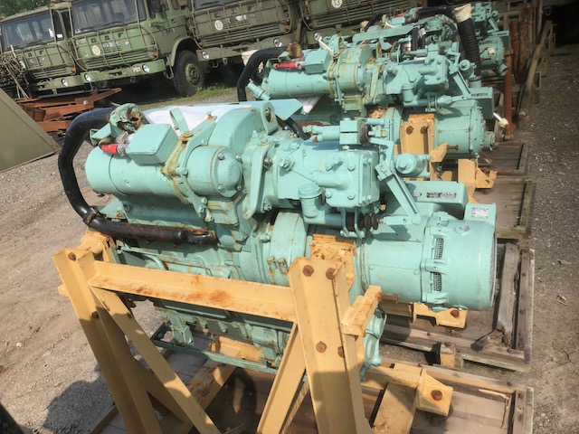

You see as the L60 is so skinny I reckon that most of the engine would slip between the armortek electric motors, as the chieftain hull is so big the motors are fairly well spaced apart, we will have to wait and see
Although the engine itself was rather "skinny", the various ancilliaries, starter motors, generator, air filter hopper, radiators bulked it out quite a bit. Engine replacements were always tricky using the jib on the FV434 where you had to co-ordinate the movements of the inner and outer parts of it to get the engine coming out or down vertically ( vertical was relative to the position and angle of the tank at the time ) , along with rotation of the jib if required. The crane on the Chieftain ARRV, the CrARRV, and the Warrior 512 & 513 combined with a lifting beam made the job a lot easier and a lot less stressful. If the hull of the vehicle was not exactly level and you needed to angle the pack to get it aligned, spare crewmen would be put on top of the pack and moved around to change it´s center of gravity as required.

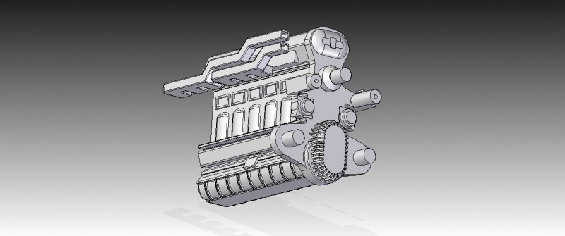

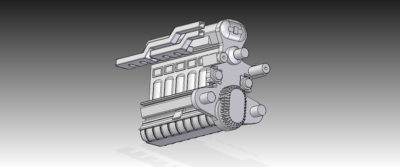

Attention, it is only the lean "motor body".
At the base, with all the various components, is very broad,
about 170 mm in scale, it is wider than the Maybach.
I agree Ivano but to get it to fit we could omit the ancillaries as they just can't be seen! I do have a plan you know
