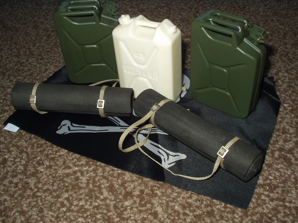

Continuing with the Kit Bash for the Chieftain, two essential bed rolls a plastic water container (yet to be painted from Armorpax) to go with the two metal Jerry Cans.(Nato Green hummmm)
The bed rolls were made from a single sheet of A4 EVA Plain Foam Fabric Craft & Hobby Sheet 2mm thick. (ebay) £1.50 Cut the A4 in half, roll and a couple of recycled, sorry up cycled 1/6 scale army straps. Soft and spongy, nothings too good for the little guys

Hi John,
Great idea for the sleeping mats, half an A4 sheet 2mm thick scales up fantastically.
They were not black though but a dull light green, unless RTR actually got black ones rather than the standard issue. The lime green foam suitably dirtied up would probably look more realistic.

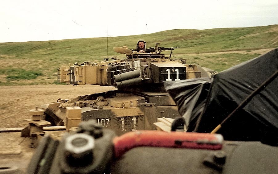

You would also need a total of four, one for each crewman, judging from the photo you posted the crew would have had two on either side of the turret.
And they would normally not have straps around them, but bungee cords wrapped around and then hooked on to suitable points.

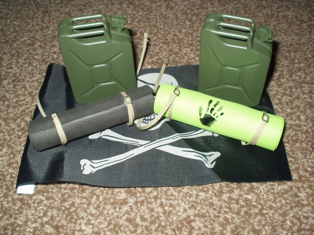

Lime Green
Naaaaaah don't think so. Though I did buy a sheet but it looks just wrong even dirtied up
I'd be worried an roaming A10 would want to take pot shots at such a blatant target strapped to the turret.
The black foam comes over with high lights of light grey, could always spray with a wash. There is a dark green available, at £1.50 might give it ago.
I've seen bungee straps on 1/10 models but I was worried that they may crush the foam too much.
Four mats? Does every one sleep at once on duty? ..............
................. usually you only see a pair on the turret.

Just spotted a metal jerry can in the photo. Very unusual unless the tank was "very thirsty" for a particular type of oil. Extra fuel in cans was not carried, nor were extra lubricants unless needed to ensure the tank could make the next replen.
Standard replens provided you with rations to survive four days plus topped you up on water,fuel and ammo. Battle replens provided ammo and fuel only .
A 20 liter water cannister is not sufficient for four people for four days, unless that tank needed the extra oil to keep operational, a second water can would have been stowed if the space allowed.

Lime green suitably dirtied up is better than black, and also definitely four. Unless REME were working on their vehicle or they had to do radio or ground stags, then all four crewmen would be sleeping if possible.

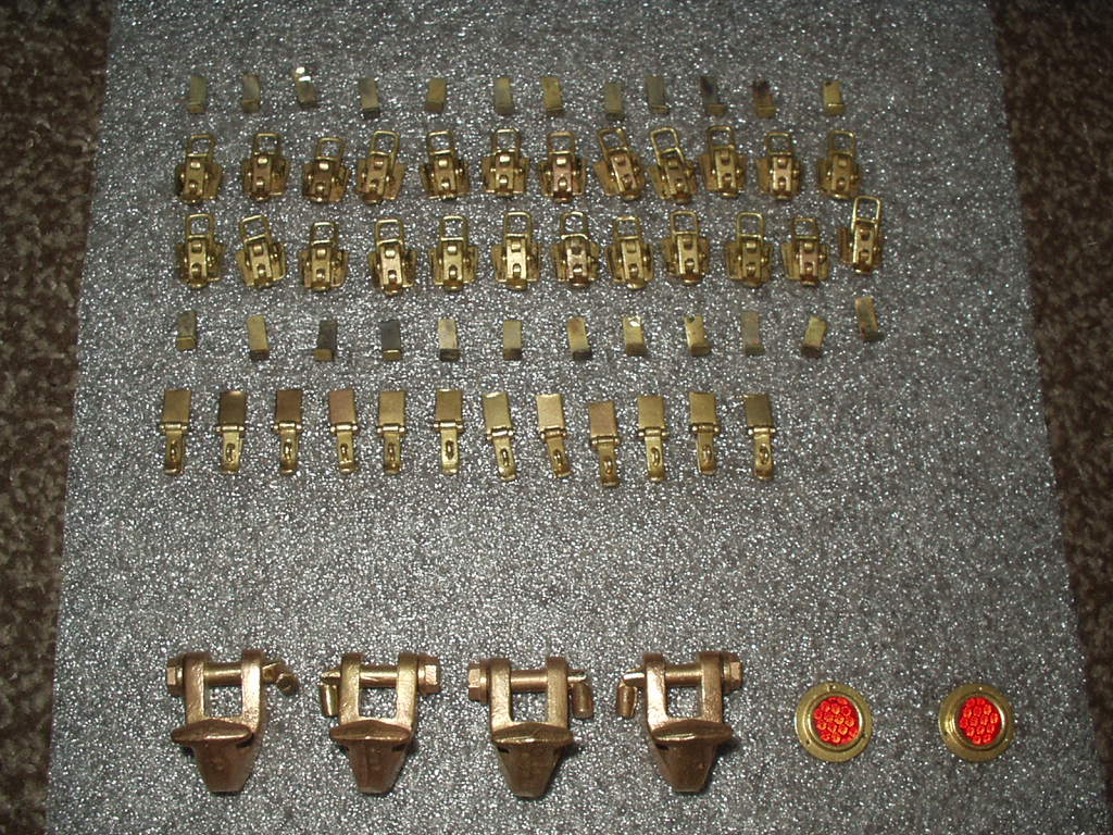

Got my Steve Winstone order the other week.
Absolutely wonderful

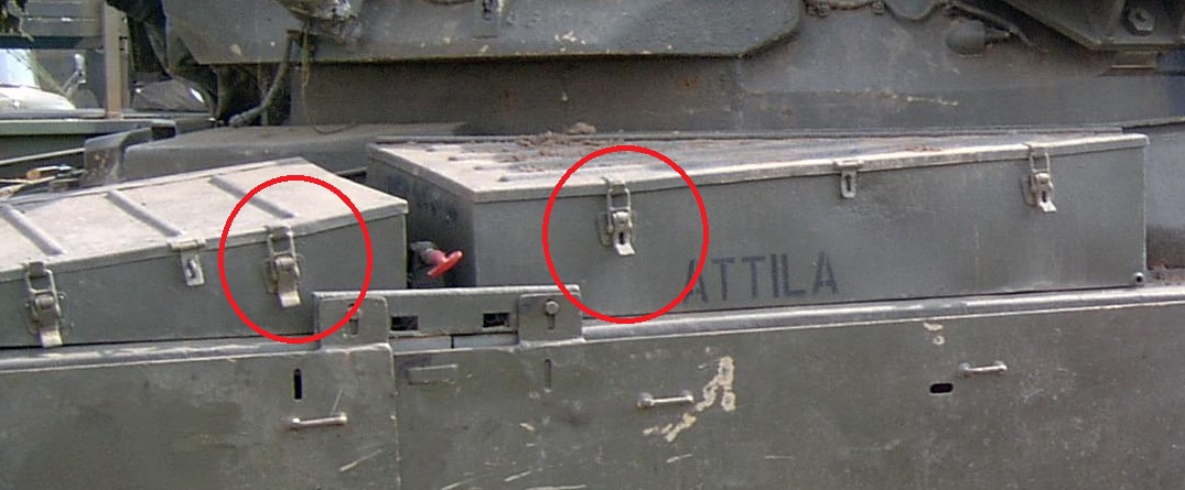

I'm hoping there'll be more detailed parts in the future. I've noticed there are two types of bin catches, slotted and non slotted fitted to Chieftain.
Amorteks very nice catches look like the non slotted type, so there's an option to mix them up on the model too.

Non-slotted bin catches are probably correct for earlier models. They were there to secure the lid and a seperate catch which would take a padlock was present.
Slotted catches to take a padlock were introduced later . A mixture on the vehicle would be fine but not on a bin, ie each bin either non-slotted with a padlock hasp, or slotted. Slotted with a seperate hasp would be wrong.

I know where you're coming from Mark but the bin on the Right has slotted with a seperate hasp?

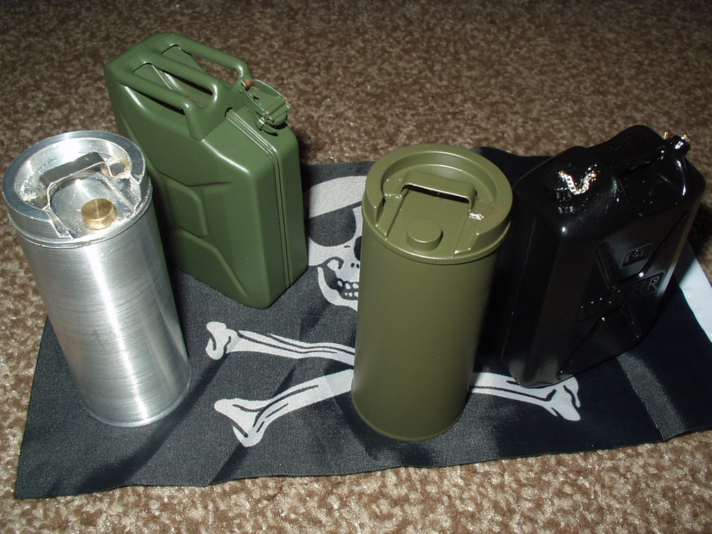

Chiseled a couple of oil cans from a couple of lumps of scraped rollers, borrowed a lathe for a few (lots of
) hours and finished up with two artistic licenced efforts.
Adding them to the other containers, they'll complete the liquid storage on the turret. Just need to find some transfers for the oily stuff.
The chain for the water container screw caps was swagged from the better half's jewelry box.
Did pretty well with the resin lump too, fixing most of the air bubbles. (Black paint is most unforgiving on resin lumps)

Looks good John.
Amazing what you can do with a double ‘A’ battery and a ring pull.

OEP-220 was the synthetic gearbox oil so in my experience to be realistic, maximum one 25 liter can for a tank that had a fault and was limping back for a gearbox change , or was carrying it for the troop of three tanks, better would be one or two 5 liter cannisters.
OMD-80 was the engine oil, carry as much as you could.
Stephen White may wish to comment as to what his tanks normally carried, or had to carry because it was mandated.
I can only speak from experience. Crewing a Chiefy ARRV supporting a squadron of Challenger´1´s, one 25 liter drum of OEP-220 was enough to cover a few multi-week exercises for normal top-ups and an emergency fill-up. Not just for our ARRV but what we carried to support the squadron.
