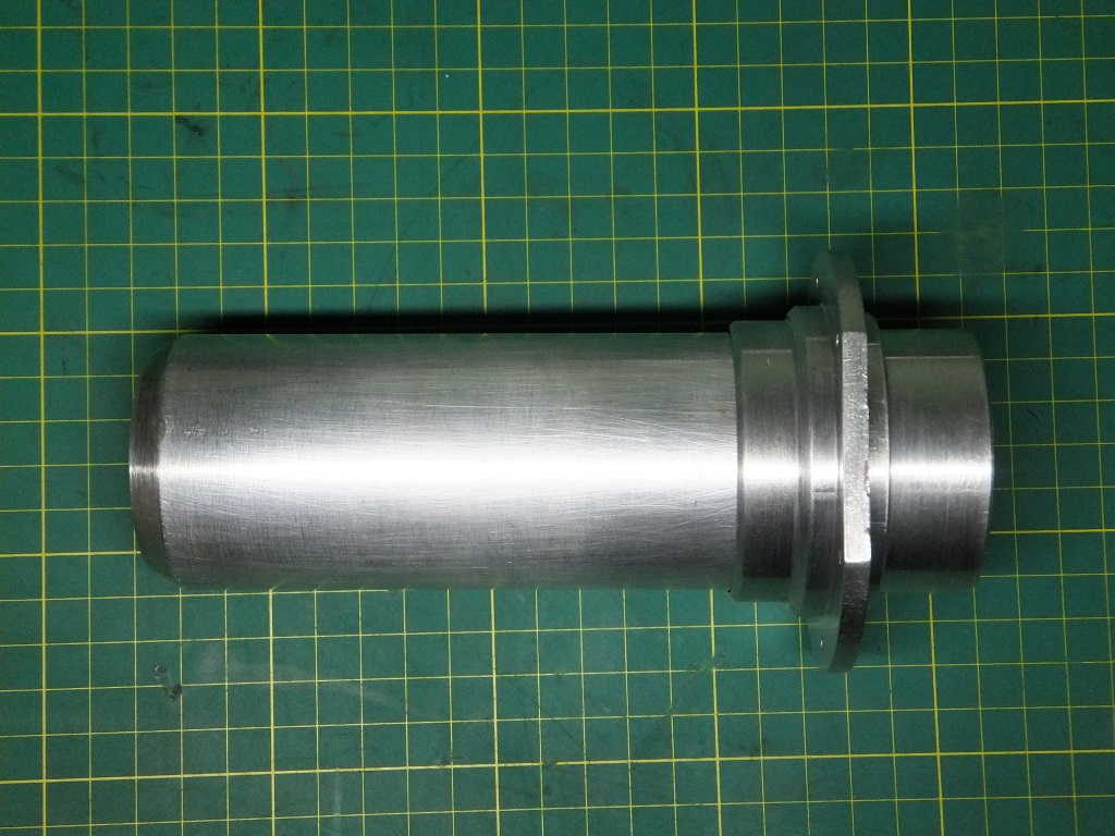

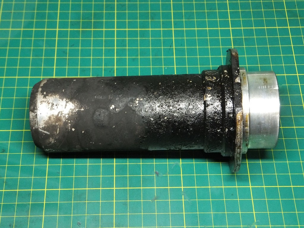

More gunk removal, this time from the recoil tube and mantlet ring.
Both the recoil sleeves were completely burnt and liquefied, which I think is why these parts are so caked with plastic residue.
I found that heat to soften the plastic, then wire wool dipped in cellulose thinners shifted it remarkably quickly.
I had it mounted in the lathe chuck for easy of handling, and so that I could have it rotating slowly to enable even application of heat.
Very glad I have some 3M full face masks to hand

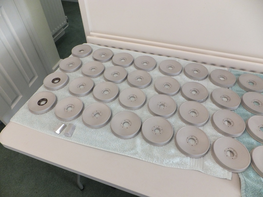

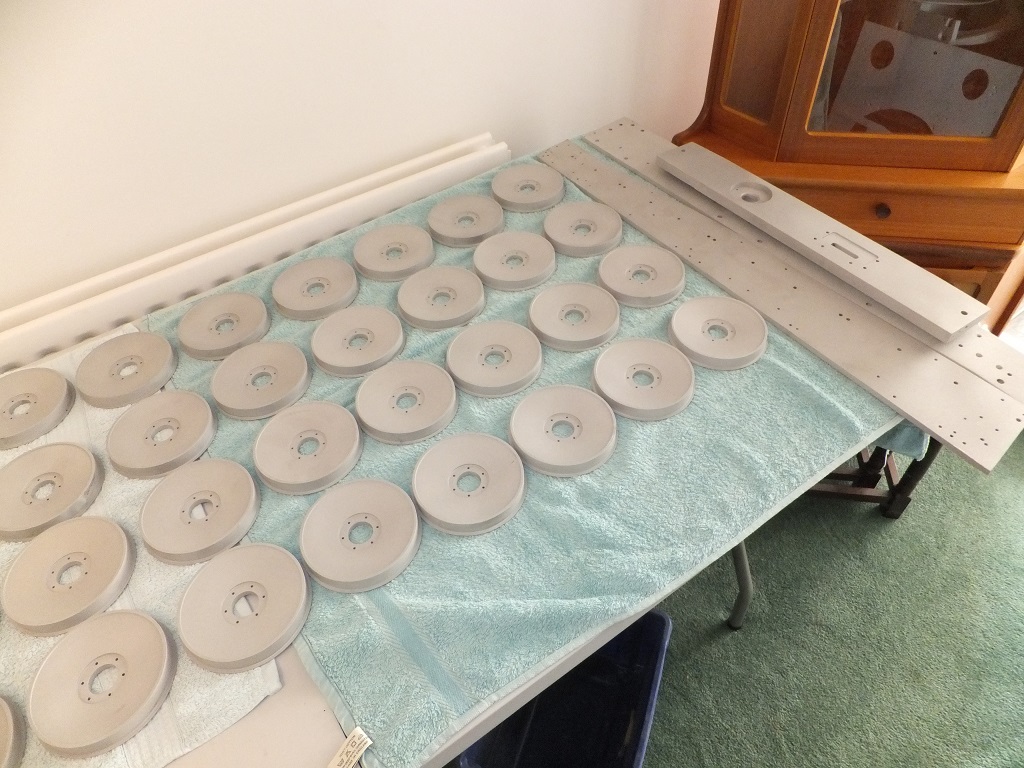

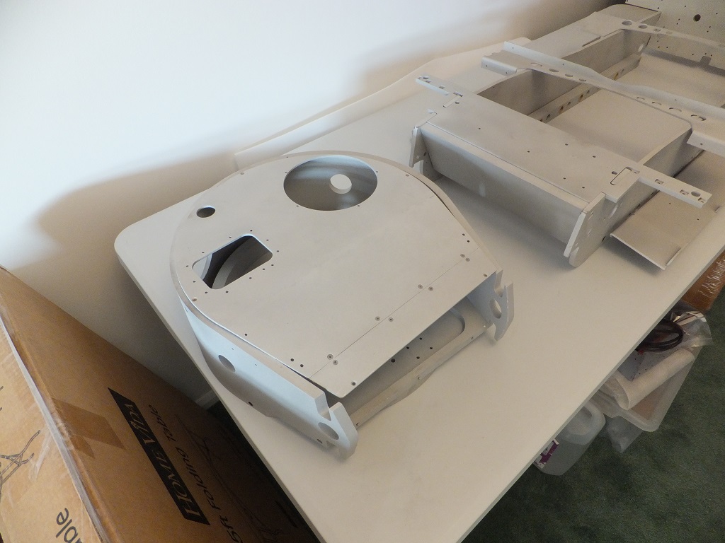

Major parts are back from the blasters.
The two wheels with the black centres are where I forgot to remove the hubs before delivering them
They will be my first test once my home blasting system arrives.

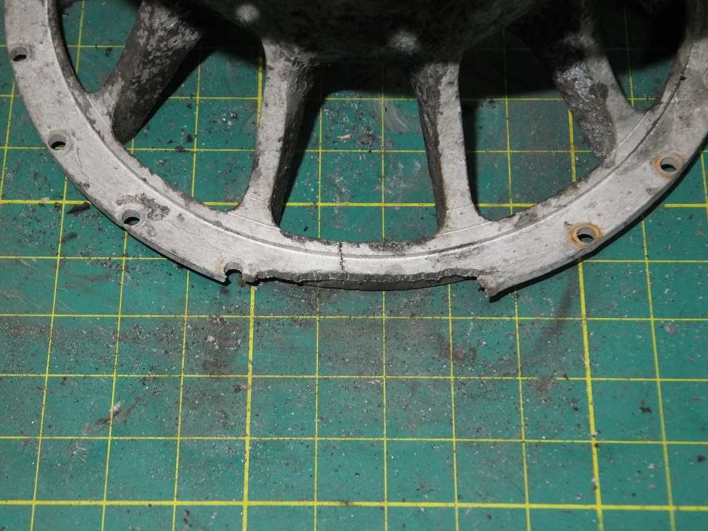

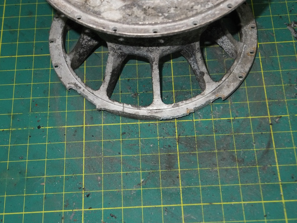

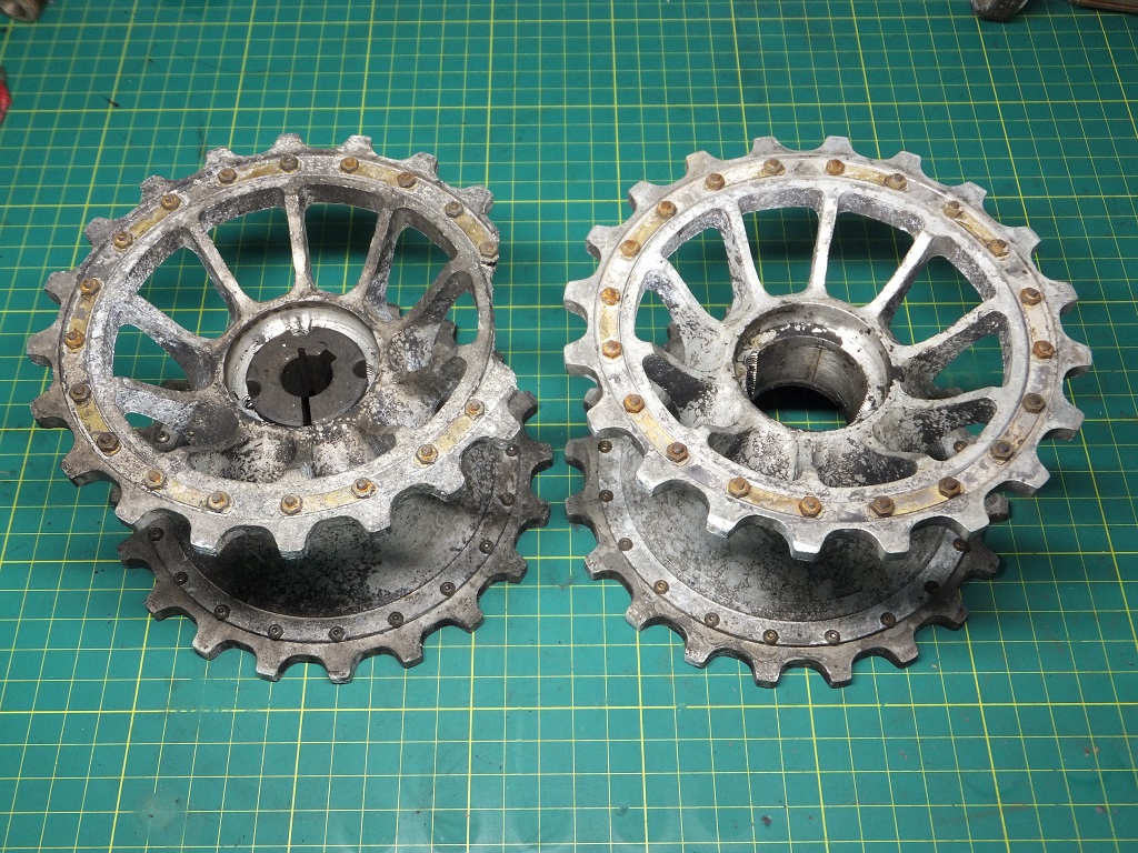

One of the two sprockets was a cause for concern, due to a break in the sprocket ring and the lip of the sprocket centre.
Having stripped them down, I was initially hopeful that the damage to the sprocket centre centre wasn't too bad, and might be repairable with Aluminium brazing sticks.
Even though there is a crack right through the rim, I was hopeful that this would be fixable.
However, in testing the rest of the rim, the metal had crystallised on both sides of the gap, and was just crumbling.
So, new sprocket ring AND sprocket centre required

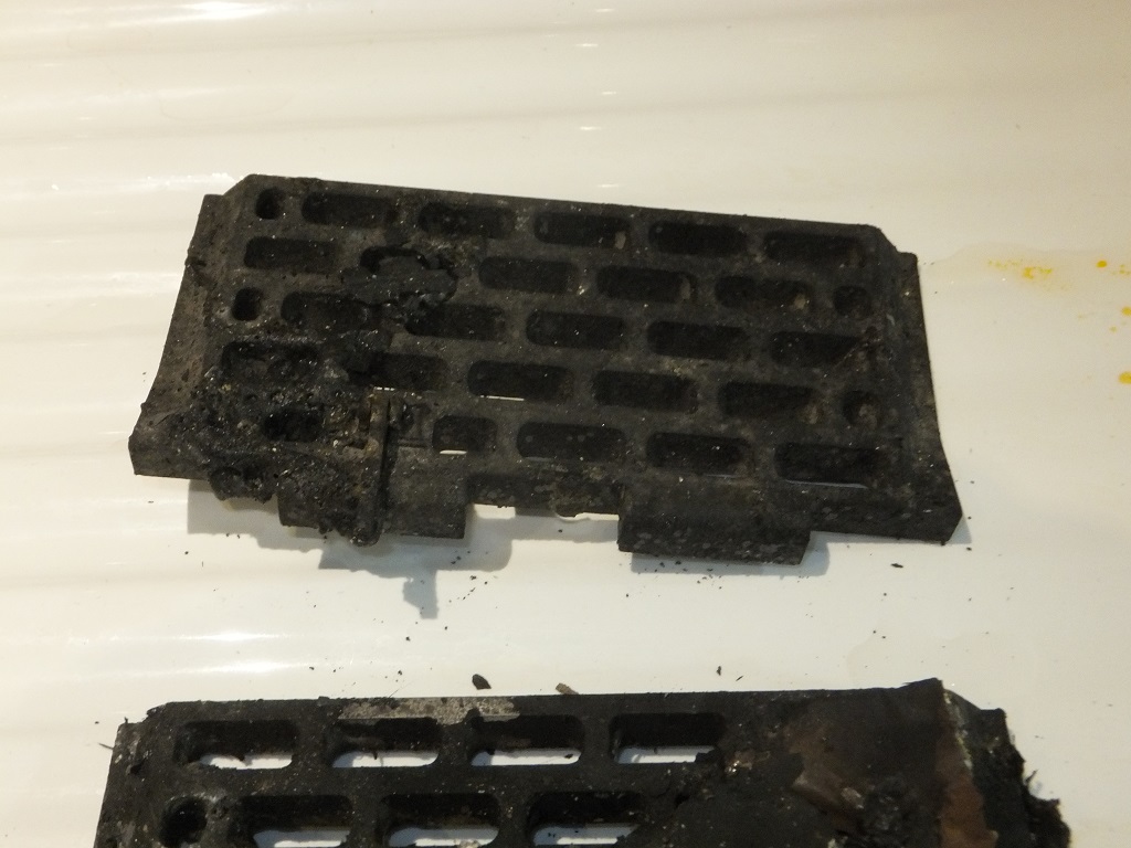

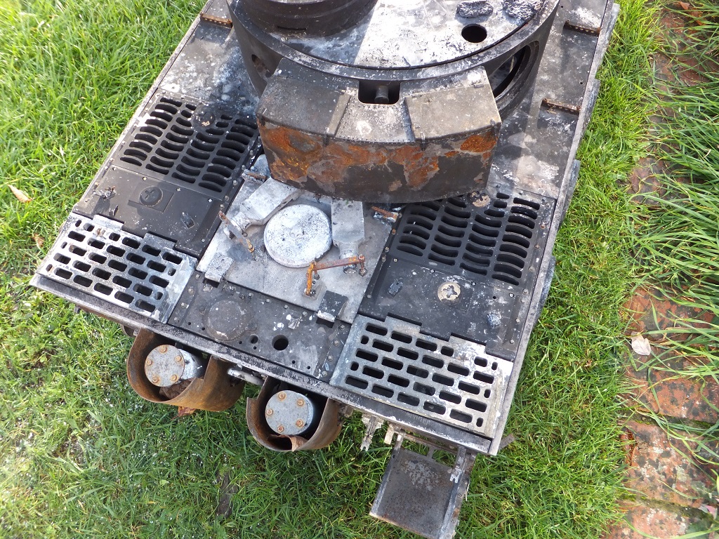

Engine Deck

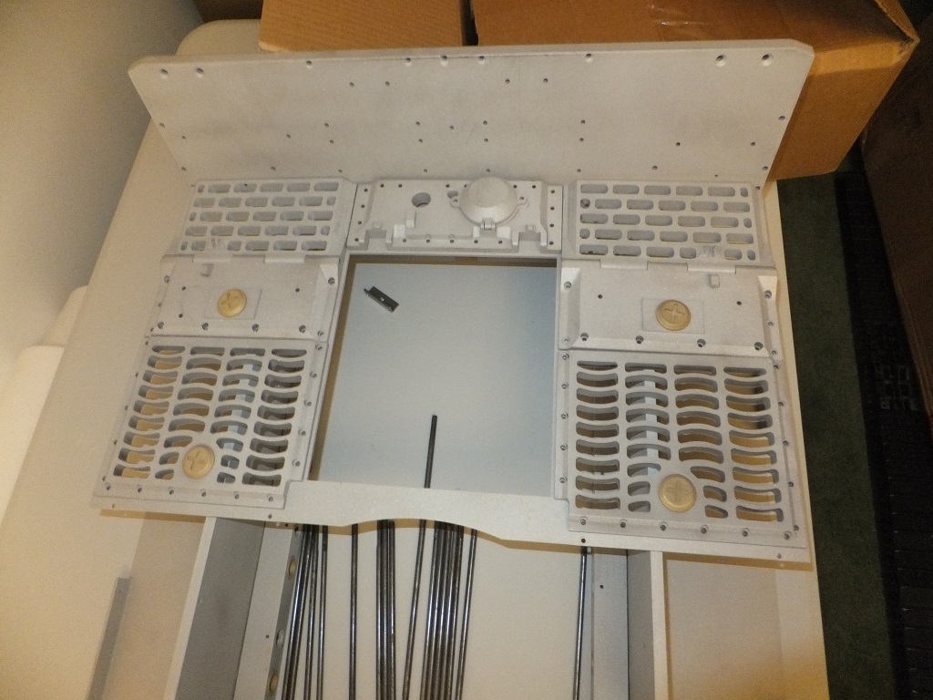

The engine deck was pretty badly covered in melted plastic and soot.
I cleaned up the rear most vents with cellulose thinners and a variety of wire brushes and thought they looked OK.
But having put all the parts through my new glass blasting cabinet, they've all come up a treat.
I left the brass plugs in place as I didn't want to contaminate the threads with media, and I'm hoping their shape will have kept most of the soot etc out of them. If they do need a clean up, I have some small steel wire wheels for the Dremel which should pass through them nicely.

Re: The Phoenix - Tiger 131 #12
It looks just like a regular build from this angle, apart from the strange pearl primer you are using... Amazing! ![Shocked :shock:](./images/smilies/icon_eek.gif)

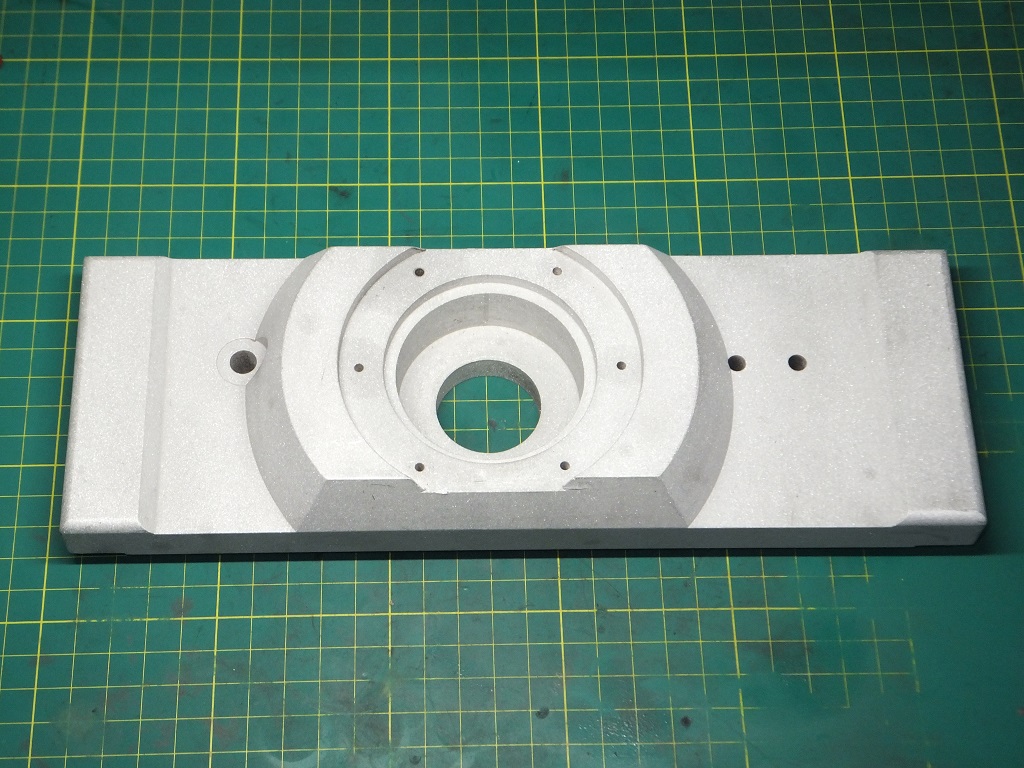

Still working my way through the parts. This is the mantlet before and after cleaning:

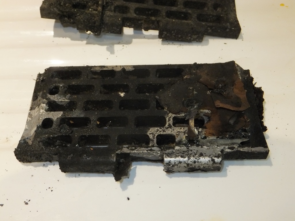

Engine Deck

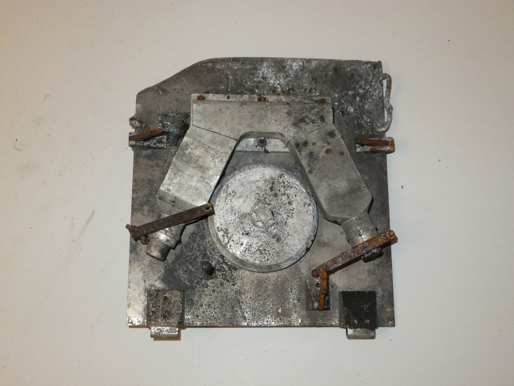

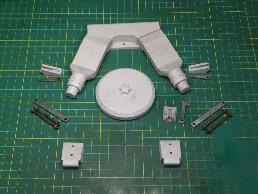

The central panel has suffered much worse damage than the other panels from the engine deck as it wasn't on the tank at the time of the fire.
One corner has been heated beyond the melting point of the aluminium and has buckled badly.
This part is a write-off, so hopefully I'll be able to get a replacement from factory stock.
These are the parts I've managed to salvage from the plate:
The aluminium parts have been media blasted to clean off all the soot etc.
The steel hooks and clamping bars have spent the day in Hammerite Rust Remover Dip, followed by a quick run over with a stainless steel brush to clean them back to bare metal. The threaded bar still needs the final clean up.
