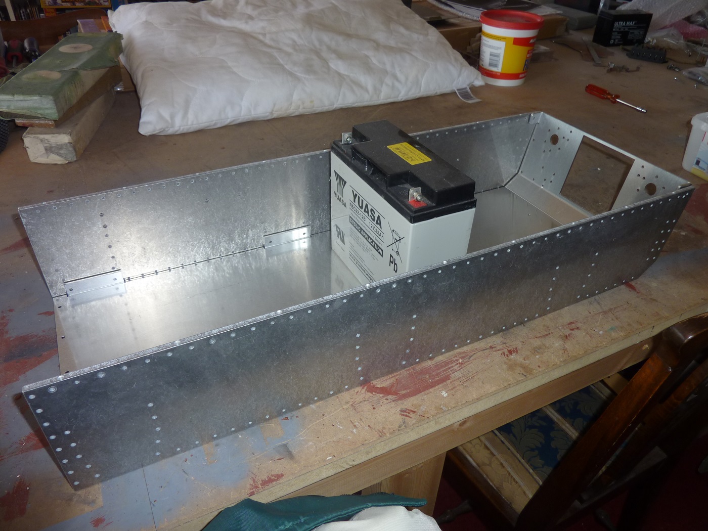

There may also be the need to build around the electronics - it's going to be pretty tight in there, and Kian says (as I mentioned earlier) that the motors are best put in before the diff casing (Stage 3) goes on.
The floorpan and sides, with a 12v battery for scale
This means that you don't have to start at Stage 1 - in fact, I'm not going to. I'll probably leave the running gear until the end of the build as (a) it looks complicated, (b) I don't want to start compressing springs until I have to, and (c) given that there are tyres on the rollers I suspect it would be better to paint some bits first, and I'm using an unusual colour (yet to be ordered).

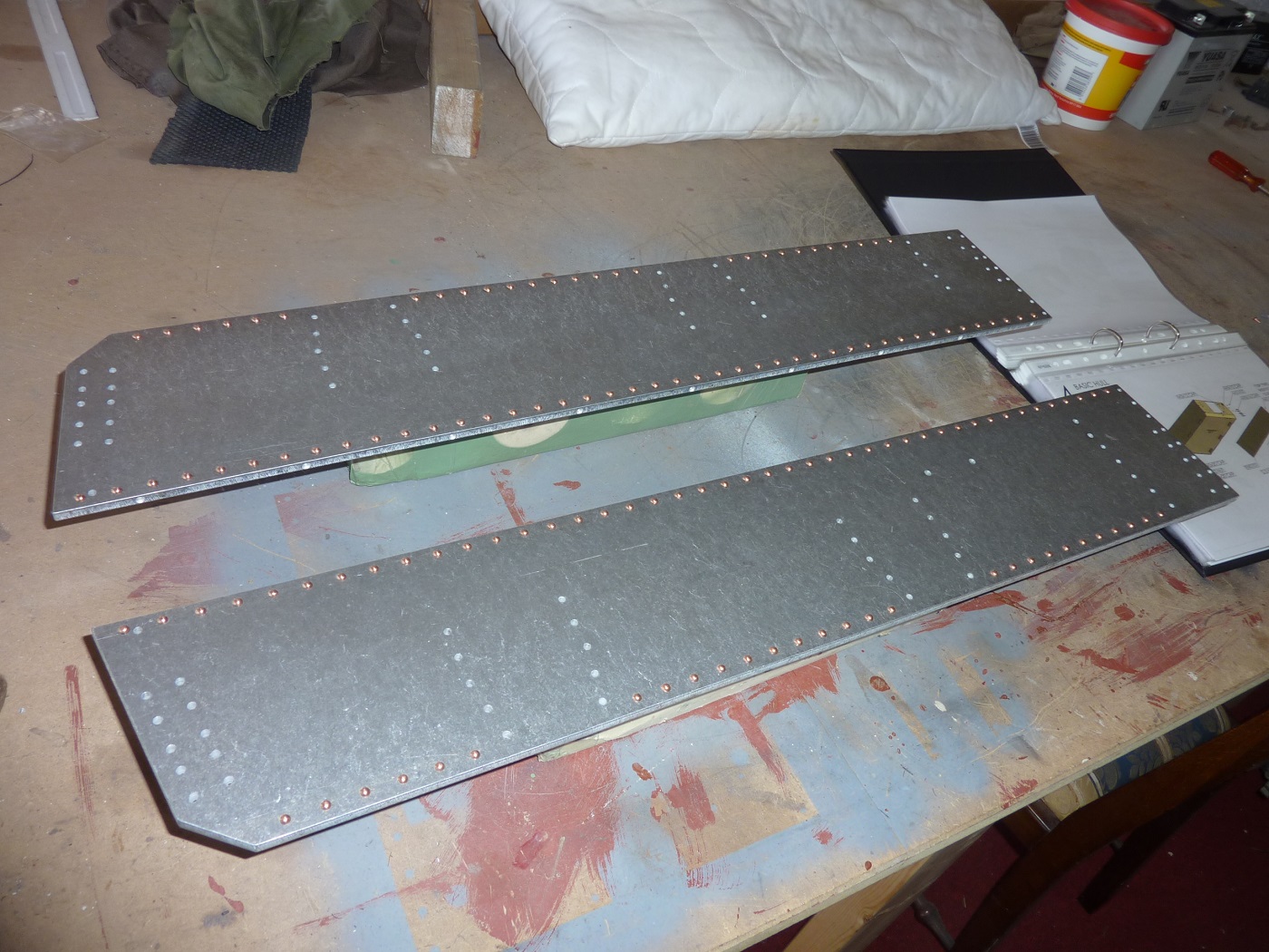

So, to start the ball rolling, I decided to start at Stage 4, with those long lines of rivets. I understand rivets, having build one (and a half) Mark IV's. But these are little ones, and very short, so they're glued and not hammered ! That saves an awful lot of time, but I can't help feeling slightly ..... disappointed (perhaps I'm a masochist :oops:). Once the glue has dried, I might use a punch to slightly mushroom the inner shank - I've seen rivets where the glue has vibrated loose - looks like a tank with acne :shock:. But none of the rivets on the M3 are load-bearing, or downward-facing, so it's not a problem.
It's also therapeutic ! This could be a very quiet build - I did it all in an hour, sitting down, with good tunes playing in the background. Makes a nice change.
Stage 4 - always nice to see copper rivets

Its good that 'we' are starting at different points, it diversifies the idiosyncrasies that we find in our builds, like what I have found with the wheels.
'Gluing' he rivets before rounding off the insides sounds like a great idea as it solves the problem of holding the rivets against the Snap while rounding off the other end. It can now be a one man job.

'Gluing' the rivets before rounding off the insides sounds like a great idea as it solves the problem of holding the rivets against the Snap while rounding off the other end.
Pete -
Gluing the rivets is the only real solution, as nothing sticks out to round off ! My idea was to tap the end of the copper shank with a punch to slightly splay them inside the sides EN0101. It should make them rock-solid, although it's probably overkill.

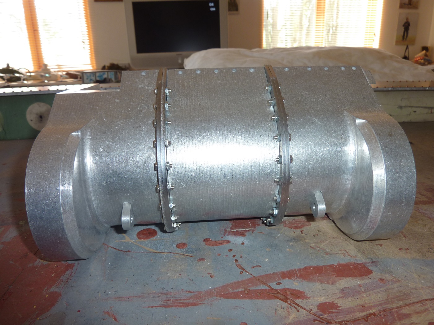

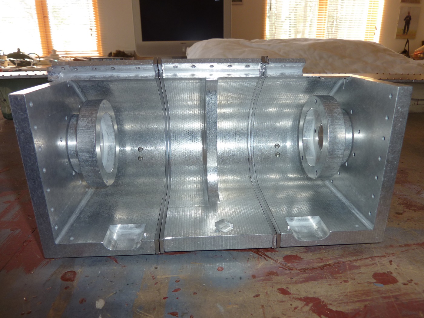

Stage 3 - the Diff case. Another therapeutic job with musical accompaniment, but with a couple of twists ...........
When fitting the Motor Mounts (EN0106, although that's not what it says on the parts list !), make sure to fit them the right way round, or they'll be wrong for the motors. From the look of the drawing the single hole should be at the top. It'll be fairly easy to correct, though, as long as you haven't covered up the M5x10 caps in EN0121. Incidentally, there's a nice deep recess for the caps, so no danger of them standing proud and carving into the front sprocket.
Pete Nash is right in suggesting that the shackle mounts / towing eyes (ED0622, Stage 24) can be done now. I can't see anything that will interfere with them, and it might be trickier later when the hull is assembled and the motors are in. I couldn't find any mention of what fasteners to use, but I had a delve through the spares box (any Armortek builder accumulates loads of spares !) and found that M3*12 button heads work fine. If they do foul anything later I'll have another think.
And one historical tweak, which doesn't affect the engineering at all, but will make your model more historically accurate (there's nothing worse than a busybody coming up to you and saying "you've got that wrong", believe me :roll:). The drawings suggest that the M3*10 hex bolts go on the inside of the flange, and the M3 nuts go on the outside. Examination of the Bovington and Duxford Grants, and all my pictures, show that it's the other way round - the nut should be on the inside. I also think that a 10mm bolt is a little too long, but I tried an 8mm bolt and it's too short. I don't think anyone makes a 9mm bolt, and I couldn't be bothered to file them all down, so I'm sticking with it. Colour me purist :wink:.
And the final results:

Guess who has to change the nuts and bolts :(
As for the last one at the bottom. I did a milling job with a Dremel to get the M3X10 bolt and nuts to fit. I did think of leaving them out but thought that was the easy way out.
I wonder if Chris Fry is going to answer your question.
The fasteners for the towing shackles are given in step 24 as M3x10 CSK.

What 'glue' are you using for the rivets on the hull sides?

Pete -
Better now than later :wink:. Not being up to milling, I've ordered a couple of M2 bolts and nuts from a well-known auction website (alternatives are available).

I use Loctite 638 - the big red bottle. Seems to be the one in the manual, but that's just a coincidence.

What glue works best for the rivets? Your not kidding about the manual. At first glance, the color manual looks very detailed until use start endlessly looking for what the correct hardware should be used on the Front Plates like ENO301 to EN0371, etc. Anyway thanks for the tips. Building an M3 Lee with motion packs in Kenosha Wisconsin.

I use Loctite 638, the old green faithful. But, as I mentioned earlier, I'm minded to lightly tap the shanks with a punch to mushroom them out for tightness. Given all the shaking up our models can get when running out (as they should be - why spend all that money on a static, showcase model ?), your pride and joy can easily end up with a bad case of measles ...... :)

I used slow setting two part epoxy to glue in my rivets, with spring clamps holding them down whilst the glue set.

I used Mark Lawson's M£ castellated Nuts for the transmission cases, they are about twice the height of standard M3 nuts and hide the exposed threads.
Don't forget the Oil Level plugs :P
