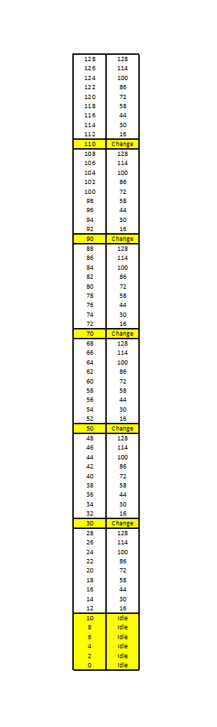

I can understand what you're saying, but the granularity of the sounds are still controlled by the movement of the stick controlling the motor.
So the sounds can go from 0% to 100% as the stick goes from 20% to 40%, but whatever processor is listening to the changes from 20% to 40% is still only going to see 20 steps, so each step will be 5 times the size of the step as compared to when the sounds follow the stick motion from 0% to 100%
The way I would code it would be to read the incoming stick movement then, for instance, if this changes from 40 to 41, then the pulse controlling the sounds has to change from 72 to 79.
When it changes from 41 to 42, the sounds change from 79 to 86.
Any jitter in the movement signal will be magnified due to the bigger step changes in the sound signal.
The table above shows the progression of stick movement and sound changes, but the granularity of each "gear" would still be limited by the small number of changes over the range of the stick movement. I've used steps of two to limit the size of the picture, so it would be better by a factor of two that this might suggest.
