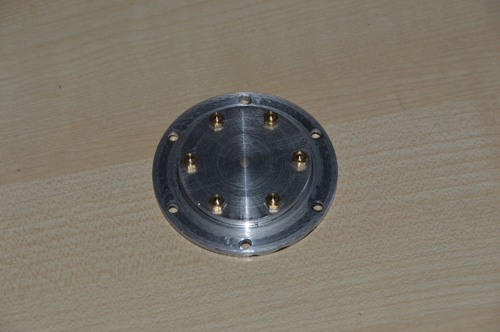

Still, the remaining M3 brass inserts have arrived so I can carry on with the female sponsons.

Female sponson ends have been fully kitted out with the new inserts, so once the Loctite has time to go off, I'll start building them up. Then I need to make out the missing rivets on the roof and add them, without clashing with the fasteners already installed :roll:

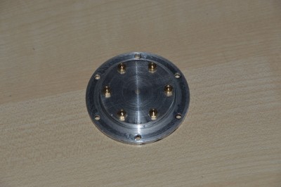

Been getting a bit bored with all the painting so thought I'd have a crack at some detailing.
When you start to look, there's an awful lot more detail to a Mark IV than just the rivets. These armoured covers for instance:

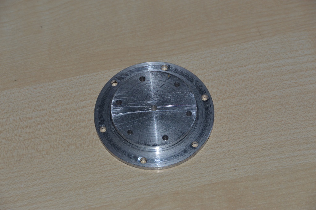

The model parts are fixed on with M3x16 hex head bolts and nuts. I felt the M3 nuts were too thin, so decided to swap them out for 6BA brass nuts and bolts, with the nuts on the outside. A ring of holes has been provided on the kit part for the inner nuts, but no fasteners are supplied and, as they appear to be slightly smaller, I decided to use 7BA for the inner ring.
In order to fit them, I have ordered 7BA full brass nuts and 7BA x 1/2" CSK brass bolts.
The first step was to drill the existing holes all the way through the part, using a 2.5mm drill:
Next, I counter drilled from the rear with a 4.5mm drill, using the stop on the drill press so that all the holes were to the correct depth:

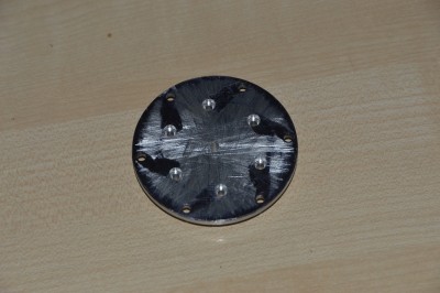

The last machining step was to mount the part in the lathe and drill a 3mm hole through the centre. This is for a short length of 1/6th brass square bar to add the final detail.
This is how the part looks prior to priming and installation:

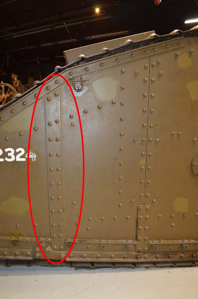

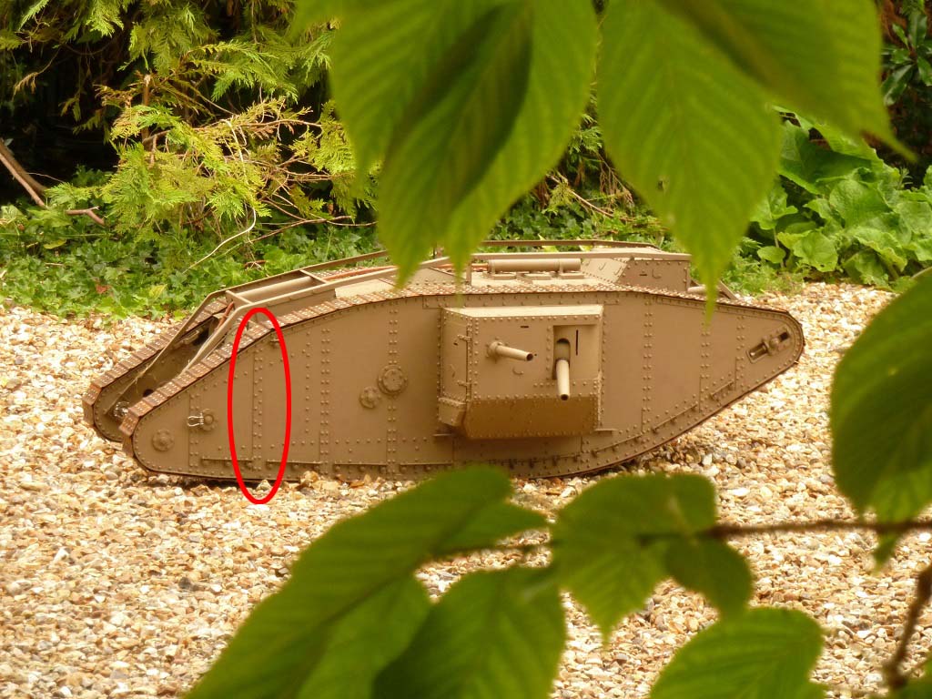

Why are these rivets not lined up in pairs as on all the other armour plates ?
A quick look through my various other pictures and it turns out they should be lined up, and there should be a gap above the angled line of rivets.
Easy enough to drill new holes but filling in the other holes may prove to be a pain. I've done it before with silver solder but that means stripping all the paint off again. I could use an epoxy such as JB Weld but I wonder how much of a grip it will get in a 1mm thick panel. With the lack of any kind of suspension on these tanks, everything gets bounced around when driving about.

2. Rivet patterns
You're correct that all the pictures of Mark IV's show those rivets as level in pairs. However, Mark based the Armortek model on the original drawings, which can be seen in the rear inside cover of the Mark IV Haynes Guide. That had the rivet pattern as on our tanks. It's an example of the differences between design and production.

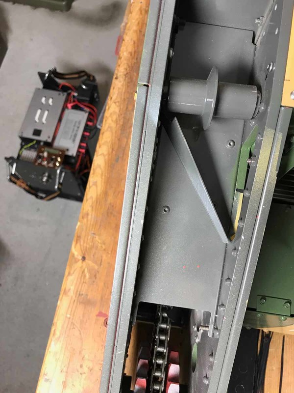

Am I right in thinking the handed pair of EK0113 parts have been folded upside down :oops: , so the deflector holes face the wrong way :roll: :?:

lacking any answer from the pros I’ll show my solution.
I think this section needs to be corrected.

I have drilled two new holes in line with the others and will fill the empty with screws as you have done.
I see you have changed the angle slightly so the end of the baffle meets the end of the hole. I may do that as well, otherwise the debris will be trapped in the corner. Not that it seems to have been an issue for the three BoB tanks.

Hope I’m not about to embarrass myself with my ignorance but...... aren’t those deflector plates meant to channel muck out through the hole in the inner side frames? Given that the track moves from rear to front it seems that debris would accumulate against the outer frame where the holes are covered by the outer armour.

As supplied, the baffles do point the wrong way and trap debris against the outer plates, hence the need to drill new holes so that the baffles face inwards. Page 16 of the manual actually shows them facing the wrong way :oops: :oops:
Due to the way the holes are aligned in the sides of these pieces, it's not possible to simply switch them from side to side on the tank to get the correct orientation.

The original discussion on this would have been around 3 :shock: years ago in my Liesel thread. The plates are indeed the wrong way round, and need to be put in as Oliver has shown. It only requires two new holes to be drilled - I blanked the old ones by gluing a spare rivet in.
Debris does indeed gather behind the plate - both Daniel and I showed pictures of it when we took our tracks off, describing it as the 'birds nest'. But it doesn't interfere with the track running.
It's a small, almost invisible, but historically correct change for the Mark IV. Confusingly, the Mark V has them the other way round, ie. the way shown on Page 16 of our instructions ! :?
But it also has the chute through the outer skin, so the debris falls to the outside, rather than all over the back of the Mark IV, where it will presumably sit like tinder on the fuel tank :shock: :shock:
