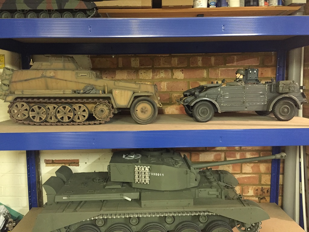

Hi all, owning 2 Armorteks has required that i have a bit of a re-org in the garage/werkstatt.
I have just built this heavy duty shelf unit to hold all my 1/6 armor.
Each shelf can hold upto 350kg evenly distributed.
The dimensions are 1800 high X 1600 wide and 600 deep.
I got it from ebay for under £60 with free postage.
It went together pretty easily and seems very solid now it is together.
The unit still need to be fixed to the wall, but it was getting too late to do any drilling.

That looks well organised Tim

It will certainly help with storage although it is a bit of a pain moving them on and off but hopefully will become easier once i get the hang of it.
