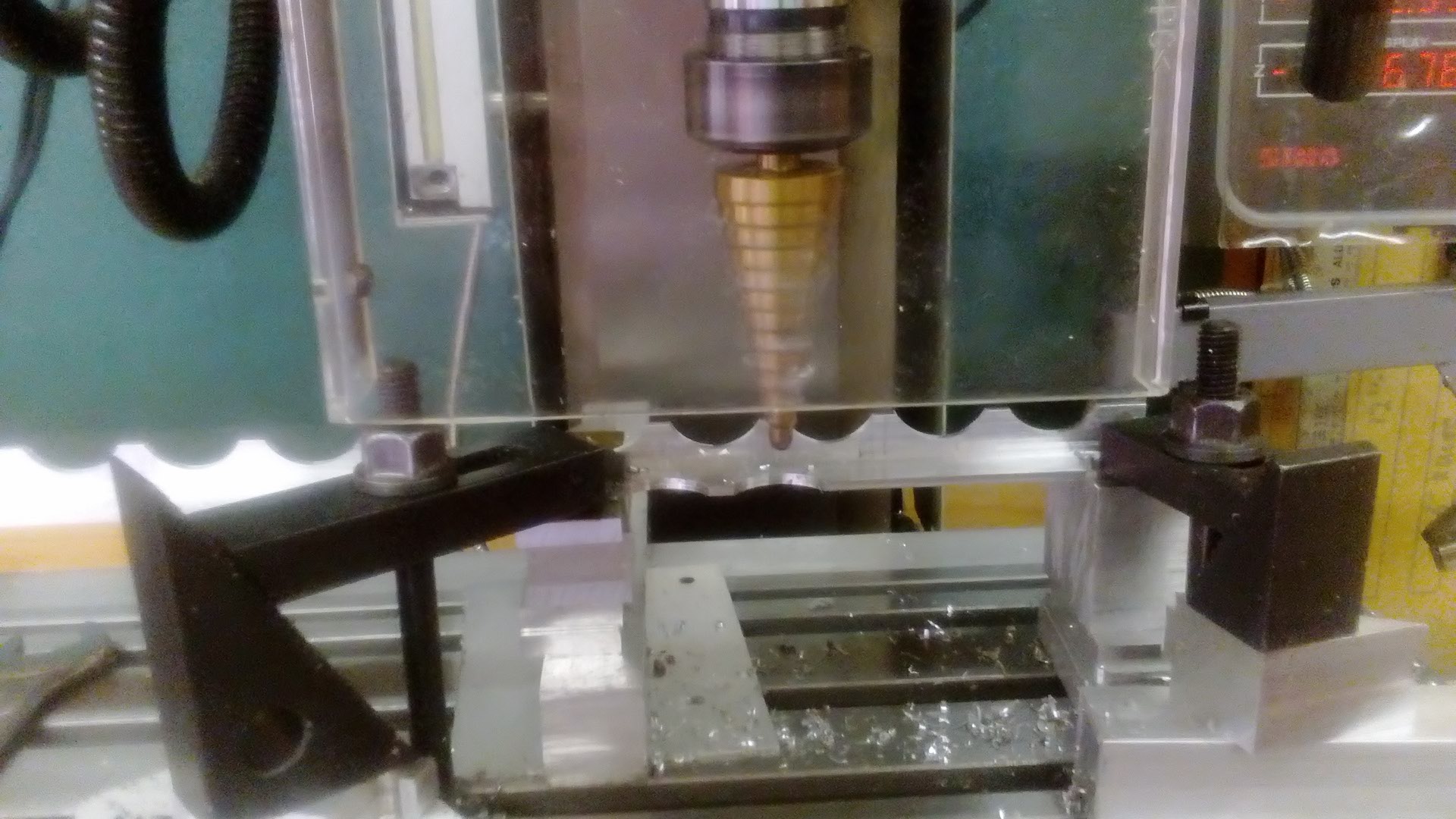

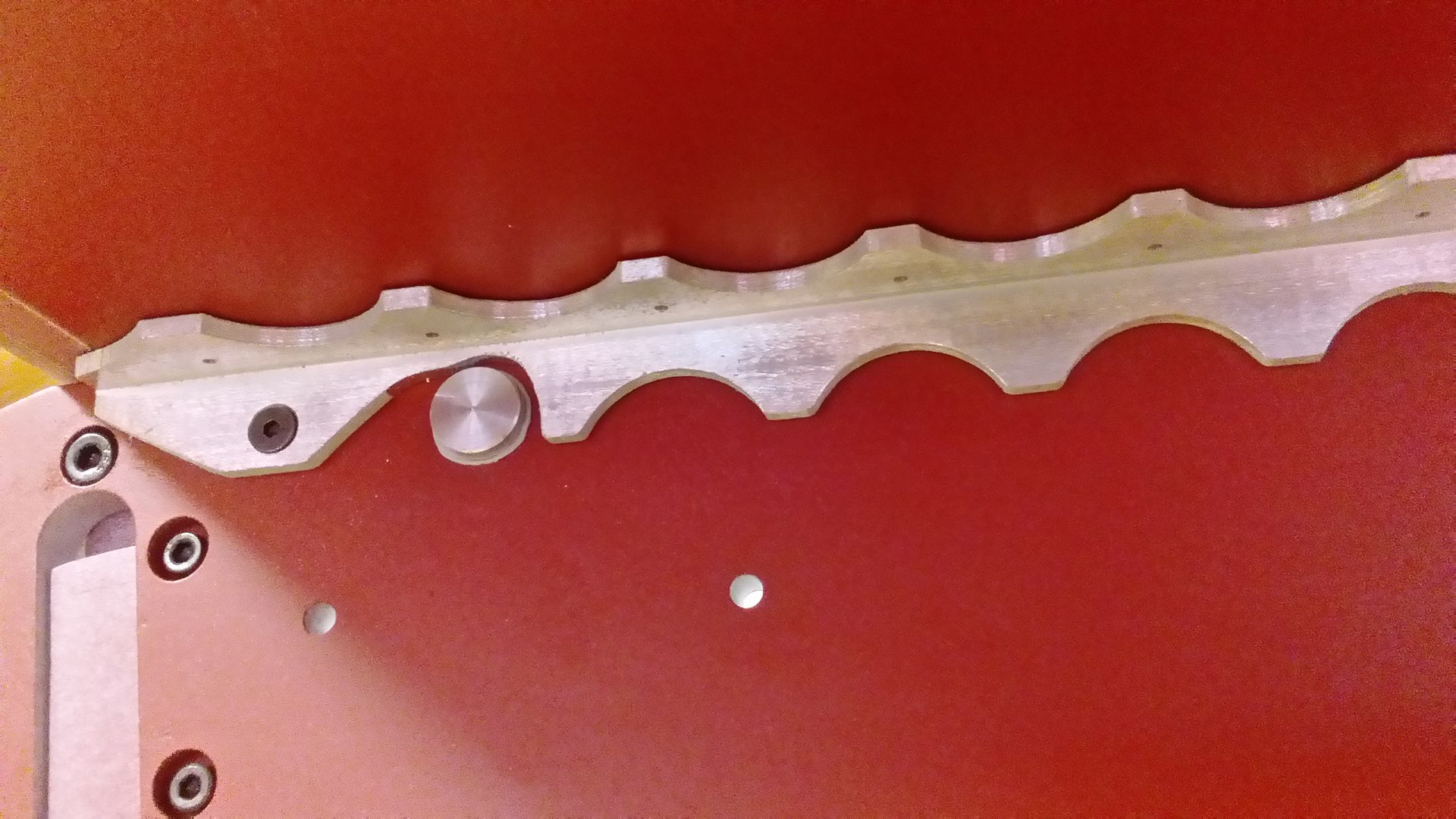

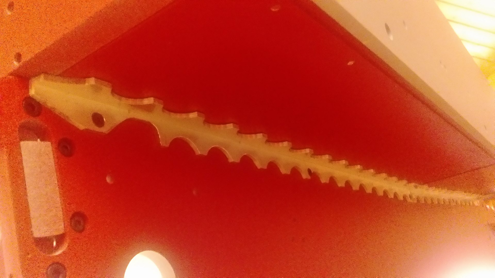

I gone back to working on the pannier floor angle plate l have looked at some excellent ideas on the forum on the subject but I have decided to carry on with my original idea as I have spent quite a bit of time cutting these plates to size and thickness.
The semi circles cut into these plate vary quite a bit so I used a average measurement and got what I felt was the right look.

Nice bit of milling there David, and it looks good in place.

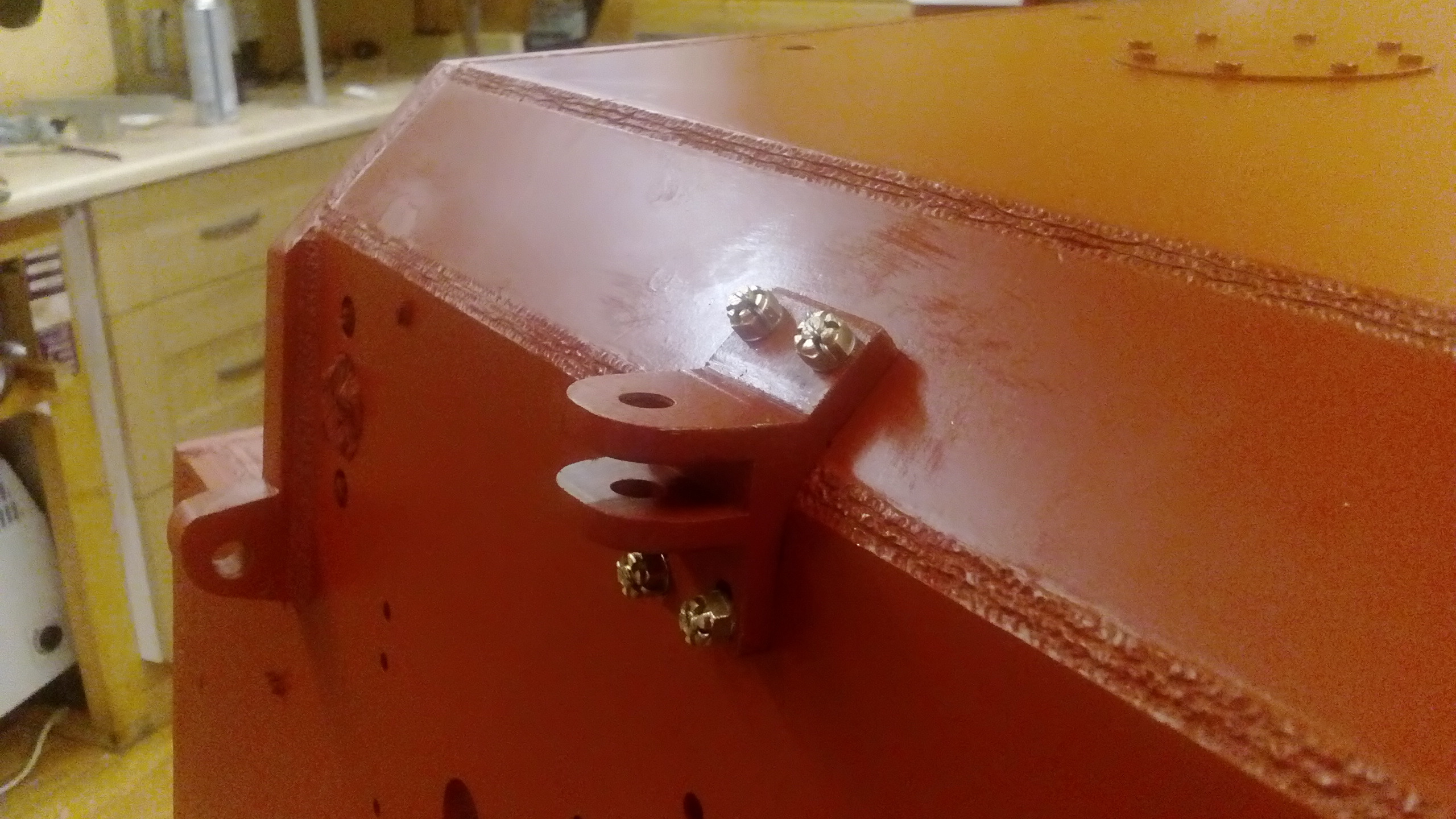

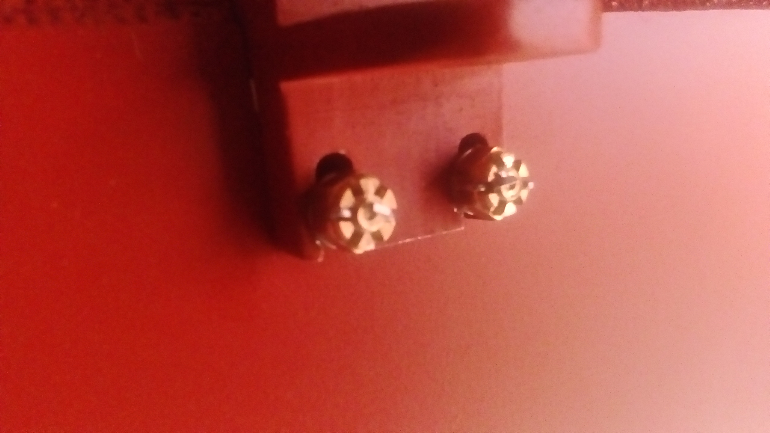

Paul, Simon, thanks for your kind comments always appreciated. The rivets have just arrived in the post so I will fit these and then start on some weld simulations.

David, belated admiration for the machining you've done to produce the scalloped edges. I bought a step drill a while back and wondered if I might ever get it use it. Now it has a use, if in several years time.....

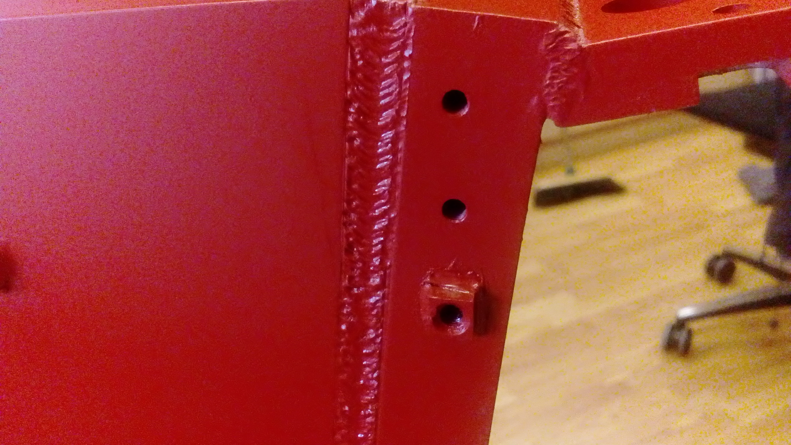

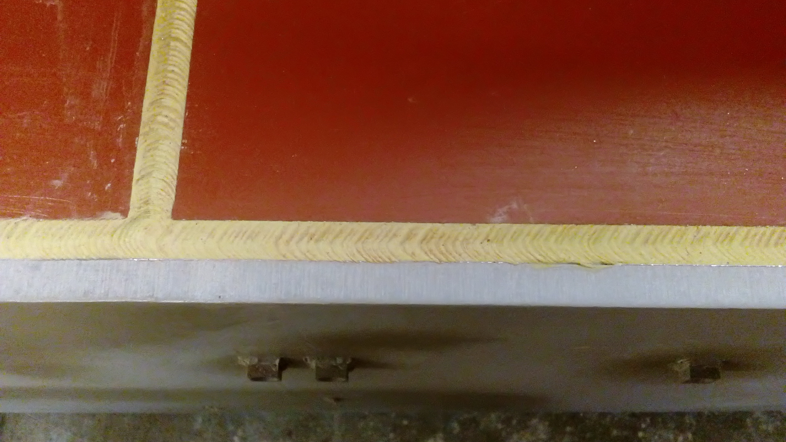

Progress has been a bit slow with the weld simulations I have tried liquid metal and fabric paint but was not very pleased with the results so I went back to the milliput.
After looking at photos of Tiger 131 welds I tried to copy the relevant weld patterns with what I felt was a reasonable image.

Hi David,
Wow
lucky Gill. To be honest, I am not sure who got the better deal there. I like the ministry of finance title, I have one as well, she is there to remind me I no longer earn as much as I want to spend
Those welds look real, I had to look twice at the painted version to make sure it wasn't a comparison photo. Can you give away your tooling and technique?

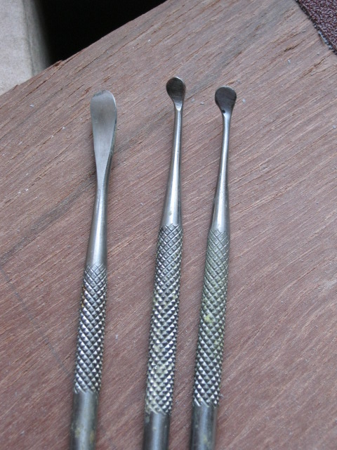

I have been using the three sculpting tools below, but it doesn't come close to yours. I found that by working backwards the circular ribs were created. Paul.

Thanks for your kind words, as regards the tools that I use for making the weld simulations they are just a old set screwdrivers ranging from 1.5mm to 6mm blade width. The tips are rounded off similar to the tools that you are using. I have also added a couple of old worn ball ended hex keys 1.5mm to 2.5mm.
Some of the welds on tiger 131 are very rough with very little pattern to try and copy, so this is where I used the hex keys first and just gently used the ball end all over the weld to give stiple finish. Then I would use the rounded screwdrivers to gently press in a waved pattern or I would use the back of a knife to cut thin narrow lines to represent what I call a multi bead weld.
