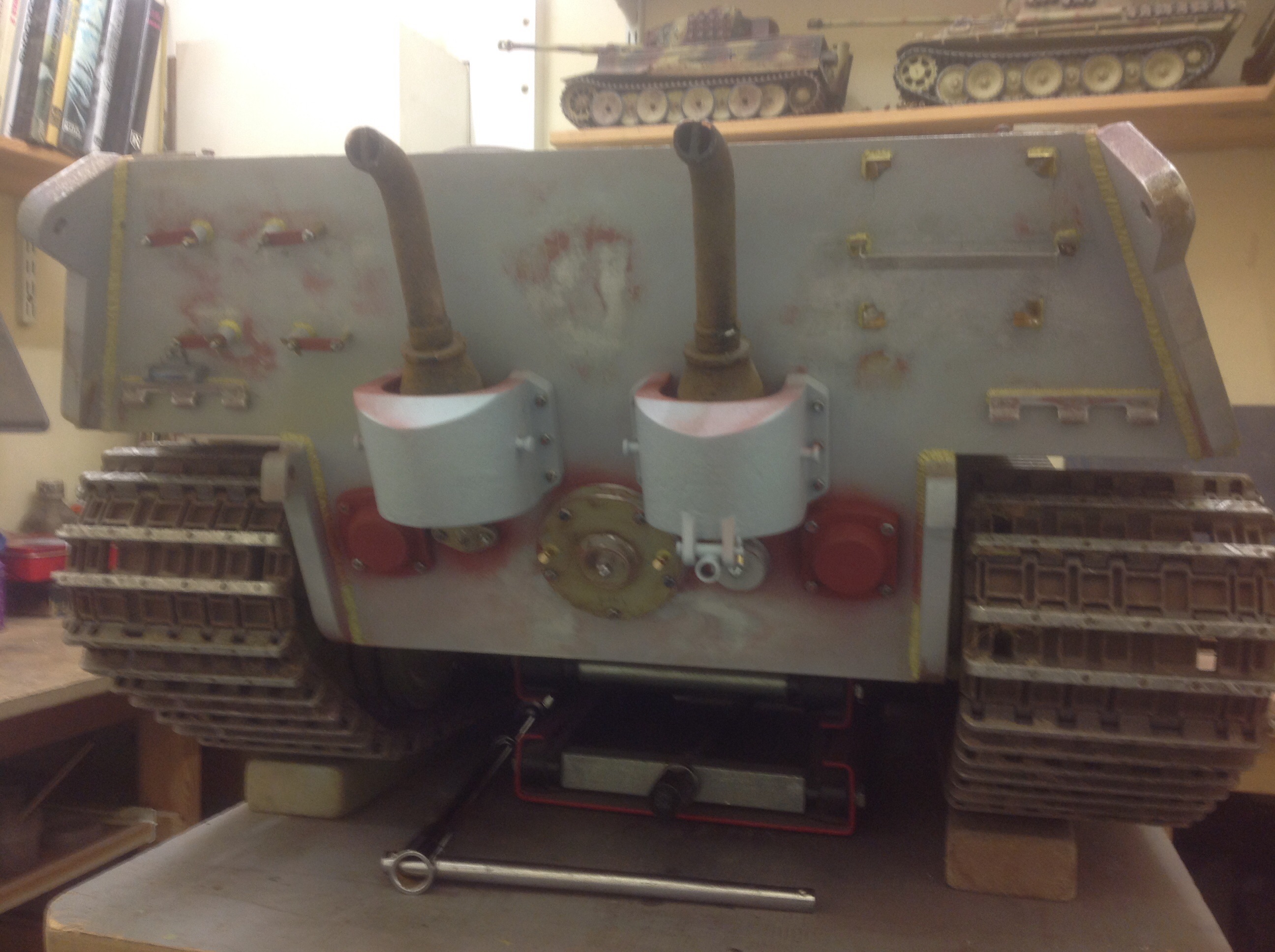

I've not posted much recently so I think it's about time for a update.
Back end now complete, I have deleted the jack from below the exhaust as it was not fitted on late vehicles although strangely the jack block was.
Rear view showing added details
Again rear deck detail
The front end
The front end
The turret now needs to be started so I will post more when that is underway.

Hello Steve,
Good to see you get going again. This will turn out to be a very nice model.
Some small comments; four vent tubes from the petrol tanks was a bit later if this is meant to be a September vehicle. Also you added "anti step-on" bars at the back tubes - this was a very late feature, probably in Mars/April 1945.
Regards, Per
Steve Norris
Posts: 1231
Location: Manchester
Has liked: 8 times
Been liked: 701 times
Re: King Tiger rebuild
Post by Steve Norris »
Hi Per
Great to see you and your wife again at the open day.
Thanks for the info. I am going to finish this KT in a hard edge camofauge scheme as seen on some that took part in the battle of the bulge, so the build date for the tank has been moved a bit to the right and could now be October or November 1944. I didn't,t know that the gaurds were very late war additions so thanks for that info and I will remove them.
Ok, step guards removed from around rear vent tubes on pers advice.

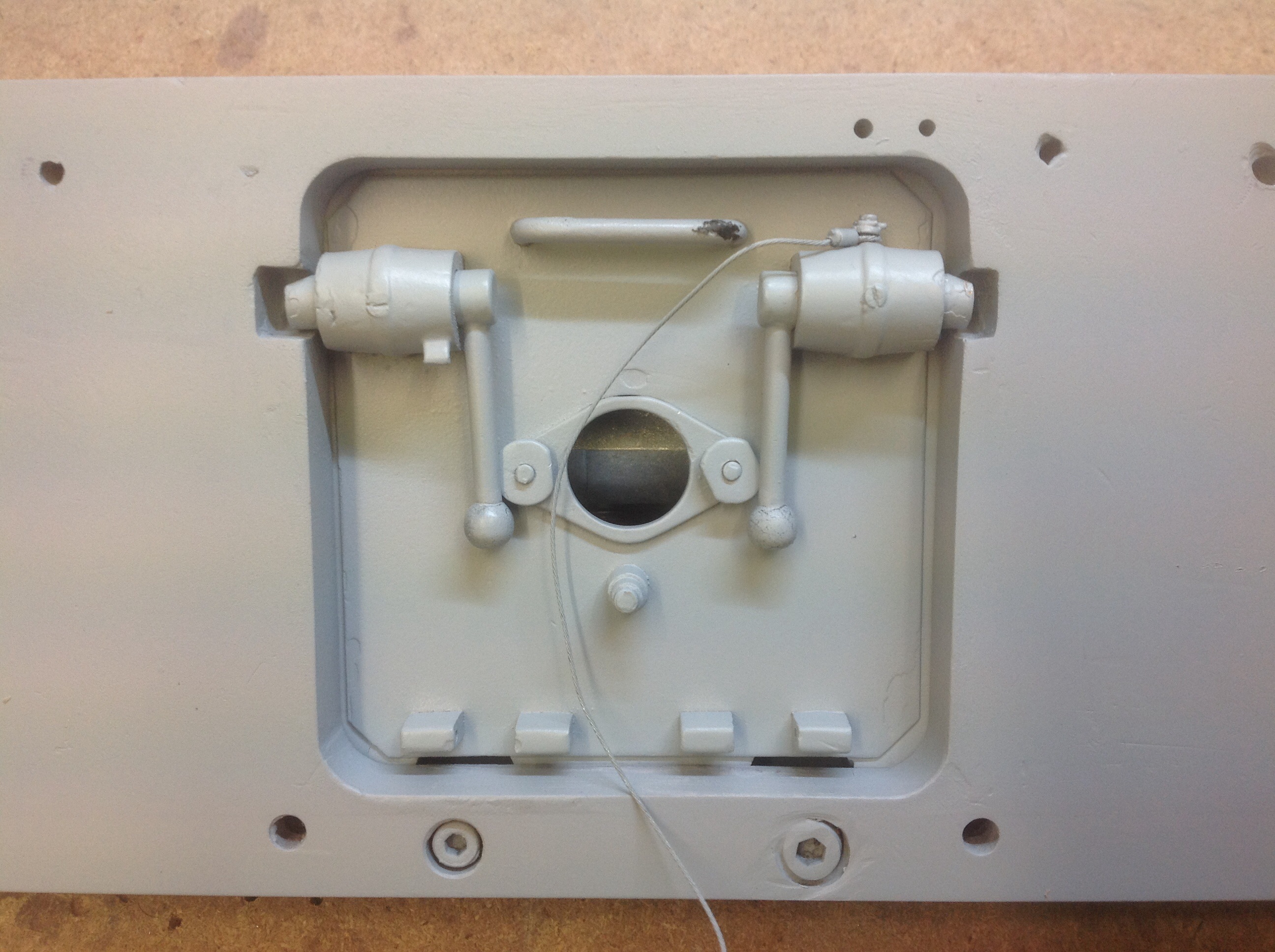

A bit more work carried out on the turret parts prior to assembly
I have a rear turret hatch with Steve Winstons upgrade locking mechanism and have decided to modify the surround to accept the lock pins. This photo shows the rough cut outs that I did using my Dremmel and many cutting discs.
Two cut out liners have been made to neaten things up a bit
The liners Araldited in position, when dry filler will be added and the area cleaned up
More to follow

Hi Steve,
My back is on the mend, give it a couple more weeks and I will be raring to go :D Your new mods look good mate 8) I need to rework the turret hatch on mine, it doesn't sit flush. Thanks for sorting the other things.
Paul.
Steve Norris
Posts: 1231
Has liked: 8 times
Job done, hatch added to check fit.

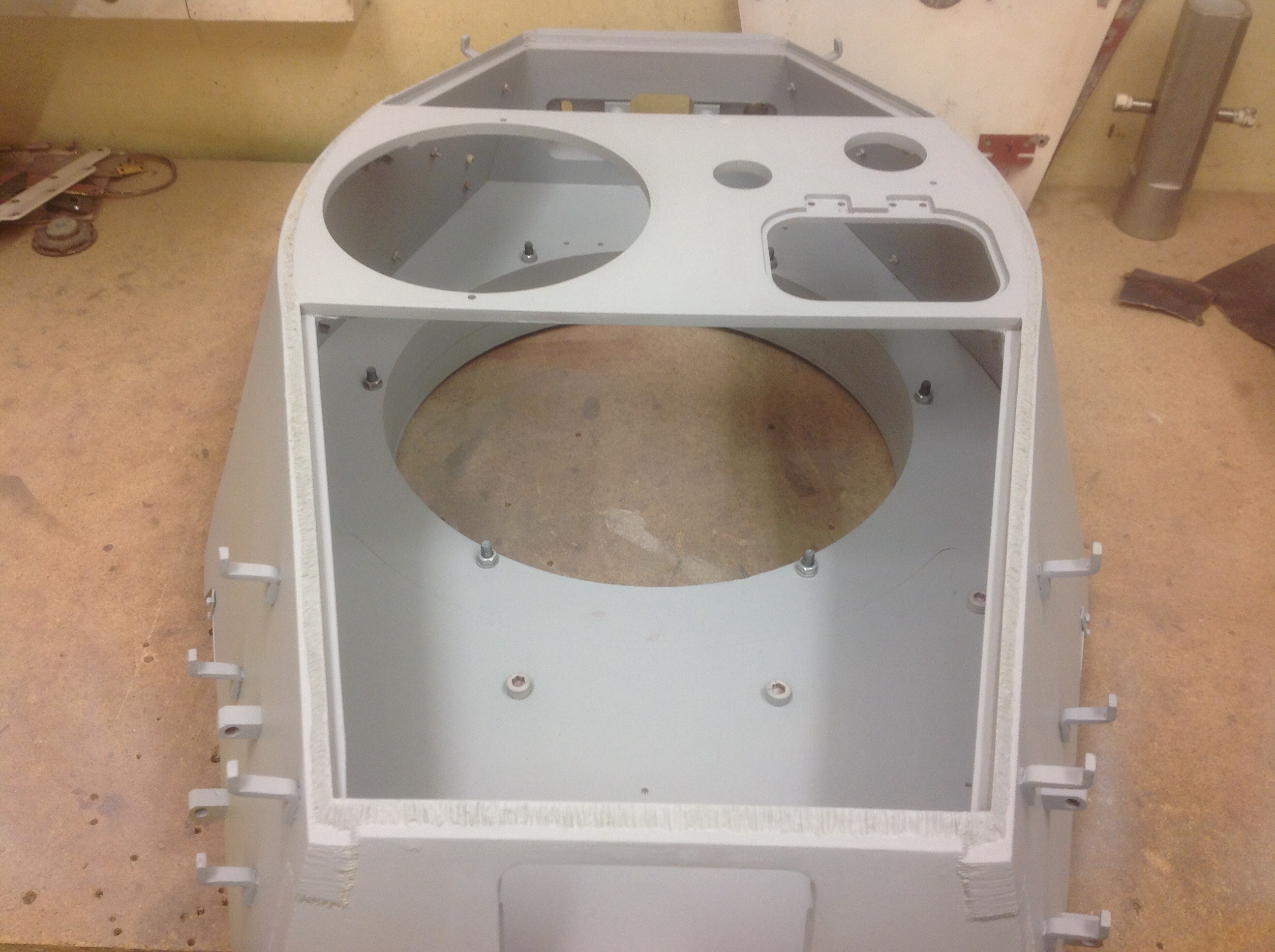

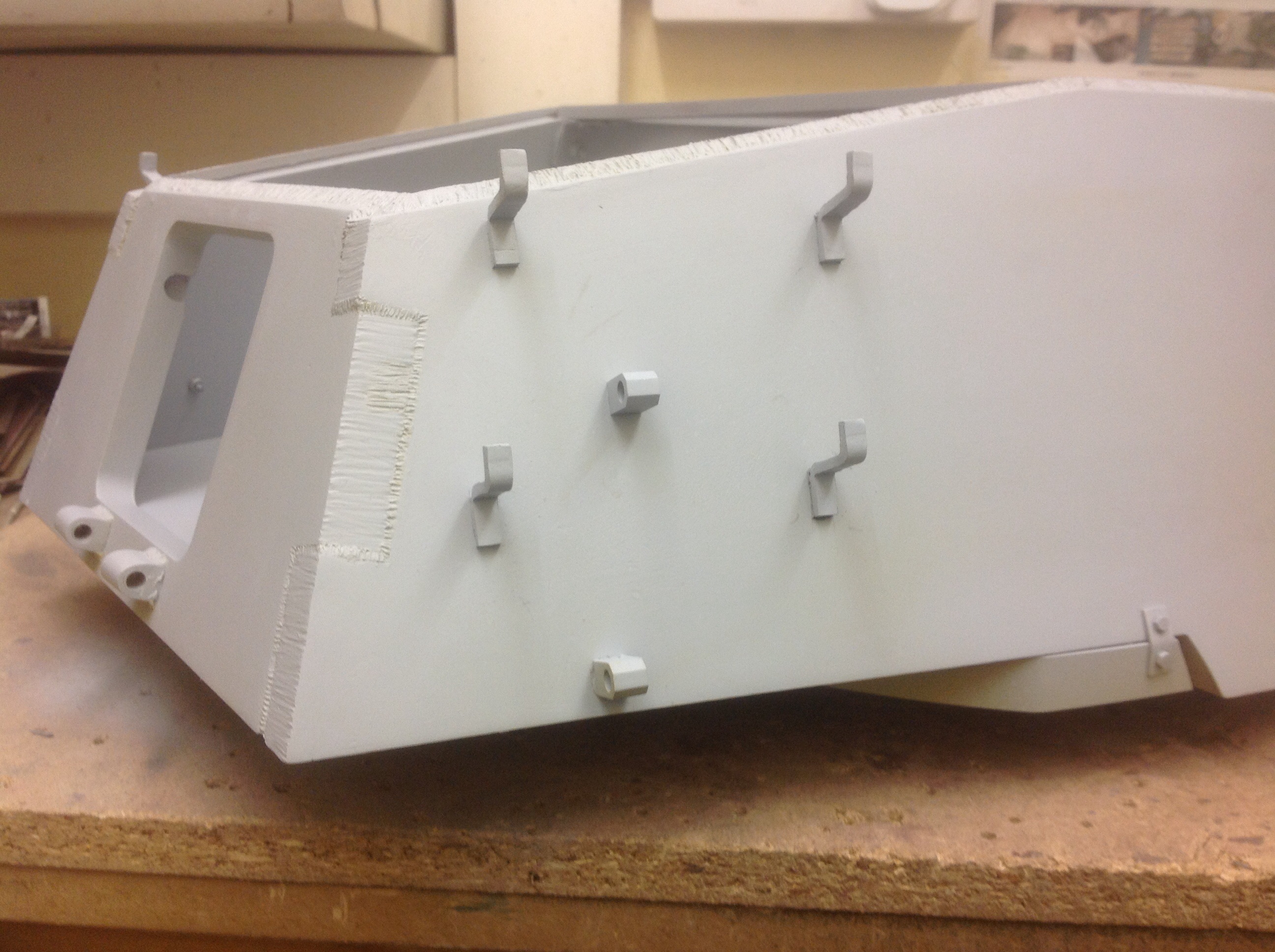

Basic turret awaiting detailing
Turret overhang,the track hangers have all been repositioned and the grenade guard added bellow the overhang
Basic turret now reassembled
