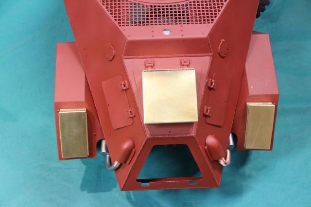

Some more progress on the 222.
Rear mudguards replaced with brass. Changed the angle at the front based on drawings.
