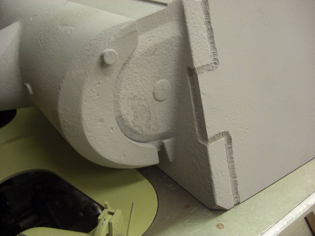

I just have seen the advance to get the cast surface. The eraser you have used is not powerful enough to get a satisfying effect. I have taken a normal sandblasterpistol and the pressure was about 6 - 8 bar (think it`s arround 60 - 100 PSI ).
The small eraser I only use to clean soldered components as seen on the picture. That is the abutment of the 2 cm gun.
Bodo

Bodo, I agree, although it does produce a very fine pattern which is useful and I did find it worked when the spachtel was still uncured and soft.

Hi Stephen,
yes that is the size of the pistol I use to get the results I want to have. I let the spachtel dry complete to get sharp edges, where I blast it away. I have attached the turret picture again, where you can see the difference between the surface from the steel plate turret and the casted gunmount.
The turret was only thin coated twice and blastered with low pressure and the gunmount several times thick and blastered with higher pressure.
Bodo
