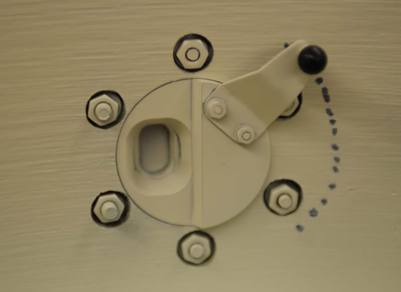

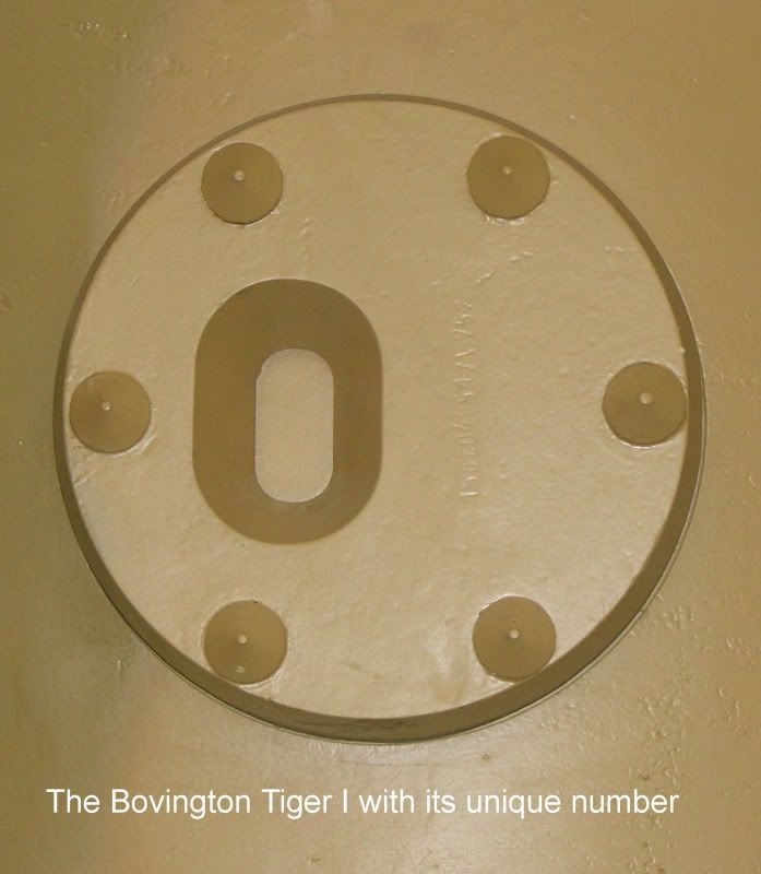

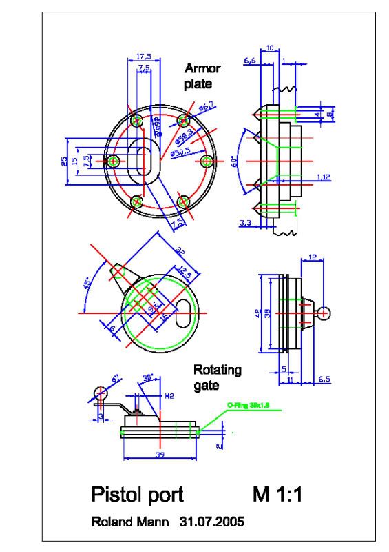

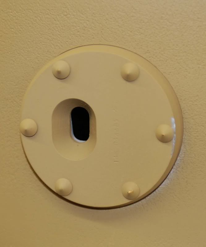

I can only say the port was a night mare to me. My first turn went out in a desaster - completely wrong placed bolts. The following pictures say all about. Luckily the rotating gate was correct because it was the bigger amount of work. With the wrong bores I made two photos. One in open and one in closed position. Finaly I got it right. Unfortunately I have no pictures of the O-ring to make the turning gate tight and just not too easy to turn. So the final result of my port is shown with the rotating gate in open position after the drwaing. The part number stamped on the cover is a allmost overlooked. The original part therefore is shown on the last photo. The drawing may help yo to understand the inner details.
Goog luck for your build - Roland[/img]
