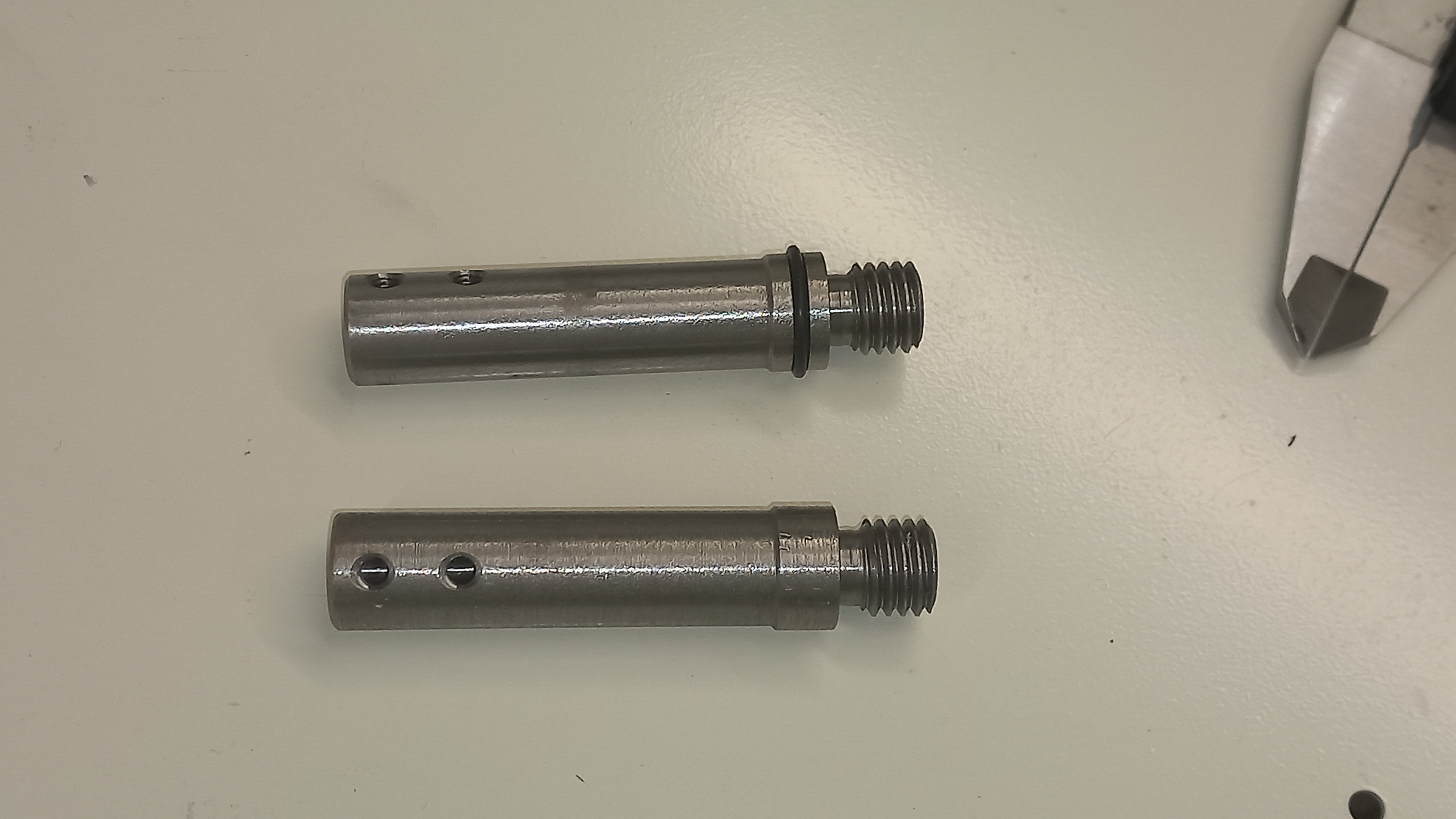

Hello Andre
This is not mandatory, I do it because I think it's an improvement.
And I enjoy working with brass.
Robert T

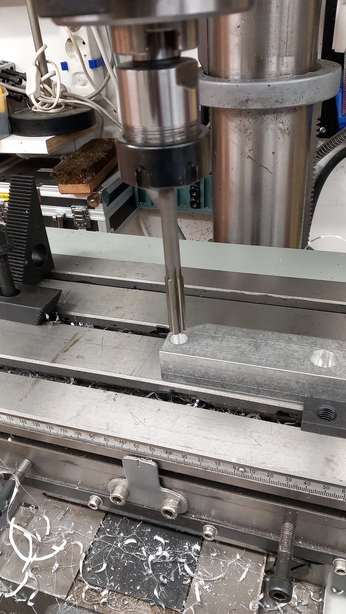

Some brass alloys are definitely NOT fun to work with; they can be 'chewy', grabby and just a pill to work with. Especially with twist drills
and too aggressively shaped lathe tools.... Chucking reamers as you used there are probably the best way of getting a reliable bore with any brass type.

Hello Jerry
I've never had a problem with brass, that you are talking about.
Hope I didn't say anything bad now. And jinx my self.
I have the best results with small sharp tines tools on my lathe.
Have a nice day
Robert T

Hi Yves
The bushes supplied with this run of Jagdpanther are steel.
This is a first for me all my previous kits the bushes were brass as you mentioned.
I would think they will be fine but will need ceramic grease to stop rust seizing things up.
Regards Derek
yves mouton
Posts: 1034
Location: Belgium
Been liked: 673 times
Re: JagdPanther G2 Robert 2024
Post by yves mouton »
Hello,
Strange that they go from brass to steel, if there go rust on these bushings it will block the suspension.
Best regards Yves

I continue to make brass bushings.
Only because I think brass is such a good and easy material to work with.
Robert T

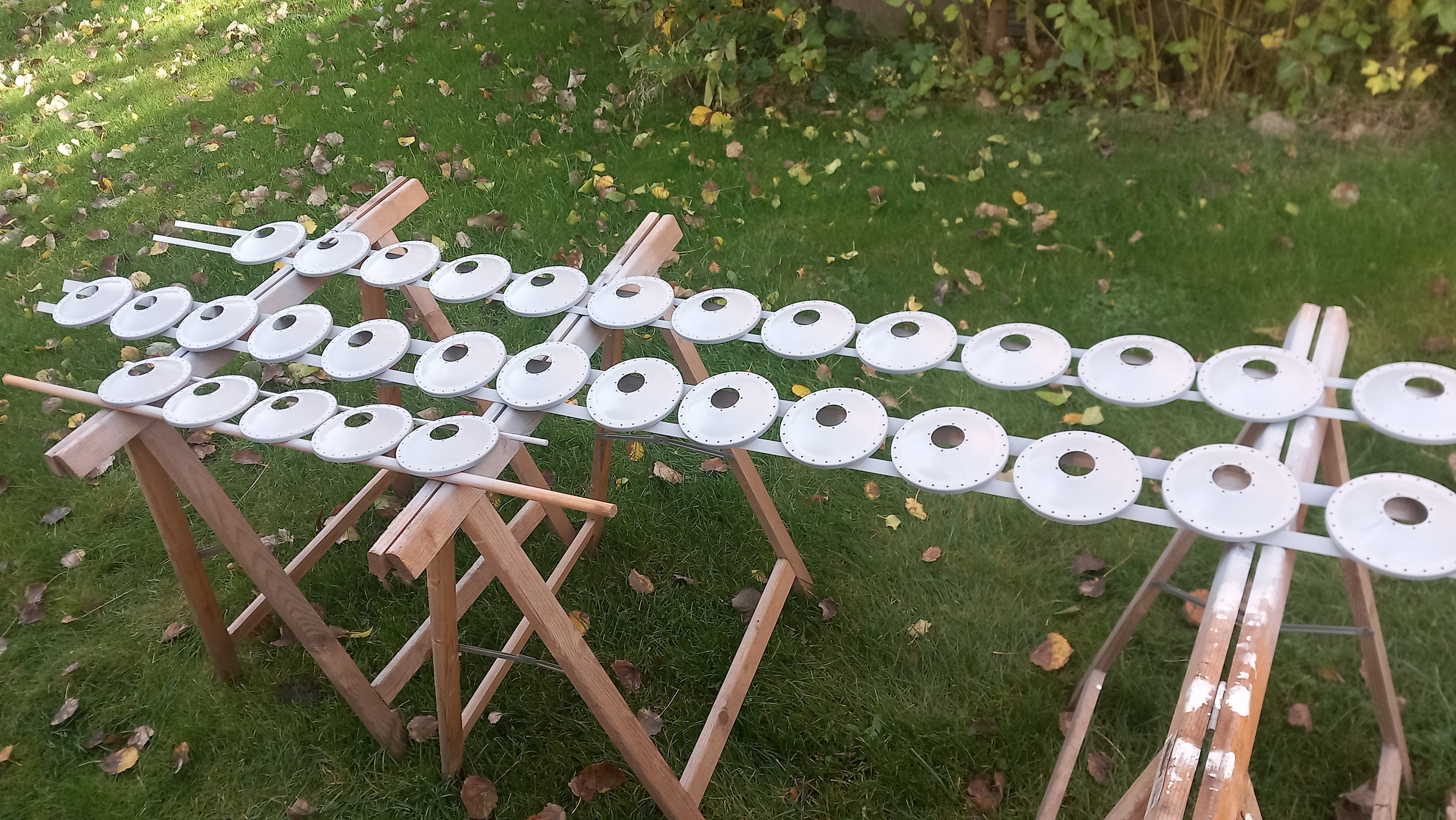

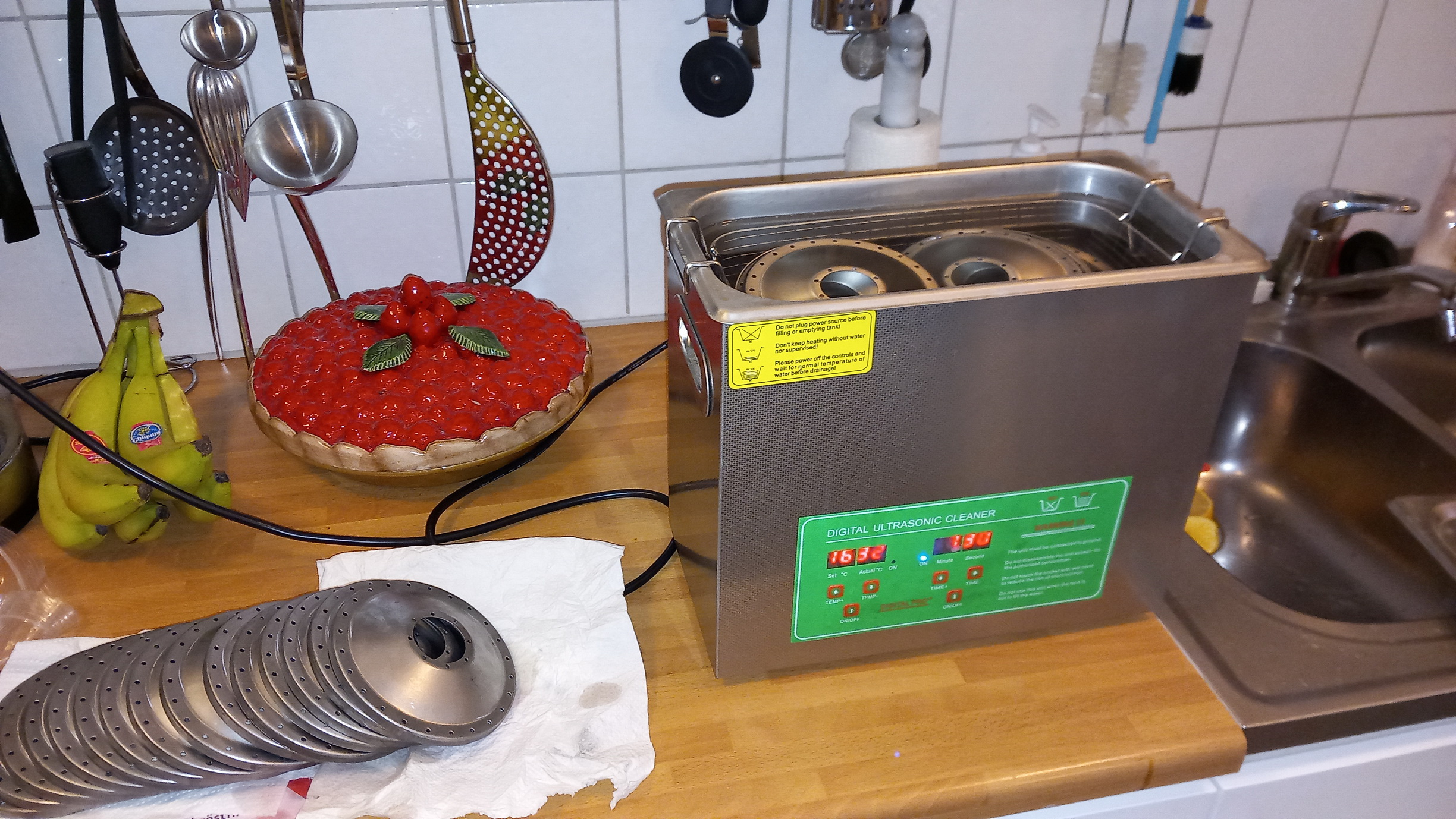

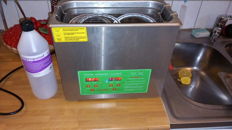

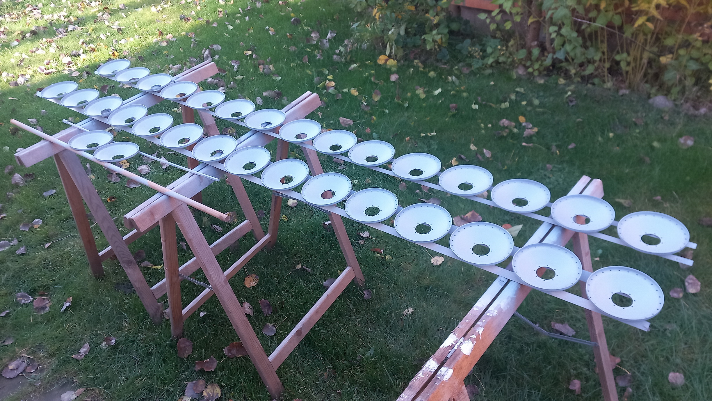

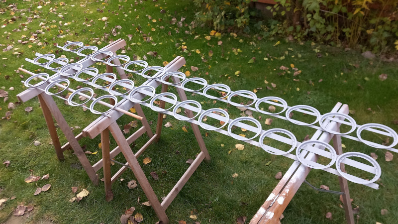

Today we've had wonderful weather, so I took the opportunity to wash and prime paint all the road wheels.
I also washed with thinner after the ultrasonic wash.

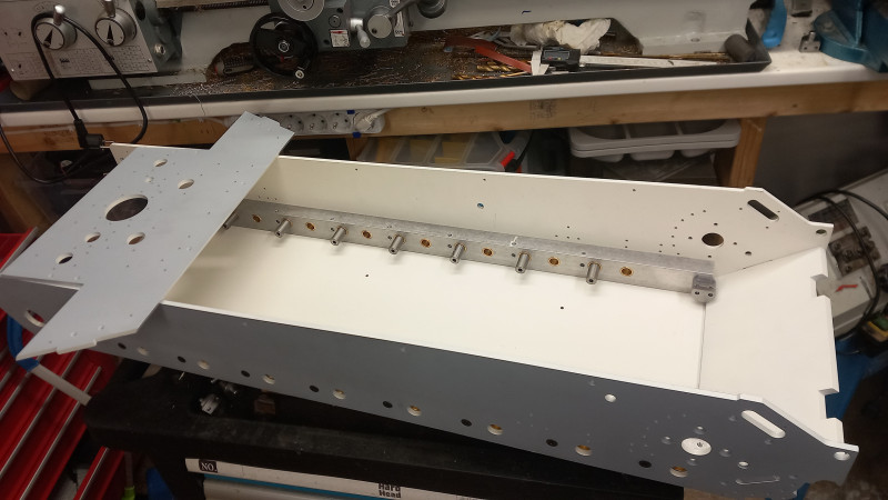

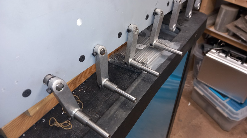

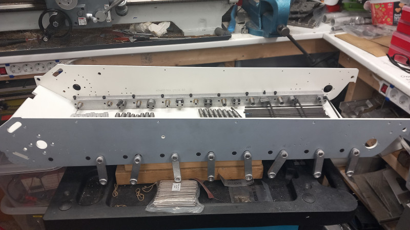

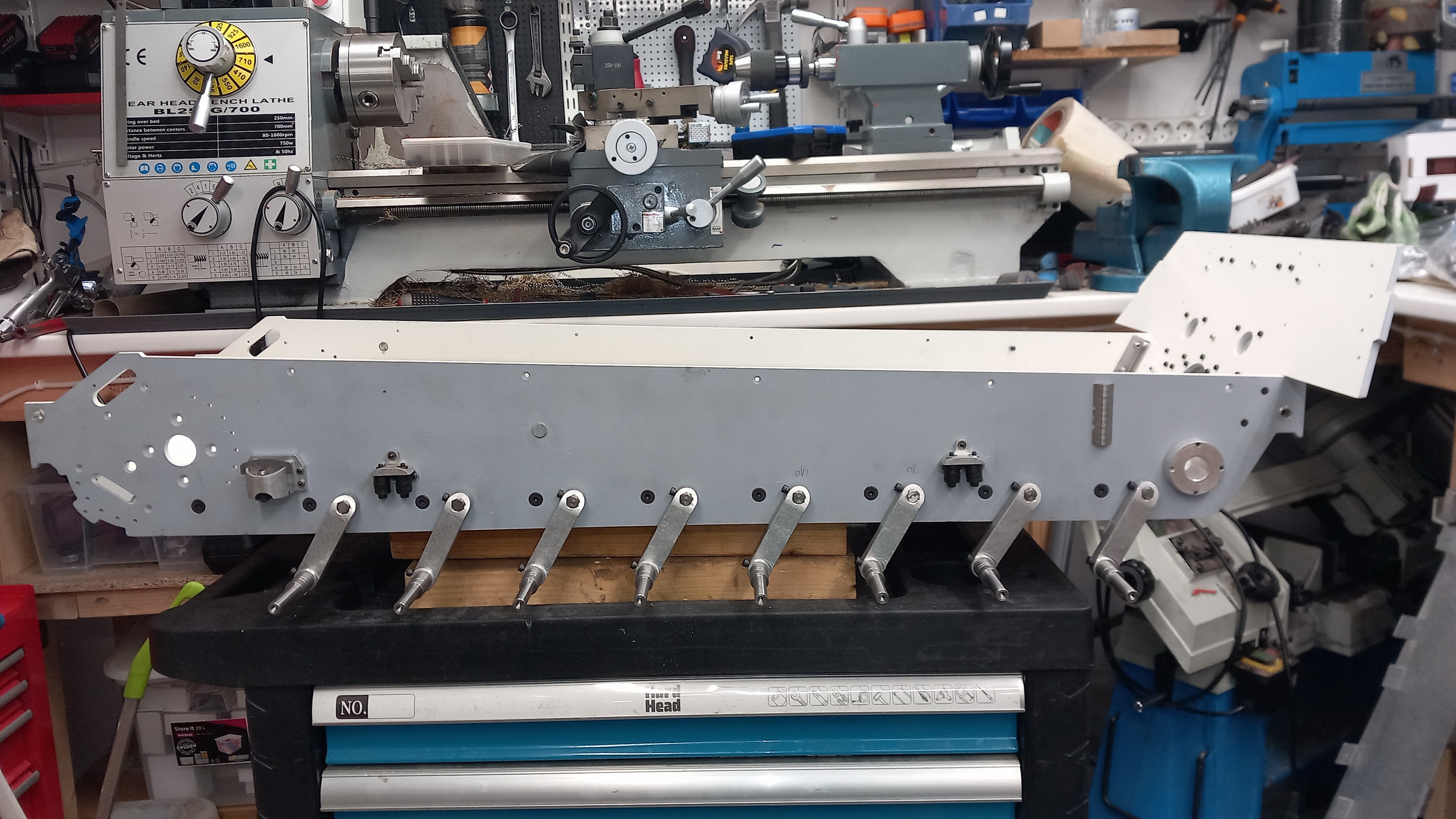

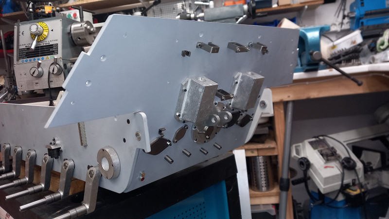

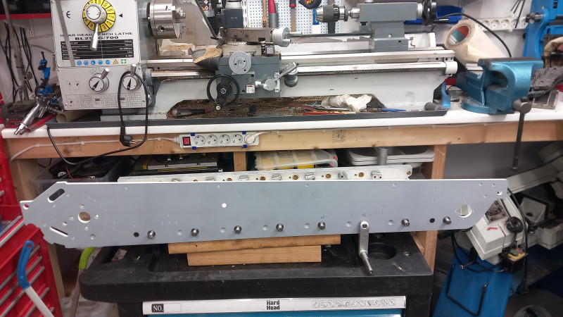

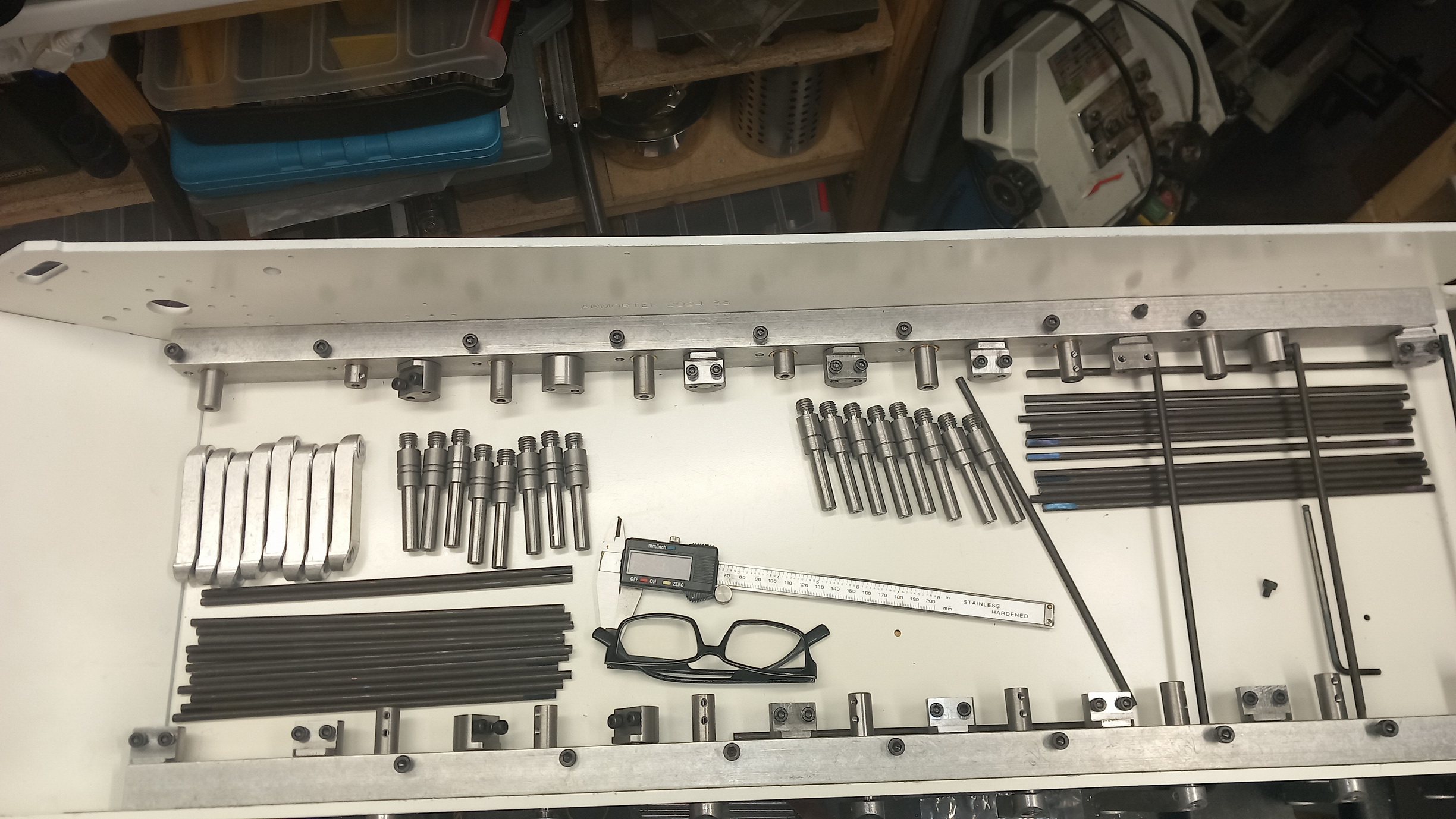

Started screwing the chassis together.

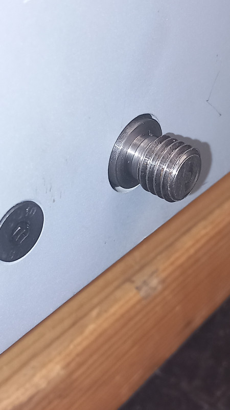

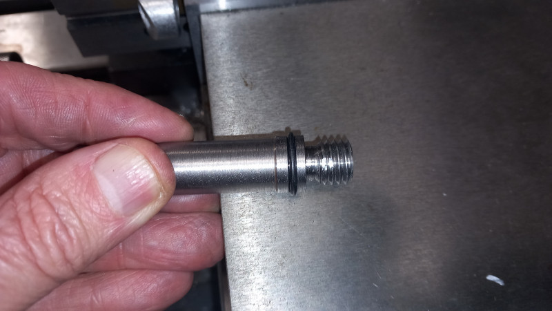

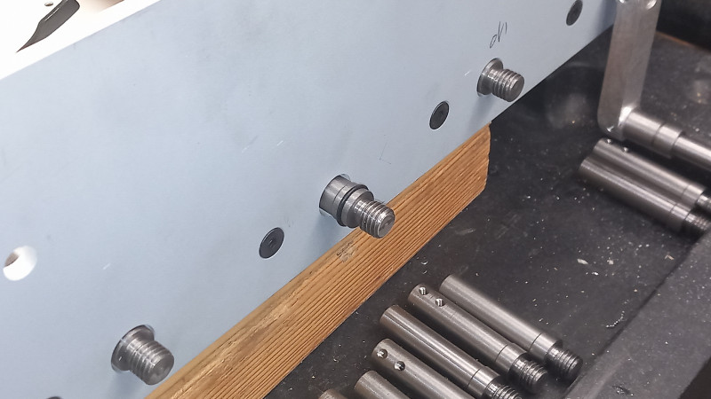

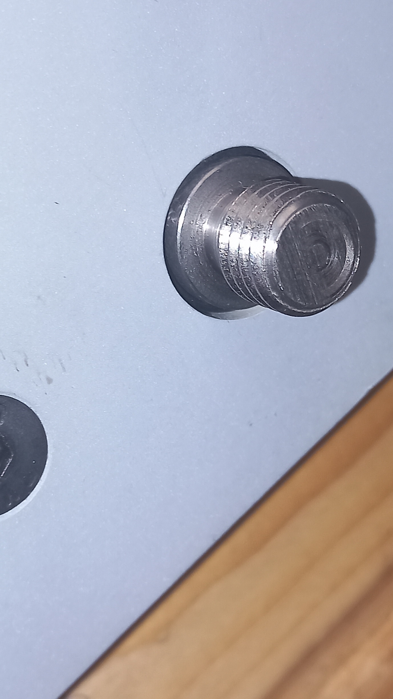

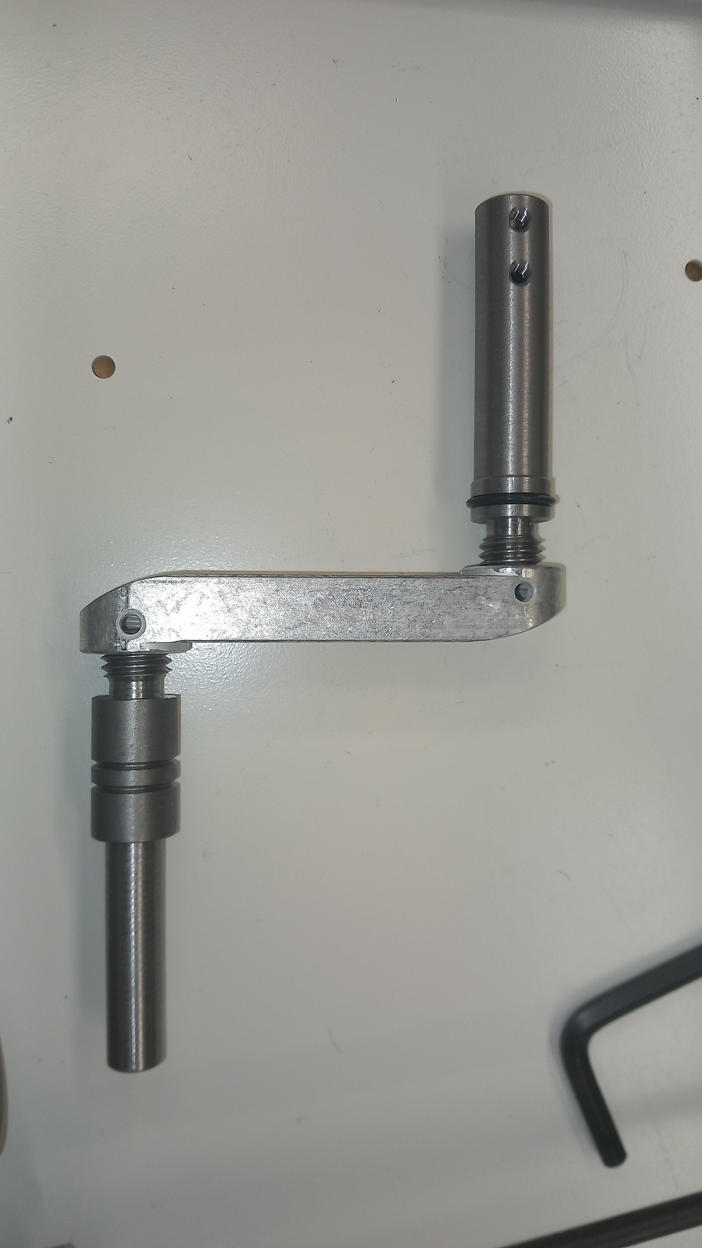

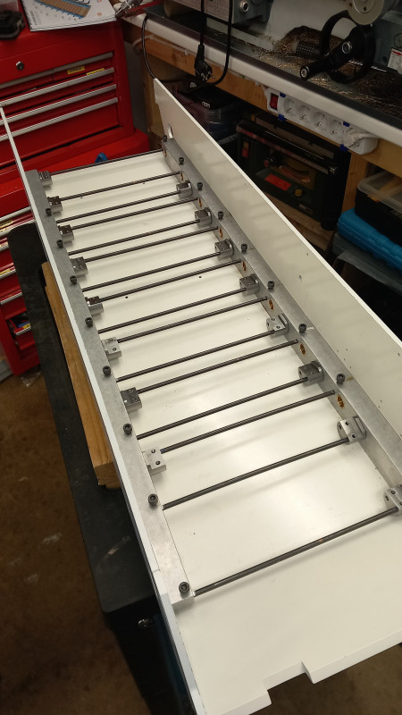

I have also put an o-ring on the shaft through the hull, possibly intending to have oil lubrication there.
And assembled the suspension.

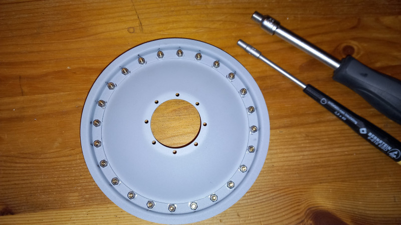

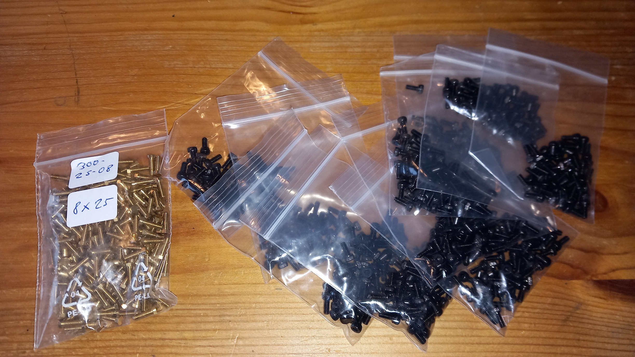

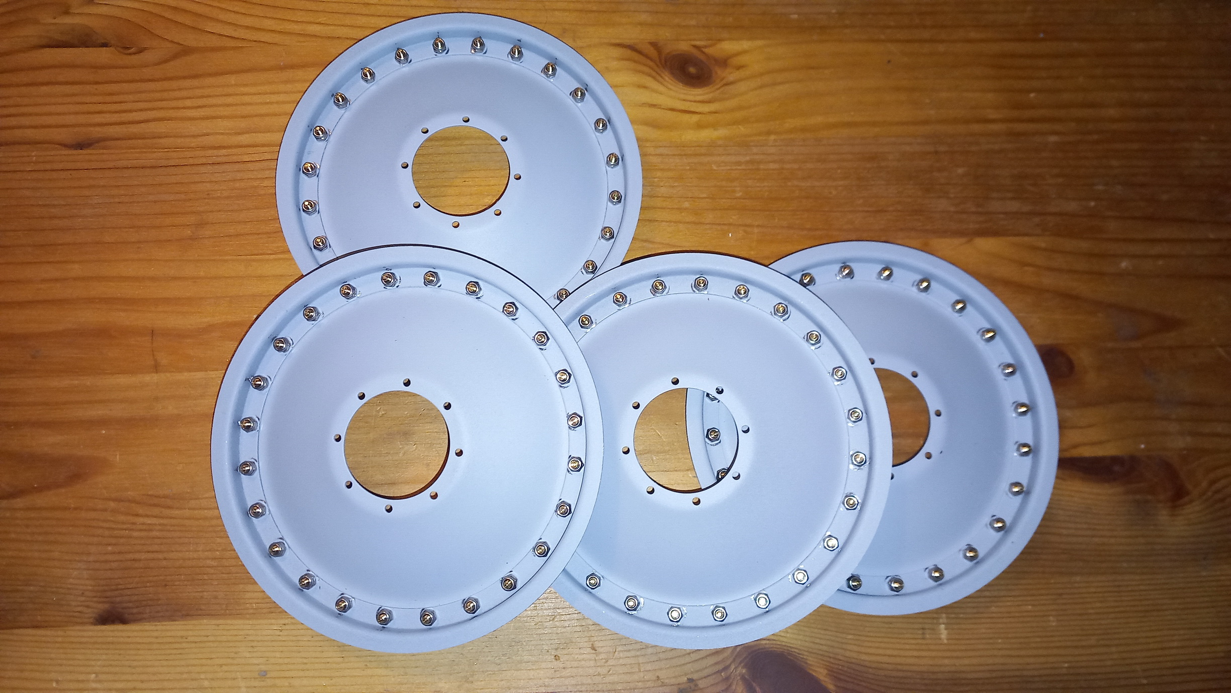

Have now started assembling the road wheels, I think I will have nightmares about all these screws. :D

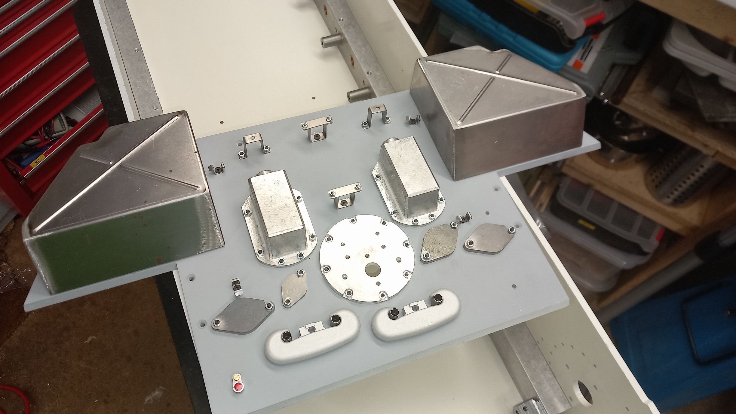

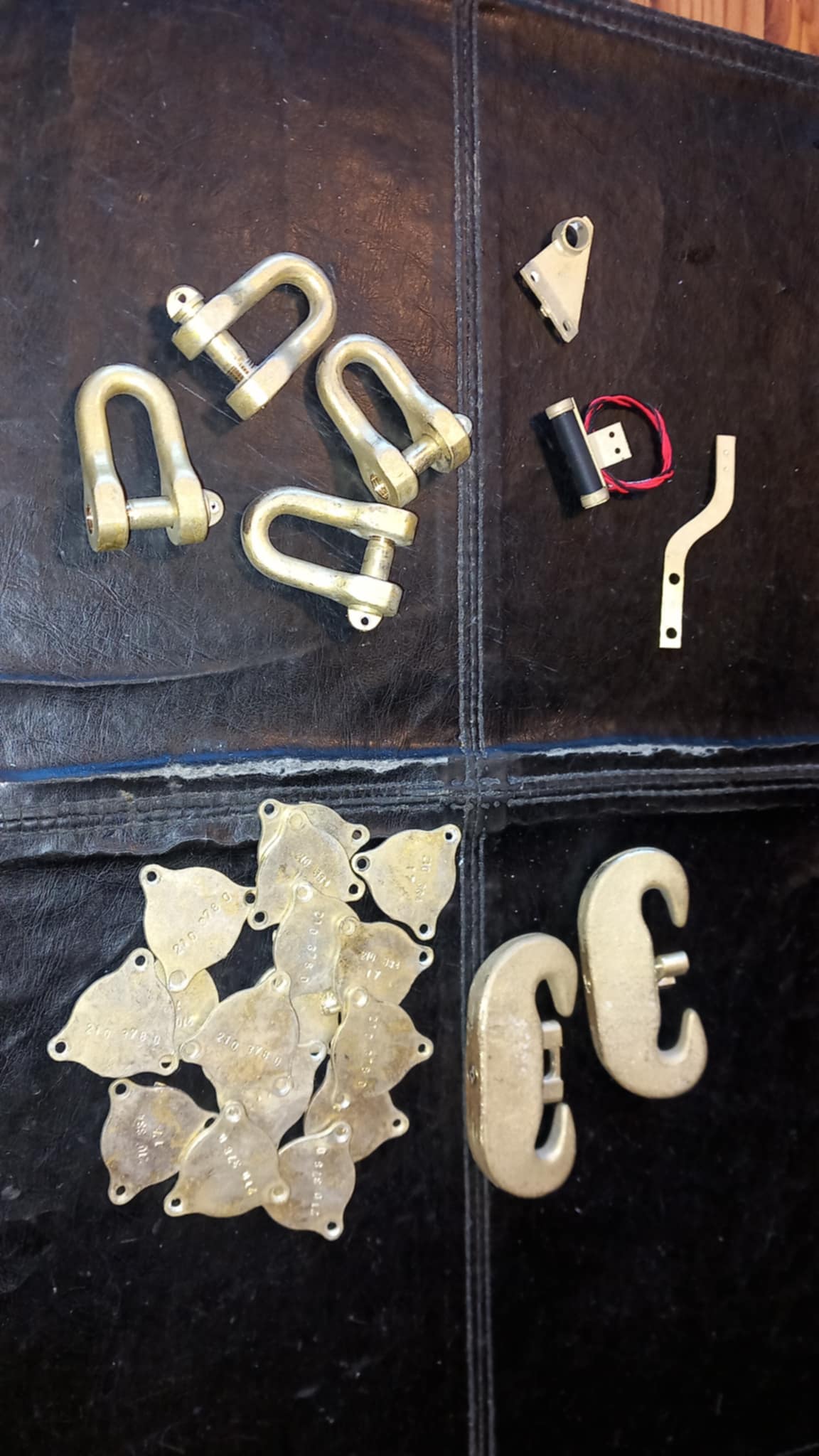

Today I had an early Christmas Eve.
Got a package from Mark Lawson, lots of brass candy in it.
To my beloved Jagdpanther.
Robert T

Lovely Parts from Mark! indeed early christmas for you! Torsion bar covers are not visible when all wheels are fitted but definietely one of the detail parts we should put them on our Panther! 8)
Marco Peter
Posts: 546
Has liked: 1502 times
Been liked: 794 times
Post by Marco Peter »
I fell in love with those C-Hooks long ago! :-)

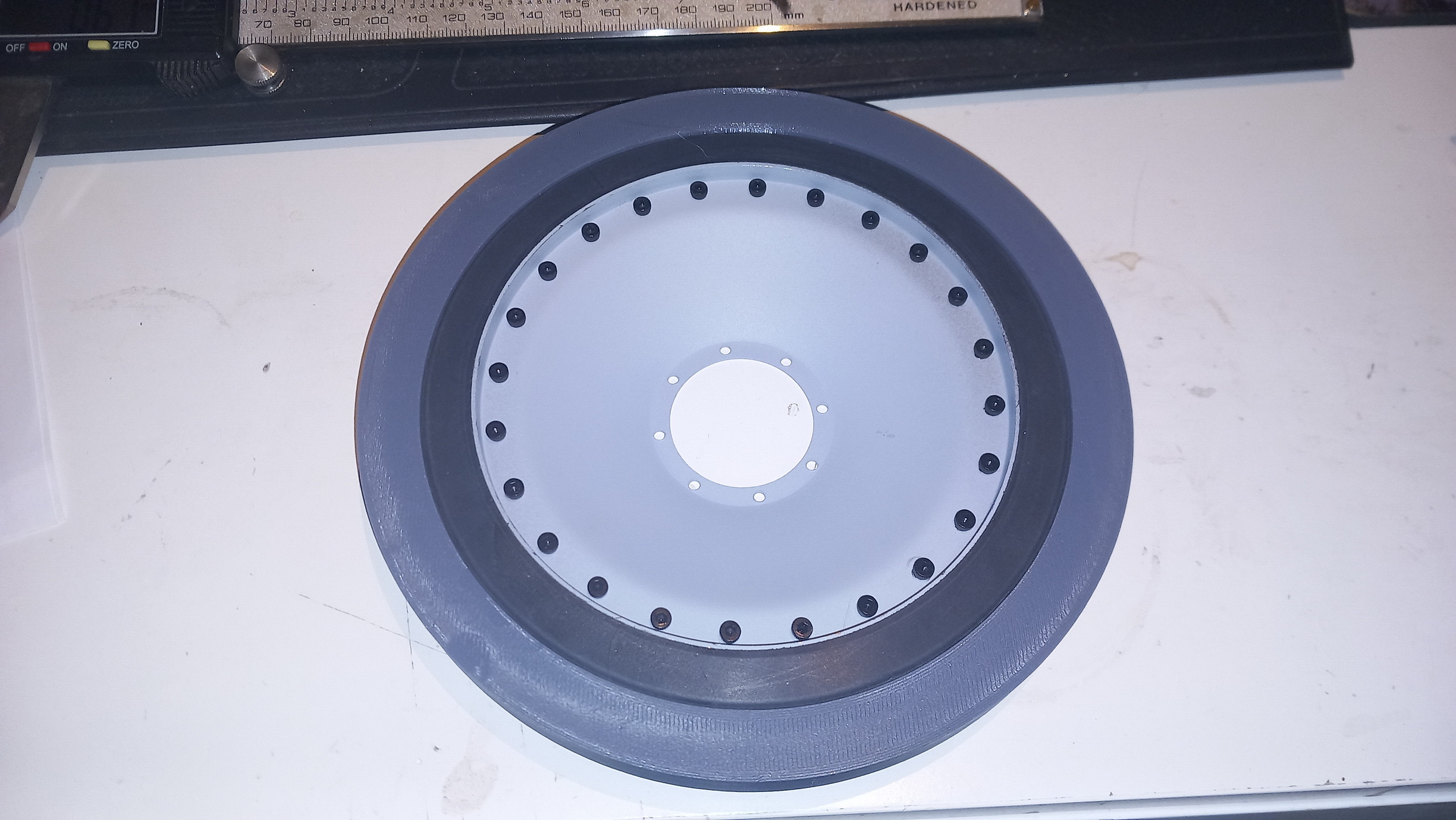

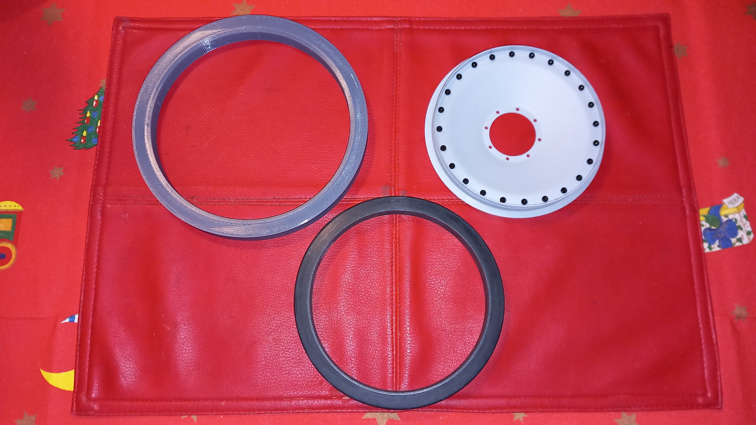

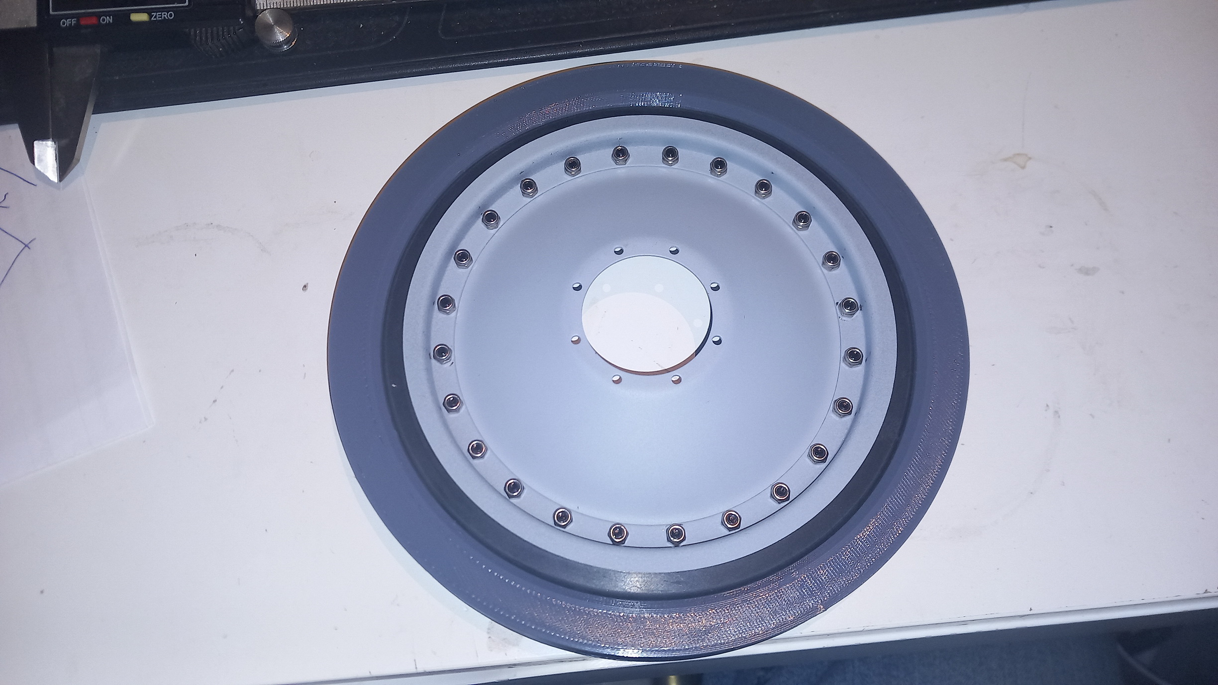

I have now made molds to glue my rubber rings on to the metal rims.
The molds are super snugg. Made them with my 3d printer.
This wants to be a test of whether and how this will work.
I will glue with Loctite 480.
