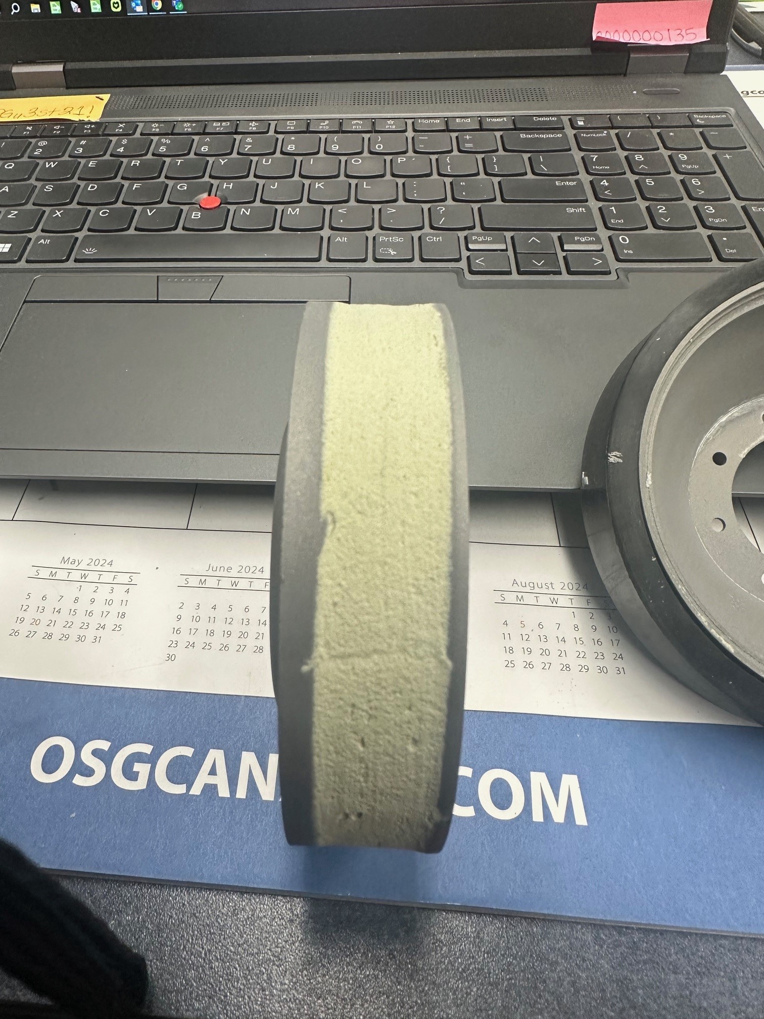

Onto the tire bonding time myself and had pondered a few Q & A's here, all good reading.
I had wondered about the recess and how it would fill/cure with the rubber clamped around it creating a convex look to the tire.
Thought I would try filling the void with a car body filler/bondo type material and then texturing with a burr for a cross hatch finish, or even lightly glass bead.
looking into Loctite the 480 seems to be the "go to" by General Consensus.
all wheels have been shot with Aluminum Oxide to give a better surface condition and kept free n clean.
will see how it goes.

Found a tin of car body filler/Bondo type and set to work trying to fill the void (so to speak) first attempt failed as product went off faster than i could work it.
second times a charm, worked fairly quickly and applied to wheel, smoothed over as best i could... no expert as you can see.
brought to my shop and ran through Aluminum oxide grit blast to rough up surface and decontaminate the wheel.
think it looks ok with a good bonding surface for the tyre to bind to, still not sure of the correct adhesive to use yet, may call the local Loctite rep in for a chat.
also found 1.4MM rubber cut to strips as above post by Dave. agree with his finding on no gap and no forcing the tyre off.
