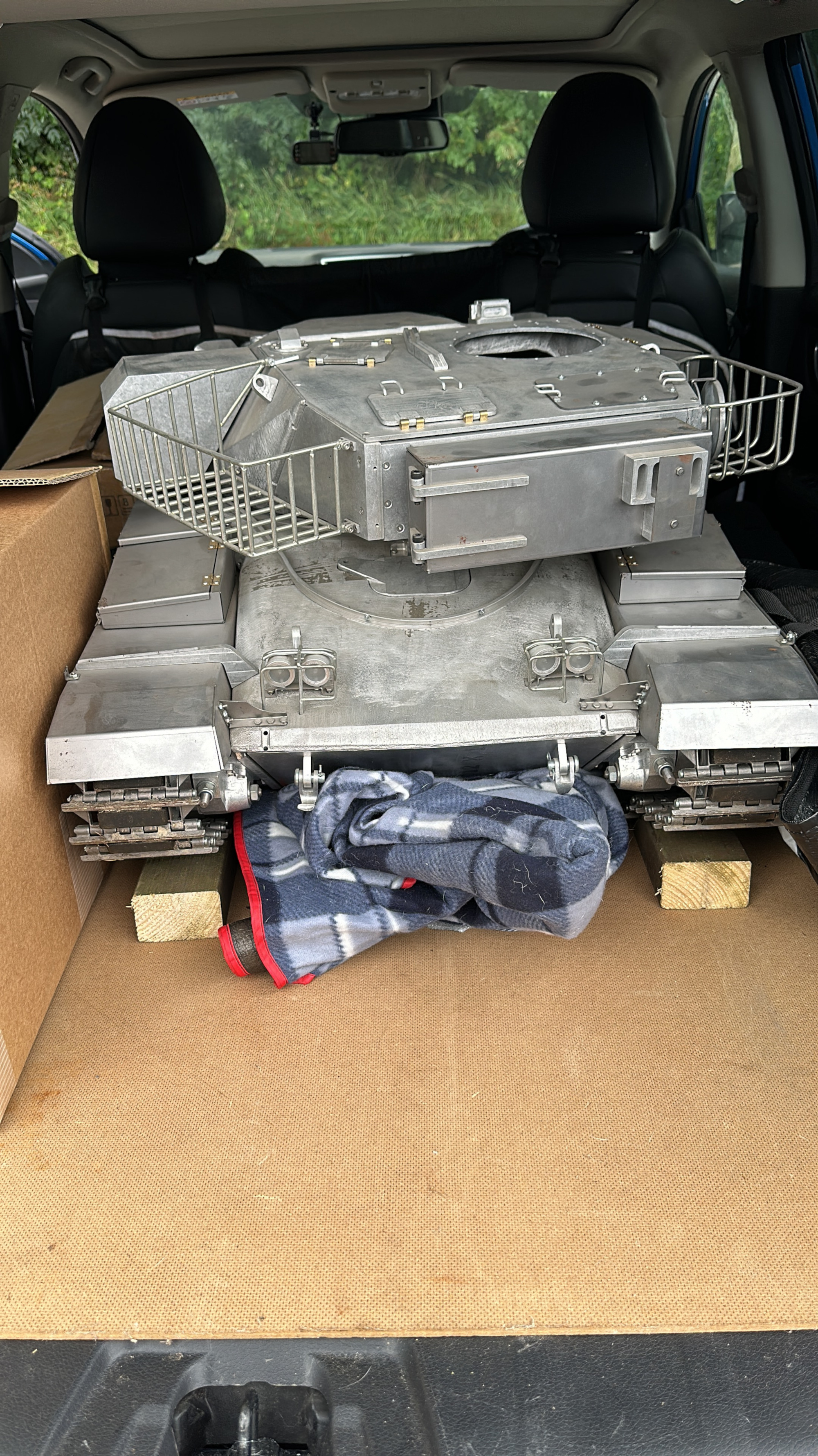

As prevously posted, I am now the proud owner of Chieftain MBT Mk V Prototype XX,
Takes up most of the car, might have to look at a bigger car, that is another bit of negotiation with management

- Posts: 1693
- Been liked: 1842 times
Re: New to Chieftain
Looks like you've got a decent build there Steve
Good to see you got it home safely, looking forward to seeing what you do with it.
Does it have double X stamped inside?
I was wondering what other goodies Armortek gave you with it?

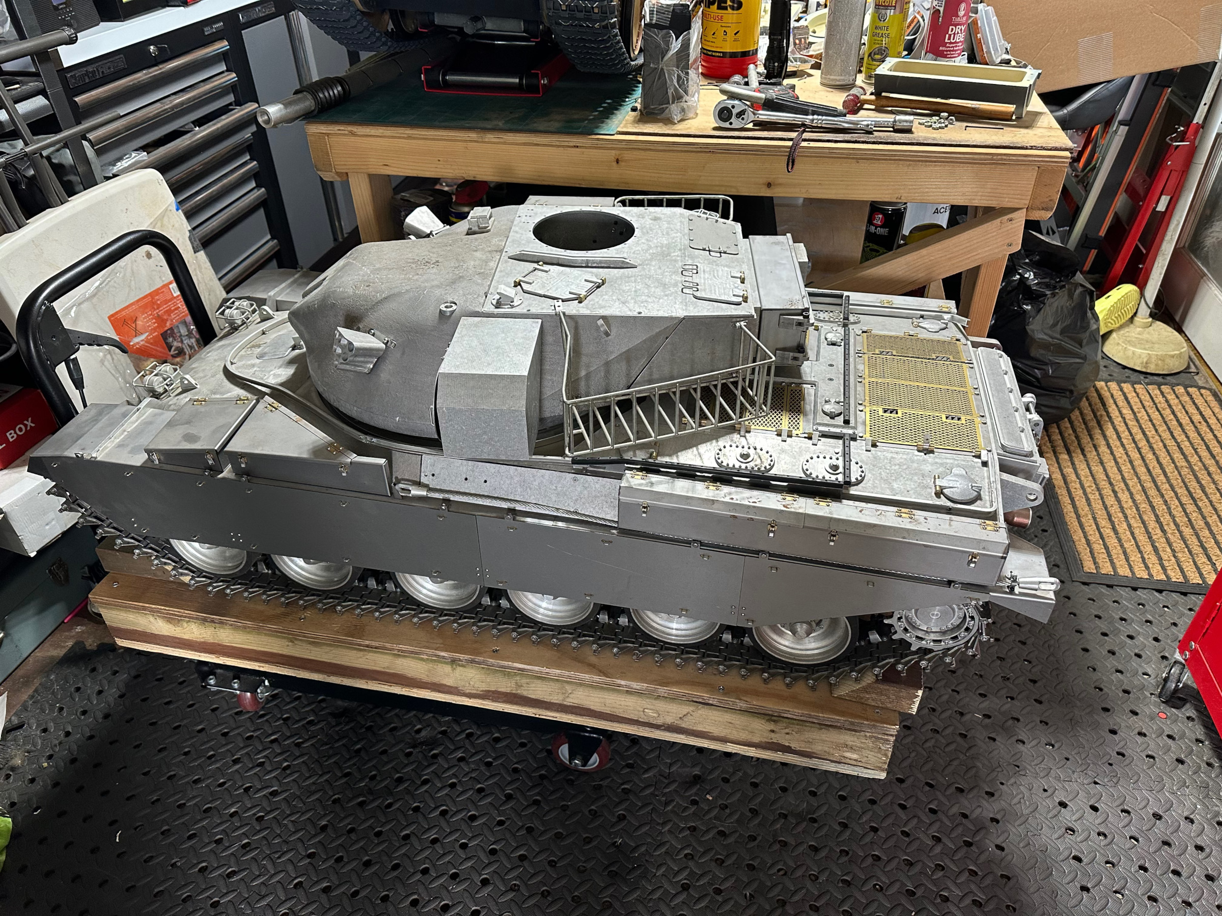

Hi John
I must admit I have my work cut out, there are bits missing and I need to try and work out how to fix an issue with the turret bearing not lining up with the hull, so it is not fixed, there seems to be a 5mm gap between the front of the hull and the rear so none of the retaining holes line up, plus I will be stripping it down so that it can be painted as there is a lot of rust showing itself.
I will post pictures of my progress and I will post a picture of the issue I have got with none of the retaining position holes lining up, hopefully the communty will have ideas how to resolve
Yes the XX is stamped on the inside.
