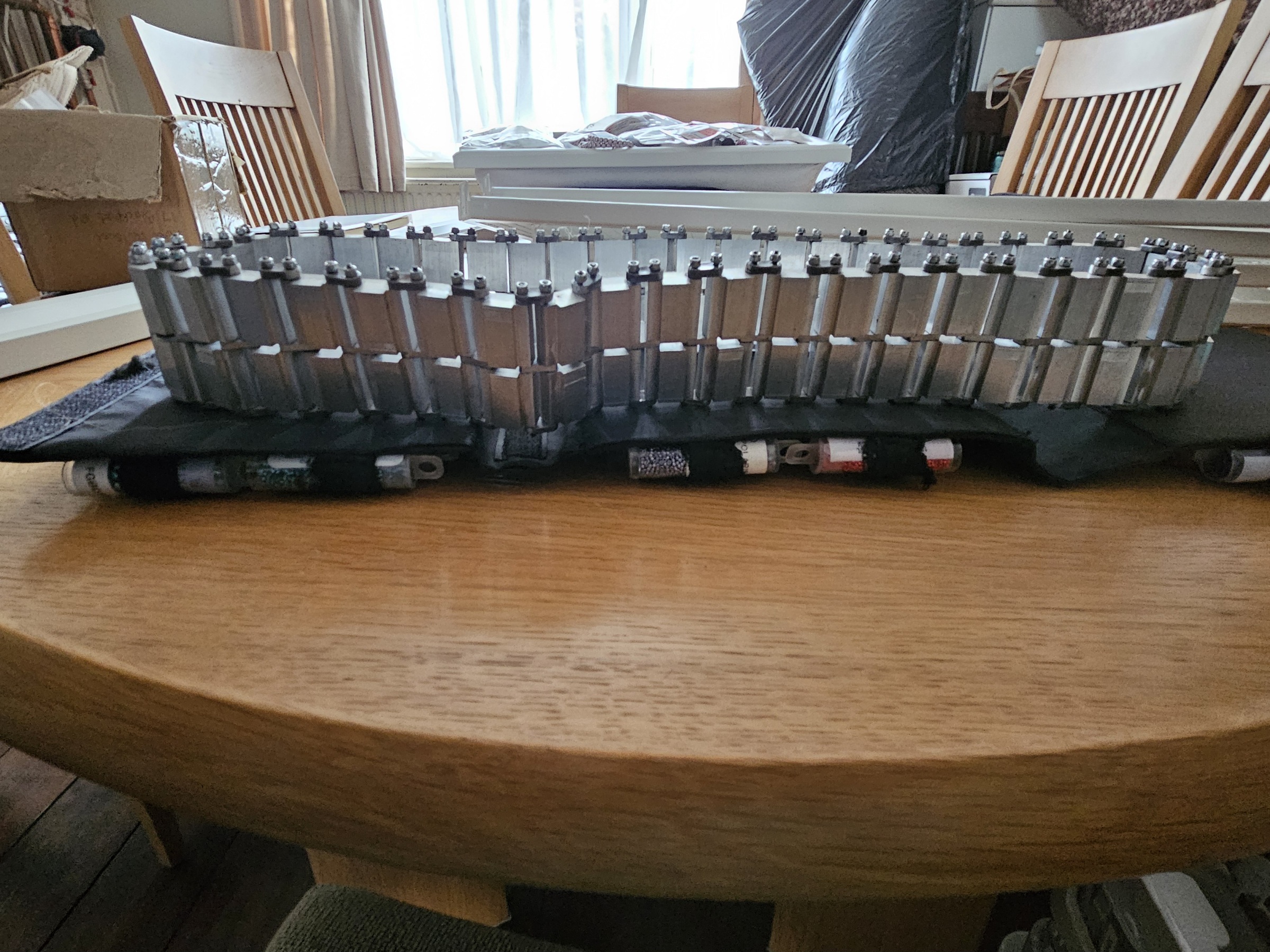

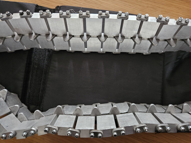

The aluminium tracks avoid every problem you and others have encountered Jerry. In addition I found that the rubber tracks will split very quickly if you don't run the model on grass. They were a good solution for realism and accuracy but I found them not to be practical and they don't lie on the rollers correctly . Will post photos tomorrow as I'm away today.Jerry Carducci wrote: ↑Sat Apr 27, 2024 1:56 amSooooo Peter, tell me more about these aluminium tracks you spoke of! Do you have photos?Peter Silcock wrote: ↑Tue Apr 23, 2024 12:49 pmSorry Jerry typo mistake. I reduced the gear to 34 tooth not 30. Involved a new X member as well. Whether you would get any benefit from just this mod without all the alterations to the tracks etc I don't know.

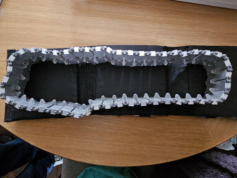

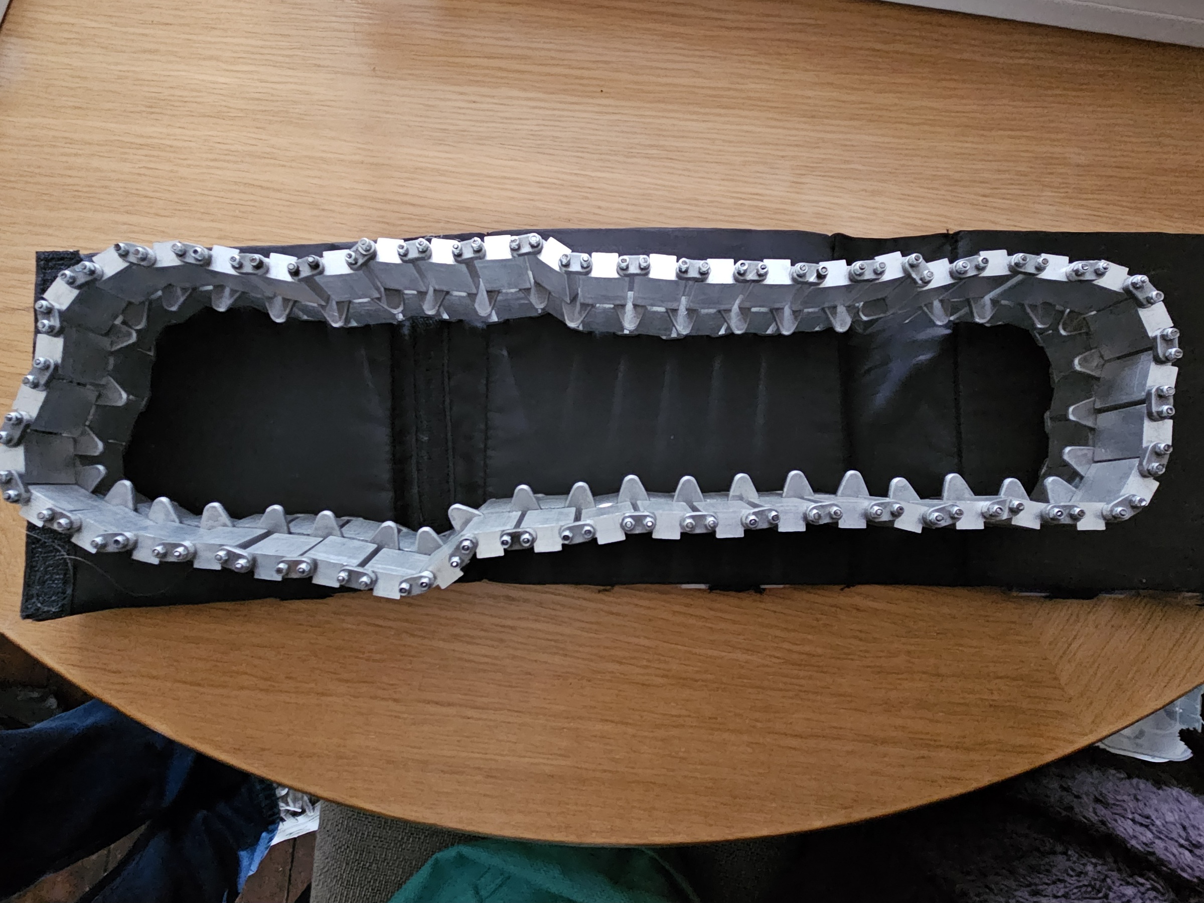

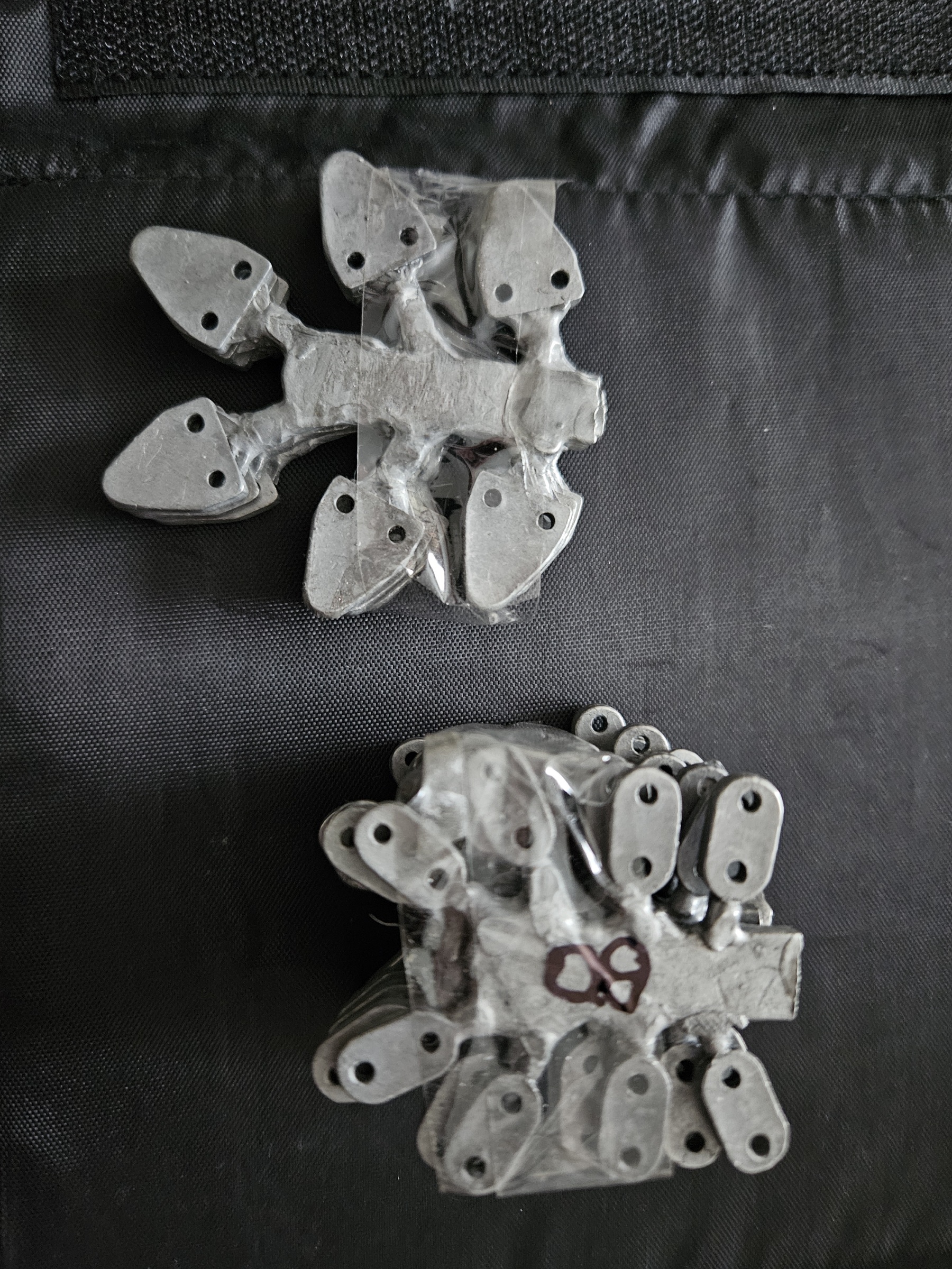

Piccies of tracks before being painted. Only a 20 footer in terms of scale appearance but much better for running.
- Jerry Carducci
- Posts: 803
- Been liked: 1117 times
Re: New to me
Very interesting approach Peter. Strength and durability have a certain beauty all their own...

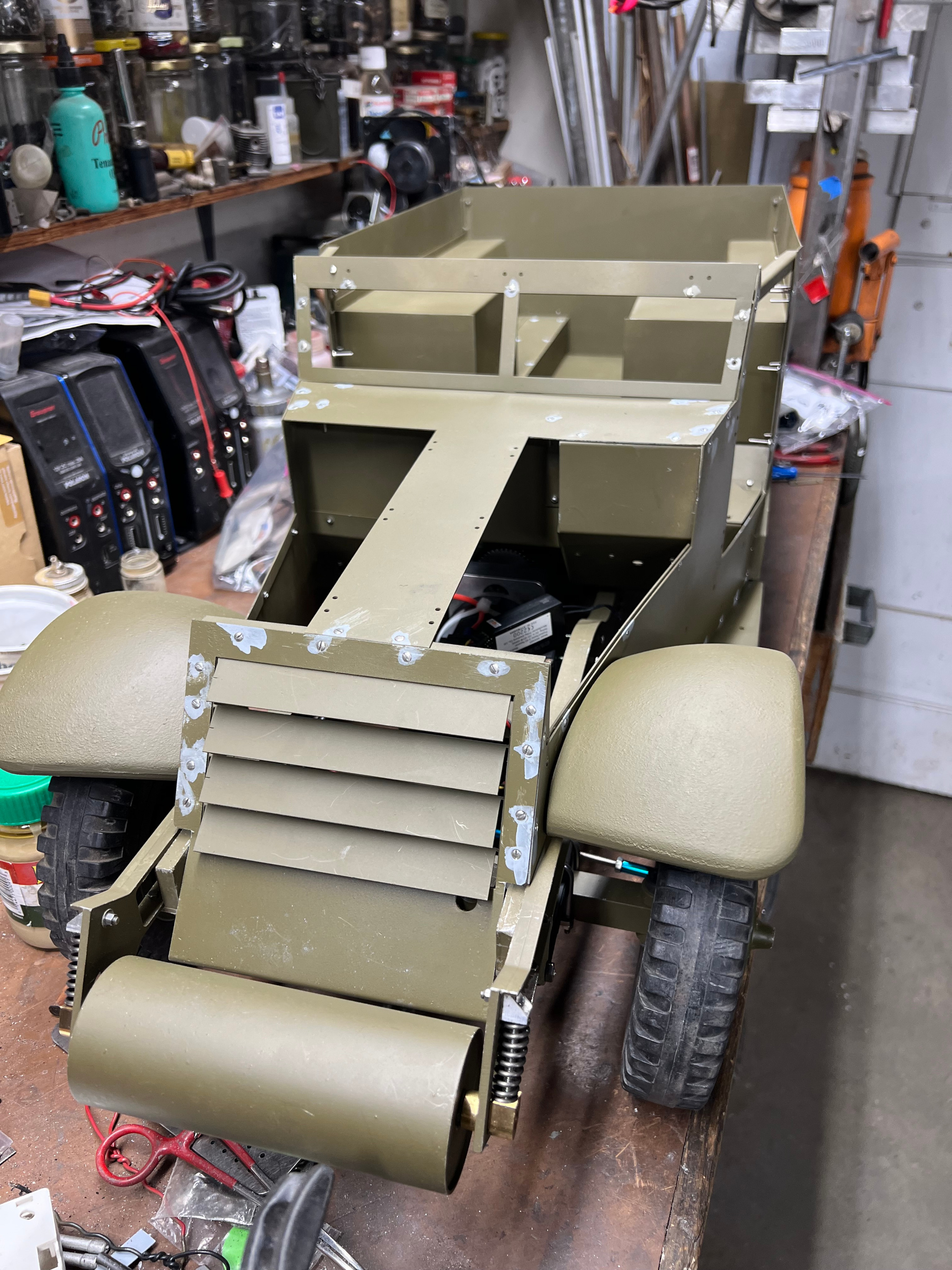

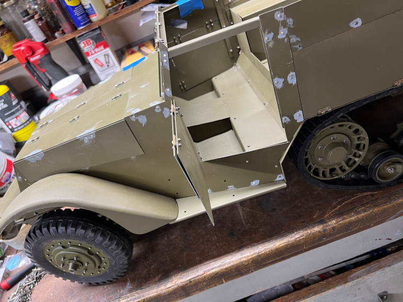

More progress on this model. I'd spent the initial time working on the chassis which for the moment is about as done
as I can get it. Not entirely satisfied with the track's ability to run smoothly despite the grinding and smoothing of
the roller chain master link pins and the overall impact of all the roller chain link pins. But for the moment I've
done what I'm able with what I have.
I had turned my focus to the body. I've been hampered a bit by missing parts which the previous owner has been locating
a few at a time. I'd decided to make a few things such as the front roller and a few angle brackets. At this point I believe I have
all the parts to complete an M2 version of the machine although I'd wanted to build an M3... the body parts just aren't there although
I do have the parts, assembled for the M16 version- I realize there's some commonality between the M3 and M16 parts - I just don't
have the M3 side of things.
Anyway, the M2 body is coming along well, I've slightly increased the depth of the sheet metal countersink holes; this due in part to me
locating 2mm oval head screws- in most cases they look more appropriate than the flat heads...
Although still one of the most difficult tracks to mount or remove I've come up with a mounting procedure that works for me and I usually
come away with uninjured hands (most of the time!)....

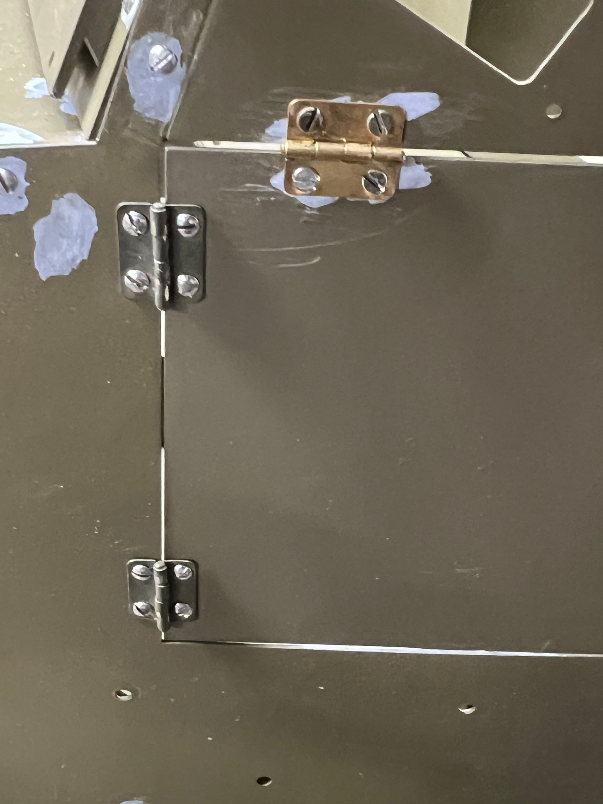

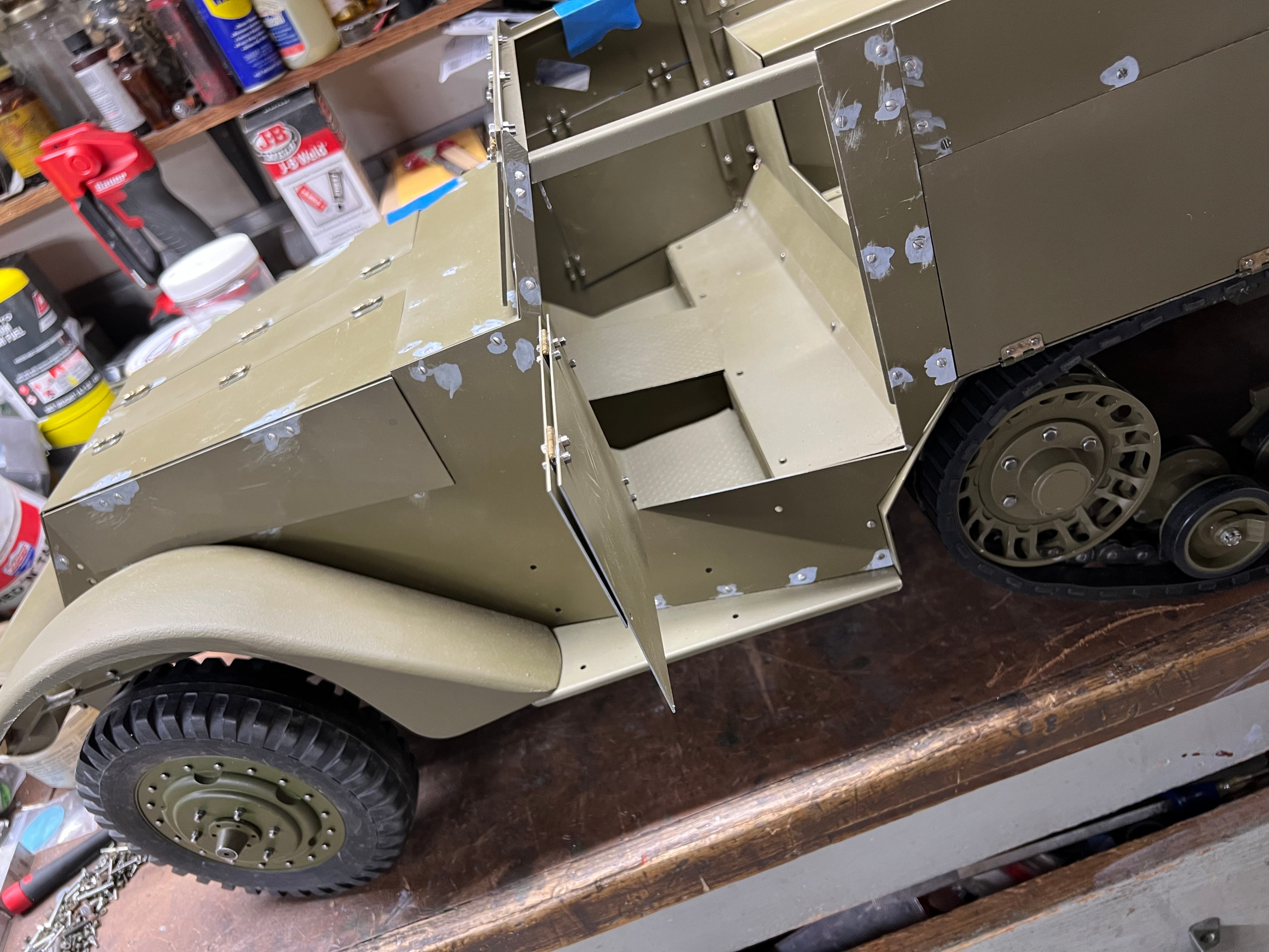

Having seriously underestimated the number of oval head machine screws I needed for this project I must pause construction on the body while a reorder of screws arrives. I like the way the ovals look so it's worth the wait. I've increased the countersink hole depth on most parts to better accept the screw heads although it's a delicate balance between appearance and strength..
I believe I'm one short of the required number of the small brass hinges used for this model and not knowing if/where these are available I plan
to make up something of my own..
For the moment I'll focus on the dash and the latches for the stowage bins followed by the details for the driver and passenger side doors.
Not certain I'll use the original electronics for the model; there's not a lot of hidey space on this thing so space is at a premium and the black boxes are pretty hefty. I'm going to use my same FrSky X20HD system communicating to a x8R receiver that I've updated the firmware on to have it be compatible with the latest ETHOS OS. I hope to use a single speed control and a Benedini micro for sound if the mood strikes; overall the space required for these shouldn't pose a problem.
I'm going to try to come up with driver/passenger seats for the model, not sure if these were ever part of the kit or not; I've not seen
any indication that they were. Not sure if there was ever aftermarket bits for these...
Not sure how well this model will run; my bench tests weren't stellar however I'm hoping being actually on the ground running might have a positive effect on run characteristics.
I think one of the things I will try, eventually is to eliminate the master link in the track roller chain backbone. My logic is this: once the track is assembled the master link is irrelevant. This track will always be a fixed length; unlike tank tracks there will never be any adjustment to track tension by removing or adding a link. In my opinion once the track is assembled the master link is not only irrelevant it becomes a liability which I plan to remove. The master link will always have a wider profile than the others due to its function and way it provides that function- a function that isn't needed for this implementation. In every test I made where the track hung up the master link was the cause; and I've ground down and shaped the master link pins as much as possible however because of the retaining clip there remains even minimally a certain degree of sharpness. sharpness that can and does hang up on the idler in particular.. I plan to eliminate the master link by removing the retainer clip and peining over the pins like regular link pins; basically riveting the link together.. In this way they can be made more smooth to conform to all the other link pins...

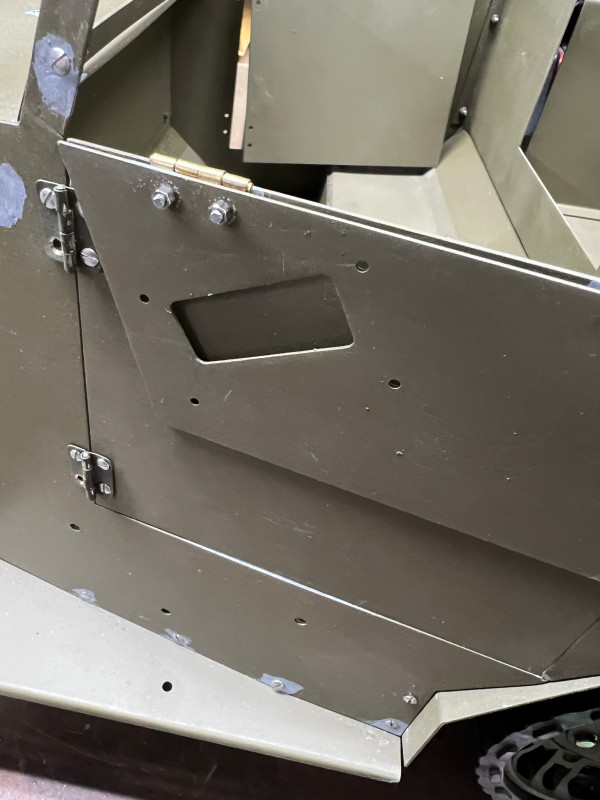

Nice progress there Jerry. I have a spare hinge if you want it. Any other parts you are missing let me know - I have some left over stuff I won't be using. You are probably already aware but halftrack.info is a great forum for getting information and is loaded with good photos of the details of restored and unrestored US halftracks.
One thing while you are still at the building stage. If you move the storage lockers 10mm towards the rear or enlarge them by that amount you can get the next size up battery in there which will give a longer running time.

Thanks Peter, I've been considering what pack I'll use for this, I believe there's a few options especially if I don't use the stock electronicsPeter Silcock wrote: ↑Tue May 28, 2024 8:59 amNice progress there Jerry. I have a spare hinge if you want it. Any other parts you are missing let me know - I have some left over stuff I won't be using. You are probably already aware but halftrack.info is a great forum for getting information and is loaded with good photos of the details of restored and unrestored US halftracks.
which are quite bulky.
Regarding the hinge, again many thanks; I might try some alternatives there as well. On the stowage bins possibly, freeing up the stock hinges for use elsewhere..

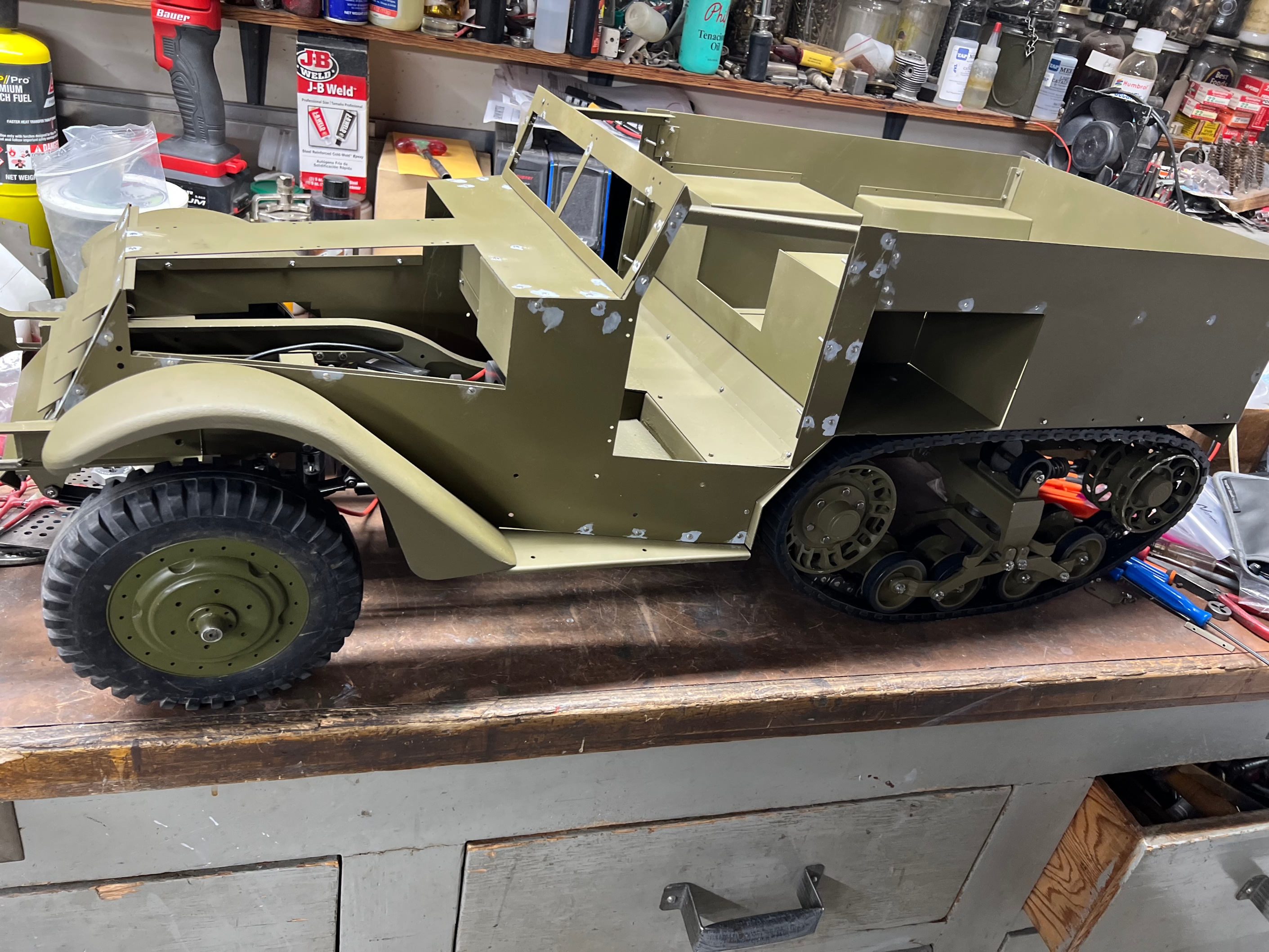

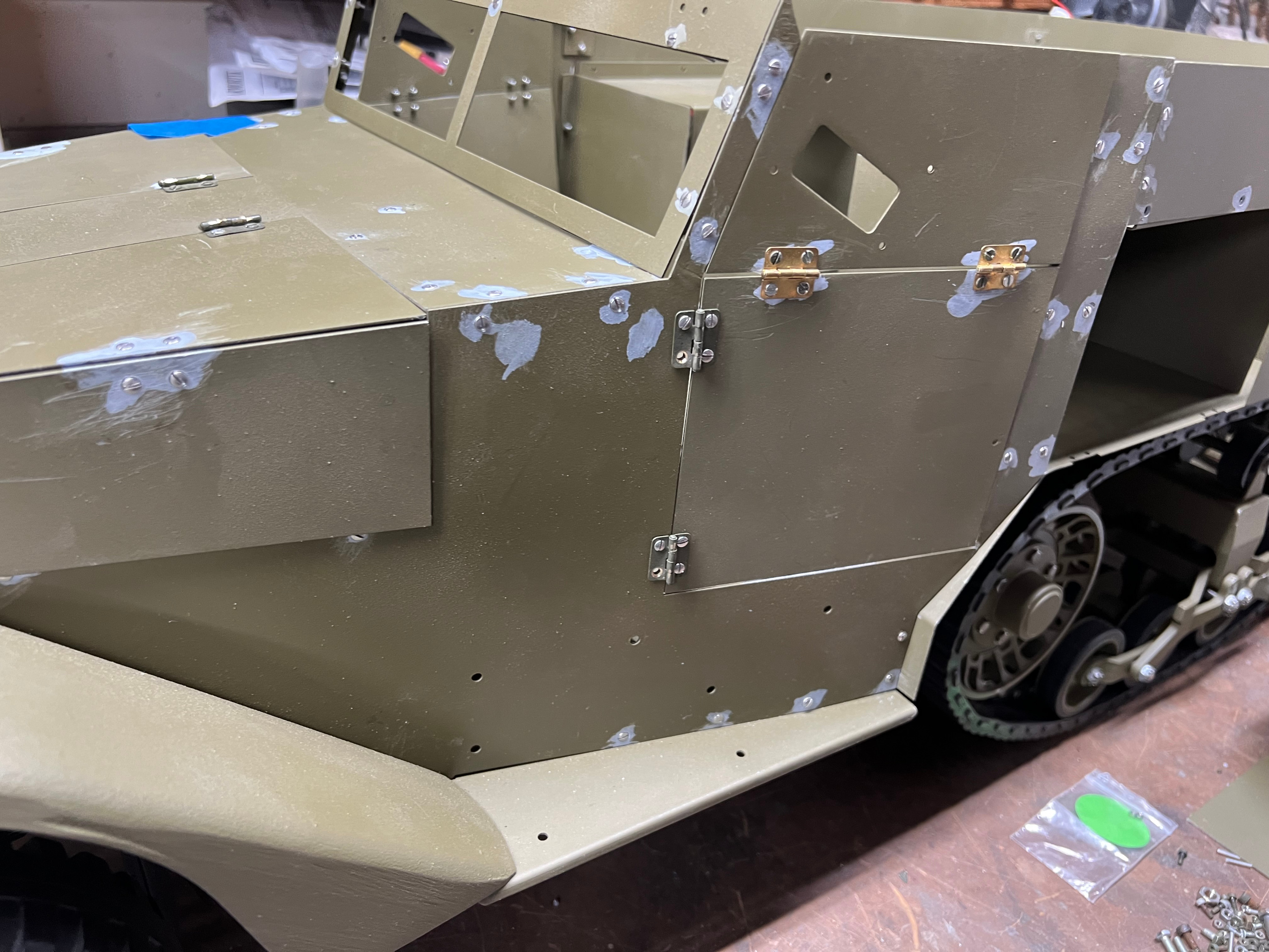

I have basically all the key bits assembled for the M2. Now comes mods and adds, I've already made some modifications however seeing as the model, at least the body is primarily sheet steel one must choose wisely...
First will be the latches for the side stowage lockers. After that will be some sort of rudimentary seat for driver and co-driver... I also
need to add some diamond tread plate on the running boards and rear steps.
Then of course the dash board... potentially a very enjoyable part to do but also frustrating at the same time.
I actually have the hull fastened, partially, to the frame- not the easiest exercise... but it's just temporary anyway.
Onward!
Onward!

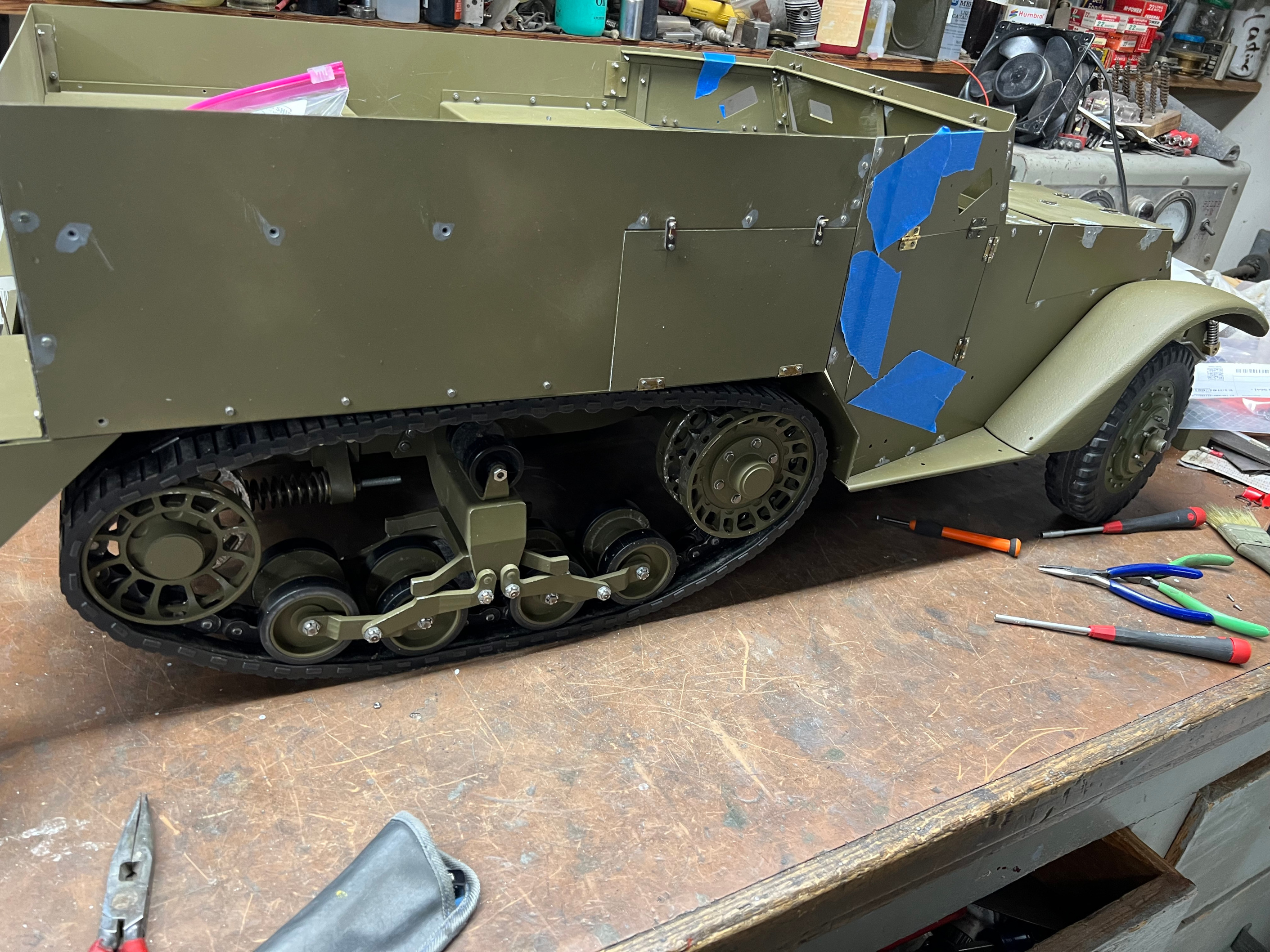

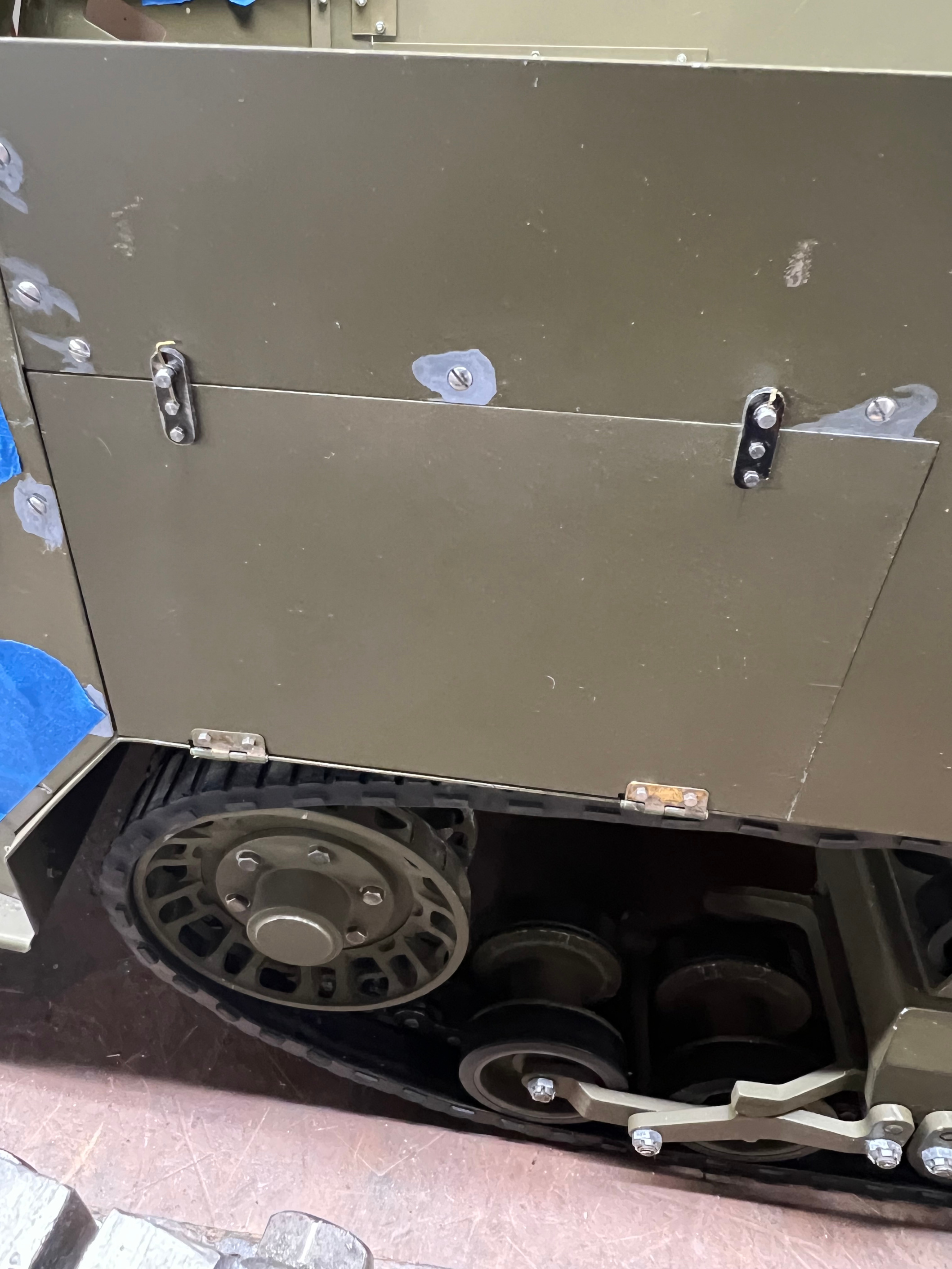

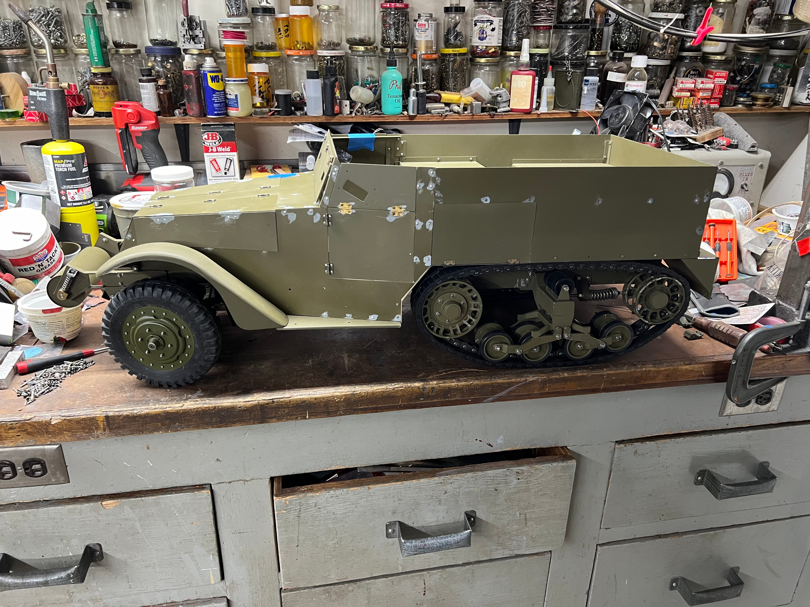

Began making the latches and mounted them for the side stowage lockers. need to finish them over the next days...
I couldn't resist trying out the old girl when a speed control I was waiting for arrived today. It's amusing to me that I am using a
radio system capable of 24 channels of control and I'm using two at the moment: steering and throttle...
It's strictly a test setup; there's no on/off switch(!) just plugging a 30Ah LiPo in this ESC that's rated (so the seller says) at 100A and
up to 26v... As luck would have it it worked first time so I took it for a slow spin around my yard.
Before anyone asks the blue painter's tape everywhere is to keep thing from flopping open while I manhandle the body, as it is I left off tape on one stowage locker and it flopped open within a few moments of running.
Clearly I need to work on the tracks but it wasn't quite as bad as I expected. Not sure of this ESC and I didn't do any radio trickery; simply plugged it all together and let fly. FrSky X20HD transmitter (same system used for my KT), FrSky x8R with updated firmware to be compatible and this no-name brand ESC. Also steering is better in motion as I expected; I will not be breaking records on the local skip pad...
I'll get back to details but at least I know it can work and the tracks stayed together! Go Loctite 408....!

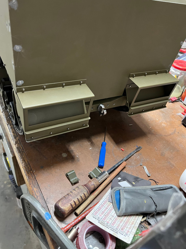

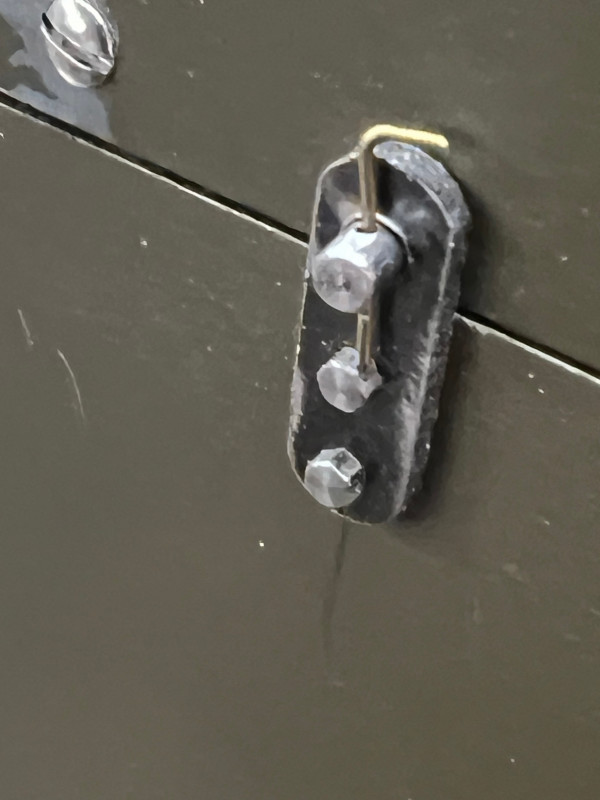

Not quite sure why but I was particularly pleased with myself over making these little things. Remarkable the effort that went into
making the 4 latches that look so simple. From cutting the steel, milling the steel bits to make them all alike, drilling the holes identically,
shaping the steel latch plates into that distinctive cartouche shape, mounting them at the appropriate position and height on the stowage locker
doors. Then machining the corresponding posts, preparing them with a 2mm x. 4 thread then making a fixture to drill that tiny hole at just the right position to clear the latch plates when mounted.
All this while it was 39.5 degrees in my garage shop. The sacrifices we make for our hobbies.
Anyway they're mounted and mostly done; I need to install chains, chain keepers and proper retaining pins on the ends of the chains.
On the whole I'm pleased...and I get to eliminate some painter's tape!

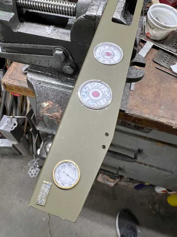

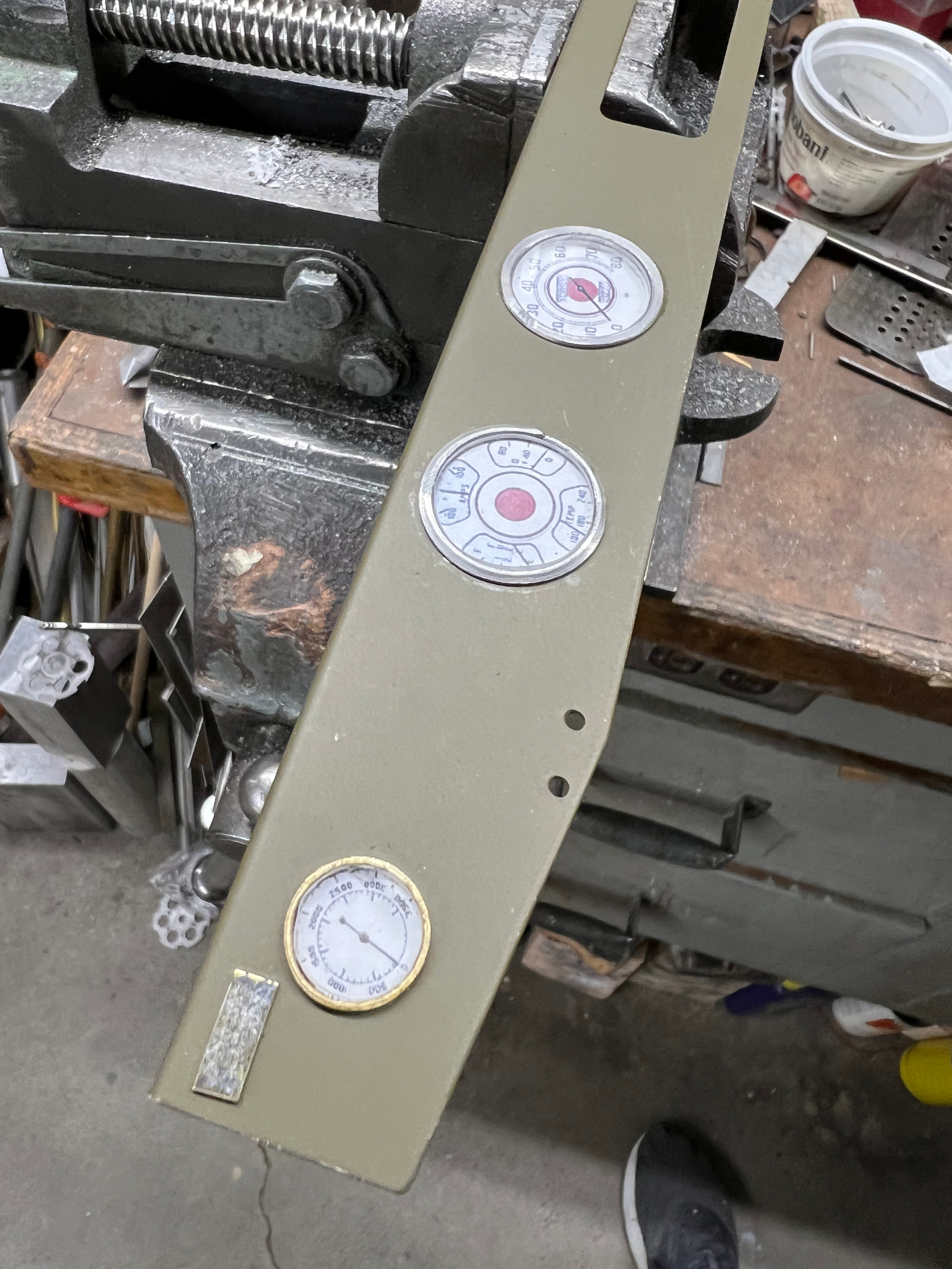

Skipping around as the mood strikes me (and as the temps rise and fall). Looking at the door and windscreen details as well as the dash.

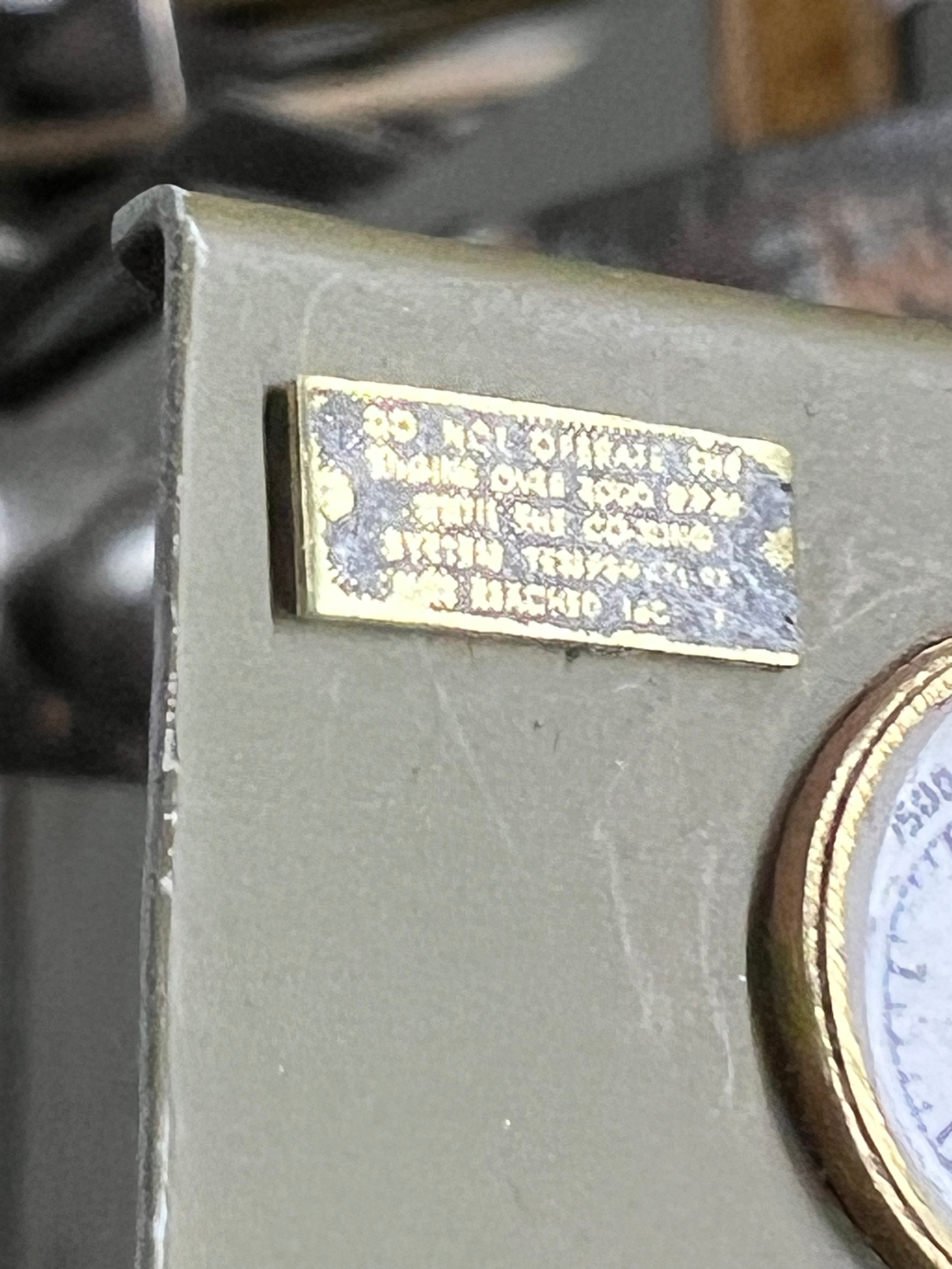

Spent some time capturing images of the various data plates used on the dash. Some are fairly small; all have relatively tiny font..
Made a test print of one of the plates, used brass sheet however it's readily apparent that the sheet is far too thick; something 1/2 or even a 1/3
would be more appropriate. Also tricky to find the optimal image and print setting to make it usable... Will keep at it.
Just barely scratching the surface of what needs doing here.
