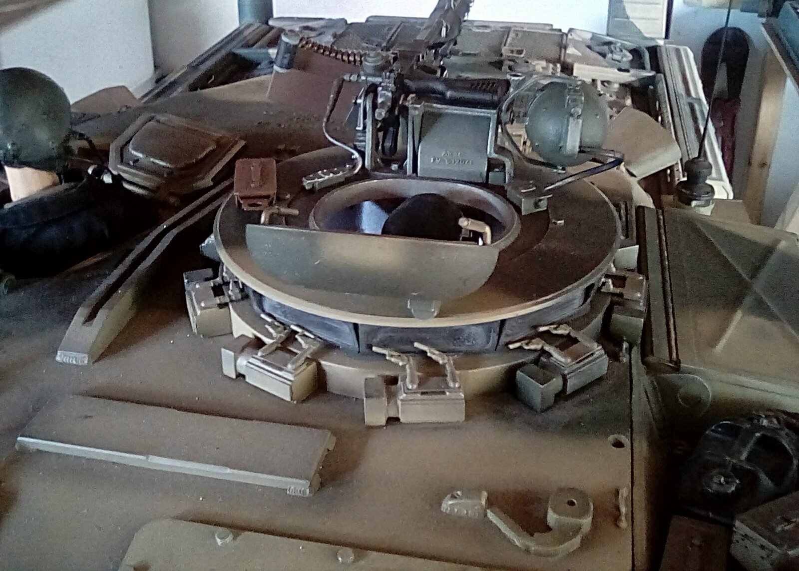

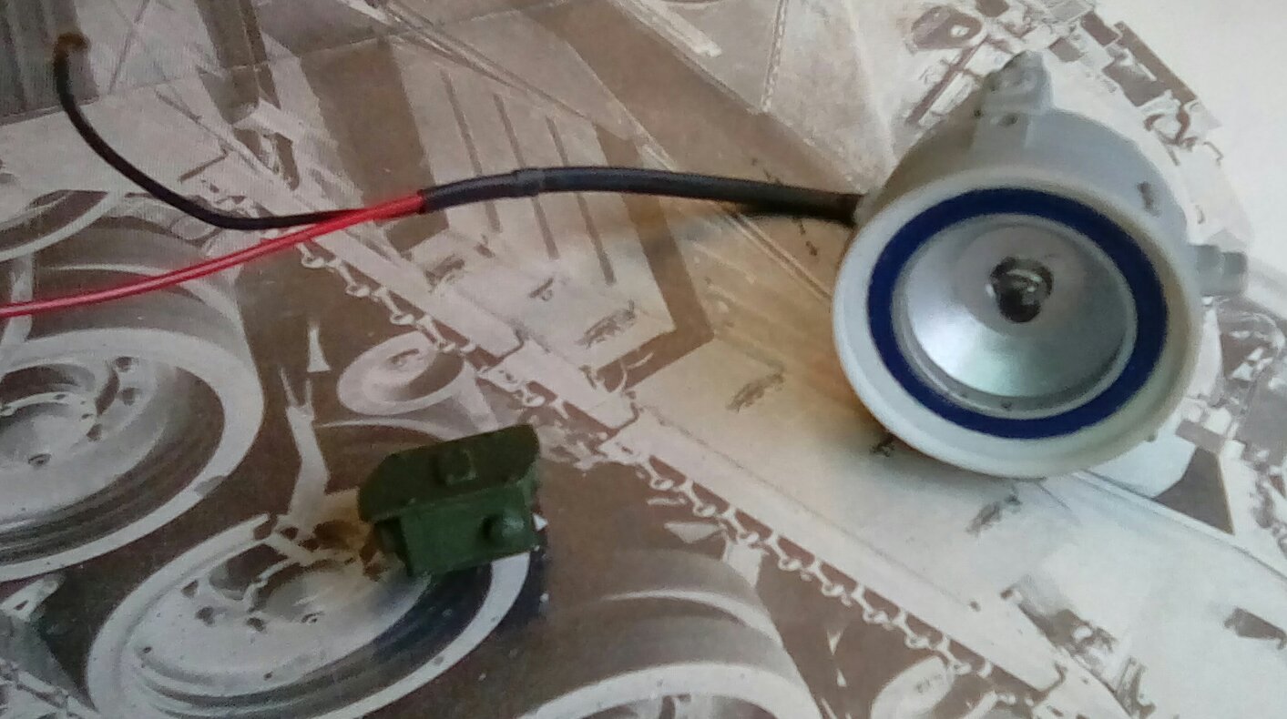

Loads of information there, thanks but I still don't know where the cable enters the search light ?
- In the back of the search light housing ?
- IMG_20200813_140230_kindlephoto-10156383.jpg (36.46 KiB) Viewed 446920 times

Re: Chieftain build by Phil Woollard.
Phil
My guess is the cable goes from the junction box in Stephen's pictures to the elbow shaped connector on the rear of the searchlight, outboard of the hand grip? Kevin
I think you might be right Kevin now we can see the link to the build photos but I can't find an original photo for angles or length of any wire . may be I will do a nice loose loop.
Ah, Phil, your question was ambiguous and Sod's Law dictates that..... well, you know the rest.

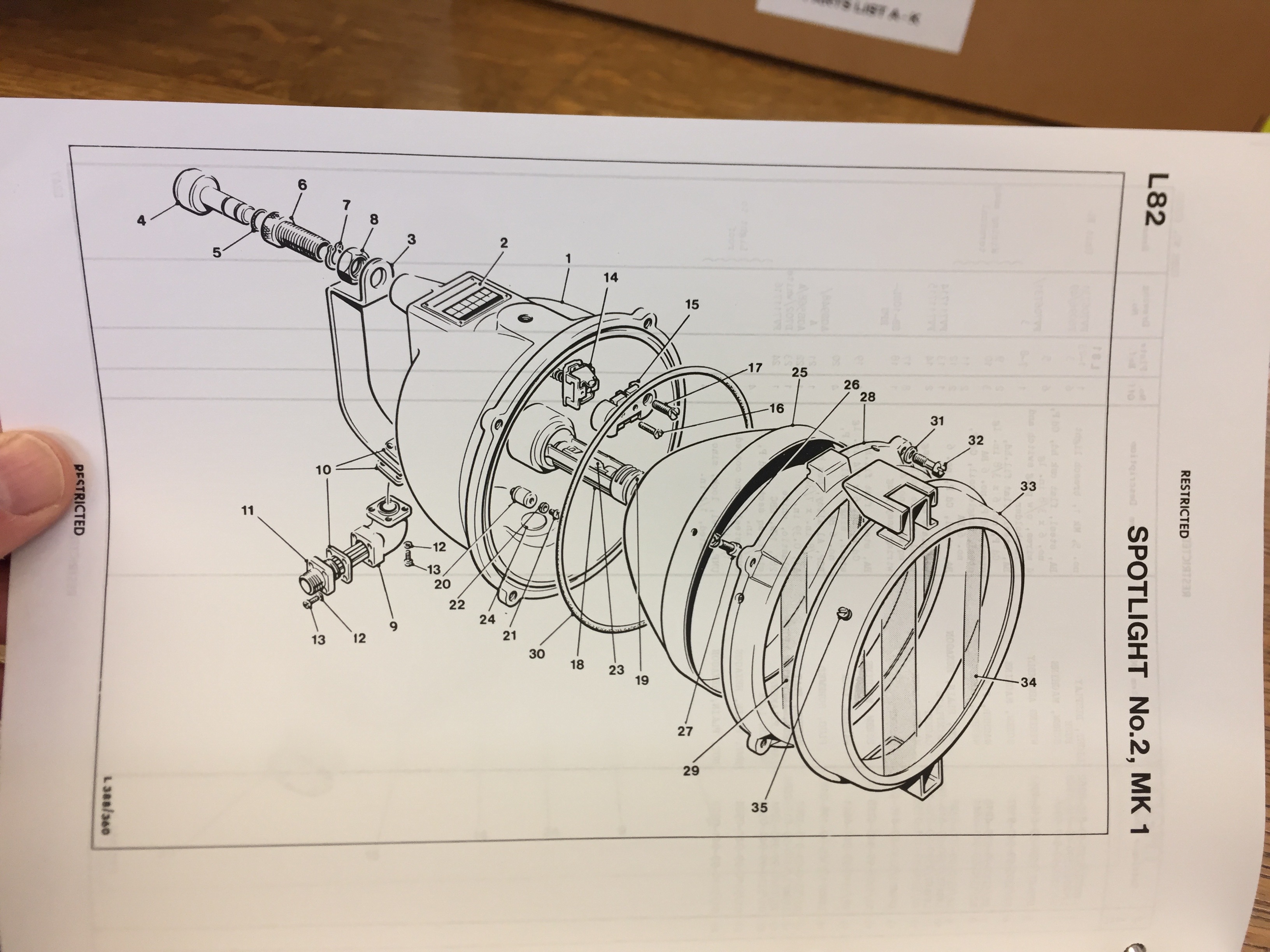

The cable runs from the junction box to the connector on the spotlight, Number 11 on the diagramme below.

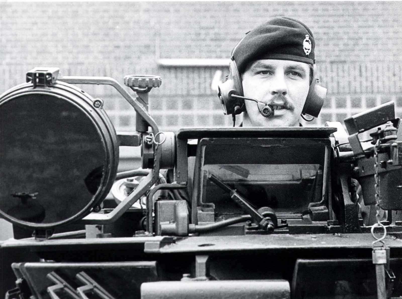

It was an armoured cable with just enough play to allow the spotlight to elevate with the Comd's MG. A "loose loop" would be too long. The cable can just be seen beside CPL Paul Bowes, 4RTR, in this mugshot.
Now that's a nice diagram indeed, look at all those internal parts ! Looks like the connector was at 90° and must have looped out and back in to the connector block....thanks Stephen and thank you Kevin, as this is right in your face it has to be correct.
- Has liked: 1040 times

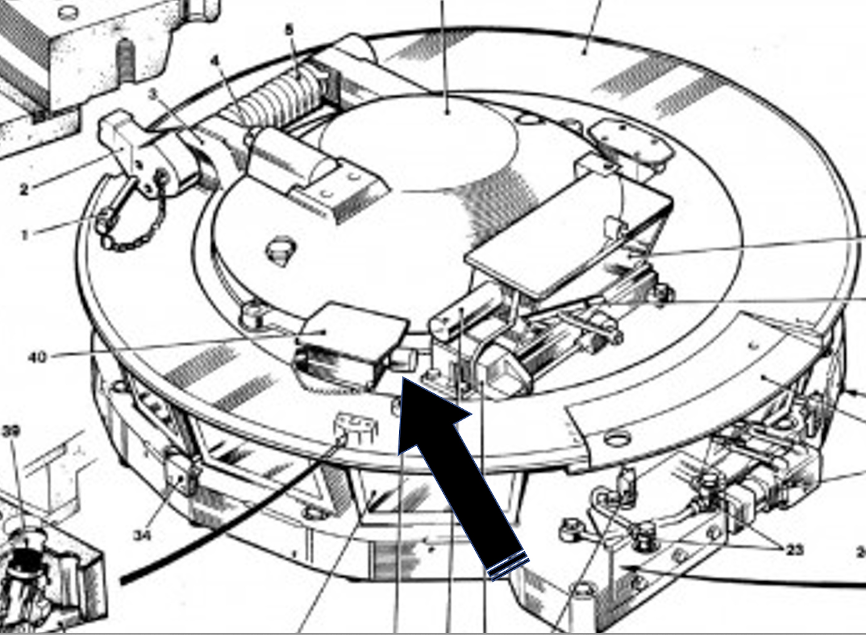

Phil, I'll make it easy for you, the connector on the junction box is the front one indicated by the arrow below.

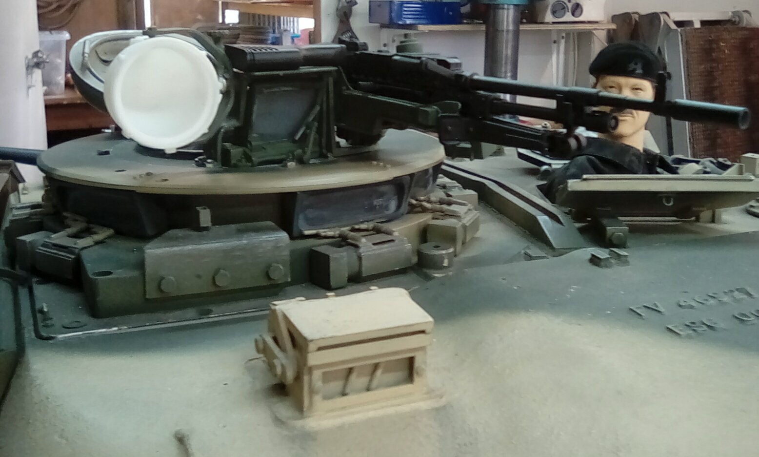

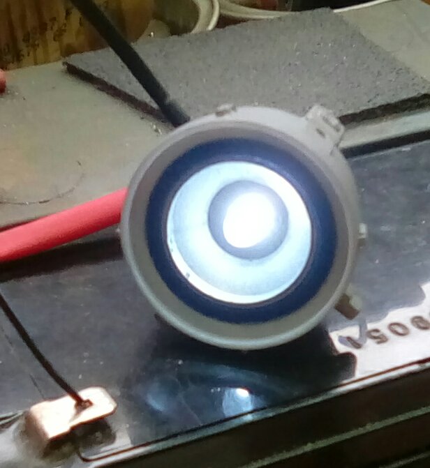

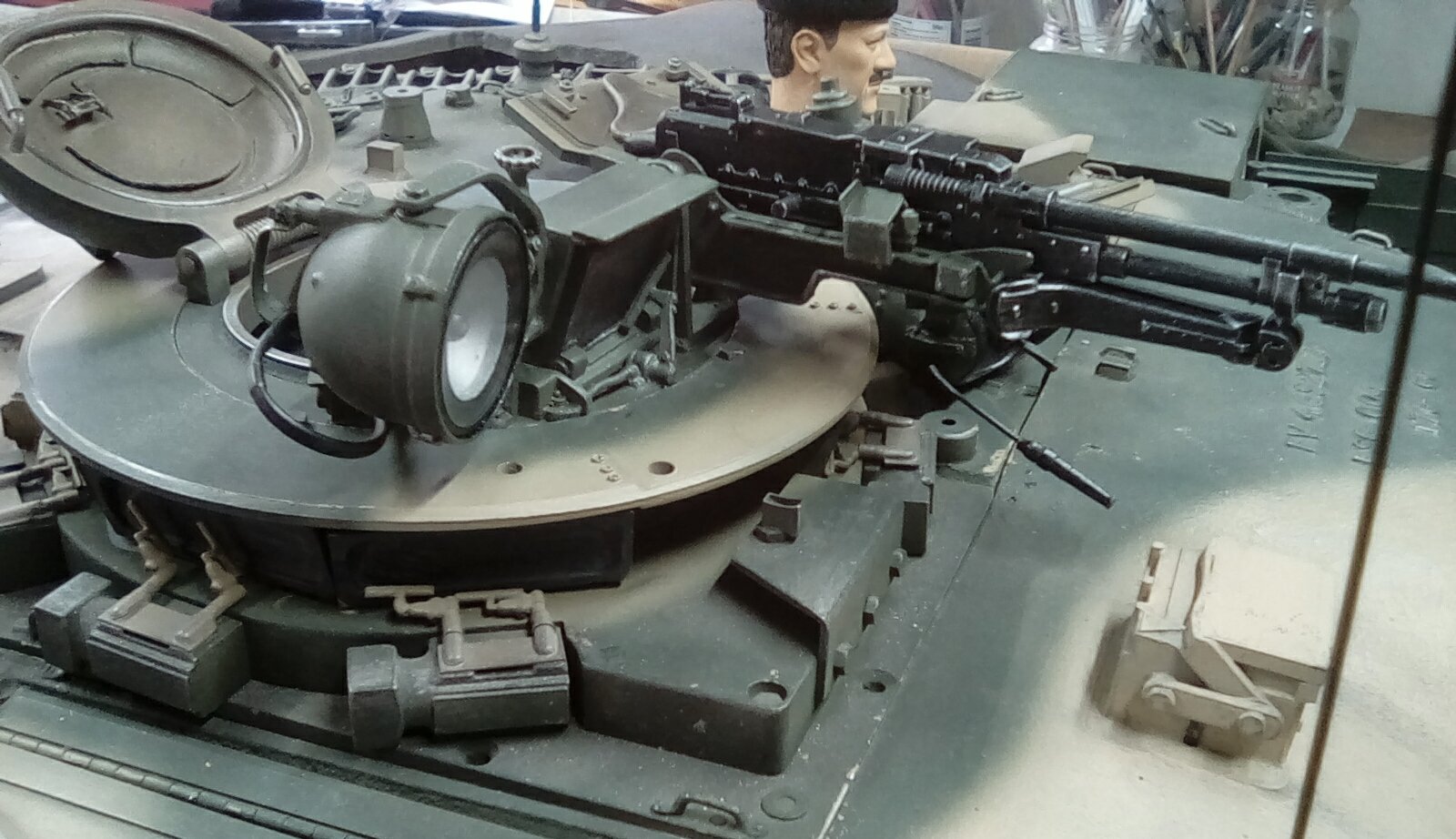

I've sorted the search light.
- I think it looks just fine.
- IMG_20200814_134643_kindlephoto-4080571.jpg (71.71 KiB) Viewed 446812 times

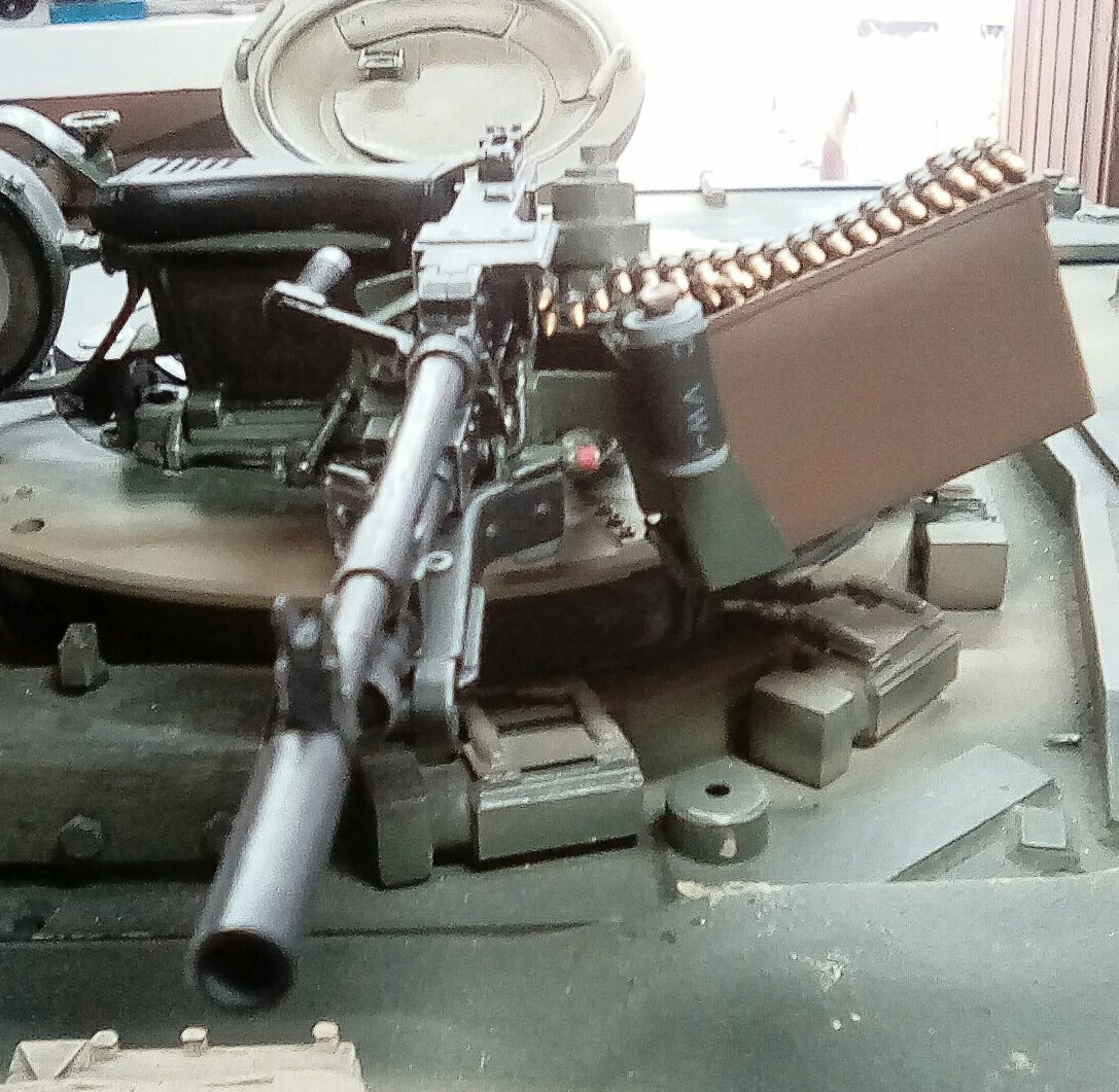

Dave’s stuff looking great Phil, I like it. This model is truly coming to life.
To my untrained eye that butt/stock looks a bit big sat atop the sight, compared to the photo of the 1/1 version. Does it sit there ok?
Kevin
Kevin
Dave is a master for sure, that stock, I think it looks slightly to big and how can I get the gaffa tape to look right but I like the idea of keeping it close to hand because if you had to demount your steed there's no way you could fire that gpmg without it? I've seen infantry fire these when they are absolutely knackered on a tripod and not paying attention the weapon almost flips over on auto!
