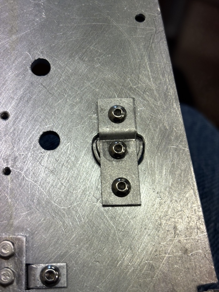

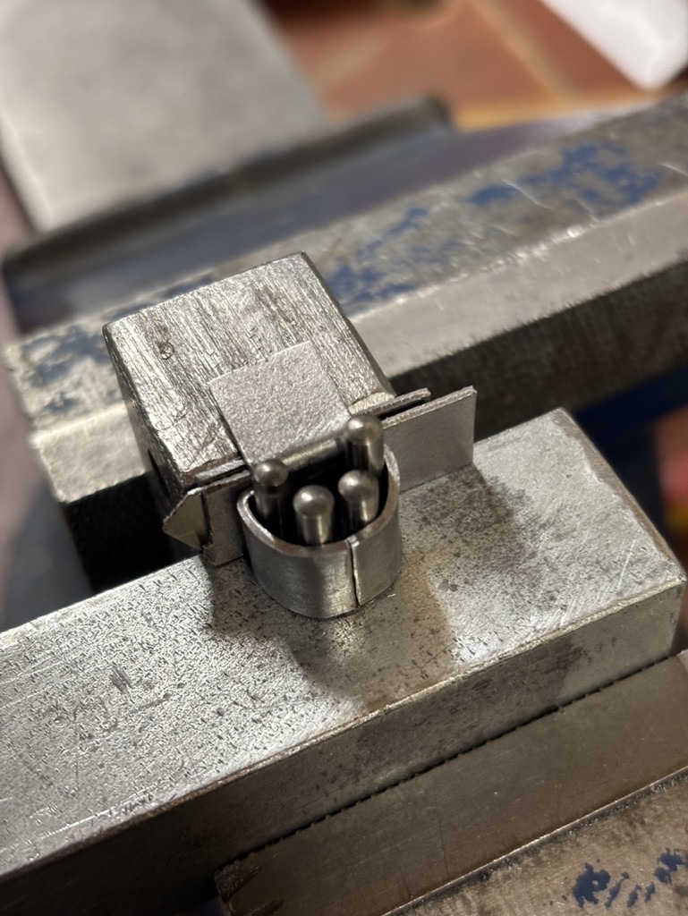

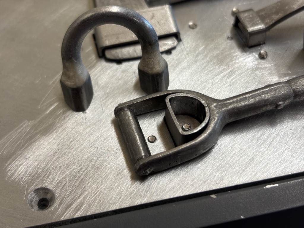

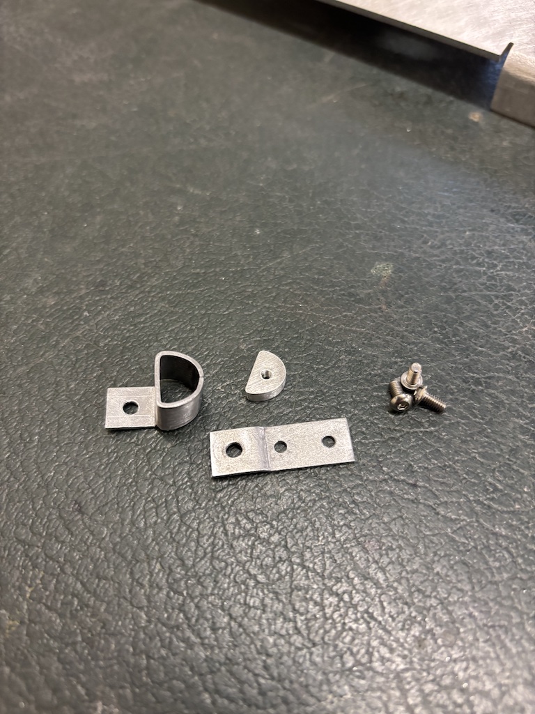

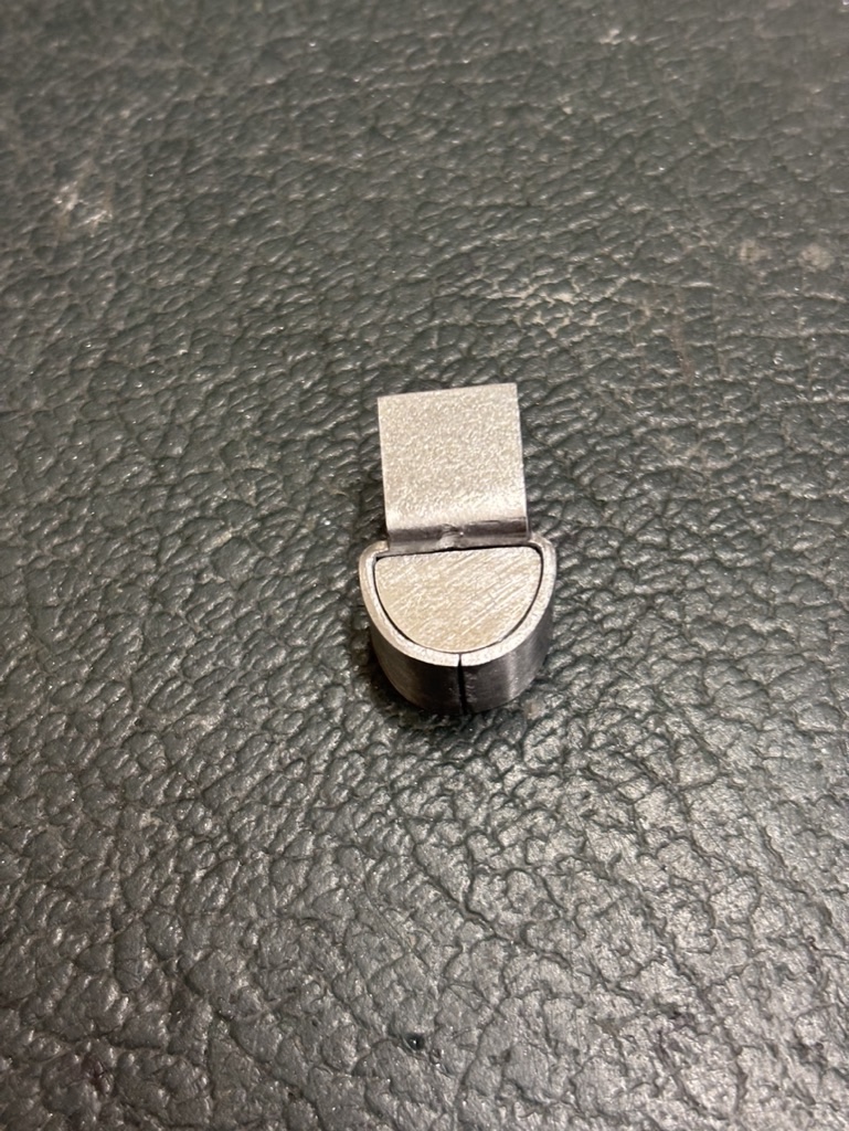

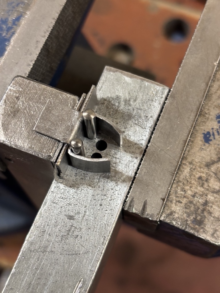

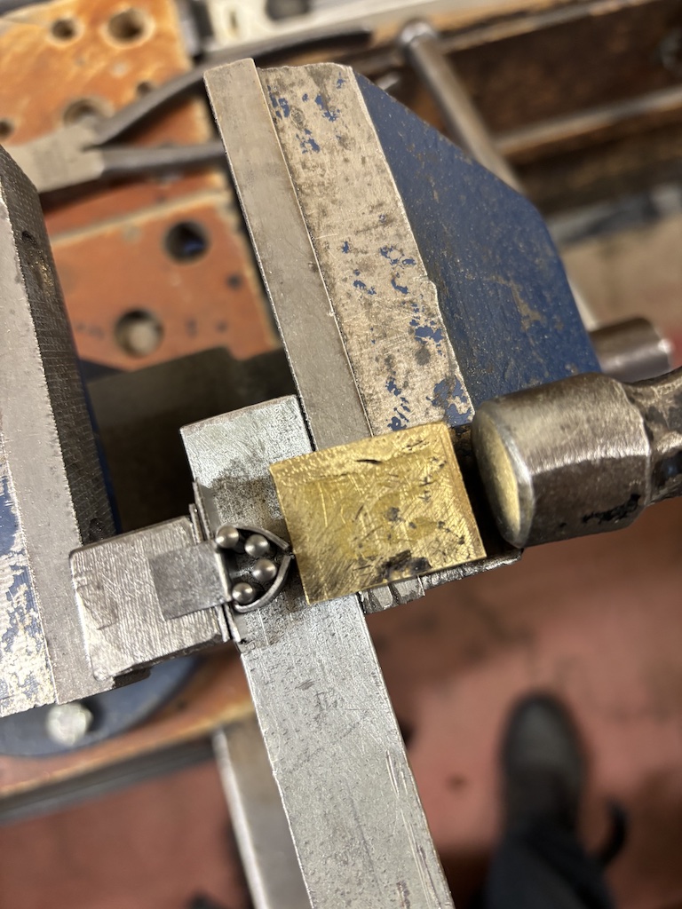

Following on from the previous post the other end of the shovel.
Started off with a T shaped piece then bent the fixing tab.
Then through trial and error worked out the lengths of the sides and cut them to length.
Then bent them at slightly over 90deg. to start the curves.
Made up a little bending jig and gently tweaked the sides in a few places with bending pliers to get the curve on its way.
Then inserted the other pins in the jig and gently tapped the front to form the curve with a piece of brass.
Hopefully it should end up like this.
Then made a 3mm thick plug to go up the inside.

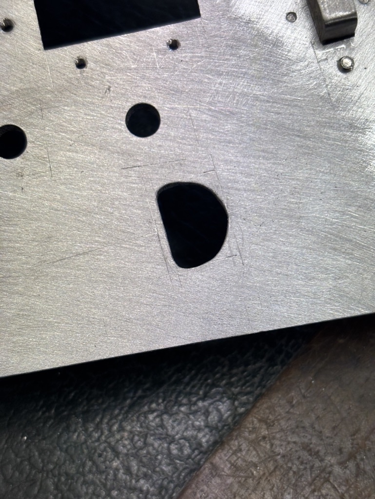

Drilled and filed the hole in the deck.
Made a little stepped plate to attach to the plug and the underside of the deck.
Fixed like so.
Fixed like so.
And topside.
And topside.

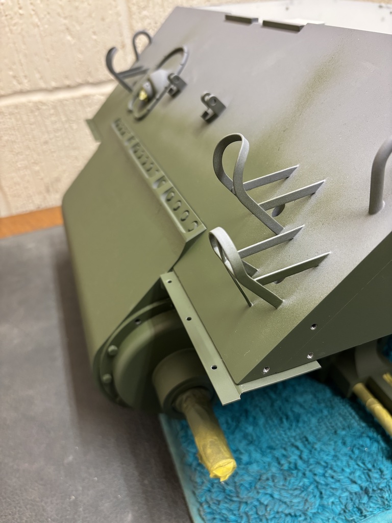

Still got the tying down handles to do but really pleased how that little area worked out.

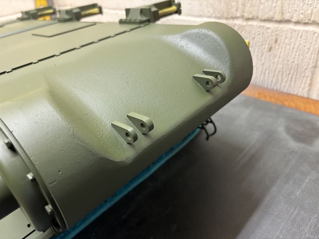

So the next bit to do. I can see some work required on the fuel cap protection pieces, shall put that on the list. I will do the pick axe handle next. May I ask if anybody has a photo of the long crow bar they could help out. I have got plenty of photos of the box type sections that it goes in but I haven't got a clue what the actual crowbar looks like.Thanks in advance.

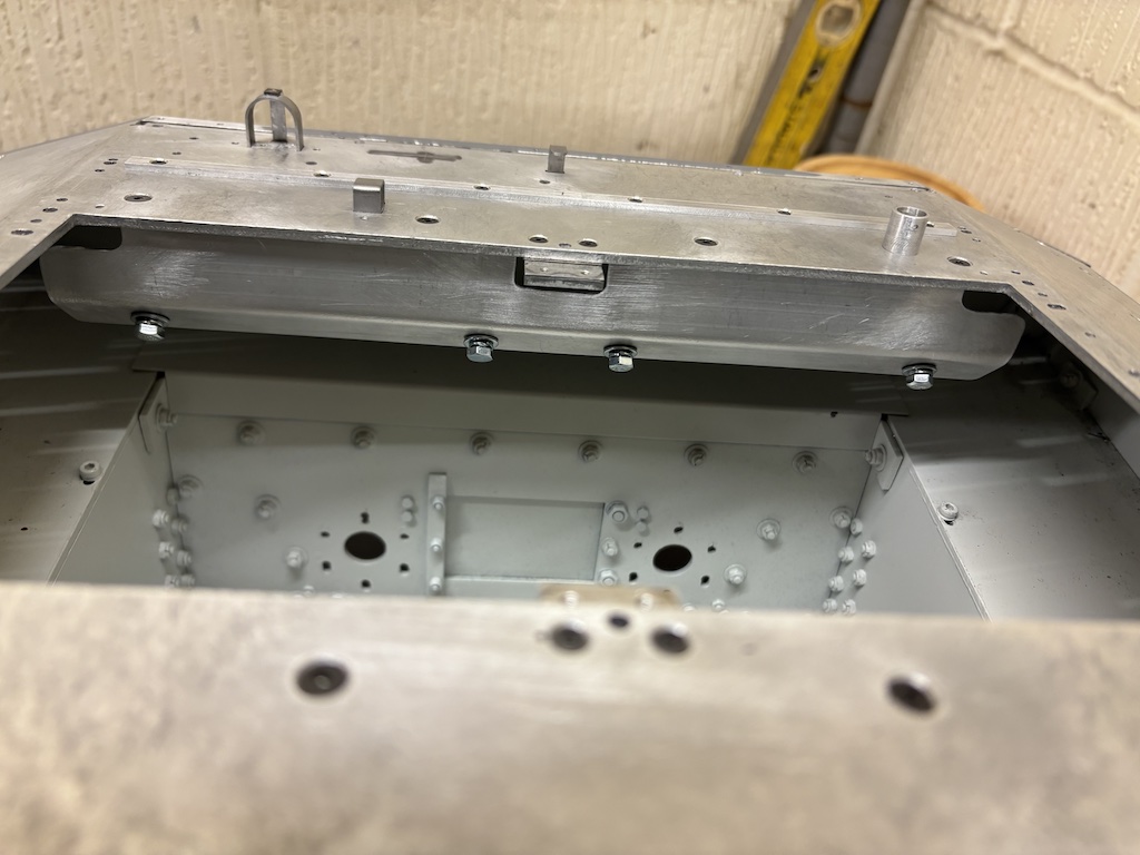

After adding all the bits, the speaker box mounting brackets needed a bit of alteration to miss everything.
Like so.
Like so.
That's those done.
That's those done.

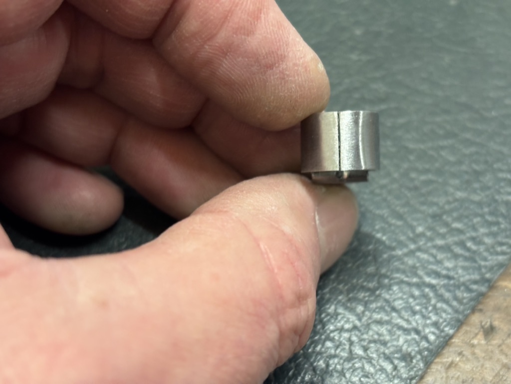

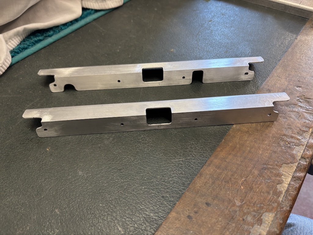

Onto something much simpler. I didn't want to see that hex fixing on the return rollers, so found a way to hide it.
Nipped down the local diy store and got a pack of these things for hiding screw heads in cabinets. They are really designed for cross head screws but they plug into the hex head nicely.
Quick coat of paint. A little blob of loctite on final assembly will be required. Ok they may not be perfect but at least it hides the hex head.

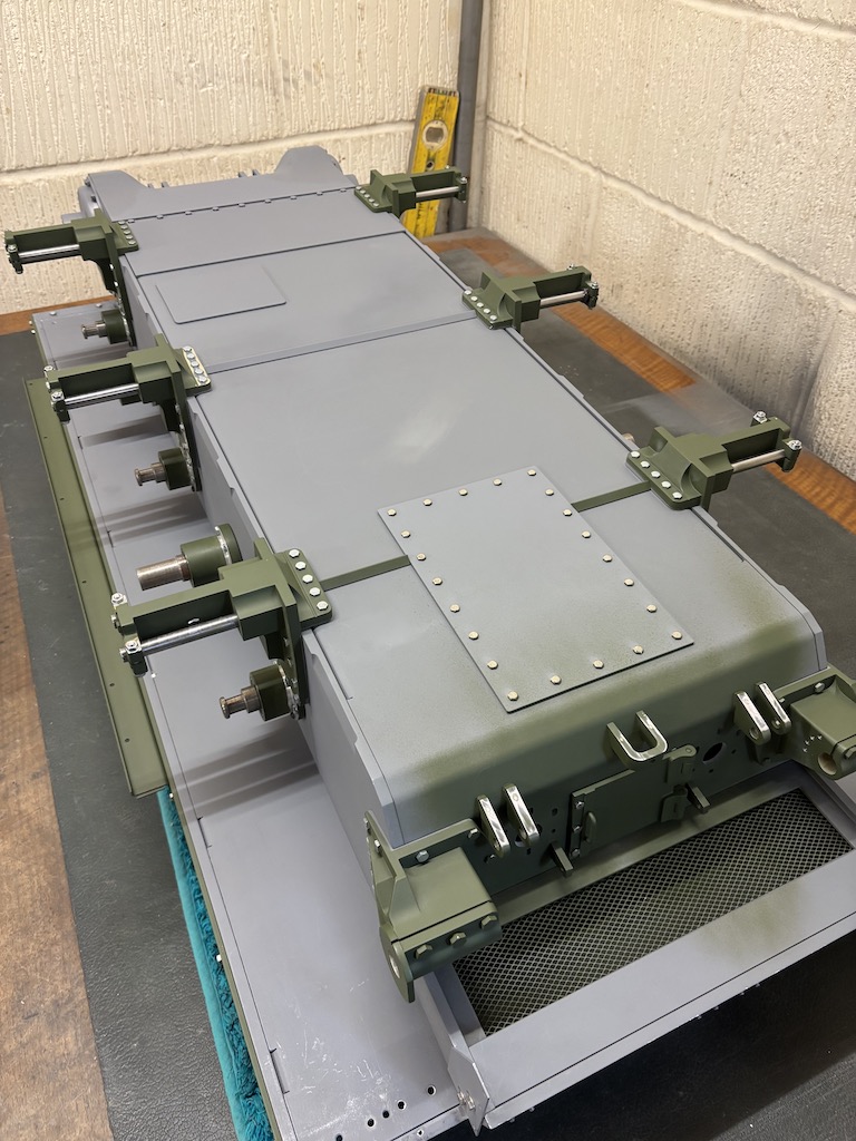

The reason I am going through the running gear is because I have started the final prep on the underside. I am hoping to get that into paint this week then install the running gear etc. Let us hope this week goes to plan.

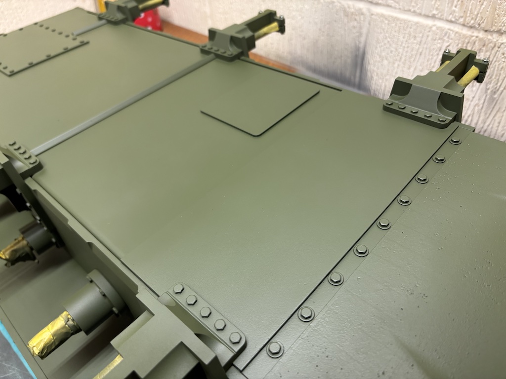

At last the weather is good enough for painting.
It is green, what more can I say.
I will leave it to harden for a few days then start installing the running gear.

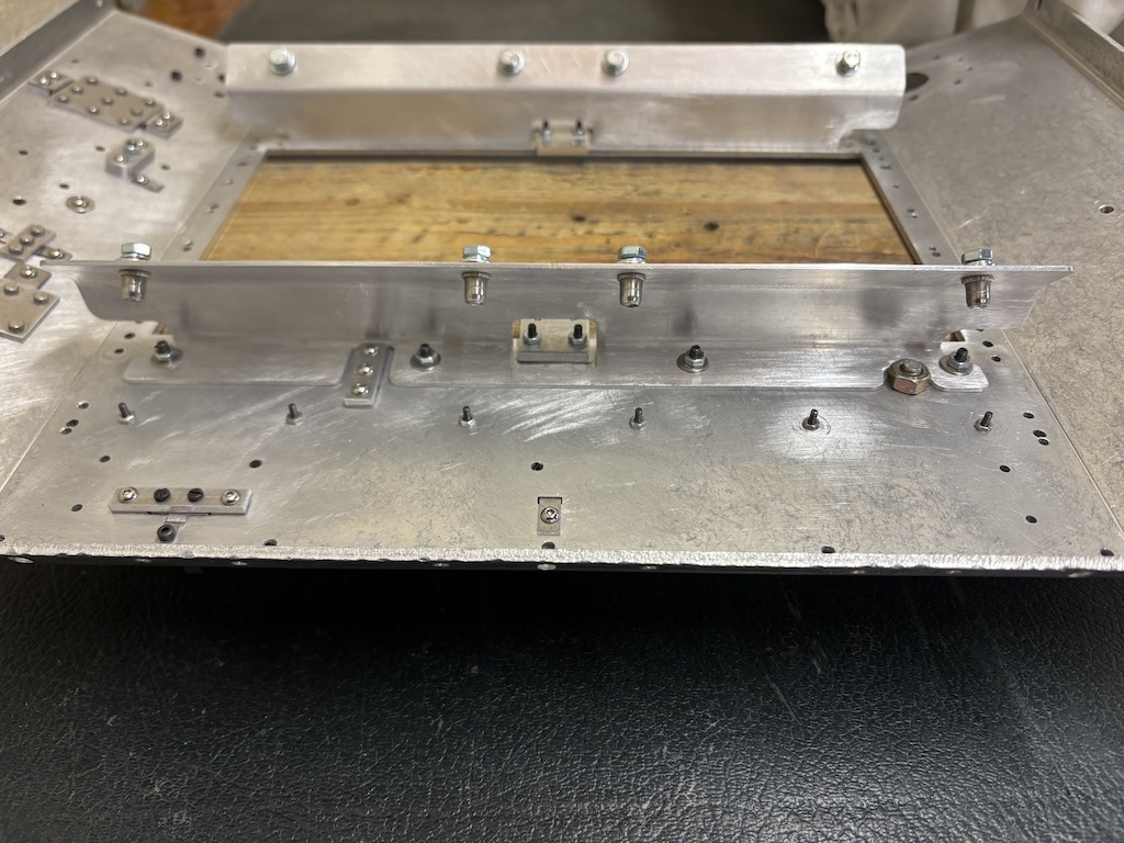

A little bit of progress.

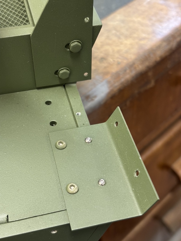

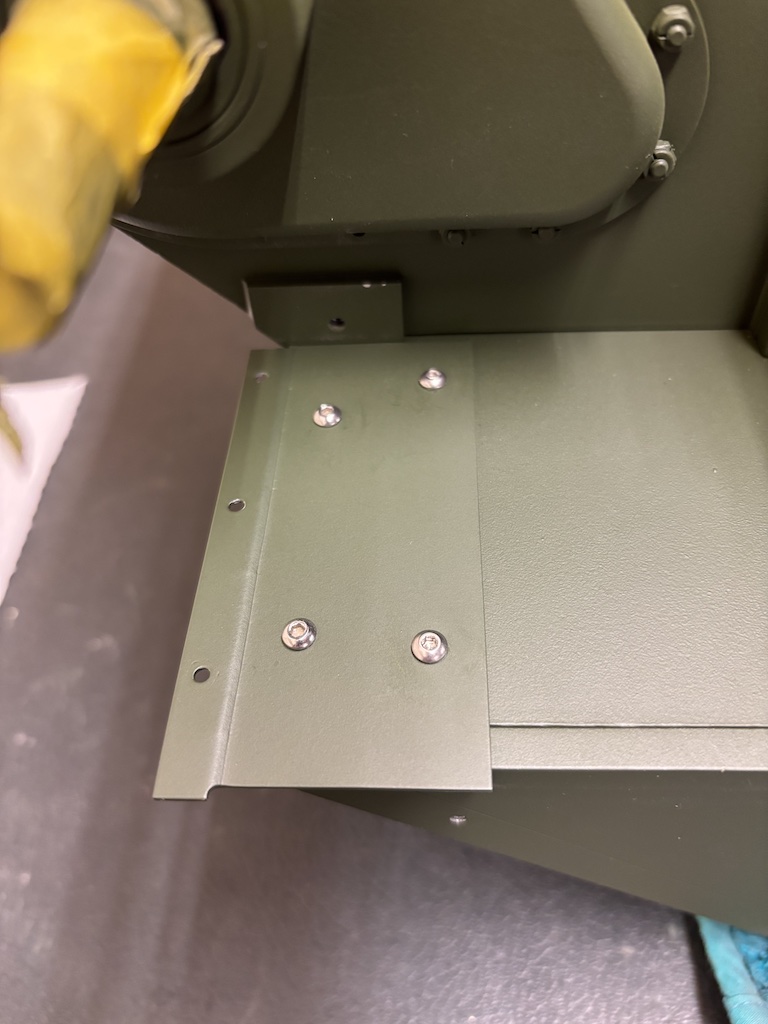

I wanted to get the mudguard plates permanently fixed on. Flipped the hull back over and fitted all the mudguards then removed. everything apart from the plates.
I will paint the fixings now it is upside down again.

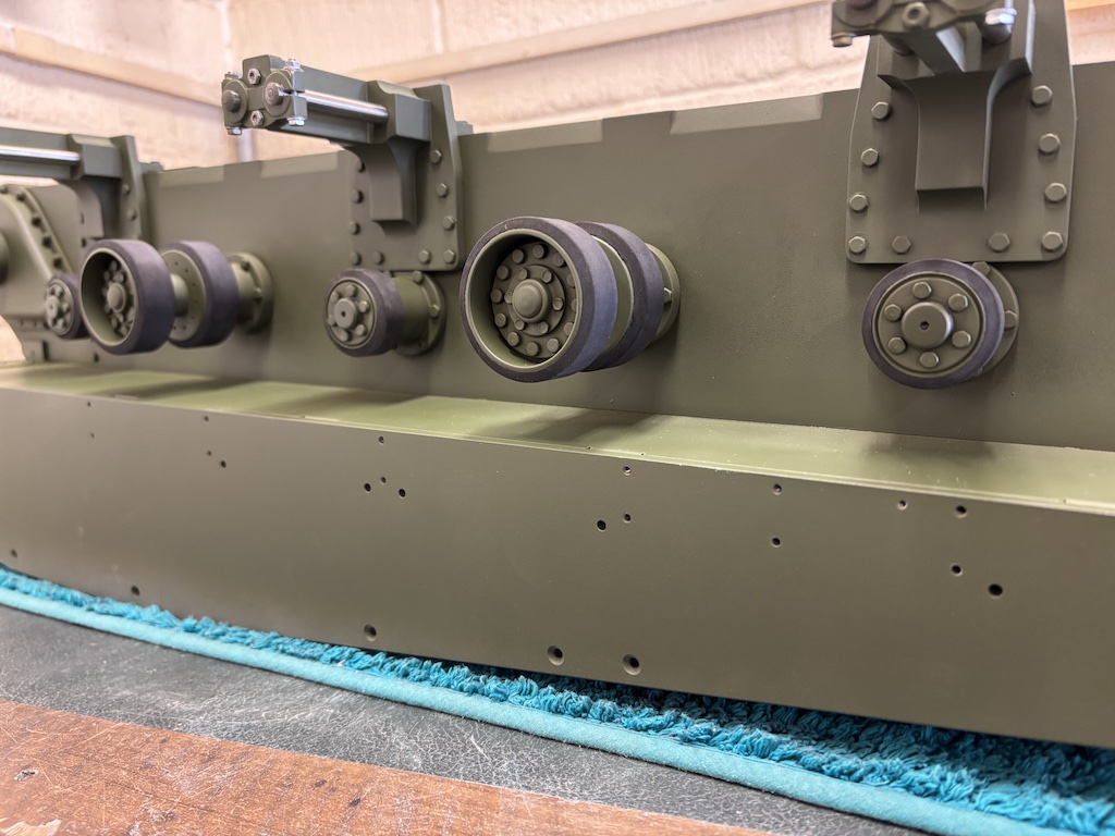

Cleaned all the shafts up ready for the return roller fitting.
Decided to use the rear fixing discs instead of the wider ones. So ordered another six, thank you Monique. Then the raised section on the front of the idler was machined to the same width as the small fixing discs. That left room for some fixings.
Fitted like so.
Fitted like so.
Then high build primer and paint to hide the head of the screw

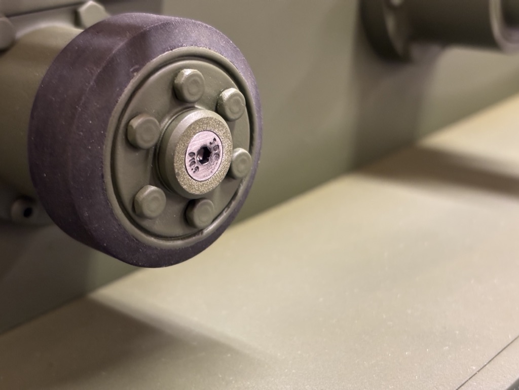

Then the larger return rollers were fitted.
That is those all done. The suspension and road wheels will be next time.

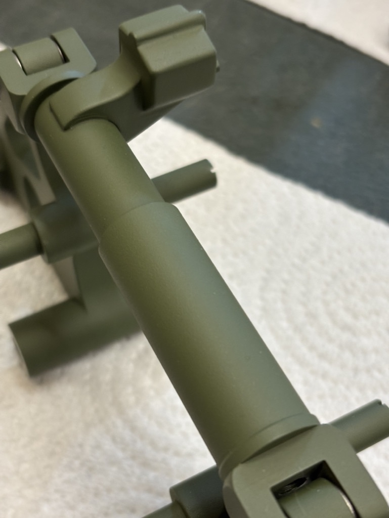

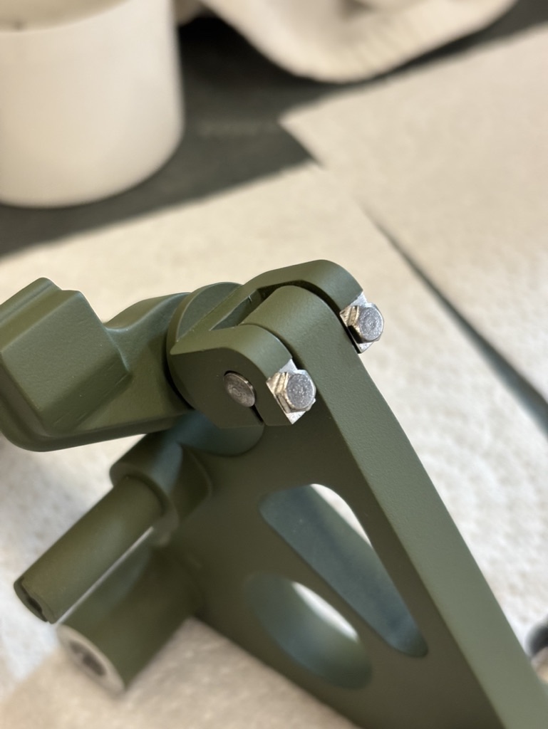

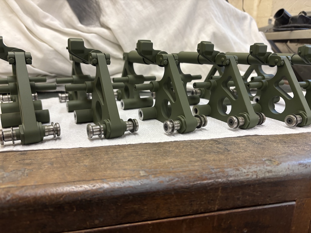

On with the suspension.
First job was to clean the paint form the spring cup pivot points.
Spring units assembled.
First pivot installed.
Then insert the spring unit and swing the other swing arm into position and insert the other pin.
Drivers side.
Drivers side.
Bow gunners side.
Bow gunners side.
Then checked they were in line and parallel.
I inverted the photo to show you what they look like the right way up. So first job tomorrow is tidy up the paint work on them.

Inner road wheels fitted. Just the hub caps to fit then I can turn it over. I will fit the outer ones once it is up the correct way. That is getting pretty heavy so I don't want to add anymore weight.

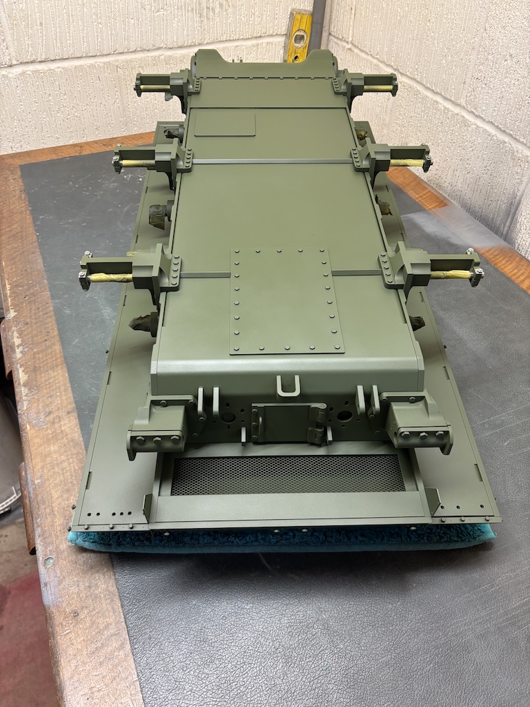

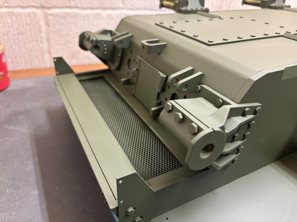

Little bit of progress.
Rear grill hinges going on.
Lined up and ready for filling.
Filled and painted.
Filled and painted.
Upper brackets lined up and fitted.
Last thing under here to do is the exhausts.

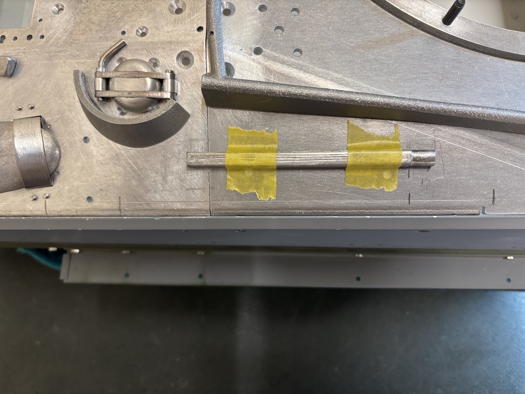

Final fitting of the side mudguards.
Checking they are nice and level.
Little skim of filler on the nuts.
Then sort out the paintwork.
That is those completed.
