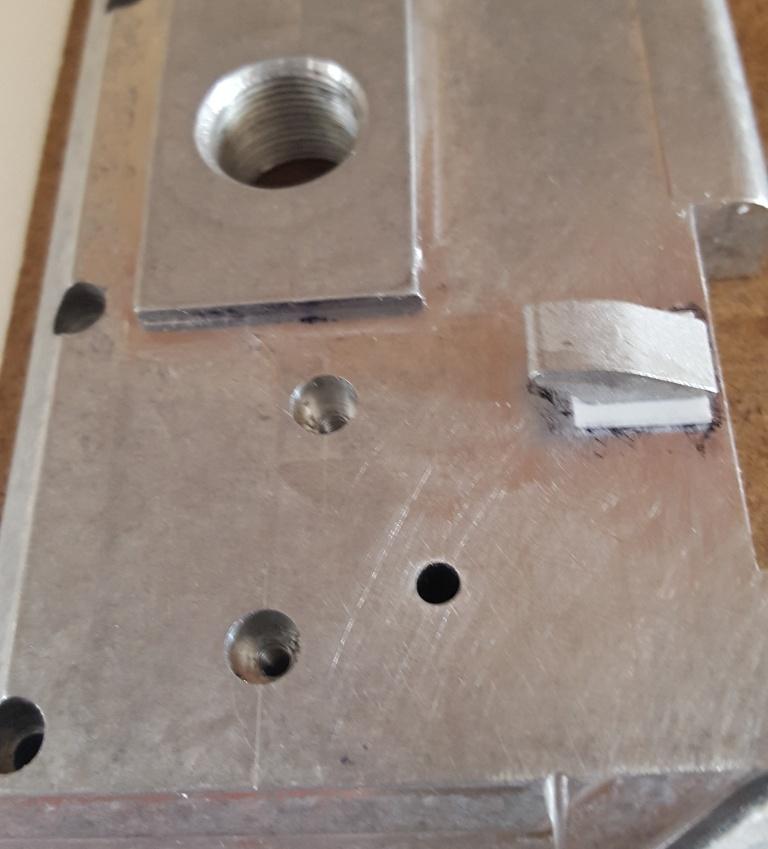

Front plate.
Weld detail completed
Driver’s visor side blocks trimmed to allow for weld

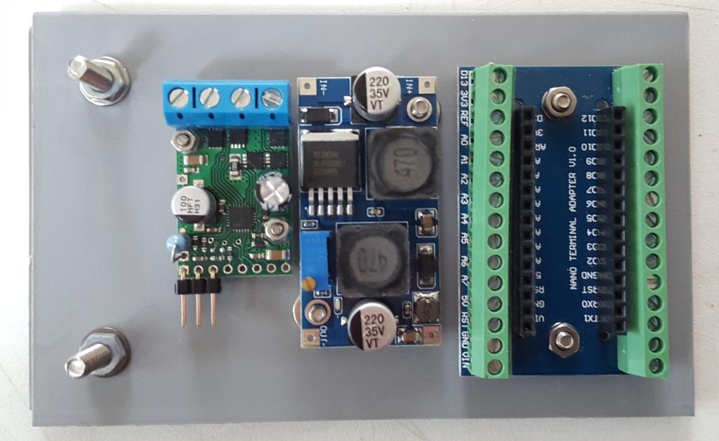

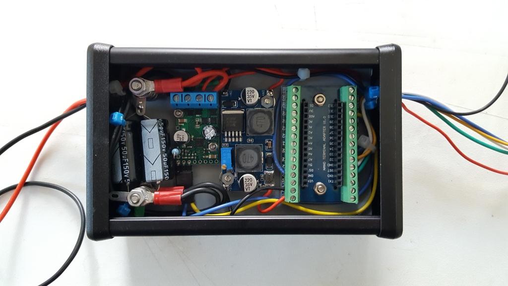

Finishing the smoker electronics...Wiring complete:
Next job: set the voltage regulators (buck/boost) to deliver 12V. A 13.8V bench supply was connected and the trim pots adjusted until a steady 12V was output:
Programming the Arduino Nano.
First, I wrote the code to trigger the heater elements at specific throttle positions. The code was tested with LEDs as substitutes. Once again, the bench power supply was used with the regulated 5V pin on the Nano powering the RC receiver whilst a 12V feed from one of the regulators powered the Nano. Then followed code to control the fan speed with the same signal. (The fan speed is a linear function of throttle position. Although I arranged for the fans to run at a low speed even with zero throttle, -100%.)
Once happy, the Nano was installed...
...and the enclosure closed up:
Note: enclosure ends are not currently secured, just in case some reprogramming is required. :wink:

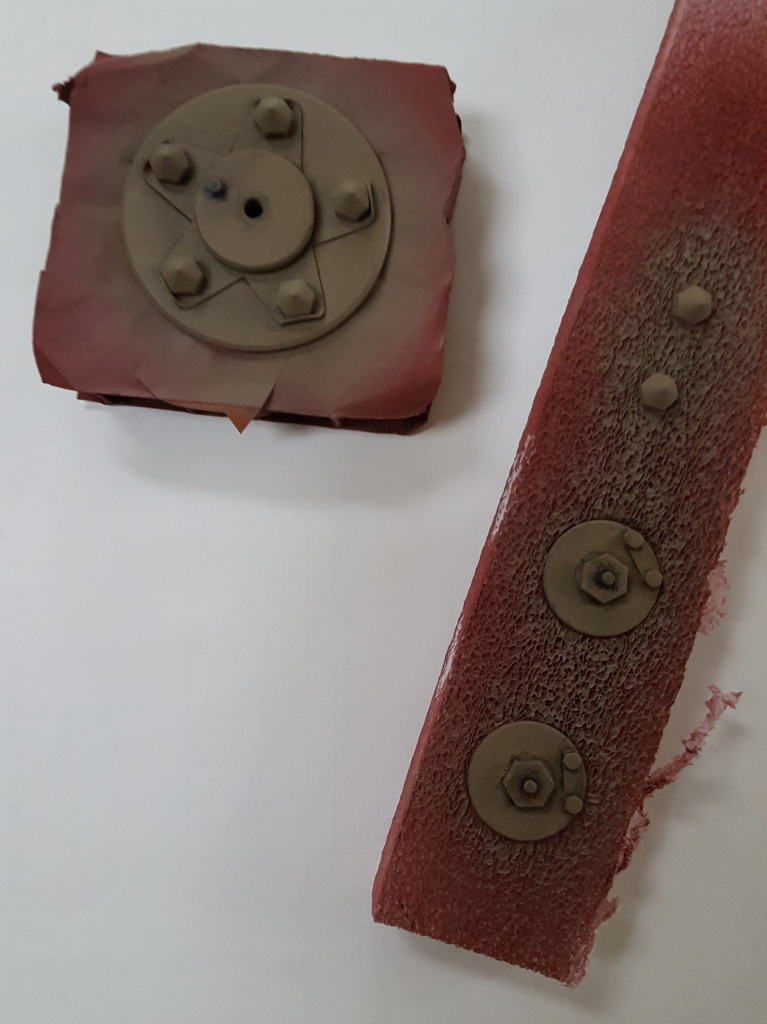

Armoured exhaust covers
Lift pegs epoxied in place and weld detail added:
Manufacturer (Henschel: DKR) and year (1943) casting marks added using Slater’s 5mm Plastikard Letters and Numerals.
Followed by what I have assumed is the part number (021-?-2701-162):
Then several coats of Mr Surfacer to blend the markings and add some cast texturing:
Will probably add some more coats before applying the red primer.

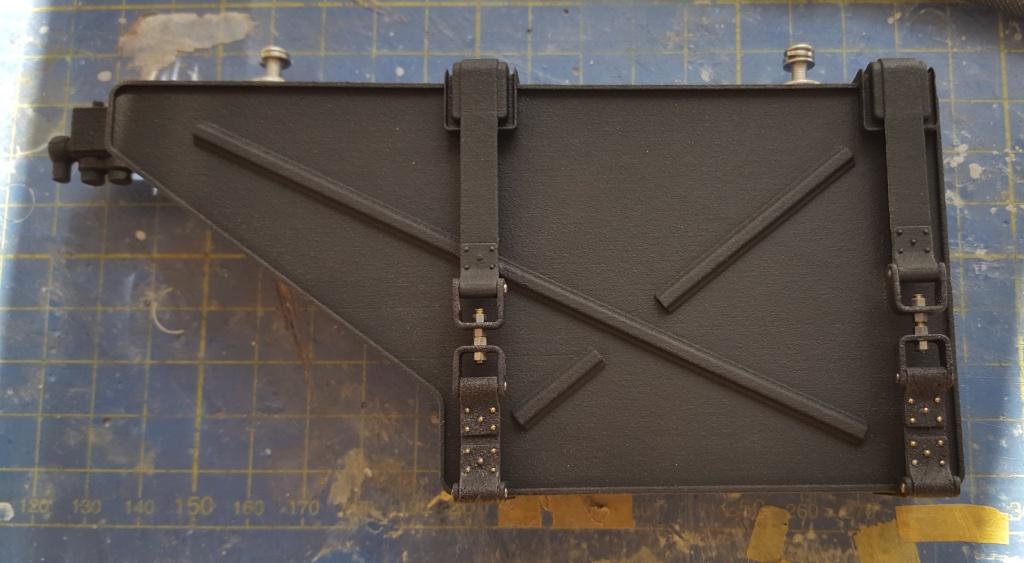

Basic 3D printed parts
Custom etched brass lock plate and 10BA bolts fitted. (I have some spare sets of the lock plates if anyone is interested; please PM.)
Shown here with fitting/removal tool, which contains an M4 cap head bolt for strength.
Trial fit, just needs some primer and paint.

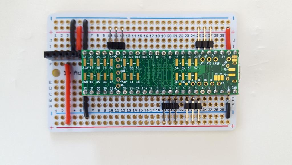

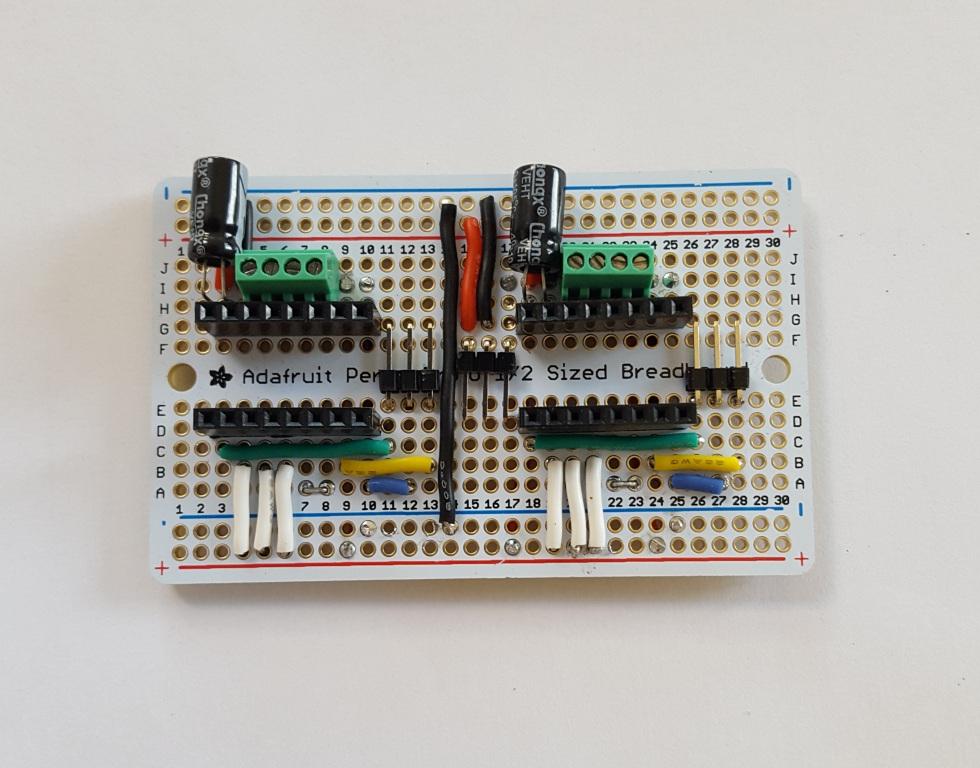

The electronics will be distributed with the controller in the front and the drivers (A4988) close to the stepper motors as there is a convenient space where the radiators would have been. I decided to use Perma-Proto board so that I could simply copy the layout from the prototype...
One of the two driver boards (front side). Notice I will have the boards permanently set for 1/16 microstepping.
Rear side
Controller board featuring a Teensy 3.5 and a socket for a 5V voltage regulator.

Any particular reason for using 1 / 16 microstepping?
AlastairCooke
Posts: 248
Joined: Tue Jul 16, 2019 9:59 am
Has liked: 16 times
Been liked: 776 times
Re: Tiger Ausf E “F01” Gruppe Fehrmann
Post by AlastairCooke »
Thanks Vince. :)
The NEMA8 stepper motors are quite low torque so the maximum micro-stepping available was selected as an attempt to reduce the acceleration on start up. This will hopefully reduce the likelihood of stalling. A Teensy microcontroller was also selected as there is code available that will generate sufficient steps/sec to give a realistic RPM whilst limiting the acceleration. There are 'stronger' NEMA8 steppers available now so an upgrade may be required... :?
Alastair
Alastair
Has liked: 794 times
That makes sense. I guess those nema 8 steppers can't handle a lot of current.

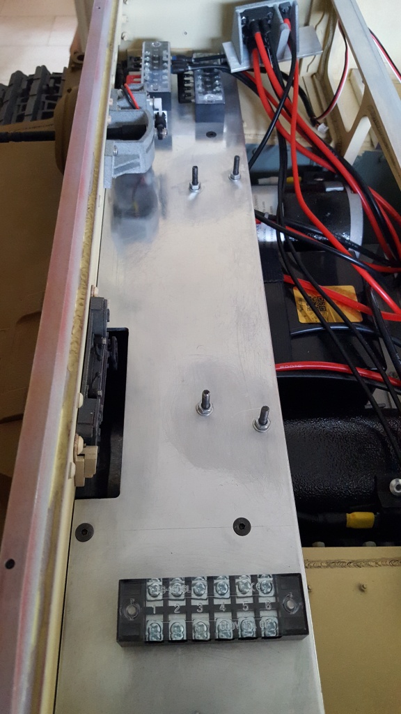

Recharging points
I decided to access the recharging points for the 12V batteries from the Radio Operator’s hatch as the Driver’s hatch is used for the service ON/OFF, power ON/OFF and JOIN/SPLIT switches.
Recharging points mounted on Speed Controller plate, next to service distribution bus bars.
Checking access through hatch, looks OK.

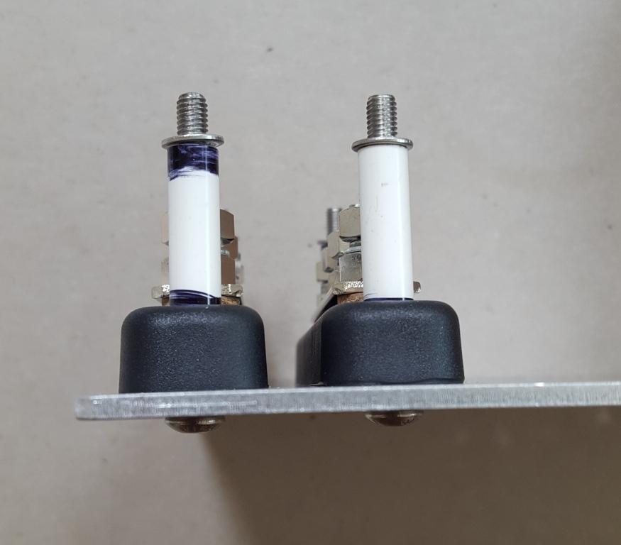

I have got around to making a cover for the 24V power circuit distribution busbars as they were a little exposed. I used some more 1.7mm thick ABS sheet, which was doubled up for added strength.
Note the use of extended securing fasteners to provide support for the cover.
Cover in place, the busbar terminals are now shielded adequately.
Cover separates the positive and negative terminals.
Supporting fasteners will be isolated using rigid PVC tubing.

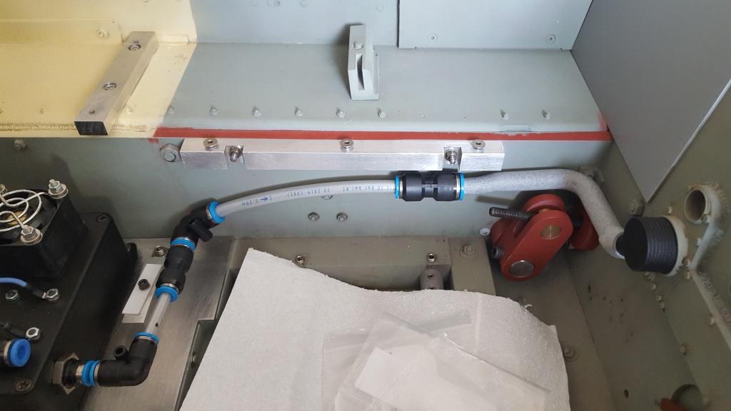

Exhaust
Trial fit of exhaust pipes and laying out of smoker tubing
Both stacks in place.
Armoured covers fitted.
Right-hand smoker unit in position
Smoke tubing roughed out... needs support at second elbow to ensure pipe run rises gradually to outlet.

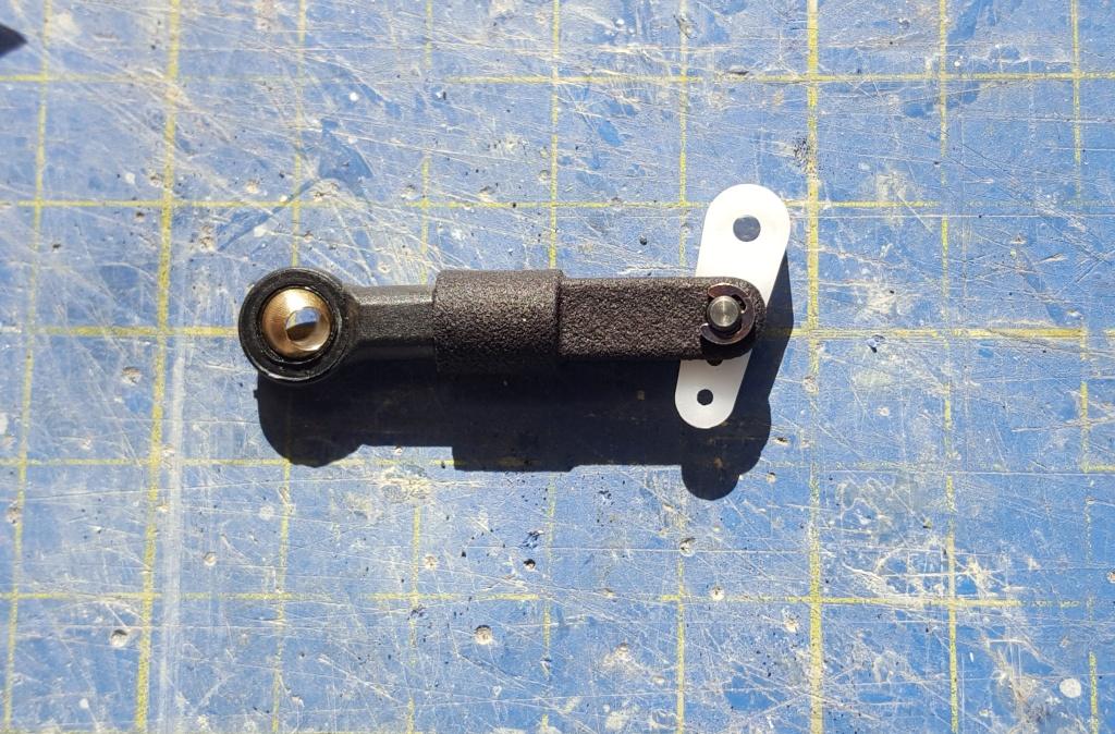

Custom support and servo mount (servo is a FrSky Xact H5701)...
Servo horn linkage...
In the end, I decided to use the outer most hole (opened out to 2.5mm) to get more travel.

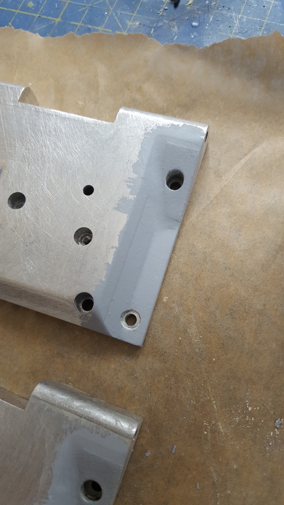

Final configuration of the plate. Holes cut/drilled for the receiver voltage regulator and to allow cables to pass through to the underside.

Fan cover latch clip (from Sixth Scale Icons) test fitted.
Photographs of surviving Tigers showed that the clip had a lipped base. I assume this base made it easier to weld the clip to the armoured cover. Image shows the first attempt to size this feature. I ended up making the plate square and moving it slightly further back.
Decided to reprofile the covers...
Insert epoxied in place, note the roughened surface to aid adhesion.
First pass with Milliput.
Second pass with Milliput, sanded ready for Mr Surfacer 1200...

Another coat, after sanding down the first.
Final coat (fourth I think) ready for some cast texture. Will do this when other holes have been filled.
Electrics (final fix)
Having acquired some light strength (Purple) Loctite I have started to refit the electrics/electronics...
Ready to refit speed controller, relay switches and charging jacks...
Front plate installed...
Electronics refitted.

As you may know from earlier posts, I plan to have a fully detailed engine in F01. I want to able to remove it for display but have something reasonably prototypical left to look at when the engine is removed. I have decided therefore to include the lower fuel tanks. These will have added bonus of hiding the plumbing for the smokers and the wiring for the radiator fans.
Right tank tension strap detail (0.5mm rivets, 1.4mm threaded rod and M1.4-2.0mm A/F nuts)
Straps for left tank and fuel valves.
Lining up the strap ready for 1.5 x 8mm dowel pins.
Straps fitted
Valve detail dry fitted, ready for painting. Will be primed in black and then sprayed with some metal colours to simulated aged aluminium.
The aim here was for something that had the ‘feel’ of the full size item without going too far with the accuracy. Hence the lack of heat shields which would make the tank less interesting to look at.
Radiator Fan Electronics
Stepper motor driver board installed and motors wired up.
Fan blades installed, will require some additional hub detail.
Turret Rotation Electronics
Started on the turret rotation electronics. I want to have position feedback so that I can stop the rotation when the main gun gets close to the radio antenna. On start-up, the controller will ‘assume’ the antenna is fitted. A switch will need to be set in order to get full rotation. I plan to use a three-position switch on the transmitter so that the third position can be used to set the current azimuth angle to zero. This will enable me to ensure that the correct zero position is established once the tank is ready to operate. I anticipate that the turret azimuth angle for storage or transport will not be with the gun pointing straight ahead. These requirements necessitated the use of a micro-computer (Arduino Nano).
Components fitted. Left: motor driver (Pololu G2 High-Power Motor Driver 24v13, #2992), middle: adjustable voltage regulator to provide 9V for the Arduino and right: the breakout board for the Arduino.
Power wiring added. Note the addition of some more capacitors to provide additional decoupling.
Driver control wiring and motor wiring installed on the right hand side.
