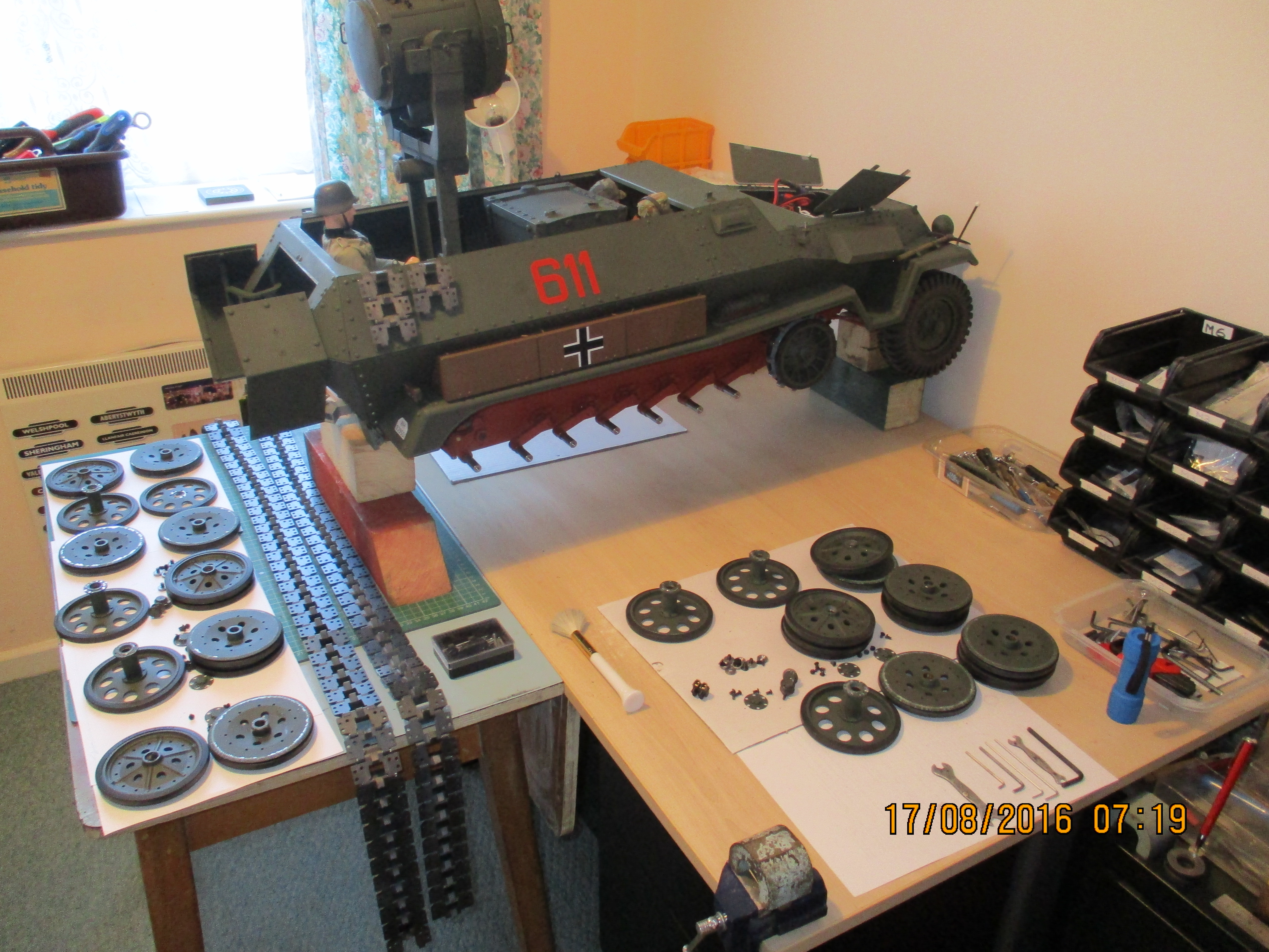

Recovered to the workshop...removed remaining track and all road wheels. Results are, one fractured track link, three suspension arms worked loose as a result of the track jamming. So, I took the opportunity to clean and reset everything...I did notice that the suspension arms which were grub screwed and loctited had not moved....All rebuilt and working.....be advised, a salutary lesson.
