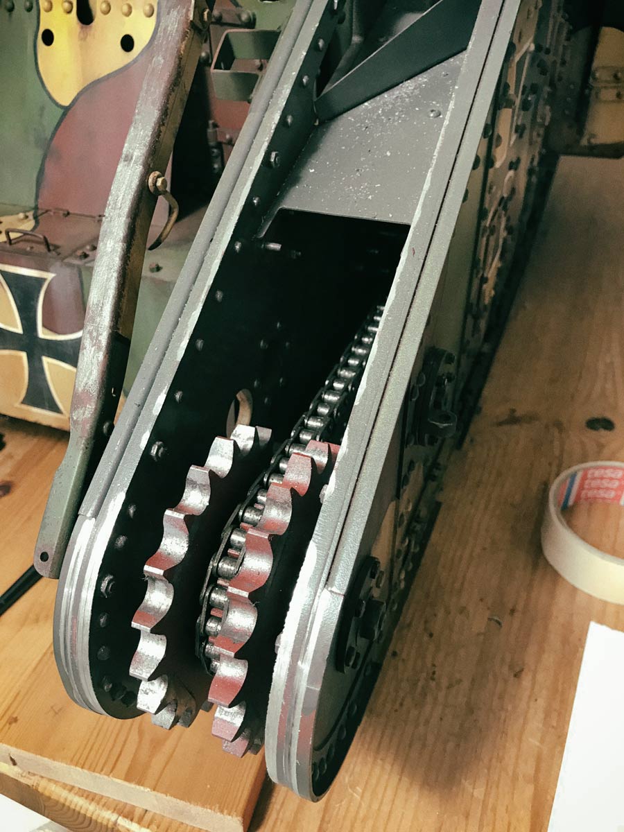

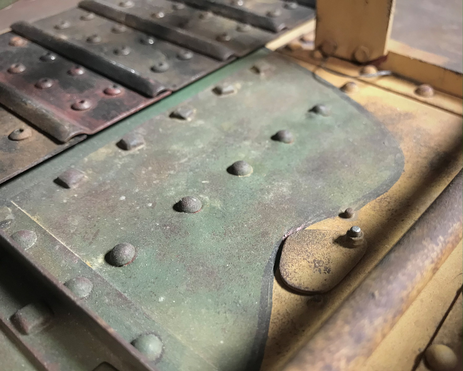

Spend some attention to the tracks – again
The heavy abrasion of the tracks and some collisions with the track locks and a few rollers during the first tests in march made me worried.
I decided to look if I could make some small improvements in the workshop before the tank goes into action. So the tracks had to be taken off again.
The two things I changed were the sharp heads of the chain lock which I rounded, and I flattened all the screws which connect the track plates to the conveyor chain hoping that this will help to improve a smooth run.
Oliver

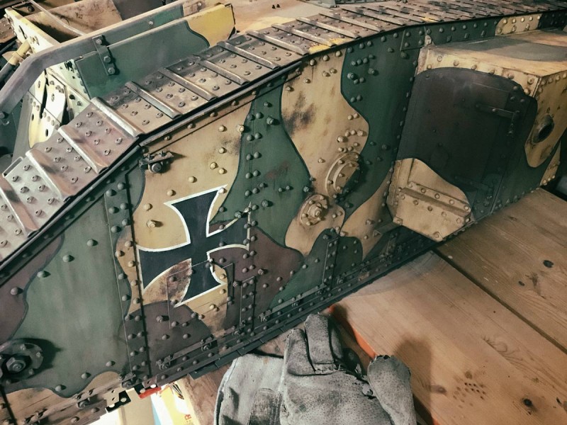

June 2021

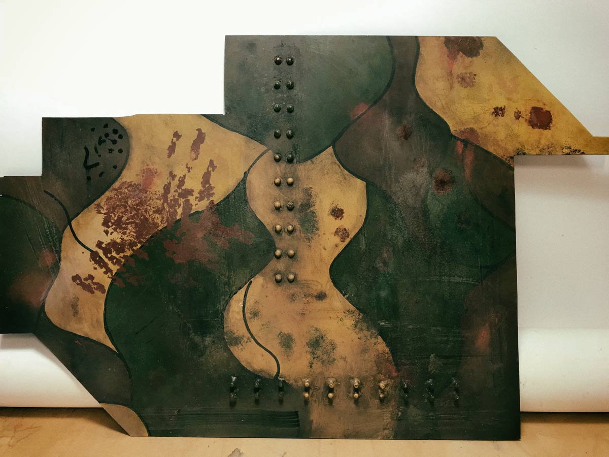

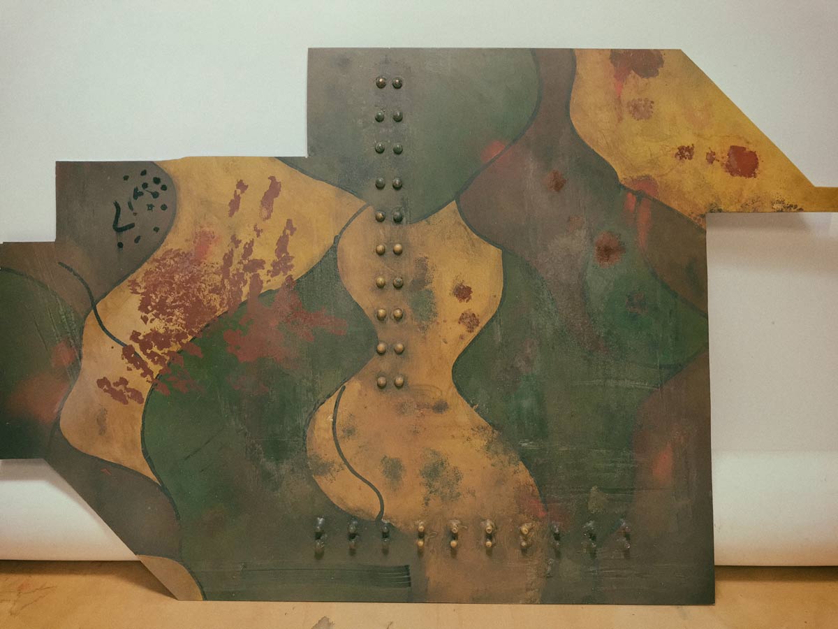

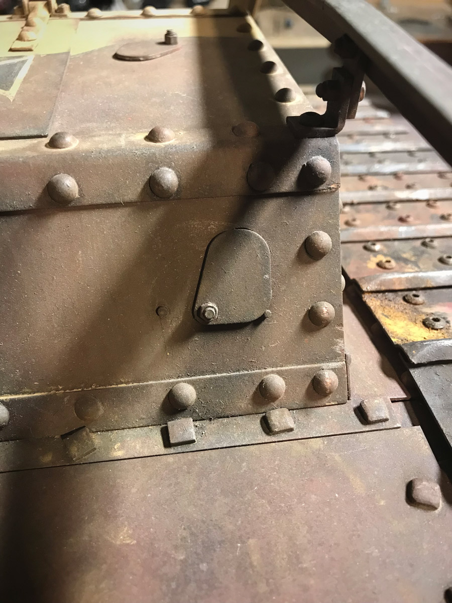

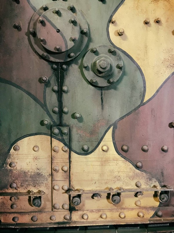

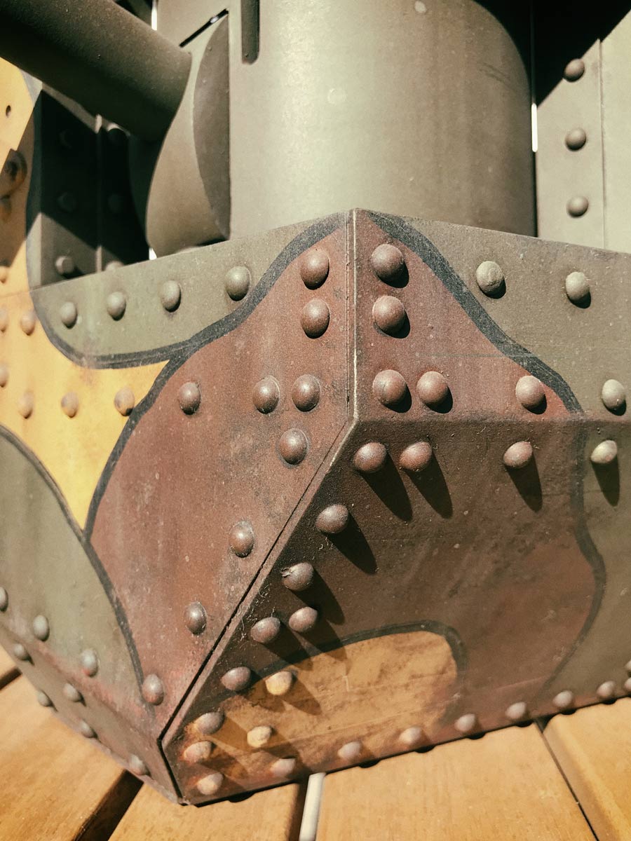

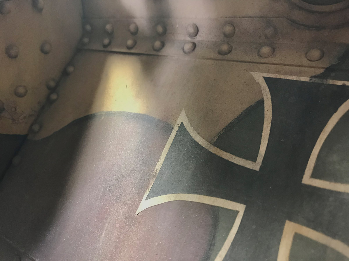

A heavy used tank needs some dust.
I found all the dust impressions on 1/35 scale models showed massive dust.
So I wasn‘t sure if it would work in 1/6, as I wanted to preserve the underlying detail and not cover it all up with dust.
So I tried to apply some light dusty hues with Humbrol enamels. After that, the exclusive paintwork was covered with Humbrol matte vanish. In the previous tests, this matte varnish gave the best results with the mix of oils and enamels on my model. To enrich the diversity of the different surfaces, another light weathering with oils was applied.
On the rooftop and the horizontal surfaces, I pushed some lighter hues with some earth tones in the corners and around some rivets to get some vividness in the overall appearance of the heavily used tank.
The tracks were easier to fit the second time, as they had already stretched slightly. But it is still a time-consuming and somewhat inconvenient job on this model.
Oliver

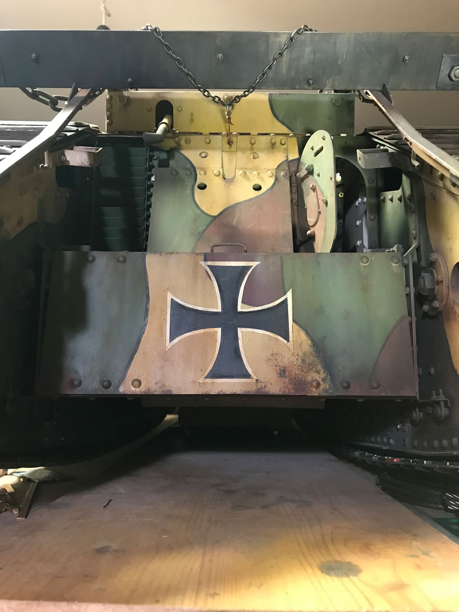

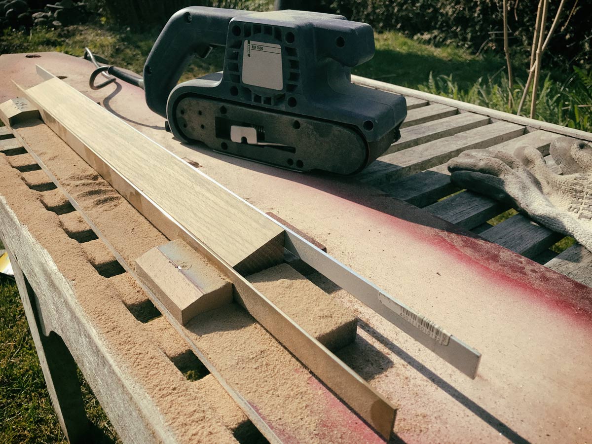

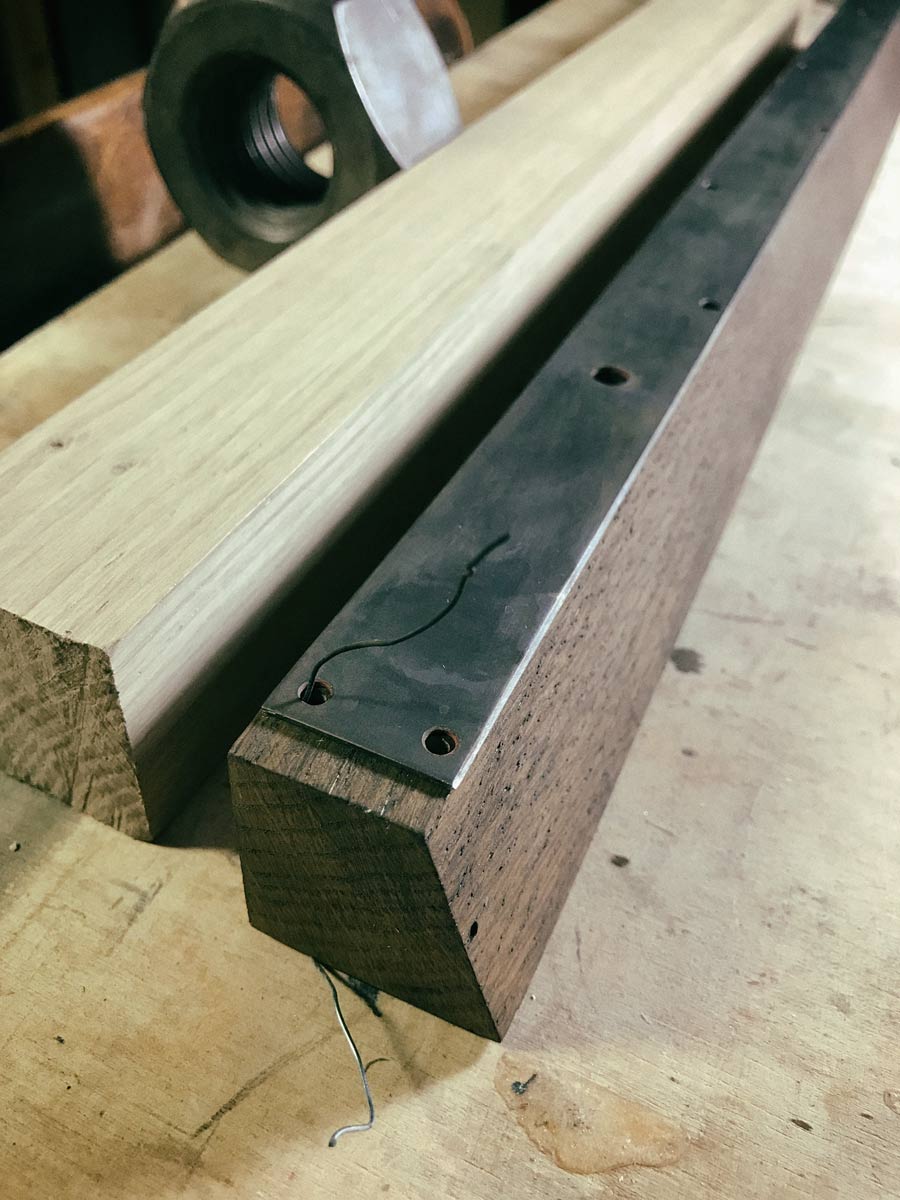

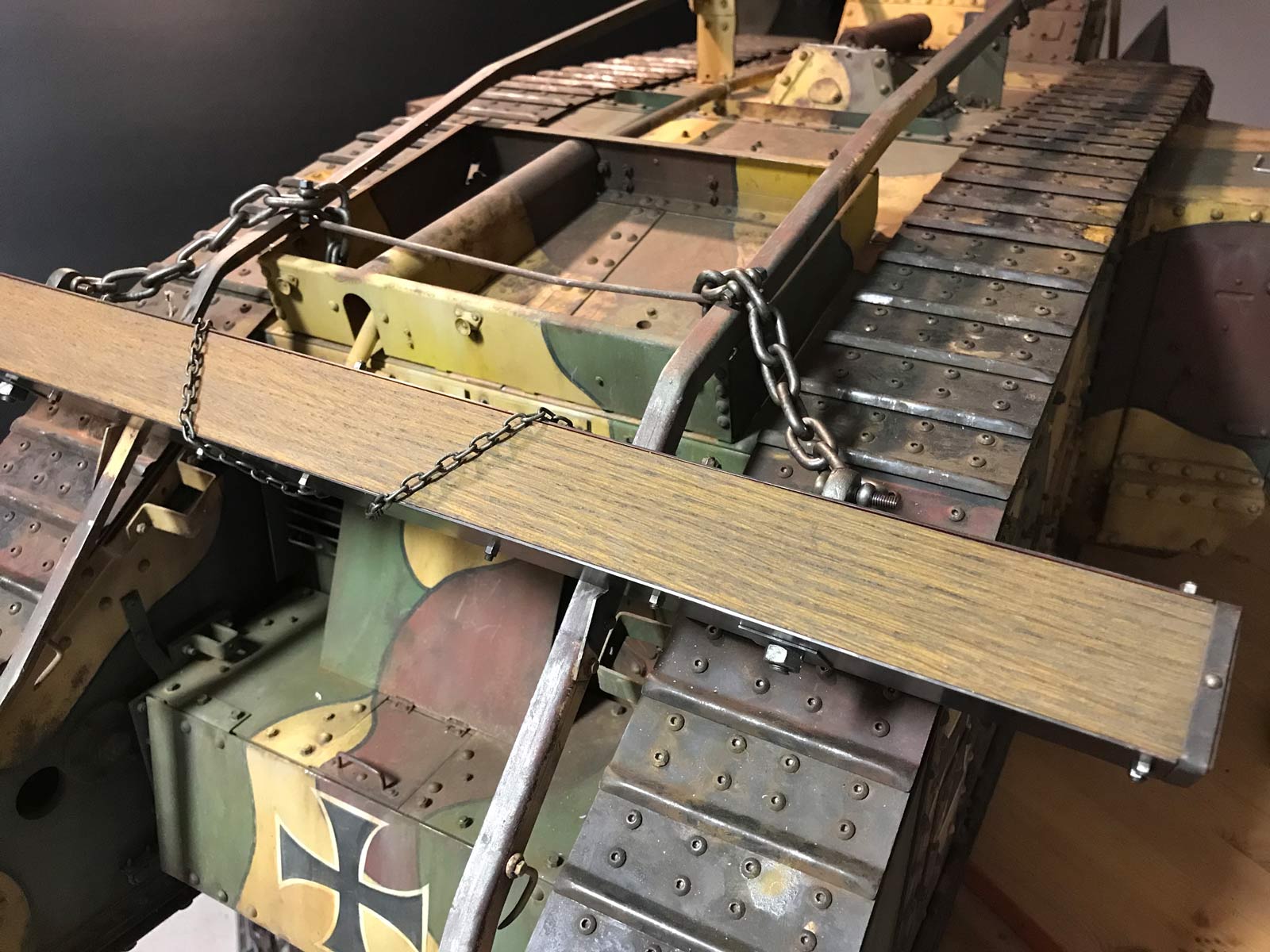

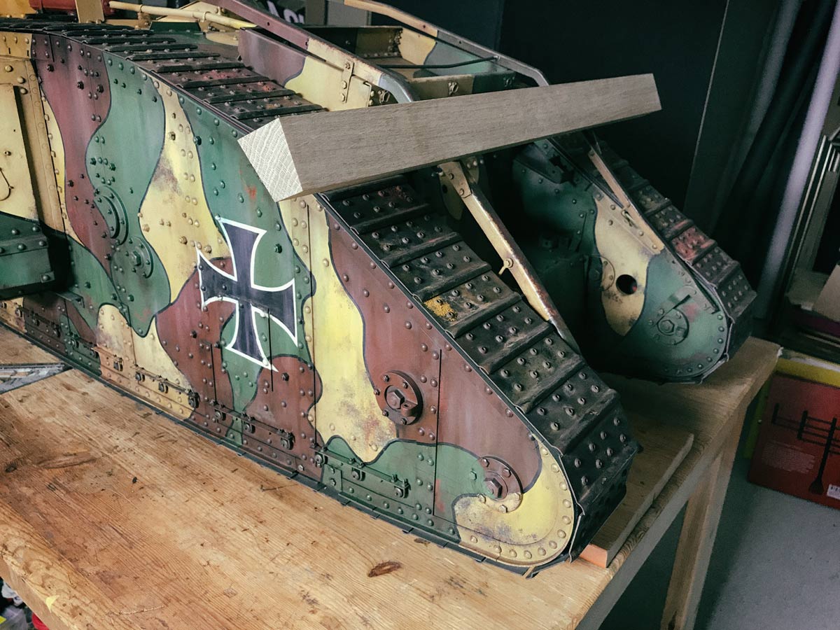

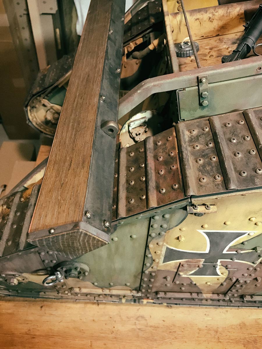

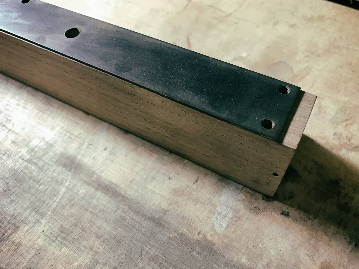

well, something important is still missing – The Unditching Beam
The tank still lacks its characteristic unditching beam.
The piece of wood included in the kit was not quite the right size and was also missing various details that make up the charm of this prominent accessory. So in 2021, I had a carpenter craft me a fine-grained oak wood and later in the summer I sanded it to the correct size.
This would not have been possible without Steve Stuarts‘s detailed measurements in his build log.
So a big thank you at this point for publishing the data.

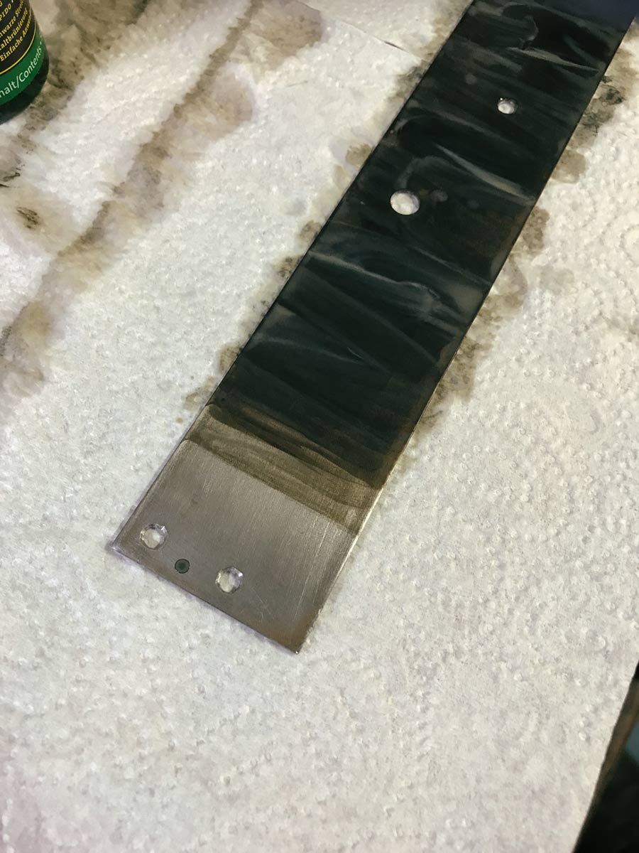

I then assembled metal plates to match existing images and again blackened them for an authentic look. The oak wood was carefully stained and sealed with a very matt finish.
Best Wishes
Oliver

The narrower face of the beam should be facing upwards
- Posts: 223
- Has liked: 551 times
- Been liked: 409 times
Re: Schwerer Panzerkraftwagen
You got it Chris,
only a WW1 tankie would would spot that at first glance
Best wishes
Oliver
Best wishes
Oliver

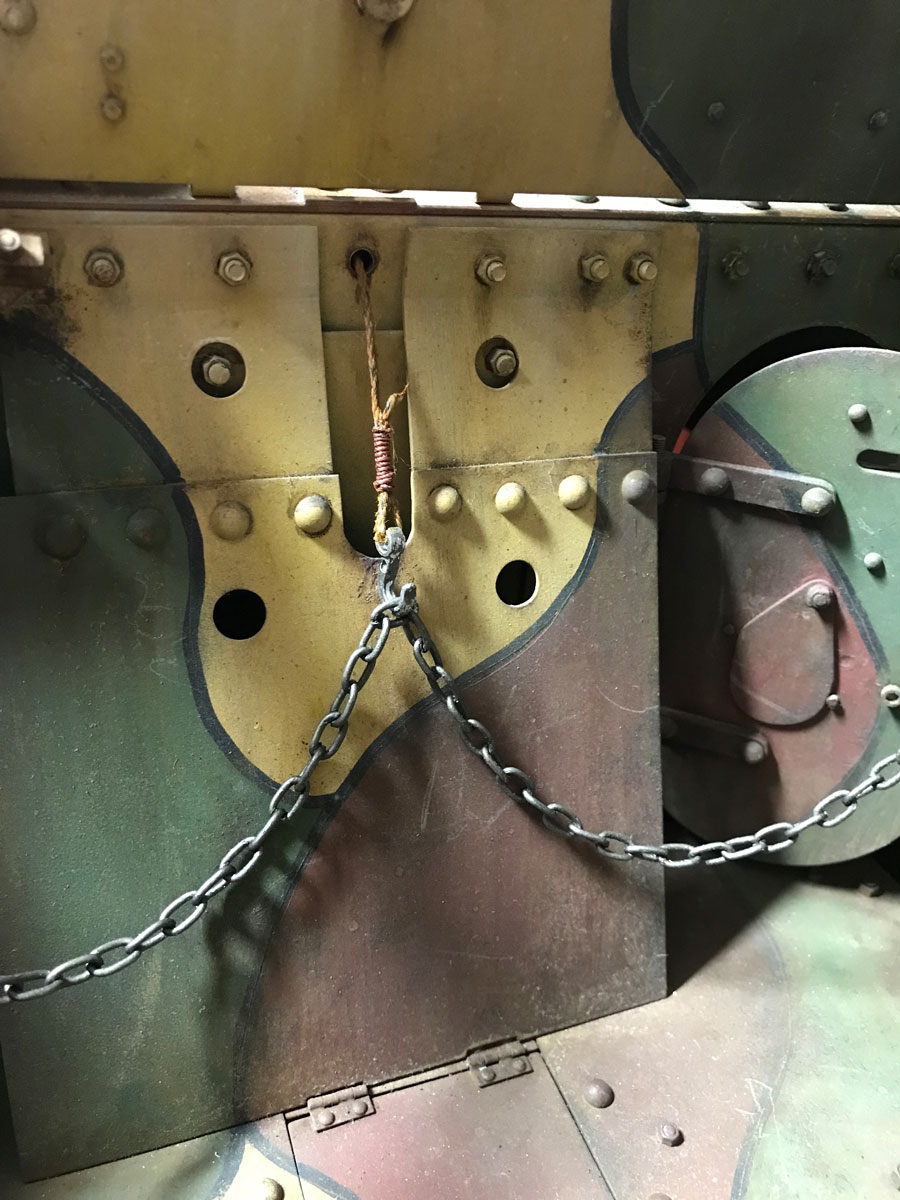

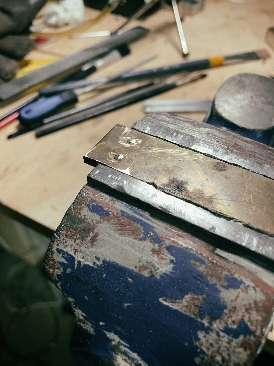

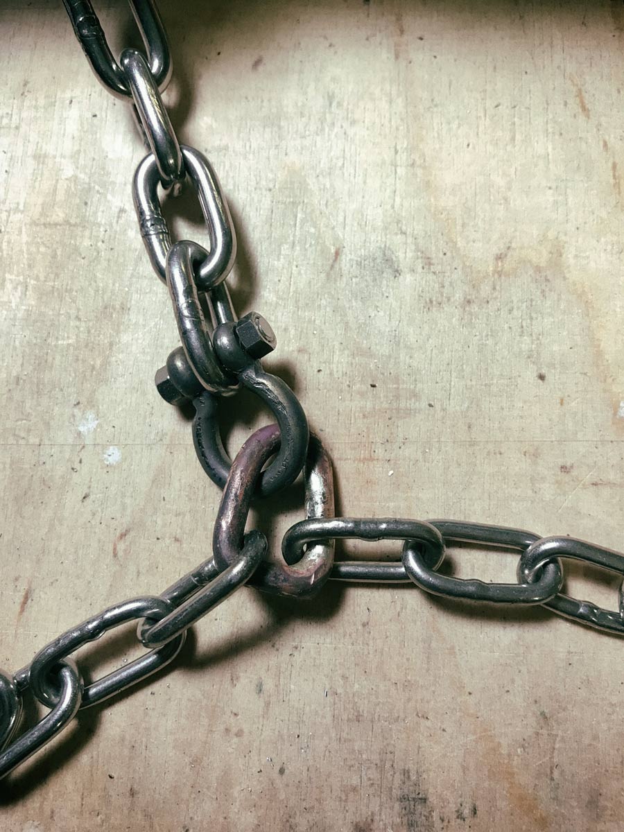

November 2021

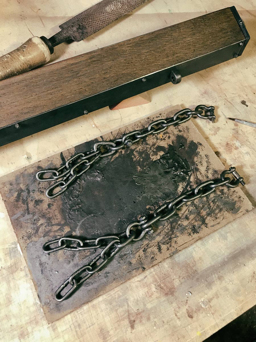

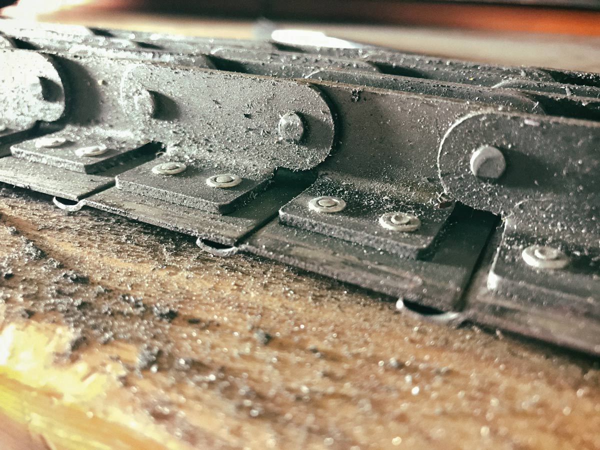

Chains on tanks excite me ...
Well, not the way you might think, because it was a little bit difficult to get the right measurements for the Unditching Beam chains.
Most of the chains you can buy these days have different shapes than the ones in the past. It took several tries and orders to get closer to the vintage look. Sometimes it was a frustrating and sometimes an exciting search. So, with the chains of today, I could only get an approximation of the old shapes that can be seen in the references.
The biggest challenge was figuring out how the chains were attached to the chain plates, but more on that later ... ... ...
Best Wishes
Oliver

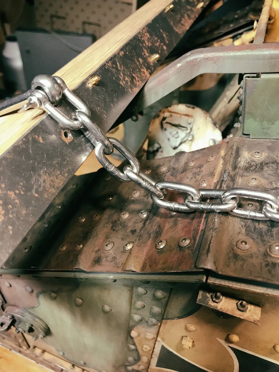

- Posts: 223
December 2021

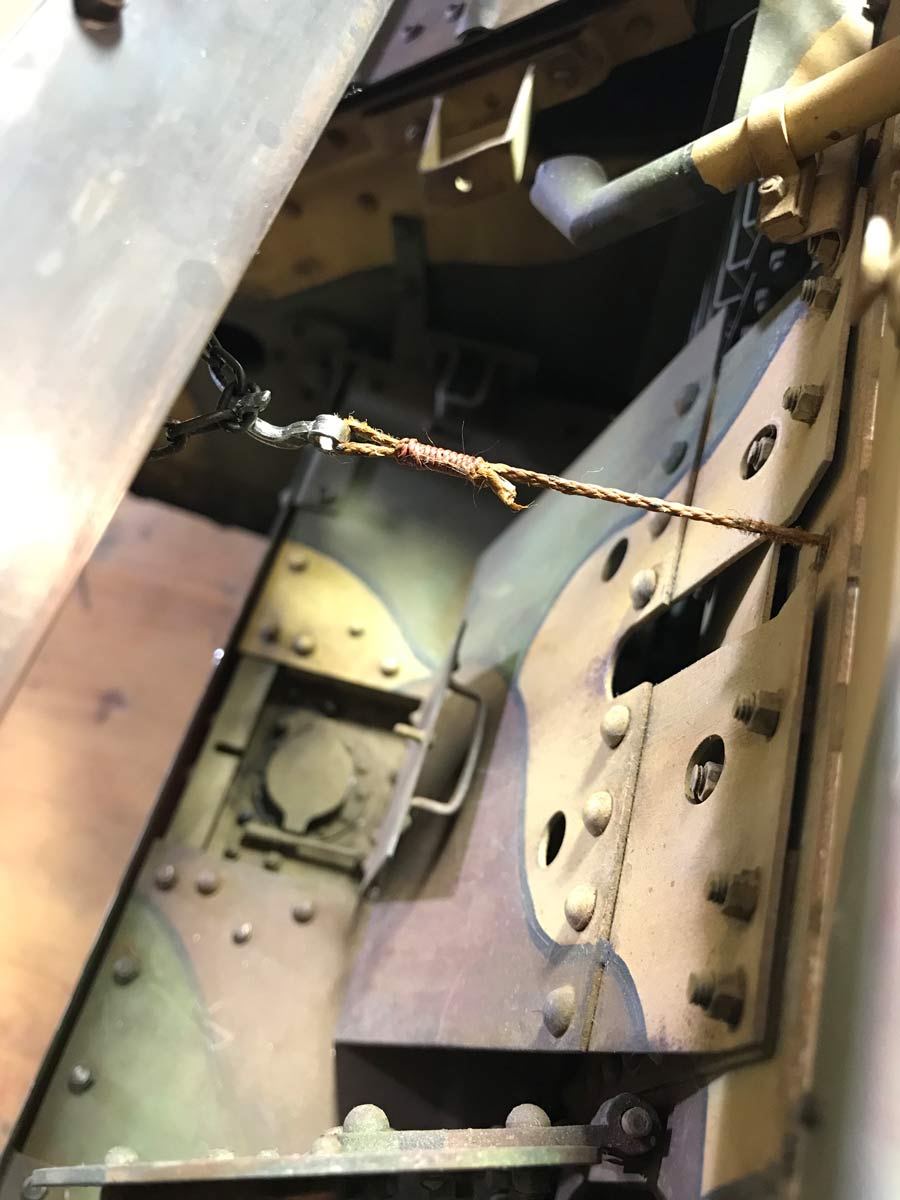

How to attach piece of wood
How was the unditching beam held on the tank?
To find out again a longer search on the web was necessary. A few posts in forums and especially details of old pictures gave an approximate hint how a simple attachment could have been. The attachment had to be quickly detachable even under enemy fire. A rope and hook was used to hold a chain wrapped around the Unditching Beam. The rope was tightened or loosened by the crew from inside the tank.
In the model, the tension of the holding rope is taken over by a tension spring, which is fixed inside.
This makes it very easy to demonstrate the principle.
Best Wishes
Oliver

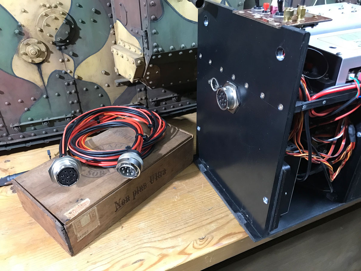

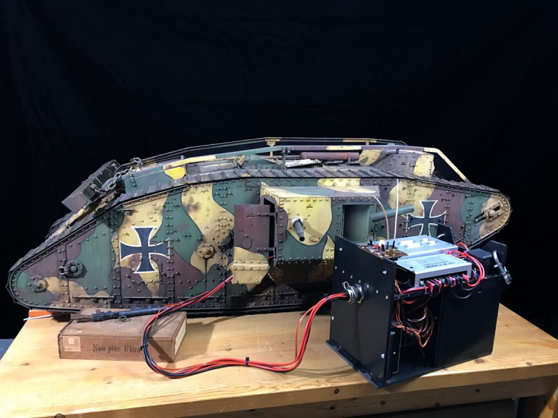

For convenient maintenance of the tank I soldered an additional lead to the most important components like the drives. Whether this will ever be needed I don‘t know yet, but it is a practical aid in case of doubt. Perhaps the lead could also be used for an external power supply in emergencies when the batteries are discharged? Maybe I can come up with something useful.
Best wishes
Oliver

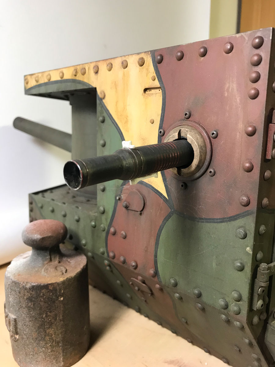

Little more details for the Lewis Guns
The beautiful turned Lewis Gun Barrels from Adrian still seemed a bit plain to me on the tank. Additional details like the front sight and the gas regulator would offer some variety to the eye. These parts are now cast in resin.
Best wishes
Oliver
