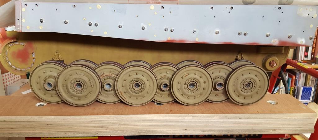

Update 16 Nov 22...
Road wheels fitted, ready to roll (literally: needed to tie it up so that it did not roll off the lift!) Will eventually store the tank with wheels off the ground but thought it wise to let the torsion bars take the load for a bit and start to bed in. Note the different shade of the wheels compared with the chassis and the paint removed in readiness for the application of sealant on the final drive case.

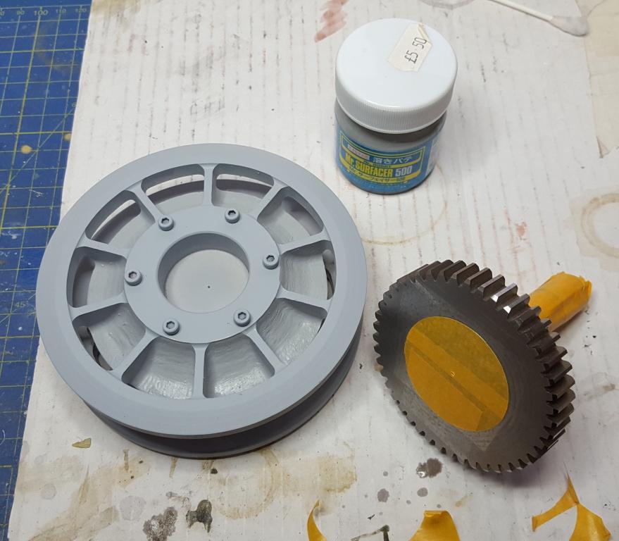

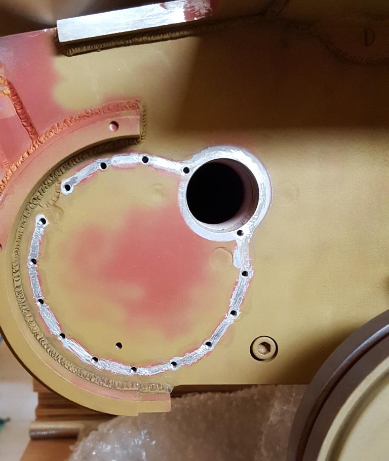

Update 13 Dec 22.
Preparation of rest of running gear.
Started adding Mr Surfacer 500 to pre-etch primed boss of idler to simulate cast texture. Will probably need at least one coat applied with a stipple action. The final drive gear was masked in readiness for a coat of dry lubricant. Final Drive
Fitted motors and final drive casings. Ran the motors with 6V to check clearance. No evidence of scuffing of the primer inside so no need to mill out any material. Then Dry Molybdenum Sulphide lubricant sprayed on... Gear secured in place using red Loctite, lubricant buffed up and Teflon disc added... Area prepared for gasket paste.

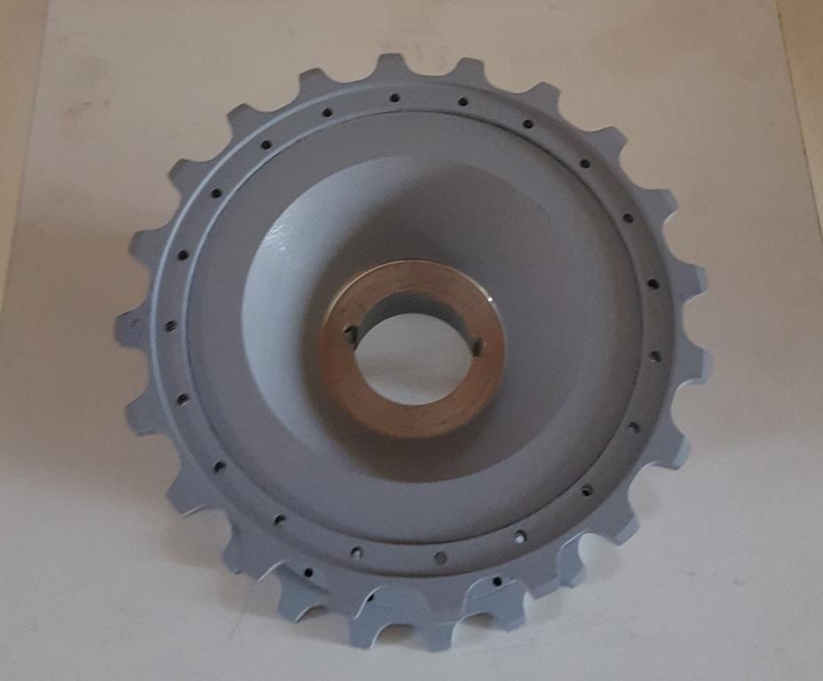

Finishing sprockets
Base colour applied used Dunkelgelb Ausgabe 44 (RC061) as the sprockets are the later pattern... Pin wash applied... Improving sprocket hubs

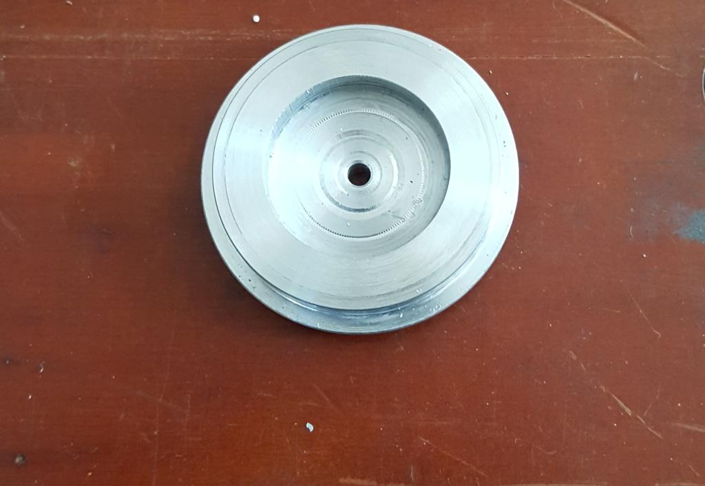

First inside was machined square and flat around holes for cone bolts Then a tube was machined to size and epoxied in place... Drilled and tapped for M3... Parts dry fitted after hole for zerk fitting drilled... First coat of etch primer applied and outer bolts permanently fixed in place. Modifying the Idlers
Rims polished on the lathe... A rear cover plate was designed and 3D printed in black nylon. Plate then used as a guide for drilling mounting holes... Holes drilled and scale bolts dry fitted... Cast texture enhanced with more Mr Surfacer 500 stippled on, then sprayed with red oxide primer... Base coat applied (using RAL 8000 Gelbbraun, RC063, as the idler is assumed to be from the original delivery)... Pin wash applied, will do some oil dot weathering later. That's all for now...

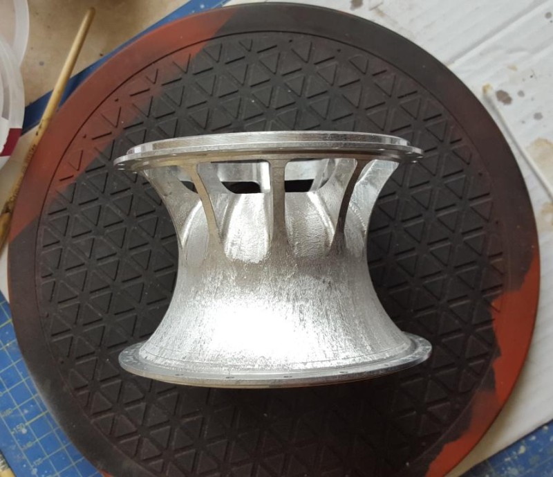

Update 13 Dec 22.
Finishing sprockets

Re: Tiger Ausf E “F01” Gruppe Fehrmann
AlastairAlastairCooke wrote: ↑Tue Dec 13, 2022 10:39 amHi All,
Update 13 Dec 22.

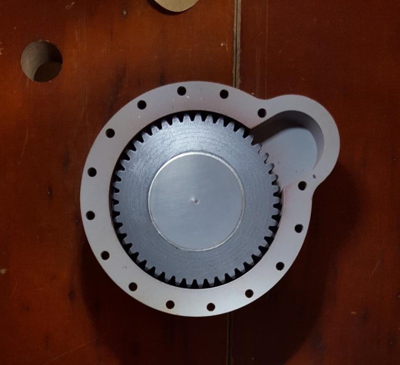

Final Drive
Finishing sprockets
Pin wash applied...

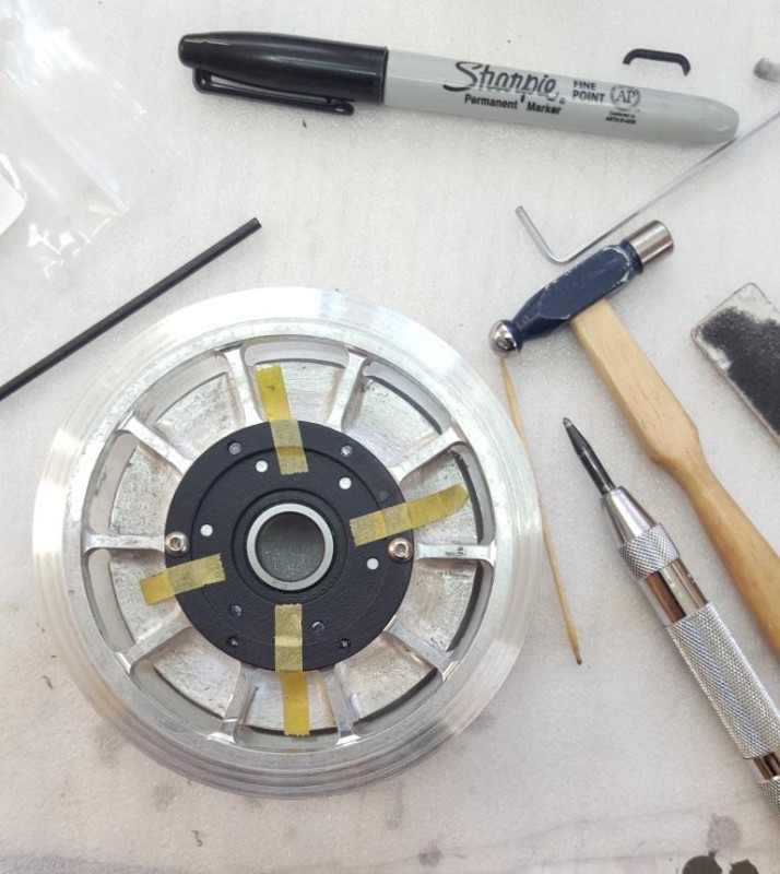

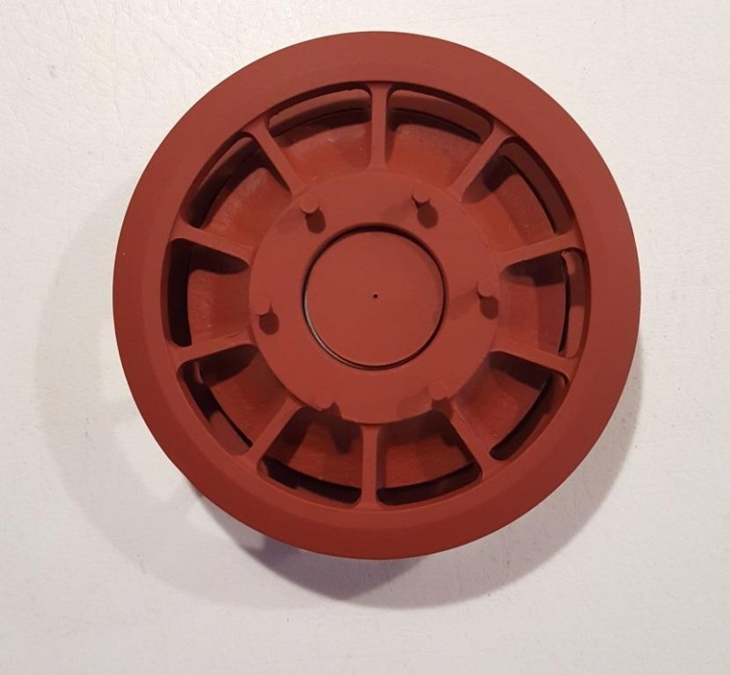

Alastair

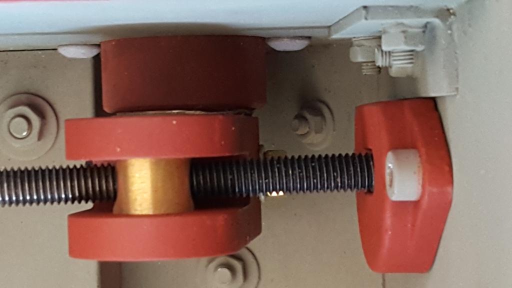

Swing arm fitted with custom made retention cap... Note how much of the bushing protrudes to ensure there is negligible end float. Plenty of grease applied to help swing arm slide in past the o-ring. Needed some 'gentle' persuasion from a rubber mallet! Reflector required installation before left hand idler arm could be fitted. First, a pad was glued in place. On the full-scale vehicle this was tapped but, here holes had been drilled through to accept an M2 nut on the inside. Then the reflector was primed, painted and fitted with 3mm A/F M2 bolts... Just a little touch up or rusting to do. (Nuts will be locked in place with a little Milliput.) Will keep the reflector lens masked until the rear has been matt clear-coated.

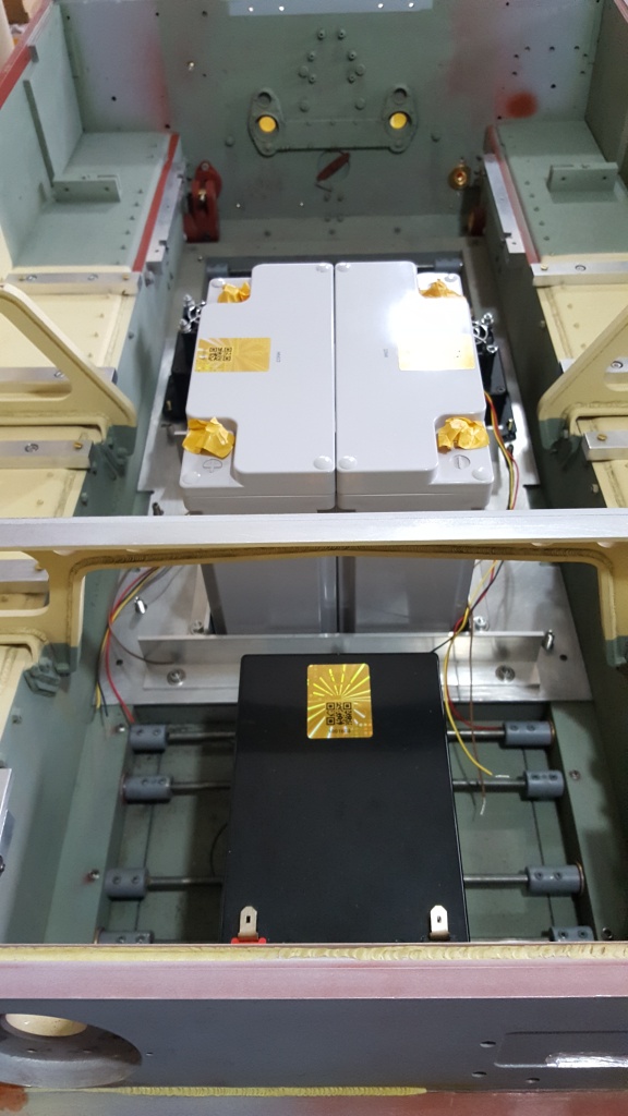

Time to position the electrics so I can finalise the lower mounting plate.
Starting with the batteries... and the relays... That's all for now...

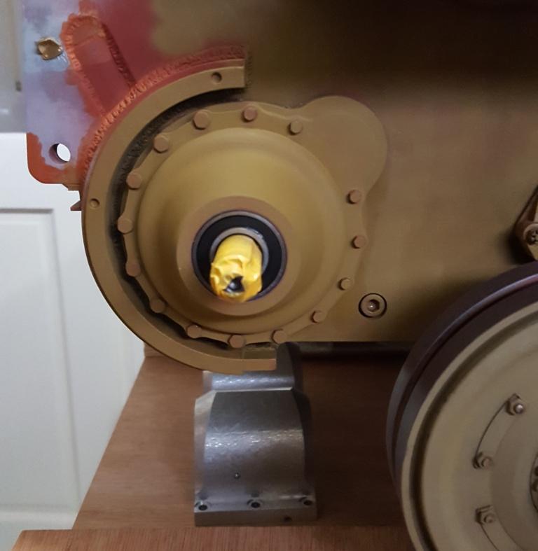

Final drive housing fixed in place. I have used 4mm A/F M3 bolts for the locations that may be visible and standard M3 hex head elsewhere. Electricals....

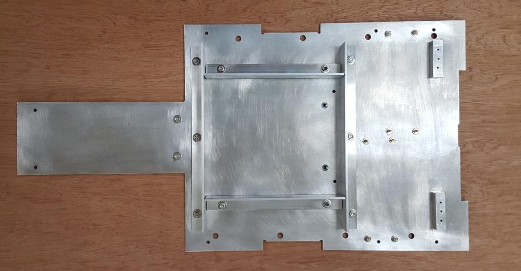

The battery/smoker tray (or plate) has been completed and test fitted. I wanted to finish this item before the motors are installed. 24 volt battery (2 x 12v) tray finished and mounting pegs for smokers fitted. Plate in place... ...and populated.

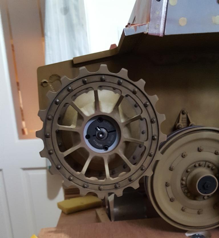

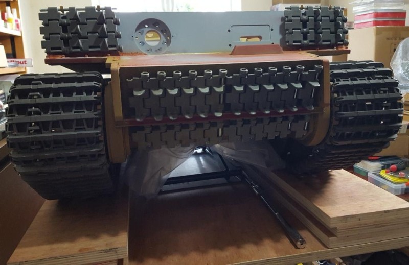

Update 11 Jan 23
Significant moment has arrived... (more on this later...)
First... Idler installed and showing off revised rear hub.

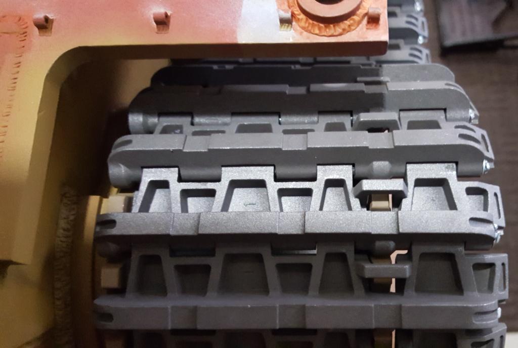

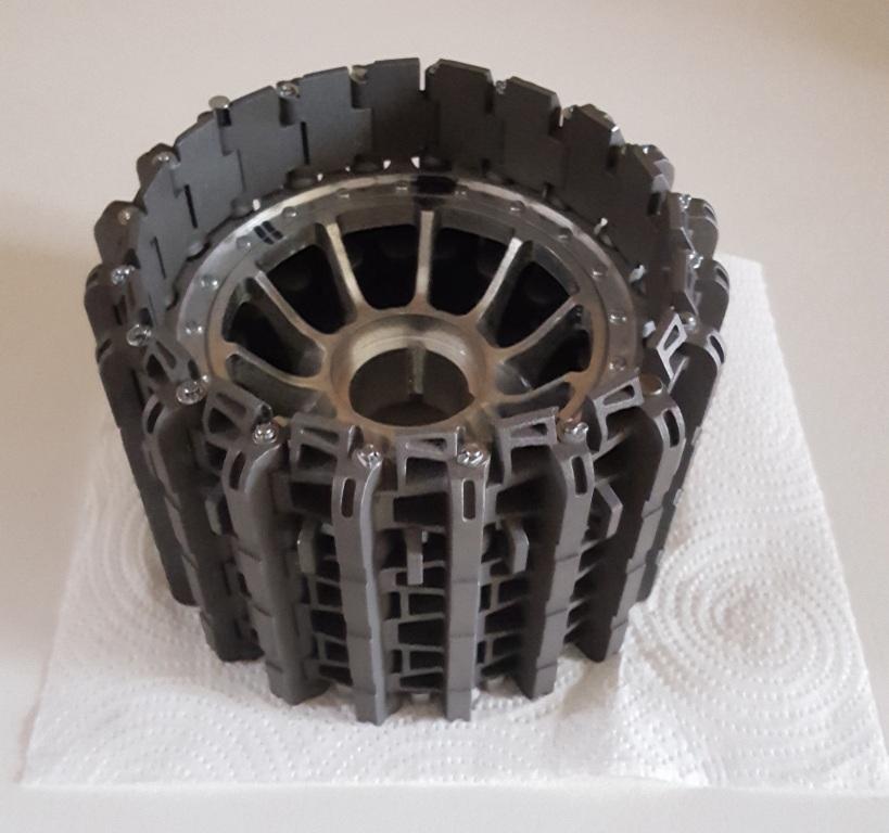

Then... Sprocket fitted using standard taper bushing Track section used to ensure correct positioning of sprocket. View from front showing position of sprocket teeth in track.
Next a full length of track was made up. Started with 96 links but reduced it to 94 on fitting. Finally with crossed fingers...connected the left motor to a DC power supply. With the hull lifted, so that the track was off the table, I began with only 6 volts gradually increasing the voltage to 12V. The track ran without any issues... so time to fit and trial the other one and then Loctite all the axle bolts.
Phew... that's all for now.

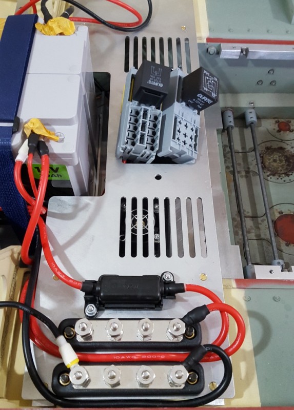

Update 28 Jan 23
Laying out the power electrics.

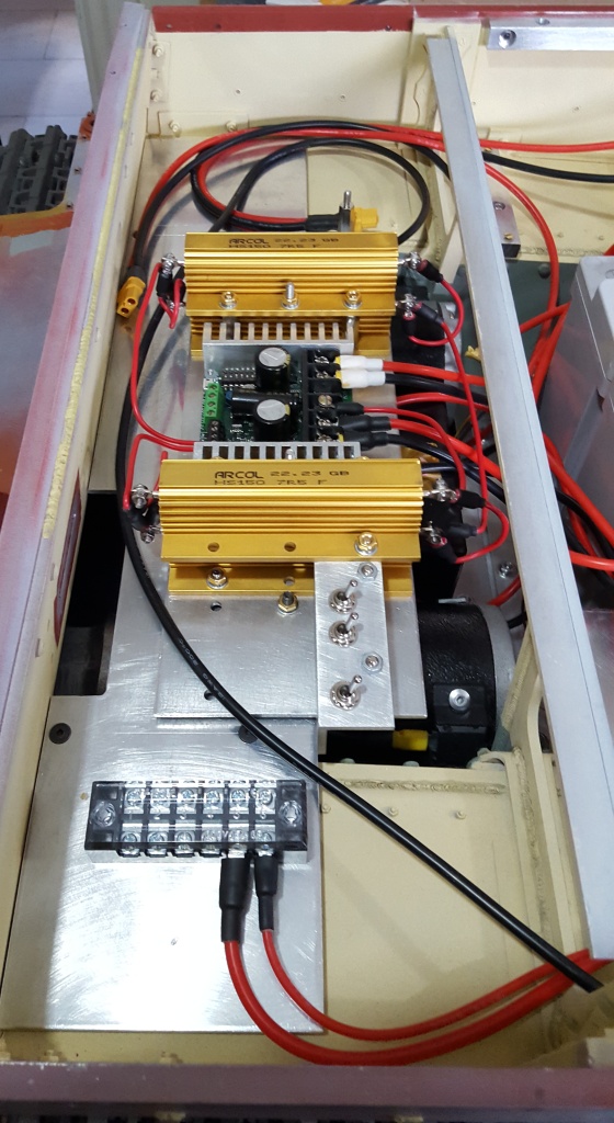

This is a 24V system that will feed the motors, smokers, receiver, and possibly the turret rotation circuit). I intend to supply power to the receiver from the service electrics (12V system) as well. Deciding on position of supply busbars and fuse. Likewise for the relay switches distribution block. Note that all circuits have at least one split point so that they can be taken out should I need access to the torsion bars.
Starting the wiring... 24V system, note supply bus bars on left side along with 60A fuse. I will need to finesse the battery connections to avoid fouling the turret ring
... that's for later.
Motor electronics: Sabertooth 2x32 with voltage clamp resistors.
...now with relay switches wired up. The relay for the service electrics will be dealt with later...
Power relays installed and checked. I now have a switch activated 12V 70A one to link the batteries in series (Split/Join) and a 24V 70A one to energise the power circuit (On/Off).
Next job... wire up the 24v supply to the motor controller and to a 5V BEC to power the receiver. Note that the exposed terminals, busbars and speed controller will be covered later.
Looks like a very neat and organised layout but, if I may, I have two concerns.
1) Powering the receiver from a different source than the motors means you could have a runaway tank if the secondary supply is interrupted or becomes depleted first.
2) Having the two busbars next to each other like that is just inviting Sod to drop a bolt or spanner onto them.
Hi Adrian,
Thanks for your observations.
I hope the following will allay your fears....
1. I am using an FrSky Archer R10 Pro receiver. This has two XT30 power ports and so one will be connected to the power electrics (24V down to 5V) and the other will be connected to the services electrics (12v down to 5V). As the receiver will always use the higher voltage I should be okay
The worst that could happen is a functional receiver but no drive power. To reduce the risk of this I am also fitting a FrSky FAS100 ADV between the power circuit and the motor controller to monitor the 24V system voltage and the current draw from the motors.
2. All exposed busbars will be capped with bespoke insulated lids when the system is fully fleshed out. The standard ones designed for these types of busbar are too bulky. At the moment the relays are installed only for testing then quickly removed. As things progress the busbars will be covered to avoid contact with any stray metal and the batteries will be disconnected physically when not required.
Alastair
Alastair
