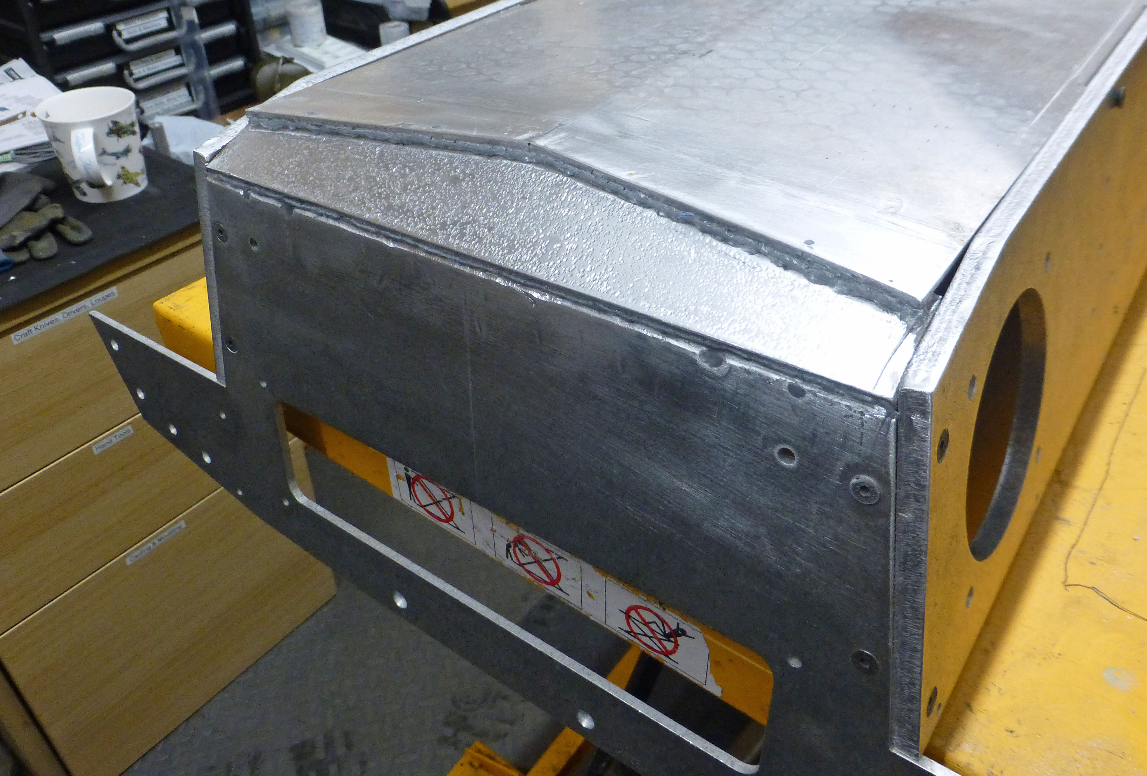

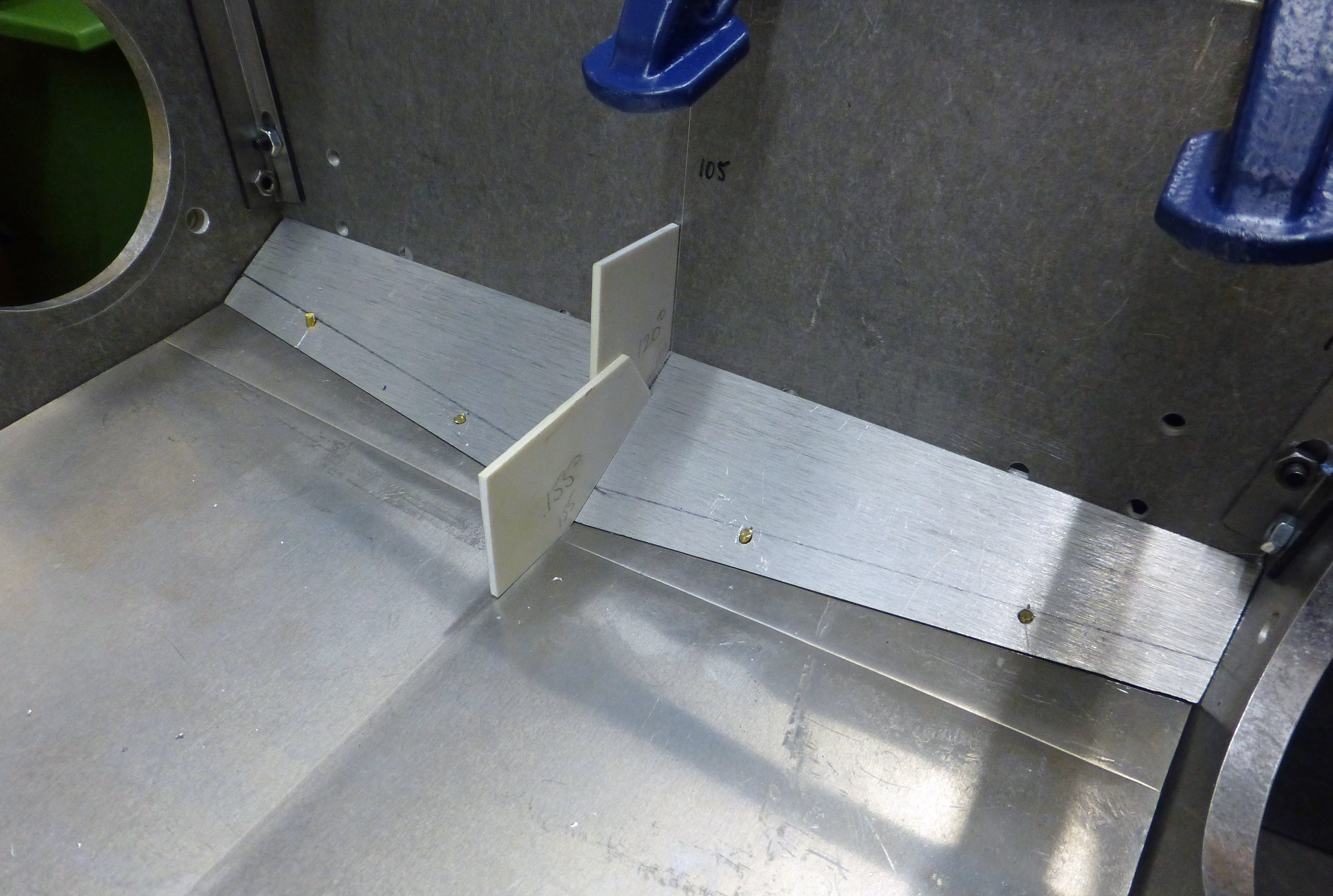

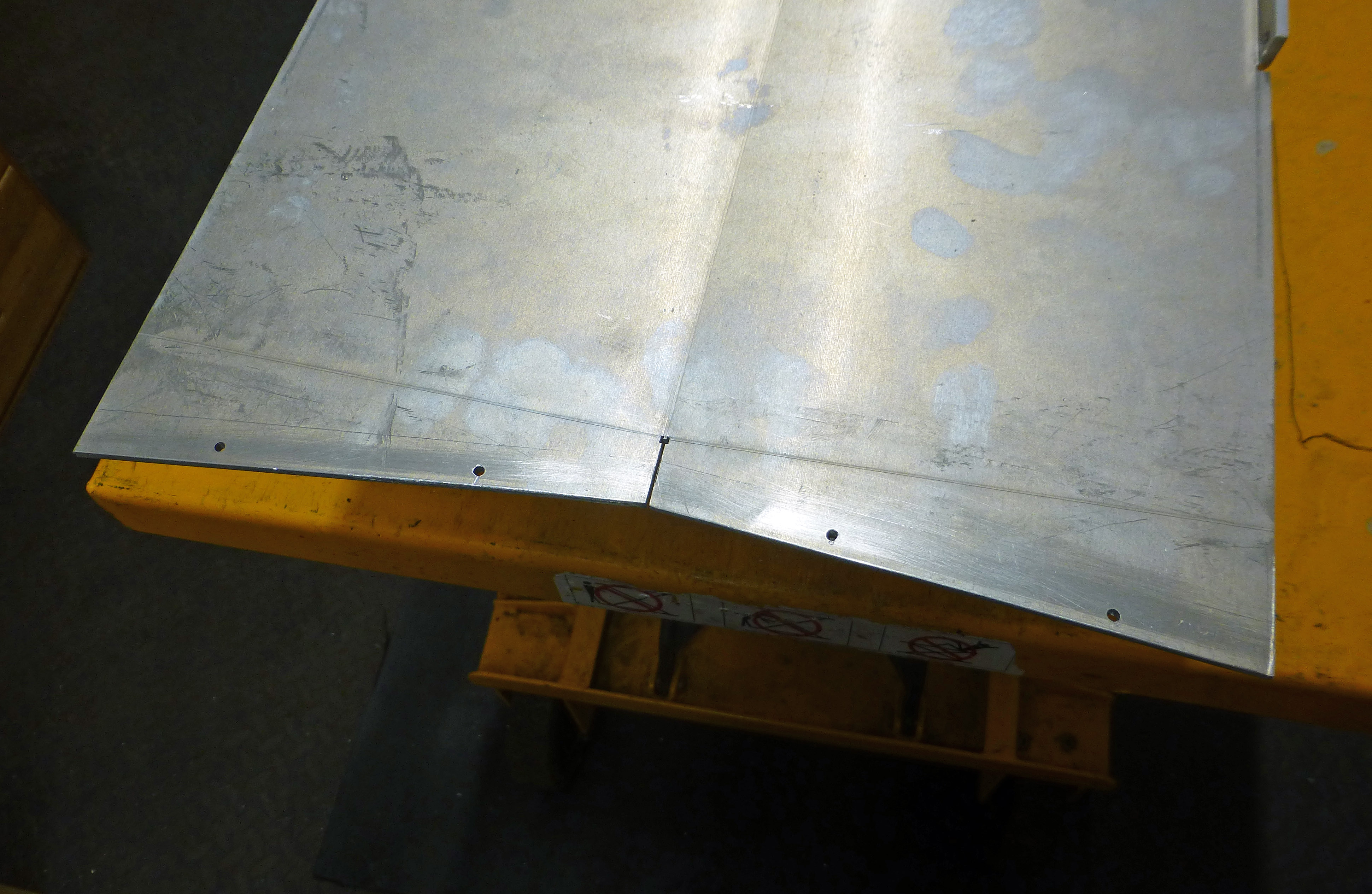

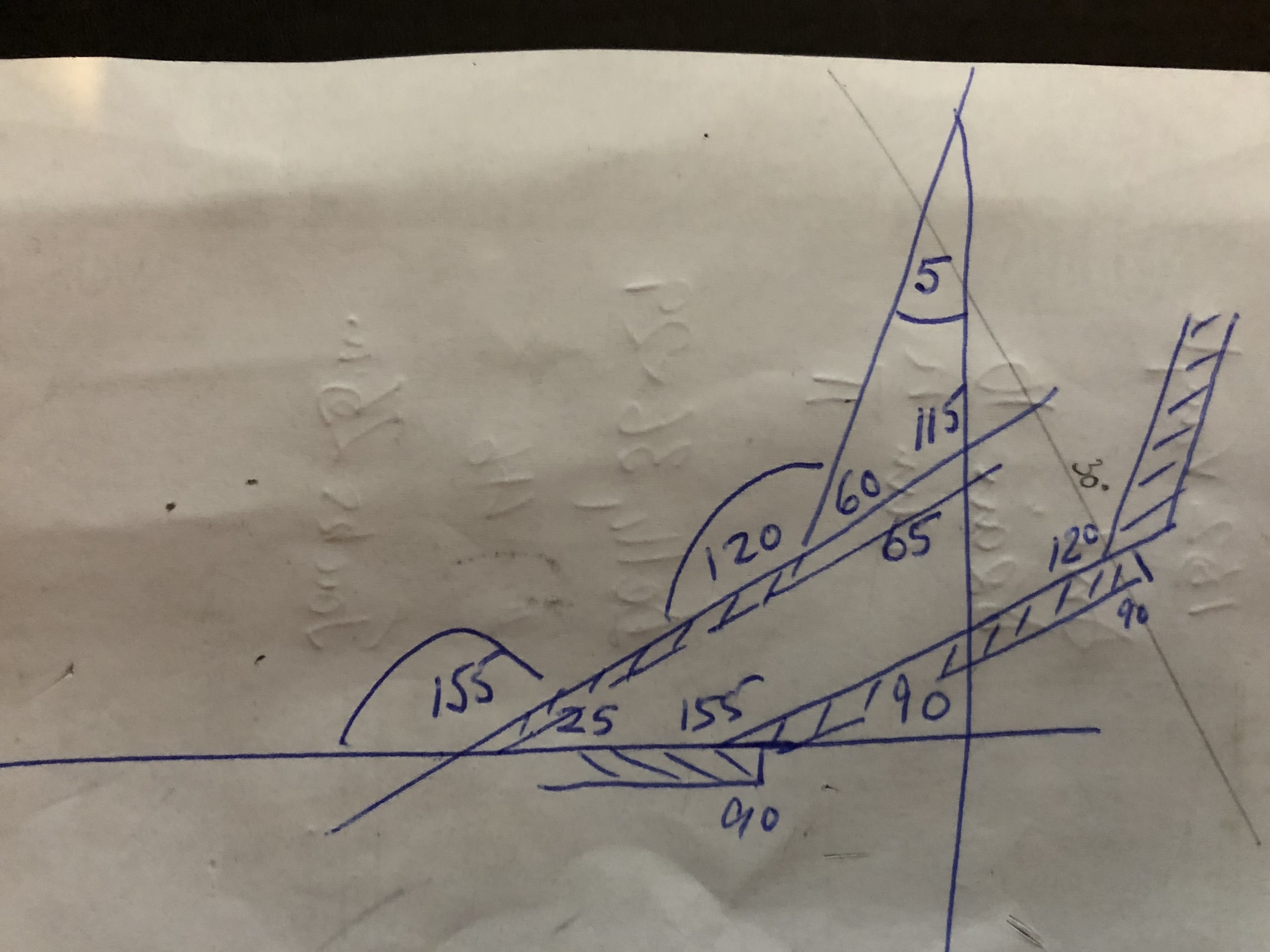

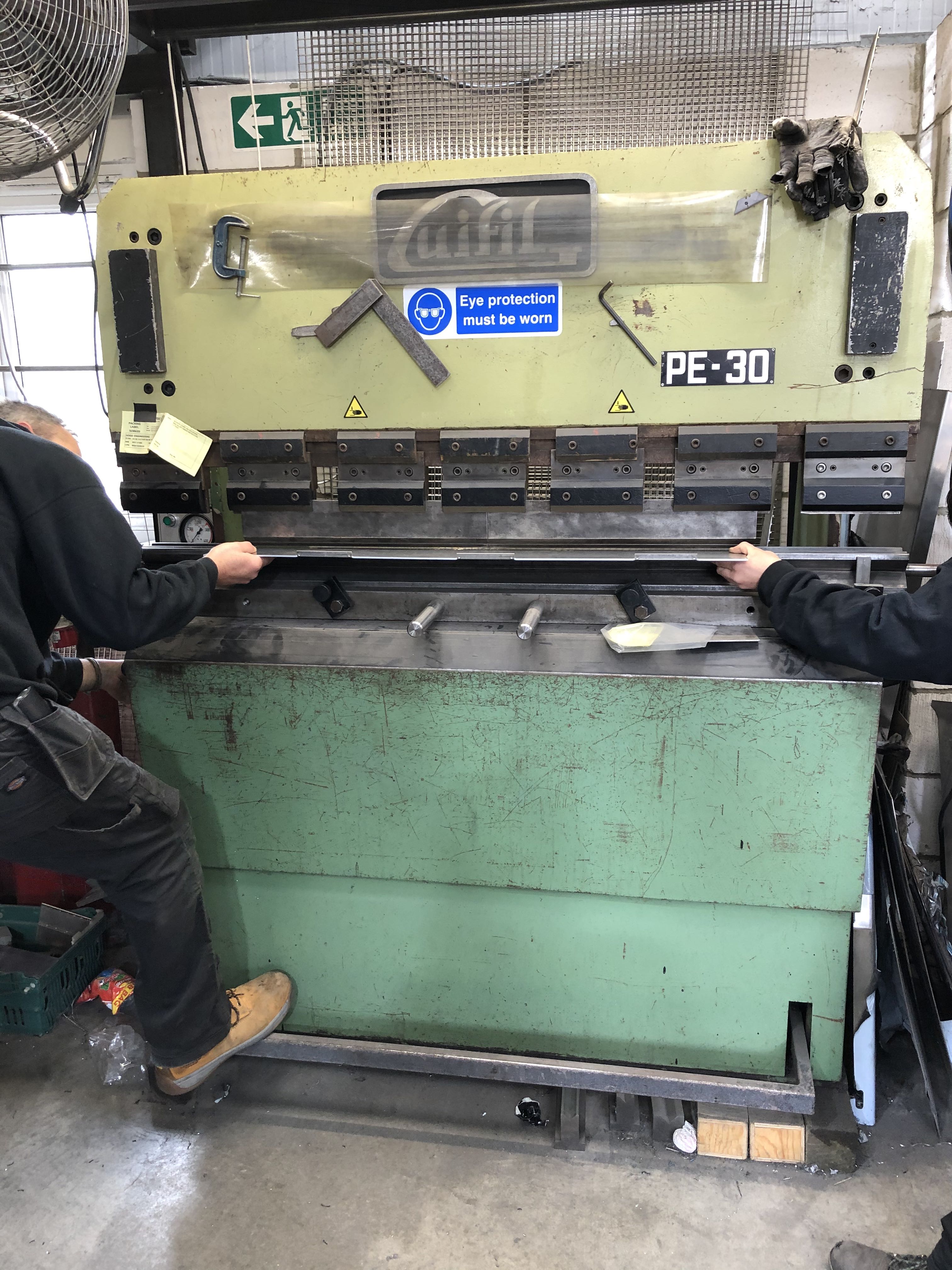

First task in assembling the hull bath tub is the triangular fillet plate at the rear. The geometry of this is fairly illusive, it's all about angles. It took some working out to establish the plane of the fillet plate, which then determines the shape, which I established on paper and then confirmed with a card template. The other aspect is the way in which the real plates are welded, which governs how the plates sit. A sketch spells it out.

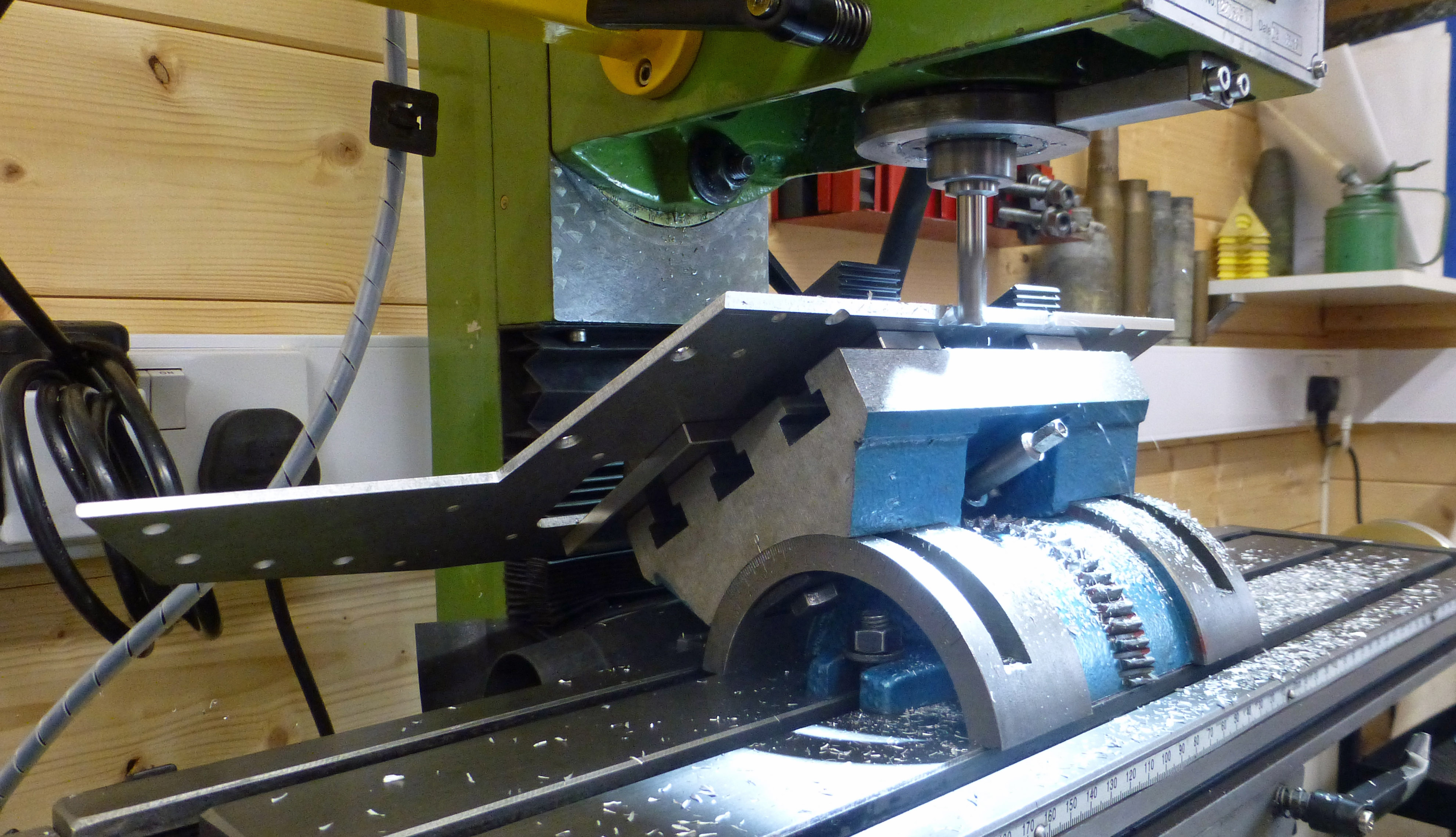

Some preparatory work is needed, to mill a straight edge on the hull rear plate at the correct angle and then flatten the hull bottom plate and cut the necessary V. I also took the bottom plate to a local engineering shop, Hood Engineering in Warmwell, who couldn't have been more helpful, putting it into a whacking great brake press to increase the angle of the V from 3 to 5 deg. This then allows the angles of the V fillet to slot into place.
After machining the part, the next challenge is to hold it in place while I brazed the joints. I used brass rod pins, drilled through the fillet and bottom plate.
The aluminium brazing was not easy. It was important to hold the work pieces in the hull assembly because the angles are critical but this creates a problem of heat sink. There is simply so much metal that with a MAPP gas torch, it takes a while to get the work up to heat and for aluminium, that temperature is in a critically small range of 550 to 660 deg C. The top seam was OK but I found the heat needed for the bottom caused the hull bottom plate to sag a bit, which opened up the joint. If this all sounds like too much faff, it is but at least you end up with a strong hull and no fasteners. The result is pretty authentic but there is still work to do at the corners. I used the UV625 UV sensitive adhesive for the welds, to give additional strength but I'm not very happy with the effect and will add fabric paint to finish.
Re: Chinese Eye Chieftain
That's a lot of work mate, I'm not sure yet but I know you will make it perfect!
You can see why I decided to compromise as the hull side plates now need your attention. Keep it coming!

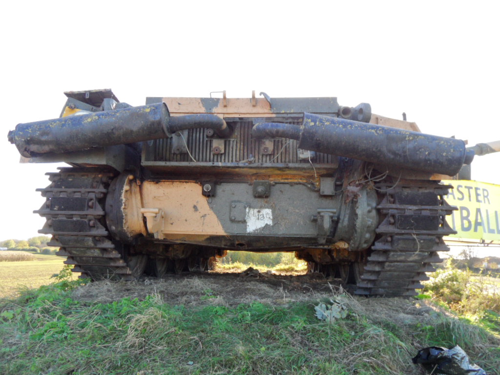

Excellent effort Stephen, that's just how I remember it from the tank I saw on Sunday! I assume you will have sufficient clearance to mount the motors/gearboxes? I also note the nice unevenness of that cloth paint; I could do with that for my stillbrew! Keep up the good work!
- Posts: 1693
- Been liked: 1842 times
Fantastic work Stephen.................... (that bar gets higher and higher).
Looks like I'm gonna have to nip in the shed and get the old Black and Decker workmate out to do my bit of bending
I don't think there's too much to do with the side plates at the rear. I'd just like to get the belly plate flush with the side plates and loose that side plate overlap.
Here's a nice pair of exhausts, you can hardly see the side plates as they blend into the gearboxes.

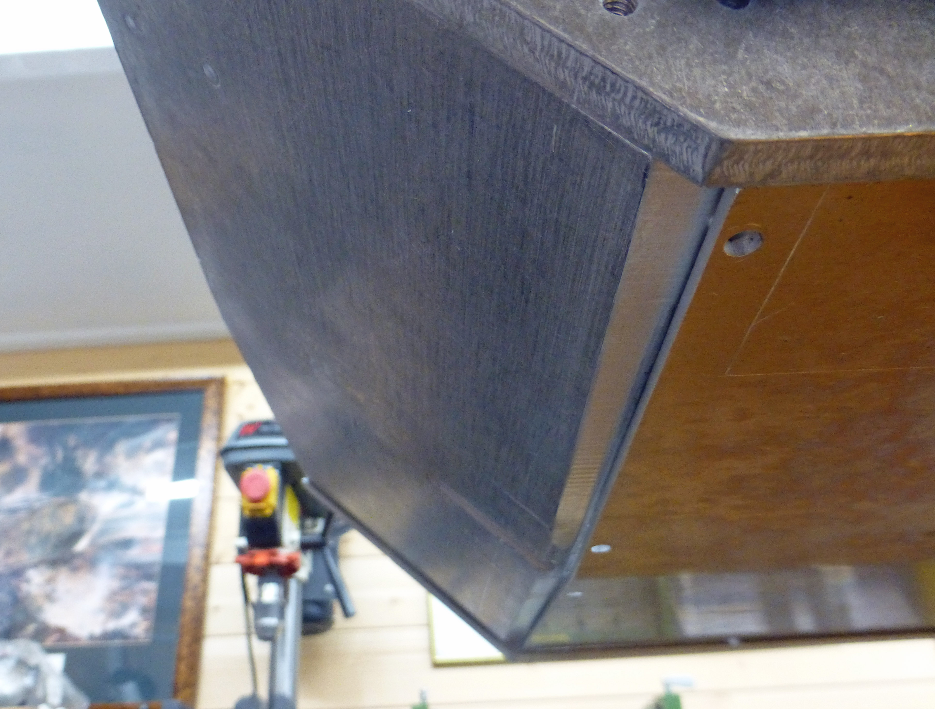

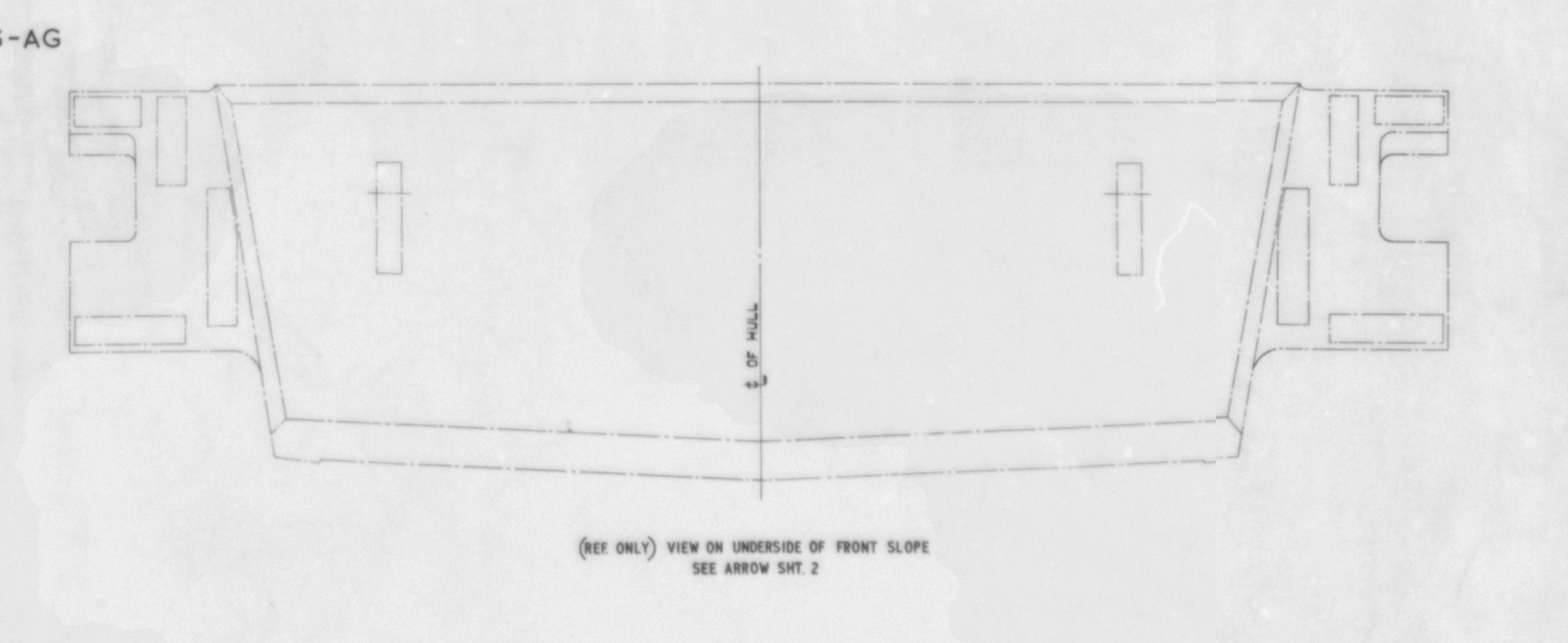

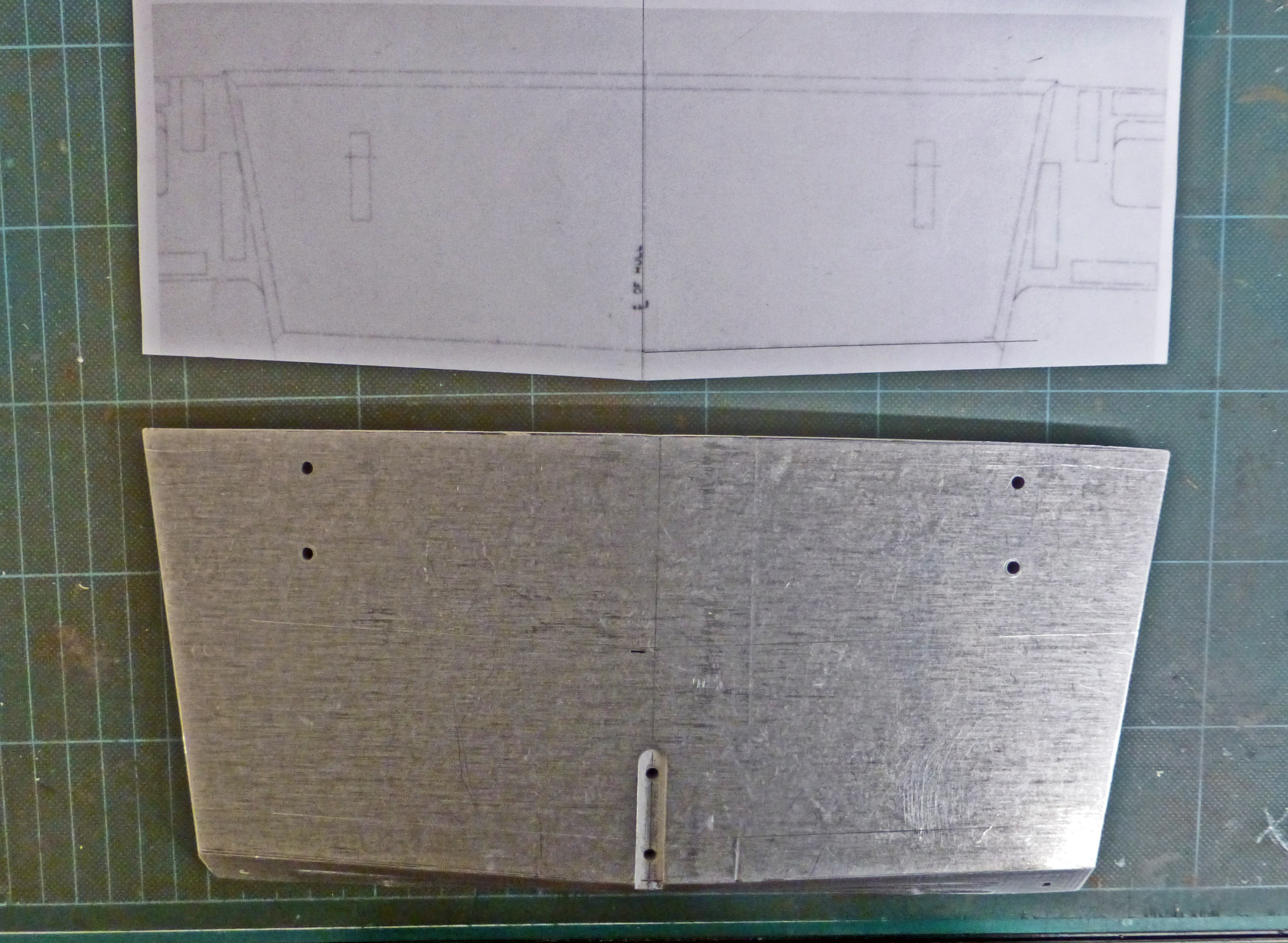

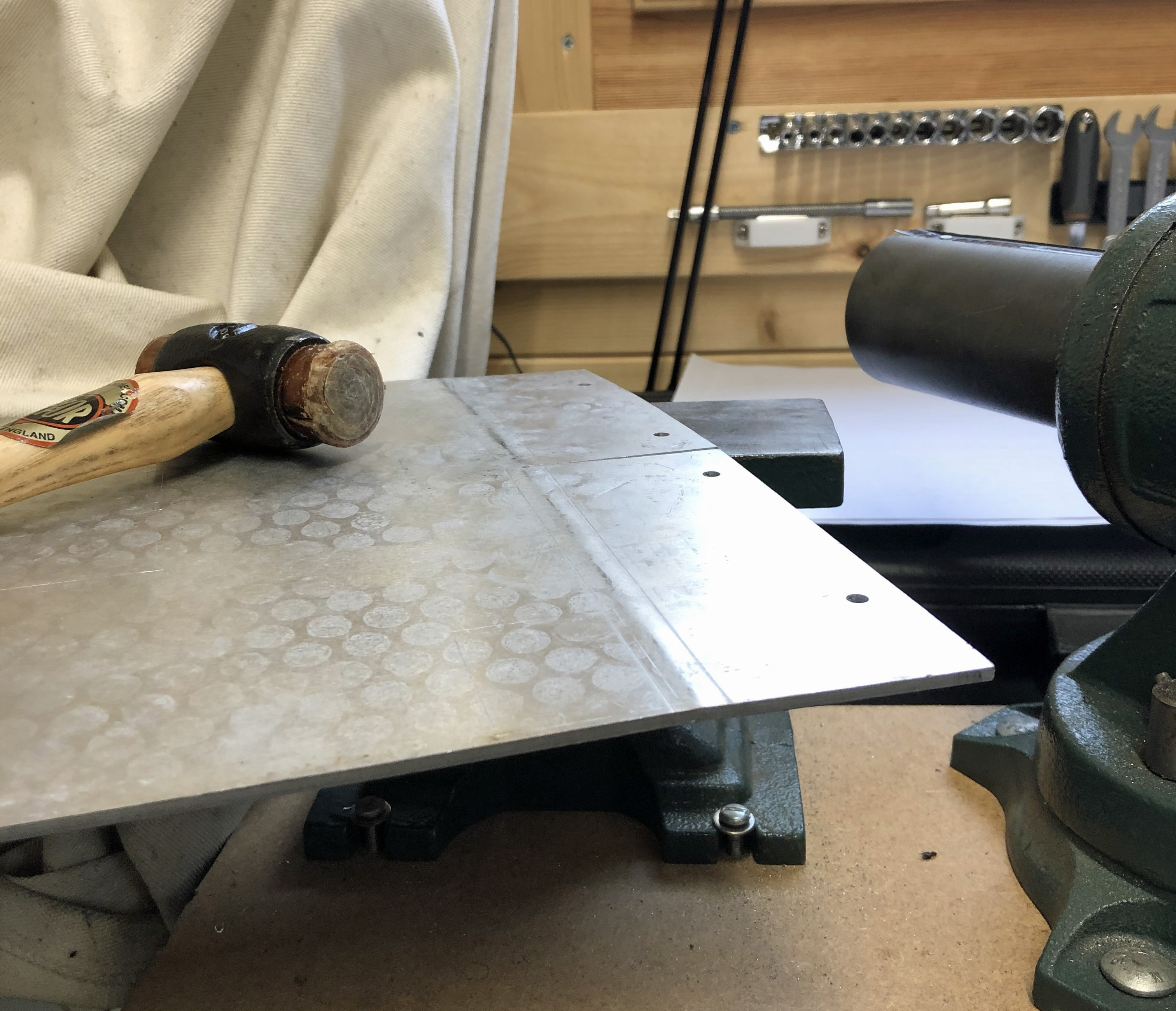

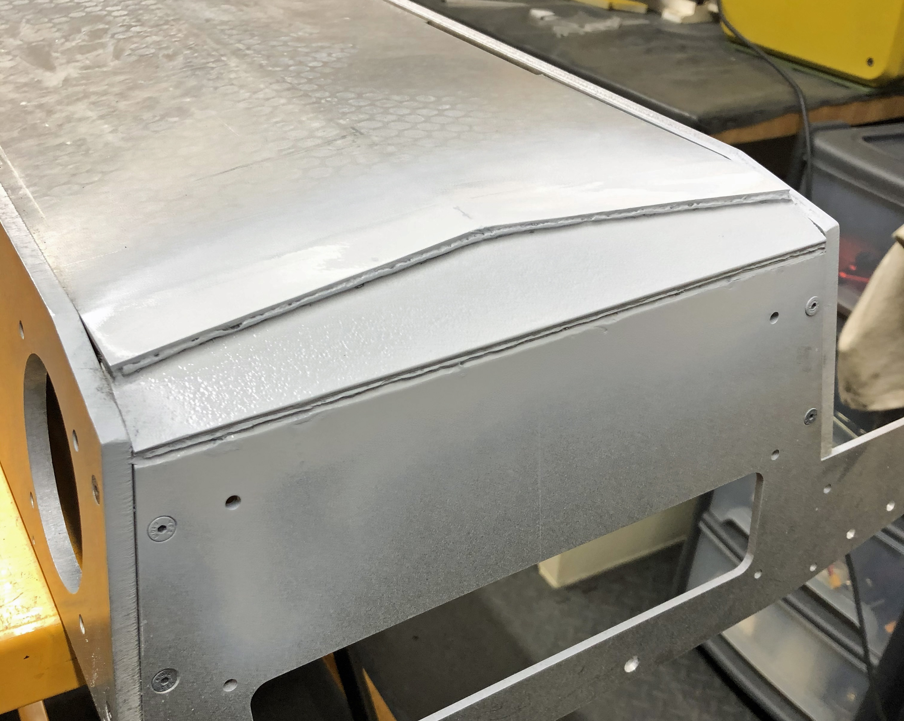

On with sorting out the basic geometry of the hull bath tub. I'll leave the final fit and details until I've got the heavy machining done.

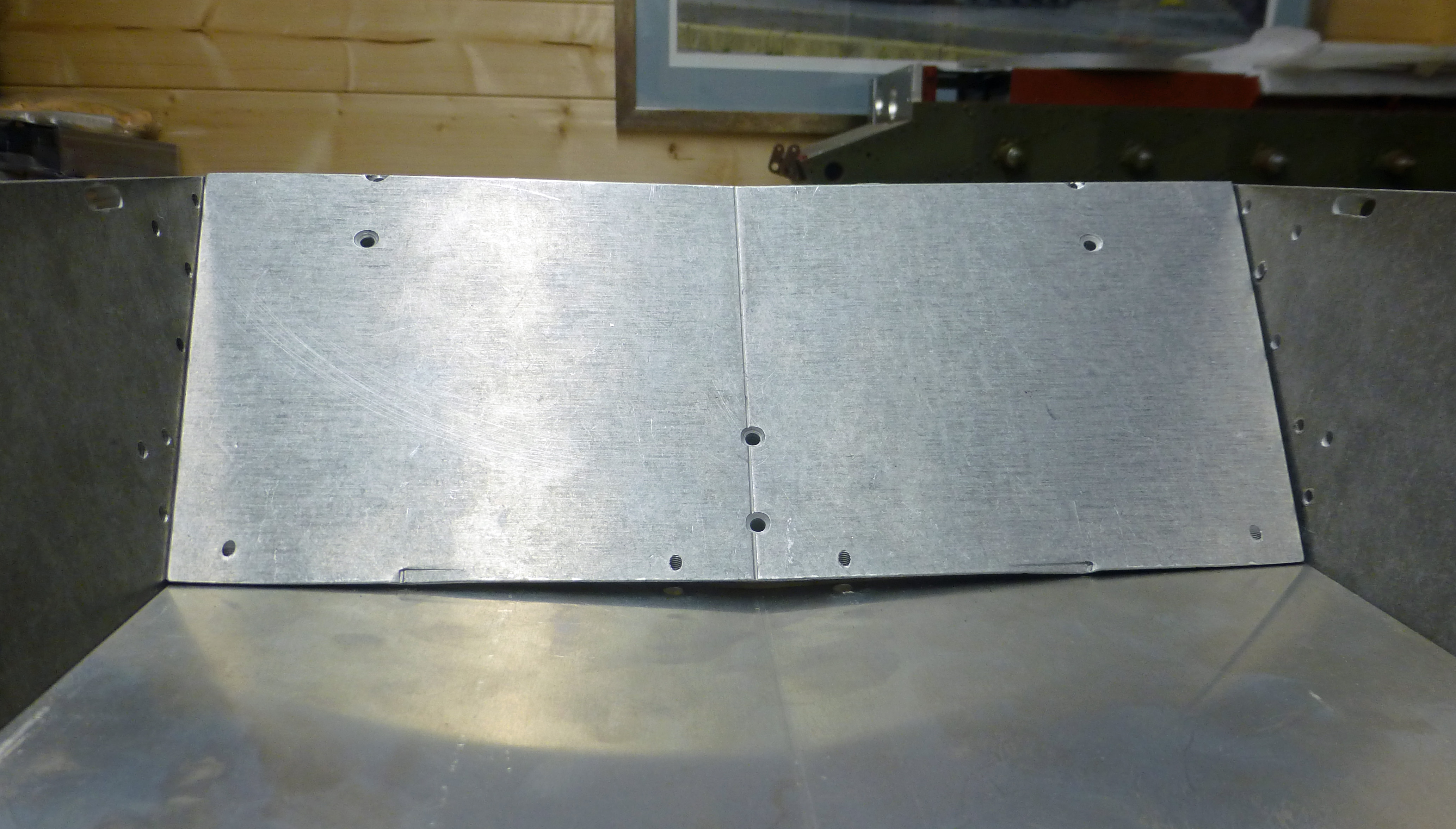

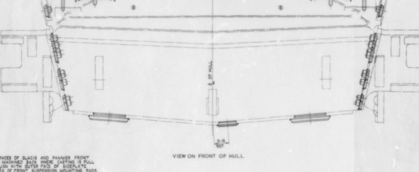

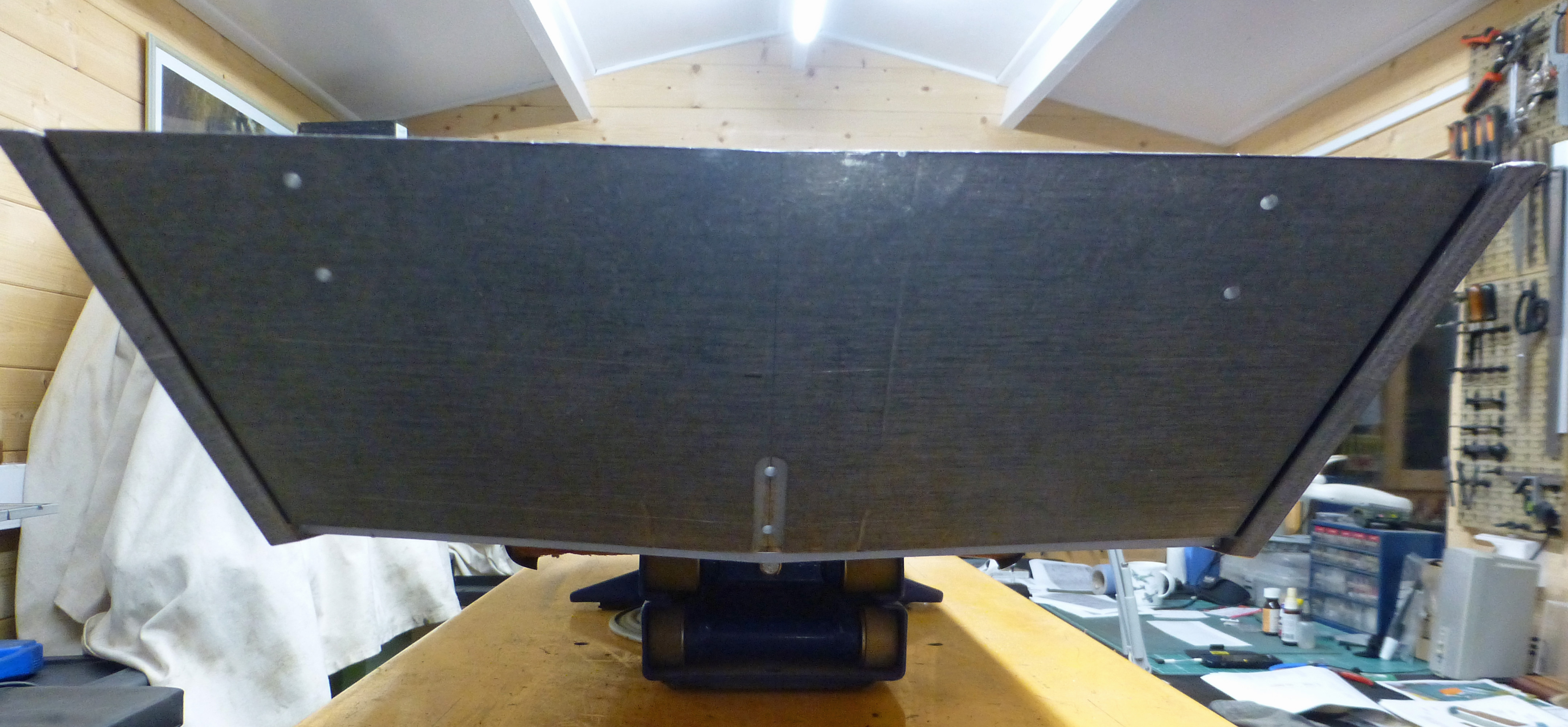

The toe plate really sets the character of the front of the tank. You get two very different perceptions of the shape of the plate depending on whether your perspective is normal to the plane of the plate or parallel with the ground, since the plate sits at 45deg to the horizontal. This is the view horizontal to the ground:
Compare that with the perspective normal to the plane of the plate (ignoring the effect of each half being 3deg off the flat plane)
When compared with the kit part, you can see that there is a chamfer at the top which in reality is at the bottom. The hatched lines show the divergences. , some machining to do. This is also useful because it will secure the fit with the hull bottom plate which now has the correct 5deg V.
The part after machining top and bottom edges:
Fitted to the model, it all comes together. The weld at the bottom now conforms and the gap inside will be easily filled with UV glue.
The hull side plates now need some attention.
